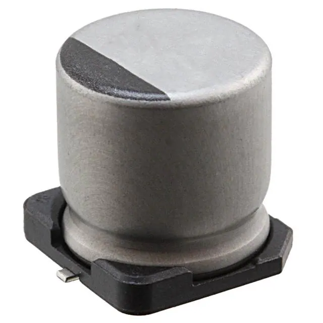

    SMD,D10xL14.5mm
    33UF ±20% 160V
ULT2C330MNL1GS 数据手册
ALUMINUM  ELECTROLYTIC  CAPACITORS LT Chip Type, High Voltage. High Temperature Range. series Chip type, high voltage and high temperature range. Load life of 2000 hours at +125°C. Applicable to automatic mounting machine using carrier tape. Compliant to the RoHS directive (2011/65/EU). LH LT Long Life High Voltage UB Specifications Item Category Temperature Range Rated Voltage Range Rated Capacitance Range Capacitance Tolerance Performance Characteristics –40 to +125°C 160 to 500V 1.8 to 33µF ± 20% at 120Hz, 20°C Leakage Current Rated voltage (V) – Tangent of loss angle (tan δ) Rated voltage (V) tan δ (MAX.) 160~450 0.04CV+100(μA)max.(1 minute's) 500 0.04CV+200(μA)max.(1 minute's) Measurement frequency : 120Hz at 20°C 160 0.20 200 0.20 250 0.25 450 0.30 400 0.25 500 0.30 Measurement frequency : 120Hz Rated voltage (V) Impedance ratio Z–40°C / Z+20°C ZT / Z20 (MAX.) Stability at Low Temperature 160 200 250 400 450 500 6 6 10 10 15 15 Capacitance change The specifications listed at right shall be met when the capacitors are restored to 20°C after the rated voltage is applied for 2000 hours at 125°C. Endurance Leakage current After storing the capacitors under no load at 125°C for 1000 hours and then performing voltage treatment based on JIS C 5101-4 clause 4.1 at 20°C, they shall meet the specified values for the endurance characteristics listed above. The capacitors are kept on a hot plate for 30 seconds, Within ±10% of the initial capacitance value Capacitance change which is maintained at 250°C and then performing voltage treatment based on JIS C 5101-4 clause 4.1 at 20°C, they Less than or equal to the initial specified value tan δ shall meet the characteristic requirements listed at right Less than or equal to the initial specified value Leakage current when they are removed from the plate. Black print on the case top. Shelf Life Resistance to soldering heat Marking Chip Type Type numbering system (Example : 400V 6.8µF) Plastic platform 0.3MAX. Voltage(2G : 400V) Series C±0.2 A B C E L H 8 × 10 10 × 10 2.9 3.2 10.3 8.3 10.3 8.3 3.1 4.5 10 10 0.8 to 1.1 0.8 to 1.1 3 4 5 6 7 8 9 10 11 12 13 14 A±0.2 Taping code Configuration A±0.2 L±1.0 Capacitance tolerance (±20%) Rated capacitance (6.8µF) Negative H Pressure relief vent φD × L 2 U L T 2 G 6 R 8 MNL 1 GS E B±0.2 φD±0.5 A2 6.8 2G LT Lot No. Capacitance 1 Positive 0.5MAX. (φ8 × 10L, φ10) Trade mark Within ±30% of the initial capacitance value 300% or less than the intial specified value Less than or equal to the initial specified value tan δ Rated voltage (400V) (mm) Series name 10 × 13.5 3.2 10.3 10.3 4.5 13.5 0.8 to 1.1 Type Voltage V Code 160 200 250 400 450 500 2C 2D 2E 2G 2W 2H Dimensions Cap.(µF) 1.8 3.3 3.9 4.7 5.6 6.8 7.5 8.2 10 12 15 18 22 27 33 160 2C V Code 1R8 3R3 3R9 4R7 5R6 6R8 7R5 8R2 100 120 150 180 220 270 330 200 2D 8 × 10 45 10 × 10 60 10 × 13.5 65 250 2E 8 × 10 45 10 × 10 60 10 × 13.5 65 400 2G 8 × 10 30 10 × 10 10 × 13.5 45 50 450 2W 8 × 10 30 10 × 10 45 10 × 13.5 50 8 × 10 20 10 × 10 35 10 × 13.5 40 8 × 10 10 × 10 500 2H 20 35 10 × 13.5 40 Case size φ D × L (mm) Rated ripple Rated ripple current (mArms) at 125°C 120Hz Frequency coefficient of rated ripple current Frequency Coefficient 50 Hz 0.70 120 Hz 1.00 300 Hz 1.17 1 kHz 1.36 10 kHz or more 1.50 Taping specifications are given in page 23. Recommended land size, soldering by reflow are given in page 18, 19. Please refer to page 3 for the minimum order quantity. CAT.8100D
