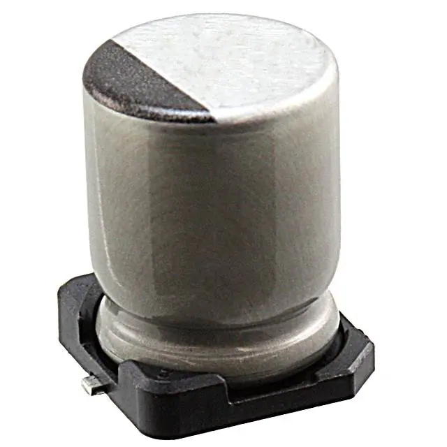

    NICHICON(尼吉康)
    SMD,D8xL11mm
    3.3UF ±20% 450V
ULV2W3R3MNL1GS 数据手册
ALUMINUM  ELECTROLYTIC  CAPACITORS ULV Chip Type, High Voltage. Long Life. Chip Type, high voltage and long life. Load life of 10000 hours at +105°C Applicable to automatic mounting machine using carrier tape. Compliant to the RoHS directive (2011/65/EU,(EU)2015/863). AEC-Q200 Qualified. Please contact us for details. ULV ULR Long Life Specifications Item Performance Characteristics Category Temperature Range –40 to +105°C Rated Voltage Range 160 to 500V Rated Capacitance Range 1.8 to 33µF Capacitance Tolerance ± 20% at 120Hz, 20°C Rated voltage (V) – Leakage Current 160 to 450 0.04CV+100(μA)max.(1 minute's at 20°C) 500 0.04CV+200(μA)max.(1 minute's at 20°C) Measurement frequency : 120Hz at 20°C Tangent of loss angle (tan δ) 160 0.20 Rated voltage (V) tan δ (max.) 200 0.20 250 0.25 400 0.25 500 0.30 450 0.30 Measurement frequency: 120Hz Stability at Low Temperature Rated voltage (V) Impedance ratio Z(–40°C) / Z(+20°C) ZT / Z20 (max.) 160 200 250 400 450 500 6 6 10 10 15 15 Capacitance change tan δ Leakage current Within ±30% of the initial capacitance value 300% or less than the intial specified value Less than or equal to the initial specified value Endurance The specifications listed at right shall be met when the capacitors are restored to 20°C after the rated voltage is applied for 10000 hours at 105°C. Shelf Life After storing the capacitors under no load at 105°C for 1000 hours and then performing voltage treatment based on JIS C 5101-4 clause 4.1 at 20°C, they shall meet the specified values for the endurance characteristics listed above. Resistance to soldering heat The capacitors are kept on a hot plate for 30 seconds, which is maintained at 250°C and then performing voltage treatment based on JIS C 5101-4 clause 4.1 at 20°C, they shall meet the characteristic requirements listed at right when they are removed from the plate. Capacitance change tan δ Leakage current Within ±10% of the initial capacitance value Less than or equal to the initial specified value Less than or equal to the initial specified value Black print on the case top. Marking ※ I : Leakage Current (μA), C : Rated Capacitance (μF), V : Rated Voltage (V) Chip Type Type numbering system (Example : 400V 6.8µF) (φ8 , φ10) Positive C±0.2 0.3max. Series Capacitance A B C E L H 10 × 13.5 3.2 10.3 10.3 4.5 13.5 0.8 to 1.1 5 6 7 8 9 10 11 12 13 14 Capacitance tolerance (±20%) Negative Rated voltage (400V) Series name (mm) 8 × 10 10 × 10 2.9 3.2 10.3 8.3 10.3 8.3 3.1 4.5 10 10 0.8 to 1.1 0.8 to 1.1 4 Configuration Pressure relief vent φD × L 3 Rated capacitance (6.8µF) H L±1.0 2 Taping code A±0.2 E A±0.2 B±0.2 φD±0.5 Trade mark A2 6.8 2G LV Lot No. 1 U L V 2 G 6 R 8 MN L 1 GS 0.5max. Plastic platform Voltage(2G : 400V) Type Voltage V Code 160 200 250 400 450 500 2C 2D 2E 2G 2W 2H Frequency coefficient of rated ripple current Frequency Coefficient 50 Hz 0.80 120 Hz 1.00 300 Hz 1.25 1 kHz 1.40 10 kHz or more 1.60 Dimension table in next page. CAT.8100M ALUMINUM  ELECTROLYTIC  CAPACITORS ULV ■ Dimensions Rated Voltage (V) (code) 160 (2C) 200 (2D) Rated Capacitance (µF) 400 (2G) 500 (2H) 196 50 ULV2C150MNL1GS 0.20 240.8 65 ULV2C220MNL1GS 0.20 311.2 70 ULV2C330MNL1GS 15 8× 10 0.20 22 10× 10 33 10× 13.5 ( ) 12 8× 10 0.20 196 50 ULV2D120MNL1GS 18 10×10 0.20 244 65 ULV2D180MNL1GS 27 10× 13.5 0.20 316 70 ULV2D270MNL1GS 8× 10 0.25 182 35 ULV2E8R2MNL1GS 15 10× 10 0.25 250 50 ULV2E150MNL1GS 18 10× 13.5 0.25 280 55 ULV2E180MNL1GS 3.9 8× 10 0.25 162.4 35 ULV2G3R9MNL1GS 6.8 10× 10 0.25 208.8 50 ULV2G6R8MNL1GS 10 450 (2W) Part Number tan δ 8.2 250 (2E) Leakage Current (µA) at 20℃ after 1 minute Rated Ripple (mArms) (105℃/120Hz) Case Size φD×L(mm) 10× 13.5 0.25 260 55 ULV2G100MNL1GS 3.3 8× 10 0.30 159.4 25 ULV2W3R3MNL1GS 5.6 10× 10 0.30 200.8 40 ULV2W5R6MNL1GS 7.5 10× 13.5 0.30 235 45 ULV2W7R5MNL1GS 1.8 8× 10 0.30 236 25 ULV2H1R8MNL1GS 3.3 10× 10 0.30 266 40 ULV2H3R3MNL1GS 4.7 10× 13.5 0.30 294 45 ULV2H4R7MNL1GS For taping specifications, recommended land size/soldering by reflow and minimum order quantity, please refer to the Guidelines for Aluminum Electrolytic Capacitors. CAT.8100M
