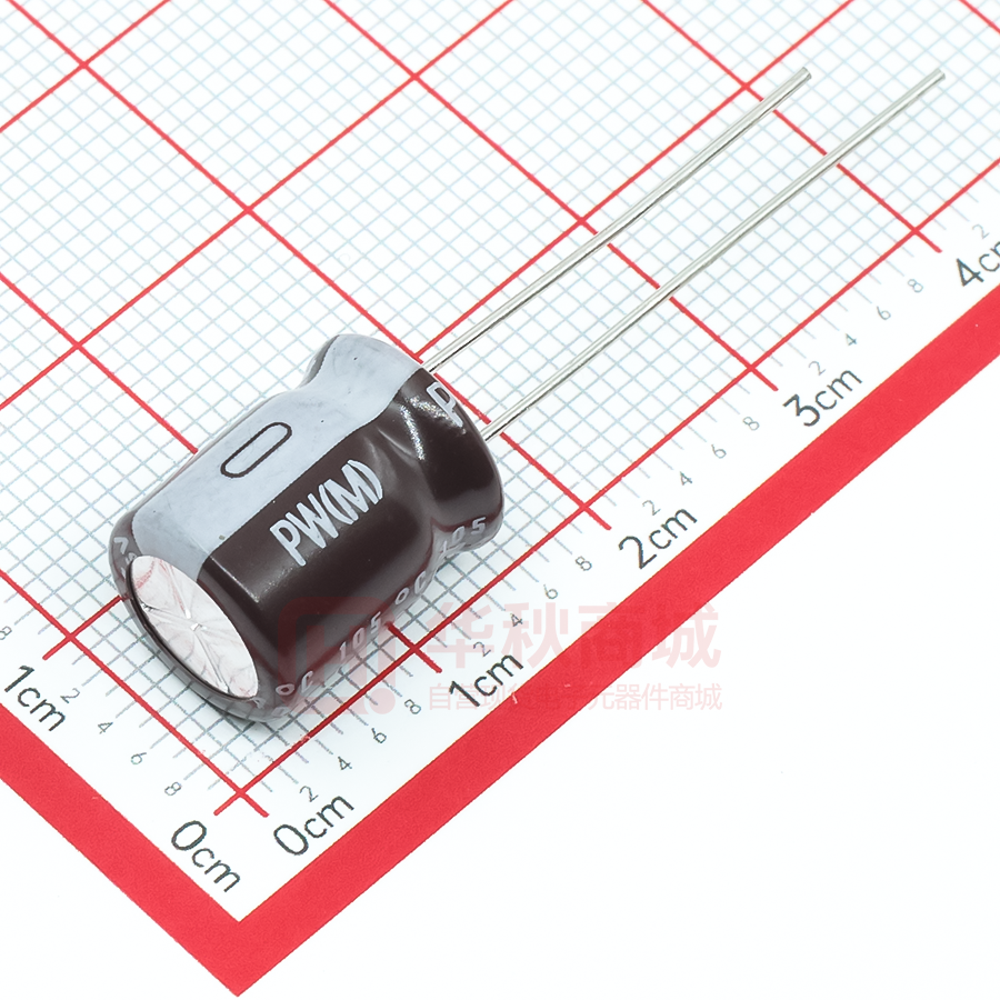

UPW1C471MPD
UPW1C471MPD
    NICHICON(尼吉康)
    插件,D10xL12.5mm
    直插铝电解电容 插件,D10xL12.5mm 470µF ±20% 16V 760mA@100KHz 5000Hrs@105℃
UPW1C471MPD 数据手册
ALUMINUM ELECTROLYTIC CAPACITORS Miniature Sized, Low lmpedance, High Reliability For Switching Power Supplies UPW Smaller case size and lower impedance than UPM. Low impedance and high reliability withstanding 2000 hours to 8000 hours. Capacitance ranges available based on the numerical values in E12 series under JIS. Compliant to the RoHS directive (2011/65/EU). UPM Values marked with an *in the dimension table are scheduled Smaller to be discontinued and are not recommended for new designs. UPW Low Impedance UPA Specifications UTT Long Life Performance Characteristics Item Category Temperature Range –55 to +105˚C (6.3 to 100V), –40 to + 105˚C (160 to 400V), –25 to +105˚C (450V) Rated Voltage Range 6.3 to 450V Rated Capacitance Range 0.47 to 15000µF Capacitance Tolerance ± 20% at 120Hz, 20˚C Rated voltage (V) Leakage Current Leakage current 6.3 to 100 After 1 minute's application of rated voltage at 20°C, leakage current is not more than 0.03CV or 4 (µA), whichever is greater. 160 to 450 CV 1000 : I = 0.04CV+100 (µA) max. For capacitance of more than 1000µF, add 0.02 for every increase of 1000µF. Rated voltage (V) tan δ (MAX.) Tangent of loss angle (tan δ) 6.3 0.22 10 0.19 16 0.16 25 0.14 35 0.12 6.3 · 10 — — 3 16 · 25 — — 3 35 · 50 — — 3 Measurement frequency : 120Hz at 20˚C 50 0.10 63 0.09 100 0.08 160 to 250 315 · 350 400 · 450 0.15 0.20 0.25 250 3 6 — 315 · 350 4 8 — 120Hz Rated voltage (V) Z– 25˚C / Z+20˚C Impedance ratio Z– 40˚C / Z+20˚C (MAX.) Z– 55˚C / Z+20˚C Stability at Low Temperature The specifications listed at right shall be met when the capacitors are restored to 20˚C after D.C. bias plus rated ripple current is applied for 8000 hours (2000 hours for φD=4, 5 and 6.3, 3000 hours for φD=8, 5000 hours for φD=10, 7000 hours for φD=12.5) at 105˚C, the peak voltage shall not exceed the rated voltage. Endurance 63 · 100 160 · 200 — 3 — 4 3 — 400 6 10 — 450 15 — — Capacitance change Within ±20% of the initial capacitance value tan δ 200% or less than the initial specified value Leakage current Less than or equal to the initial specified value Shelf Life After storing the capacitors under no load at 105˚C for 1000 hours and then performing voltage treatment based on JIS C 5101-4 clause 4.1 at 20°C, they shall meet the specified values for the endurance characteristics listed above. Marking Printed with white color letter on dark brown sleeve. Radial Lead Type Type numbering system (Example : 10V 680µF) φd Sleeve (P.E.T.) 1 2 3 4 5 6 7 8 9 10 11 12 Size code P±0.5 φD+ MAX. U PW 1 A 6 8 1 MP D Configuration Capacitance tolerance (±20%) 15MIN L+ MAX. Rated capacitance (680µF) 4MIN Rated voltage (10V) Pressure relief vent φ 6.3up (No pressure relief vent for 7mmL products) Series name Type (mm) (L = 7) 1.0 (L < 20) 1.5 (L 20) 2.0 φD P φd 4 1.5 0.45 0.5 5 2.0 6.3 2.5 0.5 0.5 (0.45) (0.45) 0.5 0.5 8 3.5 10 5.0 12.5 5.0 16 7.5 18 7.5 20 22 25 10.0 10.0 12.5 0.6 0.6 0.8 0.8 1.0 1.0 1.0 0.5 0.5 0.6 0.8 0.5 0.5 0.5 0.5 1.0 1.0 : Applied to L>25 products ( ): Applied to 7mmL products Configuration φD 4·5 6.3 8 · 10 12.5 to 18 20 to 25 Pb-free leadwire Pb-free PET sleeve DD ED (7mm L : DD) PD HD RD • Please refer to page 20 about the end seal configuration. Frequency coefficient of rated ripple current V 6.3 to 100 160 to 450 Frequency 50Hz 120Hz 300Hz 1kHz 10kHz or more 0.47 to 56000 0.20 0.30 0.50 0.80 1.00 68 to 330. 0.55 0.65 0.75 0.85 1.00 390 to 1000. 0.70 0.75 0.80 0.90 1.00 .1200 to 150000 0.80 0.85 0.90 0.95 1.00 0.47 to 22000 0.80 1.00 1.25 1.40 1.60 330 to 4700. 0.90 1.00 1.10 1.13 1.15 Cap. (µF) Please refer to page 20, 21, 22 about the formed or taped product spec. Please refer to page 4 for the minimum order quantity. Dimension table in next page. 201 CAT.8100F ALUMINUM ELECTROLYTIC CAPACITORS UPW Standard Ratings V (Code) Item Cap.(µF) Code Case size φD × L (mm) 6.3 (0J) Impedance (Ω) MAX. 20˚C / 100kHz Rated ripple (mArms) – 10˚C / 100kHz 105˚C / 100kHz 22 220 5 × 11 0.60 1.20 180 27 270 33 330 4×7 5 × 11 5×7 2.00 0.60 0.95 5.00 1.20 2.40 65 180 120 39 390 47 470 56 68 560 680 5 × 11 5×7 5×7 4 × 11 0.60 0.95 0.95 1.30 1.20 2.40 2.40 2.60 180 120 120 120 82 820 100 101 5 × 11 0.60 1.20 180 120 121 150 151 6.3 × 7 6.3 × 11 5 × 15 0.45 0.25 0.50 1.20 0.50 1.00 200 290 235 180 181 220 221 330 331 470 560 6.3 × 11 0.25 0.50 290 471 561 6.3 × 11 6.3 × 15 8 × 11.5 8 × 11.5 0.25 0.23 0.117 0.117 0.50 0.46 0.234 0.234 290 430 555 555 680 681 10 × 12.5 0.090 0.180 755 820 821 8 × 15 10 × 12.5 0.085 0.090 0.170 0.180 730 755 1000 102 10 × 12.5 0.090 0.180 755 1200 122 8 × 20 10 × 16 0.065 0.068 0.130 0.136 995 1050 10 × 20 0.052 0.104 1220 272 12.5 × 20 10 × 25 10 × 31.5 0.038 0.045 0.035 0.076 0.090 0.070 1655 1440 1815 3300 332 12.5 × 20 0.038 0.076 1655 3900 392 12.5 × 25 0.030 0.060 1945 4700 472 5600 562 6800 682 16 × 25 12.5 × 31.5 12.5 × 35.5 16 × 20 16 × 25 18 × 20 0.022 0.025 0.022 0.029 0.022 0.028 0.044 0.050 0.044 0.058 0.044 0.056 2555 2310 2510 2210 2560 2490 8200 822 16 × 31.5 0.018 0.036 3010 10000 103 12000 15000 123 153 16 × 31.5 18 × 25 18 × 31.5 18 × 35.5 0.016 0.020 0.016 0.015 0.032 0.040 0.032 0.030 3150 2740 3635 3680 1500 152 2200 222 2700 Case size φD × L (mm) 10 (1A) Impedance (Ω) MAX. 20˚C / 100kHz Rated ripple (mArms) –10˚C / 100kHz 105˚C / 100kHz 5 × 11 4×7 0.60 2.00 1.20 5.00 180 65 5 × 11 5×7 5×7 5 × 11 4 × 11 0.60 0.95 0.95 0.60 1.30 1.20 2.40 2.40 1.20 2.60 180 120 120 180 120 5 × 11 6.3 × 7 5 × 11 5 × 15 0.60 0.45 0.60 0.50 1.20 1.20 1.20 1.00 180 200 180 235 6.3 × 11 0.25 0.50 290 6.3 × 11 6.3 × 11 6.3 × 15 0.25 0.25 0.23 0.50 0.50 0.46 290 290 430 8 × 11.5 0.117 0.234 555 8 × 11.5 0.117 0.234 555 10 ×12.5 8 × 15 0.090 0.085 0.180 0.170 760 730 10 × 16 8 × 20 0.068 0.065 0.136 0.130 1050 995 10 × 20 0.052 0.104 1220 10 × 20 10 × 25 12.5 × 20 10 × 31.5 12.5 × 25 12.5 × 25 12.5 × 31.5 12.5 × 35.5 16 × 20 0.052 0.045 0.038 0.035 0.030 0.030 0.025 0.022 0.029 0.104 0.090 0.076 0.070 0.060 0.060 0.050 0.044 0.058 1220 1440 1655 1815 1945 1950 2310 2510 2210 16 × 25 0.022 0.044 2555 16 × 25 18 × 20 16 × 31.5 18 × 25 16 × 35.5 18 × 31.5 0.022 0.028 0.018 0.020 0.016 0.016 0.044 0.056 0.036 0.040 0.032 0.032 2560 2490 3010 2740 3150 3635 18 × 35.5 0.015 0.030 3680 18 × 40 0.014 0.028 3800 : In this case, 6 will be put at 12th digit of type numbering system. 202 CAT.8100F ALUMINUM ELECTROLYTIC CAPACITORS UPW Standard Ratings V(Code) Item Cap. (µF) Code Case size φD × L (mm) 16 (1C) Impedance (Ω) MAX. 20˚C / 100kHz Rated ripple (mArms) – 10˚C / 100kHz 105˚C / 100kHz 00004.7 4R7 00010 100 5 × 11 0.60 1.20 180 00015 150 00022 220 00027 270 00033 330 4×7 5 × 11 5×7 5×7 5 × 11 6.3 × 7 2.00 0.60 0.95 0.95 0.60 0.45 5.00 1.20 2.40 2.40 1.20 1.20 65 180 120 120 180 200 00039 390 4 × 11 1.30 2.60 120 00047 470 00056 560 00082 00100 00120 00150 00180 00220 820 101 121 151 181 221 5 × 11 5 × 11 6.3 × 7 5 × 15 6.3 × 11 6.3 × 11 6.3 × 11 6.3 × 15 8 × 11.5 0.60 0.60 0.45 0.50 0.25 0.25 0.25 0.23 0.117 1.20 1.20 1.20 1.00 0.50 0.50 0.50 0.46 0.234 180 180 200 235 290 290 290 430 555 00330 331 8 × 11.5 0.117 0.234 555 00470 471 10 × 12.5 8 × 15 0.090 0.085 0.180 0.170 760 730 00560 561 00680 681 00820 821 10 × 16 8 × 20 10 × 20 0.068 0.065 0.052 0.136 0.130 0.104 1050 995 1220 01000 102 10 × 20 0.052 0.104 1220 01200 122 01500 152 10 × 25 12.5 × 20 10 × 31.5 0.045 0.038 0.035 0.090 0.076 0.070 1440 1655 1815 01800 182 02200 222 12.5 × 25 0.030 0.060 1945 02700 272 12.5 × 31.5 16 × 20 16 × 25 12.5 × 35.5 16 × 25 18 × 20 16 × 31.5 18 × 25 16 × 35.5 18 × 31.5 18 × 35.5 18 × 35.5 18 × 40 0.025 0.029 0.022 0.022 0.022 0.028 0.018 0.020 0.016 0.016 0.015 0.015 0.014 0.050 0.058 0.044 0.044 0.044 0.056 0.036 0.040 0.032 0.032 0.030 0.030 0.028 2310 2210 2555 2510 2560 2490 3010 2740 3150 3635 3680 3680 3800 03300 332 03900 392 04700 472 05600 562 06800 08200 10000 682 822 103 Case size φD × L (mm) 25 (1E) Impedance (Ω) MAX. 20˚C / 100kHz Rated ripple (mArms) –10˚C / 100kHz 105˚C / 100kHz 5 × 11 5 × 11 4×7 0.60 0.60 2.00 1.20 1.20 5.00 180 180 65 5 × 11 5×7 4 × 11 0.60 0.95 1.30 1.20 2.40 2.60 180 120 120 5 × 11 0.60 1.20 180 5 × 11 6.3 × 7 5 × 11 0.60 0.45 0.60 1.20 1.20 1.20 180 200 180 5 × 15 0.50 1.00 235 6.3 × 11 6.3 × 11 6.3 × 15 8 × 11.5 0.25 0.25 0.23 0.117 0.50 0.50 0.46 0.234 290 290 430 555 8 × 11.5 10 × 12.5 8 × 15 10 × 16 8 × 20 10 × 20 0.117 0.090 0.085 0.068 0.065 0.052 0.234 0.180 0.170 0.136 0.130 0.104 555 760 730 1050 995 1220 10 × 20 0.052 0.104 1220 10 × 25 12.5 × 20 10 × 31.5 0.045 0.038 0.035 0.090 0.076 0.070 1440 1660 1815 16 × 25 12.5 × 25 12.5 × 31.5 16 × 20 16 × 25 18 × 20 12.5 × 35.5 0.022 0.030 0.025 0.029 0.022 0.028 0.022 0.044 0.060 0.050 0.058 0.044 0.056 0.044 2555 1950 2310 2210 2555 2490 2510 16 × 25 0.022 0.044 2555 16 × 31.5 18 × 25 16 × 35.5 18 × 31.5 0.018 0.020 0.016 0.016 0.036 0.040 0.032 0.032 3010 2740 3150 3635 18 × 35.5 0.015 0.030 3680 18 × 40 0.014 0.028 3800 : In this case, 6 will be put at 12th digit of type numbering system. : In this case, 3 will be put at 12th digit of type numbering system. 203 CAT.8100F ALUMINUM ELECTROLYTIC CAPACITORS UPW Standard Ratings V(Code) Item Cap.(µF) Code 0000.47 0001 0002.2 0003.3 0004.7 0006.8 R47 010 2R2 3R3 4R7 6R8 0010 100 0012 0018 0022 120 180 220 0027 270 0033 0039 0047 0056 0082 0100 330 390 470 560 820 101 0120 121 0150 151 0180 181 0220 221 0270 271 0330 331 0390 0470 0560 391 471 561 0680 681 0820 821 1000 102 1200 122 1500 152 1800 182 2200 222 2700 272 3300 4700 332 472 Case size φD × L (mm) 35 (1V) Impedance (Ω) MAX. 20˚C / 100kHz Rated ripple (mArms) – 10˚C / 100kHz 105˚C / 100kHz 5 × 11 4×7 5 × 11 5×7 5×7 4 × 11 5 × 11 5 × 11 6.3 × 7 5 × 11 5 × 15 6.3 × 11 6.3 × 11 6.3 × 15 8 × 11.5 0.60 2.00 0.60 0.95 0.95 1.30 0.60 0.60 0.45 0.60 0.50 0.25 0.25 0.23 0.117 1.20 5.00 1.20 2.40 2.40 2.60 1.20 1.20 1.20 1.20 1.00 0.50 0.50 0.46 0.234 180 65 180 120 120 120 180 180 200 180 235 290 290 430 555 8 × 11.5 0.117 0.234 555 10 × 12.5 8 × 15 0.090 0.085 0.180 0.170 760 730 10 × 16 8 × 20 10 × 20 10 × 20 10 × 25 12.5 × 20 10 × 31.5 0.068 0.065 0.052 0.052 0.045 0.038 0.035 0.136 0.130 0.104 0.104 0.090 0.076 0.070 1050 995 1220 1220 1440 1660 1815 12.5 × 25 12.5 × 31.5 16 × 20 16 × 25 12.5 × 35.5 16 × 25 18 × 20 16 × 31.5 18 × 25 16 × 35.5 18 × 31.5 18 × 35.5 18 × 40 0.030 0.025 0.029 0.022 0.022 0.022 0.028 0.018 0.020 0.016 0.016 0.015 0.014 0.060 0.050 0.058 0.044 0.044 0.044 0.056 0.036 0.040 0.032 0.032 0.030 0.028 1950 2310 2210 2555 2510 2555 2490 3010 2740 3150 3635 3680 3800 Case size φD × L (mm) 50 (1H ) Impedance (Ω) MAX. 20˚C / 100kHz Rated ripple (mArms) –10˚C / 100kHz 105˚C / 100kHz *5 × 11 *5 × 11 5 × 11 5 × 11 5 × 11 5.00 3.50 3.00 2.60 2.30 10.0 7.00 6.00 5.20 4.60 25 40 55 65 90 5 × 11 4 × 11 1.40 2.50 2.80 5.00 120 90 5 × 11 5 × 11 1.30 1.20 2.60 2.40 155 170 5 × 15 0.90 1.80 215 6.3 × 11 0.43 0.86 300 6.3 × 11 6.3 × 15 8 × 11.5 8 × 11.5 8 × 15 10 × 12.5 10 × 12.5 8 × 20 10 × 16 10 × 16 10 × 20 10 × 25 10 × 20 10 × 31.5 12.5 × 20 12.5 × 20 12.5 × 25 12.5 × 25 16 × 20 12.5 × 35.5 18 × 20 16 × 25 16 × 31.5 18 × 25 16 × 31.5 16 × 35.5 0.43 0.40 0.234 0.234 0.155 0.162 0.162 0.120 0.119 0.119 0.090 0.082 0.090 0.060 0.063 0.060 0.050 0.050 0.048 0.034 0.042 0.034 0.028 0.029 0.028 0.025 0.86 0.80 0.468 0.468 0.310 0.324 0.324 0.240 0.238 0.238 0.180 0.164 0.180 0.120 0.126 0.120 0.100 0.100 0.096 0.068 0.084 0.068 0.056 0.058 0.056 0.050 300 360 485 485 635 620 615 860 850 850 1030 1200 1030 1610 1480 1500 1832 1840 1840 2290 2420 2235 2700 2610 2700 2790 18 × 31.5 0.025 0.050 3000 18 × 35.5 0.023 0.046 3100 : In this case, 6 will be put at 12th digit of type numbering system. 204 CAT.8100F ALUMINUM ELECTROLYTIC CAPACITORS UPW Standard Ratings V(Code) Item Co de Cap.(µF) 0000.47 0001 0002.2 0003.3 0004.7 R47 010 2R2 3R3 4R7 0006.8 6R8 0010 0012 0015 0018 0022 Case size φD × L (mm) 63 (1J) Impedance (Ω) MAX. 20˚C / 100kHz Rated ripple (mArms) – 10˚C / 100kHz 105˚C / 100kHz 100 120 150 180 220 00.5 × 11 00.5 × 11 4 × 11 00.5 × 11 0.05 × 11 06.3 × 11 0.05 × 15 06.3 × 11 4.70 2.50 3.50 2.10 2.00 1.20 1.30 0.71 9.40 5.00 7.00 4.20 4.00 2.40 2.60 1.42 68 95 80 110 145 160 200 250 0033 330 06.3 × 11 0.71 1.42 250 0039 390 06.3 × 15 0.70 1.40 330 0047 470 0.08 × 11.5 0.342 0.684 405 0068 0082 680 820 0.08 × 11.5 0.342 0.684 405 0100 101 0120 0150 121 151 0180 181 0220 221 0270 0330 271 331 0390 391 0470 471 0.10 × 12.5 8 × 15 0.10 × 16 0.10 × 16 0.10 × 20 12.5 × 15 0.10 × 20 10 × 25 0.16 × 15 12.5 × 20 12.5 × 25 18 × 15 12.5 × 25 12.5 × 31.5 16 × 20 0.256 0.230 0.194 0.194 0.147 0.150 0.147 0.130 0.090 0.085 0.070 0.086 0.070 0.055 0.059 0.512 0.460 0.388 0.388 0.294 0.300 0.294 0.260 0.180 0.170 0.140 0.172 0.140 0.110 0.118 540 535 600 660 890 1020 885 1050 1410 1290 1720 1690 1720 2090 1770 0560 561 0.16 × 25 12.5 × 35.5 18 × 20 0.16 × 31.5 18 × 25 0.16 × 31.5 16 × 35.5 0.18 × 31.5 0.18 × 35.5 0.18 × 40 0.050 0.047 0.055 0.043 0.043 0.043 0.036 0.032 0.030 0.028 0.100 0.094 0.110 0.086 0.086 0.086 0.072 0.064 0.060 0.056 2160 2270 2290 2670 2590 2770 2770 2950 3100 3200 0680 681 0820 821 1000 102 1200 1500 2200.00 122 152 222 Case size φD × L (mm) 100 (2A) Impedance (Ω) MAX. 20˚C / 100kHz Rated ripple (mArms) –10˚C / 100kHz 105˚C / 100kHz 00.5 * × 11 00.5 * × 11 00.5 × 11 00.5 × 11 00.5 × 11 43.0 20.0 9.80 6.60 4.60 86.0 40.0 19.6 13.2 9.20 20 30 44 58 74 00.5 × 11 3.50 7.00 95 06.3 × 11 1.80 3.60 130 0.08 × 11.5 06.3 × 15 0.08 × 11.5 0.10 × 12.5 8 × 15 0.83 0.80 0.68 0.46 0.45 1.66 1.60 1.36 0.92 0.90 180 200 230 320 360 0.10 × 16 8 × 20 0.10 × 20 0.10 × 25 0.37 0.37 0.30 0.25 0.74 0.74 0.60 0.50 420 420 490 540 12.5 × 20 0.18 0.36 580 12.5 × 25 12.5 × 31.5 16 × 20 0.16 × 25 18 × 20 0.13 0.12 0.13 0.10 0.11 0.26 0.24 0.26 0.20 0.22 710 790 750 890 850 0.16 × 25 0.090 0.18 1080 0.18 × 25 0.083 0.166 1260 16 × 31.5 0.076 0.152 1310 0.18 × 31.5 0.068 0.136 1370 0.16 × 35.5 0.064 0.128 1410 0.18 × 40 0.047 0.094 1520 0. : In this case, 6 will be put at 12th digit of type numbering system. : In this case, 3 will be put at 12th digit of type numbering system. Cap. (µF) V (Code) 160 200 250 315 350 400 450 Code 2C 2D 11 2E 2F 2V 2G 2W R47 6.3 × 11 12 6.3 × 1 010 6.3 × 11 17 2.2 2R2 6.3 × 11 25 3.3 3R3 8 × 11.5 36 4.7 4R7 8 × 11.5 10 100 10 × 12.5 22 220 33 47 12 6.3 × 11 12 6.3 × 11 17 6.3 × 11 6.3 × 11 25 8 × 11.5 8 × 11.5 36 43 10 × 12.5 70 10 × 20 330 470 100 8 × 11.5 11 8 × 11.5 11 17 8 × 11.5 16 10 × 12.5 17 10 × 12.5 16 10 × 12.5 18 29 10 × 12.5 28 10 × 16 31 10 × 16 27 10 × 20 29 10 × 12.5 42 10 × 12.5 34 10 × 16 38 10 × 20 36 12.5 × 20 41 50 10 × 12.5 50 10 × 16 45 10 × 20 49 10 × 20 43 12.5 × 20 49 10 × 16 80 10 × 20 88 10 × 20 72 12.5 × 20 82 12.5 × 25 72 16 × 25 130 10 × 20 140 12.5 × 25 155 12.5 × 25 120 16 × 25 130 16 × 25 110 12.5 × 20 180 12.5 × 25 190 12.5 × 25 12.5 × 25 220 12.5 × 25 220 101 16 × 25 330 220 221 •18 × 35.5 500 330 331 20 × 40 470 471 22 × 50 0.47 16 × 31.5 335 • 190 16 × 25 155 16 × 31.5 160 16 × 31.5 140 230 16 × 35.5 190 •18 × 35.5 200 •18 × 35.5 170 20 × 40 175 340 Δ18 × 40 285 20 × 40 290 22 × 50 350 25 × 50 350 22 × 50 540 25 × 50 550 • 515 20 × 40 525 900 22 × 40 1100 22 × 50 1150 1200 22 × 50 1310 25 × 50 1350 • 115 16 × 25 18 × 35.5 Δ18 × 40 1 Rated ripple current (mArms) at 105˚C 120Hz Size φ20 × 31 is available for capacitors marked " " Size φ20 × 35 is available for capacitors marked " Δ " In this case, 6 will be put at 12th digit of type numbering system. 75 16 × 31.5 18 × 35.5 205 145 Case size φ D × L (mm) CAT.8100F 1
