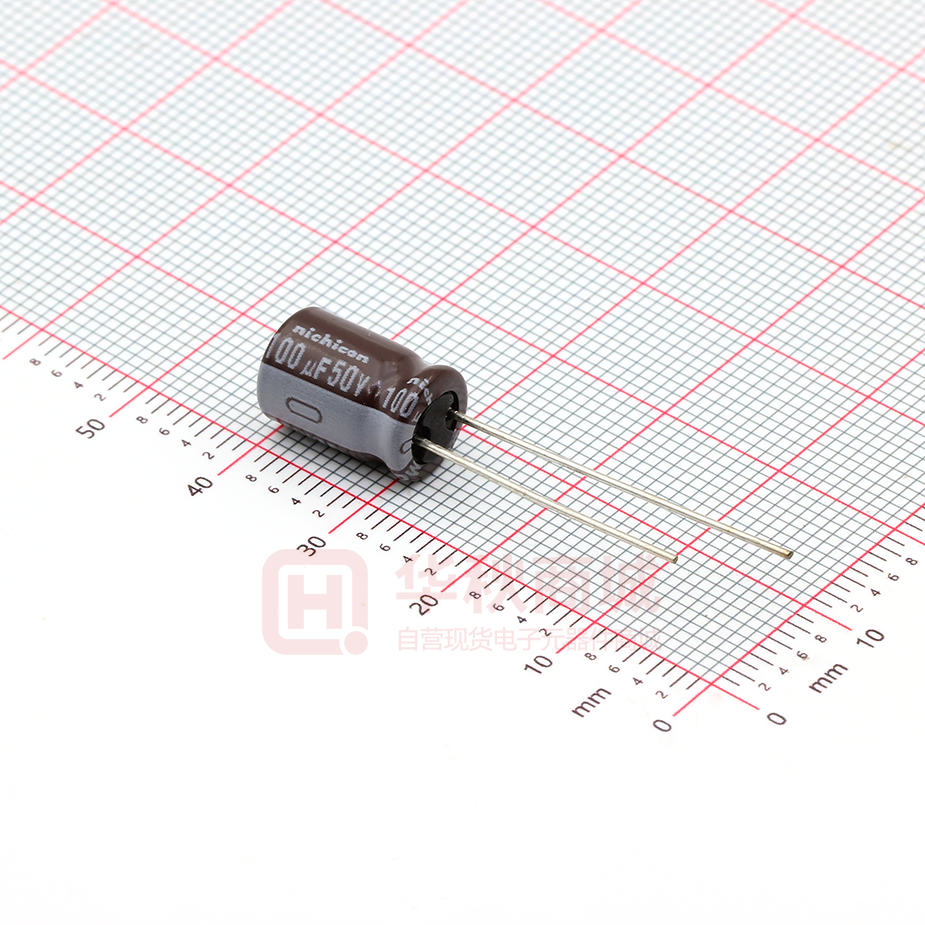

    直插铝电解电容 插件,D8xL11.5mm 100µF ±20% Ф8.00 x 11.50mm 50V 234mΩ 485mA 3000Hrs@105℃
UPW1H101MPD 数据手册
ALUMINUM ELECTROLYTIC CAPACITORS UPW Smaller case size and lower impedance than UPM. Low impedance and high reliability withstanding 2000 hours to 8000 hours. Capacitance ranges available based on the numerical values in E12 series under JIS. Compliant to the RoHS directive (2011/65/EU,(EU)2015/863). Low UPA AEC-Q200 compliant. Please contact us for details. Impedance UPM Smaller UPW Valued marked with an ※ in the dimension table are scheduled to be discontinued and are not recommended for new designs. Specifications Performance Characteristics Item Category Temperature Range –55 to +105˚C (6.3 to 100V),  –40 to + 105˚C (160 to 400V),  –25 to +105˚C (450V) Rated Voltage Range 6.3 to 450V Rated Capacitance Range 0.47 to 15000µF Capacitance Tolerance ± 20%  at 120Hz, 20˚C Leakage Current ※ Rated voltage (V) 6.3 to 100 Leakage current After 1 minute's application of rated voltage at 20°C, leakage current is not more than 0.03CV or 4 (µA), whichever is greater. For capacitance of more than 1000µF, add 0.02 for every increase of 1000µF. Tangent of loss angle (tan δ) Rated voltage (V) tan δ (max.) Stability at Low Temperature Rated voltage (V) Z(–25˚C) / Z(+20˚C) Impedance ratio Z(–40˚C) / Z(+20˚C) (max.) Z(–55˚C) / Z(+20˚C) 10 0.19 6.3 0.22 16 0.16 25 0.14 35 0.12 6.3 · 10 — — 3 16 · 25 — — 3 35 · 50 — — 3 160 to 450 After 1 minute's application of rated voltage at 20°C, CV 1000 : I = 0.04CV+100 (µA) or less.        Measurement frequency : 120Hz at 20˚C 50 0.10 63 0.09 100 0.08 160 to 250 315 · 350 400 · 450 0.15 0.20 0.25 250 3 6 — 315 · 350 4 8 — 120Hz The specifications listed below shall be met when the capacitors are restored to 20˚C after D.C. bias plus rated ripple current is applied at 105˚C for the condition listed at right.The peak voltage shall not exceed the rated voltage. Endurance 63 · 100 160 · 200 — 3 — 4 3 — Rated Voltage φD(mm) φ 5, φ 6.3 6.3〜450V φ8 400 6 10 — φ10 450 15 — — φ12.5 > = φ16 2000hrs. 3000hrs. 5000hrs. 7000hrs. 8000hrs. Capacitance change Within ±20% of the initial capacitance value 200% or less than the initial specified value tan δ Less than or equal to the initial specified value Leakage current Shelf Life After storing the capacitors under no load at 105˚C for 1000 hours and then performing voltage treatment based on JIS C 5101-4 clause 4.1 at 20°C, they shall meet the specified values for the endurance characteristics listed above. Marking Printed with white color letter on dark brown sleeve. ※ I : Leakage Current (μA), C : Rated Capacitance (μF), V : Rated Voltage (V) Radial Lead Type φd Sleeve (PET) Type numbering system (Example : 10V 680µF) 1 2 3 4 5 6 7 8 9 10 11 12 U PW 1 A 6 8 1 MP D P±0.5 φD+ max. Miniature Sized, Low lmpedance, High Reliability For Switching Power Supplies Size code 4min. 15min. L± Configuration Capacitance tolerance (±20%) Pressure relief vent φD 6.3 Rated capacitance (680µF) (mm) (L < 20) 1.5 (L 20) 2.0 φD P φd 5 2.0 6.3 2.5 8 3.5 10 5.0 12.5 5.0 16 7.5 18 7.5 20 22 25 10.0 10.0 12.5 0.5 0.5 0.6 0.6 0.8 0.8 1.0 1.0 1.0 0.5 0.5 0.5 0.5 0.6 0.8 0.5 0.5 0.5 0.5 1.0 1.0 Rated voltage (10V) Series name Type Configuration : Applied to L>25 products φD  lease refer to the Guidelines for Aluminum Electrolytic Capacitors P for end seal configuration information. Frequency coefficient of rated ripple current V 6.3 to 100 160 to 450 Frequency 50Hz 120Hz 300Hz 1kHz 10kHz or more 2.2 to 56000 0.20 0.30 0.50 0.80 1.00 68 to 330. 0.55 0.65 0.75 0.85 1.00 390 to 1000. 0.70 0.75 0.80 0.90 1.00 .1200 to 150000 0.80 0.85 0.90 0.95 1.00 0.47 to 22000 0.80 1.00 1.25 1.40 1.60 330 to 4700. 0.90 1.00 1.10 1.13 1.15 Cap. (µF) Dimension table in next page. 5 6.3 8 · 10 12.5 to 18 20 to 25 Pb-free leadwire Pb-free PET sleeve DD ED PD HD RD CAT.8100L ALUMINUM ELECTROLYTIC CAPACITORS UPW ■ Dimensions Rated Voltage (V) (code) Rated Capacitance (µF) 10 (1A) tan δ Leakage Current (µA) at 20℃ after 1 minute ( ) Impedance(Ω) max. 20℃/ 100kHz Rated Ripple (mArms) -10℃/ 100kHz 105℃/ 100kHz 105℃/ 120Hz Part Number 22 5× 11 0.22 4.158 0.60 1.20 180 - ※UPW0J220MDD 33 5× 11 0.22 6.237 0.60 1.20 180 - ※UPW0J330MDD ※UPW0J470MDD 47 5× 11 0.22 0.60 1.20 180 - 100 5× 11 0.22 18.9 0.60 1.20 180 - ※UPW0J101MDD 150 6.3× 11 0.22 28.35 0.25 0.50 290 - ※UPW0J151MED 8.883 220 6.3× 11 0.22 41.58 0.25 0.50 290 - ※UPW0J221MED 330 6.3× 11 0.22 62.37 0.25 0.50 290 - ※UPW0J331MED 330 6.3× 15 0.22 62.37 0.23 0.46 430 - ※UPW0J331MED6 8× 11.5 0.22 88.83 0.117 0.234 555 -  UPW0J471MPD 560 8× 11.5 0.22 105.84 0.117 0.234 555 -  UPW0J561MPD 680 10× 12.5 0.22 128.52 0.090 0.18 755 -  UPW0J681MPD 470 6.3 (0J) Case Size φD×L(mm) 820 8× 15 0.22 154.98 0.085 0.17 730 -  UPW0J821MPD 820 10× 12.5 0.22 154.98 0.090 0.18 755 -  UPW0J821MPD6 1000 10× 12.5 0.22 189 0.090 0.18 755 -  UPW0J102MPD 1200 8× 20 0.22 226.8 0.065 0.13 995 -  UPW0J122MPD 1200 10× 16 0.22 226.8 0.068 0.136 1050 -  UPW0J122MPD6 1500 10× 20 0.22 283.5 0.052 0.104 1220 -  UPW0J152MPD 2200 12.5× 20 0.24 415.8 0.038 0.076 1655 -  UPW0J222MHD 2200 10×25 0.24 415.8 0.045 0.090 1440 -  UPW0J222MPD6 2700 10×30.5 0.24 510.3 0.035 0.070 1815 -  UPW0J272MPD 3300 12.5× 20 0.26 623.7 0.038 0.076 1655 -  UPW0J332MHD 3900 12.5× 25 0.26 737.1 0.030 0.060 1945 -  UPW0J392MHD 4700 16× 25 0.28 888.3 0.022 0.044 2555 -  UPW0J472MHD 4700 12.5× 30.5 0.28 888.3 0.025 0.050 2310 -  UPW0J472MHD6 5600 12.5× 35.5 0.30 1058.4 0.022 0.044 2510 -  UPW0J562MHD 5600 16× 20 0.30 1058.4 0.029 0.058 2210 -  UPW0J562MHD6 6800 16× 25 0.32 1285.2 0.022 0.044 2560 -  UPW0J682MHD 6800 18× 20 0.32 1285.2 0.028 0.056 2490 -  UPW0J682MHD6 8200 16× 30.5 0.36 1549.8 0.018 0.036 3010 -  UPW0J822MHD 10000 16× 30.5 0.40 1890 0.016 0.032 3150 -  UPW0J103MHD 10000 18× 25 0.40 1890 0.020 0.040 2740 -  UPW0J103MHD6 12000 18× 30.5 0.44 2268 0.016 0.032 3635 -  UPW0J123MHD 15000 18× 35.5 0.50 2835 0.015 0.030 3680 -  UPW0J153MHD 22 5× 11 0.19 6.6 0.60 1.20 180 - ※UPW1A220MDD 33 5× 11 0.19 9.9 0.60 1.20 180 - ※UPW1A330MDD 47 5× 11 0.19 14.1 0.60 1.20 180 - ※UPW1A470MDD 82 5× 11 0.19 24.6 0.60 1.20 180 - ※UPW1A820MDD 100 5× 11 0.19 30 0.60 1.20 180 - ※UPW1A101MDD 150 6.3× 11 0.19 45 0.25 0.50 290 - ※UPW1A151MED 180 6.3 ×11 0.19 54 0.25 0.50 290 - ※UPW1A181MED 220 6.3×11 0.19 66 0.25 0.50 290 - ※UPW1A221MED 220 6.3× 15 0.19 66 0.23 0.46 430 - ※UPW1A221MED6 330 8× 11.5 0.19 99 0.117 0.234 555 -  UPW1A331MPD 470 8× 11.5 0.19 141 0.117 0.234 555 -  UPW1A471MPD 680 10× 12.5 0.19 204 0.090 0.18 760 -  UPW1A681MPD 680 8× 15 0.19 204 0.085 0.17 730 -  UPW1A681MPD6 1000 10×16 0.19 300 0.068 0.136 1050 -  UPW1A102MPD 1000 8 ×20 0.19 300 0.065 0.13 995 -  UPW1A102MPD6 1200 10× 20 0.19 360 0.052 0.104 1220 -  UPW1A122MPD 1500 10× 20 0.19 450 0.052 0.104 1220 -  UPW1A152MPD 1500 10× 25 0.19 450 0.045 0.090 1440 -  UPW1A152MPD6 2200 12.5× 20 0.21 660 0.038 0.076 1655 -  UPW1A222MHD For cut leads, formed leads or taped parts, please add the appropriate code after the size code (12th digit ). If there is no size code in the part number, please add size code “1” and then add the appropriate code. CAT.8100L ALUMINUM ELECTROLYTIC CAPACITORS UPW ■ Dimensions Rated Voltage (V) (code) Rated Capacitance (µF) 2200 10 (1A) 10× 30.5 Impedance(Ω) max. Leakage Current (µA) at 20℃ after 1 minute 20℃/ 100kHz -10℃/ 100kHz ( ) Rated Ripple (mArms) 105℃/ 100kHz 105℃/ 120Hz Part Number 0.21 660 0.035 0.070 1815 -  UPW1A222MPD6 12.5× 25 0.21 810 0.030 0.060 1945 -  UPW1A272MHD 3300 12.5× 25 0.23 990 0.030 0.060 1950 -  UPW1A332MHD 3300 12.5× 30.5 0.23 990 0.025 0.050 2310 -  UPW1A332MHD6 3900 12.5× 35.5 0.23 1170 0.022 0.044 2510 -  UPW1A392MHD 3900 16×20 0.23 1170 0.029 0.058 2210 -  UPW1A392MHD6 4700 16×25 0.25 1410 0.022 0.044 2555 -  UPW1A472MHD 5600 16×25 0.27 1680 0.022 0.044 2560 -  UPW1A562MHD 5600 18×20 0.27 1680 0.028 0.056 2490 -  UPW1A562MHD6 6800 16×30.5 0.29 2040 0.018 0.036 3010 -  UPW1A682MHD 6800 18×25 0.29 2040 0.020 0.040 2740 -  UPW1A682MHD6 8200 16×35.5 0.33 2460 0.016 0.032 3150 -  UPW1A822MHD 8200 18×30.5 0.33 2460 0.016 0.032 3635 -  UPW1A822MHD6 10000 18×35.5 0.37 3000 0.015 0.030 3680 -  UPW1A103MHD 15000 18×40 0.47 4500 0.014 0.028 3800 -  UPW1A153MHD 10 5× 11 0.16 4.8 0.60 1.20 180 - ※UPW1C100MDD 22 5× 11 0.16 10.56 0.60 1.20 180 - ※UPW1C220MDD 33 5× 11 0.16 15.84 0.60 1.20 180 - ※UPW1C330MDD 47 5× 11 0.16 22.56 0.60 1.20 180 - ※UPW1C470MDD 56 5× 11 0.16 26.88 0.60 1.20 180 - ※UPW1C560MDD 100 6.3× 11 0.16 48 0.25 0.50 290 - ※UPW1C101MED 120 6.3× 11 0.16 57.6 0.25 0.50 290 - ※UPW1C121MED 150 6.3× 11 0.16 72 0.25 0.50 290 - ※UPW1C151MED 180 6.3× 15 0.16 86.4 0.23 0.46 430 - ※UPW1C181MED 0.16 105.6 0.117 0.234 555 -  UPW1C221MPD 8× 11.5 330 8× 11.5 0.16 158.4 0.117 0.234 555 -  UPW1C331MPD 470 10× 12.5 0.16 225.6 0.090 0.18 760 -  UPW1C471MPD 470 8×15 0.16 225.6 0.085 0.17 730 -  UPW1C471MPD6 680 10× 16 0.16 326.4 0.068 0.136 1050 -  UPW1C681MPD 680 8×20 0.16 326.4 0.065 0.13 995 -  UPW1C681MPD6 820 10× 20 0.16 393.6 0.052 0.104 1220 -  UPW1C821MPD 1000 10× 20 0.16 480 0.052 0.104 1220 -  UPW1C102MPD 1200 10× 25 0.16 576 0.045 0.090 1440 -  UPW1C122MPD 1500 12.5×20 0.16 720 0.038 0.076 1655 -  UPW1C152MHD 0.16 720 0.035 0.070 1815 -  UPW1C152MPD6  UPW1C222MHD 1500 10× 30.5 2200 12.5×25 0.18 1056 0.030 0.060 1945 - 2700 12.5×30.5 0.18 1296 0.025 0.050 2310 -  UPW1C272MHD 2700 16×20 0.18 1296 0.029 0.058 2210 -  UPW1C272MHD6 3300 16×25 0.20 1584 0.022 0.044 2555 -  UPW1C332MHD 3300 12.5× 35.5 0.20 1584 0.022 0.044 2510 -  UPW1C332MHD6 3900 16×25 0.20 1872 0.022 0.044 2560 -  UPW1C392MHD 3900 18× 20 0.20 1872 0.028 0.056 2490 -  UPW1C392MHD6 4700 16× 30.5 0.22 2256 0.018 0.036 3010 -  UPW1C472MHD 4700 18×25 0.22 2256 0.020 0.040 2740 -  UPW1C472MHD6 5600 16×35.5 0.24 2688 0.016 0.032 3150 -  UPW1C562MHD 5600 18× 30.5 0.24 2688 0.016 0.032 3635 -  UPW1C562MHD6 6800 18× 35.5 0.26 3264 0.015 0.030 3680 -  UPW1C682MHD 8200 18×35.5 0.30 3936 0.015 0.030 3680 -  UPW1C822MHD 18×40 0.34 4800 0.014 0.028 3800 -  UPW1C103MHD 5× 11 0.14 4 0.60 1.20 180 - ※UPW1E4R7MDD 10 5× 11 0.14 7.5 0.60 1.20 180 - ※UPW1E100MDD 22 5× 11 0.14 16.5 0.60 1.20 180 - ※UPW1E220MDD 10000 25 (1E) tan δ 2700 220 16 (1C) Case Size φD×L(mm) 4.7 For cut leads, formed leads or taped parts, please add the appropriate code after the size code (12th digit ). If there is no size code in the part number, please add size code “1” and then add the appropriate code. CAT.8100L ALUMINUM ELECTROLYTIC CAPACITORS UPW ■ Dimensions Rated Voltage (V) (code) Rated Capacitance (µF) Case Size φD×L(mm) tan δ 33 5× 11 0.14 39 5× 11 0.14 47 5× 11 82 Rated Ripple (mArms) Part Number -10℃/ 100kHz 105℃/ 100kHz 105℃/ 120Hz 24.75 0.60 1.20 180 - ※UPW1E330MDD 29.25 0.60 1.20 180 - ※UPW1E390MDD 0.14 35.25 0.60 1.20 180 - ※UPW1E470MDD 6.3× 11 0.14 61.5 0.25 0.50 290 - ※UPW1E820MED 100 6.3× 11 0.14 75 0.25 0.50 290 - ※UPW1E101MED 120 6.3× 15 0.14 90 0.23 0.46 430 - ※UPW1E121MED 8× 11.5 0.14 112.5 0.117 0.234 555 -  UPW1E151MPD  UPW1E221MPD ( ) 220 8× 11.5 0.14 165 0.117 0.234 555 - 330 10× 12.5 0.14 247.5 0.090 0.18 760 -  UPW1E331MPD 330 8× 15 0.14 247.5 0.085 0.17 730 -  UPW1E331MPD6 470 10× 16 0.14 352.5 0.068 0.136 1050 -  UPW1E471MPD 470 8× 20 0.14 352.5 0.065 0.13 995 -  UPW1E471MPD6 560 10× 20 0.14 420 0.052 0.104 1220 -  UPW1E561MPD 680 10× 20 0.14 510 0.052 0.104 1220 -  UPW1E681MPD 820 10× 25 0.14 615 0.045 0.090 1440 -  UPW1E821MPD 1000 12.5× 20 0.14 750 0.038 0.076 1660 -  UPW1E102MHD 1000 10×30.5 0.14 750 0.035 0.070 1815 -  UPW1E102MPD6 1500 16×25 0.14 1125 0.022 0.044 2555 -  UPW1E152MHD 1500 12.5× 25 0.14 1125 0.030 0.060 1950 -  UPW1E152MHD6 1800 12.5× 30.5 0.14 1350 0.025 0.050 2310 -  UPW1E182MHD 1800 16× 20 0.14 1350 0.029 0.058 2210 -  UPW1E182MHD6 2200 16× 25 0.16 1650 0.022 0.044 2555 -  UPW1E222MHD 2200 18× 20 0.16 1650 0.028 0.056 2490 -  UPW1E222MHD6 2200 12.5× 35.5 0.16 1650 0.022 0.044 2510 -  UPW1E222MHD3  UPW1E272MHD 2700 16×25 0.16 2025 0.022 0.044 2555 - 3300 16× 30.5 0.18 2475 0.018 0.036 3010 -  UPW1E332MHD 3300 18× 25 0.18 2475 0.020 0.040 2740 -  UPW1E332MHD6 3900 16× 35.5 0.18 2925 0.016 0.032 3150 -  UPW1E392MHD 3900 18× 30.5 0.18 2925 0.016 0.032 3635 -  UPW1E392MHD6 4700 18× 35.5 0.20 3525 0.015 0.030 3680 -  UPW1E472MHD 6800 18× 40 0.24 5100 0.014 0.028 3800 -  UPW1E682MHD 4.7 5× 11 0.12 0.60 1.20 180 - ※UPW1V4R7MDD 10 5× 11 0.12 10.5 0.60 1.20 180 - ※UPW1V100MDD 22 5× 11 0.12 23.1 0.60 1.20 180 - ※UPW1V220MDD 27 5× 11 0.12 28.35 0.60 1.20 180 - ※UPW1V270MDD 33 5× 11 0.12 34.65 0.60 1.20 180 - ※UPW1V330MDD 47 6.3× 11 0.12 49.35 0.25 0.50 290 - ※UPW1V470MED 56 6.3× 11 0.12 58.8 0.25 0.50 290 - ※UPW1V560MED 82 6.3× 15 0.12 86.1 0.23 0.46 430 - ※UPW1V820MED 105 0.117 0.234 555 -  UPW1V101MPD 100 35 (1V) Impedance(Ω) max. 20℃/ 100kHz 150 25 (1E) Leakage Current (µA) at 20℃ after 1 minute 8× 11.5 0.12 4.935 150 8× 11.5 0.12 157.5 0.117 0.234 555 -  UPW1V151MPD 220 10× 12.5 0.12 231 0.090 0.18 760 -  UPW1V221MPD  UPW1V221MPD6 220 8 ×15 0.12 231 0.085 0.17 730 - 330 10×16 0.12 346.5 0.068 0.136 1050 -  UPW1V331MPD 330 8× 20 0.12 346.5 0.065 0.13 995 -  UPW1V331MPD6 390 10× 20 0.12 409.5 0.052 0.104 1220 -  UPW1V391MPD 470 10× 20 0.12 493.5 0.052 0.104 1220 -  UPW1V471MPD 560 10×25 0.12 588 0.045 0.090 1440 -  UPW1V561MPD 680 12.5× 20 0.12 714 0.038 0.076 1660 -  UPW1V681MHD 680 10× 30.5 0.12 714 0.035 0.070 1815 -  UPW1V681MPD6 0.12 1050 0.030 0.060 1950 -  UPW1V102MHD 1000 12.5× 25 1200 12.5× 30.5 0.12 1260 0.025 0.050 2310 -  UPW1V122MHD 1200 16× 20 0.12 1260 0.029 0.058 2210 -  UPW1V122MHD6 For cut leads, formed leads or taped parts, please add the appropriate code after the size code (12th digit ). If there is no size code in the part number, please add size code “1” and then add the appropriate code. CAT.8100L ALUMINUM ELECTROLYTIC CAPACITORS UPW ■ Dimensions Rated Voltage (V) (code) 35 (1V) 50 (1H) Rated Capacitance (µF) tan δ Leakage Current (µA) at 20℃ after 1 minute ( ) Impedance(Ω) max. 20℃/ 100kHz -10℃/ 100kHz Rated Ripple (mArms) 105℃/ 100kHz 105℃/ 120Hz Part Number 1500 16× 25 0.12 1575 0.022 0.044 2555 -  UPW1V152MHD 1500 12.5× 35.5 0.12 1575 0.022 0.044 2510 -  UPW1V152MHD6 1800 16×25 0.12 1890 0.022 0.044 2555 -  UPW1V182MHD 1800 18×20 0.12 1890 0.028 0.056 2490 -  UPW1V182MHD6 2200 16×30.5 0.14 2310 0.018 0.036 3010 -  UPW1V222MHD 2200 18×25 0.14 2310 0.020 0.040 2740 -  UPW1V222MHD6 2700 16×35.5 0.14 2835 0.016 0.032 3150 -  UPW1V272MHD 2700 18×30.5 0.14 2835 0.016 0.032 3635 -  UPW1V272MHD6 3300 18×35.5 0.16 3465 0.015 0.030 3680 -  UPW1V332MHD 4700 18×40 0.18 4935 0.014 0.028 3800 -  UPW1V472MHD 2.2 5× 11 0.10 4 3.00 6.00 55 - ※UPW1H2R2MDD 3.3 5× 11 0.10 4.95 2.60 5.20 65 - ※UPW1H3R3MDD 4.7 5× 11 0.10 7.05 2.30 4.60 90 - ※UPW1H4R7MDD 10 5× 11 0.10 15 1.40 2.80 120 - ※UPW1H100MDD 18 5× 11 0.10 27 1.30 2.60 155 - ※UPW1H180MDD 22 5× 11 0.10 33 1.20 2.40 170 - ※UPW1H220MDD 33 6.3× 11 0.10 49.5 0.43 0.86 300 - ※UPW1H330MED 47 6.3× 11 0.10 70.5 0.43 0.86 300 - ※UPW1H470MED 56 6.3×15 0.10 84 0.40 0.80 360 - ※UPW1H560MED  UPW1H820MPD 82 8× 11.5 0.10 123 0.234 0.468 485 - 100 8× 11.5 0.10 150 0.234 0.468 485 -  UPW1H101MPD 120 8× 15 0.10 180 0.155 0.31 635 -  UPW1H121MPD  UPW1H121MPD6 120 10× 12.5 0.10 180 0.162 0.324 620 - 150 10× 12.5 0.10 225 0.162 0.324 615 -  UPW1H151MPD 180 8×20 0.10 270 0.12 0.24 860 -  UPW1H181MPD  UPW1H181MPD6 180 10× 16 0.10 270 0.119 0.238 850 - 220 10× 16 0.10 330 0.119 0.238 850 -  UPW1H221MPD 220 10× 20 0.10 330 0.090 0.18 1030 -  UPW1H221MPD6 270 10× 25 0.10 405 0.082 0.164 1200 -  UPW1H271MPD 330 10×20 0.10 495 0.090 0.18 1030 -  UPW1H331MPD 330 63 (1J) Case Size φD×L(mm) 0.10 495 0.060 0.12 1610 -  UPW1H331MPD6 390 12.5× 20 10×30.5 0.10 585 0.063 0.126 1480 -  UPW1H391MHD 470 12.5× 20 0.10 705 0.060 0.12 1500 -  UPW1H471MHD 560 12.5×25 0.10 840 0.050 0.10 1832 -  UPW1H561MHD 680 12.5×25 0.10 1020 0.050 0.10 1840 -  UPW1H681MHD 680 16×20 0.10 1020 0.048 0.096 1840 -  UPW1H681MHD6 820 12.5× 35.5 0.10 1230 0.034 0.068 2290 -  UPW1H821MHD 820 18× 20 0.10 1230 0.042 0.084 2420 -  UPW1H821MHD6 1000 16× 25 0.10 1500 0.034 0.068 2235 -  UPW1H102MHD 1200 16× 30.5 0.10 1800 0.028 0.056 2700 -  UPW1H122MHD 1200 18×25 0.10 1800 0.029 0.058 2610 -  UPW1H122MHD6 1500 16×30.5 0.10 2250 0.028 0.056 2700 -  UPW1H152MHD 1500 16× 35.5 0.10 2250 0.025 0.050 2790 -  UPW1H152MHD6 1800 18× 30.5 0.10 2700 0.025 0.050 3000 -  UPW1H182MHD 2200 18×35.5 0.12 3300 0.023 0.046 3100 -  UPW1H222MHD 4.7 5 ×11 0.09 8.883 4.70 9.40 68 - ※UPW1J4R7MDD 6.8 5× 11 0.09 12.852 2.50 5.00 95 - ※UPW1J6R8MDD 10 5 ×11 0.09 18.9 2.10 4.20 110 - ※UPW1J100MDD 12 5 ×11 0.09 22.68 2.00 4.00 145 - ※UPW1J120MDD 15 6.3× 11 0.09 28.35 1.20 2.40 160 - ※UPW1J150MED 22 6.3× 11 0.09 41.58 0.71 1.42 250 - ※UPW1J220MED 33 6.3× 11 0.09 62.37 0.71 1.42 250 - ※UPW1J330MED 39 6.3× 15 0.09 73.71 0.70 1.40 330 - ※UPW1J390MED For cut leads, formed leads or taped parts, please add the appropriate code after the size code (12th digit ). If there is no size code in the part number, please add size code “1” and then add the appropriate code. CAT.8100L ALUMINUM ELECTROLYTIC CAPACITORS UPW ■ Dimensions Rated Voltage (V) (code) 63 (1J) Rated Capacitance (µF) tan δ 47 8× 11.5 0.09 68 8× 11.5 0.09 100 10×12.5 0.09 189 Impedance(Ω) max. Rated Ripple (mArms) Part Number 20℃/ 100kHz -10℃/ 100kHz 105℃/ 100kHz 105℃/ 120Hz 88.83 0.342 0.684 405 - 128.52 0.342 0.684 405 -  UPW1J680MPD 0.256 0.512 540 -  UPW1J101MPD ( )  UPW1J470MPD 100 8× 15 0.09 189 0.23 0.46 535 -  UPW1J101MPD6 120 10× 16 0.09 226.8 0.194 0.388 600 -  UPW1J121MPD 150 10× 16 0.09 283.5 0.194 0.388 660 -  UPW1J151MPD 180 10× 20 0.09 340.2 0.147 0.294 890 -  UPW1J181MPD 180 12.5× 15 0.09 340.2 0.15 0.30 1020 -  UPW1J181MHD6 220 10× 20 0.09 415.8 0.147 0.294 885 -  UPW1J221MPD 220 10× 25 0.09 415.8 0.13 0.26 1050 -  UPW1J221MPD6 270 16× 15 0.09 510.3 0.090 0.18 1410 -  UPW1J271MHD 330 12.5× 20 0.09 623.7 0.085 0.17 1290 -  UPW1J331MHD 390 12.5× 25 0.09 737.1 0.070 0.14 1720 -  UPW1J391MHD 390 18× 15 0.09 737.1 0.086 0.172 1690 -  UPW1J391MHD6 470 12.5× 25 0.09 888.3 0.070 0.14 1720 -  UPW1J471MHD 470 12.5× 30.5 0.09 888.3 0.055 0.11 2090 -  UPW1J471MHD6 470 16× 20 0.09 888.3 0.059 0.118 1770 -  UPW1J471MHD3 680 16× 25 0.09 1285.2 0.050 0.10 2160 -  UPW1J681MHD 680 12.5× 35.5 0.09 1285.2 0.047 0.094 2270 -  UPW1J681MHD6 680 18× 20 0.09 1285.2 0.055 0.11 2290 -  UPW1J681MHD3 820 16× 30.5 0.09 1549.8 0.043 0.086 2670 -  UPW1J821MHD 820 18× 25 0.09 1549.8 0.043 0.086 2590 -  UPW1J821MHD6 1000 16× 30.5 0.09 1890 0.043 0.086 2770 -  UPW1J102MHD 1000 16× 35.5 0.09 1890 0.036 0.072 2770 -  UPW1J102MHD6 1200 18× 30.5 0.09 2268 0.032 0.064 2950 -  UPW1J122MHD 1500 18× 35.5 0.09 2835 0.030 0.060 3100 -  UPW1J152MHD 2200 18× 40 0.11 4158 0.028 0.056 3200 -  UPW1J222MHD 2.2 5× 11 0.08 6.6 9.80 19.60 44 - ※UPW2A2R2MDD 3.3 5× 11 0.08 9.9 6.60 13.20 58 - ※UPW2A3R3MDD 4.7 5× 11 0.08 14.1 4.60 9.20 74 - ※UPW2A4R7MDD 6.8 5× 11 0.08 20.4 3.50 7.00 95 - ※UPW2A6R8MDD 6.3× 11 0.08 30 1.80 3.60 130 - ※UPW2A100MED 0.08 45 0.83 1.66 180 -  UPW2A150MPD 0.08 54 0.80 1.60 200 - ※UPW2A180MED 10 15 18 100 (2A) Leakage Current (µA) at 20℃ after 1 minute Case Size φD×L(mm) 8× 11.5 6.3× 15 22 8 ×11.5 0.08 66 0.68 1.36 230 -  UPW2A220MPD 33 10× 12.5 0.08 99 0.46 0.92 320 -  UPW2A330MPD 33 8× 15 0.08 99 0.45 0.90 360 -  UPW2A330MPD6 47 10×16 0.08 141 0.37 0.74 420 -  UPW2A470MPD 47 8× 20 0.08 141 0.37 0.74 420 -  UPW2A470MPD6 68 10×20 0.08 204 0.30 0.60 490 -  UPW2A680MPD 82 10×25 0.08 246 0.25 0.50 540 -  UPW2A820MPD 100 12.5×20 0.08 300 0.18 0.36 580 -  UPW2A101MHD 150 12.5× 25 0.08 450 0.13 0.26 710 -  UPW2A151MHD 180 12.5× 30.5 0.08 540 0.12 0.24 790 -  UPW2A181MHD 180 16× 20 0.08 540 0.13 0.26 750 -  UPW2A181MHD6  UPW2A221MHD 220 16× 25 0.08 660 0.10 0.20 890 - 220 18× 20 0.08 660 0.11 0.22 850 -  UPW2A221MHD6 330 16×25 0.08 990 0.090 0.18 1080 -  UPW2A331MHD 390 18×25 0.08 1170 0.083 0.166 1260 -  UPW2A391MHD 470 16×30.5 0.08 1410 0.076 0.152 1310 -  UPW2A471MHD 560 18×30.5 0.08 1680 0.068 0.136 1370 -  UPW2A561MHD 680 16×35.5 0.08 2040 0.064 0.128 1410 -  UPW2A681MHD 18×40 0.08 3000 0.047 0.094 1520 -  UPW2A102MHD 1000 For cut leads, formed leads or taped parts, please add the appropriate code after the size code (12th digit ). If there is no size code in the part number, please add size code “1” and then add the appropriate code. CAT.8100L ALUMINUM ELECTROLYTIC CAPACITORS UPW ■ Dimensions Rated Voltage (V) (code) 160 (2C) 200 (2D) 250 (2E) Rated Capacitance (µF) Case Size φD×L(mm) tan δ Leakage Current (µA) at 20℃ after 1 minute ( ) Rated Ripple (mArms) 105℃/ 100kHz 105℃/ 120Hz Part Number 0.47 6.3 × 11 0.15 47.52 - 12 ※UPW2CR47MED 1 6.3 × 11 0.15 56 - 17 ※UPW2C010MED 2.2 6.3 × 11 0.15 75.2 - 25 ※UPW2C2R2MED 3.3 8 × 11.5 0.15 92.8 - 36 ※UPW2C3R3MPD 4.7 8 × 11.5 0.15 115.2 - 43 ※UPW2C4R7MPD 10 10 × 12.5 0.15 164 - 70 ※UPW2C100MPD 22 10 × 20 0.15 240.8 - 130 ※UPW2C220MPD 33 12.5 × 20 0.15 311.2 - 180 ※UPW2C330MHD 47 12.5 × 25 0.15 400.8 - 220 ※UPW2C470MHD 100 16 × 25 0.15 740 - 330 ※UPW2C101MHD 220 18 × 35.5 0.15 1508 - 500 ※UPW2C221MHD 220 20 × 31 0.15 1508 - 500 ※UPW2C221MRD6 330 20 × 40 0.15 2212 - 900 ※UPW2C331MRD 470 22 × 50 0.15 3108 - 1200 ※UPW2C471MRD 0.47 6.3 × 11 0.15 49.4 - 12 ※UPW2DR47MED 1 6.3 × 11 0.15 60 - 17 ※UPW2D010MED 2.2 6.3 × 11 0.15 84 - 25 ※UPW2D2R2MED 3.3 8 × 11.5 0.15 106 - 36 ※UPW2D3R3MPD 4.7 10 × 12.5 0.15 134 - 50 ※UPW2D4R7MPD 10 10 × 16 0.15 180 - 80 ※UPW2D100MPD 22 10 × 20 0.15 276 - 140 ※UPW2D220MPD 33 12.5 × 25 0.15 364 - 190 ※UPW2D330MHD 47 12.5 × 25 0.15 476 - 220 ※UPW2D470MHD 100 16 × 30.5 0.15 900 - 335 ※UPW2D101MHD 220 18 × 40 0.15 1860 - 515 ※UPW2D221MHD 220 20 × 35 0.15 1860 - 515 ※UPW2D221MRD6 330 22 × 40 0.15 2740 - 1100 ※UPW2D331MRD 470 22 × 50 0.15 3860 - 1310 ※UPW2D471MRD 0.47 6.3 × 11 0.15 51.75 - 12 ※UPW2ER47MED 1 6.3 × 11 0.15 65 - 17 ※UPW2E010MED 2.2 8 × 11.5 0.15 95 - 29 ※UPW2E2R2MPD 3.3 10 × 12.5 0.15 122.5 - 42 ※UPW2E3R3MPD 4.7 10 × 12.5 0.15 147 - 50 ※UPW2E4R7MPD 10 10 × 20 0.15 200 - 88 ※UPW2E100MPD 22 12.5 × 25 0.15 320 - 155 ※UPW2E220MHD 33 12.5 × 25 0.15 430 - 190 ※UPW2E330MHD 47 16 × 25 0.15 570 - 230 ※UPW2E470MHD 100 18 × 35.5 0.15 1100 - 340 ※UPW2E101MHD 100 20 × 31 0.15 1100 - 340 ※UPW2E101MRD6 220 20 × 40 0.15 2300 - 525 ※UPW2E221MRD 330 22 × 50 0.15 3400 - 1150 ※UPW2E331MRD 470 25 × 50 0.15 4800 - 1350 ※UPW2E471MRD For cut leads, formed leads or taped parts, please add the appropriate code after the size code (12th digit ). If there is no size code in the part number, please add size code “1” and then add the appropriate code. CAT.8100L ALUMINUM ELECTROLYTIC CAPACITORS UPW ■ Dimensions Rated Voltage (V) (code) 315 (2F) Rated Capacitance (µF) Case Size φD×L(mm) tan δ 0.47 8 × 11.5 0.20 1 8 × 11.5 0.20 2.2 10 × 12.5 3.3 4.7 450 (2W) Part Number 105℃/ 120Hz 54.805 - 11 ※UPW2FR47MPD 71.5 - 16 ※UPW2F010MPD 0.20 109.3 - 28 ※UPW2F2R2MPD 10 × 12.5 0.20 141.58 - 34 ※UPW2F3R3MPD 10 × 16 0.20 159.22 - 45 ※UPW2F4R7MPD 10 10 × 20 0.20 226 - 72 ※UPW2F100MPD 22 12.5 × 25 0.20 377.2 - 120 ※UPW2F220MHD 33 16 × 25 0.20 515.8 - 155 ※UPW2F330MHD 47 692.2 ( ) 16 × 35.5 0.20 - 190 ※UPW2F470MHD 100 18 × 40 0.20 1360 - 285 ※UPW2F101MHD 100 20 × 35 0.20 1360 - 285 ※UPW2F101MRD6 220 22 × 50 0.20 2872 - 540 ※UPW2F221MRD 56.45 - 11 ※UPW2VR47MPD 8 × 11.5 0.20 1 10 × 12.5 0.20 75 - 17 ※UPW2V010MPD 2.2 10 × 16 0.20 117 - 31 ※UPW2V2R2MPD 3.3 10 × 16 0.20 146.2 - 38 ※UPW2V3R3MPD 4.7 10 × 20 0.20 165.8 - 49 ※UPW2V4R7MPD 10 12.5 × 20 0.20 240 - 82 ※UPW2V100MHD 22 16 × 25 0.20 408 - 130 ※UPW2V220MHD 33 16 × 30.5 0.20 562 - 160 ※UPW2V330MHD 47 18 × 35.5 0.20 758 - 200 ※UPW2V470MHD 47 20 × 31 0.20 758 - 200 ※UPW2V470MRD6 100 20 × 40 0.20 1500 - 290 ※UPW2V101MRD 220 400 (2G) Rated Ripple (mArms) 105℃/ 100kHz 0.47 350 (2V) Leakage Current (µA) at 20℃ after 1 minute 25 × 50 0.20 3180 - 550 ※UPW2V221MRD 1 10 × 12.5 0.25 80 - 16 ※UPW2G010MPD 2.2 10 × 16 0.25 128 - 27 ※UPW2G2R2MPD 3.3 10 × 20 0.25 152.8 - 36 ※UPW2G3R3MPD 4.7 10 × 20 0.25 175.2 - 43 ※UPW2G4R7MPD 10 12.5 × 25 0.25 260 - 72 ※UPW2G100MHD 22 16 × 25 0.25 452 - 110 ※UPW2G220MHD 33 16 × 30.5 0.25 628 - 140 ※UPW2G330MHD 47 18 × 35.5 0.25 852 - 170 ※UPW2G470MHD 47 20 × 31 0.25 852 - 170 ※UPW2G470MRD6 100 22 × 50 0.25 1700 - 350 ※UPW2G101MRD 1 10 × 12.5 0.25 85 - 18 ※UPW2W010MPD 2.2 10 × 20 0.25 139 - 29 ※UPW2W2R2MPD 3.3 12.5 × 20 0.25 159.4 - 41 ※UPW2W3R3MHD 4.7 ※UPW2W4R7MHD 12.5 × 20 0.25 184.6 - 49 10 16 × 25 0.25 280 - 75 ※UPW2W100MHD 22 16 × 30.5 0.25 496 - 115 ※UPW2W220MHD 33 18 × 35.5 0.25 694 - 145 ※UPW2W330MHD 33 20 × 31 0.25 694 - 145 ※UPW2W330MRD6 47 20 × 40 0.25 946 - 175 ※UPW2W470MRD 100 25 × 50 0.25 1900 - 350 ※UPW2W101MRD For cut leads, formed leads or taped parts, please add the appropriate code after the size code (12th digit ). If there is no size code in the part number, please add size code “1” and then add the appropriate code. For formed lead or taped product specifications and minimum order quantity, please refer to the Guidelines for Aluminum Electrolytic Capacitors. CAT.8100L

物料型号: - UPW系列:小型化、低阻抗、高可靠性,适用于开关电源。 - UPM系列:体积更小的UPW系列。 - CZL系列:小型长寿命、抗固体。 - 220-F252系列:特定型号的电容器。
器件简介: - 这些电容器具有较小的尺寸和较低的阻抗,并且具有较高的可靠性,能够承受2000到8000小时的测试。它们符合E12系列下的JIS数值标准,并且遵守RoHS指令。
引脚分配: - 文档中没有提供具体的引脚分配信息,但通常这类电容器会有明确的引脚标识。
参数特性: - 工作温度范围:-55℃至+105℃(6.3至100V),-40℃至+105℃(160至400V),-25℃至+105℃(450V)。 - 额定电压范围:6.3V至450V。 - 额定电容范围:0.47μF至15000μF。 - 电容公差:在120Hz、20°C时为±20%。 - 漏电流:在20°C下,1分钟后的漏电流不超过0.03CV或4μA(以较大者为准)。 - 损耗角正切(tan δ):对于大于1000μF的电容,每增加1000μF增加0.02。
功能详解: - 文档提供了详细的性能特性,包括在不同温度和频率下的阻抗比、耐久性测试、漏电流、货架寿命和标记信息。
应用信息: - 这些电容器适用于开关电源,并且符合AEC-Q200标准。具体应用可能需要联系制造商以获取更多细节。
封装信息: - 提供了多种尺寸的电容器,包括径向引线类型,并且有特定的尺寸代码系统用于标识不同的配置和电容值。
