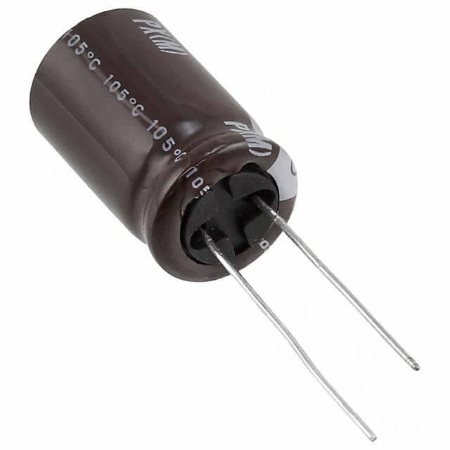

    470 µF 16 V 铝电解电容器 径向,Can 105°C 时为 20000 小时
UPX1C471MHD 数据手册
ALUMINUM ELECTROLYTIC CAPACITORS UPX Long Life Assurance Load life of 20000 hours at 105°C. Compliant to the RoHS directive (2011/65/EU). UPM UPX Long Life Specifications Item Performance Characteristitcs Category Temperature Range –55 to +105˚C Rated Voltage Range 10 to 35V Rated Capacitance Range 1 to 4700µF Capacitance Tolerance ±20% (120Hz, 20˚C) Leakage Current After 1 minute's application of rated voltage at 20°C, leakage current is not more than 0.03CV or 4 (µA), whichever is greater. Tangent of loss angle (tan δ) Rated voltage (V) 10 16 25 35 tan δ (MAX) 0.20 0.16 0.14 0.12 Measurement frequency : 120Hz Temperature : 20˚C For capacitance of more than 1000µF, add 0.02 for every increase of 1000µF. Rated voltage (V) Stability at Low Temperature Endurance Impedance ratio Z–25˚C / Z+20˚C (MAX.) Z–40˚C / Z+20˚C 10 16 25 35 3 2 2 2 4 4 4 4 The specifications listed at right shall be met when the capacitors are restored to 20˚C after D.C. bias plus rated ripple current is applied for 20000 hours at 105˚C, the peak voltage shall not exceed the rated voltage. Measurement frequency : 120Hz Capacitance change Within ±30% of the initial capacitance value tan δ 300% or less than the initial specified value Leakage current Less than or equal to the initial specified value Shelf Life After storing the capacitors under no load at 105˚C for 1000 hours and then performing voltage treatment based on JIS C 5101-4 clause 4.1 at 20°C, they shall meet the specified values for the endurance characteristics listed above. Marking Printed with white color letter on dark brown sleeve. • Please refer to page 20 about the end seal configuration. Please refer to page 20, 21, 22 about the formed or taped product spec. Please refer to page 4 for the minimum order quantity. Dimension table in next page. 248 CAT.8100E ALUMINUM ELECTROLYTIC CAPACITORS UPX Dimensions 10 (1A) 16 (1C) 25 (1E) 35 (1V) 1 010 10 × 12.5 2.2 2R2 10 × 12.5 84 3.3 3R3 10 × 12.5 101 4.7 59 4R7 10 × 12.5 143 10 100 10 × 12.5 294 22 220 10 × 12.5 336 33 330 10 × 12.5 378 47 470 10 × 12.5 420 100 101 420 10 × 20 672 220 221 840 12.5 × 25 1008 1344 10 × 12.5 10 × 16 504 12.5 × 20 330 331 10 × 16 504 10 × 20 672 12.5 × 25 1008 16 × 25 470 471 10 × 20 672 12.5 × 20 1008 16 × 25 1344 16 × 31.5 1680 1000 102 12.5 × 25 1008 16 × 25 1344 16 × 31.5 1680 18 × 40 2184 2200 222 16 × 31.5 1680 18 × 35.5 2016 3300 332 18 × 35.5 2016 18 × 40 2184 4700 472 18 × 40 2184 Frequency coefficient of rated ripple current Frequency 120Hz 1kHz 10kHz 100kHz or more Coefficient 0.75 0.80 0.90 1.00 249 CAT.8100E
