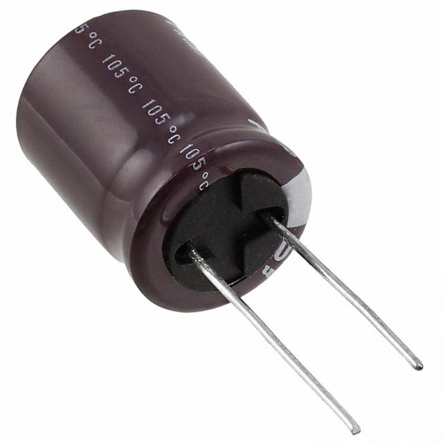

URZ0J222MHD
URZ0J222MHD
    NICHICON(尼吉康)
    插件,D12.5xL17.5mm
    2200 µF 6.3 V 铝电解电容器 径向,Can 105°C 时为 1000 小时
URZ0J222MHD 数据手册
ALUMINUM ELECTROLYTIC CAPACITORS RZ Compact & Low-Profile Sized, Wide Temperature Range series Very small case sizes same as RS series, but operating over wide temperature range of – 55 (– 40) ~ +105˚C. Adapted to the RoHS directive (2002/95/EC). (Through 100V only) RZ High Temperature Specifications Item Category Temperature Range Rated Voltage Range Rated Capacitance Range Capacitance Tolerance RS Performance Characteristics – 55 ~ +105˚C (6.3 ~ 100V) , – 40 ~ +105˚C (160 ~ 400V) 6.3 ~ 400V 0.1 ~ 10000µF ± 20% at 120Hz, 20˚C Rated voltage (V) 6.3 ~ 100 After 1 minute's application of rated voltage, leakage current is not more than 0.03CV or 4 (µA), whichever is greater. After 2 minutes' application of rated voltage, leakage current is not more than 0.01CV or 3 (µA), whichever is greater. 160 ~ 400 After 1 minute's application of rated voltage, I = 0.04CV+100 (µA) or less Leakage Current For capacitance of more than 1000µF, add 0.02 for every increase of 1000µF. Measurement frequency : 120Hz, Temperature : 20˚C tan δ Rated voltage (V) tan δ ( MAX.) 6.3 0.28 10 0.24 16 0.20 6.3 5 10 25 0.16 10 4 8 35 0.14 16 3 6 25 2 4 50 0.12 35 2 3 63 0.10 50 2 3 100 0.08 63 2 3 160 0.20 100 2 3 200 0.20 160 3 4 200 3 4 250 0.20 250 3 6 400 0.25 400 6 10 Measurement frequency : 120Hz Stability at Low Temperature Rated voltage (V) Z– 25˚C / Z+20˚C Impedance ratio ZT / Z20 (MAX.) Z– 40˚C / Z+20˚C Endurance After 1000 hours' application of rated voltage at 105˚C, capacitors meet the characteristic requirements listed at right. Capacitance change tan δ Leakage current Within ±20% of initial value 200% or less of initial specified value Initial specified value or less Shelf Life Marking After storing the capacitors under no load at 105˚C for 1000 hours, and after performing voltage treatment based on JIS C 5101-4 clause 4.1 at 20°C, they will meet the specified value for endurance characteristics listed above. Printed with white color letter on black sleeve. Radial Lead Type Sleeve (P.E.T.) Type numbering system (Example : 10V 330µF) φd 1 2 3 4 5 6 7 8 9 10 11 12 Size code URZ 1 A 3 3 1 MPD Configuration P ± 0.5 φD+0.5 MAX Capacitance tolerance (±20%) Rated Capacitance (330µF) Rated voltage (10V) Pressure relief vent (φ 8up) Series name L+ MAX 15MIN 4MIN Type Configuration (mm) (φD < 20) 1.5 (φD 20) 2.0 φD P φd 5 2.0 0.5 6.3 2.5 0.5 8 3.5 0.6 10 5.0 0.6 12.5 5.0 0.6 16 7.5 0.8 18 7.5 0.8 20 10.0 1.0 φD 5 · 6.3 8 · 10 12.5 ~ 18 20 Pb-free leadwire Pb-free PET sleeve DD PD HD RD • Please refer to page 21 about the end seal configulation. Please refer to page 21, 22, 23 about the formed or taped product spec. Please refer to page 3 for the minimum order quantity. Dimension table in next page. CAT.8100V ALUMINUM ELECTROLYTIC CAPACITORS RZ Cap.(µF) series Dimensions V 6.3 0J 10 1A 16 1C 25 1E 35 1V 50 1H 5× 9 5× 9 5× 9 5× 9 5× 9 5× 9 25 40 60 75 95 155 235 340 420 720 1110 1430 5× 9 5× 9 6.3 × 9 10 × 9 5× 9 5× 9 1.1 2.3 3.5 5 12 18 25 30 46 65 85 100 170 290 370 540 830 1250 0.1 0.22 0.33 0.47 1 2.2 3.3 4.7 10 22 33 47 100 220 330 470 1000 2200 3300 4700 6800 10000 Code 0R1 R22 R33 R47 010 2R2 3R3 4R7 100 220 330 470 101 221 331 471 102 222 332 472 682 103 5× 9 5× 9 5× 9 6.3 × 9 8× 9 5× 9 25 40 55 90 145 180 235 370 635 860 1010 1200 1450 5× 9 5× 9 6.3 × 9 8× 9 8× 9 5× 9 5× 9 40 55 65 95 155 210 275 450 690 940 1120 1330 1700 5× 9 5× 9 6.3 × 9... 10 × 9.. 8 × 9.. 5× 9 5× 9 30 50 60 70 115 205 240 290 520 830 1050 1260 1560 5× 9 5× 9 5× 9 6.3 × 9... 10 × 9.. 10 × 9.. 5× 9 5× 9 20 35 55 70 80 130 220 270 370 590 970 1220 1470 5× 9 5× 9 6.3 × 9 10 × 9 5× 9 5× 9 8× 9 6.3 × 9 10 × 12.5 16 × 15 6.3 × 9 10 × 9 12.5 × 15 16 × 15 18 × 15 18 × 20 16 × 15 12.5 × 15 10 × 12.5 16 × 15 .12.5 × 12.5. 16 × 15 18 × 15 18 × 20 18 × 25 10 × 9.. 12.5 × 15... 18 × 20 18 × 25 18 × 15 ...10 × 12.5 12.5 × 12.5 18 × 20 20 × 25 16 × 15 10 × 12.5 12.5 × 12.5 18 × 20 20 × 25 18 × 15 18 × 20 18 × 25 Case size φ D × L (mm) Rated ripple V Cap.(µF) Code 63 1J 100 2A 5× 9 5× 9 5× 9 5× 9 5× 9 5× 9 6.3 × 9 42 71 100 120 215 335 510 640 6.3 × 9 10 × 9 8× 9 5× 9 1.2 3 4.5 6.5 12 17 25 32 50 93 130 165 265 440 540 160 2C 200 2D 250 2E 400 2G 0.1 0.22 0.33 0.47 1 2.2 3.3 4.7 10 22 33 47 68 100 150 220 330 470 0R1 R22 R33 R47 010 2R2 3R3 4R7 100 220 330 470 680 101 151 221 331 471 12.5 × 12.5 12.5 × 15.5 16 × 15.5 10 × 9.51 6.3 × 9.51 8 × 9.51 8 × 9.51 5 × 9.51 10 × 12.5 12.5 × 15 16 × 15 ∆ 18 × 20 • 18 × 15 .20 × 25 18 × 25 16 × 15 300 350 420 510 550 ∆ 18 × 20 • 18 × 15 18 × 25 .16 × 15 250 300 350 420 510 .∆ 18 × 20 • 18 × 15 .16 × 15 200 250 300 350 420 • 18 × 15 18 × 25 16 × 15 18 × 20 20 × 25 100 200 250 300 350 .18 × 20 .18 × 25 .18 × 25 18 × 15 φ D × L (mm) Case size Rated ripple Rated Ripple (mArms) at 105˚C 120Hz Size φ 16 × 20 is available for capacitors marked " " Size φ 20 × 15 is available for capacitors marked " ∆ " Size φ 20 × 20 is available for capacitors marked " " • Frequency coefficient of rated ripple current V 6.3 ~ 100 160 ~ 400 Cap.(µF) Frequency 100 ~ 470 100 ~ 470 1000 ~00000 010 ~ 220 50Hz 0.75 0.80 0.85 0.80 120Hz 1.00 1.00 1.00 1.00 300Hz 1.35 1.23 1.10 1.25 1 kHz 1.57 1.34 1.13 1.40 10kHz ~ 2.00 1.50 1.15 1.60 In this case, 6 will be put at 12th digit of type numbering system. Wider range of rating. CAT.8100V
