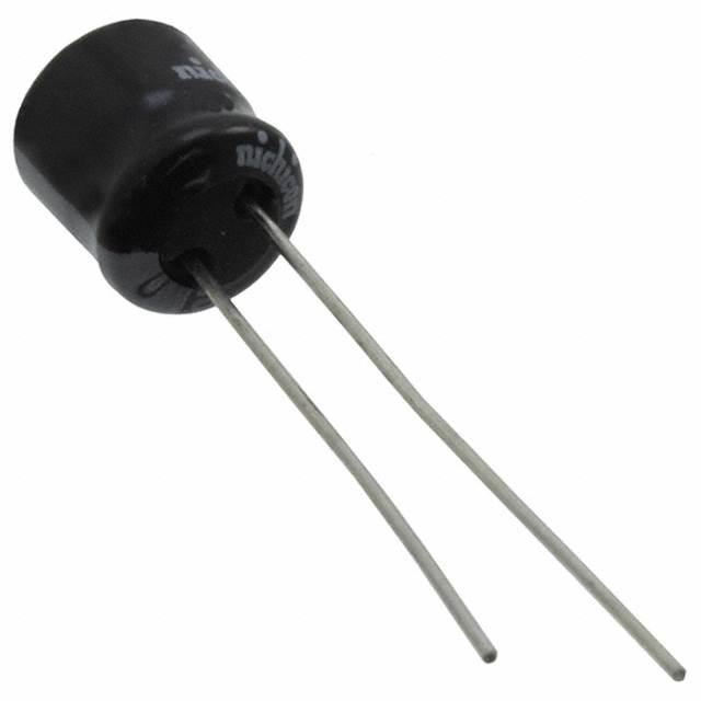

ALUMINUM ELECTROLYTIC CAPACITORS ST 7mmL, Wide Temperature Range series Wide temperature range of – 55 ~ +105˚C, with 7mm height. Adapted to the RoHS directive (2002/95/EC). ST High Temperature SA Specifications Item Category Temperature Range Rated Voltage Range Rated Capacitance Range Capacitance Tolerance Leakage Current tan δ Performance Characteristics – 55 ~ +105˚C 6.3 ~ 50V 0.1 ~ 220µF ± 20% at 120Hz, 20˚C After 2 minutes' application of rated voltage, leakage current is not more than 0.01CV or 3 (µA), whichever is greater. Measurement frequency : 120Hz, Temperature : 20˚C Rated voltage ( V) tan δ (MAX.) 6.3 0.24 10 0.21 6.3 3 6 16 0.18 10 2 5 25 0.15 16 2 4 25 2 3 35 0.13 35 2 3 50 0.12 50 2 3 Measurement frequency : 120 Hz Stability at Low Temperature Rated voltage ( V) Z– 25˚C / Z+20˚C Impedance ratio Z– 40˚C / Z+20˚C ZT / Z20 (MAX.) Endurance After 1000 hours' application of rated voltage at 105˚C, capacitors meet the characteristic requirement listed at right. Capacitance change tan δ Leakage current Within ±25% of initial value (16Vor less) Within ±20% of initial value (25Vor more) 200% or less of initial specified value Initial specified value or less Shelf Life Marking After storing the capacitors under no load at 105˚C for 1000 hours, and after performing voltage treatment based on JIS C 5101-4 clause 4.1 at 20°C, they will meet the specified value for endurance characteristics listed above. Printed with white color letter on black sleeve. Radial Lead Type Sleeve (P.E.T.) φd Type numbering system (Example : 10V 33µF) 1 2 3 4 5 6 7 8 9 10 11 UST 1A 3 3 0 MDD Configuration φD+0.5MAX Capacitance tolerance (±20%) P ± 0.5 Rated Capacitance (33µF) Rated voltage (10V) L+1MAX 15MIN 4MIN (mm) Series name Type Configuration φD 4~8 Pb-free leadwire Pb-free PET sleeve φD P φd 4 1.5 0.45 5 2.0 0.45 6.3 2.5 0.45 8 3.5 0.5 DD Dimensions V Cap.(µF) Code 6.3 0J 10 1A 16 1C 25 1E 35 1V 4×7 4×7 4×7 4×7 4×7 4×7 4×7 5×7 6.3 × 7 8×7 50 1H 1.0 2.3 3.5 5.0 10 19 24 29 44 65 0.1 0.22 0.33 0.47 1 2.2 3.3 4.7 10 22 33 47 100 220 0R1 R22 R33 R47 010 2R2 3R3 4R7 100 220 330 470 101 221 4×7 5×7 5×7 6.3 × 7 8×7 34 42 50 77 130 5×7 5×7 6.3 × 7 8×7 8×7 38 47 59 96 140 4×7 5×7 6.3 × 7 6.3 × 7 8×7 29 44 57 68 107 5×7 6.3 × 7 6.3 × 7 8×7 33 51 63 78 4×7 5×7 6.3 × 7 8×7 24 36 57 72 Case size φ D × L (mm) Rated ripple Frequency coefficient of rated ripple current Frequency Coefficient 50 Hz 0.70 120 Hz 1.00 300 Hz 1.17 1 kHz 1.36 10 kHz ~ 1.50 Rated Ripple (mArms) at 105˚C 120Hz Please refer to page 21, 22, 23 about the formed or taped product spec. Please refer to page 3 for the minimum order quantity. CAT.8100V
