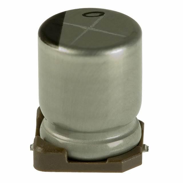

    150 µF 25 V 铝电解电容器 径向,Can - SMD 105°C 时为 5000 小时
UUD1E151MNR1GS 数据手册
ALUMINUM ELECTROLYTIC CAPACITORS UD Chip Type, Low Impedance series Chip type, low impedance temperature range up to +105°C. Designed for surface mounting on high density PC board. Applicable to automatic mounting machine using carrier tape. UU Low Impedance UD Low Impedance WG Specifications Item Category Temperature Range Rated Voltage Range Rated Capacitance Range Capacitance Tolerance Leakage Current tan δ Performance Characteristics – 55 ~ +105°C 6.3 ~ 50V 1 ~ 1500µF ± 20% at 120Hz, 20°C After 2 minutes' application of rated voltage, leakage current is not more than 0.01 CV or 3 (µA), whichever is greater. Measurement frequency : 120Hz, Temperature : 20°C Rated voltage (V) 6.3 10 16 25 35 50 tan δ ( MAX.) 0.26 (0.28) 0.20 (0.24) 0.16 (0.20) 0.14 (0.16) 0.12 (0.14) 0.12 (0.14) Measurement frequency : 120Hz Rated voltage (V) Z– 25°C / Z+20°C Z– 55°C / Z+20°C ( ) is φ8 over Stability at Low Temperature Impedance ratio ZT / Z20 (MAX.) 6.3 3 5 10 2 4 16 2 4 25 2 3 35 2 3 50 2 3 Endurance After 5000 hours' (2000 hours for φD 6.3) application of rated voltage at 105°C , capacitors meet the characteristic requirements listed at right. Capacitance change tan δ Leakage current Within ±30% of initial value 200% or less of initial specified value Initial specified value or less Shelf Life Resistance to soldering heat Marking After leaving capacitors under no load at 105°C for 1000 hours, they meet the specified value for endurance characteristics listed above. The capacitors shall be kept on the hot plate maintained at 250°C Capacitance change for 30 seconds. After removing from the hot plate and restored tan δ at room temperature, they meet the characteristic requirements Leakage current listed at right. Black print on the case top. Within ±10% of initial value Initial specified value or less Initial specified value or less Chip Type (φ4 ~ 6.3) Plastic platform 0.3 MAX. 0.5 MAX. C±0.2 Positive Series Type numbering system (Example : 16V 22µF) 1 2 3 4 5 6 7 8 9 10 11 12 13 14 UUD 1C 2 2 0 M CR 1GS A±0.2 Voltage (C:16V) Package code Configuration Capacitance tolerance (±20%) Rated Capacitance (22µF) Rated voltage (16V) Series name φD×L 4 ~ 6.3 8 • 10 φD±0.5 N2 22C UD B±0.2 E A±0.2 Lot No. Capacitance L±0.3 H Negative Code CR NR (φ8, φ10×10L) Voltage (V:35V) Type Positive Series Plastic platform 0.3 MAX. C±0.2 0.5 MAX. • The lead-free product is also available upon request. In this case, L will be put at 11th digit of type numbering system. φD×L (mm) Trade mark 4 × 5.8 1.8 4.3 4.3 1.0 5.8 0.5 ~ 0.8 5 × 5.8 2.1 5.3 5.3 1.3 5.8 0.5 ~ 0.8 6.3 × 5.8 2.4 6.6 6.6 2.2 5.8 0.5 ~ 0.8 6.3 × 7.7 2.4 6.6 6.6 2.2 7.7 0.5 ~ 0.8 8 × 10 2.9 8.3 8.3 3.1 10 0.8 ~ 1.1 10 × 10 3.2 10.3 10.3 4.5 10 0.8 ~ 1.1 A±0.2 A±0.2 Lot No. Capacitance L±0.5 Pressure relief vent H Negative A B C E L H N2 100V UD φD±0.5 B±0.2 Voltage V 6.3 Code j 10 A 16 C 25 E 35 V 50 H Dimension table in next page. E CAT.8100T ALUMINUM ELECTROLYTIC CAPACITORS UD Cap. (µF) series Dimensions V Code φ D × L (mm) 6.3 0J 10 1A 16 1C 25 1E 35 1V 4 × 5.8 4 × 5.8 4 × 5.8 4 × 5.8 1.80 0.76 0.76 0.76 0.44 0.44 0.44 0.34 0.34 0.17 0.17 0.17 0.09 80 150 150 150 230 230 230 280 280 450 450 450 670 5 × 5.8 6.3 × 5.8 6.3 × 5.8 6.3 × 5.8 6.3 × 7.7 6.3 × 7.7 6.3 × 7.7 8 × 10 8 × 10 8 × 10 10 × 10 10 × 10 50 1H 5.00 5.00 5.00 1.52 0.88 0.88 0.88 0.68 0.68 0.68 0.34 0.34 0.34 0.18 0.18 30 30 30 85 165 165 165 185 185 185 300 300 300 670 670 1 2.2 3.3 4.7 10 15 22 27 33 47 56 68 100 150 220 330 470 680 1000 1500 010 2R2 3R3 4R7 100 150 220 270 330 470 560 680 101 151 221 331 471 681 102 152 4 × 5.8 5 × 5.8 5 × 5.8 5 × 5.8 6.3 × 5.8 6.3 × 5.8 6.3 × 5.8 6.3 × 5.8 6.3 × 7.7 8 × 10 8 × 10 8 × 10 10 × 10 1.80 0.76 0.76 0.76 0.44 0.44 0.44 0.44 0.34 0.17 0.17 0.17 0.09 80 150 150 150 230 230 230 230 280 450 450 450 670 4 × 5.8 5 × 5.8 5 × 5.8 6.3 × 5.8 6.3 × 5.8 6.3 × 5.8 6.3 × 5.8 6.3 × 5.8 6.3 × 7.7 8 × 10 8 × 10 10 × 10 10 × 10 1.80 0.76 0.76 0.44 0.44 0.44 0.44 0.44 0.34 0.17 0.17 0.09 0.09 80 150 150 230 230 230 230 230 280 450 450 670 670 4 × 5.8 5 × 5.8 5 × 5.8 6.3 × 5.8 6.3 × 5.8 6.3 × 5.8 6.3 × 5.8 6.3 × 5.8 6.3 × 7.7 6.3 × 7.7 8 × 10 8 × 10 10 × 10 1.80 0.76 0.76 0.44 0.44 0.44 0.44 0.44 0.34 0.34 0.17 0.17 0.09 80 150 150 230 230 230 230 230 280 280 450 450 670 4 × 5.8 5 × 5.8 5 × 5.8 6.3 × 5.8 6.3 × 5.8 6.3 × 5.8 6.3 × 5.8 6.3 × 5.8 6.3 × 7.7 8 × 10 8 × 10 8 × 10 10 × 10 1.80 0.76 0.76 0.44 0.44 0.44 0.44 0.44 0.34 0.17 0.17 0.17 0.09 80 150 150 230 230 230 230 230 280 450 450 450 670 5 × 5.8 5 × 5.8 5 × 5.8 6.3 × 5.8 6.3 × 5.8 6.3 × 5.8 6.3 × 7.7 6.3 × 7.7 8 × 10 8 × 10 8 × 10 10 × 10 Case size Impedance Rated ripple Max. impedance (Ω) at 20°C 100kHz, Rated Ripple (mA rms) at 105°C 100kHz Frequency coefficient of rated ripple current Frequency Coefficient 50 Hz 0.35 120 Hz 0.50 300 Hz 0.64 1 kHz 0.83 10 kHz~ 1.00 Taping specifications are given in page 22. Recommended land size are given in page 23 Please refer to page 3 for the minimum order quantity. CAT.8100T
