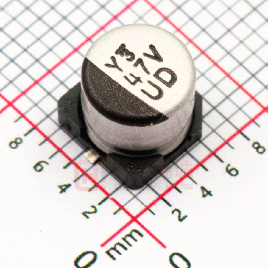

ALUMINUM  ELECTROLYTIC  CAPACITORS UUD Chip Type, Low Impedance Chip type, low impedance temperature range up to +105°C. Designed for surface mounting on high density PC board. Applicable to automatic mounting machine fed with carrier tape. Compliant to the RoHS directive (2011/65/EU). AEC-Q200 compliant. Please contact us for details. UWD High Temp reflow UCD Low Impedance UUD UWG Low Impedance Specifications Performance Characteristics Item Category Temperature Range –55 to +105°C Rated Voltage Range 6.3 to 50V Rated Capacitance Range 1 to 1500µF Capacitance Tolerance ± 20% at 120Hz, 20°C Leakage Current After 2 minutes' application of rated voltage at 20°C, leakage current is not more than 0.01 CV or 3 (µA), whichever is greater. Measurement frequency : 120Hz at 20°C 6.3 10 16 25 35 50 Rated voltage (V) tan δ (MAX.) 0.26 (0.28) 0.20 (0.24) 0.16 (0.20) 0.14 (0.16) 0.12 (0.14) 0.12 (0.14) Tangent of loss angle (tan δ) ( ) is φ8 over Measurement frequency : 120Hz 6.3 3 5 Rated voltage (V) Z– 25°C / Z+20°C Stability at Low Temperature Impedance ratio ZT / Z20 (MAX.) Z– 55°C / Z+20°C 10 2 4 The specifications listed at right shall be met when the capacitors are restored to 20°C after the rated voltage is applied for 5000 hours (2000 hours for φD = 4, 5 and 6.3) at 105°C. Endurance 50 2 3 35 2 3 25 2 3 16 2 4 Capacitance change tan δ Leakage current Within ±30% of the initial capacitance value 200% or less than the initial specified value Less than or equal to the initial specified value After storing the capacitors under no load at 105°C for 1000 hours and then performing voltage treatment based on JIS C 5101-4 clause 4.1 at 20°C, they shall meet the specified values for the endurance characteristics listed above. The capacitors are kept on a hot plate for 30 seconds, which is Capacitance change Within ±10% of the initial capacitance value maintained at 250°C. The capacitors shall meet the characteristic Less than or equal to the initial specified value tan δ requirements listed at right when they are removed from the plate Less than or equal to the initial specified value Leakage current and restored to 20°C. Shelf Life Resistance to soldering heat Black print on the case top. Marking Chip Type Type numbering system (Example : 16V 22µF) (φ4 to φ6.3) 2 3 4 5 6 7 8 9 10 11 12 13 14 0.5 MAX. UUD 1 C 2 2 0 M C L 1 GS Package code A±0.2 E A±0.2 B±0.2 φD±0.5 H L±0.3 Capacitance Lot No. C±0.2 0.3 MAX. Series A2 22C UD Voltage (C:16V) 1 Positive Plastic platform Configuration φD 4 to 6.3 Rated capacitance (22µF) 8 • 10 Rated voltage (16V) Capacitance tolerance (±20%) Negative Code CL NL Series name Type (φ8,φ10 ) Lot No. H L±0.5 Capacitance (mm) φD×L A B C E L H A±0.2 E A±0.2 C±0.2 B±0.2 A2 100V UD Trade mark Plastic platform 0.3 MAX. Series φD±0.5 Voltage (V:35V) 0.5 MAX. Positive Negative 4 × 5.8 5 × 5.8 6.3 × 5.8 6.3 × 7.7 8 × 10 10 × 10 1.8 4.3 4.3 1.0 5.8 0.5 to 0.8 2.1 5.3 5.3 1.3 5.8 0.5 to 0.8 2.4 6.6 6.6 2.2 5.8 0.5 to 0.8 2.4 6.6 6.6 2.2 7.7 0.5 to 0.8 2.9 8.3 8.3 3.1 10 0.8 to 1.1 3.2 10.3 10.3 4.5 10 0.8 to 1.1 Pressure relief vent Voltage V 6.3 Code j 10 A 16 C 25 E 35 V 50 H Dimension table in next page. 141 CAT.8100H ALUMINUM  ELECTROLYTIC  CAPACITORS UUD Dimensions Cap. (µF) V 6.3 10 16 25 35 50 Code 0J 1A 1C 1E 1V 1H 1 010 4 × 5.8 5.00 30 2.2 2R2 4 × 5.8 5.00 30 3.3 3R3 4 × 5.8 5.00 30 4.7 4R7 4 × 5.8 1.80 80 5 × 5.8 1.52 85 10 100 15 150 22 220 27 4 × 5.8 1.80 80 5 × 5.8 0.76 150 6.3 × 5.8 0.88 165 4 × 5.8 1.80 80 5 × 5.8 0.76 150 5 × 5.8 0.76 150 6.3 × 5.8 0.88 165 4 × 5.8 1.80 80 5 × 5.8 0.76 150 5 × 5.8 0.76 150 5 × 5.8 0.76 150 6.3 × 5.8 0.88 165 270 4 × 5.8 1.80 80 5 × 5.8 0.76 150 5 × 5.8 0.76 150 6.3 × 5.8 0.44 230 6.3 × 5.8 0.44 230 6.3 × 7.7 0.68 185 33 330 5 × 5.8 0.76 150 5 × 5.8 0.76 150 6.3 × 5.8 0.44 230 6.3 × 5.8 0.44 230 6.3 × 5.8 0.44 230 6.3 × 7.7 0.68 185 47 470 5 × 5.8 0.76 150 6.3 × 5.8 0.44 230 6.3 × 5.8 0.44 230 6.3 × 5.8 0.44 230 6.3 × 5.8 0.44 230 6.3 × 7.7 0.68 185 56 560 5 × 5.8 0.76 150 6.3 × 5.8 0.44 230 6.3 × 5.8 0.44 230 6.3 × 5.8 0.44 230 6.3 × 7.7 0.34 280 8 × 10 0.34 300 68 680 6.3 × 5.8 0.44 230 6.3 × 5.8 0.44 230 6.3 × 5.8 0.44 230 6.3 × 5.8 0.44 230 6.3 × 7.7 0.34 280 8 × 10 0.34 300 100 101 6.3 × 5.8 0.44 230 6.3 × 5.8 0.44 230 6.3 × 5.8 0.44 230 6.3 × 7.7 0.34 280 8 × 10 0.17 450 8 × 10 0.34 300 150 151 6.3 × 5.8 0.44 230 6.3 × 5.8 0.44 230 6.3 × 7.7 0.34 280 8 × 10 0.17 450 8 × 10 0.17 450 10 × 10 0.18 670 220 221 6.3 × 5.8 0.44 230 6.3 × 7.7 0.34 280 6.3 × 7.7 0.34 280 8 × 10 0.17 450 8 × 10 0.17 450 10 × 10 0.18 670 330 331 6.3 × 7.7 0.34 280 8 × 10 0.17 450 8 × 10 0.17 450 8 × 10 0.17 450 10 × 10 0.09 670 470 471 8 × 10 0.17 450 8 × 10 0.17 450 8 × 10 0.17 450 10 × 10 0.09 670 680 681 8 × 10 0.17 450 10 × 10 0.09 670 10 × 10 0.09 670 1000 102 8 × 10 0.17 450 10 × 10 0.09 670 1500 152 10 × 10 0.09 670 Case size φ D × L (mm) Impedance Rated ripple Max. Impedance (Ω) at 20°C 100kHz, Rated ripple current (mArms) at 105°C 100kHz Frequency coefficient of rated ripple current Frequency Coefficient 50 Hz 0.35 120 Hz 0.50 300 Hz 0.64 1 kHz 0.83 10 kHz or more 1.00 Taping specifications are given in page 23. Recommended land size, soldering by reflow are given in page 18, 19. Please refer to page 3 for the minimum order quantity. 142 CAT.8100H
UUD1V470MCL1GS
物料型号:UUD 器件简介:UUD系列是nichicon公司生产的片式铝电解电容器,属于低阻抗类型,工作温度范围可达+105°C。设计用于在高密度PCB板上表面贴装,适用于使用载带的自动贴装机。符合RoHS指令(2011/65/EU)和AEC-Q200标准。
引脚分配:文档中未特别说明引脚分配,通常片式电容器不需要引脚分配
参数特性: - 类别温度范围:-55至+105°C - 额定电压范围:6.3至50V - 额定电容范围:1至1500μF - 电容公差:在120Hz、20°C时为±20% - 漏电流:在20°C下,额定电压应用2分钟后,漏电流不超过0.01CV或3μA(以较大者为准) - 损耗角正切(tan δ):在20°C、120Hz时,不同额定电压的最大值不同,如6.3V时为0.12(0.14),50V时为0.12(0.14)
功能详解: - 低温稳定性:在120Hz测量频率下,不同额定电压的阻抗比(Z-25°C/Z+20°C)和极低温阻抗比(ZT/Z20)有具体数值。 - 耐久性:在105°C下,额定电压应用5000小时(4、5和6.3mm尺寸为2000小时)后,恢复至20°C,电容变化和tan δ应满足初始值的±30%以内。 - 漏电流和货架寿命:存储在105°C、无负载下1000小时,并在20°C下进行电压处理后,应满足耐久性特性的指定值。
应用信息:UUD系列适用于高密度PCB板的表面贴装,适用于需要低阻抗和高温范围的应用场景。
封装信息:提供了详细的尺寸表和封装代码,以及标记方式(黑色打印在外壳顶部)。
