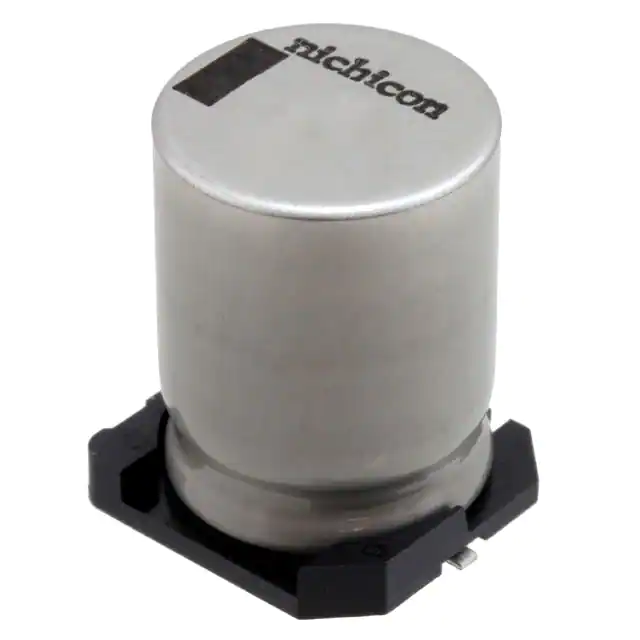

    NICHICON(尼吉康)
    SMD,D16xL22.5mm
    47UF ±20% 200V
UUJ2D470MNQ6MS 数据手册
ALUMINUM  ELECTROLYTIC  CAPACITORS UUJ Chip Type, Higher Capacitance Range Chip Type, higher capacitance in larger case sizes (φ12.5, φ16, φ18) Designed for surface mounting on high density PC board. Applicable to automatic mounting machine fed with carrier tape. Compliant to the RoHS directive (2011/65/EU,(EU)2015/863). AEC-Q200 compliant. Please contact us for details. UUJ Valued marked with an ※ in the dimension table are scheduled to be discontinued and are not recommended for new designs. UUN Bi-Polarized Specifications Item Performance Characteristics –55 to +105°C (6.3 to 100V), –40 to +105°C (160 to 450V) 6.3 to 450V 3.3 to 6800µF ± 20% at 120Hz, 20°C Category Temperature Range Rated Voltage Range Rated Capacitance Range Capacitance Tolerance Rated voltage (V) 6.3 to 100 — After 1 minute's application of rated voltage at 20°C, leakage current is not more than 0.03CV or 4 (µA), whichever is greater. Leakage Current 160 to 450 I = 0.04CV+100 (  µA) max. (1 minute's at 20°C) Measurement frequency : 120Hz at 20°C Rated voltage (V) tan δ (MAX.) Tangent of loss angle (tan δ) 6.3 0.26 10 0.22 16 0.18 25 0.16 35 0.14 50 0.12 63 0.10 100 0.08 160 to 250 400 • 450 0.20 0.15 For capacitance of more than 1000µF, add 0.02 for every increase of 1000µF. ( φ12.5 to φ18 ) Measurement frequency: 120Hz Rated voltage (V) Stability at Low Temperature Impedance ratio (MAX.) Z–25°C / Z+20°C Z–40°C / Z+20°C 6.3 5 10 10 4 8 16 3 6 35 2 3 50 2 3 Capacitance change tan δ Leakage current The specifications listed at right shall be met when the capacitors are restored to 20°C after the rated voltage is applied for 5000 hours at 105°C. Endurance 25 2 4 63 2 3 100 2 3 160 to 250 400 • 450 3 6 6 10 Within ±20% of the initial capacitance value 200% or less than the initial specified value Less than or equal to the initial specified value Shelf Life After storing the capacitors under no load at 105°C for 1000 hours and then performing voltage treatment based on JIS C 5101-4 clause 4.1 at 20°C, they shall meet the specified values for the endurance characteristics listed above. Marking Black print on the case top. Chip Type Type numbering system (Example : 50V 330µF) Plastic platform 0.5 MAX. 1 2 3 4 5 6 7 8 9 10 11 12 13 14 U U J 1 H 3 3 1 M N J 1 MS Package code A ±0.2 E A ±0.2 B ±0.2 Pressure relief vent Capacitance C ±0.2 0.3 MAX. φD ±0.5 nichicon Trade mark 330 µF UJ 50V H1015 Voltage Lot No. Positive Size code Configuration Capacitance Tolerance (±20%) Rated capacitance (330µF) H L ±1.0 Negative Series Rated voltage (50V) Series name Type (mm) φD 12.5×13.5 12.5×16. 12.5×21. 16×16.5. 16×21.5. 18×16.5. 18×21.5. 4.8 4.8 5.4 5.4 6.4 6.4 A 4.8 13.6 13.6 17.1 17.1 19.1 19.1 B 13.6 13.6 13.6 17.1 17.1 19.1 19.1 C 13.6 4.0 4.0 6.3 6.3 6.3 6.3 E 4.0 13.5 16.0 16.5 21.5 16.5 21.5 L 21.0 H 1.0 to 1.4 1.0 to 1.4 1.0 to 1.4 1.0 to 1.4 1.0 to 1.4 1.0 to 1.4 1.0 to 1.4 Code NJ NQ Remarks Standard Style Products which are scheduled to be discontinued. Not recommended for new designs. The vibration structure-resistant product is also available upon request, please ask for details. Frequency coefficient of rated ripple current V 6.3 to 100 160 to 450 Cap.(µF) Frequency  47 to 680/ 100 to 4700 1000 to 6800 3.3 to 100 50Hz 0.75 0.80 0.85 0.80 120Hz 1.00 1.00 1.00 1.00 300Hz 1.35 1.23 1.10 1.25 1kHz 1.57 1.34 1.13 1.40 10kHz or more 2.00 1.50 1.15 1.60 Dimension table in next page. CAT.8100K 12. ALUMINUM  ELECTROLYTIC  CAPACITORS UUJ ■ Dimensions Rated Voltage (V) (code) Rated Capacitance (µF) 0.26 189 440 ※UUJ0J102MNQ1MS 415.8 750 ※UUJ0J222MNQ1MS 0.28 415.8 750 ※UUJ0J222MNQ6MS 3300 18× 16.5 0.30 623.7 930 ※UUJ0J332MNQ1MS 16× 21.5 0.30 623.7 930 ※UUJ0J332MNQ6MS 4700 18× 21.5 0.32 888.3 1100 ※UUJ0J472MNQ1MS 6800 18× 21.5 0.36 1285.2 1350 ※UUJ0J682MNQ6MS 3300 12.5× 16 16× 16.5 12.5× 21 18× 16.5 0.22 300 500  UUJ1A102MNJ1MS 0.24 660 810  UUJ1A222MNJ1MS 0.24 660 810  UUJ1A222MNJ6MS 0.26 990 1000  UUJ1A332MNJ1MS 3300 16×21.5 0.26 990 1000  UUJ1A332MNJ6MS 4700 18× 21.5 0.28 1410 1200  UUJ1A472MNJ1MS 2040 1450  UUJ1A682MNJ6MS 360  UUJ1C471MNJ1MS 6800 18× 21.5 0.32 470 12.5× 13.5 0.18 1000 16×16.5 12.5× 21 225.6 0.18 480 630  UUJ1C102MNJ1MS 0.18 480 630  UUJ1C102MNJ6MS 2200 18× 16.5 0.20 1056 930  UUJ1C222MNJ1MS 2200 16× 21.5 0.20 1056 930  UUJ1C222MNJ6MS 1584 1150  UUJ1C332MNJ1MS 320  UUJ1E331MNJ1MS 3300 18× 21.5 0.22 330 12.5× 13.5 0.16 470 12.5× 16 1000 18× 16.5 247.5 0.16 352.5 400  UUJ1E471MNJ1MS 0.16 750 700  UUJ1E102MNJ1MS 1000 16× 21.5 0.16 750 700  UUJ1E102MNJ6MS 2200 18×21.5 0.18 1650 1050  UUJ1E222MNJ1MS 220 12.5× 13.5 0.14 231 280  UUJ1V221MNJ1MS 330 12.5× 16 0.14 346.5 360  UUJ1V331MNJ1MS 470 16× 16.5 12.5× 21 0.14 493.5 490  UUJ1V471MNJ1MS 0.14 493.5 490  UUJ1V471MNJ6MS 1000 18× 16.5 0.14 1050 750  UUJ1V102MNJ1MS 1000 16× 21.5 0.14 1050 750  UUJ1V102MNJ6MS 18× 21.5 0.16 2310 1150  UUJ1V222MNJ6MS 0.12 330 320  UUJ1H221MNJ1MS 2200 220 330 330 12.5× 16 16× 16.5 12.5× 21 0.12 495 440  UUJ1H331MNJ1MS 0.12 495 440  UUJ1H331MNJ6MS 470 18× 16.5 0.12 705 550  UUJ1H471MNJ1MS 470 16× 21.5 0.12 705 550  UUJ1H471MNJ6MS 1000 18× 21.5 0.12 1500 820  UUJ1H102MNJ1MS 68 12.5× 13.5 0.10 175  UUJ1J680MNJ1MS 100 220 63 (1J) 12.5× 21 3300 470 50 (1H) Part Number 0.28 1000 35 (1V) ) 16× 16.5 2200 25 (1E) ( Rated Ripple (mArms) (105℃/120Hz) 12.5× 13.5 1000 16 (1C) Leakage Current (µA) at 20℃ after 1 minute 1000 2200 10 (1A) tan δ 2200 2200 6.3 (0J) Case Size φD×L(mm) 220 330 12.5× 16 16× 16.5 12.5× 21 18× 16.5 128.52 0.10 189 225  UUJ1J101MNJ1MS 0.10 415.8 385  UUJ1J221MNJ1MS 0.10 415.8 385  UUJ1J221MNJ6MS 0.10 623.7 490  UUJ1J331MNJ1MS 330 16× 21.5 0.10 623.7 490  UUJ1J331MNJ6MS 470 18× 21.5 0.10 888.3 590  UUJ1J471MNJ1MS CAT.8100K ALUMINUM  ELECTROLYTIC  CAPACITORS UUJ ■ Dimensions Rated Voltage (V) (code) Rated Capacitance (µF) 0.08 141 160 UUJ2A470MNJ1MS 204 205 UUJ2A680MNJ1MS 0.08 300 285 UUJ2A101MNJ1MS 100 16× 16.5 12.5× 21 18× 16.5 0.08 300 285 UUJ2A101MNJ6MS 0.08 660 440 UUJ2A221MNJ1MS 220 16× 21.5 0.08 660 440 UUJ2A221MNJ6MS 330 18× 21.5 0.08 990 500 UUJ2A331MNJ6MS 33 12.5× 13.5 0.15 311.2 95 UUJ2C330MNJ1MS 47 16× 16.5 0.15 400.8 260 UUJ2C470MNJ1MS 47 68 12.5× 21 18×16.5 0.15 400.8 260 UUJ2C470MNJ6MS 0.15 535.2 320 UUJ2C680MNJ1MS 68 16× 21.5 0.15 535.2 320 UUJ2C680MNJ6MS 100 16× 21.5 0.15 740 380 UUJ2C101MNJ1MS 10 12.5× 13.5 0.15 180 80 UUJ2D100MNJ1MS 22 12.5× 16 0.15 276 105 UUJ2D220MNJ1MS 33 16×16.5 12.5× 21 0.15 364 220 UUJ2D330MNJ1MS 0.15 364 220 UUJ2D330MNJ6MS 47 18× 16.5 0.15 476 270 UUJ2D470MNJ1MS 47 16× 21.5 0.15 476 270 UUJ2D470MNJ6MS 68 18× 21.5 0.15 644 330 UUJ2D680MNJ1MS 100 18× 21.5 0.15 900 410 UUJ2D101MNJ6MS 22 22 12.5× 13.5 0.15 147 65 UUJ2E4R7MNJ1MS 12.5× 16 0.15 200 105 UUJ2E100MNJ1MS 16× 16.5 12.5× 21 0.15 320 180 UUJ2E220MNJ1MS 0.15 320 180 UUJ2E220MNJ6MS 33 18× 16.5 0.15 430 230 UUJ2E330MNJ1MS 33 16× 21.5 0.15 430 230 UUJ2E330MNJ6MS 47 18× 21.5 0.15 570 280 UUJ2E470MNJ1MS 68 18× 21.5 0.15 780 340 UUJ2E680MNJ6MS 4.7 450 (2W) Part Number 0.08 4.7 400 (2G) ) 12.5×13.5 10 250 (2E) ( Rated Ripple (mArms) (105℃/120Hz) 12.5× 16 33 200 (2D) Leakage Current (µA) at 20℃ after 1 minute 47 220 160 (2C) tan δ 68 100 100 (2A) Case Size φD×L(mm) 10 12.5× 16 16× 16.5 0.20 175.2 50 UUJ2G4R7MNJ1MS 0.20 260 85 UUJ2G100MNJ1MS 22 18× 21.5 0.20 452 130 UUJ2G220MNJ1MS 33 18× 21.5 0.20 628 160 UUJ2G330MNJ6MS 3.3 12.5× 13.5 0.20 159.4 40 UUJ2W3R3MNJ1MS 4.7 12.5× 16 0.20 184.6 50 UUJ2W4R7MNJ1MS 10 16× 16.5 0.20 280 85 UUJ2W100MNJ1MS 22 18× 21.5 0.20 496 130 UUJ2W220MNJ1MS 33 18× 21.5 0.20 694 160 UUJ2W330MNJ6MS For taping specifications, recommended land size/soldering by reflow and minimum order quantity, please refer to the Guidelines for Aluminum Electrolytic Capacitors. CAT.8100K
