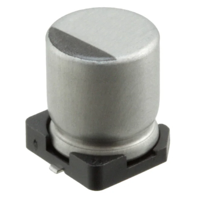

ALUMINUM ELECTROLYTIC CAPACITORS UL Chip Type, Long Life Assurance series Chip type with load life of 5000 hours at +105°C. Designed for surface mounting on high density PC board. Adapted to the RoHS directive (2002/95/EC). CB Long Life UL Long Life UA Specifications Item Category Temperature Range Rated Voltage Range Rated Capacitance Range Capacitance Tolerance Leakage Current tan δ Performance Characteristics – 40 ~ +105°C 6.3 ~ 50V 0.1 ~ 1000µF ± 20% at 120Hz, 20°C After 2 minutes' application of rated voltage, leakage current is not more than 0.01 CV or 3 (µA), Max Measurement frequency : 120Hz, Temperature : 20°C Rated voltage (V) tan δ ( MAX.) 6.3 0.32 10 0.24 6.3 4 10 16 0.20 10 3 7 16 2 5 25 0.16 25 2 3 35 0.13 35 2 3 50 0.12 50 2 3 Measurement frequency : 120Hz Stability at Low Temperature Rated voltage (V) Z– 25°C / Z+20°C Impedance ratio ZT / Z20 (MAX.) Z– 40°C / Z+20°C Endurance After 5000 hours' application of rated voltage at 105°C , capacitors meet the characteristic requirements listed at right. Capacitance change tan δ Leakage current Within ±30% of initial value 300% or less of initial specified value Initial specified value or less Shelf Life Resistance to soldering heat Marking After storing the capacitors under no load at 105°C for 1000 hours, and after performing voltage treatment based on JIS C 5101-4 clause 4.1 at 20°C, they will meet the specified value for endurance characteristics listed above. The capacitors shall be kept on the hot plate maintained at 250°C Capacitance change Within ±10% of initial value for 30 seconds. After removing from the hot plate and restored tan δ Initial specified value or less at room temperature, they meet the characteristic requirements Leakage current Initial specified value or less listed at right. Black print on the case top. Chip Type (φ4 ~ 6.3) Series Plastic platform 0.3 MAX. 0.5 MAX. C±0.2 Positive Type numbering system (Example : 16V 100µF) 1 2 3 4 5 6 7 8 9 10 11 12 13 14 Voltage (C : 16V) UUL 1C 1 0 1 M CL 1GS A±0.2 φD±0.5 B±0.2 Package code Configuration Capacitance tolerance (–20%) Rated Capacitance (100 µF) Rated voltage (16V) Series name φD 4 ~ 6.3 8 ¥ 10 n2 10C UL E A±0.2 Lot No. Capacitance L±0.3 H Negative Code CL NL (φ8 ~ 10 ) Voltage (V : 35V) Trade mark Plastic platform 0.3 MAX. C±0.2 Type Positive Series 0.5 MAX. (mm) A±0.2 A±0.2 φD×L φD±0.5 n2 100V UL B±0.2 4 × 5.8 1.8 4.3 4.3 1.0 5.8 0.5 ~ 0.8 5 × 5.8 2.1 5.3 5.3 1.3 5.8 0.5 ~ 0.8 6.3 × 5.8 2.4 6.6 6.6 2.2 5.8 0.5 ~ 0.8 6.3 × 7.7 2.4 6.6 6.6 2.2 7.7 0.5 ~ 0.8 8 × 10 2.9 8.3 8.3 3.1 10 0.8 ~ 1.1 10 × 10 3.2 10.3 10.3 4.5 10 0.8 ~ 1.1 E A B C E L H Lot No. Capacitance L±0.5 Pressure relief vent H Negative Voltage V 6.3 Code j 10 A 16 C 25 E 35 V 50 H Dimension table in next page. CAT.8100V ALUMINUM ELECTROLYTIC CAPACITORS UL Cap. (µF) series Dimensions V Code 6.3 0J 10 1A 16 1C 25 1E 35 1V 4 × 5.8 4 × 5.8 4 × 5.8 4 × 5.8 4 × 5.8 4 × 5.8 4 × 5.8 4 × 5.8 15 25 42 57 92 151 216 5 × 5.8 6.3 × 5.8 6.3 × 7.7 8 × 10 8 × 10 10 × 10 50 1H 1.0 2.6 3.2 3.8 6.2 11 14 19 30 49 77 92 151 0.1 0.22 0.33 0.47 1 2.2 3.3 4.7 10 22 33 47 100 220 330 470 1000 0R1 R22 R33 R47 010 2R2 3R3 4R7 100 220 330 470 101 221 331 471 102 5 × 5.8 5 × 5.8 6.3 × 5.8 6.3 × 7.7 8 × 10 10 × 10 10 × 10 35 36 60 101 160 254 313 5 × 5.8 5 × 5.8 6.3 × 5.8 6.3 × 7.7 8 × 10 10 × 10 10 × 10 30 35 50 81 141 238 254 4 × 5.8 5 × 5.8 6.3 × 5.8 6.3 × 5.8 6.3 × 7.7 10 × 10 10 × 10 10 × 10 18 30 48 50 81 216 238 254 5 × 5.8 6.3 × 5.8 6.3 × 5.8 6.3 × 7.7 8 × 10 10 × 10 10 × 10 25 42 48 63 116 216 238 5 × 5.8 6.3 × 5.8 6.3 × 7.7 8 × 10 10 × 10 10 × 10 Case size φ D × L (mm) Rated ripple Rated Ripple (mArms) at 105°C 120Hz Frequency coefficient of rated ripple current Frequency Coefficient 50 Hz 0.70 120 Hz 1.00 300 Hz 1.17 1 kHz 1.36 10 kHz~ 1.50 Taping specifications are given in page 24. Recommended land size, soldering by reflow are given in page 25, 26. Please refer to page 3 for the minimum order quantity. CAT.8100V
