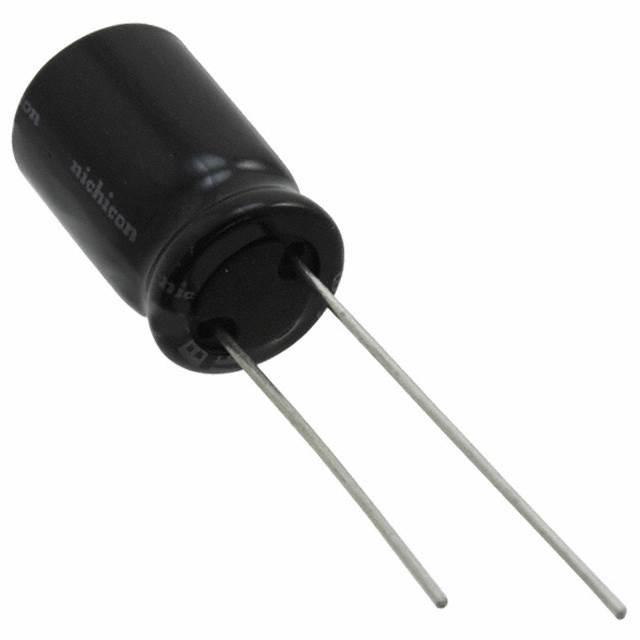

ALUMINUM ELECTROLYTIC CAPACITORS VP Bi-Polarized series Standard bi-polarized series for entertainment electronics. Adapted to the RoHS directive (2002/95/EC). ET High Temperature VP Specifications Item Category Temperature Range Rated Voltage Range Rated Capacitance Range Capacitance Tolerance Leakage Current tan δ Performance Characteristics – 40 ~ +85°C 6.3 ~ 100V 0.47 ~ 6800µF ± 20% at 120Hz, 20°C After 5 minutes' application of rated voltage, leakage current is not more than 0.03CV or 3 (µA), whichever is greater. For capacitance of more than 1000µF, add 0.02 for every increase of 1000µF. Rated voltage (V) tan δ ( MAX.) Measurement frequency : 120Hz, Temperature : 20°C 6.3 0.26 10 0.24 16 0.22 6.3 4 10 10 3 8 25 0.20 16 2 6 35 0.16 25 2 5 50 0.14 35 2 4 50 2 4 63 0.12 63 2 3 100 0.10 100 2 3 Measurement frequency : 120Hz Stability at Low Temperature Rated voltage (V) Z– 25°C / Z+20°C Impedance ratio ZT / Z20 (MAX.) Z– 40°C / Z+20°C Endurance After 2000 hours' application of rated voltage at 85°C with the polarity inverted every 250 hours,capacitors meet the characteristic requirements listed at right. Capacitance change tan δ Leakage current Within ± 20% of initial value 200% or less of initial specified value Initial specified value or less Shelf Life Marking After storing the capacitors under no load at 85°C for 1000 hours, and after performing voltage treatment based on JIS C 5101-4 clause 4.1 at 20°C, they will meet the specified value for endurance characteristics listed above. Printed with white color letter on black sleeve. Radial Lead Type Type numbering system (Example : 10V 47µF) Bd Sleeve (P.E.T.) D+0.5 MAX UVP 1 A 4 7 0 MDD P±0.5 1 2 3 4 5 6 7 8 9 10 11 Configuration Capacitance tolerance (± 20%) Rated Capacitance (47µF) Rated voltage (10V) Series name Type Configuration Pb-free leadwire BD Pb-free PET sleeve 5 DD 6.3 ED 8 á 10 PD 12.5 ~ 18 HD B (B 6.3up) Pressure reliefvent L+ MAX 15MIN B 4MIN (mm) (L < 20) 1.5 > (L = 20) 2.0 D 5 6.3 8 10 12.5 16 18 P 2.0 2.5 3.5 5.0 5.0 7.5 7.5 Bd 0.5 0.5 0.6 0.6 0.6 0.8 0.8 • Please refer to page 21 about the end seal configulation. Please refer to page 21, 22, 23 about the formed or taped product spec. Please refer to page 3 for the minimum order quantity. Dimension table in next page. CAT.8100V ALUMINUM ELECTROLYTIC CAPACITORS VP Cap. (µF) series Dimensions V Code 6.3 0J 10 1A 16 1C 25 1E 35 1V 50 1H 5 × 11 5 × 11 5 × 11 5 × 11 11 17 25 27 34 52 89 105 150 480 650 835 63 1J 100 2A 5 × 11 5 × 11 6.3 × 11 14 21 34 39 47 71 135 220 240 425 720 0.47 1 2.2 3.3 4.7 10 22 33 47 100 220 330 470 1000 2200 3300 4700 6800 R47 010 2R2 3R3 4R7 100 220 330 470 101 221 331 471 102 332 472 682 5 × 11 5 × 11 6.3 × 11 8 × 11.5 8 × 11.5 10 × 12.5 10 × 20 16 × 25 64 76 125 215 265 370 1160 1570 5 × 11 5 × 11 5 × 11 6.3 × 11 8 × 11.5 10 × 16 10 × 16 16 × 25 57 64 76 125 215 345 410 1280 5 × 11 5 × 11 5 × 11 6.3 × 11 8 × 11.5 10 × 12.5 10 × 16 10 × 20 42 57 70 95 160 275 5 × 11 6.3 × 11 6.3 × 11 6.3 × 11 8 × 11.5 10 × 16 42 65 80 95 160 5 × 11 5 × 11 6.3 × 11 8 × 11.5 8 × 11.5 10 × 16 34 43 73 100 120 230 505 655 5 × 11 6.3 × 11 6.3 × 11 8 × 11.5 10 × 12.5 10 × 16 16 × 25 16 × 31.5 18 × 35.5 28 34 57 95 6.3 × 11 6.3 × 11 8 × 11.5 10 × 16 5 × 11 6.3 × 11 8 × 11.5 8 × 11.5 10 × 12.5 10 × 20 16 × 25 16 × 31.5 135 12.5 × 20 180 12.5 × 20 320 575 655 965 16 × 25 18 × 35.5 265 12.5 × 20 305 12.5 × 20 450 12.5 × 20 540 12.5 × 25 950 410 12.5 × 25 375 12.5 × 20 485 12.5 × 20 855 16 × 25 650 12.5 × 20 720 12.5 × 25 16 × 31.5 1140 222 12.5 × 25 16 × 31.5 1510 18 × 35.5 1980 18 × 35.5 1620 Case size Rated φ D × L (mm) ripple Rated Ripple (mArms) at 85°C 120Hz 16 × 31.5 1690 18 × 35.5 2160 16 × 31.5 2020 18 × 35.5 2600 Frequency coefficient of rated ripple current Cap.(µF) Frequency 50 Hz 0.75 0.80 0.85 120 Hz 1.00 1.00 1.00 300 Hz 1.35 1.23 1.10 1 kHz 1.57 1.34 1.13 10 kHz ~ 2.00 1.50 1.15 0000 ~ 4700 0100 ~ 4700 1000 ~ 6800 CAT.8100V
