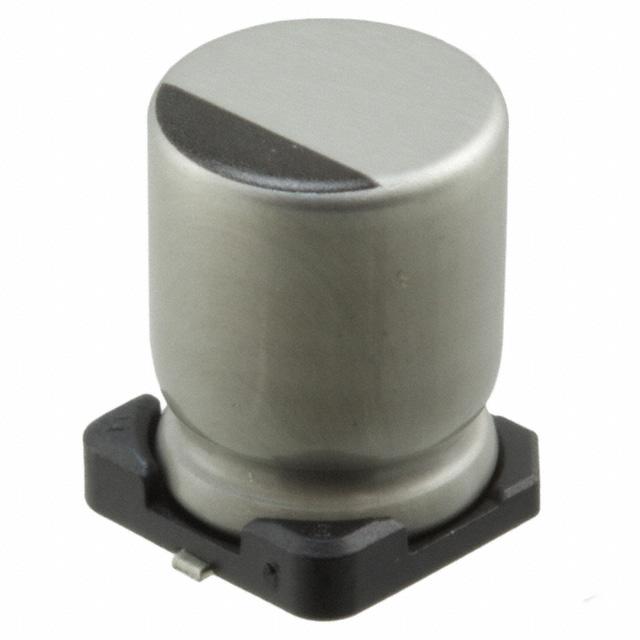

    470 µF 6.3 V 铝电解电容器 径向,Can - SMD 105°C 时为 5000 小时
UWD0J471MCL1GS 数据手册
ALUMINUM  ELECTROLYTIC  CAPACITORS UWD Chip Type, Low Impedance High Temperature (260°C) Reflow Corresponding with 260°C peak reflow soldering Recomended reflow condition : 260°C peak 5 sec. 230°C over 60 sec. 2 times (φ10 × 10 : 1 time) Chip type, low impedance temperature range up to +105°C. UWD Designed for surface mounting on high density PC board. Applicable to automatic mounting machine fed with carrier tape. Compliant to the RoHS directive (2011/65/EU,(EU)2015/863). AEC-Q200 Qualified. Please contact us for details. High Temperature Reflow UUD Specifications Item Performance Characteristics Category Temperature Range –55 to +105°C Rated Voltage Range 6.3 to 50V Rated Capacitance Range 1 to 1500µF Capacitance Tolerance ± 20% at 120Hz, 20°C Leakage Current After 2 minutes' application of rated voltage at 20°C, leakage current is not more than 0.01 CV or 3 (µA), whichever is greater. Measurement frequency : 120Hz at 20°C Rated voltage (V) 6.3 10 16 25 35 50 tan δ (max.) 0.26 (0.28) 0.20 (0.24) 0.16 (0.20) 0.14 (0.16) 0.12 (0.14) 0.12 (0.14) Tangent of loss angle (tan δ) ( ) is φ8 over Measurement frequency : 120Hz 6.3 3 5 Rated voltage (V) Z(– 25°C) / Z(+20°C) Z(– 55°C) / Z(+20°C) Stability at Low Temperature Impedance ratio ZT / Z20 (max.) 10 2 4 The specifications listed at right shall be met when the capacitors are restored to 20°C after the rated voltage is applied for 5000 hours (2000 hours for φD = 4, 5 and 6.3) at 105°C. Endurance 50 2 3 35 2 3 25 2 3 16 2 4 Within ±30% of the initial capacitance value 200% or less than the initial specified value Less than or equal to the initial specified value Capacitance change tan δ Leakage current After storing the capacitors under no load at 105°C for 1000 hours and then performing voltage treatment based on JIS C 5101-4 clause 4.1 at 20°C, they shall meet the specified values for the endurance characteristics listed above. The capacitors are kept on a hot plate for 30 seconds, which is Capacitance change Within ±10% of the initial capacitance value maintained at 250°C. The capacitors shall meet the characteristic tan δ Less than or equal to the initial specified value requirements listed at right when they are removed from the plate Leakage current Less than or equal to the initial specified value and restored to 20°C. Shelf Life Resistance to soldering heat Black print on the case top. Marking ※ I : Leakage Current (μA), C : Rated Capacitance (μF), V : Rated Voltage (V) Chip Type Type numbering system (Example : 16V 22µF) (φ4 to φ6.3) Positive 2 3 4 5 6 7 8 9 10 11 12 13 14 Taping code A±0.2 E A±0.2 B±0.2 A2 33C WD φD±0.5 H L±0.3 Capacitance Lot No. C±0.2 0.3 max. Series Voltage (C:16V) 1 UWD 1 C 2 2 0 M C L 1 G S 0.5 max. Plastic platform Configuration Capacitance tolerance (±20%) Rated capacitance (22µF) Negative Rated voltage (16V) Series name Type (φ8,φ10) Lot No. Voltage V 6.3 Code j C±0.2 H L±0.5 Capacitance (mm) φD×L A±0.2 E A±0.2 0.3 max. B±0.2 A2 100V WD Trade mark Plastic platform Series φD±0.5 Voltage (V:35V) 0.5 max. Positive Negative A B C E L H 4 × 5.8 5 × 5.8 6.3 × 5.8 6.3 × 7.7 8 × 10 10 × 10 1.8 4.3 4.3 1.0 5.8 0.5 to 0.8 2.1 5.3 5.3 1.3 5.8 0.5 to 0.8 2.4 6.6 6.6 2.2 5.8 0.5 to 0.8 2.4 6.6 6.6 2.2 7.7 0.5 to 0.8 2.9 8.3 8.3 3.1 10 0.8 to 1.1 3.2 10.3 10.3 4.5 10 0.8 to 1.1 Frequency coefficient of rated ripple current 10 A 16 C 25 E 35 V 50 H Frequency Coefficient 50 Hz 0.35 120 Hz 0.50 300 Hz 0.64 1 kHz 0.83 10 kHz or more 1.00 Dimension table in next page. CAT.8100M ALUMINUM  ELECTROLYTIC  CAPACITORS UWD Dimensions Rated Voltage (V) (code) 6.3 (0J) 10 (1A) 16 (1C) Rated Capacitance (µF) Leakage Current Impedance(Ω) Rated Ripple (µA) (mArms) max. at 20℃ after (20℃/100kHz) (105℃/100kHz) 2 minutes Case Size φD×L(mm) tan δ 27 4× 5.8 0.26 3 1.80 80 UWD0J270MCL1GS 33 5× 5.8 0.26 3 0.76 150 UWD0J330MCL1GS 47 5× 5.8 0.26 3 0.76 150 UWD0J470MCL1GS 56 5× 5.8 0.26 3.528 0.76 150 UWD0J560MCL1GS 68 6.3× 5.8 0.26 4.284 0.44 230 UWD0J680MCL1GS 100 6.3× 5.8 0.26 6.3 0.44 230 UWD0J101MCL1GS 150 6.3× 5.8 0.26 9.45 0.44 230 UWD0J151MCL1GS 220 6.3× 5.8 0.26 13.86 0.44 230 UWD0J221MCL1GS 330 6.3× 7.7 0.26 20.79 0.34 280 UWD0J331MCL1GS 470 8× 10 0.28 29.61 0.17 450 UWD0J471MCL1GS 680 8× 10 0.28 42.84 0.17 450 UWD0J681MCL1GS 1000 10× 10 0.28 63 0.09 670 UWD0J102MCL1GS 1500 10× 10 0.28 94.5 0.09 670 UWD0J152MCL1GS 22 4× 5.8 0.20 3 1.80 80 UWD1A220MCL1GS 27 5× 5.8 0.20 3 0.76 150 UWD1A270MCL1GS 33 5× 5.8 0.20 3.3 0.76 150 UWD1A330MCL1GS 47 6.3× 5.8 0.20 4.7 0.44 230 UWD1A470MCL1GS 56 6.3× 5.8 0.20 5.6 0.44 230 UWD1A560MCL1GS 68 6.3× 5.8 0.20 6.8 0.44 230 UWD1A680MCL1GS 100 6.3× 5.8 0.20 10 0.44 230 UWD1A101MCL1GS 150 6.3× 5.8 0.20 15 0.44 230 UWD1A151MCL1GS 220 6.3× 7.7 0.20 22 0.34 280 UWD1A221MCL1GS 330 8× 10 0.24 33 0.17 450 UWD1A331MCL1GS 470 8× 10 0.24 47 0.17 450 UWD1A471MCL1GS ( ) Part Number 680 10× 10 0.24 68 0.09 670 UWD1A681MCL1GS 1000 10× 10 0.24 100 0.09 670 UWD1A102MCL1GS 15 4× 5.8 0.16 3 1.80 80 UWD1C150MCL1GS 22 5× 5.8 0.16 3.52 0.76 150 UWD1C220MCL1GS 27 5× 5.8 0.16 4.32 0.76 150 UWD1C270MCL1GS 33 6.3× 5.8 0.16 5.28 0.44 230 UWD1C330MCL1GS 47 6.3× 5.8 0.16 7.52 0.44 230 UWD1C470MCL1GS 56 6.3× 5.8 0.16 8.96 0.44 230 UWD1C560MCL1GS 68 6.3× 5.8 0.16 10.88 0.44 230 UWD1C680MCL1GS 100 6.3× 5.8 0.16 16 0.44 230 UWD1C101MCL1GS 150 6.3× 7.7 0.16 24 0.34 280 UWD1C151MCL1GS 220 6.3× 7.7 0.16 35.2 0.34 280 UWD1C221MCL1GS 330 8× 10 0.20 52.8 0.17 450 UWD1C331MCL1GS 470 8× 10 0.20 75.2 0.17 450 UWD1C471MCL1GS 680 10× 10 0.20 108.8 0.09 670 UWD1C681MCL1GS CAT.8100M ALUMINUM  ELECTROLYTIC  CAPACITORS UWD Dimensions Rated Voltage (V) (code) 25 (1E) Rated Capacitance (µF) Case Size φD×L(mm) tan δ 10 4× 5.8 0.14 ) Part Number 3 1.80 80 UWD1E100MCL1GS 15 5× 5.8 0.14 3.75 0.76 150 UWD1E150MCL1GS 5× 5.8 0.14 5.5 0.76 150 UWD1E220MCL1GS 27 6.3× 5.8 0.14 6.75 0.44 230 UWD1E270MCL1GS 33 6.3× 5.8 0.14 8.25 0.44 230 UWD1E330MCL1GS 47 6.3× 5.8 0.14 11.75 0.44 230 UWD1E470MCL1GS 56 6.3× 5.8 0.14 14 0.44 230 UWD1E560MCL1GS 68 6.3× 5.8 0.14 17 0.44 230 UWD1E680MCL1GS 100 6.3× 7.7 0.14 25 0.34 280 UWD1E101MCL1GS 150 8× 10 0.16 37.5 0.17 450 UWD1E151MCL1GS 220 8× 10 0.16 55 0.17 450 UWD1E221MCL1GS 330 10× 10 0.16 82.5 0.09 670 UWD1E331MCL1GS 470 10×10 0.16 117.5 0.09 670 UWD1E471MCL1GS 4× 5.8 0.12 3 1.80 80 UWD1V4R7MCL1GS 10 5× 5.8 0.12 3.5 0.76 150 UWD1V100MCL1GS 15 5× 5.8 0.12 5.25 0.76 150 UWD1V150MCL1GS 22 5× 5.8 0.12 7.7 0.76 150 UWD1V220MCL1GS 27 6.3× 5.8 0.12 9.45 0.44 230 UWD1V270MCL1GS 33 6.3× 5.8 0.12 11.55 0.44 230 UWD1V330MCL1GS 47 6.3× 5.8 0.12 16.45 0.44 230 UWD1V470MCL1GS 56 6.3× 7.7 0.12 19.6 0.34 280 UWD1V560MCL1GS 68 6.3× 7.7 0.12 23.8 0.34 280 UWD1V680MCL1GS 100 8× 10 0.14 35 0.17 450 UWD1V101MCL1GS 150 8× 10 0.14 52.5 0.17 450 UWD1V151MCL1GS 220 10× 10 0.14 77 0.09 670 UWD1V221MCL1GS 330 10× 10 0.14 115.5 0.09 670 UWD1V331MCL1GS 1 4× 5.8 0.12 3 5.00 30 UWD1H010MCL1GS 2.2 4× 5.8 0.12 3 5.00 30 UWD1H2R2MCL1GS 3.3 4× 5.8 0.12 3 5.00 30 UWD1H3R3MCL1GS 4.7 50 (1H) ( 22 4.7 35 (1V) Leakage Current Impedance(Ω) Rated Ripple (µA) (mArms) max. at 20℃ after (20℃/100kHz) (105℃/100kHz) 2 minutes 5× 5.8 0.12 3 1.52 85 UWD1H4R7MCL1GS 10 6.3× 5.8 0.12 5 0.88 165 UWD1H100MCL1GS 15 6.3× 5.8 0.12 7.5 0.88 165 UWD1H150MCL1GS 22 6.3× 5.8 0.12 11 0.88 165 UWD1H220MCL1GS 27 6.3× 7.7 0.12 13.5 0.68 185 UWD1H270MCL1GS 33 6.3× 7.7 0.12 16.5 0.68 185 UWD1H330MCL1GS 47 6.3× 7.7 0.12 23.5 0.68 185 UWD1H470MCL1GS 56 8× 10 0.14 28 0.34 300 UWD1H560MCL1GS 68 8× 10 0.14 34 0.34 300 UWD1H680MCL1GS 100 8× 10 0.14 50 0.34 300 UWD1H101MCL1GS 150 10 ×10 0.14 75 0.18 670 UWD1H151MCL1GS 220 10× 10 0.14 110 0.18 670 UWD1H221MCL1GS For taping specifications, recommended land size/soldering by reflow and minimum order quantity, please refer to the Guidelines for Aluminum Electrolytic Capacitors. CAT.8100M
