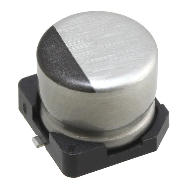

ALUMINUM  ELECTROLYTIC  CAPACITORS WJ 5.5mmL Chip Type High Temperature (260°C) Reflow series Corresponding with 260°C peak reflow soldering Recomended reflow condition : 260°C peak 5 sec. 230°C over 60 sec. 2 times  WJ Chip type with 5.5mm height. Designed for surface mounting on high density PC board. Applicable to automatic mounting machine fed with carrier tape. Load life of 2000 hours at 85°C Compliant to the RoHS directive (2011/65/EU). High Temperature Reflow WX Specifications Item Performance Characteristics Category Temperature Range –40 to +85°C Rated Voltage Range 6.3 to 50V Rated Capacitance Range 0.1 to 150µF Capacitance Tolerance ± 20% at 120Hz, 20°C Leakage Current After 2 minutes' application of rated voltage, leakage current is not more than 0.01CV or 3 (µA) ,whichever is greater. 6.3 0.26 Rated voltage (V) tan δ (MAX.) Tangent of loss angle (tan δ) Rated voltage (V) Z– 25°C / Z+20°C Impedance ratio Stability at Low Temperature ZT / Z20 (MAX.) Measurement frequency : 120Hz at 20°C 16 25 35 50 0.16 0.14 0.12 0.12 10 0.20 Z– 40°C / Z+20°C 6.3 4 8 10 3 8 16 2 4 Endurance The specifications listed at right shall be met when the capacitors are restored to 20°C after the rated voltage is applied for 2000 hours at 85°C. Shelf Life After storing the capacitors under no load at 85°C for 1000 hours and then performing voltage treatment based on JIS C 5101-4 clause 4.1 at 20°C, they shall meet the specified values for the endurance characteristics listed above. Resistance to soldering heat The capacitors are kept on a hot plate for 30 seconds, which is maintained at 250°C. The capacitors shall meet the characteristic requirements listed at right when they are removed from the plate and restored to 20°C. Marking Black print on the case top. Capacitance change tan δ Leakage Current Chip Type 1 3 4 5 8 Positive 9 10 11 12 13 14 Positive Capacitance change tan δ Leakage current Within ±10% of the initial capacitance value Less than or equal to the initial specified value Less than or equal to the initial specified value 1 0.5 MAX. 4 5 6 7 8 9 10 11 12 13 14 Package code Package code Configuration Configuration Capacitance toleranc (20%) Capacitance tolerance (±20%) Rated capacitance (10F) Rated capacitance (10µF) Rated voltage (16V) Rated voltage (16V) Series name Series name Type Type Capacitance toleranc (20%) Rated capacitance (10F) Rated voltage (16V) Series name Negative Negative 0.5 to 0.8 0.5 to 0.8 3 Configuration A±0.2 A±0.2 0.5 MAX. +0.1 –0.2 2 3 4 5 6 7 8 9 10 11 12 13 14 U2 W J 1 C 1 0 0 MC L 1 GB UW J 1 C 1 0 0 MC L 1 G B 1 Package code E A0.2 A0.2 +0.1 –0.2 B±0.2 φD0.5 B0.2 5.4 C±0.2 C0.2 Type (mm) Voltage Code 7 E 0.5 MAX. φD±0.5 5.4 Lot No. Capacitance Negative 0.5 to 0.8 Lot No. Capacitance V 6 UW J 1 C 1 0 0 MC L 1 G B N2 100A A2 E WJ100A A±0.2WJ A±0.2 B±0.2 2 Plastic platform Plastic platform 0.3 MAX. 0.3 MAX. C±0.2 Voltage (A:10V) Series Voltage (A:10V) Series Within ±20% of the initial capacitance value 200% or less than the initial specified value Less than or equal to the initial specified value Type numbering system (Example : 16V 10µF) Positive m .3 MAX. Measurement frequency : 120Hz 25 35 50 2 2 2 4 3 3 6.3 10 16 25 35 50 j A C E V H φD A B C E 4 1.8 4.3 4.3 1.0 5 2.1 5.3 5.3 1.3 6.3 2.4 6.6 6.6 2.2 φD A A B B C C E E φD 4 1.8 4.3 4.3 1.0 4 1.8 4.3 4.3 1.0 5 2.1 5.3 5.3 1.3 5 2.1 5.3 5.3 1.3 (mm) (mm) 6.3 6.3 2.4 2.4 6.6 6.6 6.6 6.6 2.2 2.2 Dimension table in next page. CAT.8100D ALUMINUM  ELECTROLYTIC  CAPACITORS WJ series Dimensions Cap. (µF) V V 6.3 10 16 25 35 50 Code 0J 1A 1C 1E 1V 1H 0.1 0R1 4 1.0 0.22 R22 4 2.0 0.33 R33 4 2.8 0.47 R47 4 4.0 1 010 4 8.4 2.2 2R2 4 13 3.3 3R3 4 17 4.7 4R7 10 100 22 220 4 28 33 330 5 37 47 470 5 45 100 101 6.3 70 150 151 6.3 71 4 16 4 18 5 20 6.3 33 4 23 5 27 5 29 6.3   45 5 33 5 37 6.3 42 5 41 6.3 49 6.3 52 6.3 52 6.3 58 6.3 76 6.3 86 Case size φ D (mm) Rated ripple Rated ripple current (mArms) at 85°C 120Hz Frequency coefficient of rated ripple current Frequency Coefficient 50 Hz 0.70 120 Hz 1.00 300 Hz 1.17 1 kHz 1.36 10 kHz or more 1.50   Taping specifications are given in page 23. Recommended land size, soldering by reflow are given in page 18, 19. Please refer to page 3 for the minimum order quantity. CAT.8100D
