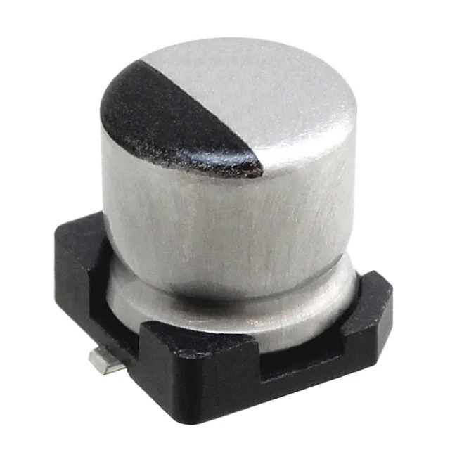

UWJ1V100MCL1GB
UWJ1V100MCL1GB
    NICHICON(尼吉康)
    SMD,D5xL5.4mm
    10UF ±20% 35V
UWJ1V100MCL1GB 数据手册
ALUMINUM ELECTROLYTIC CAPACITORS UWJ 5.5mmL Chip Type High Temperature (260°C) Reflow Corresponding with 260°C peak reflow soldering Recomended reflow condition : 260°C peak 5 sec. 230°C over 60 sec. 2 times UWJ Chip type with 5.5mm height. Designed for surface mounting on high density PC board. Applicable to automatic mounting machine fed with carrier tape. Load life of 2000 hours at 85°C Compliant to the RoHS directive (2011/65/EU,(EU)2015/863). AEC-Q200 compliant. Please contact us for details. High Temperature Reflow UWX Specifications Item Performance Characteristics Category Temperature Range –40 to +85°C Rated Voltage Range 6.3 to 50V Rated Capacitance Range 1 to 150µF Capacitance Tolerance ± 20% at 120Hz, 20°C Leakage Current After 2 minutes' application of rated voltage at 20°C, leakage current is not more than 0.01CV or 3 (µA) ,whichever is greater. 6.3 0.26 Rated voltage (V) tan δ (MAX.) Tangent of loss angle (tan δ) Rated voltage (V) Z– 25°C / Z+20°C Impedance ratio Stability at Low Temperature ZT / Z20 (MAX.) Measurement frequency : 120Hz at 20°C 16 25 35 50 0.16 0.14 0.12 0.12 10 0.20 Z– 40°C / Z+20°C 6.3 4 8 10 3 8 16 2 4 Endurance The specifications listed at right shall be met when the capacitors are restored to 20°C after the rated voltage is applied for 2000 hours at 85°C. Shelf Life After storing the capacitors under no load at 85°C for 1000 hours and then performing voltage treatment based on JIS C 5101-4 clause 4.1 at 20°C, they shall meet the specified values for the endurance characteristics listed above. Resistance to soldering heat The capacitors are kept on a hot plate for 30 seconds, which is maintained at 250°C. The capacitors shall meet the characteristic requirements listed at right when they are removed from the plate and restored to 20°C. Marking Black print on the case top. Capacitance change tan δ Leakage Current Chip Type 1 3 4 5 6 Capacitance change tan δ Leakage current 11 12 13 14 Within ±10% of the initial capacitance value Less than or equal to the initial specified value Less than or equal to the initial specified value 1 5.4 +0.1 –0.2 +0.1 –0.2 0.5 MAX. 0.5 MAX. E 0.5 to 0.8 3 4 5 6 7 8 9 10 Capacitance toleranc (20%) Rated capacitance (10F) Rated voltage (16V) Series name Type (mm) Voltage V 6.3 10 16 25 35 50 Code j A C E V H 4 1.8 4.3 4.3 1.0 φD A B C E 5 2.1 5.3 5.3 1.3 6.3 2.4 6.6 6.6 2.2 11 12 13 14 Package code Taping code Configuration Configuration Capacitance toleranc (20%) Capacitance tolerance (±20%) Rated capacitance (10F) Rated capacitance (10µF) Rated voltage (16V) Rated voltage (16V) Series name Series name Type Type Configuration Negative Negative 0.5 to 0.8 2 3 4 5 6 7 8 9 10 11 12 13 14 U2 W J 1 C 1 0 0 MC L 1 GB UW J 1 C 1 0 0 MC L 1 G B 1 Package code E A±0.2 A0.2A±0.2 A0.2 5.4 Lot No. Capacitance Negative Lot No. Capacitance C±0.2 C0.2 B±0.2 B0.2 φD±0.5 φD0.5 N2 100A A2 E A±0.2 WJ100A A±0.2 WJ C±0.2 Voltage (A:10V) Series Voltage (A:10V) Series B±0.2 2 7 8 Positive 9 10 Positive UW J 1 C 1 0 0 MC L 1 G B Plastic platform Plastic platform 0.3 MAX. 0.3 MAX. 0.5 MAX. m Within ±20% of the initial capacitance value 200% or less than the initial specified value Less than or equal to the initial specified value Type numbering system (Example : 16V 10µF) Positive 0.5 to 0.8 Measurement frequency : 120Hz 25 35 50 2 2 2 4 3 3 φD A A B B C C E E φD 4 1.8 4.3 4.3 1.0 4 1.8 4.3 4.3 1.0 5 2.1 5.3 5.3 1.3 5 2.1 5.3 5.3 1.3 (mm) (mm) 6.3 6.3 2.4 2.4 6.6 6.6 6.6 6.6 2.2 2.2 Frequency coefficient of rated ripple current Frequency Coefficient 50 Hz 0.70 120 Hz 1.00 300 Hz 1.17 1 kHz 1.36 10 kHz or more 1.50   Dimension table in next page. CAT.8100K ALUMINUM ELECTROLYTIC CAPACITORS UWJ Dimensions Rated Voltage (V) (code) 6.3 (0J) 10 (1A) 16 (1C) Rated Capacitance (µF) Case Size φD×L(mm) tan δ 22 4× 5.4 0.26 50 (1H) ) 3 Part Number 28 UWJ0J220MCL1GB 33 5× 5.4 0.26 3 37 UWJ0J330MCL1GB 5× 5.4 0.26 3 45 UWJ0J470MCL1GB 100 6.3× 5.4 0.26 6.3 70 UWJ0J101MCL1GB 150 6.3× 5.4 0.26 9.45 71 UWJ0J151MCL1GB 22 5× 5.4 0.20 3 33 UWJ1A220MCL1GB 33 5× 5.4 0.20 3.3 41 UWJ1A330MCL1GB 47 6.3× 5.4 0.20 4.7 52 UWJ1A470MCL1GB 100 6.3× 5.4 0.20 76 UWJ1A101MCL1GB 10 10 4× 5.4 0.16 3 23 UWJ1C100MCL1GB 22 5× 5.4 0.16 3.52 37 UWJ1C220MCL1GB 33 6.3× 5.4 0.16 5.28 49 UWJ1C330MCL1GB 47 6.3× 5.4 0.16 7.52 58 UWJ1C470MCL1GB 100 6.3× 5.4 0.16 86 UWJ1C101MCL1GB 10 16 4× 5.4 0.14 3 16 UWJ1E4R7MCL1GB 5× 5.4 0.14 3 27 UWJ1E100MCL1GB 22 6.3× 5.4 0.14 5.5 42 UWJ1E220MCL1GB 33 6.3× 5.4 0.14 8.25 52 UWJ1E330MCL1GB 4× 5.4 0.12 3 18 UWJ1V4R7MCL1GB 4.7 35 (1V) ( Rated Ripple (mArms) (85℃/120Hz) 47 4.7 25 (1E) Leakage Current (µA) at 20℃ after 2 minutes 10 5× 5.4 0.12 3.5 29 UWJ1V100MCL1GB 22 6.3× 5.4 0.12 7.7 45 UWJ1V220MCL1GB 1 4× 5.4 0.12 3 8.4 UWJ1H010MCL1GB 2.2 4× 5.4 0.12 3 13 UWJ1H2R2MCL1GB 3.3 4× 5.4 0.12 3 17 UWJ1H3R3MCL1GB 4.7 10 5× 5.4 0.12 3 20 UWJ1H4R7MCL1GB 6.3×5.4 0.12 5 33 UWJ1H100MCL1GB For taping specifications, recommended land size/soldering by reflow and minimum order quantity, please refer to the Guidelines for Aluminum Electrolytic Capacitors. CAT.8100K
