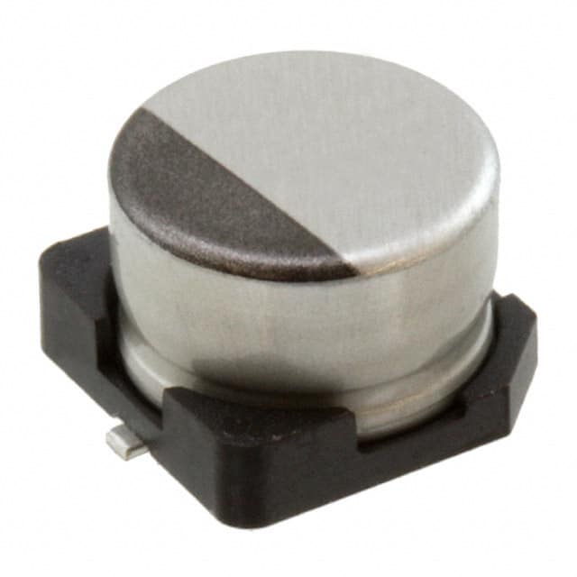

    CAP ALUM 22UF 20% 35V SMD
UZS1V220MCL1GB 数据手册
ALUMINUM  ELECTROLYTIC  CAPACITORS UZS 4.5mmL Chip Type UWX Chip type with 4.5mm height. Designed for surface mounting on high density PC board. Applicable to automatic mounting machine fed with carrier tape. Compliant to the RoHS directive (2011/65/EU,(EU)2015/863). AEC-Q200 compliant. Please contact us for details. UZT Smaller High Te m p e rature UZS Smaller UZR Specifications Item Performance Characteristics Category Temperature Range –40 to + 85°C Rated Voltage Range 4 to 50V Rated Capacitance Range 1 to 220µF Capacitance Tolerance ± 20% at 120Hz, 20°C Leakage Current After 2 minutes' application of rated voltage at 20°C, leakage current is not more than 0.01 CV or 3 (µA) ,whichever is greater. 6.3 0.30 4 0.50 Rated voltage (V) tan δ (MAX.) Tangent of loss angle (tan δ) Measurement frequency : 120Hz at 20°C 16 25 35 50 0.19 0.16 0.14 0.14 10 0.24 Measurement frequency : 120Hz Rated voltage (V) Z– 25°C / Z+20°C Impedance ratio Stability at Low Temperature ZT / Z20 (MAX.) Z– 40°C / Z+20°C After storing the capacitors under no load at 85°C for 1000 hours and then performing voltage treatment based on JIS C 5101-4 clause 4.1 at 20°C, they shall meet the specified values for the endurance characteristics listed above. The capacitors are kept on a hot plate for 30 seconds, which is Capacitance change Within +­ 10% of the initial capacitance value – maintained at 250°C. The capacitors shall meet the Less than or equal to the initial specified value tan δ characteristic requirements listed at right when they are Less than or equal to the initial specified value Leakage current removed from the plate and restored to 20°C. Black print on the case top. Shelf Life Resistance to soldering heat Marking Chip Type Type numbering system (Example : 16V 10µF) 1 Positive Plastic platform B±0.2 φD±0.5 A2 10 16V C±0.2 0.3 MAX. 4.5 Voltage mark for 6.3V is +0.1 – 0.2 3 4 5 6 7 8 9 10 11 12 13 14 Taping code A±0.3 E A±0.3 Voltage 2 U Z S 1 C 1 0 0 MC L 1 GB 0.5 MAX. Capacitance Lot No. 50 2 3 ­ 20% of the initial capacitance value Within +– 200% or less than the initial specified value Less than or equal to the initial specified value Capacitance change tan δ Leakage current The specifications listed at right shall be met when the capacitors are restored to 20°C after the rated voltage is applied for 2000 hours at 85°C. Endurance 35 2 3 25 2 4 16 2 4 10 3 8 6.3 4 8 4 7 15 φD A B C E 4 1.8 4.3 4.3 1.0 0.5 to 0.8 Negative 6V . 5 2.1 5.3 5.3 1.3 (mm) 6.3 2.4 6.6 6.6 2.2 Configuration Capacitance tolerance (+ – 20%) Rated capacitance (10µF) Rated voltage (16V) Series name Type Frequency coefficient of rated ripple current Frequency Coefficient 50 Hz 0.70 120 Hz 1.00 300 Hz 1.17 1 kHz 1.36 10 kHz or more 1.50   Dimension table in next page. CAT.8100K ALUMINUM ELECTROLYTIC CAPACITORS UZS Dimensions Leakage Current (µA) at 20℃ after 2 minutes Rated Ripple (mArms) (85℃/120Hz) Rated Voltage (V) (code) Rated Capacitance (µF) 33 4× 4.5 0.50 3 28 UZS0G330MCL1GB 4 (0G) 47 4×4.5 0.50 3 33 UZS0G470MCL1GB 100 5×4.5 0.50 4 56 UZS0G101MCL1GB 220 6.3× 4.5 0.50 8.8 96 UZS0G221MCL1GB 22 4× 4.5 0.30 3 28 UZS0J220MCL1GB 33 5× 4.5 0.30 3 37 UZS0J330MCL1GB 6.3 (0J) 10 (1A) 16 (1C) 50 (1H) ( ) Part Number 47 5× 4.5 0.30 3 45 UZS0J470MCL1GB 6.3× 4.5 0.30 6.3 70 UZS0J101MCL1GB 22 5× 4.5 0.24 3 33 UZS1A220MCL1GB 33 5× 4.5 0.24 3.3 41 UZS1A330MCL1GB 47 6.3× 4.5 0.24 4.7 52 UZS1A470MCL1GB 10 4×4.5 0.19 3 23 UZS1C100MCL1GB 22 5×4.5 0.19 3.52 37 UZS1C220MCL1GB 33 6.3× 4.5 0.19 5.28 49 UZS1C330MCL1GB 47 6.3× 4.5 0.19 7.52 58 UZS1C470MCL1GB 4× 4.5 0.16 3 16 UZS1E4R7MCL1GB 10 5× 4.5 0.16 3 27 UZS1E100MCL1GB 22 6.3× 4.5 0.16 5.5 42 UZS1E220MCL1GB 33 6.3×4.5 0.16 8.25 52 UZS1E330MCL1GB 4.7 35 (1V) tan δ 100 4.7 25 (1E) Case Size φD×L(mm) 4× 4.5 0.14 3 18 UZS1V4R7MCL1GB 10 5× 4.5 0.14 3.5 29 UZS1V100MCL1GB 22 6.3× 4.5 0.14 7.7 46 UZS1V220MCL1GB 1 4× 4.5 0.14 3 2.2 4×4.5 0.14 3 8.4 13 UZS1H010MCL1GB UZS1H2R2MCL1GB 3.3 4× 4.5 0.14 3 17 UZS1H3R3MCL1GB 4.7 5× 4.5 0.14 3 20 UZS1H4R7MCL1GB 6.3× 4.5 0.14 5 33 UZS1H100MCL1GB 10 For taping specifications, recommended land size/soldering by reflow and minimum order quantity, please refer to the Guidelines for Aluminum Electrolytic Capacitors. Please select UUR, UUG if high C/V products are required. CAT.8100K
