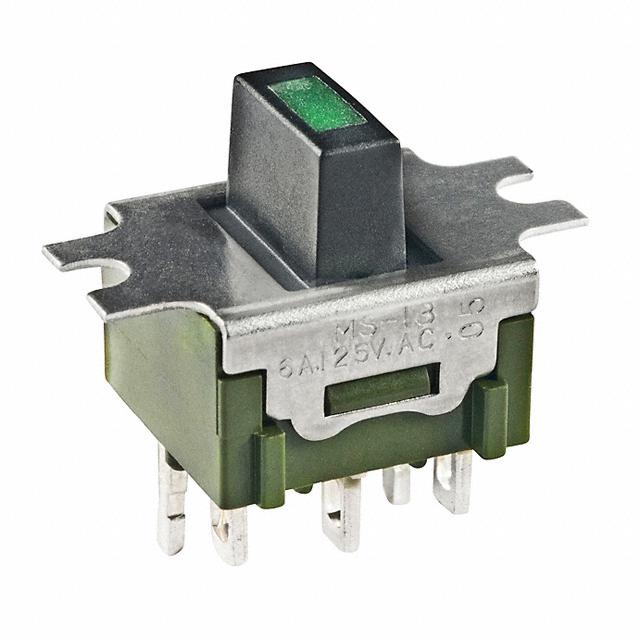

Miniature Slides Series MS Distinctive Characteristics Bright, LED illumination at top of actuator. Over-center actuator block and plunger design gives crisp actuation, diminishes sparking, and increases operating life. Guide interlocked with actuator block prevents window locking and maintains correct plunger alignment to assure contact stability. Antijamming design protects contacts from damage due to excessive downward force on the actuator. High internal barriers between poles and insulating sheet between case and actuator block give added protection to contacts. Prominent external insulating barriers increase insulation resistance and dielectric strength. Epoxy sealed terminals prevent entry of flux, solvents, and other contaminants. Clinching of frame to case well above base and terminals provides 1,500V dielectric strength. Actual Size N KK Switches • email: sales@nkkswitches.com • Phone (480) 991-0942 • Fax (480) 998-1435 • www.nkkswitches.com 07-07 Miniature Slides Series MS General Specifications Electrical Capacity (Resistive Load) Power Level: 6A @ 125V AC or 3A @ 250V AC Other Ratings Contact Resistance: Insulation Resistance: Dielectric Strength: Mechanical Life: Electrical Life: Contact Timing: Total Travel: 10 milliohms maximum 1,000 megohms minimum @ 500V DC 1,000V AC minimum between contacts for 1 minute minimum; 1,500V AC minimum between contacts & case for 1 minute minimum 50,000 operations minimum 25,000 operations minimum Nonshorting (break-before-make) .087” (2.2mm) Materials & Finishes Actuator: Frame: Case: Movable Contacts: Stationary Contacts: Terminals: Glass fiber reinforced polyester Stainless steel Glass fiber reinforced diallyl phthalate resin (UL94V-0) Silver alloy Silver capped copper with silver plating Copper or brass with silver plating Environmental Data Operating Temp Range: Humidity: Vibration: Shock: –10°C through +55°C (+14°F through +131°F) 90 ~ 95% humidity for 240 hours @ 40°C (104°F) 10 ~ 55Hz with peak-to-peak amplitude of 1.5mm traversing the frequency range & returning in 1 minute; 3 right angled directions for 2 hours 50G (490m/s2) acceleration (tested in 6 right angled directions, with 5 shocks in each direction) Processing Soldering Time & Temp: Cleaning: Wave Soldering Recommended (PC version): See Profile A in Supplement section. Manual Soldering: See Profile A in Supplement section. Note: Lever must be in center position while soldering. These devices are not process sealed. Hand clean locally using alcohol based solution. Standards & Certifications Flammability Standards: UL94V-0 rated case N KK Switches • email: sales@nkkswitches.com • Phone (480) 991-0942 • Fax (480) 998-1435 • www.nkkswitches.com 07-07 Miniature Slides TYPICAL SWITCH ORDERING EXAMPLE Series MS 01 C LEDS C E F Red Yellow Green MS POLES 1 SPDT 1 2 ILLUMINATION L LED Lighted L F W CONTACT MATERIALS & R ATINGS W Silver; Rated 6A @ 125V AC & 3A @ 250V AC C IRCUITS 2 3 ON ON NONE OFF ON ON N F MOUNTING For Straight PC (Terminal 03 only) With 2-screw Flange (Terminal 01 only) TERMINALS 01 03 Solder Lug Straight PC DESCRIPTION FOR TYPICAL ORDERING EXAMPLE MS12LFW01C Red LED Illumination Silver Contacts with 6-Amp Rating Solder Lug Terminals 2-screw Flange Frame SPDT ON-NONE-ON Circuit P OLES & CIRCUITS Slide Position Left Pole SP Model MS12 MS13 ON ON NONE OFF ON ON 2-1 OPEN 2-3 Center Right Connected Terminals Left Center Right Throw & Schematics Note: Terminal numbers are not actually on the switch. LED circuit is isolated and requires an external connection. 2 (COM) SPDT 1 3 L(+) 4 6 L(-) CONTACT MATERIALS & RATINGS W Silver over Silver Power Level 6A @ 125V AC & 3A @ 250V AC N KK Switches • email: sales@nkkswitches.com • Phone (480) 991-0942 • Fax (480) 998-1435 • www.nkkswitches.com 07-07 Miniature Slides MOUNTING TYPES & TERMINALS N Straight PC Mount (Combines with Straight PC Terminal 03 only) Series MS Epoxy Seal (1.17) Typ .046 03 Straight PC (6.35) (4.8) .250 .189 (4.8) .189 Thk = (0.8) Typ .031 F 2-screw Flange (Combines with Solder Lug Terminal 01 only) 01 Epoxy Seal Solder Lug (6.35) (4.8) .250 .189 (1.17) .046 (2.0) .079 (4.0) .157 (2.0) .079 (1.1) .043 (4.8) .189 Thk = (0.8) Typ .031 LED COLORS & SPECIFICATIONS LEDs are supplied as an integral part of the switch (not available separately). The lamp circuit is independent of switch operation. Electrical specifications shown are determined at a basic temperature of 25°C. If the source voltage exceeds the rated voltage, a ballast resistor is required. The resistor value can be calculated by using the formula given in the Supplement. (+) (-) Color IFM IF VF VRM ∆IF C Red E Yellow F Green 25mA 16mA Forward Peak Current Continuous Forward Current Forward Voltage Reverse Peak Voltage Current Reduction Rate Above 25°C Ambient Temperature Range 30mA 16mA 1.98V 5V 0.40mA/°C 30mA 16mA 2.06V 5V 0.42mA/°C –15° ~ +60°C 2.16V 5V 0.33mA/°C TYPICAL SWITCH DIMENSIONS Solder Lug Terminals (1.2) R Typ .047 (5.0) .197 Circuit Mark This Side (1.1) x (2.0) Typ .043 x .079 (0.8) Typ .031 (1.17) Typ .046 (2.0) Typ .079 (2.4) .094 Dia Typ Direction of Actuation (17.53) .690 (19.6) .772 (2.0) .079 (6.1) .240 (8.2) .323 6 3 2 (3.8) .150 (4.7) Typ .185 (12.7) .500 (6.8) .268 (17.53) .690 4 1 (5.1) .201 (0.4) (4.5) .016 .177 (7.6) (6.35) .299 .250 (4.8) .189 (11.9) .469 (0.5) .020 (9.0) .354 MS12LFW01C Actuator in LEFT Position Maximum Panel Thickness .197” (5.0mm) Straight PC Terminals (5.0) .197 Circuit Mark This Side (0.8) Typ .031 6 (1.17) Typ .046 3 2 4 1 (4.8) .189 3 6 2 1 4 Direction of Actuation (2.0) .079 (3.8) .150 (4.7) Typ .185 (4.8) .189 (6.35) .250 (12.7) .500 (4.7) Typ .185 (9.0) .354 (6.8) .268 (8.2) .323 (5.1) .201 (7.6) .299 (4.8) .189 (11.9) .469 (0.5) .020 (1.8) Dia Typ .073 MS12LNW03C Actuator in LEFT Position Maximum Panel Thickness .197” (5.0mm) 07-07 N KK Switches • email: sales@nkkswitches.com • Phone (480) 991-0942 • Fax (480) 998-1435 • www.nkkswitches.com
