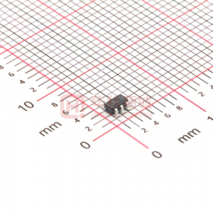

LM3722/LM3723/LM3724 5-Pin Microprocessor Reset Circuits June 2001 LM3722/LM3723/LM3724 5-Pin Microprocessor Reset Circuits General Description The LM3722/LM3723/LM3724 microprocessor supervisory circuits monitor the power supplies in microprocessor and digital systems. They provide a reset to the microprocessor during power-up, power-down, brown-out conditions, and manual reset. The LM3722/LM3723/LM3724 asserts a reset signal whenever the supply decreases below the factory-programmed reset threshold for at least 100 ms. The reset signal remains asserted for 190 ms after VCC rises above the threshold. The LM3722 has an active-low RESET push-pull output. The LM3723 has an active-high RESET push-pull output. The LM3724 has an active-low open-drain RESET output. Three standard reset voltage options are available, suitable for monitoring 5V, 3.3V, and 2.5V supply voltages. Additional reset voltages are also available; contact National Semiconductor for details. With a low supply current of only 6µA, the LM3722/LM3723/LM3724 are ideal for use in portable equipment. The LM3722/LM3723/LM3724 are available in the 5-pin SOT23 package. Features n Precise monitoring of 2.5V, 3.3V, and 5V supply voltages n Fully specified over temperature Industrial: −40˚C to +85˚C Extended: −40˚C to +125˚C n 100 ms minimum Power-On Reset pulse width, 190 ms typical: Active-Low RESET Output (LM3722) Active-High RESET Output (LM3723) Active-Low RESET Open Drain Output (LM3724) n Guaranteed RESET Output valid for VCC ≥ 1V n Low Supply Current, 6µA typical n Power supply transient immunity n Compatible with MAX811/812 applications Applications n n n n n Microprocessor Systems Computers Controllers Intelligent Instruments Portable/Battery-Powered Equipment Typical Application Circuit 20014401 20014437 Connection Diagram SOT23-5 20014402 *( ) are for LM3723 © 2001 National Semiconductor Corporation DS200144 www.national.com LM3722/LM3723/LM3724 Ordering Information Industrial Temperature Range (−40˚C to +85˚C): Reset Threshold (V) 4.63 3.08 2.32 Reset Threshold (V) 4.63 3.08 2.32 Reset Threshold (V) 4.63 3.08 2.32 LM3722 Supplied as 1000 units, tape & reel LM3722IM5-4.63 LM3722IM5-3.08 LM3722IM5-2.32 LM3723 Supplied as 1000 units, tape & reel LM3723IM5-4.63 LM3723IM5-3.08 LM3723IM5-2.32 LM3724 Supplied as 1000 units, tape & reel LM3724IM5-4.63 LM3724IM5-3.08 LM3724IM5-2.32 LM3722 Supplied as 3000 units, tape & reel LM3722IM5X-4.63 LM3722IM5X-3.08 LM3722IM5X-2.32 LM3723 Supplied as 3000 units, tape & reel LM3723IM5X-4.63 LM3723IM5X-3.08 LM3723IM5X-2.32 LM3724 Supplied as 3000 units, tape & reel LM3724IM5X-4.63 LM3724IM5X-3.08 LM3724IM5X-2.32 Package Top Mark R43B R41B R34B Package Top Mark R13B R11B R46B Package Top Mark R55B R53B R50B SOT23-5 MF05A Package Type NSC Package SOT23-5 MF05A Package Type NSC Package SOT23-5 MF05A Package Type NSC Package Extended Temperature Range (−40˚C to +125˚C): Reset Threshold (V) 4.63 3.08 2.32 Reset Threshold (V) 4.63 3.08 2.32 Reset Threshold (V) 4.63 3.08 2.32 LM3722 Supplied as 1000 units, tape & reel LM3722EM5-4.63 LM3722EM5-3.08 LM3722EM5-2.32 LM3723 Supplied as 1000 units, tape & reel LM3723EM5-4.63 LM3723EM5-3.08 LM3723EM5-2.32 LM3724 Supplied as 1000 units, tape & reel LM3724EM5-4.63 LM3724EM5-3.08 LM3724EM5-2.32 LM3722 Supplied as 3000 units, tape & reel LM3722EM5X-4.63 LM3722EM5X-3.08 LM3722EM5X-2.32 LM3723 Supplied as 3000 units, tape & reel LM3723EM5X-4.63 LM3723EM5X-3.08 LM3723EM5X-2.32 LM3724 Supplied as 3000 units, tape & reel LM3724EM5X-4.63 LM3724EM5X-3.08 LM3724EM5X-2.32 Package Top Mark R56B R57B R58B Package Top Mark R59B R60 R61B Package Top Mark R62B R63B R64B SOT23-5 MF05A Package Type NSC Package SOT23-5 MF05A Package Type NSC Package SOT23-5 MF05A Package Type NSC Package Custom voltages and improved accuracies are available, subject to minimum orders. Contact your local National Semiconductor Sales Office for information. www.national.com 2 LM3722/LM3723/LM3724 Pin Description PIN 1 2 NAME GND GND RESET LM3722/LM3724 RESET LM3723 MR VCC Ground reference Ground reference, device substrate, connect to ground. Active-low output. RESET remains low while VCC is below the reset threshold voltage, and for 190 ms after VCC rises above the reset threshold voltage. Active-high output. RESET remains high while VCC is below the reset threshold, and for 190 ms after VCC rises above the reset threshold. Active-low input. Reset is asserted whenever this pin is pulled low and remains asserted for 190 ms after the MR pin goes high. May be left open. Supply Voltage (+5V, +3.3V, or +2.5V, nominal) FUNCTION 3 4 5 Block Diagram LM3722/LM3723/LM3724 Block Diagram 20014435 3 www.national.com LM3722/LM3723/LM3724 Absolute Maximum Ratings (Note 1) Continuous Power Dissipation (TA = +70˚C) SOT-23 (Note 3) Operating Temperature Range Industrial: Extended: Maximum Junction Temperature Storage Temperature Range Lead Temperature (soldering, 10sec) −40˚C to +85˚C −40˚C to +125˚C 125˚C −65˚C to +160˚C +300˚C 320mW If Military/Aerospace specified devices are required, please contact the National Semiconductor Sales Office/ Distributors for availability and specifications. VCC, MR RESET, RESET Input Current, VCC Pin Output Current, RESET, RESET Pin ESD Rating (Note 2) −0.3V to 6.0V −0.3V to (VCC+ 0.3V) 20mA 20mA 2kV Electrical Characteristics Typical values are at TA = +25˚C. Limits with standard typeface are for TA = +25˚C, and limits in boldface type apply for the operating temperature range (−40˚C to +85˚C) for LM372_IM5X, and (−40˚C to +125˚C) for LM372_EM5X, unless otherwise noted. (Note 4) Symbol VCC ICC Parameter VCC Range Supply Current (ILOAD = 0A) LM372 _ -4.63 LM372 _ -3.08 LM372 _ -2.32 LM372 _ -4.63 VTH Reset Threshold LM372 _ -3.08 LM372 _ -2.32 VTH Tempco tRD tRP tMR tMD Reset Threshold Temperature Coefficient VCC to Reset Delay (Note 5) Reset Active Timeout Period MR Minimum Pulse Width MR to Reset Propagation Delay MR Glitch Immunity (Note 6) VIH VIL VIH VIL MR Pull-Up Resistance VCC = VTH min, ISINK = 1.2mA, (LM3722-2.32/3.08) VCC = VTH min, ISINK = 3.2mA, (LM3722-4.63) VCC > 1V, ISINK = 50µA RESET Output Voltage High (LM3722) VCC > VTH max, ISOURCE = 500µA, (LM3722-2.32/3.08) VCC > VTH max, ISOURCE = 800µA, (LM3722-4.63) VCC = VTH max, ISINK = 1.2mA (LM3723 -2.32/3.08) VCC = VTH max, ISINK = 3.2mA (LM3723 -4.63) 0.8VCC VCC−1.5 0.3 0.4 V V MR Input Threshold VCC > VTH(MAX), LM372_ -4.63 VCC > VTH(MAX), LM372_ -3.08, LM372_ -2.32 2.3 0.8 0.7 VCC 0.25 VCC 22 0.3 0.4 0.3 V kΩ V VCC = VTH to (VTH − 100mV) 100 10 2 100 VCC = 5.5V VCC = 3.6V VCC = 2.5V 4.54 4.50 3.03 3.00 2.27 2.25 Conditions Min 1.0 8 7 6 4.63 3.08 2.32 Typ Max 5.5 15 10 10 4.72 4.75 3.14 3.15 2.37 2.40 ppm/˚C µs 560 ms µs µs ns V Units V µA 30 20 190 VOL RESET Output Voltage Low (LM3722) VOH VOL RESET Output Voltage Low (LM3723) www.national.com 4 LM3722/LM3723/LM3724 Electrical Characteristics (Continued) Typical values are at TA = +25˚C. Limits with standard typeface are for TA = +25˚C, and limits in boldface type apply for the operating temperature range (−40˚C to +85˚C) for LM372_IM5X, and (−40˚C to +125˚C) for LM372_EM5X, unless otherwise noted. (Note 4) Parameter RESET Output Voltage High (LM3723) RESET Output Voltage Low (LM3724) Conditions 1.8V < VCC < VTH min, ISOURCE = 150µA VCC = VTH min, ISINK = 1.2 mA (LM3724 -2.32/3.08) VCC = VTH min, ISINK = 3.2 mA (LM3724 -4.63) VCC > 1V, ISINK = 50µA IIN RESET Output Leakage Current (LM3724) VCC > VTH, RESET = 5.5V Min 0.8VCC 0.3 0.4 0.3 0.5 µA Typ Max Units V V VOH VOL Symbol Note 1: Absolute Maximum Ratings are limits beyond which damage to the device may occur. Operating Ratings are conditions under which the device operates correctly. Operating ratings do not imply guaranteed performance limits. For guaranteed performance limits and associated test conditions, see the Electrical Characteristics. Note 2: The human body model is a 100pF capacitor discharged through a 1.5kΩ resistor into each pin. Note 3: At elevated temperatures, devices must be derated based on package thermal resistance. The device in the SOT23-5 package must be derated at 4.5mW/˚C at ambient temperatures above 70˚C. The device has internal thermal protection. Note 4: Production testing done at TA = +25˚C. Limits over the operating temperature range are guaranteed through correlation using Statistical Quality Control (SQC) methods. Note 5: RESET Output for LM3722 and LM3724, RESET output for LM3723. Note 6: Glitches of 100 ns or less typically will not generate a reset pulse. 5 www.national.com LM3722/LM3723/LM3724 Typical Performance Characteristics Supply Current vs VCC Supply Current vs Temperature 20014403 20014407 Reset Timeout vs VCC Reset Timeout vs Temperature 20014408 20014404 Normalized VTH vs Temperature LM3724 VOL vs Current 20014416 20014405 www.national.com 6 LM3722/LM3723/LM3724 Typical Performance Characteristics LM3724 Low VCC Characteristics (Continued) 20014406 7 www.national.com LM3722/LM3723/LM3724 Timing Diagram 20014412 Circuit Information Reset Output The reset input of a µP initializes the device into a known state. The LM3722/LM3723/LM3724 microprocessor voltage monitoring circuits assert a forced reset output to prevent code execution errors during power-up, power-down, and brownout conditions. RESET is guaranteed valid for VCC ≥ 1V. Once VCC exceeds the reset threshold, an internal timer maintains the output for the reset timeout period. After this interval, reset goes high and the microprocessor initializes itself into a known state. The LM3722 and LM3724 offer an active-low RESET; the LM3723 offers an active-high RESET. As VCC drops below the reset threshold (such as during a brownout), the reset activates (see the Negative-Going VCC Transients section). When VCC again rises above the reset threshold, the internal timer starts. Reset holds until VCC exceeds the reset threshold for longer than the reset timeout period. After this time, reset releases. Additionally, the Manual Reset input (MR) will initiate a forced reset. See the Manual Reset Input section. The LM3722/LM3723/LM3724 reset outputs ignore short duration glitches on VCC and MR. See the Applications Information section for details. Reset Threshold The LM3722/LM3723/LM3724 are available with reset voltages of 4.63V, 3.08V, and 2.32V which are suitable for monitoring 5.0V, 3.3V, and 2.5V supplies respectively. Other reset thresholds in the 2.20V to 5.0V range, in 10 mV steps, are available; contact National Semiconductor for details. Manual Reset Input (MR) Many µP-based products require a manual reset capability, allowing the operator to initiate a reset. The MR input is fully debounced and provides an internal 22 kΩ pull-up. When the MR input is pulled below VIL (0.25VCC) for more than 100 ns, reset is asserted after a typical delay of 2 µs. Reset remains active as long as MR is held low, and releases after MR rises above VIH and the reset timeout period expires. Use MR with digital logic to assert reset or to daisy chain supervisory circuits. Applications Information Benefits of Precision Reset Thresholds A microprocessor supply supervisor must provide a reset output within a predictable range of the supply voltage. A common threshold range is between 5% and 10% below the nominal supply voltage. The 4.63V, 3.08V and 2.32V options of the LM3722/LM3723/LM3724 use highly accurate circuitry to ensure that the reset threshold occurs only within this range (for 5.0V, 3.3V and 2.5V supplies). Table 1 shows how the standard reset thresholds apply to 5.0V, 3.3V, and 2.5V nominal supply voltages. 8 www.national.com LM3722/LM3723/LM3724 Applications Information Reset Threshold 4.63 ± % 3.08 ± % 2.32 ± % 91.8-95.2% 90.8-94.8% (Continued) TABLE 1. Monitored Tolerance Table Supply Voltage 2.5V 3.3V 5.0V 90.8-94.4% resistor must be small enough so that the leakage current of all connected devices does not create an excessive voltage drop when the output is not activated. A resistor value of 100 kΩ will generally suffice. Negative-Going VCC Transients The LM3722/LM3723/LM3724 are relatively immune to short negative-going transients or glitches on VCC. Figure 2 shows the maximum pulse width a negative-going VCC transient can have without causing a reset pulse. In general, as the magnitude of the transient increases, going further below the threshold, the maximum allowable pulse width decreases. Typically, a VCC transient that goes 125 mV below the reset threshold and lasts 40 µs or less will not cause a reset pulse. A 0.1 µF bypass capacitor mounted as close as possible to the VCC pin will provide additional transient rejection. Ensuring a Valid Reset Output Down to VCC = 0V When VCC falls below 1V, the LM3722 RESET output is unable to sink the rated current. A high-impedance CMOS logic input connected to RESET can therefore drift to undetermined voltages. To prevent this situation, a 100kΩ resistor should be connected from the RESET output to ground, as shown in Figure 1. A 100kΩ pull-up resistor to VCC is also recommended for the LM3723, if RESET is required to remain valid for VCC < 1V. 20014410 20014414 FIGURE 1. Circuit for RESET Valid from VCC = 0V Open Drain Output (LM3724) An open drain output allows easy paralleling of multiple microprocessor reset circuits without requiring additional logic gates. Open drain outputs also allow interfacing devices of differing logic levels or families, since the output pull-up resistor may be connected to any supply voltage up to 5.5V, regardless of LM3724 VCC. The pull up resistor is calculated so that maximum current flow into RESET is less than 10 mA when activated. The FIGURE 2. Maximum Transient Duration without Causing a Reset Pulse vs. Reset Comparator Overdrive Interfacing to µPs with Bidirectional Reset Pins Microprocessors with bidirectional reset pins, such as the Motorola 68HC11 series, can be connected to the LM3722 RESET output. To ensure a correct output on the LM3722 even when the microprocessor reset pin is in the opposite state, connect a 4.7kΩ resistor between the LM3722 RESET output and the µP reset pin, as shown in Figure 3. Buffer the LM3722 RESET output to other system components. 9 www.national.com LM3722/LM3723/LM3724 Typical Application Circuits 20014411 FIGURE 3. Interfacing to Microprocessors with Bidirectional Reset I/O 20014422 FIGURE 4. Regulator/Switch with Long-Term Overvoltage Lockout Prevents Overdissipation in Linear Regulator www.national.com 10 LM3722/LM3723/LM3724 Typical Application Circuits (Continued) 20014431 FIGURE 5. LM3722 Switch Debouncer 20014424 FIGURE 6. LM3723 Power-On Delay 11 www.national.com LM3722/LM3723/LM3724 5-Pin Microprocessor Reset Circuits Physical Dimensions unless otherwise noted inches (millimeters) 5-Lead SOT23-5 For Ordering, refer to Ordering Information table NS Package Number MF05A LIFE SUPPORT POLICY NATIONAL’S PRODUCTS ARE NOT AUTHORIZED FOR USE AS CRITICAL COMPONENTS IN LIFE SUPPORT DEVICES OR SYSTEMS WITHOUT THE EXPRESS WRITTEN APPROVAL OF THE PRESIDENT AND GENERAL COUNSEL OF NATIONAL SEMICONDUCTOR CORPORATION. As used herein: 1. Life support devices or systems are devices or systems which, (a) are intended for surgical implant into the body, or (b) support or sustain life, and whose failure to perform when properly used in accordance with instructions for use provided in the labeling, can be reasonably expected to result in a significant injury to the user. National Semiconductor Corporation Americas Email: support@nsc.com National Semiconductor Europe Fax: +49 (0) 180-530 85 86 Email: europe.support@nsc.com Deutsch Tel: +49 (0) 69 9508 6208 English Tel: +44 (0) 870 24 0 2171 Français Tel: +33 (0) 1 41 91 8790 2. A critical component is any component of a life support device or system whose failure to perform can be reasonably expected to cause the failure of the life support device or system, or to affect its safety or effectiveness. National Semiconductor Asia Pacific Customer Response Group Tel: 65-2544466 Fax: 65-2504466 Email: ap.support@nsc.com National Semiconductor Japan Ltd. Tel: 81-3-5639-7560 Fax: 81-3-5639-7507 www.national.com National does not assume any responsibility for use of any circuitry described, no circuit patent licenses are implied and National reserves the right at any time without notice to change said circuitry and specifications.

### 物料型号 - LM3722/LM3723/LM3724:5脚微处理器复位电路。
### 器件简介 - 这些微处理器监控电路用于监控微处理器和数字系统的电源。在上电、掉电、低电压和手动复位情况下为微处理器提供复位信号。
### 引脚分配 - PIN 1 (GND):地参考。 - PIN 2 (GND):地参考,连接到地。 - PIN 3 (RESET LM3722/LM3724):低电平输出。当Vcc低于复位阈值时,RESET保持低电平,并在Vcc上升超过阈值后保持190ms。 - PIN 3 (RESET LM3723):高电平输出。当Vcc低于复位阈值时,RESET保持高电平,并在Vcc上升超过阈值后保持190ms。 - PIN 4 (MR):低电平输入。当此引脚被拉低时,复位被触发,并在MR引脚变高后保持190ms。 - PIN 5 (Vcc):供电电压(+5V, +3.3V, 或 +2.5V)。
### 参数特性 - 复位电压选项:适用于监控5V、3.3V和2.5V供电电压。 - 低供电电流:典型值仅为6µA。 - 工作温度范围:工业级:-40˚C至+85˚C;扩展级:-40˚C至+125˚C。 - 最小上电复位脉冲宽度:100ms;典型190ms。
### 功能详解 - 提供精确的2.5V、3.3V和5V供电电压监测。 - 低供电电流,适合便携设备使用。 - 兼容MAX811/812应用。 - 具有手动复位输入(MR),允许操作者触发复位。
### 应用信息 - 微处理器系统、计算机、控制器、智能仪器、便携/电池供电设备。
### 封装信息 - 5脚SOT23封装。
