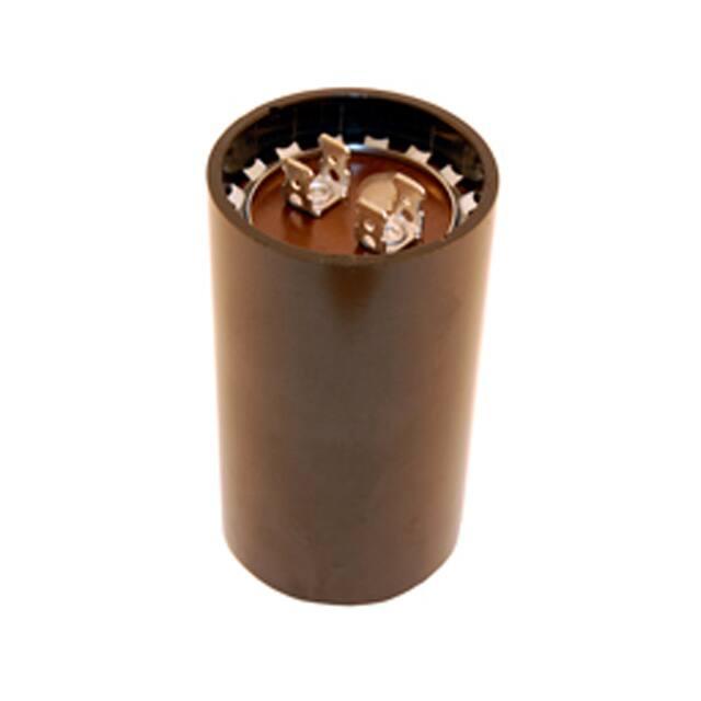

MOTOR START AC ELECTROLYTIC MSC SERIES The MSC Series is a range of AC electrolytic capacitors. These capacitors are most often used to provide the torque necessary to start AC motors and in other intermittent AC applications. FEATURES: • Two .25” Quick Connect terminals • Round moisture and oil resistant plastic case • 110VAC to 330VAC • Quick disconnect terminals • Recessed terminals • Long life and high reliability C D RATINGS Capacitance Range: 110/125 Volts – 21µF to 1200µF 220/250 Volts – 21µF to 324µF 330 Volts – 21µF to 259µF H PERFORMANCE SPECIFICATIONS Operating Temperature Range: –40°C to +65°C Power Factor: 10% Max.; 12% ≤30µF Operating Frequency: 47 – 60HZ MOUNTING Vertical mounting of the capacitor with the terminals up is recommended. However, horizontal mounting is acceptable providing the vent is located in the up position. Vertical mounting with the terminals down is not recommended because the capacitor life may be reduced and the operation of the pressure relief vent impaired. SAFETY Because the watt–second value of these capacitors is high, precautions should be taken during the testing of these devices. Discharge resistors should be specified when there is a possibility of a residual charge left on the capacitor or to protect contacts. Mis–application, such as exceeding design limits or applying continuous AC voltage, may result in destruction or explosion of capacitors. CLEANING Solvent residues on the capacitors after cleaning may penetrate the seal and cause internal corrosion resulting in shortened life. Alcohol or water detergent cleaning is not usually harmful but halogenated cleaning solvents are not recommended and should be avoided. ORDERING INFORMATION MSC Series Voltage Capacitance 125V 21 NTE Electronics, Inc. D Voice (800) 631–1250 (973) 748–5089 D FAX (973) 748–6224 D http://www.nteinc.com 25 MOTOR START AC ELECTROLYTIC MSC SERIES 110/125VAC Ratings and Dimensions NTE Type Number MSC125V21 MSC125V25 MSC125V30 MSC125V36 MSC125V43 MSC125V53 MSC125V72 MSC125V88 MSC125V108 MSC125V124 MSC125V145 MSC125V161 MSC125V189 MSC125V216 MSC125V233 MSC125V270 MSC125V324 MSC125V340 MSC125V378 MSC125V400 MSC125V460 MSC125V540 MSC125V590 MSC125V829 MSC125V1000 Capacitance mF 21–25 25–30 30–36 36–43 43–52 53–64 72–86 88–106 108–130 124–149 145–174 161–193 189–227 216–259 233–280 270–324 324–389 340–408 378–454 400–480 460–552 540–648 590–708 829–995 1000–1200 Case Dimensions – Inch (mm) D 1.438 (36.53) 1.438 (36.53) 1.438 (36.53) 1.438 (36.53) 1.438 (36.53) 1.438 (36.53) 1.438 (36.53) 1.438 (36.53) 1.438 (36.53) 1.438 (36.53) 1.438 (36.53) 1.438 (36.53) 1.438 (36.53) 1.438 (36.53) 1.438 (36.53) 1.438 (36.53) 1.438 (36.53) 1.810 (45.97) 1.810 (45.97) 1.810 (45.97) 1.810 (45.97) 1.810 (45.97) 1.810 (45.97) 1.810 (45.97) 2.060 (52.32) H 2.75 (69.85) 2.75 (69.85) 2.75 (69.85) 2.75 (69.85) 2.75 (69.85) 2.75 (69.85) 2.75 (69.85) 2.75 (69.85) 2.75 (69.85) 2.75 (69.85) 2.75 (69.85) 2.75 (69.85) 2.75 (69.85) 3.38 (85.85) 3.38 (85.85) 3.38 (85.85) 4.38 (111.25) 3.38 (85.85) 3.38 (85.85) 3.38 (85.85) 3.38 (85.85) 3.38 (85.85) 4.38 (111.25) 4.38 (111.25) 4.38 (111.25) C 0.50 (12.70) 0.50 (12.70) 0.50 (12.70) 0.50 (12.70) 0.50 (12.70) 0.50 (12.70) 0.50 (12.70) 0.50 (12.70) 0.50 (12.70) 0.50 (12.70) 0.50 (12.70) 0.50 (12.70) 0.50 (12.70) 0.50 (12.70) 0.50 (12.70) 0.50 (12.70) 0.50 (12.70) 0.63 (16.00) 0.63 (16.00) 0.63 (16.00) 0.63 (16.00) 0.63 (16.00) 0.63 (16.00) 0.63 (16.00) 0.88 (22.35) E E E E E E E E E E E E E F F F G H H H H H J J K Case Style 220/250VAC Ratings and Dimensions NTE Type Number MSC250V21 MSC250V25 MSC250V30 MSC250V36 MSC250V43 MSC250V53 MSC250V72 MSC250V88 MSC250V108 MSC250V124 MSC250V130 MSC250V145 MSC250V161 MSC250V189 MSC250V216 MSC250V233 MSC250V270 Capacitance mF 21–25 25–30 30–36 36–43 43–52 53–64 72–86 88–106 108–130 124–149 130–156 145–174 161–193 189–227 216–259 233–280 270–324 Case Dimensions – Inch (mm) D 1.438 (36.53) 1.438 (36.53) 1.438 (36.53) 1.438 (36.53) 1.810 (45.97) 1.810 (45.97) 1.810 (45.97) 1.810 (45.97) 1.810 (45.97) 1.810 (45.97) 1.810 (45.97) 1.810 (45.97) 2.060 (52.32) 2.060 (52.32) 2.060 (52.32) 2.060 (52.32) 2.060 (52.32) H 2.75 (69.85) 2.75 (69.85) 2.75 (69.85) 2.75 (69.85) 3.38 (85.85) 3.38 (85.85) 3.38 (85.85) 3.38 (85.85) 3.38 (85.85) 4.38 (111.25) 4.38 (111.25) 4.38 (111.25) 4.38 (111.25) 4.38 (111.25) 4.38 (111.25) 4.38 (111.25) 4.38 (111.25) C 0.50 (12.70) 0.50 (12.70) 0.50 (12.70) 0.50 (12.70) 0.50 (12.70) 0.50 (12.70) 0.63 (16.00) 0.63 (16.00) 0.63 (16.00) 0.63 (16.00) 0.63 (16.00) 0.63 (16.00) 0.88 (22.35) 0.88 (22.35) 0.88 (22.35) 0.88 (22.35) 0.88 (22.35) E E E E F F H H H J J J K K K K K Case Style 26 NTE Electronics, Inc. D Voice (800) 631–1250 (973) 748–5089 D FAX (973) 748–6224 D http://www.nteinc.com MOTOR START AC ELECTROLYTIC MSC SERIES 330VAC Ratings and Dimensions NTE Type Number MSC330V21 MSC330V25 MSC330V30 MSC330V36 MSC330V43 MSC330V53 MSC330V72 MSC330V88 MSC330V108 MSC330V124 MSC330V145 MSC330V161 MSC330V189 MSC330V216 Capacitance mF 21–25 25–30 30–36 36–43 43–52 53–64 72–86 88–106 108–130 124–149 145–174 161–193 189–227 216–259 Case Dimensions – Inch (mm) D 1.438 (36.53) 1.438 (36.53) 1.438 (36.53) 1.438 (36.53) 1.438 (36.53) 1.810 (45.97) 1.810 (45.97) 1.810 (45.97) 2.060 (52.32) 2.560 (65.02) 2.060 (52.32) 2.560 (65.02) 2.560 (65.02) 2.560 (65.02) H 2.75 (69.85) 2.75 (69.85) 2.75 (69.85) 2.75 (69.85) 3.38 (85.85) 3.38 (85.85) 4.38 (111.25) 4.38 (111.25) 4.38 (111.25) 4.38 (111.25) 4.38 (111.25) 4.38 (111.25) 4.38 (111.25) 4.38 (111.25) C 0.50 (12.70) 0.50 (12.70) 0.50 (12.70) 0.50 (12.70) 0.50 (12.70) 0.63 (16.00) 0.63 (16.00) 0.63 (16.00) 0.88 (22.35) 0.88 (22.35) 0.88 (22.35) 0.88 (22.35) 0.88 (22.35) 0.88 (22.35) E F F F F H J J K K K L L L Case Style NTE Electronics, Inc. D Voice (800) 631–1250 (973) 748–5089 D FAX (973) 748–6224 D http://www.nteinc.com 27
