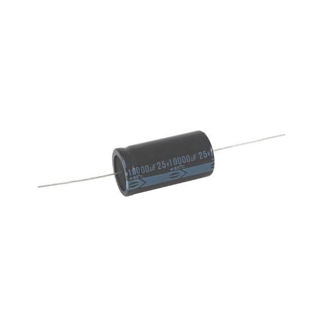

ALUMINUM ELECTROLYTIC 6.3V to 100V NEV, NEH SERIES SUBMINIATURE (NEV: Radial Lead, NEH: Axial Leads) MECHANICAL SPECIFICATIONS Lead Solderability: The NEV and NEH series subminiature aluminum electrolytic capacitors are especially suitable for applications requiring high capacitance, low cost, and very small size. In fact, you’ll find these capacitors in some of the most demanding applications, from precision medical electronics and automobiles to the newest personal computers and disk drives. They operate over a broad temperature range and are available in either blister pack or bulk. Meets the requirements of MIL−STD 202, Method 208 Marking: Consists of series type, nominal capacitance, rated voltage, temperature range, anode and/or cathode identification, vendor identification. Recommended Cleaning Solvents: Methanol, isopropanol ethanol, isobutanol, petroleum ether, propanol and/or commercial detergents. Halogenated hydrocarbon cleaning agents such as Freon (MF, TF, or TC), trichloroethylene, trichloroethane, or methylchloride are not recommended as they may damage the capacitor. RATINGS Capacitance Range: 0.1 f to 22,000 f Tolerance: 20% Voltage Range: 6.3V to 100V CASE SIZE AND DIMENSIONS: PERFORMANCE SPECIFICATIONS Operating Temperature Range: −40 C to +85 C (−40 F to +185 F) Leakage Current: I 0.01CV + 3 A (measured after 3 minutes of applied voltage) I = Leakage Current ( A) C = Nominal Capacitance ( f) V = Rated Voltage (V) Capacitance Tolerance (M): 20% measured at +20 C (+68 F), 120Hz Dissipation Factor: measured at +20 C (+68 F),120Hz Rated Voltage 6.3 10 16 25 35 50−80 100 0.1 f to 1000 f 0.24 0.2 0.17 0.15 0.12 0.10 0.08 1000 f to 22,000 f NEV SERIES Insulating Sleeve 18.0 Min Values above plus 0.02 for each 1000 f A 0.5 dØ Impedance Ratio at Low Temperature: 120Hz Comparison Z WV Z @ −25 C (−13 F)/ Z @ +20 C (+68 F) Z @ −40 C (−40 F)/ Z @ +20 C (+68 F) 6.3 10 16 25 35 50−100 DØ L L’ 4 3 8 2 6 4 2 2 4 2 4 5.0 Min D’ Ø = D Ø + 0.5 Max Surge Voltage L’ = L + 1.0 Max at D Ø 4 L 6.3 10 16 25 35 50 63 100 8 13 20 32 44 63 79 125 dØ DØ 25V to 100V Within 20% of the initial value D’ Ø = D Ø + 0.5 Max 35.0 Min L’ = L + 1.0 Max at D Ø 8.0 D’ Ø L’ = L + 2.0 Max at D Ø 10.0 47 M 50 Series Capacitance Leakage Current: Within 200% of specified value Dissipation Factor: Within 150% of specified value Capacitance Change Max: Within 20% of initial value NTE Electronics, Inc. L’ NEV Shelf Life: 1000 Hrs @ +85 C (+185 F), no voltage applied 32 35.0 Min ORDERING INFORMATION Capacitance Change Max Within 30% of the initial value 10.0 2.3 Max Leakage Current: Within values specified above Dissipation Factor: Within 150% of specified value Capacitance Change Max: See Table 6.3V to 16V L’ = L + 2.0 Max at D Ø Insulating Sleeve Load Life: 1000 12Hrs @ +85 C (+185 F), at rated voltage Rated Voltage 8.0 NEH SERIES (Insulating Bar = Negative) Surge Voltage: DC Rated Voltage D’ Ø Tolerance Voltage Voice (973) 748−5089 FAX (973) 748−6224 http://www.nteinc.com ALUMINUM ELECTROLYTIC 6.3V to 100V NEV Series (Radial Type) Dimensions: Diameter (D Ø) x Length (L): mm WV Cap ( f) 6.3 10 16 25 35 50 0.10 63 5 x 11 100 5 x 11 0.15 5 x 11.5 0.22 5 x 11 5 x 11.5 0.33 5 x 11 5 x 11.5 5 x 11.5 0.47 5 x 11 5 x 11.5 5 x 11.5 0.56 5 x 12 5 x 11.5 5 x 11.5 5 x 11.5 5 x 11.5 5 x 11.5 5 x 11.5 0.68 5 x 11.5 1.0 1.5 2.2 5 x 11 5 x 11.5 5 x 11.5 3.3 5 x 11 5 x 11 5 x 11 4.7 5 x 11.5 5 x 11.5 5 x 11 6.8 5 x 11 5 x 11.5 5 x 11 5 x 11 6.3 x 11 10 15 5 x 12 5 x 11.5 6.3 x 12 7 x 12 5 x 11 6.5 x 11.5 5 x 11 6.3 x 11 8 x 11.5 5 x 11.5 5 x 12 5 x 11.5 5 x 11 8 x 12 5 x 11.5 5 x 11 5 x 11.5 8 x 11.5 6.5 x 11 8 x 11.5 5 x 11 5 x 11.5 6.5 x 11 8 x 11 8 x 11 8 x 11 10 x 12 10 x 16 10 x 20 6.5 x 11 8 x 11 10 x 12 10 x 15 13 x 25 22 33 47 5 x 11 68 100 5 x 11 5 x 11.5 6.3 x 12 8 x 11.5 10 x 18 8 x 11.5 10 x 12 10 x 17 10 x 20 150 6.5 x 11.5 220 6.3 x 11.9 6.5 x 11 330 6.5 x 11.5 6.5 x 11 10 x 12.5 10 x 12.5 10 x 15.5 10 x 20 16 x 27 470 6.5 x 11.5 7 x 11 10 x 12 10 x 12 10 x 12 10 x 20 13 x 25.5 18 x 32 8 x 12 10 x 16 10 x 17 10 x 25 13 x 25 16 x 27 18 x 32 16 x 26 16 x 27 18 x 41 680 6.5 x 11 5 x 12 8 x 12 6.5 x 11.5 8 x 11.5 1000 10 x 16 10 x 12 10 x 15 10 x 20 13 x 21 1500 10 x 20 10 x 17 10 x 20 13 x 21 13 x 26 2200 10 x 20 10 x 20 13 x 20.5 13 x 21 13 x 26 16 x 32 22 x 41 3300 10 x 20 13 x 22 13 x 25 16 x 27 16 x 36 18.5 x 37 22 x 41 13 x 25 16 x 26 16 x 32 18 x 37 22 x 43 22 x 42 4700 6800 13 x 25 16 x 26 16 x 33 18 x 36 10000 16 x 26 16 x 32 18 x 40 22 x 43 22000 22 x 36 * These dimensions are for reference only, please consult the factory for actual size. NEV Series (Radial Type) Mechanical Specifications: mm Outside Diameter (D Ø) 5 6.3 8 10 13 16 18 Lead Spacing (A) 2 2.5 3.5 5 5 7.5 7.5 10 0.5 0.6 0.6 0.6 0.6 0.8 0.8 1.0 Lead Diameter (d Ø) 22 * These dimensions are for reference only, please consult the factory for actual size. NTE Electronics, Inc. Voice (973) 748−5089 FAX (973) 748−6224 http://www.nteinc.com 33 ALUMINUM ELECTROLYTIC 6.3V to 100V NEH Series (Axial Type) Dimensions: Diameter (D Ø) x Length (L): mm WV Cap ( f) 6.3 10 16 25 35 50 63 100 0.10 6 x 12.5 5 x 13 0.22 5 x 13 5 x 13 5 x 12.5 0.33 5 x 12.5 5 x 12.5 5 x 13 0.47 5 x 13 5 x 12.5 6 x 13 0.68 6 x 12.5 1.0 6 x 12.5 6 x 13 6 x 13 1.5 2.2 6 x 13.5 3.3 6 x 12.5 4.7 6 x 13 6.8 6 x 13 6.3 x 13 5 x 13 6 x 13 6.3 x 12.5 8 x 11.5 10 5 x 12.5 15 6 x 13 6 x 13 6.3 x 11 6.3 x 13 22 6 x 13 6.3 x 13 6.3 x 14 6 x 13 5 x 12 5 x 13 6.3 x 12.5 6.3 x 13 6 x 16.5 6 x 13 6.3 x 13 33 47 6 x 14 6.3 x 12.5 68 6 x 13 6.3 x 11 100 6 x 12.5 6.3 x 13 150 8 x 13.5 220 8 x 16 5 x 12.5 6 x 13 5 x 12.5 6 x 12.5 6 x 12.5 6 x 13 8 x 16 8 x 20 6.5 x 17.5 8 x 16 8 x 16 6 x 17 8 x 14 8 x 16 10 x 16 10 x 20 6 x 13 8 x 16 8 x 17 8 x 16 10 x 20 10 x 20 6 x 13 10 x 16 8 x 17 8 x 16 8 x 16 10 x 17 10 x 20 10 x 26 13 x 27 8 x 20.5 330 8 x 14 8 x 16 8 x 16 8 x 16 10 x 20 10 x 21 13 x 26.5 470 8 x 16 8 x 16 58 x 21 10 x 21 13 x 22 13 x 27 13 x 26 16 x 31.5 680 10 x 21 10 x 17 10 x 21 13 x 25 13 x 30 13 x 36 16 x 39 1000 10 x 17 10 x 21 10 x 21 13 x 22 13 x 27 16 x 23 16 x 32 22 x 42 1500 13 x 25 10 x 21 13 x 22 13 x 26 2200 13 x 25 13 x 22 13 x 26 16 x 27 16 x 31 18 x 35 18 x 39 3300 13 x 30 13 x 30 16 x 28 16 x 32.5 18 x 36 18 x 39 22 x 50 4700 16 x 26 16 x 25 16 x 31 16 x 38.5 22 x 42 13 x 26 6800 16 x 40 16 x 40 16 x 41 18 x 34 10000 16 x 31 18 x 40 18 x 39 22 x 41 22000 21.5 x 41 22 x 42 * These dimensions are for reference only, please consult the factory for actual size. NEH Series (Axial Type) Mechanical Specifications: mm Outside Diameter (D Ø) Lead Diameter (d Ø) 5 6.3 8 10 13 16 18 22 25 0.6 0.6 0.6 0.6 0.8 0.8 0.8 0.8 0.8 * These dimensions are for reference only, please consult the factory for actual size. 34 NTE Electronics, Inc. Voice (973) 748−5089 FAX (973) 748−6224 http://www.nteinc.com

参数特性: - 电容范围:0.1μF至22,000μF - 公差:20% - 电压范围:6.3V至100V - 工作温度范围:-40°C至+85°C - 漏电流:I = 0.01CV + 3mA(在施加电压3分钟后测量) - 电容公差:在+20°C,120Hz时测量为20% - 损耗因子:在+20°C,120Hz时测量
功能详解: - 电容器在高温下也能正常工作,提供长时间的使用寿命和存储寿命。 - 承受高浪涌电压。 - 符合MIL−STD 202标准,具有良好的引脚可焊性。
应用信息:适用于精密医疗电子、汽车、个人电脑和硬盘驱动器等。
封装信息: - NEV系列提供了多种尺寸,直径(D Ø)x 长度(L):毫米 - NEH系列提供了多种尺寸,直径(D Ø)x 长度(L):毫米 - 提供了详细的尺寸和引脚规格,但请注意,这些尺寸仅供参考,实际尺寸请咨询厂家。
