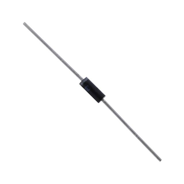

NTE5111A thru NTE5166A Zener Diode, 5 Watt 5% Tolerance Features: D Zener Voltage: 3.3V to 200V D High Surge Current Capability Absolute Maximum Ratings: DC Power Dissipation (TL = +75C, Lead Length = 3/8”), PD . . . . . . . . . . . . . . . . . . . . . . . . . . . . . 5W Derate Above 75C . . . . . . . . . . . . . . . . . . . . . . . . . . . . . . . . . . . . . . . . . . . . . . . . . . . . . . 40mW/C Forward Voltage (IF = 1A), VF . . . . . . . . . . . . . . . . . . . . . . . . . . . . . . . . . . . . . . . . . . . . . . . . . . . . . . . 1.2V Operating Junction Temperature Range, TJ . . . . . . . . . . . . . . . . . . . . . . . . . . . . . . . . . . −65 to +200C Storage Temperature Range, Tstg . . . . . . . . . . . . . . . . . . . . . . . . . . . . . . . . . . . . . . . . . . −65 to +200C Electrical Characteristics: (TA = +25C unless otherwise specified) Max Reverse Leakage Current Nominal Zener Voltage VZ @ IZT (Note 1) Max Surge Current ir (Note 2) Max Voltage Regulation VZ (Note 3) Test Current IZT Max Regulator Current IZM ZZT @ IZT (Note 1) ZZK @ IZK = 1mA (Note 1) IR Volts mA   A Volts Amps Volt mA NTE5111A 3.3 380 3.0 400 300 1 20 0.85 1440 NTE5112A 3.6 350 2.5 500 150 1 18.7 0.8 1320 NTE5113A 3.9 320 NTE5114A 4.3 290 2 500 50 1 17.6 0.54 1220 2 500 10 1 16.4 0.49 1100 NTE5115A 4.7 260 2 450 5 1 15.3 0.44 1010 NTE5116A NTE5117A 5.1 240 1.5 400 1 1 14.4 0.39 930 5.6 220 1 400 1 2 13.4 0.25 865 Max Zener Impedance @ VR Note 1 Test conditions for zener voltage and impedance are as follows: IZ is applied 40 10ms prior to reading. Mounting contacts are located 3/8” to 1/2” from the inside edge of mounting clips to the body of the diode (TA = +25C +8, −2C). Note 2 Surge current is specified as the maximum allowable peak, non−recurrent square−wave current with a pulse width, PW, of 8.3ms. Mounting contact located as specified in Note 1. Note 3 Test conditions for voltage regulation are as follows: VZ measurements are made at 10% and then at 50% of the IZ max value listed in the “Electrical Characteristic” table. The test current time duration for each VZ measurement is 40 10ms (TA = +25C +8, −2C). Mounting contact located as specified in Note 1. Rev. 11−21 Electrical Characteristics (Cont’d): (TA = +25C unless otherwise specified) Max Reverse Leakage Current Nominal Zener Voltage VZ @ IZT (Note 1) Max Surge Current ir (Note 2) Max Voltage Regulation VZ (Note 3) Test Current IZT Max Regulator Current IZM ZZT @ IZT (Note 1) ZZK @ IZK = 1mA (Note 1) IR Volts mA   A Volts Amps Volt mA NTE5118A 6.0 200 1 300 1 3 12.7 0.19 790 NTE5119A 6.2 200 1 200 NTE5120A 6.8 175 1 200 1 3 12.4 0.1 765 10 5.2 11.5 0.15 700 NTE5121A 7.5 175 1.5 200 NTE5122A 8.2 150 1.5 200 10 5.7 10.7 0.15 630 10 6.2 10 0.2 580 NTE5123A 8.7 150 2 NTE5124A 9.1 150 2 200 10 6.6 9.5 0.2 545 150 7.5 6.9 9.2 0.22 520 NTE5125A 10 125 NTE5126A 11 125 2 125 5 7.6 8.6 0.22 475 2.5 125 5 8.4 8 0.25 430 NTE5127A 12 100 NTE5128A 13 100 2.5 125 2 9.1 7.5 0.25 395 2.5 100 1 9.9 7 0.25 365 NTE5129A 14 100 2.5 75 1 10.6 6.7 0.25 340 NTE5130A NTE5131A 15 75 2.5 75 1 11.5 6.3 0.25 315 16 75 2.5 75 1 12.2 6 0.3 295 NTE5132A 17 70 2.5 75 0.5 12.9 5.8 0.35 280 NTE5133A 18 65 2.5 75 0.5 13.7 5.5 0.4 265 NTE5134A 19 65 3 75 0.5 14.4 5.3 0.4 250 NTE5135A 20 65 3 75 0.5 15.2 5.1 0.4 237 NTE5136A 22 50 3.5 75 0.5 16.7 4.7 0.45 216 NTE5137A 24 50 3.5 100 0.5 18.2 4.4 0.55 198 NTE5138A 25 50 4 110 0.5 19 4.3 0.55 190 NTE5139A 27 50 5 120 0.5 20.6 4.1 0.6 176 NTE5140A 28 50 6 130 0.5 21.2 3.9 0.6 170 NTE5141A 30 40 8 140 0.5 22.8 3.7 0.6 158 NTE5142A 33 40 10 150 0.5 25.1 3.5 0.6 144 NTE5143A 36 30 11 160 0.5 27.4 3.3 0.65 132 NTE5144A 39 30 14 170 0.5 29.7 3.1 0.65 122 NTE5145A 43 30 20 190 0.5 32.7 2.8 0.7 110 NTE5146A 47 25 25 210 0.5 35.8 2.7 0.8 100 NTE5147A 51 25 27 230 0.5 38.8 2.5 0.9 93 NTE5148A 56 20 35 280 0.5 42.6 2.3 1 86 NTE5149A 60 20 40 350 0.5 42.5 2.2 1.2 79 NTE5150A 62 20 42 400 0.5 47.1 2.1 1.35 76 NTE5151A 68 20 44 500 0.5 51.7 2 1.5 70 Max Zener Impedance @ VR Note 1 Test conditions for zener voltage and impedance are as follows: IZ is applied 40 10ms prior to reading. Mounting contacts are located 3/8” to 1/2” from the inside edge of mounting clips to the body of the diode (TA = +25C +8, −2C). Note 2 Surge current is specified as the maximum allowable peak, non−recurrent square−wave current with a pulse width, PW, of 8.3ms. Mounting contact located as specified in Note 1. Note 3 Test conditions for voltage regulation are as follows: VZ measurements are made at 10% and then at 50% of the IZ max value listed in the “Electrical Characteristic” table. The test current time duration for each VZ measurement is 40 10ms (TA = +25C +8, −2C). Mounting contact located as specified in Note 1. Electrical Characteristics (Cont’d): (TA = +25C unless otherwise specified) Max Reverse Leakage Current Nominal Zener Voltage VZ @ IZT (Note 1) Max Surge Current ir (Note 2) Max Voltage Regulation VZ (Note 3) Test Current IZT Max Regulator Current IZM ZZT @ IZT (Note1) ZZK @ IZK = 1mA (Note 1) IR Volts mA   A Volts Amps Volt mA NTE5152A 75 20 45 620 NTE5153A 82 15 65 720 0.5 56 1.9 1.6 63 0.5 62.2 1.8 1.8 58 NTE5154A 87 15 75 760 0.5 66 1.7 2 54.5 NTE5155A 91 15 NTE5156A 100 12 75 760 0.5 69.2 1.6 2.2 52.5 90 800 0.5 76 1.5 2.5 47.5 NTE5157A 110 12 125 1000 0.5 83.6 1.4 2.5 43 NTE5158A 120 10 170 1150 0.5 91.2 1.3 2.5 39.5 NTE5159A 130 10 190 1250 0.5 98.8 1.2 2.5 36.6 NTE5160A 140 8 230 1500 0.5 106 1.2 2.5 34 NTE5161A 150 8 330 1500 0.5 114 1.1 3 31.6 NTE5162A 160 8 350 1650 0.5 122 1.1 3 29.4 NTE5163A 170 8 380 1750 0.5 129 1 3 28 NTE5164A 180 5 430 1750 0.5 137 1 4 26.4 NTE5165A 190 5 450 1850 0.5 144 0.9 5 25 NTE5166A 200 5 480 1850 0.5 152 0.9 5 23.6 Max Zener Impedance @ VR Note 1 Test conditions for zener voltage and impedance are as follows: IZ is applied 40 10ms prior to reading. Mounting contacts are located 3/8” to 1/2” from the inside edge of mounting clips to the body of the diode (TA = +25C +8, −2C). Note 2 Surge current is specified as the maximum allowable peak, non−recurrent square−wave current with a pulse width, PW, of 8.3ms. Mounting contact located as specified in Note 1. Note 3 Test conditions for voltage regulation are as follows: VZ measurements are made at 10% and then at 50% of the IZ max value listed in the “Electrical Characteristic” table. The test current time duration for each VZ measurement is 40 10ms (TA = +25C +8, −2C). Mounting contact located as specified in Note 1. 1.000 (25.4) Min L D2 D Color Band Denotes Cathode DO−15 DO−201 Dim Min Max Min Max L .216 (5.50) .300 (7.62) .283 (7.20) .374 (9.50) D .102 (2.60) .142 (3.60) .189 (4.80) .209 (5.30) D2 .028 (0.71) .034 (0.864) .037 (0.94) .042 (1.07)

物料型号:NTE5111A至NTE5166A
器件简介:这些是5瓦特的Zener Diode,具有±5%的容差,提供从3.3V到200V的Zener电压。
引脚分配:文档中未明确指出具体的引脚分配,但通常Zener二极管有一个阳极和一个阴极。
参数特性: - Zener电压范围:3.3V至200V - 最大直流功耗:5W(在特定条件下,随温度升高而降低) - 最大正向电压:在1A电流下的正向电压为1.2V - 工作结温范围:-65°C至+200°C - 存储温度范围:-65°C至+200°C
功能详解: - 这些稳压二极管具有高浪涌电流能力,适用于电路中需要稳定电压的应用。
应用信息: - 适用于需要电压稳定和保护的电路,如电源电路、电压参考等。
封装信息: - 提供了两种封装尺寸:DO-15和DO-201,每种封装的最小和最大尺寸都有列出。
