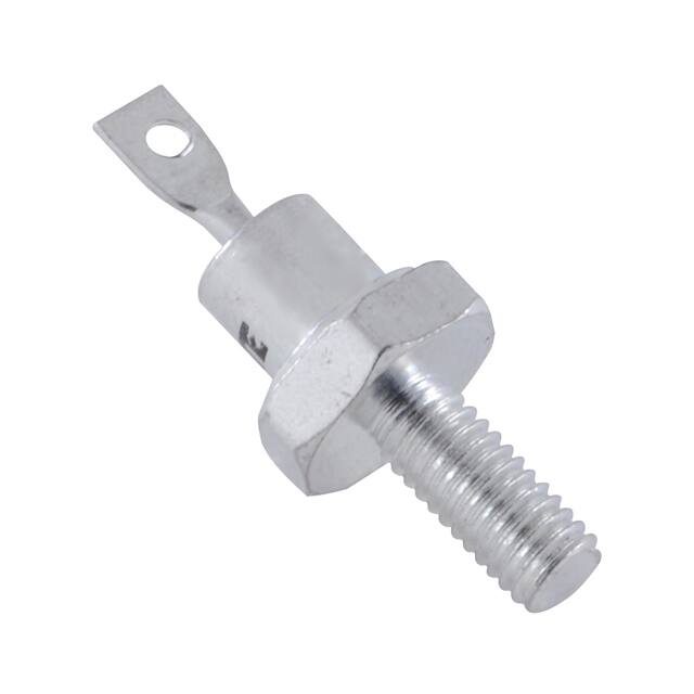

    DIODE ZENER 190V 10W DO4
NTE5231AK 数据手册
NTE5174A thru NTE5232A Zener Diode, 10 Watt 5% Tolerance Features: D Zener Voltage 3.9V to 200V D Also Available in Reverse Polarity (NTE5174AK thru NTE5232AK) D DO4 Stud Mount Package Absolute Maximum Ratings: Forward Voltage (IF = 2A), VF . . . . . . . . . . . . . . . . . . . . . . . . . . . . . . . . . . . . . . . . . . . . . . . . . . . . . . . 1.5V DC Power Dissipation, PD . . . . . . . . . . . . . . . . . . . . . . . . . . . . . . . . . . . . . . . . . . . . . . . . . . . . . . . . . . 10W Derate Above 50C . . . . . . . . . . . . . . . . . . . . . . . . . . . . . . . . . . . . . . . . . . . . . . . . . . . . . . 80mW/C Operating Junction Temperature Range, Topr . . . . . . . . . . . . . . . . . . . . . . . . . . . . . . . . . −65 to +175C Storage Temperature Range, Tstg . . . . . . . . . . . . . . . . . . . . . . . . . . . . . . . . . . . . . . . . . . −65 to +175C Electrical Characteristics: (TC = +30C, unless otherwise specified) Maximum Dynamic Impedance (Note 3) Zzk @ 1mA (Izk) Maximum DC Zener Current* (Izm) (Note 4) Typical Temperature Coefficient vz Ohms mA %/C 2.0 400 2380 580 1.5 400 4.7 530 1.2 NTE5177A 5.1 490 NTE5178A 5.6 NTE5179A Nominal Zener Voltage Vz @ Izt (Note 2) Zener Test Current (Izt) Zzt @ Izt Volts mA Ohms NTE5174A 3.9 640 NTE5175A 4.3 NTE5176A NTE Type Number (Note 1) Maximum Leakage Current IR @ VR A Volts −.046 100 0.5 2130 −.033 100 0.5 500 1940 −.015 50 1.0 1.1 550 1780 .010 10 1.0 445 1.0 600 1620 +.030 10 1.0 6.0 425 1.0 675 1540 +.035 10 1.5 NTE5180A 6.2 405 1.1 750 1460 +.049 10 2.0 NTE5181A 6.8 370 1.2 500 1330 +.040 10 2.0 NTE5182A 7.5 335 1.3 250 1180 .045 100 5.7 NTE5183A 8.2 305 1.5 250 1040 .048 50 6.2 * Stud Temperature = +75C Rev. 9−20 Electrical Characteristics (Cont’d): (TC = +30C, unless otherwise specified) Maximum Dynamic Impedance (Note 3) Zzk @ 1mA (Izk) Maximum DC Zener Current* (Izm) (Note 4) Typical Temperature Coefficient vz Ohms mA %/C 1.7 250 1000 275 2 250 Nominal Zener Voltage Vz @ Izt (Note 2) Zener Test Current (Izt) Zzt @ Izt Volts mA Ohms NTE5184A 8.7 290 NTE5185A 9.1 NTE Type Number (Note 1) Maximum Leakage Current IR @ VR A Volts .049 37 6.6 720 .051 25 6.9 NTE5186A 10 250 3 250 860 .055 25 7.6 NTE5187A 11 230 3 250 780 .060 10 8.4 NTE5188A 12 210 3 250 720 .065 10 9.1 NTE5189A 13 190 3 250 660 .065 10 9.9 NTE5190A 14 180 3 250 600 .070 10 10.5 NTE5191A 15 170 3 250 560 .070 10 11.4 NTE5192A 16 155 4 250 530 .070 10 12.2 NTE5193A 17 145 4 250 500 .075 10 13.0 NTE5194A 18 140 4 250 460 .075 10 13.7 NTE5195A 19 130 4 250 440 .075 10 14.0 NTE5196A 20 125 4 250 420 .075 10 15.2 NTE5197A 22 115 5 250 380 .080 10 16.7 NTE5198A 24 105 5 250 350 .080 10 18.2 NTE5199A 25 100 6 250 310 .080 10 18.2 NTE5200A 27 95 7 250 300 .085 10 20.6 NTE5201A 28 90 7.5 275 290 .085 10 21.7 NTE5202A 30 85 8 300 280 .085 10 22.8 NTE5203A 33 75 9 300 260 .085 10 25.1 NTE5204A 36 70 10 300 230 .085 10 27.4 NTE5205A 39 65 11 300 210 .090 10 29.7 NTE5206A 43 60 12 400 195 .090 10 32.7 NTE5207A 45 55 13 400 185 .090 10 33.0 NTE5208A 47 55 14 400 175 .090 10 35.8 NTE5209A 50 50 15 500 165 .090 10 36.0 NTE5210A 51 50 15 500 160 .090 10 38.8 NTE5211A 52 50 15 500 160 .090 10 39.0 NTE5212A 56 45 16 500 150 .090 10 42.6 NTE5213A 60 43 16 550 140 .090 10 44.8 NTE5214A 62 40 17 600 130 .090 10 47.1 * Stud Temperature = +75C Electrical Characteristics (Cont’d): (TC = +30C, unless otherwise specified) Maximum Dynamic Impedance (Note 3) Zzk @ 1mA (Izk) Maximum DC Zener Current* (Izm) (Note 4) Typical Temperature Coefficient vz Ohms Ohms mA %/C 37 18 600 120 75 33 22 600 NTE5217A 82 30 25 NTE5218A 87 29 NTE5219A 91 NTE5220A Nominal Zener Voltage Vz @ Izt (Note 2) Zener Test Current (Izt) Zzt @ Izt Volts mA NTE5215A 68 NTE5216A NTE Type Number (Note 1) Maximum Leakage Current IR @ VR A Volts .090 10 51.7 110 .090 10 56.0 700 100 .090 10 62.2 30 750 93 .090 10 65.7 28 35 800 85 .090 10 69.2 100 25 40 900 80 .090 10 76.0 NTE5221A 105 25 45 1000 75 .095 10 76.0 NTE5222A 110 23 55 1100 72 .095 10 83.6 NTE5223A 120 20 75 1200 67 .095 10 91.2 NTE5224A 130 19 100 1300 62 .095 10 98.8 NTE5225A 140 18 125 1400 58 .095 10 100.0 NTE5226A 150 17 175 1500 54 .095 10 114.0 NTE5227A 160 16 200 1600 50 .095 10 121.6 NTE5228A 170 15 225 1675 48 .095 10 128.3 NTE5229A 175 14 250 1750 46 .095 10 135.0 NTE5230A 180 14 260 1850 45 .095 10 136.8 NTE5231A 190 13 280 1925 43 .097 10 144.4 NTE5232A 200 12 300 2000 40 .100 10 152.0 * Stud Temperature = +75C Note 1. The NTE type 10W Zener Diodes listed have Anode (Standard Polarity) connected to stud. Add suffix letter “K” to the device number for Cathode (Reverse Polarity) connected to stud (i. e. NTE5174AK). Note 2. The electrical characteristics are measured after allowing the device to stabilize for 90 seconds with +30C base temperature. Note 3. The zener impedance (Zzt) is derived from the 60Hz AC voltage, which results when an AC current having an RMS value equal to 10% of the DC zener current (IZT or IZK) is superimposed on IZT or IZK. When making zener impedance measurements at the IZK test point, it may be necessary to insert a 60Hz band pass filter between the diode and voltmeter to avoid errors resulting from low level noise signals. Note 4. These values of IZM may be exceeded in the case of individual diodes. The values shown are calculated for the worst case which is a unit of 5% tolerance at the high voltage and of its tolerance range. Allowance has also been made for the rise in zener voltage above VZT, which results from zener impedance and the increase in junction temperature as power dissipation approaches 10 watts. .437 (11.1) .250 (6.35) .175 (4.45) .060 (1.52) Dia Min 10−32 NF−2A .405 (10.3) .424 (10.8) Dia. 1.250 (31.75) .453 (11.5)
NTE5231AK
1. 物料型号:NTE5174A至NTE5232A,包括反向极性版本(型号后加"K")。 2. 器件简介:这些是10瓦特的稳压二极管,具有±5%的容差,并且有DO4螺柱安装封装。 3. 引脚分配:阳极(标准极性)连接到螺柱,如果需要阴极连接到螺柱,型号后加"K"。 4. 参数特性: - 绝对最大额定值包括2A的正向电压、10W的直流功率耗散、-65°C至+175°C的工作结温范围和存储温度范围。 - 电气特性在+30°C下测量,包括名义稳压电压、稳压测试电流、最大动态阻抗、最大直流稳压电流、典型温度系数、最大漏电流等。 5. 功能详解:文档提供了详细的电气特性表,列出了不同型号的稳压二极管的稳压电压、测试电流、动态阻抗、直流稳压电流、温度系数和漏电流等参数。 6. 应用信息:虽然文档没有直接提供应用信息,但稳压二极管通常用于电路中稳定电压,防止电压波动。 7. 封装信息:封装类型为DO4螺柱安装封装,文档还提供了封装的尺寸信息。
