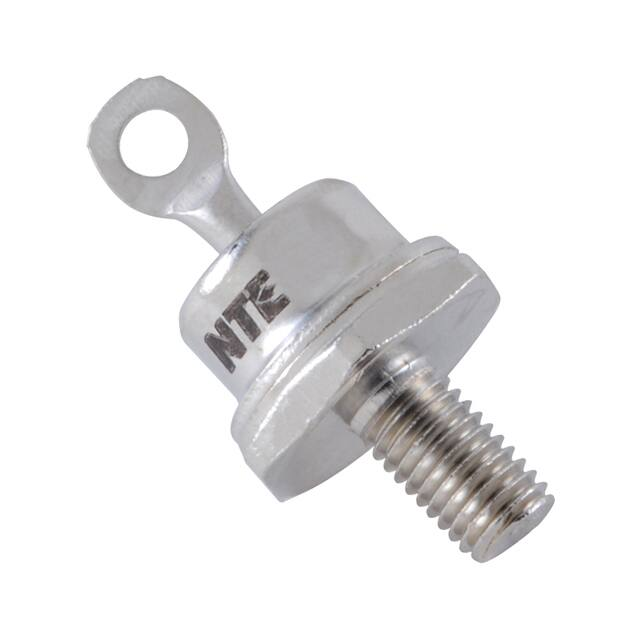

    DIODE ZENER 50V 50W DO5
NTE5275A 数据手册
NTE5240A thru NTE5296A 50 Watt Zener Diodes 5% Tolerance Features: D Zener Voltage 3.9 to 200V D Low Zener Impedance D Highly Reliable and Rugged D Also Available in Reverse Polarity (NTE5240AK thru NTE5296AK) Maximum Ratings: Operating Junction Temperature Range, Topr . . . . . . . . . . . . . . . . . . . . . . . . . . . . . . . . . −65 to +175C Storage Temperature Range, Tstg . . . . . . . . . . . . . . . . . . . . . . . . . . . . . . . . . . . . . . . . . . −65 to +175C DC Power Dissipation, PD . . . . . . . . . . . . . . . . . . . . . . . . . . . . . . . . . . . . . . . . . . . . . . . . . . . . . . . . . . 50W Derate Above 75C . . . . . . . . . . . . . . . . . . . . . . . . . . . . . . . . . . . . . . . . . . . . . . . . . . . . . . . 0.5W/C Forward Voltage (IF = 10A), VF . . . . . . . . . . . . . . . . . . . . . . . . . . . . . . . . . . . . . . . . . . . . . . . . . . . . . . 1.5V Note 1. Suffix “A” denotes anode to case polarity, “AK” denotes cathode to case. Electrical Characteristics: (TC = +30C, unless otherwise specified) Maximum Dynamic Impedance (Note 3) Nominal Zener Voltage Vz @ Izt (Note 2) Zener Test Current (Izt) Zzk @ 1mA (Izk) Maximum DC Zener Current (Izm) Typical Temperature Coefficient vz Zzt @ Izt Volts mA Ohms Ohms mA %/C A Volts NTE5240A 3.9 3200 0.16 400 11900 −0.046 150 0.5 NTE5241A 4.3 2900 0.16 500 10650 −0.033 150 0.5 NTE5242A 4.7 2650 0.12 600 9700 −0.015 100 1.0 NTE5243A 5.1 2450 0.12 650 8900 0.010 20 1.0 NTE5244A 5.6 2250 0.12 900 8100 +0.030 29 1.0 NTE5245A 6.0 2125 0.13 950 7700 +0.040 20 1.5 NTE5246A 6.2 2000 0.14 1000 7300 +0.049 20 2.0 NTE5247A 6.8 1850 0.20 70 6600 0.040 300 4.5 NTE5248A 7.5 1700 0.30 70 5900 0.045 125 5.0 NTE5249A 8.2 1500 0.40 70 5200 0.048 50 5.4 NTE Type Number Maximum Leakage Current IR @ VR Rev. 9−20 Electrical Characteristics (Cont’d): (TC = +30C, unless otherwise specified) Maximum Dynamic Impedance (Note 3) Nominal Zener Voltage Vz @ Izt (Note 2) Zener Test Current (Izt) Zzk @ 1mA (Izk) Maximum DC Zener Current (Izm) Typical Temperature Coefficient vz Zzt @ Izt Volts mA Ohms Ohms mA %/C NTE5250A 8.7 1435 0.45 70 5000 NTE5251A 9.1 1370 0.50 70 NTE5252A 10.0 1200 0.60 NTE5253A 11.0 1100 NTE5254A 12.0 NTE5255A NTE Type Number Maximum Leakage Current IR @ VR A Volts 0.049 37 5.7 4800 0.050 25 6.1 80 4300 0.055 25 6.7 0.80 80 3900 0.060 10 8.4 1000 1.00 80 3800 0.065 10 9.1 13.0 960 1.10 80 3300 0.065 10 9.9 NTE5256A 14.0 890 1.20 80 3000 0.070 10 11.4 NTE5257A 15.0 835 1.40 80 2825 0.070 10 11.8 NTE5258A 16.0 780 1.60 80 2650 0.070 10 12.2 NTE5259A 17.0 740 1.80 80 2500 0.075 10 13.0 NTE5260A 18.0 700 2.00 80 2300 0.075 10 13.7 NTE5261A 19.0 660 2.20 80 2200 0.075 10 13.7 NTE5262A 20.0 630 2.40 80 2100 0.075 10 15.2 NTE5263A 22.0 570 2.50 80 1900 0.080 10 16.7 NTE5264A 24.0 520 2.60 80 1750 0.080 10 18.2 NTE5265A 25.0 500 2.70 90 1550 0.080 10 18.2 NTE5266A 27.0 460 2.80 90 1500 0.085 10 20.6 NTE5267A 28.0 440 2.90 90 1450 0.085 10 21.7 NTE5268A 30.0 420 3.00 90 1400 0.085 10 22.8 NTE5269A 33.0 380 3.20 90 1300 0.085 10 25.1 NTE5270A 36.0 350 3.50 90 1150 0.085 10 27.4 NTE5271A 39.0 320 4.00 90 1050 0.090 10 29.7 NTE5272A 43.0 290 4.50 90 975 0.090 10 32.7 NTE5273A 45.0 280 4.50 100 930 0.090 10 32.7 NTE5274A 47.0 270 5.00 100 880 0.090 10 35.8 NTE5275A 50.0 250 5.00 100 830 0.090 10 38.8 NTE5276A 51.0 245 5.20 100 810 0.090 10 38.8 NTE5277A 52.0 240 5.50 100 790 0.090 10 42.6 NTE5278A 56.0 220 6.00 110 740 0.090 10 42.6 NTE5279A 60.0 210 6.50 115 700 0.090 10 44.8 NTE5280A 62.0 200 7.00 120 660 0.090 10 47.1 NTE5281A 68.0 180 8.00 140 600 0.090 10 51.7 Electrical Characteristics (Cont’d): (TC = +30C, unless otherwise specified) Maximum Dynamic Impedance (Note 3) Nominal Zener Voltage Vz @ Izt (Note 2) Zener Test Current (Izt) Zzk @ 1mA (Izk) Maximum DC Zener Current (Izm) Typical Temperature Coefficient vz Zzt @ Izt Volts mA Ohms Ohms mA %/C NTE5282A 75.0 170 9.00 150 540 NTE5283A 82.0 150 11.00 160 NTE5284A 91.0 140 15.00 NTE5285A 100.0 120 NTE5286A 105.0 NTE5287A NTE Type Number Maximum Leakage Current IR @ VR A Volts 0.090 10 56.0 490 0.090 10 62.2 180 420 0.090 10 69.2 20.00 200 400 0.090 10 76.0 120 25.00 210 380 0.095 10 83.0 110.0 110 30.00 220 365 0.095 10 83.0 NTE5288A 120.0 100 40.00 240 335 0.095 10 91.2 NTE5289A 130.0 95 50.00 275 310 0.095 10 99.8 NTE5290A 140.0 90 60.00 325 290 0.095 10 114.0 NTE5291A 150.0 85 75.00 400 270 0.095 10 114.0 NTE5292A 160.0 80 80.00 450 250 0.095 10 121.6 NTE5293A 175.0 70 85.00 500 230 0.095 10 121.6 NTE5294A 180.0 68 90.00 525 220 0.095 10 136.8 NTE5295A 190.0 66 95.00 561 210 0.098 10 144.4 NTE5296A 200.0 65 100.00 600 200 0.100 10 152.0 Note 2. Zener Voltage (Vz) is measured with junction in thermal equilibrium with 30C stud temperature. Note 3.The zener impedance is derived from the 60 cycle A.C. voltage, which results when an AC current having an RMS value equal to 10% of the DC zener current (IZT or IZK) is superimposed on IZT or IZK. Zener impedance is measured at 2 points to insure a sharp knee on the breakdown curve and to eliminate unstable units. .687 (17.4) .667 (16.9) Dia .375 (9.55) 1.440 (36.58) .450 (11.4) .453 (11.5) .150 (3.81) Dia .200 (5.08) 1/4−28 UNF−2A
