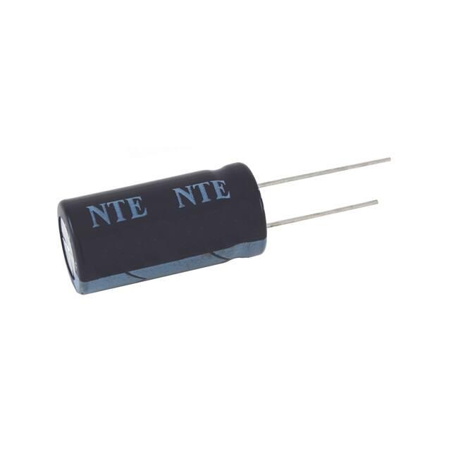

105°C ALUMINUM ELECTROLYTIC VHT SERIES SUBMINIATURE (Radial Lead, 105°C Max) The NTE VHT series of aluminum electrolytic capacitors are designed for use in automotive, commercial, and industrial applications. These high temperature, radial lead capacitors are especially suitable for applications that require extended life and higher temperature operation. MECHANICAL SPECIFICATIONS Lead Solderability: Meets the requirements of MIL–STD 202, Method 208 Marking: Consists of series type, nominal capacitance, rated voltage, temperature range, anode and/or cathode identification, vendor identification. Recommended Cleaning Solvents: Methanol, isopropanol ethanol, isobutanol, petroleum ether, propanol and/or commercial detergents. Halogenated hydrocarbon cleaning agents such as Freon (MF, TF, or TC), trichloroethylene, trichloroethane, or methylchloride are not recommended as they may damage the capacitor. RATINGS Capacitance Range: 0.1µf to 4700µf Tolerance: ±20% Voltage Range: 16 to 250 Volts PERFORMANCE SPECIFICATIONS Operating Temperature Range: –40°C to +105°C (–40°F to +220.9°F) Leakage Current: 6.3V to 100V: ≤ 0.01CV (+3µA) 160V to 250V: ≤ 0.03CV (+15µA) Capacitance Tolerance: ±20% (M) measured at +20°C (+68°F), 120HZ High Temperature Load Test: 1000 Hrs @ +105°C (+220.9°F) and rated voltage Ripple Current: The ripple current multipliers (See Table) adjust the current to make the capacitors operating temperature the same for different ambient temperatures and ripple frequencies. Temperature Multiplier 45°C 1.5 55°C 1.46 65°C 1.32 75°C 1.17 85°C 1.0 95°C 0.79 105°C 0.5 CASE SIZE AND DIMENSIONS: Insulating Sleeve 18.0 Min dØ A ±0.5 L L’ 5.0 Min L’ = L + 1.0 Max at D Ø ≤ 8.0 DØ D’ Ø L’ = L + 2.0 Max at D Ø ≥ 10.0 D’ Ø = D Ø + 0.5 Max ORDERING INFORMATION VHT Series Capacitance Tolerance Voltage 10 M 25 Load Life: 1000 Hrs @ +105°C (+220.9°F), no voltage applied Shelf Life: 1000 Hrs @ +105°C (+220.9°F), no voltage applied 10 NTE Electronics, Inc. D Voice (800) 631–1250 (973) 748–5089 D FAX (973) 748–6224 D http://www.nteinc.com 105°C ALUMINUM ELECTROLYTIC VHT SERIES VHT Series Dimensions: Diameter (D Ø) x Length (L): mm WV Cap (µf) 0.1 0.22 0.33 0.47 1.0 2.2 3.3 4.7 10 22 33 47 100 220 330 470 1000 2200 3300 4700 5 x 11 5 x 11 5 x 11 6 x 11 8 x 11.5 10 x 12.5 10 x 16 10 x 20 13 x 25 16 x 25 16 x 31.5 18 x 31.5 5 x 11 5 x 11 5 x 11 6 x 11 6 x 11 8 x 11.5 10 x 16 10 x 20 13 x 20 16 x 25 16 x 31.5 18 x 31.5 5 x 11 5 x 11 6 x 11 6 x 11 8 x 11.5 10 x 12.5 10 x 20 13 x 20 13 x 25 16 x 25 18 x 31.5 16 25 35 50 5 x 11 5 x 11 5 x 11 5 x 11 5 x 11 5 x 11 5 x 11 5 x 11 5 x 11 6 x 11 8 x 11.5 8 x 11.5 10 x 16 13 x 20 13 x 20 16 x 25 16 x 25 5 x 11 5 x 11 5 x 11 5 x 11 5 x 11 6 x 11 8 x 11.5 8 x 11.5 10 x 12.5 10 x 20 13 x 20 13 x 25 16 x 25 18 x 31.5 6 x 11 6 x 11 8 x 11.5 8 x 11.5 10 x 12.5 10 x 20 13 x 21 13 x 25 16 x 25 6 x 11 8 x 11.5 10 x 12.5 10 x 12.5 10 x 20 13 x 25 13 x 25 16 x 25 18 x 36 63 160 250 * These dimensions are for reference only, please consult the factory for actual size. VHT Mechanical Specs: Dimensions (mm) Outside Diameter Lead Spacing Lead Wire DØ A dØ 5.0 2.0 6.0 2.5 0.5 8.0 3.5 10.0 5.0 0.6 0.65 13.0 16.0 7.5 0.8 18.0 * These dimensions are for reference only, please consult the factory for actual size. NTE Electronics, Inc. D Voice (800) 631–1250 (973) 748–5089 D FAX (973) 748–6224 D http://www.nteinc.com 11
