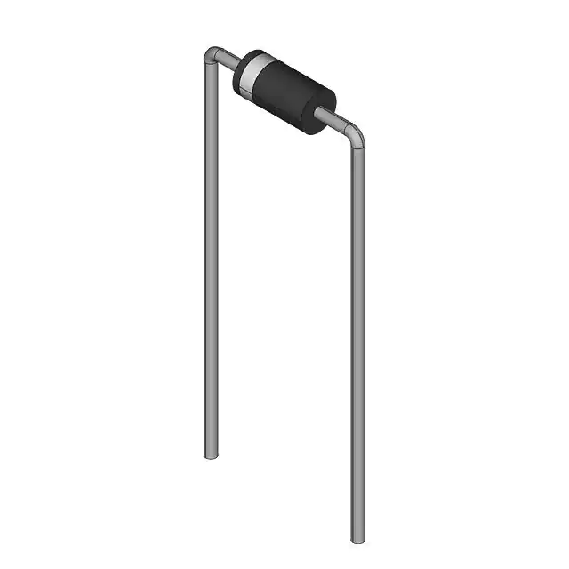

1N4728A to 1N4749A Voltage regulator diodes Rev. 02 — 30 October 2009 Product data sheet 1. Product profile 1.1 General description Low voltage regulator diodes in hermetically sealed small SOD66 (DO-41) glass packages. The series consists of 22 types with nominal working voltages from 3.3 to 24 V. 1.2 Features n Total power dissipation: max. ≤ 1000 mW n Working voltage range: nom. 3.3 V to 24 V n Tolerance series: ±5 % n Small hermetically sealed glass package 1.3 Applications n Low voltage stabilizers 1.4 Quick reference data Table 1. Quick reference data Symbol Parameter Conditions Min Typ Max Unit VF forward voltage IF = 200 mA - - 1.2 V Ptot total power dissipation - - 1000 mW 2. Pinning information Table 2. Pin Pinning Description 1 cathode 2 anode Simplified outline Graphic symbol [1] k a 1 2 006aaa152 [1] The marking band indicates the cathode. 1N4728A to 1N4749A Nexperia Voltage regulator diodes 3. Ordering information Table 3. Ordering information Type number 1N4728A to 1N4749A[1] [1] Package Name Description Version - hermetically sealed glass package; axial leaded; 2 leads SOD66 The series consists of 22 types with nominal working voltages from 3.3 V to 24 V. 4. Marking Table 4. Marking codes Type number Marking code 1N4728A to 1N4749A The diodes are type branded. 5. Limiting values Table 5. Limiting values In accordance with the Absolute Maximum Rating System (IEC 60134). Symbol Parameter IF Conditions Min Max Unit forward current - 500 mA IZ working current - see Table 8 IZSM non-repetitive peak reverse current - see Table 8 Ptot total power dissipation - 1000 mW Tj junction temperature −65 +200 °C Tstg storage temperature −65 +200 °C Tamb = 50 °C 1N4728A_SER Product data sheet © Nexperia B.V. 2009. All rights reserved. Rev. 02 — 30 October 2009 2 of 10 1N4728A to 1N4749A Nexperia Voltage regulator diodes 6. Thermal characteristics Table 6. Thermal characteristics Symbol Parameter Conditions Min Typ Max Unit Rth(j-t) thermal resistance from junction to tie-point lead length 4 mm - - 110 K/W 006aab843 103 Rth(j-t) (K/W) δ=1 0.75 0.50 0.33 102 0.20 0.10 0.05 10 0.02 0.01 0 1 10−1 Fig 1. 1 10 102 103 104 tp (ms) 105 Thermal resistance from junction to tie-point as a function of pulse duration; lead length 4 mm 7. Characteristics Table 7. Characteristics Tj = 25 °C unless otherwise specified. Symbol Parameter Conditions Min Typ Max Unit VF forward voltage IF = 200 mA - - 1.2 V 1N4728A_SER Product data sheet © Nexperia B.V. 2009. All rights reserved. Rev. 02 — 30 October 2009 3 of 10 1N4728A to 1N4749A Nexperia Voltage regulator diodes Table 8. Characteristics per type Tj = 25 °C unless otherwise specified. Type number Working voltage VZ (V)[1] at Itest Test current Itest (mA) Nom Differential resistance Reverse current IR (µA) rdif (Ω) at Itest at IZ Working current IZ (mA) Non-repetitive peak reverse current IZSM (mA)[2] IZ (mA) Max Max Max VR (V) Max Max 1N4728A 3.3 76 10 400 1 100 1 276 1380 1N4729A 3.6 69 10 400 1 100 1 252 1260 1N4730A 3.9 64 9 400 1 50 1 234 1190 1N4731A 4.3 58 9 400 1 10 1 217 1070 1N4732A 4.7 53 8 500 1 10 1 193 970 1N4733A 5.1 49 7 550 1 10 1 178 890 1N4734A 5.6 45 5 600 1 10 2 162 810 1N4735A 6.2 41 2 700 1 10 3 146 730 1N4736A 6.8 37 3.5 700 1 10 4 133 660 1N4737A 7.5 34 4 700 0.5 10 5 121 605 1N4738A 8.2 31 4.5 700 0.5 10 6 110 550 1N4739A 9.1 28 5 700 0.5 10 7 100 500 1N4740A 10 25 7 700 0.25 10 7.6 91 454 1N4741A 11 23 8 700 0.25 5 8.4 83 414 1N4742A 12 21 9 700 0.25 5 9.1 76 380 1N4743A 13 19 10 700 0.25 5 9.9 69 344 1N4744A 15 17 14 700 0.25 5 11.4 61 304 1N4745A 16 15.5 16 700 0.25 5 12.2 57 285 1N4746A 18 14 20 750 0.25 5 13.7 50 250 1N4747A 20 12.5 22 750 0.25 5 15.2 45 225 1N4748A 22 11.5 23 750 0.25 5 16.7 41 205 1N4749A 24 10.5 25 750 0.25 5 18.2 38 190 [1] VZ is measured with device at thermal equilibrium while held in clips at 10 mm from body in still air at 25 °C. [2] Half square wave or equivalent sine wave pulse 1/120 second duration superimposed on Itest. 1N4728A_SER Product data sheet © Nexperia B.V. 2009. All rights reserved. Rev. 02 — 30 October 2009 4 of 10 1N4728A to 1N4749A Nexperia Voltage regulator diodes mbg925 300 IF (mA) 200 (1) (2) 100 0 0 0.5 VF (V) 1.0 (1) Tj = 200 °C (2) Tj = 25 °C Fig 2. Forward current as a function of forward voltage; typical values 1N4728A_SER Product data sheet © Nexperia B.V. 2009. All rights reserved. Rev. 02 — 30 October 2009 5 of 10 1N4728A to 1N4749A Nexperia Voltage regulator diodes 8. Package outline Hermetically sealed glass package; axial leaded; 2 leads SOD66 (1) k a b D G1 L L Dimensions Unit b max 0.81 nom min mm D G1 2.6 4.8 L 0 25.4 2 4 mm scale Note 1. The marking band indicates the cathode. Outline version SOD66 Fig 3. sod066_po References IEC JEDEC JEITA European projection Issue date 97-06-20 09-10-09 DO-41 Package outline SOD66 (DO-41) 1N4728A_SER Product data sheet © Nexperia B.V. 2009. All rights reserved. Rev. 02 — 30 October 2009 6 of 10 1N4728A to 1N4749A Nexperia Voltage regulator diodes 9. Packing information Please refer to packing information on www.nexperia.com. 1N4728A_SER Product data sheet © Nexperia B.V. 2009. All rights reserved. Rev. 02 — 30 October 2009 7 of 10 1N4728A to 1N4749A Nexperia Voltage regulator diodes 10. Revision history Table 10. Revision history Document ID Release date Data sheet status Change notice Supersedes 1N4728A_SER_2 20091030 Product data sheet - 1N4728A_1 Modifications: 1N4728A_1 • The format of this data sheet has been redesigned to comply with the new identity guidelines of NXP Semiconductors. • • • • • • Legal texts have been adapted to the new company name where appropriate. Table 5 “Limiting values”: IZM redefined to IZ working current Table 6: Rth(j-tp) redefined to Rth(j-t) thermal resistance from junction to tie-point Figure 1: Rth(j-tp) redefined to Rth(j-t) thermal resistance from junction to tie-point Table 8 “Characteristics per type”: IZtest redefined to Itest test current Figure 3 “Package outline SOD66 (DO-41)”: updated 19960426 Product data sheet - © Nexperia B.V. 2009. All rights reserved. 1N4728A_SER Product data sheet - Rev. 02 — 30 October 2009 8 of 10 1N4728A to 1N4749A Nexperia Voltage regulator diodes 11. Legal information 11.1 Data sheet status Document status[1][2] Product status[3] Definition Objective [short] data sheet Development This document contains data from the objective specification for product development. Preliminary [short] data sheet Qualification This document contains data from the preliminary specification. Product [short] data sheet Production This document contains the product specification. [1] Please consult the most recently issued document before initiating or completing a design. [2] The term ‘short data sheet’ is explained in section “Definitions”. [3] The product status of device(s) described in this document may have changed since this document was published and may differ in case of multiple devices. The latest product status information is available on the Internet at URL http://www.nexperia.com. 11.2 Definitions Draft — The document is a draft version only. The content is still under internal review and subject to formal approval, which may result in modifications or additions. Nexperia does not give any representations or warranties as to the accuracy or completeness of information included herein and shall have no liability for the consequences of use of such information. Short data sheet — A short data sheet is an extract from a full data sheet with the same product type number(s) and title. A short data sheet is intended for quick reference only and should not be relied upon to contain detailed and full information. For detailed and full information see the relevant full data sheet, which is available on request via the local Nexperia sales office. In case of any inconsistency or conflict with the short data sheet, the full data sheet shall prevail. 11.3 Disclaimers General — Information in this document is believed to be accurate and reliable. However, Nexperia does not give any representations or warranties, expressed or implied, as to the accuracy or completeness of such information and shall have no liability for the consequences of use of such information. Right to make changes — Nexperia reserves the right to make changes to information published in this document, including without limitation specifications and product descriptions, at any time and without notice. This document supersedes and replaces all information supplied prior to the publication hereof. Suitability for use — Nexperia products are not designed, authorized or warranted to be suitable for use in medical, military, aircraft, space or life support equipment, nor in applications where failure or malfunction of an Nexperia product can reasonably be expected to result in personal injury, death or severe property or environmental damage. Nexperia accepts no liability for inclusion and/or use of Nexperia products in such equipment or applications and therefore such inclusion and/ or use is at the customer’s own risk. Applications — Applications that are described herein for any of these products are for illustrative purposes only. Nexperia makes no representation or warranty that such applications will be suitable for the specified use without further testing or modification. Limiting values — Stress above one or more limiting values (as defined in the Absolute Maximum Ratings System of IEC 60134) may cause permanent damage to the device. Limiting values are stress ratings only and operation of the device at these or any other conditions above those given in the Characteristics sections of this document is not implied. Exposure to limiting values for extended periods may affect device reliability. Terms and conditions of sale — Nexperia products are sold subject to the general terms and conditions of commercial sale, as published at http:// www.nexperia.com/profile/terms, including those pertaining to warranty, intellectual property rights infringement and limitation of liability, unless explicitly otherwise agreed to in writing by Nexperia. In case of any inconsistency or conflict between information in this document and such terms and conditions, the latter will prevail. No offer to sell or license — Nothing in this document may be interpreted or construed as an offer to sell products that is open for acceptance or the grant, conveyance or implication of any license under any copyrights, patents or other industrial or intellectual property rights. Export control — This document as well as the item(s) described herein may be subject to export control regulations. Export might require a prior authorization from national authorities. Quick reference data — The Quick reference data is an extract of the product data given in the Limiting values and Characteristics sections of this document, and as such is not complete, exhaustive or legally binding. 11.4 Trademarks Notice: All referenced brands, product names, service names and trademarks are the property of their respective owners. 1N4728A_SER Product data sheet © Nexperia B.V. 2009. All rights reserved. Rev. 02 — 30 October 2009 9 of 10 1N4728A to 1N4749A Nexperia Voltage regulator diodes 12. Contents 1 1.1 1.2 1.3 1.4 2 3 4 5 6 7 8 9 10 11 11.1 11.2 11.3 11.4 12 Product profile . . . . . . . . . . . . . . . . . . . . . . . . . . General description. . . . . . . . . . . . . . . . . . . . . . Features . . . . . . . . . . . . . . . . . . . . . . . . . . . . . . Applications . . . . . . . . . . . . . . . . . . . . . . . . . . . Quick reference data. . . . . . . . . . . . . . . . . . . . . Pinning information . . . . . . . . . . . . . . . . . . . . . . Ordering information . . . . . . . . . . . . . . . . . . . . . Marking . . . . . . . . . . . . . . . . . . . . . . . . . . . . . . . . Limiting values. . . . . . . . . . . . . . . . . . . . . . . . . . Thermal characteristics. . . . . . . . . . . . . . . . . . . Characteristics . . . . . . . . . . . . . . . . . . . . . . . . . . Package outline . . . . . . . . . . . . . . . . . . . . . . . . . Packing information. . . . . . . . . . . . . . . . . . . . . . Revision history . . . . . . . . . . . . . . . . . . . . . . . . . Legal information. . . . . . . . . . . . . . . . . . . . . . . . Data sheet status . . . . . . . . . . . . . . . . . . . . . . . Definitions . . . . . . . . . . . . . . . . . . . . . . . . . . . . . Disclaimers . . . . . . . . . . . . . . . . . . . . . . . . . . . . Trademarks . . . . . . . . . . . . . . . . . . . . . . . . . . . . 1 1 1 1 1 1 2 2 2 3 3 6 7 8 9 9 9 9 9 Contents . . . . . . . . . . . . . . . . . . . . . . . . . . . . . . 10 Please be aware that important notices concerning this document and the product(s) described herein, have been included in section ‘Legal information’. © Nexperia B.V. 2009. All rights reserved. For more information, please visit: http://www.Nexperia.com For sales office addresses, please send an email to: salesaddresses@nexperia.com Date of release: 30 October 2009 Document identifier: 1N4728A_SER
1N4738A,133
物料型号:1N4728A至1N4749A
器件简介:这是一系列低电压调节二极管,采用密封的小SOD66(DO-41)玻璃封装。共有22种型号,标称工作电压从3.3V至24V。
引脚分配:文档中提供了简化的外形图和图形符号,其中1代表阴极,2代表阳极。标记带表示阴极。
参数特性: - 总功耗:最大 ≤1000 mW - 容差系列:±5% - 工作电压范围:标称3.3V至24V - 小型密封玻璃封装
功能详解: - 这些二极管适用于低电压稳定器。 - 快速参考数据表提供了不同条件下的最小值、典型值和最大值,例如正向电压(VF)和总功耗(Ptot)。
应用信息:适用于低电压稳定器。
封装信息:SOD66封装,轴向引线,2个引脚。文档还提供了封装的尺寸和标记信息。
其他信息: - 限制值:根据IEC 60134的绝对最大额定系统,包括正向电流(IF)、工作电流(lz)、非重复峰值反向电流(IzsM)等。 - 热特性:包括从结到连接点的热阻(Rth(i-t))。 - 特性:包括正向电压(VF)和每种型号的工作电压(Vz)、测试电流(Itest)、差分电阻、反向电流(IR)、工作电流(Iz)和非重复峰值反向电流(Izsm)。
