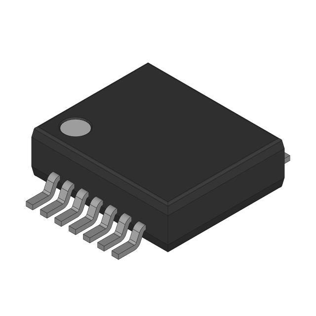

74HC74; 74HCT74 Dual D-type flip-flop with set and reset; positive edge-trigger Rev. 7 — 13 September 2021 Product data sheet 1. General description The 74HC74 and 74HCT74 are dual positive edge triggered D-type flip-flop. They have individual data (nD), clock (nCP), set (nSD) and reset (nRD) inputs, and complementary nQ and nQ outputs. Data at the nD-input, that meets the set-up and hold time requirements on the LOW-to-HIGH clock transition, is stored in the flip-flop and appears at the nQ output. Schmitt-trigger action in the clock input, makes the circuit highly tolerant to slower clock rise and fall times. Inputs include clamp diodes that enable the use of current limiting resistors to interface inputs to voltages in excess of VCC. 2. Features and benefits • • • • • • • • • • • • Wide supply voltage range from 2.0 to 6.0 V CMOS low power dissipation High noise immunity Input levels: • For 74HC74: CMOS level • For 74HCT74: TTL level Symmetrical output impedance High noise immunity Balanced propagation delays Latch-up performance exceeds 100 mA per JESD 78 Class II Level B Complies with JEDEC standards: • JESD8C (2.7 V to 3.6 V) • JESD7A (2.0 V to 6.0 V) ESD protection: • HBM JESD22-A114F exceeds 2000 V • MM JESD22-A115-A exceeds 200 V Multiple package options Specified from -40 °C to +85 °C and from -40 °C to +125 °C 3. Ordering information Table 1. Ordering information Type number Package 74HC74D Temperature range Name Description Version -40 °C to +125 °C SO14 plastic small outline package; 14 leads; body width 3.9 mm SOT108-1 -40 °C to +125 °C TSSOP14 plastic thin shrink small outline package; 14 leads; body width 4.4 mm SOT402-1 -40 °C to +125 °C DHVQFN14 plastic dual in-line compatible thermal enhanced very thin quad flat package; no leads; 14 terminals; body 2.5 × 3 × 0.85 mm SOT762-1 74HCT74D 74HC74PW 74HCT74PW 74HC74BQ 74HCT74BQ 74HC74; 74HCT74 Nexperia Dual D-type flip-flop with set and reset; positive edge-trigger 4. Functional diagram 4 2 3 4 4 10 3 1SD 2SD 2 12 3 11 SD 1Q 1D D Q 2D 2Q 1CP CP 2CP FF 1Q Q 2Q RD 2 1 5 9 10 6 8 11 12 13 1RD 2RD 1 13 Fig. 1. S 5 1 6 10 Logic symbol Fig. 2. 12 S 9 11 C1 1D Q CP FF Q 1Q 1Q 5 6 1RD 2SD 2D 2CP SD D Q CP 8 FF Q 2Q 2Q 9 8 RD R 13 IEC logic symbol Fig. 3. 2RD mna420 Functional diagram Q C C 1CP SD D R mna419 mna418 1D RD C1 1D 1SD C C C C D Q C RD C SD CP mna421 C C Fig. 4. Logic diagram for one flip-flop 74HC_HCT74 Product data sheet All information provided in this document is subject to legal disclaimers. Rev. 7 — 13 September 2021 © Nexperia B.V. 2021. All rights reserved 2 / 17 74HC74; 74HCT74 Nexperia Dual D-type flip-flop with set and reset; positive edge-trigger 5. Pinning information 5.1. Pinning 1RD 1 terminal 1 index area 1D 2 13 2RD 12 2D 1CP 3 1SD 4 11 2CP 1Q 5 10 2SD 1Q 6 9 2Q GND 7 8 2Q Pin configuration for SOT108-1 (SO14) and SOT402-1 (TSSOP14) 1SD 4 11 2CP 1Q 5 10 2SD 1Q 6 GND(1) 9 2Q aaa-003909 Transparent top view (1) This is not a ground pin. There is no electrical or mechanical requirement to solder the pad. In case soldered, the solder land should remain floating or connected to GND. aaa-003908 Fig. 5. 13 2RD 12 2D 8 14 VCC 3 7 1 2 2Q 1RD 1D 1CP GND 74HC74 74HCT74 14 VCC 74HC74 74HCT74 Fig. 6. Pin configuration for SOT762-1 (DHVQFN14) 5.2. Pin description Table 2. Pin description Symbol Pin Description 1RD 1 asynchronous reset-direct input (active LOW) 1D 2 data input 1CP 3 clock input (LOW-to-HIGH, edge-triggered) 1SD 4 asynchronous set-direct input (active LOW) 1Q 5 output 1Q 6 complement output GND 7 ground (0 V) 2Q 8 complement output 2Q 9 output 2SD 10 asynchronous set-direct input (active LOW) 2CP 11 clock input (LOW-to-HIGH, edge-triggered) 2D 12 data input 2RD 13 asynchronous reset-direct input (active LOW) VCC 14 supply voltage 74HC_HCT74 Product data sheet All information provided in this document is subject to legal disclaimers. Rev. 7 — 13 September 2021 © Nexperia B.V. 2021. All rights reserved 3 / 17 74HC74; 74HCT74 Nexperia Dual D-type flip-flop with set and reset; positive edge-trigger 6. Functional description Table 3. Function table H = HIGH voltage level; L = LOW voltage level; X = don’t care. Input Output nSD nRD nCP nD nQ nQ L H X X H L H L X X L H L L X X H H Table 4. Function table H = HIGH voltage level; L = LOW voltage level; X = don’t care; ↑ = LOW-to-HIGH transition; Qn+1 = state after the next LOW-to-HIGH CP transition. Input Output nSD nRD nCP nD nQn+1 nQ n+1 H H ↑ L L H H H ↑ H H L 7. Limiting values Table 5. Limiting values In accordance with the Absolute Maximum Rating System (IEC 60134). Voltages are referenced to GND (ground = 0 V). Symbol Parameter Conditions Min Max Unit -0.5 +7 V VCC supply voltage IIK input clamping current VI < -0.5 V or VI > VCC + 0.5 V - ±20 mA IOK output clamping current VO < -0.5 V or VO > VCC + 0.5 V - ±20 mA IO output current VO = -0.5 V to (VCC + 0.5 V) - ±25 mA ICC supply current - +100 mA IGND ground current -100 - mA Tstg storage temperature -65 +150 °C Ptot total power dissipation - 500 mW [1] [1] For SOT108-1 (SO14) package: Ptot derates linearly with 10.1 mW/K above 100 °C. For SOT402-1 (TSSOP14) package: Ptot derates linearly with 7.3 mW/K above 81 °C. For SOT762-1 (DHVQFN14) package: Ptot derates linearly with 9.6 mW/K above 98 °C. 74HC_HCT74 Product data sheet All information provided in this document is subject to legal disclaimers. Rev. 7 — 13 September 2021 © Nexperia B.V. 2021. All rights reserved 4 / 17 74HC74; 74HCT74 Nexperia Dual D-type flip-flop with set and reset; positive edge-trigger 8. Recommended operating conditions Table 6. Recommended operating conditions Voltages are referenced to GND (ground = 0 V) Symbol Parameter Conditions 74HC74 74HCT74 Unit Min Typ Max Min Typ Max 2.0 5.0 6.0 4.5 5.0 5.5 V VCC supply voltage VI input voltage 0 - VCC 0 - VCC V VO output voltage 0 - VCC 0 - VCC V Tamb ambient temperature -40 +25 +125 -40 +25 +125 °C Δt/ΔV input transition rise and fall rate VCC = 2.0 V - - 625 - - - ns/V VCC = 4.5 V - 1.67 139 - 1.67 139 ns/V VCC = 6.0 V - - 83 - - - ns/V Tamb = -40 °C to +125 °C Unit 9. Static characteristics Table 7. Static characteristics At recommended operating conditions; voltages are referenced to GND (ground = 0 V). Symbol Parameter Conditions Tamb = -40 °C to +85 °C Min Typ [1] Max Min Max VCC = 2.0 V 1.5 1.2 - 1.5 - V VCC = 4.5 V 3.15 2.4 - 3.15 - V VCC = 6.0 V 4.2 3.2 - 4.2 - V VCC = 2.0 V - 0.8 0.5 - 0.5 V VCC = 4.5 V - 2.1 1.35 - 1.35 V VCC = 6.0 V - 2.8 1.8 - 1.8 V VI = VIH or VIL HIGH-level output voltage IO = -4.0 mA; VCC = 4.5 V 3.84 4.32 - 3.7 - V IO = -5.2 mA; VCC = 6.0 V 5.34 5.81 - 5.2 - V VI = VIH or VIL LOW-level output voltage IO = 4.0 mA; VCC = 4.5 V - 0.15 0.33 - 0.4 V IO = 5.2 mA; VCC = 6.0 V - 0.16 0.33 - 0.4 V - - ±1.0 - ±1.0 μA 74HC74 VIH VIL VOH VOL HIGH-level input voltage LOW-level input voltage II input leakage current VI = VCC or GND; VCC = 6.0 V ICC supply current VI = VCC or GND; IO = 0 A; VCC = 6.0 V - - 40 - 80 μA CI input capacitance - 3.5 - - - pF 74HCT74 VIH HIGH-level input voltage VCC = 4.5 V to 5.5 V 2.0 1.6 - 2.0 - V VIL LOW-level input voltage VCC = 4.5 V to 5.5 V - 1.2 0.8 - 0.8 V 74HC_HCT74 Product data sheet All information provided in this document is subject to legal disclaimers. Rev. 7 — 13 September 2021 © Nexperia B.V. 2021. All rights reserved 5 / 17 74HC74; 74HCT74 Nexperia Dual D-type flip-flop with set and reset; positive edge-trigger Symbol Parameter VOH VOL Conditions Tamb = -40 °C to +85 °C Typ [1] Max Min Max VI = VIH or VIL; VCC = 4.5 V HIGH-level output voltage IO = -4 mA 3.84 4.32 - 3.7 - V VI = VIH or VIL; VCC = 4.5 V LOW-level output voltage IO = 4.0 mA - 0.15 0.33 - 0.4 V - - ±1.0 - ±1.0 μA - - 40 - 80 μA per input pin; nD, nRD inputs - 70 315 - 343 μA per input pin; nSD, nCP input - 80 360 - 392 μA - 3.5 - - - pF input leakage current ICC supply current VI = VCC or GND; IO = 0 A; VCC = 5.5 V ΔICC VI = VCC - 2.1 V; additional supply current other inputs at VCC or GND; VCC = 4.5 V to 5.5 V; IO = 0 A [1] Unit Min II CI Tamb = -40 °C to +125 °C VI = VCC or GND; VCC = 5.5 V input capacitance All typical values are measured at Tamb = 25 °C. 10. Dynamic characteristics Table 8. Dynamic characteristics Voltages are referenced to GND (ground = 0 V); CL = 50 pF unless otherwise specified; for test circuit see Fig. 9. Symbol Parameter Conditions Tamb = -40 °C to +85 °C Tamb = -40 °C to +125 °C Unit Min Typ [1] Max Min Max VCC = 2.0 V - 47 220 - 265 ns VCC = 4.5 V - 17 44 - 53 ns VCC = 5 V; CL = 15 pF - 14 - - - ns - 14 37 - 45 ns VCC = 2.0 V - 50 250 - 300 ns VCC = 4.5 V - 18 50 - 60 ns VCC = 5 V; CL = 15 pF - 15 - - - ns - 14 43 - 51 ns VCC = 2.0 V - 52 250 - 300 ns VCC = 4.5 V - 19 50 - 60 ns VCC = 5 V; CL = 15 pF - 16 - - - ns - 15 43 - 51 ns VCC = 2.0 V - 19 95 - 110 ns VCC = 4.5 V - 7 19 - 22 ns VCC = 6.0 V - 6 16 - 19 ns 74HC74 tpd propagation delay nCP to nQ, nQ; see Fig. 7 [2] VCC = 6.0 V nSD to nQ, nQ; see Fig. 8 [2] VCC = 6.0 V nRD to nQ, nQ; see Fig. 8 [2] VCC = 6.0 V tt transition time 74HC_HCT74 Product data sheet nQ, nQ; see Fig. 7 [3] All information provided in this document is subject to legal disclaimers. Rev. 7 — 13 September 2021 © Nexperia B.V. 2021. All rights reserved 6 / 17 74HC74; 74HCT74 Nexperia Dual D-type flip-flop with set and reset; positive edge-trigger Symbol Parameter tW pulse width Conditions Tamb = -40 °C to +85 °C Tamb = -40 °C to +125 °C Unit Min Typ [1] Max Min Max VCC = 2.0 V 100 19 - 120 - ns VCC = 4.5 V 20 7 - 24 - ns VCC = 6.0 V 17 6 - 20 - ns VCC = 2.0 V 100 19 - 120 - ns VCC = 4.5 V 20 7 - 24 - ns VCC = 6.0 V 17 6 - 20 - ns VCC = 2.0 V 40 3 - 45 - ns VCC = 4.5 V 8 1 - 9 - ns VCC = 6.0 V 7 1 - 8 - ns VCC = 2.0 V 75 6 - 90 - ns VCC = 4.5 V 15 2 - 18 - ns VCC = 6.0 V 13 2 - 15 - ns VCC = 2.0 V 3 -6 - 3 - ns VCC = 4.5 V 3 -2 - 3 - ns VCC = 6.0 V 3 -2 - 3 - ns VCC = 2.0 V 4.8 23 - 4.0 - MHz VCC = 4.5 V 24 69 - 20 - MHz - 76 - - - MHz 28 82 - 24 - MHz - 24 - - - pF VCC = 4.5 V - 18 44 - 53 ns VCC = 5 V; CL = 15 pF - 15 - - - ns - 23 50 - 60 ns - 18 - - - ns VCC = 4.5 V - 24 50 - 60 ns VCC = 5 V; CL = 15 pF - 18 - - - ns nCP HIGH or LOW; see Fig. 7 nSD, nRD LOW; see Fig. 8 trec tsu th fmax recovery time set-up time hold time maximum frequency nSD, nRD; see Fig. 8 nD to nCP; see Fig. 7 nD to nCP; see Fig. 7 nCP; see Fig. 7 VCC = 5 V; CL = 15 pF VCC = 6.0 V CPD power dissipation capacitance CL = 50 pF; f = 1 MHz; VI = GND to VCC [4] nCP to nQ, nQ; see Fig. 7 [2] 74HCT74 tpd propagation delay nSD to nQ, nQ; see Fig. 8 [2] VCC = 4.5 V VCC = 5 V; CL = 15 pF nRD to nQ, nQ; see Fig. 8 74HC_HCT74 Product data sheet [2] All information provided in this document is subject to legal disclaimers. Rev. 7 — 13 September 2021 © Nexperia B.V. 2021. All rights reserved 7 / 17 74HC74; 74HCT74 Nexperia Dual D-type flip-flop with set and reset; positive edge-trigger Symbol Parameter tt transition time Conditions Tamb = -40 °C to +85 °C nQ, nQ; see Fig. 7 pulse width Unit Min Typ [1] Max Min Max - 7 19 - 22 ns 23 9 - 27 - ns 20 9 - 24 - ns 8 1 - 9 - ns 15 5 - 18 - ns 3 -3 - 3 - ns 22 54 - 18 - MHz - 59 - - - MHz - 29 - - - pF [3] VCC = 4.5 V tW Tamb = -40 °C to +125 °C nCP HIGH or LOW; see Fig. 7 VCC = 4.5 V nSD, nRD LOW; see Fig. 8 VCC = 4.5 V trec recovery time nSD, nRD; see Fig. 8 VCC = 4.5 V tsu set-up time nD to nCP; see Fig. 7 VCC = 4.5 V th hold time nD to nCP; see Fig. 7 VCC = 4.5 V fmax maximum frequency nCP; see Fig. 7 VCC = 4.5 V VCC = 5 V; CL = 15 pF CPD [1] [2] [3] [4] power dissipation capacitance CL = 50 pF; f = 1 MHz; VI = GND to VCC - 1.5 V [4] All typical values are measured at Tamb = 25 °C. tpd is the same as tPLH and tPHL. tt is the same as tTHL and tTLH. CPD is used to determine the dynamic power dissipation (PD in μW). 2 2 PD = CPD × VCC × fi × N + Σ(CL × VCC × fo) where: fi = input frequency in MHz; fo = output frequency in MHz; CL = output load capacitance in pF; VCC = supply voltage in V; N = number of inputs switching; 2 Σ(CL × VCC × fo) = sum of outputs. 74HC_HCT74 Product data sheet All information provided in this document is subject to legal disclaimers. Rev. 7 — 13 September 2021 © Nexperia B.V. 2021. All rights reserved 8 / 17 74HC74; 74HCT74 Nexperia Dual D-type flip-flop with set and reset; positive edge-trigger 10.1. Waveforms and test circuit VI nD input VM GND th th tsu 1/fmax tsu VI nCP input VM GND tW tPHL tPLH VOH VM nQ output VOL tPLH tPHL VOH nQ output 90 % 90 % VM VOL 10 % 10 % tTLH tTHL aaa-004005 Measurement points are given in Table 9. VOL and VOH are typical voltage output levels that occur with the output load. Fig. 7. Propagation delay input (CP) to output (Qn), output transition time, clock input (CP) pulse width and the maximum frequency (CP) 74HC_HCT74 Product data sheet All information provided in this document is subject to legal disclaimers. Rev. 7 — 13 September 2021 © Nexperia B.V. 2021. All rights reserved 9 / 17 74HC74; 74HCT74 Nexperia Dual D-type flip-flop with set and reset; positive edge-trigger VI VM nCP input GND t rec VI VM nSD input GND tW tW VI VM nRD input GND t PLH t PHL VOH nQ output VM VOL VOH VM nQ output VOL t PHL t PLH mna423 Measurement points are given in Table 9. VOL and VOH are typical voltage output levels that occur with the output load. Fig. 8. The set (nSD) and reset (nRD) input to output (nQ,nQ) propagation delays, set and reset pulse widths and the nSD, nRD to nCP recovery time Table 9. Measurement points Type Input Output VM VM 74HC74 0.5VCC 0.5VCC 74HCT74 1.3 V 1.3 V 74HC_HCT74 Product data sheet All information provided in this document is subject to legal disclaimers. Rev. 7 — 13 September 2021 © Nexperia B.V. 2021. All rights reserved 10 / 17 74HC74; 74HCT74 Nexperia Dual D-type flip-flop with set and reset; positive edge-trigger VI negative pulse VM VI GND VM 10 % GND positive pulse tW 90 % tf tr tr tf 90 % VM VM 10 % tW VCC G VI VO DUT RT CL 001aah768 Test data is given in Table 10. Definitions test circuit: RT = Termination resistance should be equal to output impedance Zo of the pulse generator. CL = Load capacitance including jig and probe capacitance. RL = Load resistance. S1 = Test selection switch. Fig. 9. Test circuit for measuring switching times Table 10. Test data Type Input Load Test VI tr, tf CL RL 74HC74 VCC 6 ns 15 pF, 50 pF 1 kΩ tPLH, tPHL 74HCT74 3V 6 ns 15 pF, 50 pF 1 kΩ tPLH, tPHL 74HC_HCT74 Product data sheet All information provided in this document is subject to legal disclaimers. Rev. 7 — 13 September 2021 © Nexperia B.V. 2021. All rights reserved 11 / 17 74HC74; 74HCT74 Nexperia Dual D-type flip-flop with set and reset; positive edge-trigger 11. Package outline SO14: plastic small outline package; 14 leads; body width 3.9 mm SOT108-1 D E A X c y HE v M A Z 8 14 A2 Q A (A 3) A1 pin 1 index θ Lp 1 L 7 e detail X w M bp 0 2.5 5 mm scale DIMENSIONS (inch dimensions are derived from the original mm dimensions) UNIT A max. A1 A2 A3 bp c D (1) E (1) e HE L Lp Q v w y Z (1) mm 1.75 0.25 0.10 1.45 1.25 0.25 0.49 0.36 0.25 0.19 8.75 8.55 4.0 3.8 1.27 6.2 5.8 1.05 1.0 0.4 0.7 0.6 0.25 0.25 0.1 0.7 0.3 inches 0.069 0.010 0.057 0.004 0.049 0.01 0.019 0.0100 0.35 0.014 0.0075 0.34 0.16 0.15 0.05 0.01 0.01 0.004 0.028 0.012 0.244 0.039 0.028 0.041 0.228 0.016 0.024 θ o 8 o 0 Note 1. Plastic or metal protrusions of 0.15 mm (0.006 inch) maximum per side are not included. REFERENCES OUTLINE VERSION IEC JEDEC SOT108-1 076E06 MS-012 JEITA EUROPEAN PROJECTION ISSUE DATE 99-12-27 03-02-19 Fig. 10. Package outline SOT108-1 (SO14) 74HC_HCT74 Product data sheet All information provided in this document is subject to legal disclaimers. Rev. 7 — 13 September 2021 © Nexperia B.V. 2021. All rights reserved 12 / 17 74HC74; 74HCT74 Nexperia Dual D-type flip-flop with set and reset; positive edge-trigger TSSOP14: plastic thin shrink small outline package; 14 leads; body width 4.4 mm D SOT402-1 E A X c y HE v M A Z 8 14 Q A2 pin 1 index (A 3 ) A1 A θ Lp 1 L 7 detail X w M bp e 0 2.5 5 mm scale DIMENSIONS (mm are the original dimensions) UNIT A max. A1 A2 A3 bp c D (1) E (2) e HE L Lp Q v w y Z (1) θ mm 1.1 0.15 0.05 0.95 0.80 0.25 0.30 0.19 0.2 0.1 5.1 4.9 4.5 4.3 0.65 6.6 6.2 1 0.75 0.50 0.4 0.3 0.2 0.13 0.1 0.72 0.38 8o 0o Notes 1. Plastic or metal protrusions of 0.15 mm maximum per side are not included. 2. Plastic interlead protrusions of 0.25 mm maximum per side are not included. OUTLINE VERSION SOT402-1 REFERENCES IEC JEDEC JEITA EUROPEAN PROJECTION ISSUE DATE 99-12-27 03-02-18 MO-153 Fig. 11. Package outline SOT402-1 (TSSOP14) 74HC_HCT74 Product data sheet All information provided in this document is subject to legal disclaimers. Rev. 7 — 13 September 2021 © Nexperia B.V. 2021. All rights reserved 13 / 17 74HC74; 74HCT74 Nexperia Dual D-type flip-flop with set and reset; positive edge-trigger DHVQFN14: plastic dual in-line compatible thermal enhanced very thin quad flat package; no leads; 14 terminals; body 2.5 x 3 x 0.85 mm B D SOT762-1 A A A1 E c detail X terminal 1 index area terminal 1 index area C e1 e v w b 2 6 C A B C y y1 C L 1 7 14 8 Eh e k 13 9 Dh X k 0 2 Dimensions (mm are the original dimensions) Unit mm max nom min A(1) 1 A1 b 0.05 0.30 0.02 0.25 0.00 0.18 4 mm scale c D(1) Dh E(1) Eh e e1 0.2 3.1 3.0 2.9 1.65 1.50 1.35 2.6 2.5 2.4 1.15 1.00 0.85 0.5 2 k L v 0.2 0.5 0.4 0.3 0.1 w y 0.05 0.05 y1 0.1 Note 1. Plastic or metal protrusions of 0.075 mm maximum per side are not included. Outline version SOT762-1 References IEC JEDEC JEITA sot762-1_po European projection Issue date 15-04-10 15-05-05 MO-241 Fig. 12. Package outline SOT762-1 (DHVQFN14) 74HC_HCT74 Product data sheet All information provided in this document is subject to legal disclaimers. Rev. 7 — 13 September 2021 © Nexperia B.V. 2021. All rights reserved 14 / 17 74HC74; 74HCT74 Nexperia Dual D-type flip-flop with set and reset; positive edge-trigger 12. Abbreviations Table 11. Abbreviations Acronym Description CMOS Complementary Metal Oxide Semiconductor ESD ElectroStatic Discharge HBM Human Body Model MM Machine Model TTL Transistor-Transistor Logic 13. Revision history Table 12. Revision history Document ID Release date Data sheet status Change notice Supersedes 74HC_HCT74 v.7 20210913 Product data sheet - Modifications: • • 74HC_HCT74 v.6 20200421 Modifications: • • • • Type numbers 74HC74DB and 74HCTDB (SOT337-1/SSOP14) removed. Section 2updated. Product data sheet - 74HC_HCT74 v.5 The format of this data sheet has been redesigned to comply with the identity guidelines of Nexperia. Legal texts have been adapted to the new company name where appropriate. Fig. 6: Pin configuration for SOT762-1 (DHVQFN14) corrected (errata). Table 5: Derating values for Ptot total power dissipation updated. 74HC_HCT74 v.5 20151203 Modifications: • 74HC_HCT74 v.4 20120827 Modifications: • • 74HC_HCT74 v.6 Product data sheet - 74HC_HCT74 v.4 Type numbers 74HC74N and 74HCT74N (SOT27-1) removed. Product data sheet - 74HC_HCT74 v.3 The format of this data sheet has been redesigned to comply with the new identity guidelines of NXP Semiconductors. Legal texts have been adapted to the new company name where appropriate. 74HC_HCT74 v.3 20030710 Product data sheet - 74HC_HCT74_CNV v.2 74HC_HCT74_CNV v.2 19980223 Product specification - - 74HC_HCT74 Product data sheet All information provided in this document is subject to legal disclaimers. Rev. 7 — 13 September 2021 © Nexperia B.V. 2021. All rights reserved 15 / 17 74HC74; 74HCT74 Nexperia Dual D-type flip-flop with set and reset; positive edge-trigger 14. Legal information injury, death or severe property or environmental damage. Nexperia and its suppliers accept no liability for inclusion and/or use of Nexperia products in such equipment or applications and therefore such inclusion and/or use is at the customer’s own risk. Data sheet status Quick reference data — The Quick reference data is an extract of the product data given in the Limiting values and Characteristics sections of this document, and as such is not complete, exhaustive or legally binding. Document status [1][2] Product status [3] Definition Objective [short] data sheet Development This document contains data from the objective specification for product development. Preliminary [short] data sheet Qualification This document contains data from the preliminary specification. Product [short] data sheet Production This document contains the product specification. [1] [2] [3] Please consult the most recently issued document before initiating or completing a design. The term 'short data sheet' is explained in section "Definitions". The product status of device(s) described in this document may have changed since this document was published and may differ in case of multiple devices. The latest product status information is available on the internet at https://www.nexperia.com. Definitions Draft — The document is a draft version only. The content is still under internal review and subject to formal approval, which may result in modifications or additions. Nexperia does not give any representations or warranties as to the accuracy or completeness of information included herein and shall have no liability for the consequences of use of such information. Short data sheet — A short data sheet is an extract from a full data sheet with the same product type number(s) and title. A short data sheet is intended for quick reference only and should not be relied upon to contain detailed and full information. For detailed and full information see the relevant full data sheet, which is available on request via the local Nexperia sales office. In case of any inconsistency or conflict with the short data sheet, the full data sheet shall prevail. Product specification — The information and data provided in a Product data sheet shall define the specification of the product as agreed between Nexperia and its customer, unless Nexperia and customer have explicitly agreed otherwise in writing. In no event however, shall an agreement be valid in which the Nexperia product is deemed to offer functions and qualities beyond those described in the Product data sheet. Disclaimers Limited warranty and liability — Information in this document is believed to be accurate and reliable. However, Nexperia does not give any representations or warranties, expressed or implied, as to the accuracy or completeness of such information and shall have no liability for the consequences of use of such information. Nexperia takes no responsibility for the content in this document if provided by an information source outside of Nexperia. In no event shall Nexperia be liable for any indirect, incidental, punitive, special or consequential damages (including - without limitation - lost profits, lost savings, business interruption, costs related to the removal or replacement of any products or rework charges) whether or not such damages are based on tort (including negligence), warranty, breach of contract or any other legal theory. Notwithstanding any damages that customer might incur for any reason whatsoever, Nexperia’s aggregate and cumulative liability towards customer for the products described herein shall be limited in accordance with the Terms and conditions of commercial sale of Nexperia. Right to make changes — Nexperia reserves the right to make changes to information published in this document, including without limitation specifications and product descriptions, at any time and without notice. This document supersedes and replaces all information supplied prior to the publication hereof. Suitability for use — Nexperia products are not designed, authorized or warranted to be suitable for use in life support, life-critical or safety-critical systems or equipment, nor in applications where failure or malfunction of an Nexperia product can reasonably be expected to result in personal 74HC_HCT74 Product data sheet Applications — Applications that are described herein for any of these products are for illustrative purposes only. Nexperia makes no representation or warranty that such applications will be suitable for the specified use without further testing or modification. Customers are responsible for the design and operation of their applications and products using Nexperia products, and Nexperia accepts no liability for any assistance with applications or customer product design. It is customer’s sole responsibility to determine whether the Nexperia product is suitable and fit for the customer’s applications and products planned, as well as for the planned application and use of customer’s third party customer(s). Customers should provide appropriate design and operating safeguards to minimize the risks associated with their applications and products. Nexperia does not accept any liability related to any default, damage, costs or problem which is based on any weakness or default in the customer’s applications or products, or the application or use by customer’s third party customer(s). Customer is responsible for doing all necessary testing for the customer’s applications and products using Nexperia products in order to avoid a default of the applications and the products or of the application or use by customer’s third party customer(s). Nexperia does not accept any liability in this respect. Limiting values — Stress above one or more limiting values (as defined in the Absolute Maximum Ratings System of IEC 60134) will cause permanent damage to the device. Limiting values are stress ratings only and (proper) operation of the device at these or any other conditions above those given in the Recommended operating conditions section (if present) or the Characteristics sections of this document is not warranted. Constant or repeated exposure to limiting values will permanently and irreversibly affect the quality and reliability of the device. Terms and conditions of commercial sale — Nexperia products are sold subject to the general terms and conditions of commercial sale, as published at http://www.nexperia.com/profile/terms, unless otherwise agreed in a valid written individual agreement. In case an individual agreement is concluded only the terms and conditions of the respective agreement shall apply. Nexperia hereby expressly objects to applying the customer’s general terms and conditions with regard to the purchase of Nexperia products by customer. No offer to sell or license — Nothing in this document may be interpreted or construed as an offer to sell products that is open for acceptance or the grant, conveyance or implication of any license under any copyrights, patents or other industrial or intellectual property rights. Export control — This document as well as the item(s) described herein may be subject to export control regulations. Export might require a prior authorization from competent authorities. Non-automotive qualified products — Unless this data sheet expressly states that this specific Nexperia product is automotive qualified, the product is not suitable for automotive use. It is neither qualified nor tested in accordance with automotive testing or application requirements. Nexperia accepts no liability for inclusion and/or use of non-automotive qualified products in automotive equipment or applications. In the event that customer uses the product for design-in and use in automotive applications to automotive specifications and standards, customer (a) shall use the product without Nexperia’s warranty of the product for such automotive applications, use and specifications, and (b) whenever customer uses the product for automotive applications beyond Nexperia’s specifications such use shall be solely at customer’s own risk, and (c) customer fully indemnifies Nexperia for any liability, damages or failed product claims resulting from customer design and use of the product for automotive applications beyond Nexperia’s standard warranty and Nexperia’s product specifications. Translations — A non-English (translated) version of a document is for reference only. The English version shall prevail in case of any discrepancy between the translated and English versions. Trademarks Notice: All referenced brands, product names, service names and trademarks are the property of their respective owners. All information provided in this document is subject to legal disclaimers. Rev. 7 — 13 September 2021 © Nexperia B.V. 2021. All rights reserved 16 / 17 74HC74; 74HCT74 Nexperia Dual D-type flip-flop with set and reset; positive edge-trigger Contents 1. General description...................................................... 1 2. Features and benefits.................................................. 1 3. Ordering information....................................................1 4. Functional diagram.......................................................2 5. Pinning information......................................................3 5.1. Pinning.........................................................................3 5.2. Pin description............................................................. 3 6. Functional description................................................. 4 7. Limiting values............................................................. 4 8. Recommended operating conditions..........................5 9. Static characteristics....................................................5 10. Dynamic characteristics............................................ 6 10.1. Waveforms and test circuit........................................ 9 11. Package outline........................................................ 12 12. Abbreviations............................................................ 15 13. Revision history........................................................15 14. Legal information......................................................16 © Nexperia B.V. 2021. All rights reserved For more information, please visit: http://www.nexperia.com For sales office addresses, please send an email to: salesaddresses@nexperia.com Date of release: 13 September 2021 74HC_HCT74 Product data sheet All information provided in this document is subject to legal disclaimers. Rev. 7 — 13 September 2021 © Nexperia B.V. 2021. All rights reserved 17 / 17
74HCT74DB,118-NXP
物料型号:74HC74 和 74HCT74 器件简介:74HC74 和 74HCT74 是双正边沿触发的D型触发器,具有独立的数据(nD)、时钟(nCP)、置位(nSD)和复位(nRD)输入,以及互补的 nQ 和 nQ 输出。
引脚分配:1RD、2RD、1D、2D、1CP、2CP、1SD、2SD、1Q、2Q、GND、VCC 参数特性:工作电压范围宽(2.0至6.0V)、低功耗、高噪声容限、对称的输出阻抗、平衡的传播延迟等 功能详解:数据在满足设置和保持时间要求的 LOW-to-HIGH 时钟转换期间被存储,并出现在 nQ 输出端。
时钟输入的 Schmitt 触发器动作使电路对较慢的时钟上升和下降时间具有很强的容忍性。
应用信息:广泛应用于数字电路设计中,如数据存储、时序电路等。
封装信息:提供 SO14、TSSOP14 和 DHVQFN14 等多种封装选项。
