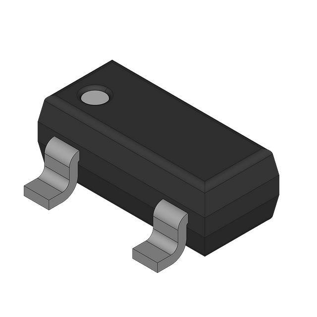

DISCRETE SEMICONDUCTORS DATA SHEET dbook, halfpage M3D088 BAL99 High-speed diode Product data sheet Supersedes data of 1999 May 26 2003 Dec 12 NXP Semiconductors Product data sheet High-speed diode BAL99 FEATURES PINNING • Small plastic SMD package PIN DESCRIPTION • High switching speed: max. 4 ns 1 not connected • Continuous reverse voltage: max. 70 V 2 cathode • Repetitive peak reverse voltage: max. 70 V 3 anode • Repetitive peak forward current: max. 500 mA. APPLICATIONS handbook, halfpage 2 1 • High-speed switching in e.g. surface mounted circuits. 1 n.c. 2 DESCRIPTION 3 The BAL99 is a high-speed switching diode fabricated in planar technology, and encapsulated in the small SOT23 plastic SMD package. 3 Marking code: JFp = made in Hong Kong; Fig.1 MAM231 JFt = made in Malaysia; JFW = made in China. Simplified outline (SOT23) and symbol. ORDERING INFORMATION PACKAGE TYPE NUMBER NAME − BAL99 DESCRIPTION VERSION plastic surface mounted package; 3 leads SOT23 LIMITING VALUES In accordance with the Absolute Maximum Rating System (IEC 60134). SYMBOL PARAMETER VRRM repetitive peak reverse voltage VR continuous reverse voltage IF continuous forward current IFRM repetitive peak forward current IFSM non-repetitive peak forward current CONDITIONS MIN. MAX. UNIT − 70 V − 70 V − 215 mA − 500 mA tp = 1 µs − 4 A tp = 1 ms − 1 A tp = 1 s − 0.5 A − 250 mW see Fig.2; note 1 square wave; Tj = 25 °C prior to surge; see Fig.4 Tamb = 25 °C; note 1 Ptot total power dissipation Tstg storage temperature −65 +150 °C Tj junction temperature − 150 °C Note 1. Device mounted on an FR4 printed-circuit board. 2003 Dec 12 2 NXP Semiconductors Product data sheet High-speed diode BAL99 ELECTRICAL CHARACTERISTICS Tj = 25 °C unless otherwise specified. SYMBOL VF IR PARAMETER forward voltage reverse current CONDITIONS MAX. UNIT IF = 1 mA 715 mV IF = 10 mA 855 mV IF = 50 mA 1 V IF = 150 mA 1.25 V VR = 25 V 30 nA VR = 70 V 1 µA VR = 25 V; Tj = 150 °C 30 µA see Fig.3 see Fig.5 VR = 70 V; Tj = 150 °C; 50 µA Cd diode capacitance f = 1 MHz; VR = 0; see Fig.6 1.5 pF trr reverse recovery time when switched from IF = 10 mA to IR = 10 mA; RL = 100 Ω; measured at IR = 1 mA; see Fig.7 4 ns Vfr forward recovery voltage when switched from IF = 10 mA; tr = 20 ns; see Fig.8 1.75 V THERMAL CHARACTERISTICS SYMBOL PARAMETER Rth(j-tp) thermal resistance from junction to tie-point Rth(j-a) thermal resistance from junction to ambient CONDITIONS note 1 Note 1. Device mounted on an FR4 printed-circuit board. 2003 Dec 12 3 VALUE UNIT 360 K/W 500 K/W NXP Semiconductors Product data sheet High-speed diode BAL99 GRAPHICAL DATA MLB755 300 MBG382 300 handbook, halfpage handbook, halfpage IF (mA) IF (mA) (1) 200 200 100 100 0 0 0 100 T amb ( oC) 200 0 (2) 1 Device mounted on an FR4 printed-circuit board. (1) Tj = 150 °C; typical values. (2) Tj = 25 °C; typical values. (3) Tj = 25 °C; maximum values. Fig.2 Fig.3 Maximum permissible continuous forward current as a function of ambient temperature. (3) 2 VF (V) Forward current as a function of forward voltage. MBG704 102 handbook, full pagewidth IFSM (A) 10 1 10−1 1 10 102 103 tp (µs) Based on square wave currents; Tj = 25 °C prior to surge. Fig.4 Maximum permissible non-repetitive peak forward current as a function of pulse duration. 2003 Dec 12 4 104 NXP Semiconductors Product data sheet High-speed diode BAL99 mbh182 105 IR (nA) Cd (pF) 104 0.6 (1) 103 (2) (3) 0.4 102 10 MBG446 0.8 handbook, halfpage 0.2 100 0 0 Tj (°C) 0 200 4 (1) VR = 70 V; maximum values. (2) VR = 70 V; typical values. (3) VR = 25 V; typical values. f = 1 MHz; Tj = 25 °C. Fig.5 Fig.6 Reverse current as a function of junction temperature. 2003 Dec 12 5 8 12 VR (V) 16 Diode capacitance as a function of reverse voltage; typical values. NXP Semiconductors Product data sheet High-speed diode BAL99 handbook, full pagewidth tr tp t D.U.T. 10% IF RS = 50 Ω IF SAMPLING OSCILLOSCOPE t rr t R i = 50 Ω V = VR I F x R S MGA881 (1) 90% VR input signal output signal (1) IR = 1 mA. Fig.7 Reverse recovery time test circuit and waveforms. I 1 kΩ 450 Ω V I 90% R S = 50 Ω D.U.T. OSCILLOSCOPE V fr R i = 50 Ω 10% MGA882 t tr input signal Fig.8 Forward recovery voltage test circuit and waveforms. 2003 Dec 12 6 t tp output signal NXP Semiconductors Product data sheet High-speed diode BAL99 PACKAGE OUTLINE Plastic surface-mounted package; 3 leads SOT23 D E B A X HE v M A 3 Q A A1 1 2 e1 bp c w M B Lp e detail X 0 1 2 mm scale DIMENSIONS (mm are the original dimensions) UNIT A A1 max. bp c D E e e1 HE Lp Q v w mm 1.1 0.9 0.1 0.48 0.38 0.15 0.09 3.0 2.8 1.4 1.2 1.9 0.95 2.5 2.1 0.45 0.15 0.55 0.45 0.2 0.1 OUTLINE VERSION SOT23 2003 Dec 12 REFERENCES IEC JEDEC JEITA EUROPEAN PROJECTION ISSUE DATE 04-11-04 06-03-16 TO-236AB 7 NXP Semiconductors Product data sheet High-speed diode BAL99 DATA SHEET STATUS DOCUMENT STATUS(1) PRODUCT STATUS(2) DEFINITION Objective data sheet Development This document contains data from the objective specification for product development. Preliminary data sheet Qualification This document contains data from the preliminary specification. Product data sheet Production This document contains the product specification. Notes 1. Please consult the most recently issued document before initiating or completing a design. 2. The product status of device(s) described in this document may have changed since this document was published and may differ in case of multiple devices. The latest product status information is available on the Internet at URL http://www.nxp.com. DISCLAIMERS above those given in the Characteristics sections of this document is not implied. Exposure to limiting values for extended periods may affect device reliability. General ⎯ Information in this document is believed to be accurate and reliable. However, NXP Semiconductors does not give any representations or warranties, expressed or implied, as to the accuracy or completeness of such information and shall have no liability for the consequences of use of such information. Terms and conditions of sale ⎯ NXP Semiconductors products are sold subject to the general terms and conditions of commercial sale, as published at http://www.nxp.com/profile/terms, including those pertaining to warranty, intellectual property rights infringement and limitation of liability, unless explicitly otherwise agreed to in writing by NXP Semiconductors. In case of any inconsistency or conflict between information in this document and such terms and conditions, the latter will prevail. Right to make changes ⎯ NXP Semiconductors reserves the right to make changes to information published in this document, including without limitation specifications and product descriptions, at any time and without notice. This document supersedes and replaces all information supplied prior to the publication hereof. No offer to sell or license ⎯ Nothing in this document may be interpreted or construed as an offer to sell products that is open for acceptance or the grant, conveyance or implication of any license under any copyrights, patents or other industrial or intellectual property rights. Suitability for use ⎯ NXP Semiconductors products are not designed, authorized or warranted to be suitable for use in medical, military, aircraft, space or life support equipment, nor in applications where failure or malfunction of an NXP Semiconductors product can reasonably be expected to result in personal injury, death or severe property or environmental damage. NXP Semiconductors accepts no liability for inclusion and/or use of NXP Semiconductors products in such equipment or applications and therefore such inclusion and/or use is at the customer’s own risk. Export control ⎯ This document as well as the item(s) described herein may be subject to export control regulations. Export might require a prior authorization from national authorities. Quick reference data ⎯ The Quick reference data is an extract of the product data given in the Limiting values and Characteristics sections of this document, and as such is not complete, exhaustive or legally binding. Applications ⎯ Applications that are described herein for any of these products are for illustrative purposes only. NXP Semiconductors makes no representation or warranty that such applications will be suitable for the specified use without further testing or modification. Limiting values ⎯ Stress above one or more limiting values (as defined in the Absolute Maximum Ratings System of IEC 60134) may cause permanent damage to the device. Limiting values are stress ratings only and operation of the device at these or any other conditions 2003 Dec 12 8 NXP Semiconductors Customer notification This data sheet was changed to reflect the new company name NXP Semiconductors, including new legal definitions and disclaimers. No changes were made to the technical content, except for package outline drawings which were updated to the latest version. Contact information For additional information please visit: http://www.nxp.com For sales offices addresses send e-mail to: salesaddresses@nxp.com © NXP B.V. 2009 All rights are reserved. Reproduction in whole or in part is prohibited without the prior written consent of the copyright owner. The information presented in this document does not form part of any quotation or contract, is believed to be accurate and reliable and may be changed without notice. No liability will be accepted by the publisher for any consequence of its use. Publication thereof does not convey nor imply any license under patent- or other industrial or intellectual property rights. Printed in The Netherlands R76/04/pp Date of release: 2003 Dec 12 Document order number: 9397 750 12389
BAL99/DG/B2215
- 物料型号:BAL99 - 器件简介:BAL99是一款采用平面技术制造的高速开关二极管,封装在小型SOT23塑料表面贴装封装中。 - 引脚分配: - 引脚1:未连接 - 引脚2:阴极 - 引脚3:阳极 - 参数特性: - 最高反向重复峰值电压:70V - 最高连续反向电压:70V - 最大连续正向电流:215mA(见图2) - 最大正向重复峰值电流:500mA - 总功耗:250mW(环境温度25°C) - 存储温度范围:-65°C 至 +150°C - 结温:最高150°C - 功能详解: - 反向电流:在不同反向电压和结温下的测试值 - 二极管电容:在1MHz频率和0V反向电压下的值 - 反向恢复时间:在特定条件下从正向电流10mA切换到反向电流10mA时的恢复时间 - 正向恢复电压:在特定条件下从正向电流10mA切换时的恢复电压 - 应用信息:适用于高速开关,例如表面贴装电路。 - 封装信息:SOT23塑料表面贴装封装,3引脚。
