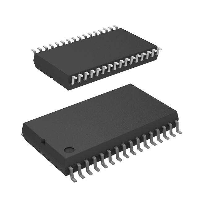

Freescale Semiconductor Technical Data Document Number: MC33882 Rev. 11.0, 11/2014 Six Output Low-side Switch with SPI and Parallel Input Control The 33882 is a smart 6 output low-side switch able to control system loads up to 1.0 A. The six outputs can be controlled via both serial peripheral interface (SPI) and parallel input control, making the device attractive for fault tolerant system applications. There are two additional 30 mA low-side switches with SPI diagnostic reporting (parallel input control only). The 33882 is designed to interface directly with industry standard microcontrollers via SPI to control both inductive and incandescent loads. Outputs are configured as open drain power MOSFETs incorporating internal dynamic clamping and current limiting. The device has multiple monitoring and protection features, including low standby current, fault status reporting, internal 52 V clamp on each output, output specific diagnostics, and protective shutdown. Additionally, it has a mode select pin affording a dual means of input control. SIX OUTPUT LOW-SIDE SWITCH VW SUFFIX (PB-FREE) 98ASH70693A 30-PIN HSOP EP SUFFIX (PB-FREE) 98ASA00706D 32-PIN QFN EK SUFFIX (PB-FREE) 98ARL10543D 32-PIN SOICW ORDERING INFORMATION Features • • • • • • • • 33882 Outputs clamped for switching inductive loads Very low operational bias currents (< 2.0 mA) CMOS input logic compatible with 5.0 V logic levels Robust load dump (60 V transient at VPWR on OUT0 – OUT5) Daisy chain operation of multiple devices possible Switch outputs can be paralleled for higher currents RDS(ON) of 0.4  per output (25 °C) at 13 V VPWR SPI operation guaranteed to 2.0 MHz Device (For Tape and Reel, add an R2 Suffix) Temperature Range (TA) MC33882PVW MC33882PEP 30 HSOP -40 °C to 125 °C MC33882PEK VDD 33882 MCU Optional Parallel Control of Outputs 0 through 7 OUT0 OUT1 OUT2 High Power Outputs OUT3 OUT4 OUT5 OUT6 OUT7 Low Power LED Outputs IN0 & IN1 IN2 & IN3 IN4 & IN5 Optional Control of Paired Outputs MODE GND Figure 1. 33882 Simplified Application Diagram © Freescale Semiconductor, Inc., 2006 - 2014. All rights reserved. 32 QFN 32 SOICW-EP VPWR VPWR VDD CS SCLK SI SO IN0 IN1 IN2 IN3 IN4 IN5 IN6 IN7 Package INTERNAL BLOCK DIAGRAM INTERNAL BLOCK DIAGRAM 16 (VDD) 1 (VPWR) 12 (SI) V DD DQ C DQ C DQ C DQ C DQ C DQ C DQ C DQ C Over-voltage Shutdown Under-voltage Shutdown On Open 3 (MODE) Detect Logic OUT6 and OUT7 Unclamped Low Power Gate 7 18 (IN7) Gate 6 29 (IN6) Internal Bias Gate 5 27 (IN5) Gate 2 21 (IN3) Gate 0 23 (OUT4) OUT1 to OUT5 High Power Gate 3 28 (IN4 & IN5) 30 (OUT6) 26 (OUT5) Gate 4 24 (IN4) 17 (OUT7) 20 (OUT3) 10 (OUT2) 7 (OUT1) 5 (OUT0) 9 (IN2) 52 V 19 (IN2 & IN3) Gate 0 6 (IN1) V REF Output 0 Status 2 (IN0 & IN1) 13 (SCLK) 0 1 2 3 4 5 6 SO Fault Latch/Shift Register 7 Serial Out V DD Tri-state GND (Heat Sink) OFF/ON Open Load Detect -+ 14 (CS) I LIM -+ Serial In Output Status 1 through 7 +- 4 (IN0) Shift Enable 3.0 A Load Short Detect 15 (SO) V OF (th) 3.0 V I O(OFF) 40 A Note Pin numbers shown in this figure are applicable only to the 30-lead HSOP package. Figure 2. 33882 Simplified Internal Block Diagram MC33882 Data Sheet, Rev. 11.0, 11/2014 2 Analog Integrated Circuit Device Data Freescale Semiconductor PIN CONNECTIONS PIN CONNECTIONS OUT5 IN4 OUT4 IN3 OUT3 IN2&IN3 IN7 30 29 28 27 26 25 OUT7 2 23 VDD OUT6 3 22 GND GND 4 21 GND HEATSINK 1 2 3 4 5 6 7 8 9 10 11 12 13 14 15 16 HEATSINK 32 31 30 29 28 27 26 25 24 23 22 21 20 19 18 17 IN0 GND NC SO CS SCLK SI OUT2 IN2 OUT1 IN1 OUT0 IN0 MODE IN0&IN1 VPWR GND 16 CS SCLK 17 SI SO 8 15 18 MODE 14 IN0&IN1 OUT2 GND 7 IN2 19 13 GND 6 12 20 VPWR OUT1 GND 5 TRANSPARENT TOP VIEW GND NC VDD OUT7 IN7 IN2&IN3 OUT3 IN3 OUT4 IN4 OUT5 IN5 IN4&IN5 IN6 OUT6 GND 31 24 IN6 9 30 PIN HSOP 1 11 SO HEATSINK IN4&IN5 10 CS GND IN1 IN0 OUT0 IN1 OUT1 NC IN2 OUT2 NC SI SCLK OUT0 MODE OUT6 IN6 IN4&IN5 IN5 OUT5 NC IN4 OUT4 NC IN3 OUT3 IN2&IN3 IN7 OUT7 VDD 30 29 28 27 26 25 24 23 22 21 20 19 18 17 16 IN5 1 2 3 4 5 6 7 8 9 10 11 12 13 14 15 VPWR IN0&IN1 32 TRANSPARENT TOP VIEW TRANSPARENT TOP VIEW 32 PIN QFN 32 PIN SOIC Figure 3. HSOP, QFN, and SOIC Pin Connections Table 1. HSOP Pin Function Description 30 Pin HSOP 32 Pin QFN 32 Pin SOIC Pin Name Formal Name Definition 1 6 18 VPWR Load Supply Voltage This pin is connected to battery voltage. A decoupling cap is required from VPWR to ground. 2 19 28 7 26 1 19 6 13 IN0 & IN1 IN2 & IN3 IN4 & IN5 Input 0 & Input 1 Input 2 & Input 3 Input 4 & Input 5 These input pins control two output channels each when the MODE pin is pulled high. These pins may be connected to pulse width modulated (PWM) outputs of the control IC while the MODE pin is high. The states of these pins are ignored during normal operation (MODE pin low), and override the normal inputs (serial or parallel) when the MODE pin is high. These pins have internal active 25 A pull-downs. 3 8 20 MODE Mode Select The MODE pin is connected to the MODE pin of the control IC. This pin has an internal active 25 A pull-up. MC33882 Data Sheet, Rev. 11.0, 11/2014 3 Analog Integrated Circuit Device Data Freescale Semiconductor PIN CONNECTIONS Table 1. HSOP Pin Function Description (continued) 30 Pin HSOP 32 Pin QFN 32 Pin SOIC Pin Name Formal Name Definition 4 6 9 18 21 24 27 29 9 11 13 25 28 30 32 2 21 23 25 5 8 10 12 14 IN0 IN1 IN2 IN7 IN3 IN4 IN5 IN6 Input 0 – Input7 These are parallel control input pins. These pins have internal 25 A active pull-downs. 5 7 10 17 20 23 26 30 10 12 14 24 27 29 31 3 22 24 26 4 7 9 11 15 OUT0 OUT1 OUT2 OUT7 OUT3 OUT4 OUT5 OUT6 Output 0 – Output7 2,31 NC No Connect Not connected. 8, 11, 22, 25 Each pin is one channel's drain, sinking current for the respective load. 12 15 27 SI Serial Input The Serial Input pin is connected to the SPI Serial Data Output pin of the control IC from where it receives output command data. This input has an internal active 25 A pull-down and requires CMOS logic levels. 13 16 28 SCLK Serial Clock The SCLK pin of the control IC is a bit (shift) clock for the SPI port. It transitions one time per bit transferred when in operation. It is idle between command transfers. It is 50% duty cycle, and has CMOS levels. 14 17 29 CS Chip Select This pin is connected to a chip select output of the control IC. This input has an internal active 25 A pull-up and requires CMOS logic levels. 15 18 30 SO Serial Output This pin is connected to the SPI Serial Data Input pin of the control IC or to the SI pin of the next device in a daisy chain. This output will remain tristated unless the device is selected by a low CS pin or the MODE pin goes low. The output signal generated will have CMOS logic levels and the output data will transition on the falling edges of SCLK. The serial output data provides fault information for each output and is returned MSB first when the device is addressed. 16 23 3 VDD Logic Supply Voltage This pin is connected to the 5.0 V power supply of the system. A decoupling capacitor is required from VDD to ground. GND Ground Ground continuity is required for the outputs to turn on. The heat sink must be electrically connected to GND. Heat 4,5,19- 1,16,17, Sink 22 32 (exposed pad)(1) Notes 1. The exposed pad on this package provides the circuit ground connection for the IC. MC33882 Data Sheet, Rev. 11.0, 11/2014 4 Analog Integrated Circuit Device Data Freescale Semiconductor ELECTRICAL CHARACTERISTICS MAXIMUM RATINGS ELECTRICAL CHARACTERISTICS MAXIMUM RATINGS Table 2. Maximum Ratings All voltages are with respect to ground unless otherwise noted. Rating Symbol Value Limit VPWR(SS) 25 VPWR(T) -1.5 to 60 VDD -0.3 to 7.0 V VIN -0.3 to VDD + 0.3 V ELECTRICAL RATINGS Load Supply Voltage V Normal Operation (Steady-state) Transient Survival (2) Logic Supply Voltage (3) Input Pin Voltage (4) Output Clamp Voltage (OUT0 to OUT5) (5) VO(OFF) 20 mA = IO = 0.2 A V 48 to 64 Output Self-limit Current IO(LIM) OUT0 to OUT5 A 3.0 to 6.0 OUT6 and OUT7 0.05 to 0.15 ESD Voltage (HSOP, QFN, and SOIC) V Human Body Model (6) VESD1 ±2000 Machine Model (7) VESD2 ±200 Output Clamp Energy (8) ECLAMP mJ OUT0 to OUT5: Single Pulse at 1.5 A, TJ = 150C 100 OUT6 and OUT7: Single Pulse at 0.45 A, TJ = 150C 50 Maximum Operating Frequency (SPI) SO (9) fOF 3.2 MHz TSTG -55 to 150 C TJ -40 to 150 C TPPRT Note 11 °C THERMAL RATINGS Storage Temperature Operating Junction Temperature Peak Package Reflow Temperature During Reflow Notes 2. 3. 4. 5. 6. 7. 8. 9. 10. 11. (10), (11) Transient capability with external 100  resistor in series with the VPWR pin and supply. Exceeding these voltages may cause a malfunction or permanent damage to the device. Exceeding the limits on any parallel inputs or SPI pins may cause permanent damage to the device. With output OFF. ESD1 testing is performed in accordance with the Human Body Model (CZAP = 100 pF, RZAP = 1500 ). ESD2 testing is performed in accordance with the Machine Model (CZAP = 200 pF, RZAP = 0 ). Maximum output clamp energy capability at indicated junction temperature using a single pulse method. Serial Frequency Specifications assume the IC is driving 8 tri-stated devices (20 pF each). Pin soldering temperature limit is for 10 seconds maximum duration. Not designed for immersion soldering. Exceeding these limits may cause malfunction or permanent damage to the device. Freescale’s Package Reflow capability meets Pb-free requirements for JEDEC standard J-STD-020C. For Peak Package Reflow Temperature and Moisture Sensitivity Levels (MSL), Go to www.freescale.com, search by part number [e.g. remove prefixes/suffixes and enter the core ID to view all orderable parts. (i.e. MC33xxxD enter 33xxx), and review parametrics. MC33882 Data Sheet, Rev. 11.0, 11/2014 Analog Integrated Circuit Device Data Freescale Semiconductor 5 ELECTRICAL CHARACTERISTICS MAXIMUM RATINGS Table 2. Maximum Ratings (continued) All voltages are with respect to ground unless otherwise noted. Rating THERMAL RESISTANCE Symbol Value Limit (12) (13) , Junction-to-Ambient, Natural Convection, Single-Layer Board (1s) (14) RJA HSOP QFN SOIC Junction-to-Ambient, Natural Convection, Four-Layer Board (2s2p) (15) RJMA HSOP QFN SOIC(17) Junction-to-Board (Bottom) C/W 18 27 TBD C/W RJB HSOP QFN SOIC(17) Junction-to-Case (Top) (16) C/W 41 85 72 3.0 10 TBD C/W RJC HSOP QFN SOIC 0.2 1.2 1.0 Notes 12. Junction temperature is a function of on-chip power dissipation, package thermal resistance, mounting site (board) temperature, ambient temperature, air flow, power dissipation of other components on the board, and board thermal resistance. 13. Thermal resistance between the die and the printed circuit board per JEDEC JESD51-8. Board temperature is measured on the top surface of the board near the package. 14. Per SEMI G38-87 and JEDEC JESD51-2 with the single-layer board horizontal. 15. Per JEDEC JESD51-6 with the board horizontal. 16. Indicates the average thermal resistance between the die and the case top surface as measured by the cold plate method (MIL SPEC 883, Method 1012.1) with the cold plate temperature used for the case temperature. 17. This value will be included when available. MC33882 Data Sheet, Rev. 11.0, 11/2014 6 Analog Integrated Circuit Device Data Freescale Semiconductor ELECTRICAL CHARACTERISTICS STATIC ELECTRICAL CHARACTERISTICS STATIC ELECTRICAL CHARACTERISTICS Table 3. Static Electrical Characteristics Characteristics noted under conditions 4.75 V  VDD  5.25 V, 9.0 V  VPWR  17 V, -40 C  TA  125 C, unless otherwise noted. Characteristic Symbol Min Typ Max Unit POWER INPUT Supply Voltage Ranges Functional Threshold V (18) Full Operation Logic Supply Voltage VPWR Supply Current (All Outputs ON) (19) V PWR 4.5 5.5 V PWR 8.0 – 25 VDD 4.5 5.0 5.5 – – 7.5 V PWR (OV) 30 – 40 V 8.0 I PWR (ON) IO = 1.0 A Each Over-voltage Shutdown (20) Over-voltage Shutdown Hysteresis (21) mA V PWR (OV) HYS 0.4 – 1.5 V Power-ON Reset Threshold, VDD (22) V POR 2.5 – 3.5 V Logic Supply Current (All Outputs ON) I DD VDD = 5.5 V mA – – 5.0 – 0.6 0.8 – 0.4 0.6 3.0 – 6.0 2.5 – 3.5 POWER OUTPUT Output Drain-to-Source ON Resistance  RDS(ON) OUT0 to OUT5: TJ = 150°C, VPWR = 13.0 V, IO = 1.0 A Output Drain-to-Source ON Resistance  RDS(ON) OUT0 to OUT5: TJ = 25°C, VPWR = 13.0 V, IO = 1.0 A Output Self-limiting Current I O (LIM) VPWR = 13.0 V, VDD = 4.5 V, VIN = 5.0 V Open Load OFF Detection (Outputs Programmed OFF) Output OFF (Open Load Detect) Drain Current (Output Pins Programmed OFF) (23) V OFF (TH) A A I O (OFF) OUT0 to OUT5 20 – 120 OUT6 and OUT7 20 – 80 20 – 200 Output ON (Open Load Detect) Drain Current (Output Pins Programmed ON) (24) Output Clamp Voltage OUT0 to OUT5: IO = 20 mA, tCLAMP = 100 s – mA V OK V 48 52 64 – 1.0 10 ISD = 1.0 mA @ 25 °C – – 1.4 ISD = 1.0 mA @ 125 °C – – 0.9 Output Leakage Current Drain-to-Source Diode Forward Voltage A I OLK VDD = VPWR = 0.5 V, VOUT = 24 V V V SD V MC33882 Data Sheet, Rev. 11.0, 11/2014 Analog Integrated Circuit Device Data Freescale Semiconductor 7 ELECTRICAL CHARACTERISTICS STATIC ELECTRICAL CHARACTERISTICS Table 3. Static Electrical Characteristics (continued) Characteristics noted under conditions 4.75 V  VDD  5.25 V, 9.0 V  VPWR  17 V, -40 C  TA  125 C, unless otherwise noted. Characteristic Symbol Min Typ Max Unit SI Logic High SIV IH 4.0 SI Logic Low SIV IL – – – V – 2.0 V CS and SCLK Logic High CSV IH 3.0 – – V CS and SCLK Logic Low CSV IL – – 3.0 V V IH 3.15 – – V V IL – – 1.35 V 5.0 – 25 DIGITAL INTERFACE Input Logic High Input Logic Low Input Pull-down Current (25) Input Pull-up Current (26) – -5.0 3.5 – – 0 – 0.4 V V SOL IOL = 1.0 mA SO and Tri-state Leakage Current -25 V SOH IOH = -1.0 mA SO and Low-state Output Voltage A I IN (PU) VIN = 3.5 V SO and High-state Output Voltage A I IN (PD) VIN = 1.5 V V A I SOT CS = 0.7 VDD, VSO = 0.3 VDD -10 – – CS = 0.7 VDD, VSO = 0.7 VDD – – 10 – – 12 – – 20 Input Capacitance (27) C IN 0 = VIN = 5.5 V SO and Tri-state Capacitance (28) pF C SOT 0 = VIN = 5.5 V pF Notes 18. Outputs of device functionally turn-on (RDS(ON) = 0.95  @125 °C). SPI / parallel inputs and power outputs are operational. Fault detection and reporting may not be fully operational within this range. 19. Value reflects all outputs ON and equally conducting 1.0 A each. VPWR = 5.5 V, CS = 5.0 V. 20. An over-voltage condition will cause any enabled outputs to latch OFF (disabled). 21. This parameter is guaranteed by design; however, it is not production tested. 22. For VDD less than the Power-ON Reset voltage, all outputs are disabled and the serial fault register is reset to all 0s. 23. Drain current per output with VPWR = 24 V and VLOAD = 9.0 V. 24. Drain current per output with VPWR = 13 V, VLOAD = 9.0 V. 25. Inputs SI, IN0 & IN1, IN2 & IN3, IN4 & IN5, and IN0 to IN7 incorporate active internal pull-down current sinks for noise immunity enhancement. 26. The MODE and CS inputs incorporate active internal pull-up current sources for noise immunity enhancement. 27. This parameter applies to inputs SI, CS, SCLK, MODE, IN0 & IN1, IN2 & IN3, IN4 & IN5, and IN0 to IN7. It is guaranteed by design; however, it is not production tested. 28. This parameter applies to the OFF state (tri-stated) condition of SO and is guaranteed by design; however, it is not production tested. MC33882 Data Sheet, Rev. 11.0, 11/2014 8 Analog Integrated Circuit Device Data Freescale Semiconductor ELECTRICAL CHARACTERISTICS DYNAMIC ELECTRICAL CHARACTERISTICS DYNAMIC ELECTRICAL CHARACTERISTICS Table 4. Dynamic Electrical Characteristics Characteristics noted under conditions 4.75 V  VDD  5.25 V, 9.0 V  VPWR  17 V, -40 C  TA  125C, unless otherwise noted. Characteristic Symbol Min Typ Max Unit Output Rise Time (29) tR 1.0 – 10 s Output Fall Time (29) POWER OUTPUT TIMING tF 1.0 – 10 s Output Turn-ON Delay Time (30) t DLY (ON) 1.0 – 10 s Output Turn-OFF Delay Time (31) t DLY (OFF) 1.0 – 10 s 25 – 100 Output Short Fault Sense Time (32) s t SS RLOAD = < 1.0 V Output Short Fault Refresh Time (33) t REF RLOAD = < 1.0 V ms 3.0 4.5 6.0 t OS(OFF) 25 60 100 s t OS(ON) 3.0 – 12 ms SC DC 0.42 – 3.22 % SCLK Clock High Time (SCLK = 3.2 MHz) (37) t SCLKH – – 141 ns (37) t SCLKL – – 141 ns Output OFF Open Load Sense Time Output ON Open Load Sense Time Output Short Fault ON Duty Cycle (34) (35) (36) DIGITAL INTERFACE TIMING SCLK Clock Low Time (SCLK = 3.2 MHz) Falling Edge (0.8 V) of CS to Rising Edge (2.0 V) of SCLK Required Setup Time Falling Edge (0.8 V) of SCLK to Rising Edge (2.0 V) of CS Required Setup Time t LEAD (37) – – 140 – – 50 t RSI – – 50 ns t FSI – – 50 ns t LAG (37) SI, CS, SCLK Incoming Signal Rise Time (37) SI, CS, SCLK Incoming Signal Fall Time (37) ns ns Notes 29. Output Rise and Fall time measured at 10% to 90% and 90% to 10% voltage points respectively across 15  resistive load to a VBAT of 15 V, VPWR = 15 V. 30. Output Turn-ON Delay Time measured from rising edge (3.0 V) VIN (CS for serial) to 90% VO using a 15  load to a VBAT of 15 V, VPWR = 15 V. 31. Output Turn-OFF Delay Time measured from falling edge (1.0 V) VIN (3.0 V rising edge of CS for serial) to 10% VO using a 15  load to a VBAT of 15 V, VPWR = 15 V. 32. The shorted output is turned ON during tSS to retry and check if the short has cleared. The shorted output is in current limit during tSS. The tSS is measured from the start of current limit to the end of current limit. 33. The Short Fault Refresh Time is the waiting period between tSS retry signals. The shorted output is disabled during this refresh time. The tREF is measured from the end of current limit to the start of current limit. 34. 36. The tOS(OFF) is measured from the time the faulted output is turned OFF until the fault bit is available to be loaded into the internal fault register. To guarantee a fault is reported on SO, the falling edge of CS must occur at least 100 s after the faulted output is off. The tOS(ON) is measured from the time the faulted output is turned ON until the fault bit is available to be loaded into the internal fault register. To guarantee a fault is reported on SO, the falling edge of CS must occur at least 12 ms after the faulted output is ON. Percent Output Short Fault ON Duty Cycle is defined as (tSS)  (tREF) x 100. This specification item is provided FYI and is not tested. 37. Parameter is not tested and values suggested are for system design consideration only in preventing the occurrence of double pulsing. 35. MC33882 Data Sheet, Rev. 11.0, 11/2014 Analog Integrated Circuit Device Data Freescale Semiconductor 9 ELECTRICAL CHARACTERISTICS DYNAMIC ELECTRICAL CHARACTERISTICS Table 4. Dynamic Electrical Characteristics (continued) Characteristics noted under conditions 4.75 V  VDD  5.25 V, 9.0 V  VPWR  17 V, -40 C  TA  125C, unless otherwise noted. Characteristic Symbol SI Setup to Rising Edge (2.0 V) of SCLK (at 3.2 MHz) Required Setup Time Required Hold Time Required Hold Time – 45 ns 90 – – – – 45 90 – – – – 50 ns ns t RSO CL = 200 pF SO Fall Time t FSO ns – CL = 200 pF Falling Edge of CS (0.8 V) to SO Low-impedance (39) t SOEN Rising Edge of CS (2.0 V) to SO High-impedance (40) t SODIS Falling Edge of SCLK (0.8 V) to SO Data Valid CS Rising Edge to Next Falling Edge (38) Notes 38. 39. 40. 41. ns – 50 – – 110 ns – – 110 ns – 65 80 – – 1.0 t SOVALID CL = 200 pF at 3.2 MHz (41) Xfer DELAY Unit ns t SOHOLD (38) SO Rise Time – t SIHOLD (38) SO Hold After SCLK Rising (2.0 V) / Falling (0.8 V) Edge Max t SOSU (38) SI Hold After Rising Edge (2.0 V) of SCLK (at 3.2 MHz) Typ t SISU Required Setup Time (38) SO Setup to SCLK Rising (2.0 V) / Falling (0.8 V) Edge Min ns s Parameter is not tested and values suggested are for system design consideration only in preventing the occurrence of double pulsing. Enable time required for SO. Pull-up resistor = 10 k. Disable time required for SO. Pull-up resistor = 10 k. Time required to obtain valid data out of SO following the falling edge of SCLK. MC33882 Data Sheet, Rev. 11.0, 11/2014 10 Analog Integrated Circuit Device Data Freescale Semiconductor ELECTRICAL CHARACTERISTICS TIMING DIAGRAMS TIMING DIAGRAMS NORMAL OPERATION NPUT InputXX GateXX GATE IOUT OUT XX 5.0 5V V 0 0V V ON ON OFF OFF IO(LIM) IDLIM ILOAD ILOAD 00AA Normal Operation Fault BIT Bit X X FAULT OFF INPUT X Input X 5.0 5V V 00V V Gate XX GATE ON ON OFF OFF IOUT OUT XX IO(LIM) IDLIM ILOAD ILOAD 0A 0A SHORT OCCURS W HILE ON, ENDS DURING REFRESH SHORTED LOAD / SHORT - TO - VBAT Shorted Load/Short-to-VPWR tSSD TSSD TREF tREF Fault Bit X FAULT BIT X CSB CB TREF tREF FAULT Fault tSSA TSSA TREF tREF tSSD TSSD tREF TREF Shorted Operation FAULT Fault GATE X = COMMAND SIGNAL AT THE GATE OF DRIVER X CommandFAULT Signal at the Gate of X FAULT Gate BIT XX==INTERNAL REGISTER BITDriver STATE TREF x Fault Bit X = Internal Fault Register Bit State = FIRST REFRESH TIMTime E M AY BEbe LESS TREF tREF X = First Refresh may lessTHAN than tREF ILOAD = 1.0 A ILOAD = 1A Figure 4. Short Occurring While On, Ending During Refresh (ILOAD = 1.0 A) MC33882 Data Sheet, Rev. 11.0, 11/2014 Analog Integrated Circuit Device Data Freescale Semiconductor 11 ELECTRICAL CHARACTERISTICS TIMING DIAGRAMS NORMAL OPERATION INPUT InputXX GATE GateXX IOUT XX IOUT 5.0 5V V 0 0V V ON ON OFF OFF IDLIM IO(LIM) ILO AD ILOAD 0A 0A Normal Operation Fault BIT Bit X X FAULT SHORT OCCURS WHILE ON, ENDS DURING RETRY SHORTED / SHORT - TO - VBAT Shorted LOAD Load/Short-to-VPWR INPUT X Input X Gate X X GATE IOUT IOUT XX 5V V 5.0 0 0V V ON ON OFF OFF IO(LIM) IDLIM ILOAD ILOAD 0A 0A Fault Bit X FAULT BIT X CSB CB tSSA tSSD TSSD TREF tREF tSSD TSSA TREF tREF TSSD TREF tREF tREF TREF FAULT Fault Shorted Operation FAULT Fault GATE X = COM M AND SIGNAL AT THE GATE OF DRIVER X Gate X = Command Signal at the Gate of Driver X Fault X INTERNAL = Internal Fault Register Bit State FAULT BIT Bit X = FAULT REGISTER BIT STATE tREF X = First Refresh Time may be less than tREF TREF ILOAD x = FIRST TIME M AY BE LESS THAN TREF = 1.0REFRESH A ILOAD = 1A Figure 5. Short Occurring While On, Ending During Retry (ILOAD = 1.0 A) NORMAL OPERATION INPUT InputXX G ATE GateXX IO UT XX IOUT 5V V 5.0 0 0V V ON ON O FF OFF IO(LIM) IDLIM ILOAD ILOAD 00AA Normal Operation Fault BIT Bit X X FAULT SHORT O CCURS WHILE ON, ENDS DURING REFRESH SHORTED Shorted LOAD Load/Short-to-VPWR / SHORT - TO - VBAT INPUT X Input X 5.0 5V V 0 0V V Gate X X G ATE ON ON OFF OFF IOUTX X IOUT IO(LIM) IDLIM ILOAD ILO AD 0A 0A tREF TREF Fault Bit X FAULT BIT X CSB CB tSSD TSSD TSSA tSSA tREF TREF FAULT Fault TR EF tREF TREF tREF Shorted Operation FAULT Fault GATE X = COM M AND SIGNAL AT THE G ATE OF DRIVER X Gate X = Command Signal at the Gate of Driver X FAULT Fault BIT XBit =X INTERNAL REGISTER BIT STATE = InternalFAULT Fault Register Bit State TREF x tREF X = First Refresh Time may be less than tREF = FIRST REFRESH TIM E MAY B E LESS THAN TREF ILOAD = 20 mA ILOAD = 20m A Figure 6. Short Occurring While On, Ending During Refresh (ILOAD = 20 mA) MC33882 Data Sheet, Rev. 11.0, 11/2014 12 Analog Integrated Circuit Device Data Freescale Semiconductor ELECTRICAL CHARACTERISTICS TIMING DIAGRAMS NORMAL OPERATION INPUT Input X X GATE Gate X IOUT IOUTXX 5.05VV 0V 0V ON ON OFF OFF IO(LIM) IDLIM ILOAD ILOAD 0 0A A Normal Operation Fault Bit X X FAULT BIT SHORT OCCURS W HILE ON, ENDS DURING RETRY SHORTED / SHORT - TO - VBAT Shorted LOAD Load/Short-to-VPWR INPUT Input XX 5.05VV 0V 0V Gate XX GATE ON ON OFF OFF IO(LIM) IDLIM ILOAD ILOAD 00AA IOUTXX IOUT TSSA tSSA TREF tREF Fault Bit X FAULT BIT X CSB CB TSSD tSSD TREF tREF FAULT Fault tSSD TSSD TREF tREF TREF tREF Shorted Operation FAULT Fault GATE X = COM MAND SIGNAL AT THE GATE OF DRIVER X Gate X = Command Signal at the Gate of Driver X FAULTFault BIT Bit X =XINTERNAL FAULT REGISTER BIT STATE = Internal Fault Register Bit State tREF X = First Refresh Time may be less than tREF = FIRST REFRESH TIM E M AY BE LESS THAN TREF ILOAD = 20 mA TREF x ILOAD = 20m A Figure 7. Short Occurring While On, Ending During Retry (ILOAD = 20 mA) MC33882 Data Sheet, Rev. 11.0, 11/2014 Analog Integrated Circuit Device Data Freescale Semiconductor 13 ELECTRICAL CHARACTERISTICS ELECTRICAL PERFORMANCE CURVES ELECTRICAL PERFORMANCE CURVES RDS(ON) 0.43 0.42 54.8 0.41 54.6 54.4 0.39 VOLTS OHMS 0.4 0.38 0.37 54.2 54.0 53.8 0.36 0.35 VCLAMP 55.0 53.6 25 40 55 70 85 100 115 130 53.4 -50 AMBIENT TEMPERATURE (°C) -25 0 25 50 75 100 125 AMBIENT TEMPERATURE (C) RDS(ON) Figure 8. Output RDS(ON) Versus Temperature Figure 9. Output Clamp Voltage Versus Temperature Table 5. Logic Table Mode of Operation Normal Operation Default Mode Status Status Command Input Pins Transmitted Transmitted Mode Pin IN0&IN1 IN4&IN5 Sent 543210 SO Next SO Gates 543210 Outputs 543210 00111111 00000000 00111111 L X X XXXXXX HHHHHH 001X1010 00000000 001Y1010 L X X XHXLXL HHHLHL LLLHLH LLLLLL 000101X1 00000000 000101Y1 L X X LXLXHX LHLHHH HLHLLL 00XXX000 00000000 00YYY000 L X X HHHLLL HHHLLL LLLHHH 00XXXXXX 11111111 11111111 H H H XXHLXX HHHLHH LLLHLL 00XXXXXX 11111111 11111111 H H L XXLHXX HHLHLL LLHLHH 00XXXXXX 11111111 11111111 H L H XXHLXX LLHLHH HHLHLL 00XXXXXX 11111111 11111111 H L L XXLHXX LLLHLL HHHLHH Over-voltage Shutdown 00XXXXXX 00XXXXXX 00XXXXXX X X X XXXXXX L L L L L L H H H H H H Short-to-Battery / Short-circuit Output 0 00XXXXX0 00000000 00YYYYY0 L X X XXXXXL YYYYYL YYYYYH 00XXXXX1 00000001 00YYYYY0 L X X XXXXXX YY Y Y Y H Y Y YY Y H Open Load /  00XXXXX0 Short-to-Ground Output 0 00XXXXX1 00000001 00YYYYY1 L X X XXXXXL YYYYYL YYYYYL 00000000 00YYYYY1 L X X XXXXXX YY Y Y Y H Y Y Y YY L Legend 0011XXYY = Serial (SPI) commands and status bytes (8-bit operation mode) MSB to LSB. 0 = Off command, SO OK status. 1 = On command, SO FAULT status. X = Don’t care. Y = Defined by state of X. H = High-voltage level: Active state for inputs / gates, inactive state for outputs. L = Low-voltage level: Inactive state for inputs / gates, active state for outputs. MC33882 Data Sheet, Rev. 11.0, 11/2014 14 Analog Integrated Circuit Device Data Freescale Semiconductor FUNCTIONAL DESCRIPTION INTRODUCTION FUNCTIONAL DESCRIPTION INTRODUCTION The 33882 incorporates six 1.0 A low-side switches using both Serial Peripheral Interface (SPI) I /O as well as optional parallel input control to each output. There are also two lowpower (30 mA) low-side switches with SPI diagnostic feedback, but parallel-only input control. The 33882 incorporates SMARTMOS technology with CMOS logic, bipolar / MOS analog circuitry, and DMOS power MOSFETs. Designed to interface directly with a microcontroller, it controls inductive or incandescent loads. Each output is configured as an open drain transistor with dynamic clamping. FUNCTIONAL PIN DESCRIPTION VPWR PIN The VPWR pin is connected to battery voltage. This supply is provided for over-voltage shutdown protection and for added gate drive capabilities. A decoupling capacitor is required from VPWR to ground. corresponding SPI control bit to control each output channel. These pins have internal 25 A active pull-downs. OUT0 TO OUT7 PINS Each pin is one channel's low-side switch output. OUT0 to OUT5 are actively clamped to handle inductive loads. IN0 & IN1, IN2 & IN3, AND IN4 & IN5 PINS These input pins control two output channels each when the MODE pin is pulled high: IN0 & IN1 controls OUT0 and OUT1, IN2 & IN3 controls OUT2 and OUT3, while IN4 & IN5 controls OUT4 and OUT5. These pins may be connected to PWM outputs of the control IC and pulled high or pulled low to control output channel states while the MODE pin is high. The states of these pins are ignored during normal operation (MODE pin low) and override the normal inputs (serial or parallel) when the MODE pin is high. These pins have internal active 25 A pull-downs. MODE PIN The MODE pin is connected to the MODE pin of the control IC. This pin has an internal active 25 A pull-up. When pulled high, the MODE pin does the following: • Disables all serial control of the outputs while still reading any serial input commands. • Disables parallel inputs IN0, IN1, IN2, IN3, IN4, and IN5 control of the outputs. • Selects IN0 & IN1, IN2 & IN3, and IN4 & IN5 input pins for control of OUT0 and OUT1, OUT2 and OUT3, OUT4 and OUT5, respectively. • Turns off OUT6 and OUT7. • Tri-states the SO pin. IN0 TO IN7 PINS These are parallel input pins connected to output pins of the control IC. Each parallel input is logic high with the SI PIN The Serial Input pin is connected to the SPI Serial Data Output pin of the control IC from where it receives output command data. This input has an internal active 25 A pulldown and requires CMOS logic levels. The serial data transmitted on this line is an 8- or 16-bit control command sent MSB first, controlling the six output channels. Bits A5 through A0 control channels 5 through 0, respectively. Bits A6 and A7 enable ON open load fault detection on channels 5 through 0. The control IC will ensure that data is available on the rising edge of SCLK. Each channel has its serial control bit high with its parallel input to determine its state. SCLK PIN The SCLK pin of the control IC is a bit (shift) clock for the SPI port. It transitions one time per bit transferred when in operation. It is idle between command transfers. It is 50% duty cycle and has CMOS levels. This signal is used to shift data to and from the device. For proper fault reporting operation, the SCLK input must be low when CS transitions from high to low. CS PIN The CS pin is connected to a chip select output of the control IC. The control IC controls which device is addressed by pulling the CS pin of the desired device low, enabling the SPI communication with the device, while other devices on the serial link keep their serial outputs tri-stated. This input has an internal active 25 A pull-up and requires CMOS logic levels. MC33882 Data Sheet, Rev. 11.0, 11/2014 Analog Integrated Circuit Device Data Freescale Semiconductor 15 FUNCTIONAL DESCRIPTION FUNCTIONAL PIN DESCRIPTION SO PIN The Serial Output pin is connected to the SPI Serial Data Input pin of the control IC or to the SI pin of the next device in a daisy chain. This output will remain tri-stated unless the device is selected by a low CS pin or the MODE pin goes low. The output signal generated will have CMOS logic levels and the output data will transition on the falling edges of SCLK. The serial output data provides fault information for each output and is returned MSB first when the device is addressed. Fault bit assignments for return data are as follows: MSB-0 through MSB-7 are output fault bits for OUT7 to OUT0, respectively. In 8-bit SPI mode, under normal conditions, the SO pin (not daisy chained) returns all 0s, representing no faults. If a fault is present, a 1 is returned for the appropriate bit. In 16-bit SPI mode, sending a double command byte will provide a command verification byte following the fault status byte returned from the SO pin (nondaisy chained). With the MODE pin high, the serial output pin tri-states. If nothing is connected to the SO pin except an external 10 k pull-up resistor, data is read as all [1]s by the control IC. VDD PIN This pin is connected to the 5.0 V power supply of the system. A decoupling capacitor is required from VDD to ground. PERFORMANCE FEATURES NORMAL OPERATION SERIAL STATUS OUTPUT OUT0 to OUT7 are independent during normal operation. OUT0 to OUT5 may be driven serially or by their parallel input pins. OUT6 and OUT7 can only be controlled by their parallel input pins. Device operation is considered normal only if the following conditions apply: • VPWR of 5.5 V to 24 V, and VDD voltage of 4.75 V to 5.25 V. • Junction temperatures less than 150 C. • For each output, drain voltage exceeds the Open Load OFF Detection Voltage, specified in the specification table, while the output is OFF. For open load detection, an open condition existing for less than the Open Load Detection time, specified in the specification table, is not considered a fault nor is it reported to the fault status register. • The MODE pin is held at the logic low level, keeping the serial channel / parallel input pins in control of the eight outputs. Serial output information sent on the SPI port is a check on the fault status of each output channel as well as a check for MODE initiation. Serial command verification is also possible. SERIAL / PARALLEL INPUT CONTROL Input control is accomplished by the serial control byte sent via the SPI port from the control IC or by the parallel control pins for each channel. For channels 0 to 5 with serial and parallel control the output state is determined by the OR of the serial bit and the parallel input pin state. Serial communication is initiated by a low state on the CS pin and timed by the SCLK signal. After CS switches low, the IC initiates eight or 16 clock pulses with the control bits being available on the SI pin at the rising edge of SCLK. The bits are transferred in descending bit-significant order. Any fault or MODE indications on bits returned are logic [1]s. The last six bits are the command signals to the six outputs. Upon completion of the serial communication the CS pin will switch high. This terminates the communication with the slave device and loads the control bits just received to the output channels. Upon device power-up, the serial register is cleared. In the application for non-daisy chain configurations, the number of SPI devices available to be driven by the SO pin is limited to eight devices. SO PIN OPERATION The SO pin provides SPI status, allowing daisy chaining. The status bits returned to the IC are the fault register bits with logic [1]s indicating a fault on the designated output or MODE if all bits return logic [1] (with a 10 k pull-up resistor on the SO pin). A command verification is possible if the SPI mode is switched to 16 bits. The first byte (8 bits) returned would be the fault status, while the second byte returned would be the first byte sent feeding through the 33882 IC. The second command byte sent would be latched into the 33882 IC. The CS pin switching low indicates the device is selected for serial communication with the IC. Once CS switches low, the fault status register cannot receive new fault information and serial communication begins. As the control bits are clocked from the IC MSB first, they are received on rising SCLK edges at the SI pin. The fault status bits transition on the SO pin on falling SCLK edges and are sampled on rising SCLK edges at the input pin of the IC SPI device. When the command bit transmissions for serial communication are complete, the CS pin is switched high. This terminates communication with the device. The SO pin tri-states, the fault status register is opened to accept new fault information, and the transmitted command data is loaded to the outputs. At the same time, the IC can read the status byte it received. DAISY CHAIN OPERATION (ONLY POSSIBLE WITH SO PIN) Daisy chain configurations can be used with the SO pin to save CS outputs on the IC. Clocking and pin operations are as defined in the SO Pin Operation paragraph. For daisy chaining two 8-bit devices, a 16-bit SPI command is sent, the first command byte for the second daisy chain device and the second command byte for the first daisy chain device. A command verification is possible if the SPI mode is switched MC33882 Data Sheet, Rev. 11.0, 11/2014 16 Analog Integrated Circuit Device Data Freescale Semiconductor FUNCTIONAL DESCRIPTION FUNCTIONAL PIN DESCRIPTION to 32 bits. The first word sent is command verification data fed through the two 33882 ICs. Data returned in the 32 bits is the two fault status bytes, followed by the first word sent. Bits sent out are sampled on rising SCLK edges at the input pin of the next IC in the daisy chain. Note Because SO pins of the 33882 ICs are tri-stated, any device receiving its SPI data from a previous 33882 IC SO pin in a daisy chain will not receive data if the MODE pin is low. This prohibits setting SPI-controlled channels ON with a SPI command while the MODE pin is low. Therefore, all channels remain OFF when the MODE pin changes from low to high at vehicle power-up. MODE OPERATION During normal operation output channels are controlled by either the Serial Input control bits or the parallel input pins. If the MODE pin is pulled high: • Serial input control is disabled. • Parallel input pins IN0 to IN5 are ignored. • The SO pin is tri-stated. OUT0 and OUT1, OUT2 and OUT3, and OUT4 and OUT5 are controlled by the IN0 & IN1, IN2 & IN3, and IN4 & IN5 pins, respectively. When a 10 kpull-up resistor is used, a logic high on the MODE pin or an open serial output pin is flagged by the SPI when all bits are returned as logic [1]s. Although a logic high on the MODE pin disables serial control of outputs, data can still be clocked into the serial input register. This allows programming of a desired state for the outputs taking effect only when the MODE pin returns to a logic low. For applications using the SO pin, daisy chaining is permitted, but if the MODE pin is high, writing to other than the first IC in a daisy chain is not possible because the serial outputs are tri-stated. OUTPUT DRIVERS The high power OUT0 to OUT5 outputs are active clamped, low-side switches driving 1.0 A typical or less loads. The low-power OUT6 and OUT7 outputs are unclamped lowside switches driving 30 mA typical or less loads. All outputs are individually protected from short circuit or short-to-battery conditions and transient voltages. The outputs are also protected by short-circuit device shutdown. Each output individually detects and reports open load /short-to-ground and short-circuit /short-to-battery faults. FAULT SENSE / PROTECTION CIRCUITRY Each output channel individually detects shorted loads / short-to-battery while the output is ON and open load /shortto-ground while the output is OFF. OUT0 to OUT5 may also be programmed via SPI bits 6 and 7 to detect open loads and shorts-to-ground while the output is ON. Whenever a short or open fault condition is present on a particular output channel, its fault bit in the internal fault register indicates the fault with a logic [1]. When a fault ends, its fault bit remains set until the SPI register is read, then it returns to a logic [0], indicating a normal condition. When the CS pin is pulled low for serial communication, the fault bits in the internal fault register latch, preventing erroneous status transmissions and the forthcoming communication reports this latched fault status. The SO pin serial output data for 8-bit SPI mode are the fault status register bits. For 16-bit SPI mode and SO pin (non-daisy chained) use, a transmitted double command provides the fault byte followed by the first byte of the double command, becoming a command verification. The status is sent back to the IC for fault monitoring. Diagnostic interpretation of the following fault types can be accomplished using the procedure described in the paragraph entitled Extensive Fault Diagnostics: • Communication error • Open load /short-to-ground • Short-to-battery or short-circuit When serial communication is ended, the CS pin returns high, opening the fault status register to new fault information and tri-stating the SO pin. Two fault conditions initiate protective action by the device: • A short-circuit or short-to-battery on a particular output will cause that output to go into a low duty cycle operation until the fault condition is removed or the input to that channel turns OFF. • A short-circuit condition causes all channels to shut down, ignoring serial and parallel inputs to the device. To be detected and reported as a fault, a fault condition must last a specified time (fault sense time or fault mask time). This prevents any normal switching transients from causing inadvertent fault status indications. Fault status information should be ignored for VBAT levels outside the 9.0 V to 17 V range. The fault reporting may appear to function properly but may not be 100 percent reliable. SHORT-CIRCUIT /SHORT-TO-BATTERY SENSING AND PROTECTION When an output is turned ON, if the drain current limit is reached, the current remains at the limit until the short-circuit sense time, tSS, has elapsed. At this time, the affected output will shut down and its fault status bit switches to a logic [1]. The output goes into a low duty cycle operation as long as the short-circuit condition exists and the input to that channel is ON. This duty cycle is defined by the sense and refresh times. If a short occurs after the output is ON, the fault sense time indicates the fault and enters the low duty cycle mode at much less than t SS. The duty cycle is low enough to keep the driver from exceeding its thermal capabilities. When the short is removed, the driver resumes normal operation at the next retry, but the fault status bit does not return to a normal logic [0] state until it is read from the SPI. When the CS pin of this device is pulled low, the fault status bits are latched, after which any new fault information is not a part of this serial communication event. MC33882 Data Sheet, Rev. 11.0, 11/2014 Analog Integrated Circuit Device Data Freescale Semiconductor 17 FUNCTIONAL DESCRIPTION FUNCTIONAL PIN DESCRIPTION The low duty cycle operation for a short-circuit condition is required to protect the output. It is possible to override this duty cycle if the input signal (parallel or SPI) turns the channel ON and OFF faster than 10 kHz. For this reason control signals should not exceed this frequency. OPEN LOAD / SHORT-TO-GROUND WHILE OFF SENSING If the drain voltage falls below the Open Load OFF Detection Voltage at turn OFF for a period of time exceeding the Open Load Sense Time, the fault status bit for this output switches to a logic [1]. If a drain voltage falls below the Open Load OFF Detection Voltage threshold when the output has been OFF, a fault is indicated with a delay much less than the Open Load Sense Time. When the fault is removed, normal operation resumes and the fault status bit will return to a normal logic [0] state. When the CS pin of this device is pulled low, the fault status bits are latched, after which any new fault information is not part of this serial communication event. OVER-VOLTAGE SENSING AND PROTECTION When VPWR exceeds the Over-voltage Shutdown Threshold, all channels are shut down. Serial input data and parallel inputs are ignored. The device resumes normal operation when the VPWR voltage drops below the Overvoltage Shutdown Hysteresis voltage. During over-voltage shutdown, some faults may appear to report accurately; however, fault sensing operation is only guaranteed for battery voltage levels from 9.0 V to 17 V. all logic [1]s are again returned, there is an open SO line, an open MODE line, or the SPI is not functioning. If the fault does not verify on the command resend, normal operation is resumed. The error could be a communication mistake, a momentary output fault, or a fault condition no longer sensed due to switching the state of the output. For the first two cases, normal operation is resumed and the software continues its normal functions. However in the third case, additional commands are required for extensive diagnosis of the fault type, if this information is mandatory. EXTENSIVE FAULT DIAGNOSTICS More extensive diagnosis may be required under the following conditions: • When the fault type of a confirmed fault is desired, the following scenarios are possible: – If MSB-2 to MSB-7 indicates a fault, it is an open load / short-to-ground fault if the output is OFF when the fault is reported because only open load / shortto-ground sensing remains operable while an output is OFF. – If the output is ON when the fault is reported, the fault is a short-circuit /short-to-battery if ON open load detection is not enabled via SPI. If ON open load detection is enabled, it must be disabled and the fault status reread. If the fault remains, it is a short-circuit / short-to-battery or it is an open load / short-to-ground. – If MSB-0 to MSB-2 indicates a fault, it is an open load / short-to-ground fault if the output is OFF when the fault is reported because only open load /shortto-ground sensing remains operable while an output is OFF. FAULT STATUS MONITORING REQUIREMENTS FOR SERIALLY CONTROLLED OUTPUTS, SO PIN Fault monitoring over the serial channel by the IC requires a minimal amount of overhead for normal operation. Each status byte received consists of all logic [0]s when faults are not present. If any logic [1]s are returned, a communication error occurred, an output fault occurred, or the MODE pin has been set low. Upon receiving any logic [1] bits, the IC must resend the last command, verifying the returned logic [1]s, or correct any communication error. A 16-bit SPI transmission with a double command byte to this 8-bit device allows verification of the command (second byte returned) in addition to the fault byte (first byte returned). The command (second) byte returned should mirror the bits sent unless a communication error occurred, in which case the command resent should accomplish the correction. If the returned logic [1] validates, it may indicate a MODE pin high or a confirmed output fault. If it was a confirmed output fault, extensive diagnostics could be performed, determining the fault type, especially if vehicle service is being performed. If all bits return high and verify such, the IC must verify sending a logic low to the MODE pin. It should then resend the command, verifying the MODE pin is at a logic low level, allowing resumption of a normal operation. If – If the output is ON when the fault is reported, the fault is a short-circuit /short-to-battery. • When a fault did not confirm on resend, the fault could either be an short-circuit /short-to-battery fault, not sensed when turned OFF; an open load /short-to-ground fault, not sensed when turned ON; or a corrected communication error. To determine if it is an output fault condition, the faulted output must be turned back to its previous state with a new command. This command should be sent twice to read the status after the output is latched in this state, thus confirming the fault and reporting it again. Parallel control of outputs is a mode of control, potentially requiring extensive diagnostics if a fault is reported. This is because parallel control signals are completely asynchronous to the serial commands. Status reports for parallel controlled outputs could require additional information exchange in software to: • Avoid status reads when outputs are transitioned, thereby avoiding fault masking times. • Obtain the state of a faulted output for determining fault type (if required). MC33882 Data Sheet, Rev. 11.0, 11/2014 18 Analog Integrated Circuit Device Data Freescale Semiconductor FUNCTIONAL DESCRIPTION FUNCTIONAL PIN DESCRIPTION SYSTEM ACTUATOR ELECTRICAL CHARACTERISTICS (AT ROOM TEMPERATURE) All drains should have a 0.01 F filter capacitor connected to ground. Any unused output pin should not be energized. A 20  resistor to the battery is required to prevent false open load reporting. There must also be a maximum of 100  of resistance from VPWR to ground, keeping battery-powered loads OFF when the IC is powered down. However, all loads should be powered by VPWR to protect the device from full transient voltages on the battery voltage. POWER-UP The device is insensitive to power sequencing for VPWR and VDD, as well as intolerant to latch-up on all I /O pins. Upon power-up, an internal power-ON reset clears the serial registers, allowing all outputs to power up in the off-state when parallel control pins are also low. Although the serial register is cleared by this power-ON reset, software must still initialize the outputs with an SPI command prior to changing the MODE pin from a high to a low state. This assures known output states when MODE is low. MC33882 Data Sheet, Rev. 11.0, 11/2014 Analog Integrated Circuit Device Data Freescale Semiconductor 19 PACKAGING PACKAGE DIMENSIONS PACKAGING PACKAGE DIMENSIONS For the most current package revision, visit www.freescale.com and perform a keyword search using the “98A” listed below. Dimensions shown are provided for reference ONLY. MC33882 Data Sheet, Rev. 11.0, 11/2014 20 Analog Integrated Circuit Device Data Freescale Semiconductor PACKAGING PACKAGE DIMENSIONS (CONTINUED) PACKAGE DIMENSIONS (CONTINUED) MC33882 Data Sheet, Rev. 11.0, 11/2014 Analog Integrated Circuit Device Data Freescale Semiconductor 21 PACKAGING PACKAGE DIMENSIONS (CONTINUED) PACKAGE DIMENSIONS (CONTINUED) MC33882 Data Sheet, Rev. 11.0, 11/2014 22 Analog Integrated Circuit Device Data Freescale Semiconductor PACKAGING PACKAGE DIMENSIONS (CONTINUED) PACKAGE DIMENSIONS (CONTINUED) MC33882 Data Sheet, Rev. 11.0, 11/2014 Analog Integrated Circuit Device Data Freescale Semiconductor 23 PACKAGING PACKAGE DIMENSIONS (CONTINUED) PACKAGE DIMENSIONS (CONTINUED) MC33882 Data Sheet, Rev. 11.0, 11/2014 24 Analog Integrated Circuit Device Data Freescale Semiconductor PACKAGING PACKAGE DIMENSIONS (CONTINUED) PACKAGE DIMENSIONS (CONTINUED) MC33882 Data Sheet, Rev. 11.0, 11/2014 Analog Integrated Circuit Device Data Freescale Semiconductor 25 PACKAGING PACKAGE DIMENSIONS (CONTINUED) PACKAGE DIMENSIONS (CONTINUED) MC33882 Data Sheet, Rev. 11.0, 11/2014 26 Analog Integrated Circuit Device Data Freescale Semiconductor PACKAGING PACKAGE DIMENSIONS (CONTINUED) PACKAGE DIMENSIONS (CONTINUED) MC33882 Data Sheet, Rev. 11.0, 11/2014 Analog Integrated Circuit Device Data Freescale Semiconductor 27 PACKAGING PACKAGE DIMENSIONS (CONTINUED) PACKAGE DIMENSIONS (CONTINUED) MC33882 Data Sheet, Rev. 11.0, 11/2014 28 Analog Integrated Circuit Device Data Freescale Semiconductor REVISION HISTORY PACKAGE DIMENSIONS (CONTINUED) REVISION HISTORY REVISION DATE DESCRIPTION OF CHANGES 3.0 9/2005 • Implemented Revision History page • Added Thermal Addendum • Converted to Freescale format 4.0 5/2006 • Updated ordering information block on page 1 5.0 10/2006 • Updated data sheet format • Removed Peak Package Reflow Temperature During Reflow (solder reflow) parameter from Maximum Ratings on page 5. Added note with instructions to obtain this information from www.freescale.com. 6.0 6/2009 • Changed Supply Voltage in Static Electrical Characteristics, Table 4, on page 9 7.0 3/2011 8.0 5/2012 • New Fab transfer devices added. No electrical parameter changes. • Removed Part Numbers MC33882FC/R2, MC33882EK/R2, MC33882VW, and MC33882EP, and replaced with part numbers MC33882PVW, MC33882PEP. • Added EK package to the ordering information and supporting data • Removed all DH suffix information. • Corrected HSOP 98A reference number and associated information • Update the Packaging section 98A drawings • In 33882 Simplified Application Diagram on page 1, added OUT2, changed the direction of arrow for the SI pin and connected the SO pin to MCU • In Table 3, Static Electrical Characteristics on page 7, changed VDD Supply Current (All Outputs ON) to VPWR Supply Current (All Outputs ON) • Updated Freescale form and style 9.0 6/2012 • Updated part number PC33882EK to MC33882EK in the Ordering Information Table. 10.0 6/2013 • Updated part number MC33882EK to MC33882PEK in the Ordering Information Table. 11.0 11/2014 • Updated the QFN package from 98ARH99032A to 98ASA00706D as per PCN 16521 MC33882 Data Sheet, Rev. 11.0, 11/2014 Analog Integrated Circuit Device Data Freescale Semiconductor 29 How to Reach Us: Information in this document is provided solely to enable system and software implementers to use Freescale products. Home Page: freescale.com There are no express or implied copyright licenses granted hereunder to design or fabricate any integrated circuits based Web Support: freescale.com/support Freescale reserves the right to make changes without further notice to any products herein. Freescale makes no on the information in this document. warranty, representation, or guarantee regarding the suitability of its products for any particular purpose, nor does Freescale assume any liability arising out of the application or use of any product or circuit, and specifically disclaims any and all liability, including without limitation consequential or incidental damages. “Typical” parameters that may be provided in Freescale data sheets and/or specifications can and do vary in different applications, and actual performance may vary over time. All operating parameters, including “typicals,” must be validated for each customer application by customer’s technical experts. Freescale does not convey any license under its patent rights nor the rights of others. Freescale sells products pursuant to standard terms and conditions of sale, which can be found at the following address: freescale.com/SalesTermsandConditions. Freescale and the Freescale logo are trademarks of Freescale Semiconductor, Inc., Reg. U.S. Pat. & Tm. Off. SMARTMOS is a trademark of Freescale Semiconductor, Inc. All other product or service names are the property of their respective owners. © 2014 Freescale Semiconductor, Inc. Document Number: MC33882 Rev. 11.0 11/2014
