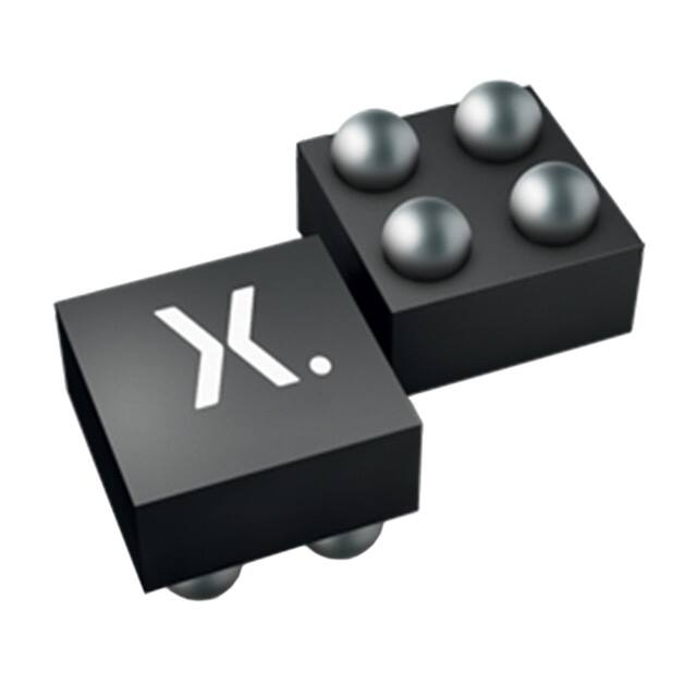

NX3P1108 Logic controlled high-side power switch Rev. 2 — 20 June 2018 Product data sheet 1. General description The NX3P1108 is a high-side load switch which features a low ON resistance P-channel MOSFET that supports more than 1.5 A of continuous current. It has an integrated output discharge resistor to discharge the output capacitance when disabled. Designed for operation from 0.9 V to 3.6 V, it is used in power domain isolation applications to reduce power dissipation and extend battery life. The enable logic includes integrated logic level translation making the device compatible with lower voltage processors and controllers. The NX3P1108 is ideal for portable, battery operated applications due to low ground current and ultra-low OFF-state current. 2. Features and benefits  Wide supply voltage range from 0.9 V to 3.6 V  Very low ON resistance:  34 m at a supply voltage of 3.3 V  High noise immunity  Low OFF-state leakage current (2.0 A maximum)  1.2 V control logic at a supply voltage of 3.6 V  High current handling capability (1.5 A continuous current)  Internal output discharge resistor  Turn-on slew rate limiting  ESD protection:  HBM JESD22-A114F Class 3A exceeds 4000 V  CDM AEC-Q100-011 revision B exceeds 500 V  Specified from 40 C to +85 C 3. Applications  Cell phone  Digital cameras and audio devices  Portable and battery-powered equipment NX3P1108 NXP Semiconductors Logic controlled high-side power switch 4. Ordering information Table 1. Ordering information Type number NX3P1108UK Package Temperature range Name Description Version 40 C to +85 C WLCSP4 wafer level chip-scale package; 4 bumps; 0.97 mm x 0.97 mm x 0.54 mm body (backside coating included) SOT1376-2 5. Marking Table 2. Marking codes Type number Marking code NX3P1108UK xB 6. Functional diagram 9287 9,1 5GFK /(9(/6+,)7 6/(:5$7(&21752/ $1'/2$'',6&+$5*( (1 EN VIN VOUT 001aao342 Fig 1. DDD Logic symbol Fig 2. Logic diagram (simplified schematic) 7. Pinning information 7.1 Pinning 1;3 EXPS$ LQGH[DUHD  $ %  Product data sheet $ 9287 9,1 % *1' (1 7UDQVSDUHQWWRSYLHZ Pin configuration for WLCSP4 NX3P1108  DDD DDD 7UDQVSDUHQWWRSYLHZ Fig 3.  Fig 4. Ball mapping for WLCSP4 All information provided in this document is subject to legal disclaimers. Rev. 2 — 20 June 2018 © NXP B.V. 2018. All rights reserved. 2 of 16 NX3P1108 NXP Semiconductors Logic controlled high-side power switch 7.2 Pin description Table 3. Pin description Symbol Pin Description VOUT A1 output voltage GND B1 ground (0 V) VIN A2 input voltage EN B2 enable input (active HIGH) 8. Functional description Table 4. Function table[1] Input EN Switch L switch OFF H switch ON [1] H = HIGH voltage level; L = LOW voltage level. 9. Limiting values Table 5. Limiting values In accordance with the Absolute Maximum Rating System (IEC 60134). Voltages are referenced to GND (ground = 0 V). Symbol Parameter input voltage VI Conditions Min Max Unit input EN [1] 0.5 +4.0 V input VIN [2] 0.5 +4.0 V [2] VSW switch voltage output VOUT 0.5 VI(VIN) V IIK input clamping current input EN: VI(EN) < 0.5 V 50 - mA ISK switch clamping current input VIN: VI(VIN) < 0.5 V 50 - mA output VOUT: VO(VOUT) < 0.5 V 50 - mA output VOUT: VO(VOUT) > VI(VIN) + 0.5 V - 50 mA VSW > 0.5 V - 1500 mA 40 +125 C ISW switch current Tj(max) maximum junction temperature Tstg storage temperature Ptot total power dissipation [3] 65 +150 C - 300 mW [1] The minimum input voltage rating may be exceeded if the input current rating is observed. [2] The minimum and maximum switch voltage ratings may be exceeded if the switch clamping current rating is observed. [3] The (absolute) maximum power dissipation depends on the junction temperature Tj. Higher power dissipation is allowed in conjunction with lower ambient temperatures. The conditions to determine the specified values are Tamb = 85 C and the use of a two layer PCB. NX3P1108 Product data sheet All information provided in this document is subject to legal disclaimers. Rev. 2 — 20 June 2018 © NXP B.V. 2018. All rights reserved. 3 of 16 NX3P1108 NXP Semiconductors Logic controlled high-side power switch 10. Recommended operating conditions Table 6. Recommended operating conditions Symbol Parameter Conditions Min Max Unit VI input voltage 0.9 3.6 V Tamb ambient temperature 40 +85 C 11. Thermal characteristics Table 7. Thermal characteristics Symbol Parameter Rth(j-a) thermal resistance from junction to ambient Conditions [1][2] Typ Unit 84 K/W [1] The overall Rth(j-a) can vary depending on the board layout. To minimize the effective Rth(j-a), all pins must have a solid connection to larger Cu layer areas for example, to the power and ground layer. In multi-layer PCB applications, use the second layer to create a large heat spreader area right below the device. If this layer is either ground or power, connect it with several vias to the top layer connected to the device ground or supply. Try not to use any solder-stop varnish under the chip. [2] Rely on the measurement data given for a rough estimation of the Rth(j-a) in your application. The actual Rth(j-a) value may vary in applications using different layer stacks and layouts 12. Static characteristics Table 8. Static characteristics VI(VIN) = 0.9 V to 3.6 V, unless otherwise specified; Voltages are referenced to GND (ground = 0 V). Symbol Parameter VIH VIL HIGH-level input voltage LOW-level input voltage Tamb = 25 C Conditions Tamb = 40 C to +85 C Unit Min Typ Max Min Max VI(VIN) = 0.9 V to 1.1 V - - - 0.8 - V VI(VIN) = 1.1 V to 1.3 V - - - 1.0 - V VI(VIN) = 1.3 V to 1.8 V - - - 1.1 - V VI(VIN) = 1.8 V to 3.6 V - - - 1.1 - V EN input EN input VI(VIN) = 0.9 V to 1.1 V - - - - 0.2 V VI(VIN) = 1.1 V to 1.3 V - - - - 0.3 V VI(VIN) = 1.3 V to 1.8 V - - - - 0.4 V VI(VIN) = 1.8 V to 3.6 V - - - - 0.45 V - 0.1 - - 1 A II input leakage current IGND ground current VI(EN) = 0 V or 3.6 V; VOUT open; see Figure 5 and Figure 6 - - - 2 - A IS(OFF) OFF-state leakage current VI(VIN) = 3.6 V; VI(EN) = GND; VI(VOUT) = GND; see Figure 10 and Figure 11 - 0.1 - - 2.0 A Rdch discharge resistance VOUT output; VI(VIN) = 3.3 V - 120 - - -  NX3P1108 Product data sheet VI(EN) = 0 V or 3.6 V All information provided in this document is subject to legal disclaimers. Rev. 2 — 20 June 2018 © NXP B.V. 2018. All rights reserved. 4 of 16 NX3P1108 NXP Semiconductors Logic controlled high-side power switch 12.1 Graphs DDD  DDD  ,*1' —$ ,*1' —$                      7DPE ƒ&     9, 9,1  9 VI(EN) = VI(VIN). VI(EN) = VI(VIN). (1) VI(VIN) = 3.6 V. (1) Tamb = 40 C. (2) VI(VIN) = 3.3 V. (2) Tamb = 25 C. (3) VI(VIN) = 1.2 V. (3) Tamb = 85 C. (4) VI(VIN) = 0.9 V. Fig 5. Waveform showing the ground current versus temperature Fig 6. DDD  Waveform showing the ground current versus input voltage on pin VIN DDD  ,*1' —$ ,*1' —$                           7DPE ƒ&    9, 9,1  9 VI(EN) = 1.2 V VI(EN) = 1.2 V (1) VI(VIN) = 3.6 V. (1) Tamb = 40 C. (2) VI(VIN) = 3.3 V. (2) Tamb = 85 C. (3) VI(VIN) = 1.2 V. (3) Tamb = 25 C. (4) VI(VIN) = 0.9 V. Fig 7. Waveform showing the ground current versus temperature NX3P1108 Product data sheet Fig 8. Waveform showing the ground current versus input voltage on pin VIN All information provided in this document is subject to legal disclaimers. Rev. 2 — 20 June 2018 © NXP B.V. 2018. All rights reserved. 5 of 16 NX3P1108 NXP Semiconductors Logic controlled high-side power switch DDD  ,*1' —$            9, 9(1  9 (1) Tamb = 40 C. (2) Tamb = 85 C. (3) Tamb = 25 C. Fig 9. Waveform showing the ground current versus input voltage on pin EN DDD  ,6 2)) —$                  7DPE ƒ& VI(EN) = GND. (1) VI(VIN) = 3.6 V. (2) VI(VIN) = 3.3 V. (3) VI(VIN) = 1.2 V. (4) VI(VIN) = 0.9 V. Fig 10. Waveforms showing the OFF-state leakage current versus temperature NX3P1108 Product data sheet All information provided in this document is subject to legal disclaimers. Rev. 2 — 20 June 2018 © NXP B.V. 2018. All rights reserved. 6 of 16 NX3P1108 NXP Semiconductors Logic controlled high-side power switch DDD  ,6 2)) —$             9, 9,1  9 (1) Tamb = 40 C. (2) Tamb = 25 C. (3) Tamb = 85 C. Fig 11. Waveforms showing the OFF-state leakage current versus input voltage on pin VIN 12.2 ON resistance Table 9. ON resistance At recommended operating conditions; voltages are referenced to GND (ground = 0 V). Symbol RON [1] Parameter ON resistance Tamb = 40 C to +85 C Conditions Unit Min Typ[1] Max VI(VIN) = 0.9 V - 105 140 m VI(VIN) = 1.2 V - 68 81 m VI(VIN) = 1.5 V - 55 65 m VI(VIN) = 1.8 V - 50 55 m VI(VIN) = 2.5 V - 40 44 m VI(VIN) = 3.3 V - 34 40 m VI(EN) = VI(VIN); ILOAD = 200 mA; see Figure 12, Figure 13 and Figure 14 Typical values are measured at Tamb = 25 C. NX3P1108 Product data sheet All information provided in this document is subject to legal disclaimers. Rev. 2 — 20 June 2018 © NXP B.V. 2018. All rights reserved. 7 of 16 NX3P1108 NXP Semiconductors Logic controlled high-side power switch 12.3 ON resistance test circuit and waveforms VSW EN VIH VIN VI VOUT ILOAD GND 001aao350 RON = VSW / ILOAD. Fig 12. Test circuit for measuring ON resistance DDD  DDD   521 Pȍ 521 Pȍ                    7DPE ƒ& ILOAD = 200 mA.          9, 9,1  9 VI(EN) = VI(VIN); ILOAD = 200 mA (1) VI(VIN) = 0.9 V. (1) Tamb = 40 C. (2) VI(VIN) = 1.2 V. (2) Tamb = 25 C. (3) VI(VIN) = 3.3 V. (3) Tamb = 85 C. (4) VI(VIN) = 3.6 V. Fig 13. Waveform showing the ON resistance versus temperature NX3P1108 Product data sheet Fig 14. Waveform showing the ON resistance versus input voltage All information provided in this document is subject to legal disclaimers. Rev. 2 — 20 June 2018 © NXP B.V. 2018. All rights reserved. 8 of 16 NX3P1108 NXP Semiconductors Logic controlled high-side power switch 13. Dynamic characteristics Table 10. Dynamic characteristics At recommended operating conditions; voltages are referenced to GND (ground = 0 V); for test circuit see Figure 16. Tamb = 25 C Symbol Parameter Conditions ten enable time EN to VOUT; see Figure 15 tdis ton toff tTLH tTHL disable time Unit Min Typ Max VI(VIN) = 1.8 V - 120 - s VI(VIN) = 3.3 V - 70 - s VI(VIN) = 1.8 V - 1.5 - s VI(VIN) = 3.3 V - 1.5 - s VI(VIN) = 1.8 V - 220 - s VI(VIN) = 3.3 V - 150 - s VI(VIN) = 1.8 V - 25 - s VI(VIN) = 3.3 V - 22.5 - s VI(VIN) = 1.8 V - 100 - s VI(VIN) = 3.3 V - 80 - s VI(VIN) = 1.8 V - 23.5 - s VI(VIN) = 3.3 V - 21 - s EN to VOUT; see Figure 15 turn-on time EN to VOUT; see Figure 15 turn-off time EN to VOUT; see Figure 15 LOW to HIGH output transition time HIGH to LOW output transition time VOUT; see Figure 15 VOUT; see Figure 15 13.1 Waveform and test circuits 9, (1LQSXW 90 *1' WHQ 92+ WRQ WRII WGLV 9; 9287RXWSXW 9< *1' W7/+ W7+/ DDD Measurement points are given in Table 11. Logic level: VOH is the typical output voltage that occurs with the output load. Fig 15. Switching times NX3P1108 Product data sheet All information provided in this document is subject to legal disclaimers. Rev. 2 — 20 June 2018 © NXP B.V. 2018. All rights reserved. 9 of 16 NX3P1108 NXP Semiconductors Logic controlled high-side power switch Table 11. Measurement points Supply voltage EN Input Output VI(VIN) VM VX VY 0.9 V to 3.6 V 0.5  VI 0.9  VOH 0.1  VOH (1 9287 * 9, 5/ 9,1 9(;7 &/ DDD Test data is given in Table 12. Definitions test circuit: RL = Load resistance. CL = Load capacitance including jig and probe capacitance. VEXT = External voltage for measuring switching times. Fig 16. Test circuit for measuring switching times Table 12. Test data Supply voltage EN Input Load VEXT VI CL RL 0.9 V to 3.6 V 3.3 V 0.1 F 500  DDD  9, (1 9 92 9287 9 DDD         9, (1 9 92 9287 9       W —V VI(VIN) = 1.8 V; CL = 0.1 F; RL = 500 . Fig 17. Waveform showing the enable time NX3P1108 Product data sheet    W —V VI(VIN) = 3.3 V; CL = 0.1 F; RL = 500 . Fig 18. Waveform showing the enable time All information provided in this document is subject to legal disclaimers. Rev. 2 — 20 June 2018 © NXP B.V. 2018. All rights reserved. 10 of 16 NX3P1108 NXP Semiconductors Logic controlled high-side power switch DDD  DDD  92 9287 9 9, (1 9 92 9287 9        9, (1 9        W —V VI(VIN) = 1.8 V; CL = 0.1 F; RL = 500 . Fig 19. Waveform showing the disable time NX3P1108 Product data sheet     W —V VI(VIN) = 3.3 V; CL = 0.1 F; RL = 500 . Fig 20. Waveform showing the disable time All information provided in this document is subject to legal disclaimers. Rev. 2 — 20 June 2018 © NXP B.V. 2018. All rights reserved. 11 of 16 NX3P1108 NXP Semiconductors Logic controlled high-side power switch 14. Package outline Fig 21. Package outline WLCSP4 (SOT1376-2) NX3P1108 Product data sheet All information provided in this document is subject to legal disclaimers. Rev. 2 — 20 June 2018 © NXP B.V. 2018. All rights reserved. 12 of 16 NX3P1108 NXP Semiconductors Logic controlled high-side power switch 15. Abbreviations Table 13. Abbreviations Acronym Description CDM Charged Device Model ESD ElectroStatic Discharge HBM Human Body Model MOSFET Metal-Oxide Semiconductor Field Effect Transistor 16. Revision history Table 14. Revision history Document ID Release date Data sheet status Change notice Supersedes NX3P1108 v.2 20180620 Product data sheet 201804021F01 NX3P1108 v.1 Modifications: NX3P1108 v.1 NX3P1108 Product data sheet • Figure 21 “Package outline WLCSP4 (SOT1376-2)”: Parameter A1 min/nom/max changed from 0.21/0.24/0.27 to 0.20/0.23/0.26. 20130109 Product data sheet - All information provided in this document is subject to legal disclaimers. Rev. 2 — 20 June 2018 - © NXP B.V. 2018. All rights reserved. 13 of 16 NX3P1108 NXP Semiconductors Logic controlled high-side power switch 17. Legal information 17.1 Data sheet status Document status[1][2] Product status[3] Definition Objective [short] data sheet Development This document contains data from the objective specification for product development. Preliminary [short] data sheet Qualification This document contains data from the preliminary specification. Product [short] data sheet Production This document contains the product specification. [1] Please consult the most recently issued document before initiating or completing a design. [2] The term ‘short data sheet’ is explained in section “Definitions”. [3] The product status of device(s) described in this document may have changed since this document was published and may differ in case of multiple devices. The latest product status information is available on the Internet at URL http://www.nxp.com. 17.2 Definitions Draft — The document is a draft version only. The content is still under internal review and subject to formal approval, which may result in modifications or additions. NXP Semiconductors does not give any representations or warranties as to the accuracy or completeness of information included herein and shall have no liability for the consequences of use of such information. Short data sheet — A short data sheet is an extract from a full data sheet with the same product type number(s) and title. A short data sheet is intended for quick reference only and should not be relied upon to contain detailed and full information. For detailed and full information see the relevant full data sheet, which is available on request via the local NXP Semiconductors sales office. In case of any inconsistency or conflict with the short data sheet, the full data sheet shall prevail. Product specification — The information and data provided in a Product data sheet shall define the specification of the product as agreed between NXP Semiconductors and its customer, unless NXP Semiconductors and customer have explicitly agreed otherwise in writing. In no event however, shall an agreement be valid in which the NXP Semiconductors product is deemed to offer functions and qualities beyond those described in the Product data sheet. 17.3 Disclaimers Limited warranty and liability — Information in this document is believed to be accurate and reliable. However, NXP Semiconductors does not give any representations or warranties, expressed or implied, as to the accuracy or completeness of such information and shall have no liability for the consequences of use of such information. NXP Semiconductors takes no responsibility for the content in this document if provided by an information source outside of NXP Semiconductors. In no event shall NXP Semiconductors be liable for any indirect, incidental, punitive, special or consequential damages (including - without limitation - lost profits, lost savings, business interruption, costs related to the removal or replacement of any products or rework charges) whether or not such damages are based on tort (including negligence), warranty, breach of contract or any other legal theory. Notwithstanding any damages that customer might incur for any reason whatsoever, NXP Semiconductors’ aggregate and cumulative liability towards customer for the products described herein shall be limited in accordance with the Terms and conditions of commercial sale of NXP Semiconductors. Right to make changes — NXP Semiconductors reserves the right to make changes to information published in this document, including without limitation specifications and product descriptions, at any time and without notice. This document supersedes and replaces all information supplied prior to the publication hereof. NX3P1108 Product data sheet Suitability for use — NXP Semiconductors products are not designed, authorized or warranted to be suitable for use in life support, life-critical or safety-critical systems or equipment, nor in applications where failure or malfunction of an NXP Semiconductors product can reasonably be expected to result in personal injury, death or severe property or environmental damage. NXP Semiconductors and its suppliers accept no liability for inclusion and/or use of NXP Semiconductors products in such equipment or applications and therefore such inclusion and/or use is at the customer’s own risk. Applications — Applications that are described herein for any of these products are for illustrative purposes only. NXP Semiconductors makes no representation or warranty that such applications will be suitable for the specified use without further testing or modification. Customers are responsible for the design and operation of their applications and products using NXP Semiconductors products, and NXP Semiconductors accepts no liability for any assistance with applications or customer product design. It is customer’s sole responsibility to determine whether the NXP Semiconductors product is suitable and fit for the customer’s applications and products planned, as well as for the planned application and use of customer’s third party customer(s). Customers should provide appropriate design and operating safeguards to minimize the risks associated with their applications and products. NXP Semiconductors does not accept any liability related to any default, damage, costs or problem which is based on any weakness or default in the customer’s applications or products, or the application or use by customer’s third party customer(s). Customer is responsible for doing all necessary testing for the customer’s applications and products using NXP Semiconductors products in order to avoid a default of the applications and the products or of the application or use by customer’s third party customer(s). NXP does not accept any liability in this respect. Limiting values — Stress above one or more limiting values (as defined in the Absolute Maximum Ratings System of IEC 60134) will cause permanent damage to the device. Limiting values are stress ratings only and (proper) operation of the device at these or any other conditions above those given in the Recommended operating conditions section (if present) or the Characteristics sections of this document is not warranted. Constant or repeated exposure to limiting values will permanently and irreversibly affect the quality and reliability of the device. Terms and conditions of commercial sale — NXP Semiconductors products are sold subject to the general terms and conditions of commercial sale, as published at http://www.nxp.com/profile/terms, unless otherwise agreed in a valid written individual agreement. In case an individual agreement is concluded only the terms and conditions of the respective agreement shall apply. NXP Semiconductors hereby expressly objects to applying the customer’s general terms and conditions with regard to the purchase of NXP Semiconductors products by customer. No offer to sell or license — Nothing in this document may be interpreted or construed as an offer to sell products that is open for acceptance or the grant, conveyance or implication of any license under any copyrights, patents or other industrial or intellectual property rights. All information provided in this document is subject to legal disclaimers. Rev. 2 — 20 June 2018 © NXP B.V. 2018. All rights reserved. 14 of 16 NX3P1108 NXP Semiconductors Logic controlled high-side power switch Export control — This document as well as the item(s) described herein may be subject to export control regulations. Export might require a prior authorization from competent authorities. Non-automotive qualified products — Unless this data sheet expressly states that this specific NXP Semiconductors product is automotive qualified, the product is not suitable for automotive use. It is neither qualified nor tested in accordance with automotive testing or application requirements. NXP Semiconductors accepts no liability for inclusion and/or use of non-automotive qualified products in automotive equipment or applications. In the event that customer uses the product for design-in and use in automotive applications to automotive specifications and standards, customer (a) shall use the product without NXP Semiconductors’ warranty of the product for such automotive applications, use and specifications, and (b) whenever customer uses the product for automotive applications beyond NXP Semiconductors’ specifications such use shall be solely at customer’s own risk, and (c) customer fully indemnifies NXP Semiconductors for any liability, damages or failed product claims resulting from customer design and use of the product for automotive applications beyond NXP Semiconductors’ standard warranty and NXP Semiconductors’ product specifications. Translations — A non-English (translated) version of a document is for reference only. The English version shall prevail in case of any discrepancy between the translated and English versions. 17.4 Trademarks Notice: All referenced brands, product names, service names and trademarks are the property of their respective owners. 18. Contact information For more information, please visit: http://www.nxp.com For sales office addresses, please send an email to: salesaddresses@nxp.com NX3P1108 Product data sheet All information provided in this document is subject to legal disclaimers. Rev. 2 — 20 June 2018 © NXP B.V. 2018. All rights reserved. 15 of 16 NX3P1108 NXP Semiconductors Logic controlled high-side power switch 19. Contents 1 2 3 4 5 6 7 7.1 7.2 8 9 10 11 12 12.1 12.2 12.3 13 13.1 14 15 16 17 17.1 17.2 17.3 17.4 18 19 General description . . . . . . . . . . . . . . . . . . . . . . 1 Features and benefits . . . . . . . . . . . . . . . . . . . . 1 Applications . . . . . . . . . . . . . . . . . . . . . . . . . . . . 1 Ordering information . . . . . . . . . . . . . . . . . . . . . 2 Marking . . . . . . . . . . . . . . . . . . . . . . . . . . . . . . . . 2 Functional diagram . . . . . . . . . . . . . . . . . . . . . . 2 Pinning information . . . . . . . . . . . . . . . . . . . . . . 2 Pinning . . . . . . . . . . . . . . . . . . . . . . . . . . . . . . . 2 Pin description . . . . . . . . . . . . . . . . . . . . . . . . . 3 Functional description . . . . . . . . . . . . . . . . . . . 3 Limiting values. . . . . . . . . . . . . . . . . . . . . . . . . . 3 Recommended operating conditions. . . . . . . . 4 Thermal characteristics . . . . . . . . . . . . . . . . . . 4 Static characteristics. . . . . . . . . . . . . . . . . . . . . 4 Graphs . . . . . . . . . . . . . . . . . . . . . . . . . . . . . . . 5 ON resistance . . . . . . . . . . . . . . . . . . . . . . . . . . 7 ON resistance test circuit and waveforms . . . . 8 Dynamic characteristics . . . . . . . . . . . . . . . . . . 9 Waveform and test circuits . . . . . . . . . . . . . . . . 9 Package outline . . . . . . . . . . . . . . . . . . . . . . . . 12 Abbreviations . . . . . . . . . . . . . . . . . . . . . . . . . . 13 Revision history . . . . . . . . . . . . . . . . . . . . . . . . 13 Legal information. . . . . . . . . . . . . . . . . . . . . . . 14 Data sheet status . . . . . . . . . . . . . . . . . . . . . . 14 Definitions . . . . . . . . . . . . . . . . . . . . . . . . . . . . 14 Disclaimers . . . . . . . . . . . . . . . . . . . . . . . . . . . 14 Trademarks. . . . . . . . . . . . . . . . . . . . . . . . . . . 15 Contact information. . . . . . . . . . . . . . . . . . . . . 15 Contents . . . . . . . . . . . . . . . . . . . . . . . . . . . . . . 16 Please be aware that important notices concerning this document and the product(s) described herein, have been included in section ‘Legal information’. © NXP B.V. 2018. All rights reserved. For more information, please visit: http://www.nxp.com For sales office addresses, please send an email to: salesaddresses@nxp.com Date of release: 20 June 2018 Document identifier: NX3P1108
