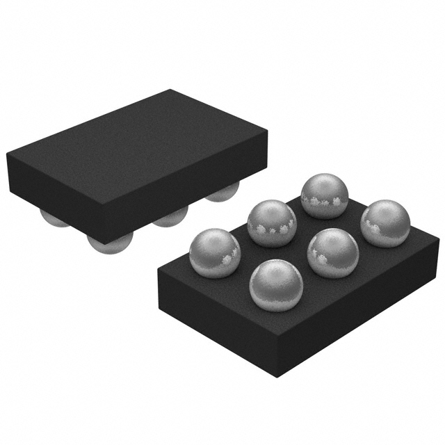

NX5P2924C Logic controlled high-side power switch Rev. 2 — 8 October 2015 Product data sheet 1. General description The NX5P2924C is a high-side load switch which features a low ON resistance N-channel MOSFET with controlled slew rate that supports 2.5 A of continuous current. Designed for operation from 0.8 V to 5.5 V, it is used in power domain isolation applications to reduce power dissipation and extend battery life. An output pull-down transistor has been integrated for fast discharge of capacitive load. The enable logic includes integrated logic level translation making the device compatible with lower voltage processors and controllers. The NX5P2924C is ideal for portable, battery operated applications due to low ground current. 2. Features and benefits  Wide supply voltage range from 0.8 V to 5.5 V  Very low ON resistance:  18 m (typical) at a supply voltage of 1.2 V  18 m (typical) at a supply voltage of 1.8 V  High noise immunity  High current handling capability (2.5 A continuous current)  Reverse current protection  Turn-on slew rate limiting  ESD protection:  HBM JESD22-A114F Class 3A exceeds 5000 V  CDM AEC-Q100-011 revision B exceeds 1000 V  Specified from 40 C to +85 C 3. Applications  Cell phone  Digital cameras and audio devices  Portable and battery-powered equipment NX5P2924C NXP Semiconductors Logic controlled high-side power switch 4. Ordering information Table 1. Ordering information Type number NX5P2924CUK Package Temperature range Name Description Version 40 C to +85 C WLCSP6 wafer level chip-scale package; 6 bumps; 0.87  1.37  0.5 mm NX5P2924C 5. Marking Table 2. Marking codes Type number Marking code NX5P2924CUK 4C 6. Functional diagram EN VIN VOUT 001aao342 Fig 1. Logic symbol 9,1 9287 5GFK (1 &+$5*(3803 6/(:5$7(&21752/ $1'/2$'',6&+$5*( DDD Fig 2. Logic diagram NX5P2924C Product data sheet All information provided in this document is subject to legal disclaimers. Rev. 2 — 8 October 2015 © NXP Semiconductors N.V. 2015. All rights reserved. 2 of 20 NX5P2924C NXP Semiconductors Logic controlled high-side power switch 7. Pinning information 7.1 Pinning bump A1 index area 1 2   A $ 9287 9,1 B % 9287 9,1 C & *1' (1 Transparent top view 7UDQVSDUHQWWRSYLHZ aaa-018031 Fig 3. Pin configuration for WLCSP6 DDD Fig 4. Ball mapping for WLCSP6 7.2 Pin description Table 3. Pin description Symbol Pin Description VIN A2, B2 input voltage GND C1 ground (0 V) EN C2 enable input (active HIGH) VOUT A1, B1 output voltage 8. Functional description Table 4. Function table[1] Input EN Switch L switch OFF H switch ON [1] H = HIGH voltage level; L = LOW voltage level. NX5P2924C Product data sheet All information provided in this document is subject to legal disclaimers. Rev. 2 — 8 October 2015 © NXP Semiconductors N.V. 2015. All rights reserved. 3 of 20 NX5P2924C NXP Semiconductors Logic controlled high-side power switch 9. Application diagram The NX5P2924C is typically used in portable, battery operated device. Pin EN enables the NX5P2924C. Slew rate controlled in-rush current reduction circuits function during switching. The VOUT discharge circuit will be active when NX5P2924C main FET is switched off by pulling EN pin low. The circuit will discharge the VOUT voltage through approximately 1.3 k resistance to GND. The discharge circuit will automatically be disconnected after VOUT drops below 10 % of the rail. VIN VOUT NX5P2924C EN CIN 1.0 µF COUT 0.1 µF EN GND aaa-018032 Fig 5. NX5P2924C application diagram NX5P2924C Product data sheet All information provided in this document is subject to legal disclaimers. Rev. 2 — 8 October 2015 © NXP Semiconductors N.V. 2015. All rights reserved. 4 of 20 NX5P2924C NXP Semiconductors Logic controlled high-side power switch 10. Limiting values Table 5. Limiting values In accordance with the Absolute Maximum Rating System (IEC 60134). Voltages are referenced to GND (ground = 0 V). Symbol Parameter input voltage VI Conditions Min Max Unit input EN [1] 0.5 +6.0 V 0.5 +6.0 V 0.5 VI(VIN) V input VIN [2] VSW switch voltage output VOUT [2] IIK input clamping current input EN: VI(EN) < 0.5 V 50 - mA ISK switch clamping current input VIN: VI(VIN) < 0.5 V 50 - mA switch current ISW Tj(max) maximum junction temperature Tstg storage temperature output VOUT: VO(VOUT) < 0.5 V 50 - mA output VOUT: VO(VOUT) > VI(VIN) 0.5 V - 50 mA VSW > 0.5 V - 2500 mA pulsed, 100 ms pulse, 2 % duty cycle - 5000 mA 40 +125 C 65 +150 C - 470 mW [3] total power dissipation Ptot [1] The minimum input voltage rating may be exceeded if the input current rating is observed. [2] The minimum and maximum switch voltage ratings may be exceeded if the switch clamping current rating is observed. [3] The (absolute) maximum power dissipation depends on the junction temperature Tj. Higher power dissipation is allowed in conjunction with lower ambient temperatures. The conditions to determine the specified values are Tamb = 85 °C and the use of a two layer PCB. 11. Recommended operating conditions Table 6. Recommended operating conditions Symbol Parameter VI Tamb input voltage Conditions Min Max Unit input EN 0 5.5 V input VIN 0.8 5.5 V 40 +85 C ambient temperature NX5P2924C Product data sheet All information provided in this document is subject to legal disclaimers. Rev. 2 — 8 October 2015 © NXP Semiconductors N.V. 2015. All rights reserved. 5 of 20 NX5P2924C NXP Semiconductors Logic controlled high-side power switch 12. Thermal characteristics Table 7. Symbol Rth(j-a) [1] Thermal characteristics Parameter Conditions [1] thermal resistance from junction to ambient Typ Unit 139 K/W Rth(j-a) is dependent upon board layout. To minimize Rth(j-a), ensure that all pins have a solid connection to larger copper layer areas. In multi-layer PCBs, the second layer should be used to create a large heat spreader area below the device. Avoid using solder-stop varnish under the device. 13. Static characteristics Table 8. Static characteristics VI(VIN) = 1.0 V to 5.5 V, unless otherwise specified; Voltages are referenced to GND (ground = 0 V). Symbol Parameter VIH VIL HIGH-level input voltage LOW-level input voltage Tamb = 25 C Conditions Tamb = 40 C to +85 C Unit Min Typ[1] Max Min Max EN input; VI(VIN) = 0.8 V 0.6 - - 0.6 - V EN input; VI(VIN) = 1.0 V to 1.2 V 0.9 - - 0.9 - V EN input; VI(VIN) = 1.2 V to 2.5 V 1.2 - - 1.2 - V EN input; VI(VIN) = 2.5 V to 5.5 V 1.2 - - 1.2 - V EN input; VI(VIN) = 0.8 V - - 0.25 - 0.25 V EN input; VI(VIN) = 1.0 V to 1.2 V - - 0.3 - 0.3 V EN input; VI(VIN) = 1.2 V to 2.5 V - - 0.4 - 0.4 V EN input; VI(VIN) = 2.5 V to 5.5 V - - 0.6 - 0.6 V II input leakage current EN input; VI(EN) = 0.9 V to 5.5 V - - - - 0.1 A Rdch discharge resistance VOUT output; VI(VIN) = 0.8 V - 4.00 - - - k VOUT output; VI(VIN) = 1.0 V - 1.40 - - - k VOUT output; VI(VIN) = 1.2 V - 1.30 - - - k VOUT output; VI(VIN) = 1.8 V - 1.27 1.50 - - k VOUT output; VI(VIN) = 3.3 V - 1.25 1.50 - - k VOUT output; VI(VIN) = 5.5 V - 1.25 1.50 - - k EN = HIGH; VI(VIN) = 1.0 V; see Figure 6 and Figure 7 - 35 - - 50 A EN = HIGH; VI(VIN) = 1.8 V; see Figure 6 and Figure 7 - 35 - - 50 A EN = HIGH; VI(VIN) = 3.6 V; see Figure 6 and Figure 7 - 50 - - 70 A EN = HIGH; VI(VIN) = 5.5 V; see Figure 6 and Figure 7 - 85 - - 110 A EN = LOW; - 0.1 - - 1.5 A IDD supply current VOUT open see Figure 8 and Figure 9 NX5P2924C Product data sheet All information provided in this document is subject to legal disclaimers. Rev. 2 — 8 October 2015 © NXP Semiconductors N.V. 2015. All rights reserved. 6 of 20 NX5P2924C NXP Semiconductors Logic controlled high-side power switch Table 8. Static characteristics …continued VI(VIN) = 1.0 V to 5.5 V, unless otherwise specified; Voltages are referenced to GND (ground = 0 V). …continued Symbol Parameter IS(OFF) Tamb = 25 C Conditions OFF-state leakage current Tamb = 40 C to +85 C Unit Min Typ[1] Max Min Max EN = LOW; VI(VIN) = 1.8 V; VI(VOUT) = 0 V; see Figure 10 and Figure 11 - 0.5 - 3.5 - A EN = LOW; VI(VIN) = 3.6 V; VI(VOUT) = 0 V; see Figure 10 and Figure 11 - 0.5 - 5.0 - A EN = LOW; VI(VIN) = 5.5 V; VI(VOUT) = 0 V; see Figure 10 and Figure 11 - 0.5 - 7.5 - A CI input capacitance EN - 3 - - - pF CS(ON) ON-state capacitance - - 0.5 - 0.5 nF [1] VIN; VOUT All typical values are measured at VI(VIN) = 3.6 V and Tamb = 25 C unless otherwise specified. 13.1 Graphs DDD  , 9,1 X$               DDD  , 9,1 X$     7DPE ƒ&           9, 9,1  9  VI(EN) = VI(VIN). VI(EN) = VI(VIN). (1) VI(VIN) = 5.5 V. (1) Tamb = +85 C. (2) VI(VIN) = 3.6 V. (2) Tamb = +25 C. (3) VI(VIN) = 1.8 V. (3) Tamb = 40 C. (4) VI(VIN) = 1.0 V. Fig 6. Typical supply current versus temperature NX5P2924C Product data sheet Fig 7. Typical supply current versus input voltage on pin VIN All information provided in this document is subject to legal disclaimers. Rev. 2 — 8 October 2015 © NXP Semiconductors N.V. 2015. All rights reserved. 7 of 20 NX5P2924C NXP Semiconductors Logic controlled high-side power switch DDD  , 9,1 Q$ DDD  , 9,1 Q$                       7DPE R&   VI(EN) = GND.     9, 9,1  9  VI(EN) = GND. (1) VI(VIN) = 5.5 V. (1) Tamb = +85 C. (2) VI(VIN) = 3.6 V. (2) Tamb = +25 C. (3) VI(VIN) = 1.8 V. (3) Tamb = 40 C. (4) VI(VIN) = 1.0 V. Fig 8. Typical supply current versus temperature DDD  , 9,1 Q$ Fig 9. Typical supply current versus input voltage on pin VIN      DDD  , 9,1 Q$                 7DPE R&    (1) VI(VIN) = 1.8 V. (1) Tamb = +85 C. (2) VI(VIN) = 3.6 V. (2) Tamb = +25 C. (3) VI(VIN) = 5.5 V. (3) Tamb = 40 C. Fig 10. Typical OFF-state leakage current versus temperature NX5P2924C Product data sheet    9, 9,1  9  Fig 11. Typical OFF-state leakage current versus input voltage on pin VIN All information provided in this document is subject to legal disclaimers. Rev. 2 — 8 October 2015 © NXP Semiconductors N.V. 2015. All rights reserved. 8 of 20 NX5P2924C NXP Semiconductors Logic controlled high-side power switch 13.2 ON resistance Table 9. ON resistance At recommended operating conditions; voltages are referenced to GND (ground = 0 V) Symbol Parameter Tamb = 25 C Conditions Tamb = 40 C to +85 C Unit Min Typ Max Min Max VI(VIN) = 0.8 V - 21 - - 26 m VI(VIN) = 0.9 V - 19 - - 24 m VI(VIN) = 1.0 V to 5.5 V - 18 - - 23 m ON resistance VI(EN) = 1.5 V; ILOAD = 200 mA; see Figure 12, 13 and 14 RON 13.3 ON resistance test circuit and graphs VSW EN VIH VIN VOUT VI ILOAD GND 001aao350 RON = VSW / ILOAD. Fig 12. Test circuit for measuring ON resistance DDD  521 Pȍ DDD  , 9,1 Q$                      7DPE ƒ&     (1) VI(VIN) = 1.0 V. (1) Tamb = +85 C. (2) VI(VIN) = 3.6 V. (2) Tamb = +25 C. (3) VI(VIN) = 5.5 V. (3) Tamb = 40 C. Fig 13. ON resistance versus temperature NX5P2924C Product data sheet    7DPE R&  Fig 14. ON resistance versus input voltage All information provided in this document is subject to legal disclaimers. Rev. 2 — 8 October 2015 © NXP Semiconductors N.V. 2015. All rights reserved. 9 of 20 NX5P2924C NXP Semiconductors Logic controlled high-side power switch 14. Dynamic characteristics Table 10. Dynamic characteristics At recommended operating conditions; voltages are referenced to GND (ground = 0 V); for test circuit, see Figure 16. Symbol ten tdis ton toff tTLH tTHL Parameter enable time disable time turn-on time turn-off time LOW to HIGH output transition time HIGH to LOW output transition time NX5P2924C Product data sheet Tamb = 25 C Conditions Tamb = 40 C to +85 C Unit Min Typ Max Min Max VI(VIN) = 0.8 V - 630 - - - s VI(VIN) = 1.0 V - 530 - 270 - s VI(VIN) = 3.6 V - 510 - 330 - s VI(VIN) = 5.5 V - 510 - 350 - s EN to VOUT; see Figure 15, 17, 18 and 19 EN to VOUT; see Figure 15 and 20 VI(VIN) = 0.8 V - 90 - - - s VI(VIN) = 1.0 V - 18 - - - s VI(VIN) = 3.6 V - 4 - - - s VI(VIN) = 5.5 V - 3 - - - s VI(VIN) = 0.8 V - 990 - - - s VI(VIN) = 1.0 V - 940 - 520 - s VI(VIN) = 3.6 V - 1290 - 830 - s VI(VIN) = 5.5 V - 1480 - 1020 - s EN to VOUT; see Figure 15, 17, 18 and 19 s EN to VOUT; see Figure 15 and 20 VI(VIN) = 0.8 V - 100 - - - s VI(VIN) = 1.0 V - 20 - - - s VI(VIN) = 3.6 V - 6 - - - s VI(VIN) = 5.5 V - 5 - - - s VI(VIN) = 0.8 V - 360 - - - s VI(VIN) = 1.0 V - 410 - 160 - s VI(VIN) = 3.6 V - 780 - 430 - s VI(VIN) = 5.5 V - 970 - 590 - s VI(VIN) = 0.8 V - 5 - - - s VI(VIN) = 1.0 V - 2.2 - - - s VI(VIN) = 3.6 V - 2.2 - - - s VI(VIN) = 5.5 V - 2.2 - - - s VOUT; see Figure 15 VOUT; see Figure 15 All information provided in this document is subject to legal disclaimers. Rev. 2 — 8 October 2015 © NXP Semiconductors N.V. 2015. All rights reserved. 10 of 20 NX5P2924C NXP Semiconductors Logic controlled high-side power switch 14.1 Waveforms, graphs and test circuit 9, (1LQSXW 90 *1' WRQ WRII WGLV WHQ 92+ 9< 9< 9287RXWSXW 9; *1' 9; W7/+ W7+/ DDD Measurement points are given in Table 11. Logic level: VOH is the typical output voltage that occurs with the output load. Fig 15. Switching times Table 11. Measurement points Supply voltage EN Input Output VI(VIN) VM VX VY 1.0 V to 5.5 V 0.5  VI(EN) 0.1  VOH 0.9  VOH (1 9287 * 9, 5/ 9,1 &/ 9(;7 DDD Test data is given in Table 12. Definitions test circuit: RL = Load resistance. CL = Load capacitance including jig and probe capacitance. VEXT = External voltage for measuring switching times. Fig 16. Test circuit for measuring switching times Table 12. Test data Supply voltage Input Load VEXT VI(EN) CL RL 1.0 V to 5.5 V 1.5 V 0.1 F 10  NX5P2924C Product data sheet All information provided in this document is subject to legal disclaimers. Rev. 2 — 8 October 2015 © NXP Semiconductors N.V. 2015. All rights reserved. 11 of 20 NX5P2924C NXP Semiconductors Logic controlled high-side power switch DDD  9287(1 9   ,, 9,1 P$  DDD  9287(1 9  ,, 9,1 P$                             W PV     VI(VIN) = 1 V; RL = 10 ; CL = 0.1 F; Tamb = 25 C. (1) VOUT (2) EN (2) EN (3) II(VIN) (3) II(VIN) DDD  9287(1 9    ,, 9,1 P$      W PV   VI(VIN) = 3.6 V; RL = 10 ; CL = 0.1 F; Tamb = 25 C. (1) VOUT Fig 17. Typical enable time at VI(VIN) = 1 V; CL = 0.1 F  Fig 18. Typical enable time at VI(VIN) = 3.6 V; CL = 0.1 F DDD  9287(1 9                      W PV   VI(VIN) = 5.5 V; RL = 10 ; CL = 0.1 F; Tamb = 25 C.        RL = 10 ; CL = 0.1 F; Tamb = 25 C (1) VOUT (1) VI(VIN) = 5.5 V (2) EN (2) VI(VIN) = 3.6 V (3) II(VIN) (3) VI(VIN) = 1.0 V (4) EN Fig 19. Typical enable time at VI(VIN) = 5.5 V; CL = 0.1 F NX5P2924C Product data sheet Fig 20. Typical disable time All information provided in this document is subject to legal disclaimers. Rev. 2 — 8 October 2015 © NXP Semiconductors N.V. 2015. All rights reserved. 12 of 20 NX5P2924C NXP Semiconductors Logic controlled high-side power switch DDD  9287(1 9     ,, 9,1 P$ DDD  9287(1 9                     W PV   VI(VIN) = 3.6 V; RL = 10 ; CL = 20 F; Tamb = 25 C.       W PV  VI(VIN) = 3.6 V; RL = 10 ; CL = 20 F; Tamb = 25 C (1) VOUT (1) VOUT (2) EN (2) EN (3) II(VIN) Fig 21. Typical enable time at VI(VIN) = 3.6 V; CL = 20 F NX5P2924C Product data sheet Fig 22. Typical disable time at VI(VIN) = 3.6 V; CL = 20 F All information provided in this document is subject to legal disclaimers. Rev. 2 — 8 October 2015 © NXP Semiconductors N.V. 2015. All rights reserved. 13 of 20 NX5P2924C NXP Semiconductors Logic controlled high-side power switch 15. Package outline :/&63ZDIHUOHYHOFKLSVFDOHSDFNDJHEXPSV[[PP $ ( 1;3& % EDOO$ LQGH[DUHD $ ' $ $ GHWDLO; H & ‘Y ‘Z E & $ % & \ & H H % $  EDOO$ LQGH[DUHD  ;  PP VFDOH 'LPHQVLRQV PPDUHWKHRULJLQDOGLPHQVLRQV 8QLW PP $ PD[  QRP PLQ $ $ E ' ( H H                  Y Z \    ZOFVSBQ[SFBSR 2XWOLQH YHUVLRQ 5HIHUHQFHV ,(& -('(& -(,7$ (XURSHDQ SURMHFWLRQ ,VVXHGDWH   1;3& Fig 23. Package outline NX5P2924C NX5P2924C Product data sheet All information provided in this document is subject to legal disclaimers. Rev. 2 — 8 October 2015 © NXP Semiconductors N.V. 2015. All rights reserved. 14 of 20 NX5P2924C NXP Semiconductors Logic controlled high-side power switch 16. Soldering of WLCSP packages 16.1 Introduction to soldering WLCSP packages This text provides a very brief insight into a complex technology. A more in-depth account of soldering WLCSP (Wafer Level Chip-Size Packages) can be found in application note AN10439 “Wafer Level Chip Scale Package” and in application note AN10365 “Surface mount reflow soldering description”. Wave soldering is not suitable for this package. All NXP WLCSP packages are lead-free. 16.2 Board mounting Board mounting of a WLCSP requires several steps: 1. Solder paste printing on the PCB 2. Component placement with a pick and place machine 3. The reflow soldering itself 16.3 Reflow soldering Key characteristics in reflow soldering are: • Lead-free versus SnPb soldering; note that a lead-free reflow process usually leads to higher minimum peak temperatures (see Figure 24) than a SnPb process, thus reducing the process window • Solder paste printing issues, such as smearing, release, and adjusting the process window for a mix of large and small components on one board • Reflow temperature profile; this profile includes preheat, reflow (in which the board is heated to the peak temperature), and cooling down. It is imperative that the peak temperature is high enough for the solder to make reliable solder joints (a solder paste characteristic) while being low enough that the packages and/or boards are not damaged. The peak temperature of the package depends on package thickness and volume and is classified in accordance with Table 13. Table 13. Lead-free process (from J-STD-020D) Package thickness (mm) Package reflow temperature (C) Volume (mm3) < 350 350 to 2000 > 2000 < 1.6 260 260 260 1.6 to 2.5 260 250 245 > 2.5 250 245 245 Moisture sensitivity precautions, as indicated on the packing, must be respected at all times. Studies have shown that small packages reach higher temperatures during reflow soldering, see Figure 24. NX5P2924C Product data sheet All information provided in this document is subject to legal disclaimers. Rev. 2 — 8 October 2015 © NXP Semiconductors N.V. 2015. All rights reserved. 15 of 20 NX5P2924C NXP Semiconductors Logic controlled high-side power switch maximum peak temperature = MSL limit, damage level temperature minimum peak temperature = minimum soldering temperature peak temperature time 001aac844 MSL: Moisture Sensitivity Level Fig 24. Temperature profiles for large and small components For further information on temperature profiles, refer to application note AN10365 “Surface mount reflow soldering description”. 16.3.1 Stand off The stand off between the substrate and the chip is determined by: • The amount of printed solder on the substrate • The size of the solder land on the substrate • The bump height on the chip The higher the stand off, the better the stresses are released due to TEC (Thermal Expansion Coefficient) differences between substrate and chip. 16.3.2 Quality of solder joint A flip-chip joint is considered to be a good joint when the entire solder land has been wetted by the solder from the bump. The surface of the joint should be smooth and the shape symmetrical. The soldered joints on a chip should be uniform. Voids in the bumps after reflow can occur during the reflow process in bumps with high ratio of bump diameter to bump height, i.e. low bumps with large diameter. No failures have been found to be related to these voids. Solder joint inspection after reflow can be done with X-ray to monitor defects such as bridging, open circuits and voids. 16.3.3 Rework In general, rework is not recommended. By rework we mean the process of removing the chip from the substrate and replacing it with a new chip. If a chip is removed from the substrate, most solder balls of the chip will be damaged. In that case it is recommended not to re-use the chip again. NX5P2924C Product data sheet All information provided in this document is subject to legal disclaimers. Rev. 2 — 8 October 2015 © NXP Semiconductors N.V. 2015. All rights reserved. 16 of 20 NX5P2924C NXP Semiconductors Logic controlled high-side power switch Device removal can be done when the substrate is heated until it is certain that all solder joints are molten. The chip can then be carefully removed from the substrate without damaging the tracks and solder lands on the substrate. Removing the device must be done using plastic tweezers, because metal tweezers can damage the silicon. The surface of the substrate should be carefully cleaned and all solder and flux residues and/or underfill removed. When a new chip is placed on the substrate, use the flux process instead of solder on the solder lands. Apply flux on the bumps at the chip side as well as on the solder pads on the substrate. Place and align the new chip while viewing with a microscope. To reflow the solder, use the solder profile shown in application note AN10365 “Surface mount reflow soldering description”. 16.3.4 Cleaning Cleaning can be done after reflow soldering. 17. Abbreviations Table 14. Abbreviations Acronym Description CDM Charged Device Model DUT Device Under Test ESD ElectroStatic Discharge HBM Human Body Model IEC International Electrotechnical Commission MOSFET Metal-Oxide Semiconductor Field Effect Transistor 18. Revision history Table 15. Revision history Document ID Release date Data sheet status Change notice Supersedes NX5P2924C v.2 20151008 Product data sheet - NX5P2924C v.1 - - Modifications: NX5P2924C v.1 NX5P2924C Product data sheet • Paragraph added, see Section 9. 20150707 Product data sheet All information provided in this document is subject to legal disclaimers. Rev. 2 — 8 October 2015 © NXP Semiconductors N.V. 2015. All rights reserved. 17 of 20 NX5P2924C NXP Semiconductors Logic controlled high-side power switch 19. Legal information 19.1 Data sheet status Document status[1][2] Product status[3] Definition Objective [short] data sheet Development This document contains data from the objective specification for product development. Preliminary [short] data sheet Qualification This document contains data from the preliminary specification. Product [short] data sheet Production This document contains the product specification. [1] Please consult the most recently issued document before initiating or completing a design. [2] The term ‘short data sheet’ is explained in section “Definitions”. [3] The product status of device(s) described in this document may have changed since this document was published and may differ in case of multiple devices. The latest product status information is available on the Internet at URL http://www.nxp.com. 19.2 Definitions Draft — The document is a draft version only. The content is still under internal review and subject to formal approval, which may result in modifications or additions. NXP Semiconductors does not give any representations or warranties as to the accuracy or completeness of information included herein and shall have no liability for the consequences of use of such information. Short data sheet — A short data sheet is an extract from a full data sheet with the same product type number(s) and title. A short data sheet is intended for quick reference only and should not be relied upon to contain detailed and full information. For detailed and full information see the relevant full data sheet, which is available on request via the local NXP Semiconductors sales office. In case of any inconsistency or conflict with the short data sheet, the full data sheet shall prevail. Product specification — The information and data provided in a Product data sheet shall define the specification of the product as agreed between NXP Semiconductors and its customer, unless NXP Semiconductors and customer have explicitly agreed otherwise in writing. In no event however, shall an agreement be valid in which the NXP Semiconductors product is deemed to offer functions and qualities beyond those described in the Product data sheet. 19.3 Disclaimers Limited warranty and liability — Information in this document is believed to be accurate and reliable. However, NXP Semiconductors does not give any representations or warranties, expressed or implied, as to the accuracy or completeness of such information and shall have no liability for the consequences of use of such information. NXP Semiconductors takes no responsibility for the content in this document if provided by an information source outside of NXP Semiconductors. In no event shall NXP Semiconductors be liable for any indirect, incidental, punitive, special or consequential damages (including - without limitation - lost profits, lost savings, business interruption, costs related to the removal or replacement of any products or rework charges) whether or not such damages are based on tort (including negligence), warranty, breach of contract or any other legal theory. Notwithstanding any damages that customer might incur for any reason whatsoever, NXP Semiconductors’ aggregate and cumulative liability towards customer for the products described herein shall be limited in accordance with the Terms and conditions of commercial sale of NXP Semiconductors. Right to make changes — NXP Semiconductors reserves the right to make changes to information published in this document, including without limitation specifications and product descriptions, at any time and without notice. This document supersedes and replaces all information supplied prior to the publication hereof. NX5P2924C Product data sheet Suitability for use — NXP Semiconductors products are not designed, authorized or warranted to be suitable for use in life support, life-critical or safety-critical systems or equipment, nor in applications where failure or malfunction of an NXP Semiconductors product can reasonably be expected to result in personal injury, death or severe property or environmental damage. NXP Semiconductors and its suppliers accept no liability for inclusion and/or use of NXP Semiconductors products in such equipment or applications and therefore such inclusion and/or use is at the customer’s own risk. Applications — Applications that are described herein for any of these products are for illustrative purposes only. NXP Semiconductors makes no representation or warranty that such applications will be suitable for the specified use without further testing or modification. Customers are responsible for the design and operation of their applications and products using NXP Semiconductors products, and NXP Semiconductors accepts no liability for any assistance with applications or customer product design. It is customer’s sole responsibility to determine whether the NXP Semiconductors product is suitable and fit for the customer’s applications and products planned, as well as for the planned application and use of customer’s third party customer(s). Customers should provide appropriate design and operating safeguards to minimize the risks associated with their applications and products. NXP Semiconductors does not accept any liability related to any default, damage, costs or problem which is based on any weakness or default in the customer’s applications or products, or the application or use by customer’s third party customer(s). Customer is responsible for doing all necessary testing for the customer’s applications and products using NXP Semiconductors products in order to avoid a default of the applications and the products or of the application or use by customer’s third party customer(s). NXP does not accept any liability in this respect. Limiting values — Stress above one or more limiting values (as defined in the Absolute Maximum Ratings System of IEC 60134) will cause permanent damage to the device. Limiting values are stress ratings only and (proper) operation of the device at these or any other conditions above those given in the Recommended operating conditions section (if present) or the Characteristics sections of this document is not warranted. Constant or repeated exposure to limiting values will permanently and irreversibly affect the quality and reliability of the device. Terms and conditions of commercial sale — NXP Semiconductors products are sold subject to the general terms and conditions of commercial sale, as published at http://www.nxp.com/profile/terms, unless otherwise agreed in a valid written individual agreement. In case an individual agreement is concluded only the terms and conditions of the respective agreement shall apply. NXP Semiconductors hereby expressly objects to applying the customer’s general terms and conditions with regard to the purchase of NXP Semiconductors products by customer. No offer to sell or license — Nothing in this document may be interpreted or construed as an offer to sell products that is open for acceptance or the grant, conveyance or implication of any license under any copyrights, patents or other industrial or intellectual property rights. All information provided in this document is subject to legal disclaimers. Rev. 2 — 8 October 2015 © NXP Semiconductors N.V. 2015. All rights reserved. 18 of 20 NX5P2924C NXP Semiconductors Logic controlled high-side power switch Export control — This document as well as the item(s) described herein may be subject to export control regulations. Export might require a prior authorization from competent authorities. Non-automotive qualified products — Unless this data sheet expressly states that this specific NXP Semiconductors product is automotive qualified, the product is not suitable for automotive use. It is neither qualified nor tested in accordance with automotive testing or application requirements. NXP Semiconductors accepts no liability for inclusion and/or use of non-automotive qualified products in automotive equipment or applications. In the event that customer uses the product for design-in and use in automotive applications to automotive specifications and standards, customer (a) shall use the product without NXP Semiconductors’ warranty of the product for such automotive applications, use and specifications, and (b) whenever customer uses the product for automotive applications beyond NXP Semiconductors’ specifications such use shall be solely at customer’s own risk, and (c) customer fully indemnifies NXP Semiconductors for any liability, damages or failed product claims resulting from customer design and use of the product for automotive applications beyond NXP Semiconductors’ standard warranty and NXP Semiconductors’ product specifications. Translations — A non-English (translated) version of a document is for reference only. The English version shall prevail in case of any discrepancy between the translated and English versions. 19.4 Trademarks Notice: All referenced brands, product names, service names and trademarks are the property of their respective owners. 20. Contact information For more information, please visit: http://www.nxp.com For sales office addresses, please send an email to: salesaddresses@nxp.com NX5P2924C Product data sheet All information provided in this document is subject to legal disclaimers. Rev. 2 — 8 October 2015 © NXP Semiconductors N.V. 2015. All rights reserved. 19 of 20 NX5P2924C NXP Semiconductors Logic controlled high-side power switch 21. Contents 1 2 3 4 5 6 7 7.1 7.2 8 9 10 11 12 13 13.1 13.2 13.3 14 14.1 15 16 16.1 16.2 16.3 16.3.1 16.3.2 16.3.3 16.3.4 17 18 19 19.1 19.2 19.3 19.4 20 21 General description . . . . . . . . . . . . . . . . . . . . . . 1 Features and benefits . . . . . . . . . . . . . . . . . . . . 1 Applications . . . . . . . . . . . . . . . . . . . . . . . . . . . . 1 Ordering information . . . . . . . . . . . . . . . . . . . . . 2 Marking . . . . . . . . . . . . . . . . . . . . . . . . . . . . . . . . 2 Functional diagram . . . . . . . . . . . . . . . . . . . . . . 2 Pinning information . . . . . . . . . . . . . . . . . . . . . . 3 Pinning . . . . . . . . . . . . . . . . . . . . . . . . . . . . . . . 3 Pin description . . . . . . . . . . . . . . . . . . . . . . . . . 3 Functional description . . . . . . . . . . . . . . . . . . . 3 Application diagram . . . . . . . . . . . . . . . . . . . . . 4 Limiting values. . . . . . . . . . . . . . . . . . . . . . . . . . 5 Recommended operating conditions. . . . . . . . 5 Thermal characteristics . . . . . . . . . . . . . . . . . . 6 Static characteristics. . . . . . . . . . . . . . . . . . . . . 6 Graphs . . . . . . . . . . . . . . . . . . . . . . . . . . . . . . . 7 ON resistance . . . . . . . . . . . . . . . . . . . . . . . . . . 9 ON resistance test circuit and graphs. . . . . . . . 9 Dynamic characteristics . . . . . . . . . . . . . . . . . 10 Waveforms, graphs and test circuit . . . . . . . . 11 Package outline . . . . . . . . . . . . . . . . . . . . . . . . 14 Soldering of WLCSP packages. . . . . . . . . . . . 15 Introduction to soldering WLCSP packages . . 15 Board mounting . . . . . . . . . . . . . . . . . . . . . . . 15 Reflow soldering . . . . . . . . . . . . . . . . . . . . . . . 15 Stand off . . . . . . . . . . . . . . . . . . . . . . . . . . . . . 16 Quality of solder joint . . . . . . . . . . . . . . . . . . . 16 Rework . . . . . . . . . . . . . . . . . . . . . . . . . . . . . . 16 Cleaning . . . . . . . . . . . . . . . . . . . . . . . . . . . . . 17 Abbreviations . . . . . . . . . . . . . . . . . . . . . . . . . . 17 Revision history . . . . . . . . . . . . . . . . . . . . . . . . 17 Legal information. . . . . . . . . . . . . . . . . . . . . . . 18 Data sheet status . . . . . . . . . . . . . . . . . . . . . . 18 Definitions . . . . . . . . . . . . . . . . . . . . . . . . . . . . 18 Disclaimers . . . . . . . . . . . . . . . . . . . . . . . . . . . 18 Trademarks. . . . . . . . . . . . . . . . . . . . . . . . . . . 19 Contact information. . . . . . . . . . . . . . . . . . . . . 19 Contents . . . . . . . . . . . . . . . . . . . . . . . . . . . . . . 20 Please be aware that important notices concerning this document and the product(s) described herein, have been included in section ‘Legal information’. © NXP Semiconductors N.V. 2015. All rights reserved. For more information, please visit: http://www.nxp.com For sales office addresses, please send an email to: salesaddresses@nxp.com Date of release: 8 October 2015 Document identifier: NX5P2924C
NX5P2924CUKZ
物料型号:NX5P2924C
器件简介:NX5P2924C是一款高侧负载开关,具有低导通电阻的N沟道MOSFET和控制的上升率,支持2.5A的连续电流。设计用于0.8V至5.5V的电源域隔离应用,减少功耗并延长电池寿命。
引脚分配:WLCSP6封装,共6个引脚,包括输入电压VIN、地GND、使能输入EN和输出电压VOUT。
参数特性:具有0.8V至5.5V的宽电源电压范围、非常低的导通电阻(典型值18 mΩ)、高噪声容限、高电流处理能力、反向电流保护、上升率限制和ESD保护。
功能详解:当EN引脚为高电平时,开关打开;为低电平时,开关关闭。文档还提供了功能表和应用图。
应用信息:适用于手机、数码相机、音频设备以及便携式和电池供电设备。
封装信息:WLCSP6封装,尺寸为0.87x1.37x0.5mm。
