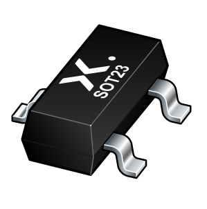

PMBT3904 40 V, 200 mA NPN switching transistor 5 November 2020 Product data sheet 1. General description NPN switching transistor in a small SOT23 (TO-236AB) Surface-Mounted Device (SMD) plastic package. PNP complement: PMBT3906 2. Features and benefits • • Collector current capability IC = 200 mA Collector-emitter voltage VCEO = 40 V 3. Applications • General switching and amplification 4. Quick reference data Table 1. Quick reference data Symbol Parameter Conditions Min Typ Max Unit VCEO collector-emitter voltage open base - - 40 V IC collector current - - 200 mA hFE DC current gain 100 - 300 [1] VCE = 1 V; IC = 10 mA [1] Pulsed test: tp ≤ 300 μs; δ ≤ 0.02 5. Pinning information Table 2. Pinning information Pin Symbol Description 1 B base 2 E emitter 3 C collector Simplified outline Graphic symbol 3 C B E 1 2 SOT23 sym021 PMBT3904 Nexperia 40 V, 200 mA NPN switching transistor 6. Ordering information Table 3. Ordering information Type number Package PMBT3904 Name Description Version SOT23 plastic, surface-mounted package; 3 terminals; 1.9 mm pitch; 2.9 SOT23 mm x 1.3 mm x 1 mm body 7. Marking Table 4. Marking codes Type number Marking code[1] PMBT3904 %1A [1] % = placeholder for manufacturing site code 8. Limiting values Table 5. Limiting values In accordance with the Absolute Maximum Rating System (IEC 60134). Symbol Parameter Conditions Min Max Unit VCBO collector-base voltage open emitter - 60 V VCEO collector-emitter voltage open base - 40 V VEBO emitter-base voltage open collector - 6 V IC collector current - 200 mA ICM peak collector current - 200 mA IBM peak base current - 100 mA Ptot total power dissipation - 250 mW Tj junction temperature - 150 °C Tamb ambient temperature -65 150 °C Tstg storage temperature -65 150 °C [1] single pulse; tp ≤ 1 ms Tamb ≤ 25 °C [1] Device mounted on an FR4 Printed-Circuit Board (PCB), single-sided copper, tin-plated and standard footprint. 9. Thermal characteristics Table 6. Thermal characteristics Symbol Parameter Rth(j-a) [1] Conditions thermal resistance from junction to ambient [1] Min Typ Max Unit - - 500 K/W Device mounted on an FR4 Printed-Circuit Board (PCB), single-sided copper, tin-plated and standard footprint. PMBT3904 Product data sheet All information provided in this document is subject to legal disclaimers. 5 November 2020 © Nexperia B.V. 2020. All rights reserved 2 / 11 PMBT3904 Nexperia 40 V, 200 mA NPN switching transistor 10. Characteristics Table 7. Characteristics Tamb = 25 °C unless otherwise specified. Symbol Parameter Conditions Min Typ Max Unit ICBO collector-base cut-off current VCB = 30 V; IE = 0 A - - 50 nA IEBO emitter-base cut-off current VEB = 6 V; IC = 0 A - - 50 nA hFE DC current gain VCE = 1 V; IC = 0.1 mA [1] 60 - - VCE = 1 V; IC = 1 mA [1] 80 - - VCE = 1 V; IC = 10 mA [1] 100 - 300 VCE = 1 V; IC = 50 mA [1] 60 - - VCE = 1 V; IC = 100 mA [1] 30 - - IC = 10 mA; IB = 1 mA - - 200 mV IC = 50 mA; IB = 5 mA - - 300 mV base-emitter saturation IC = 10 mA; IB = 1 mA voltage IC = 50 mA; IB = 5 mA 650 - 850 mV - - 950 mV td delay time - - 35 ns tr rise time - - 35 ns ts storage time - - 200 ns tf fall time - - 50 ns Cc collector capacitance VCB = 5 V; IE = 0 A; ie = 0 A; f = 1 MHz - - 4 pF Ce emitter capacitance VEB = 500 mV; IC = 0 A; ic = 0 A; f = 1 MHz - - 8 pF fT transition frequency VCE = 20 V; IC = 10 mA; f = 100 MHz 300 - - MHz NF noise figure VCE = 5 V; IC = 100 µA; RS = 1 kΩ; f = 10 Hz to 15.7 kHz - - 5 dB VCEsat VBEsat [1] collector-emitter saturation voltage IC = 10 mA; IBon = 1 mA; IBoff = -1 mA Pulsed test: tp ≤ 300 μs; δ ≤ 0.02 PMBT3904 Product data sheet All information provided in this document is subject to legal disclaimers. 5 November 2020 © Nexperia B.V. 2020. All rights reserved 3 / 11 PMBT3904 Nexperia 40 V, 200 mA NPN switching transistor mgu821 500 mgu822 250 IC (mA) hFE 400 (1) (2) (3) (4) (5) (6) (7) 200 (1) 300 150 (8) (9) (2) 200 100 (10) (3) 100 0 10- 1 1 50 10 102 IC (mA) 0 103 VCE = 1 V (1) Tamb = 150 °C (2) Tamb = 25 °C (3) Tamb = −55 °C Fig. 1. Fig. 2. mgu823 2 4 6 8 Collector current as a function of collectoremitter voltage; typical values mgu824 1200 VBEsat (mV) VBE (mV) 1000 10 VCE (V) Tamb = 25 °C (1) IB = 5.5 mA (2) IB = 5.0 mA (3) IB = 4.5 mA (4) IB = 3.5 mA (5) IB = 3.0 mA (6) IB = 2.5 mA (7) IB = 2.0 mA (8) IB = 1.5 mA (9) IB = 1.0 mA (10) IB = 0.5 mA DC current gain as a function of collector current; typical values 1200 0 1000 (1) (1) 800 800 (2) 600 (3) (2) 600 (3) 400 200 10- 1 1 400 10 102 IC (mA) 200 10- 1 103 VCE = 1 V (1) Tamb = −55 °C (2) Tamb = 25 °C (3) Tamb = 150 °C Fig. 3. Product data sheet 10 102 IC (mA) 103 IC/IB = 10 (1) Tamb = −55 °C (2) Tamb = 25 °C (3) Tamb = 150 °C Base-emitter voltage as a function of collector current; typical values PMBT3904 1 Fig. 4. Base-emitter saturation voltage as a function of collector current; typical values All information provided in this document is subject to legal disclaimers. 5 November 2020 © Nexperia B.V. 2020. All rights reserved 4 / 11 PMBT3904 Nexperia 40 V, 200 mA NPN switching transistor mgu825 103 VCEsat (mV) (2) (1) (3) 102 10 10- 1 1 10 102 IC (mA) 103 IC/IB = 10 (1) Tamb = 150 °C (2) Tamb = 25 °C (3) Tamb = −55 °C Fig. 5. Collector-emitter saturation voltage as a function of collector current; typical values PMBT3904 Product data sheet All information provided in this document is subject to legal disclaimers. 5 November 2020 © Nexperia B.V. 2020. All rights reserved 5 / 11 PMBT3904 Nexperia 40 V, 200 mA NPN switching transistor 11. Test information IB input pulse (idealized waveform) 90 % IBon (100 %) 10 % IBoff output pulse (idealized waveform) IC 90 % IC (100 %) 10 % t td ts tr ton Fig. 6. tf toff 006aaa003 BISS transistor switching time definition VBB RB VCC RC Vo (probe) oscilloscope 450 Ω (probe) 450 Ω R2 VI oscilloscope DUT R1 mlb826 Fig. 7. Test circuit for switching times PMBT3904 Product data sheet All information provided in this document is subject to legal disclaimers. 5 November 2020 © Nexperia B.V. 2020. All rights reserved 6 / 11 PMBT3904 Nexperia 40 V, 200 mA NPN switching transistor 12. Package outline Plastic surface-mounted package; 3 leads SOT23 B D A E X HE v A 3 Q A A1 1 c 2 e1 bp w B Lp e detail X 0 1 2 mm scale Dimensions (mm are the original dimensions) Unit mm max nom min A A1 1.1 0.1 0.9 bp c D E 0.48 0.15 3.0 1.4 0.38 0.09 2.8 1.2 e e1 1.9 0.95 HE Lp Q 2.5 0.45 0.55 2.1 0.15 0.45 v w 0.2 0.1 sot023_po Outline version References IEC SOT23 Fig. 8. JEDEC JEITA European projection Issue date 14-06-19 14-09-22 TO-236AB Package outline SOT23 PMBT3904 Product data sheet All information provided in this document is subject to legal disclaimers. 5 November 2020 © Nexperia B.V. 2020. All rights reserved 7 / 11 PMBT3904 Nexperia 40 V, 200 mA NPN switching transistor 13. Soldering 3.3 2.9 1.9 solder lands 3 solder resist 2 1.7 solder paste occupied area 0.6 (3×) 0.7 (3×) Dimensions in mm 0.5 (3×) 0.6 (3×) 1 Fig. 9. sot023_fr Reflow soldering footprint for SOT23 2.2 1.2 (2×) 1.4 (2×) solder lands 4.6 solder resist 2.6 occupied area Dimensions in mm 1.4 preferred transport direction during soldering 2.8 4.5 sot023_fw Fig. 10. Wave soldering footprint for SOT23 PMBT3904 Product data sheet All information provided in this document is subject to legal disclaimers. 5 November 2020 © Nexperia B.V. 2020. All rights reserved 8 / 11 PMBT3904 Nexperia 40 V, 200 mA NPN switching transistor 14. Revision history Table 8. Revision history Data sheet ID Release date Data sheet status Change notice Supersedes PMBT3904 v.3 20201105 Product data sheet - PMBT3904 v.2 Modifications: • • The format of this data sheet has been redesigned to comply with the identity guidelines of Nexperia. Legal texts have been adapted to the new company name where appropriate. PMBT3904 v.2 20040112 Product data sheet - PMBT3904 v.1 PMBT3904 v.1 19990427 Product data sheet - - PMBT3904 Product data sheet All information provided in this document is subject to legal disclaimers. 5 November 2020 © Nexperia B.V. 2020. All rights reserved 9 / 11 PMBT3904 Nexperia 40 V, 200 mA NPN switching transistor 15. Legal information injury, death or severe property or environmental damage. Nexperia and its suppliers accept no liability for inclusion and/or use of Nexperia products in such equipment or applications and therefore such inclusion and/or use is at the customer’s own risk. Data sheet status Quick reference data — The Quick reference data is an extract of the product data given in the Limiting values and Characteristics sections of this document, and as such is not complete, exhaustive or legally binding. Document status [1][2] Product status [3] Definition Objective [short] data sheet Development This document contains data from the objective specification for product development. Preliminary [short] data sheet Qualification This document contains data from the preliminary specification. Product [short] data sheet Production This document contains the product specification. [1] [2] [3] Please consult the most recently issued document before initiating or completing a design. The term 'short data sheet' is explained in section "Definitions". The product status of device(s) described in this document may have changed since this document was published and may differ in case of multiple devices. The latest product status information is available on the internet at https://www.nexperia.com. Definitions Draft — The document is a draft version only. The content is still under internal review and subject to formal approval, which may result in modifications or additions. Nexperia does not give any representations or warranties as to the accuracy or completeness of information included herein and shall have no liability for the consequences of use of such information. Short data sheet — A short data sheet is an extract from a full data sheet with the same product type number(s) and title. A short data sheet is intended for quick reference only and should not be relied upon to contain detailed and full information. For detailed and full information see the relevant full data sheet, which is available on request via the local Nexperia sales office. In case of any inconsistency or conflict with the short data sheet, the full data sheet shall prevail. Product specification — The information and data provided in a Product data sheet shall define the specification of the product as agreed between Nexperia and its customer, unless Nexperia and customer have explicitly agreed otherwise in writing. In no event however, shall an agreement be valid in which the Nexperia product is deemed to offer functions and qualities beyond those described in the Product data sheet. Disclaimers Limited warranty and liability — Information in this document is believed to be accurate and reliable. However, Nexperia does not give any representations or warranties, expressed or implied, as to the accuracy or completeness of such information and shall have no liability for the consequences of use of such information. Nexperia takes no responsibility for the content in this document if provided by an information source outside of Nexperia. In no event shall Nexperia be liable for any indirect, incidental, punitive, special or consequential damages (including - without limitation - lost profits, lost savings, business interruption, costs related to the removal or replacement of any products or rework charges) whether or not such damages are based on tort (including negligence), warranty, breach of contract or any other legal theory. Notwithstanding any damages that customer might incur for any reason whatsoever, Nexperia’s aggregate and cumulative liability towards customer for the products described herein shall be limited in accordance with the Terms and conditions of commercial sale of Nexperia. Right to make changes — Nexperia reserves the right to make changes to information published in this document, including without limitation specifications and product descriptions, at any time and without notice. This document supersedes and replaces all information supplied prior to the publication hereof. Suitability for use — Nexperia products are not designed, authorized or warranted to be suitable for use in life support, life-critical or safety-critical systems or equipment, nor in applications where failure or malfunction of an Nexperia product can reasonably be expected to result in personal PMBT3904 Product data sheet Applications — Applications that are described herein for any of these products are for illustrative purposes only. Nexperia makes no representation or warranty that such applications will be suitable for the specified use without further testing or modification. Customers are responsible for the design and operation of their applications and products using Nexperia products, and Nexperia accepts no liability for any assistance with applications or customer product design. It is customer’s sole responsibility to determine whether the Nexperia product is suitable and fit for the customer’s applications and products planned, as well as for the planned application and use of customer’s third party customer(s). Customers should provide appropriate design and operating safeguards to minimize the risks associated with their applications and products. Nexperia does not accept any liability related to any default, damage, costs or problem which is based on any weakness or default in the customer’s applications or products, or the application or use by customer’s third party customer(s). Customer is responsible for doing all necessary testing for the customer’s applications and products using Nexperia products in order to avoid a default of the applications and the products or of the application or use by customer’s third party customer(s). Nexperia does not accept any liability in this respect. Limiting values — Stress above one or more limiting values (as defined in the Absolute Maximum Ratings System of IEC 60134) will cause permanent damage to the device. Limiting values are stress ratings only and (proper) operation of the device at these or any other conditions above those given in the Recommended operating conditions section (if present) or the Characteristics sections of this document is not warranted. Constant or repeated exposure to limiting values will permanently and irreversibly affect the quality and reliability of the device. Terms and conditions of commercial sale — Nexperia products are sold subject to the general terms and conditions of commercial sale, as published at http://www.nexperia.com/profile/terms, unless otherwise agreed in a valid written individual agreement. In case an individual agreement is concluded only the terms and conditions of the respective agreement shall apply. Nexperia hereby expressly objects to applying the customer’s general terms and conditions with regard to the purchase of Nexperia products by customer. No offer to sell or license — Nothing in this document may be interpreted or construed as an offer to sell products that is open for acceptance or the grant, conveyance or implication of any license under any copyrights, patents or other industrial or intellectual property rights. Export control — This document as well as the item(s) described herein may be subject to export control regulations. Export might require a prior authorization from competent authorities. Non-automotive qualified products — Unless this data sheet expressly states that this specific Nexperia product is automotive qualified, the product is not suitable for automotive use. It is neither qualified nor tested in accordance with automotive testing or application requirements. Nexperia accepts no liability for inclusion and/or use of non-automotive qualified products in automotive equipment or applications. In the event that customer uses the product for design-in and use in automotive applications to automotive specifications and standards, customer (a) shall use the product without Nexperia’s warranty of the product for such automotive applications, use and specifications, and (b) whenever customer uses the product for automotive applications beyond Nexperia’s specifications such use shall be solely at customer’s own risk, and (c) customer fully indemnifies Nexperia for any liability, damages or failed product claims resulting from customer design and use of the product for automotive applications beyond Nexperia’s standard warranty and Nexperia’s product specifications. Translations — A non-English (translated) version of a document is for reference only. The English version shall prevail in case of any discrepancy between the translated and English versions. Trademarks Notice: All referenced brands, product names, service names and trademarks are the property of their respective owners. All information provided in this document is subject to legal disclaimers. 5 November 2020 © Nexperia B.V. 2020. All rights reserved 10 / 11 PMBT3904 Nexperia 40 V, 200 mA NPN switching transistor Contents 1. General description...................................................... 1 2. Features and benefits.................................................. 1 3. Applications.................................................................. 1 4. Quick reference data....................................................1 5. Pinning information......................................................1 6. Ordering information....................................................2 7. Marking.......................................................................... 2 8. Limiting values............................................................. 2 9. Thermal characteristics............................................... 2 10. Characteristics............................................................ 3 11. Test information.......................................................... 6 12. Package outline.......................................................... 7 13. Soldering..................................................................... 8 14. Revision history..........................................................9 15. Legal information......................................................10 © Nexperia B.V. 2020. All rights reserved For more information, please visit: http://www.nexperia.com For sales office addresses, please send an email to: salesaddresses@nexperia.com Date of release: 5 November 2020 PMBT3904 Product data sheet All information provided in this document is subject to legal disclaimers. 5 November 2020 © Nexperia B.V. 2020. All rights reserved 11 / 11
