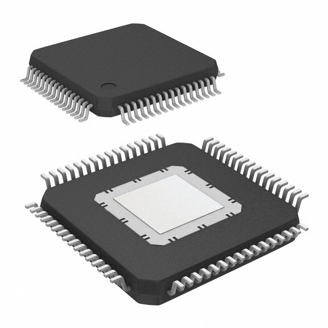

S12 MagniV Mixed-Signal MCUs S12ZVM Family Features 3-Phase Motor Control Integrated solution for 3-phase BLDC motor control applications Get Sample Integrated LIN Phy Ultra-reliable Industrial Integrated CAN Phy AEC-Q100 Grade0 (150 °C Ta / 175 °C Tj) VREG for 12 V Supply Product Block Diagram Product One-Sheet Success Stories PRODUCT BLOCK DIAGRAM Data Sheet Tools CAN/LIN-PHY System in a package – Highly integrated solution ideal for 3-Phase motors High performance – S12Z performance supports field-oriented control (FOC) for maximum energy efficiency/lowest audible noise Scalable – CAN-, LIN-, and HV-PWM-PHY options with memory up to 256 KB High Reliability– High immunity to EMI and ESD stresses, LIN 2.x compliant with +/- 8 kV ESD capability Low System Cost– Operating straight from car battery, integrated Phy for LIN or CAN, 6 channel motor control MOSFET gate pre-drivers SCI 0 SPI MSCAN BDM BDC KWU Temp Sense Pierce Osc. SCI 1 RCosc. +/-1.3% PLL 16-256 KB Flash (ECC) 2 x 12-Bit LADC Bootstrap Diodes S12Z 50 MHz Bus Win Wdog GDU 6-ch. MOS-FET-Predriver with Phase Comparators GPIO TIM 16-Bit, 4-ch. 6-ch. PMF (PWM) 128 B–128 KB EEPROM (ECC) 2-ch. PTU 2-32 KB RAM (ECC) Charge Pump VREG VSUP Sense Enablement – Supported by comprehensive hardware and software solution S12ZVM Specifications Application Example Block Diagram APPLICATION BLOCK DIAGRAM Flash RAM EEPROM PHY SCI/SPI S12Z; 50 MHz bus 70 mA (boost option to 140 mA) 16–256 KB 2–32 KB 128 B–1 KB CAN, LIN or PWM Up to 2/1 PTU ADC OpAmp EVDD Op Range 6-ch. motor control FET driver –6-ch. motor control PWM –Additional 4-ch., 16-bit PWM Triggering ADC & PWM 2 ADCs, 1+3 to 8+8 ch., 12-bit 2 x for current sensing 1-ch. 5 V/ 20 mA (source) 3.5 V–20 V HVI Up to 1 Timer 4-ch., 16-bit Core 12 V VREG Gate Driver PWM Orderable Sample Part Numbers Part Number Flash Temp Range Package S912ZVMC12F1MKH 128 KB -40 °C to 125 °C 64 LQFP-EP S912ZVMC12F1WKH 128 KB -40 °C to 150 °C 64 LQFP-EP S912ZVML12F1WKH 128 KB -40 °C to 150 °C 64 LQFP-EP S912ZVML12F1MKH 128 KB -40 °C to 125 °C 64 LQFP-EP S912ZVML31F1WKH 32 KB -40 °C to 150 °C 64 LQFP-EP S912ZVML31F1WKF 32 KB -40 °C to 150 °C 48 LQFP-EP S912ZVMC25F1WKK 256 KB -40 °C to 150 °C 80 LQFP-EP 3-Phase Motor 12 V Battery VREG LIN-PHY, S12ZVM MCU CAN-PHY or HV-PWM 6ch Gate Driver (HS/LS) Current Sensing B6 Bridge Power N-FET Shunt *Limited Sample-availability for 256 KB version with CAN-PHY. Contact your local sales www.NXP.com/S12ZVM NXP, the NXP logo, CodeWarrior and MagniV are trademarks of NXP B.V. All other product or service names are the property of their respective owners. © 2016 NXP B.V. Document Number: S12ZVMFS REV 5  Engine cooling fans  Fuel pumps  Water pumps  HVAC blower  Superchargers Target Applications  Engine cooling fan/HVAC blower  Oil/Fuel/Water pumps  Compressors  Turbo/Supercharger  Wipers Enablement Tools Current Sense (2 x Op-Amp) EVDD 6-ch. MOSFET Gate Driver M  Evaluation boards/hardware –S12ZVML12EVBLIN –S12ZVMC12EVBCAN –S12ZVM32EVB –S12ZVML-MINIBRD –S12ZVMC256EVB  Software Tools –Motor Control Development Toolbox –Automotive Math and Motorcontrol Libraries –FreeMASTER Run-Time Debugging Tool –MCAT Motorcontrol Algorithm Parameter Tunning  Reference Solutions –BLDC: MTRCKTSBNZVM128 –PMSM: MTRCKTSPNZVM128  Compiler/Debugger –CodeWarrior® IDE –Cosmic IDE  LIN Stack
S912ZVML64F3WKH
物料型号:S12ZVM系列微控制器
器件简介:S12ZVM系列微控制器是高度集成的解决方案,适用于三相电机,支持高性能的场向控制(FOC),以实现最大的能效和最低的可听噪声。
引脚分配:文档中没有提供详细的引脚分配图,但提到了多个功能模块,如CAN/LIN-PHY、PWM、ADC、GPIO等。
参数特性: - 核心:S12Z,50 MHz总线 - Flash:16-256 KB - RAM:2-32 KB - EEPROM:128B-1 KB - PHY:集成CAN、LIN或PWM - 工作电压范围:3.5V-20V - 温度范围:-40°C至150°C或125°C
功能详解: - 6通道电机控制FET驱动器 - 2个12位ADC,用于电流检测 - 2个运算放大器,用于电流感应 - 4通道、16位定时器 - 集成LIN PHY,符合LIN 2.x标准,具有±8 kV ESD能力
应用信息:适用于引擎冷却风扇、HVAC鼓风机、油/燃料/水泵、压缩机、涡轮增压器/超级增压器、雨刷等。
封装信息:提供多种封装选项,如64LOFP-EP、64LQFP-EP、80LOFP-EP等。
