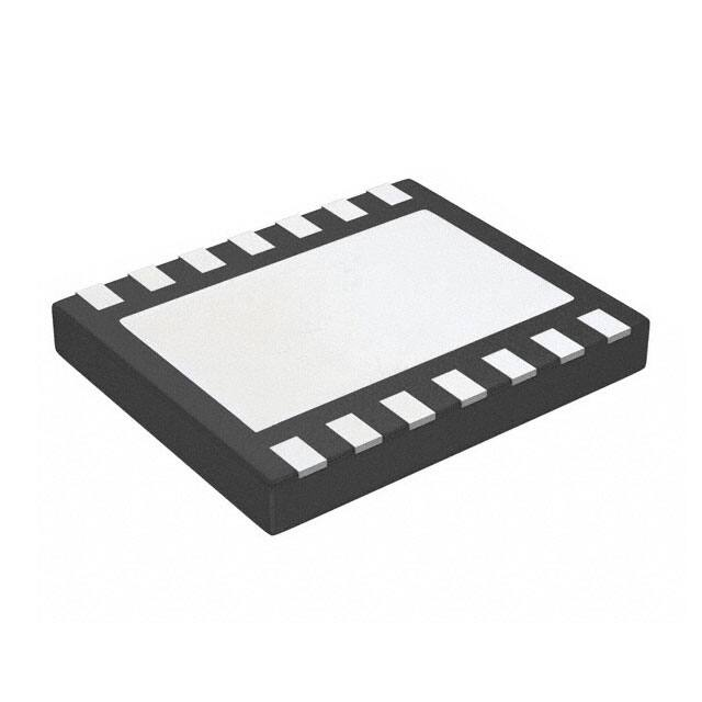

TJR1448CTK/0Z 数据手册
TJR1448 Dual high-speed CAN transceiver with Standby mode Rev. 2 — 15 October 2021 1 Product data sheet General description The TJR1448 is a member of the TJR144x family of transceivers that provide an interface between a Controller Area Network (CAN) or CAN FD (Flexible Data rate) protocol controller and the physical two-wire CAN bus. TJR144x transceivers implement the CAN physical layer as defined in ISO 11898-2:2016 and SAE J2284-1 to SAE J2284-5, and are fully interoperable with high-speed Classical CAN and CAN FD transceivers. All TJR144x variants enable reliable communication in the CAN FD fast phase at data rates up to 5 Mbit/s and are qualified to AEC-Q100 Grade 0, supporting operation at 150 °C ambient temperature. The TJR1448 is intended as a simple replacement for dual high-speed Classical CAN and CAN FD transceivers, such as the TJA1059 from NXP. It offers pin compatibility and is designed to avoid changes to hardware and software design, allowing the TJR1448 to be easily retrofitted to existing applications. An AEC-Q100 Grade 1 variant, the TJA1448, is available to support operation at 125 °C ambient temperature. 1.1 TJR1448 variants The TJR1448 comes in three variants. The TJR1448A and TJR1448B are available in SO14 and HVSON14 packages. The TJR1448C comes in a HVSON14 package: • The TJR1448A is a dual high-speed CAN transceiver with Normal and Standby modes and a VIO supply pin. The VIO pin allows for direct interfacing with 3.3 V and 5 Vsupplied microcontrollers. • The TJR1448B is a high-speed CAN transceiver with Normal and Standby modes. • The TJR1448C is a dual high-speed CAN transceiver with Normal and Standby modes, a VIO supply pin and RXD latching. The VIO pin allows for direct interfacing with 3.3 V and 5 V-supplied microcontrollers. 2 Features and benefits 2.1 General • • • • • • ISO 11898-2:2016, SAE J2284-1 to SAE J2284-5 and SAE J1939-14 compliant Standard CAN and CAN FD data bit rates up to 5 Mbit/s Low Electromagnetic Emission (EME) and high Electromagnetic Immunity (EMI) Qualified according to AEC-Q100 Grade 0 TJR1448A/C only: VIO input for interfacing with 3.3 V to 5 V microcontrollers Fully independent control of two transceivers combined monolithically in a single package TJR1448 NXP Semiconductors Dual high-speed CAN transceiver with Standby mode • All variants are available in a leadless HVSON14 (3.0 mm x 4.5 mm) package with improved Automated Optical Inspection (AOI) capability; TJR1448A/B available in an SO14 package. • Dark green product (halogen free and Restriction of Hazardous Substances (RoHS) compliant) 2.2 Predictable and fail-safe behavior • Undervoltage detection with defined handling on all supply pins • Full functionality guaranteed from the undervoltage detection thresholds up to the maximum limiting voltage values • Defined behavior below the undervoltage detection thresholds • Transceiver disengages from the bus (high-ohmic) when the supply voltage drops below the Off mode threshold • Internal biasing of TXD and mode selection input pins, to enable defined fail-safe behavior 2.3 Low-power management • Very low-current Standby mode with host and bus wake-up capability • TJR1448A/C only: CAN wake-up receiver powered by VIO allowing VCC to be shut down • CAN wake-up pattern filter time of 0.5 μs to 1.8 μs meeting Classical CAN and CAN FD requirements • TJR1448C variant offers RXD wake-up latching to enable wake-up source readout in gateway applications 2.4 Protection • • • • TJR1448 Product data sheet High ESD handling capability on the bus pins (8 kV IEC and HBM) Bus pins protected against transients in automotive environments Transmit Data (TXD) dominant time-out function Thermally protected All information provided in this document is subject to legal disclaimers. Rev. 2 — 15 October 2021 © NXP B.V. 2021. All rights reserved. 2 / 38 TJR1448 NXP Semiconductors Dual high-speed CAN transceiver with Standby mode 3 Quick reference data Table 1. Quick reference data Symbol Parameter VCC supply voltage ICC supply current Conditions Min Typ Max Unit 4.5 - 5.5 V both channels recessive - 8 14 mA one channel dominant - 42 67 mA both channels dominant - 77 120 mA TJR1448A/C - - 2 μA TJR1448B - 11 18 μA Normal mode both channels in Standby mode Vuvd(stb)(VCC) standby undervoltage detection voltage on pin VCC 4 - 4.5 V Vuvhys(stb)(VCC) standby undervoltage hysteresis voltage on pin VCC 50 - - mV Vuvd(swoff)(VCC) switch-off undervoltage detection TJR1448B voltage on pin VCC 2.65 - 2.95 V VIO supply voltage on pin VIO 2.95 - 5.5 V IIO supply current on pin VIO both channels recessive - 270 750 μA one channel dominant - 360 1000 μA both channels dominant - 450 1250 μA both channels in Standby mode - 11 16 μA 2.65 - 2.95 V Normal mode Vuvd(swoff)(VIO) switch-off undervoltage detection voltage on pin VIO VESD electrostatic discharge voltage IEC 61000-4-2 on pins CANHx and CANLx -8 - +8 kV VCANH voltage on pin CANH pins CANH1 and CANH2; limiting value according to IEC 60134 -36 - +40 V VCANL voltage on pin CANL pins CANL1 and CANL2; limiting value according to IEC 60134 -36 - +40 V Tvj virtual junction temperature -40 - +175 °C TJR1448 Product data sheet All information provided in this document is subject to legal disclaimers. Rev. 2 — 15 October 2021 © NXP B.V. 2021. All rights reserved. 3 / 38 TJR1448 NXP Semiconductors Dual high-speed CAN transceiver with Standby mode 4 Ordering information Table 2. Ordering information Type number TJR1448AT Package Name Description Version SO14 plastic small outline package; 14 leads; body width 3.9 mm SOT108-1 HVSON14 plastic thermal enhanced very thin small outline package; no leads; 14 terminals; body 3 × 4.5 × 0.85 mm SOT1086-2 TJR1448BT TJR1448ATK TJR1448BTK TJR1448CTK Table 3. TJR1448 feature overview See Section 19 for a feature overview of the complete TJx144x/TJx146x/TJF1441 family. Data rate Additional features ● ● ● [1] [2] [3] [4] [5] ● ● ● ● ● ● ● [5] TXD dominant timeout TJR1448C ● Single supply pin wake-up ● Short WUP support [0.5 - 1.8 µs] ● [2] [3] ● Wake-up source recognition TJR1448B Signal improvement ● Up to 8 Mbit/s CAN FD ● Up to 5 Mbit/s CAN FD VIO pin ● VBAT pin VCC pin Selectable Off Silent/Listen-only Standby ● [1] Sleep Normal TJR1448A Device ● ● Local diagnostics via ERR_N pin Supplies [4] Modes ● ● ● TJR1448 is AEC-Q100 Grade 0. CAN FD Signal Improvement Capability (SIC) according to CiA 601-4:2019. RXD is held LOW after wake-up request, enabling wake-up source recognition. WUP = wake-up pattern according ISO11898-2:2016. Only VBAT supply needed for wake-up. TJR1448 Product data sheet All information provided in this document is subject to legal disclaimers. Rev. 2 — 15 October 2021 © NXP B.V. 2021. All rights reserved. 4 / 38 TJR1448 NXP Semiconductors Dual high-speed CAN transceiver with Standby mode 5 Block diagrams VIO VCC 11 STB1 1 TIME-OUT SLOPE CONTROL AND DRIVER VIO STB2 12 CANH1 CANL1 normal receiver MUX AND DRIVER 4 6 WAKE-UP FILTER low-power receiver MODE CONTROL VIO TXD2 13 14 VIO RXD1 TJR1448A/C TEMPERATURE PROTECTION VIO TXD1 3 TIME-OUT VIO SLOPE CONTROL AND DRIVER 10 9 CANH2 CANL2 normal receiver 8 VIO RXD2 7 MUX AND DRIVER WAKE-UP FILTER low-power receiver 2,5 GND aaa-039105 Figure 1. Block diagram: TJR1448A/C TJR1448 Product data sheet All information provided in this document is subject to legal disclaimers. Rev. 2 — 15 October 2021 © NXP B.V. 2021. All rights reserved. 5 / 38 TJR1448 NXP Semiconductors Dual high-speed CAN transceiver with Standby mode VCC 3 TEMPERATURE PROTECTION VCC TXD1 STB1 TJR1448B 1 TIME-OUT SLOPE CONTROL AND DRIVER VCC STB2 CANH1 CANL1 normal receiver MUX AND DRIVER 4 WAKE-UP FILTER low-power receiver MODE CONTROL VCC TXD2 12 14 VCC RXD1 13 5 TIME-OUT VCC SLOPE CONTROL AND DRIVER 10 9 CANH2 CANL2 normal receiver 11 VCC RXD2 MUX AND DRIVER 8 WAKE-UP FILTER 7 low-power receiver 2,6 n.c. GND aaa-039106 Figure 2. Block diagram: TJR1448B TJR1448 Product data sheet All information provided in this document is subject to legal disclaimers. Rev. 2 — 15 October 2021 © NXP B.V. 2021. All rights reserved. 6 / 38 TJR1448 NXP Semiconductors Dual high-speed CAN transceiver with Standby mode 6 Pinning information 6.1 Pinning TXD1 1 14 STB1 TXD1 1 14 STB1 GND 2 13 CANH1 GND 2 13 CANH1 VCC 3 12 CANL1 VCC 3 12 CANL1 RXD1 4 11 VIO RXD1 4 11 STB2 GND 5 10 CANH2 TXD2 5 10 CANH2 TXD2 6 9 CANL2 GND 6 9 CANL2 RXD2 7 8 STB2 n.c. 7 8 RXD2 aaa-038133 aaa-038135 TJR1448AT: SO14 TJR1448BT: SO14 terminal 1 index area terminal 1 index area TXD1 1 14 STB1 13 CANH1 GND 2 13 CANH1 3 12 CANL1 VCC 3 12 CANL1 RXD1 4 11 VIO RXD1 4 11 STB2 GND 5 10 CANH2 TXD2 5 10 CANH2 TXD2 6 9 CANL2 GND 6 9 CANL2 RXD2 7 8 STB2 n.c. 7 8 RXD2 TXD1 1 14 STB1 GND 2 VCC aaa-038134 aaa-038136 TJR1448ATK/CTK: HVSON14 TJR1448BTK: HVSON14 Figure 3. Pin configuration diagrams TJR1448 Product data sheet All information provided in this document is subject to legal disclaimers. Rev. 2 — 15 October 2021 © NXP B.V. 2021. All rights reserved. 7 / 38 TJR1448 NXP Semiconductors Dual high-speed CAN transceiver with Standby mode 6.2 Pin description Table 4. Pin description: TJR1448A/C [1] Symbol Pin Type TXD1 1 I transmit data input 1; inputs data (from the CAN controller) to be written to CANH1/CANL1 bus lines 2 G ground VCC 3 P 5 V supply voltage input RXD1 4 O receive data output 1; outputs data read from bus lines CANH1/CANL1 (to the CAN controller) 5 G ground TXD2 6 I transmit data input 2; inputs data (from the CAN controller) to be written to CANH1/CANL1 bus lines RXD2 7 O receive data output 2; outputs data read from bus lines CANH2/CANL2 (to the CAN controller) STB2 8 I Standby mode control input 2 (HIGH: Standby mode; LOW: Normal mode) CANL2 9 AIO LOW-level CAN bus line 2 CANH2 10 AIO HIGH-level CAN bus line 2 VIO 11 P supply voltage input for I/O level adapter CANL1 12 AIO LOW-level CAN bus line 1 CANH1 13 AIO HIGH-level CAN bus line 1 STB1 14 I Standby mode control input 1 (HIGH: Standby mode; LOW: Normal mode) GND GND [1] [2] [2] [2] Description I: digital input; O: digital output; AIO: analog input/output; P: power supply; G: ground. HVSON package die supply ground is connected to both the GND pin and the exposed center pad. The GND pin must be soldered to board ground. For enhanced thermal and electrical performance, it is also recommended to solder the exposed center pad to board ground. TJR1448 Product data sheet All information provided in this document is subject to legal disclaimers. Rev. 2 — 15 October 2021 © NXP B.V. 2021. All rights reserved. 8 / 38 TJR1448 NXP Semiconductors Dual high-speed CAN transceiver with Standby mode Table 5. Pin description: TJR1448B [1] Symbol Pin Type TXD1 1 I transmit data input 1; inputs data (from the CAN controller) to be written to CANH1/CANL1 bus lines 2 G ground VCC 3 P 5 V supply voltage input RXD1 4 O receive data output 1; outputs data read from bus lines CANH1/CANL1 (to the CAN controller) TXD2 5 I transmit data input 2; inputs data (from the CAN controller) to be written to CANH2/CANL2 bus lines 6 G ground n.c. 7 - not connected RXD2 8 O receive data output 2; outputs data read from bus lines CANH2/CANL2 (to the CAN controller) CANL2 9 AIO LOW-level CAN bus line 2 CANH2 10 AIO HIGH-level CAN bus line 2 STB2 11 I Standby mode control input 2 (HIGH: Standby mode; LOW: Normal mode) CANL1 12 AIO LOW-level CAN bus line 1 CANH1 13 AIO HIGH-level CAN bus line 1 STB1 14 I Standby mode control input 1 (HIGH: Standby mode; LOW: Normal mode) GND GND [1] [2] [2] [2] Description I: digital input; O: digital output; AIO: analog input/output; P: power supply; G: ground. HVSON package die supply ground is connected to both the GND pin and the exposed center pad. The GND pin must be soldered to board ground. For enhanced thermal and electrical performance, it is also recommended to solder the exposed center pad to board ground. TJR1448 Product data sheet All information provided in this document is subject to legal disclaimers. Rev. 2 — 15 October 2021 © NXP B.V. 2021. All rights reserved. 9 / 38 TJR1448 NXP Semiconductors Dual high-speed CAN transceiver with Standby mode 7 Functional description 7.1 Operating modes The TJR1448 supports three operating modes per transceiver, Normal, Standby and Off. The operating mode is selected independently for each transceiver via pins STB1 and STB2. See Table 6 for a description of the operating modes under normal supply conditions. Mode changes are completed after transition time tt(moch). Table 6. Operating modes Mode Inputs Outputs Pin STB1/STB2 Pin TXD1/TXD2 CAN1/CAN2 driver Pin RXD1/RXD2 Normal LOW LOW dominant LOW HIGH recessive LOW when bus dominant HIGH when bus recessive Standby HIGH X biased to ground TJR1448A/B: follows BUS when wake-up detected TJR1448C: LOW when wake-up detected HIGH when no wake-up detected Off [1] [1] X X high-ohmic state high-ohmic state Off mode is entered when the voltage on pin VIO (TJR1448A/C) or pin VCC (TJR1448B) is below the switch-off undervoltage detection threshold. TJR1448 Product data sheet All information provided in this document is subject to legal disclaimers. Rev. 2 — 15 October 2021 © NXP B.V. 2021. All rights reserved. 10 / 38 TJR1448 NXP Semiconductors Dual high-speed CAN transceiver with Standby mode from any mode when VIO < Vuvd(swoff)(VIO) for t > t uvd(swoff) OFF (CANx BIAS = high-ohmic) VIO > Vuvd(swoff)(VIO) for t > tstartup STANDBY (CANx BIAS = 0 V) STBx = HIGH OR (VCC < Vuvd(stb)(VCC) for t > tdet(uv)) STBx = LOW AND (VCC > Vuvd(stb)(VCC) for t > t rec(uv)) NORMAL (CANx BIAS = VCC /2) aaa-031273 Figure 4.  TJR1448A/C state diagram (per channel) TJR1448 Product data sheet All information provided in this document is subject to legal disclaimers. Rev. 2 — 15 October 2021 © NXP B.V. 2021. All rights reserved. 11 / 38 TJR1448 NXP Semiconductors Dual high-speed CAN transceiver with Standby mode from any mode when VCC < Vuvd(swoff)(VCC) for t > t uvd(swoff) OFF (CANx BIAS = high-ohmic) VCC > Vuvd(swoff)(VCC) for t > t startup STANDBY (CANx BIAS = 0 V) STBx = HIGH OR (VCC < Vuvd(stb)(VCC) for t > tdet(uv)) STBx = LOW AND (VCC > Vuvd(stb)(VCC) for t > t rec(uv)) NORMAL (CANx BIAS = VCC/2) aaa-031274 Figure 5.  TJR1448B state diagram (per channel) 7.1.1 Off mode The TJR1448 switches to Off mode from any mode when the supply voltage (on pin VIO in TJR1448A/C and VCC in TJR1448B) falls below the switch-off undervoltage threshold (Vuvd(swoff)(VCC) or Vuvd(swoff)(VIO)). This is the default mode when the supply is first connected. In Off mode, the CAN pins and RXDx pins are in a high-ohmic state. 7.1.2 Standby mode When the supply voltage (VIO for TJR1448A/C or VCC for TJR1448B) rises above the switch-off undervoltage detection threshold, the TJR1448 starts to boot up, triggering an initialization procedure. The TJR1448 switches to the selected mode after tstartup. Standby mode is selected when pin STBx goes HIGH. In this mode, the transceiver is unable to transmit or receive data and a low-power receiver is activated to monitor the bus for a wake-up pattern. The transmitter and Normal-mode receiver blocks are switched off and the bus pins are biased to ground to minimize system supply current. Pin RXDx in the TJR1448A/B follows the bus after a wake-up request has been detected. In the TJR1448C, RXDx is forced LOW when a wake-up request is detected. A transition to Normal mode is triggered when STBx is forced LOW (provided VCC > Vuvd(stb)(VCC) and VIO > Vuvd(swoff)(VIO) in the TJR1448A/C). TJR1448 Product data sheet All information provided in this document is subject to legal disclaimers. Rev. 2 — 15 October 2021 © NXP B.V. 2021. All rights reserved. 12 / 38 TJR1448 NXP Semiconductors Dual high-speed CAN transceiver with Standby mode If VCC is below Vuvd(stb)(VCC) when STBx goes LOW (with VIO > Vuvd(swoff)(VIO) in TJR1448A/C and VCC > Vuvd(swoff)(VCC) in TJR1448B), the TJR1448 will remain in Standby mode. Pending wake-up events will be cleared and differential data on the bus pins converted to digital data via the low-power receiver and output on pin RXDx. In the TJR1448A/C, the low-power receiver is supplied from VIO and can detect CAN bus activity when VIO is above Vuvd(swoff)(VIO) (even if VIO is the only available supply voltage). 7.1.3 Normal mode A LOW level on pin STBx selects Normal mode, provided the supply voltage on pin VCC is above the standby undervoltage detection threshold, Vuvd(stb)(VCC). In this mode, the transceiver can transmit and receive data via bus lines CANHx and CANLx. Pin TXDx must be HIGH at least once in Normal Mode before transmission can begin. The differential receiver converts the analog data on the bus lines into digital data on pin RXDx. The slopes of the output signals on the bus lines are controlled internally and are optimized in a way that guarantees the lowest possible EME. In recessive state, the output voltage on the bus pins is VCC/2. 7.1.4 Operating modes and gap-free operation Gap-free operation guarantees defined behavior at all voltage levels. Supply voltage-tooperating mode mapping is detailed in Figure 6 and in the state diagrams (Figure 4 and Figure 5). TJR1448 Product data sheet All information provided in this document is subject to legal disclaimers. Rev. 2 — 15 October 2021 © NXP B.V. 2021. All rights reserved. 13 / 38 TJR1448 NXP Semiconductors Dual high-speed CAN transceiver with Standby mode TJR1448A/C TJR1448B Fully functional [2][3] Fully functional [2] OR Standby OR Off [4] Standby OR Off [4] -0.3 V - 2.65 V -0.3 V - 4 V Voltage range on VCC Off Fully functional [2] OR Standby [4] Standby VIO operating range (2.95 V - 5.5 V) Vuvd(stb)(VCC) range [6] Fully functional[2] AND characteristics guaranteed[5] 5.5 V - 6 V[1] Fully functional [2][3] VCC operating range (4.5 V - 5.5 V) Fully functional[2] AND characteristics guaranteed[5] Vuvd(stb)(VCC) range Fully functional[2] OR Standby [4] 2.95 V - 4 V Standby Vuvd(swoff)(VCC) range Standby OR Off [4] -0.3 V - 2.65 V Off 5.5 V - 6 V[1] Fully functional [2][3] OR Off [4] VCC operating range (4.5 V - 5.5 V) Vuvd(swoff)(VIO) range [6] Voltage range on VCC 5.5 V - 6 V[1] Voltage range on VIO [1] 6 V is the IEC 60134 Absolute Maximum Rating (AMR) for VCC and VIO (see Limiting values table). Above the AMR, irreversible changes in characteristics, functionality or performance may occur. Returning from above AMR to the operating range, datasheet characteristics and functionality cannot be guaranteed. [2] Target transceiver functionality as described in this datasheet is applicable. [3] Prolonged operation of the device outside the operating range may impact reliability over lifetime. Returning to the operating range, datasheet characteristics are guaranteed provided the AMR has not been exceeded. [4] For a given value of VCC (and VIO in TJR1448A/C), a specific device will be in a single defined state determined by its undervoltage detection thresholds (Vuvd(stb)(VCC), Vuvd(swoff)(VIO) and Vuvd(swoff)(VCC)). The actual thresholds can vary between devices (within the ranges specified in this data sheet). To guarantee the device will be in a specific state, VIO and VCC must be either above the maximum or below the minimum thresholds specified for these undervoltage detection ranges. [5] Datasheet characteristics are guaranteed within the VCC and VIO operating ranges. Exceptions are described in the Static and Dynamic characteristics tables. [6] The following applies to TJR1448A/C: - If both VCC and VIO are above the undervoltage threshold, the device is fully functional. - If VCC is below and VIO above the undervoltage threshold, the device is in Standby mode. - If VIO is below the undervoltage threshold, the device is in Off mode, regardless of VCC. aaa-039107 Figure 6. TJR1448 supply voltage ranges and gap-free operation 7.2 Remote wake-up (via the CAN bus) In Standby mode, the TJR1448 wakes up when a dedicated wake-up pattern (specified in ISO 11898-2: 2016) is detected on the bus. The wake-up pattern consists of: • a dominant phase of at least twake(busdom) followed by • a recessive phase of at least twake(busrec) followed by • a dominant phase of at least twake(busdom) Dominant or recessive bits between the above mentioned phases that are shorter than twake(busdom) and twake(busrec) respectively are ignored. The complete dominant-recessive-dominant pattern must be received within tto(wake)bus to be recognized as a valid wake-up pattern (see Figure 7 for TJR1448A/B wake-up timing TJR1448 Product data sheet All information provided in this document is subject to legal disclaimers. Rev. 2 — 15 October 2021 © NXP B.V. 2021. All rights reserved. 14 / 38 TJR1448 NXP Semiconductors Dual high-speed CAN transceiver with Standby mode and Figure 8 for TJR1448C wake-up timing). Otherwise, the internal wake-up logic is reset. The complete wake-up pattern then needs to be retransmitted to trigger a wake-up event. Pin RXDx remains HIGH until the wake-up event has been triggered. After a wake-up sequence has been detected, the TJR1448A/B remains in Standby mode with the bus signals reflected on RXDx after tstartup(RXD). Note that dominant or recessive phases lasting less than tfltr(wake)bus will not be detected by the low-power differential receiver and will not be reflected on RXDx in Standby mode (see Figure 7). The TJR1448C also remains in Standby mode after a wake-up sequence has been detected, but pin RXDx switches LOW after tstartup(RXD) (see Figure 8). A wake-up event is not flagged on RXDx if any of the following events occurs while a valid wake-up pattern is being received: • The device switches to Normal mode • The complete wake-up pattern was not received within tto(wake)bus • A VCC or VIO switch-off undervoltage is detected (VCC < Vuvd(swoff)(VCC) or VIO < Vuvd(swoff)(VIO); see Section 7.3.3) CANH VO(dif) CANL twake(busrec) tfltr(wake)bus tfltr(wake)bus twake(busdom) twake(busdom) RXD wake-up pattern detected tfltr(wake)bus tfltr(wake)bus t < tfltr(wake)bus t < tfltr(wake)bus tfltr(wake)bus tfltr(wake)bus tstartup(RXD)(1) t ≤ tto(wake)bus aaa-031221 (1) During tstartup(RXD), the low-power receiver is on but pin RXDx is not active (i.e. HIGH/recessive). The first dominant pulse of width ≥ tfltr(wake)bus that ends after tstartup(RXD) will trigger RXDx to go LOW/dominant. Figure 7. TJR1448A/B wake-up timing CANH VO(dif) CANL twake(busdom) twake(busrec) twake(busdom) wake-up pattern detected RXD ≤ tto(wake)bus tstartup(RXD) aaa-031220 Figure 8. TJR1448C wake-up timing TJR1448 Product data sheet All information provided in this document is subject to legal disclaimers. Rev. 2 — 15 October 2021 © NXP B.V. 2021. All rights reserved. 15 / 38 TJR1448 NXP Semiconductors Dual high-speed CAN transceiver with Standby mode 7.3 Fail-safe features 7.3.1 TXD dominant timeout function A hardware and/or software application failure in Normal mode that caused pin TXDx to be held LOW would drive the bus lines to a permanent dominant state (blocking all network communications). The TXD dominant time-out function prevents such a network lock-up. A 'TXD dominant timeout' timer is started when pin TXDx goes LOW. If the LOW state on this pin persists for longer than tto(dom)TXD, the transmitter is disabled, releasing the bus lines to recessive state. The TXD dominant time-out timer is reset when pin TXDx is set HIGH. 7.3.2 Internal biasing of TXDx and STBx input pins Pins TXDx and STBx have internal pull-ups to VCC/VIO to ensure a safe, defined state in case one, or both, of these pins is left or becomes floating. Pull-up resistors are active on these pins in all states; they should be held at the VCC/VIO level in Standby mode to minimize supply current. 7.3.3 Undervoltage detection on pins VCC and VIO If VCC drops below the standby undervoltage detection threshold (Vuvd(stb)(VCC)) for tdet(uv), both transceivers switch to Standby mode. The logic state of pin STBx is ignored until VCC has recovered. In the TJR1448A/C, if VIO drops below the switch-off undervoltage detection threshold (Vuvd(swoff)(VIO)) for tuvd(swoff), both transceiver switch to Off mode and disengage from the bus (high-ohmic) until VIO has recovered. In the TJR1448B, if VCC drops below the switch-off undervoltage detection threshold (Vuvd(swoff)(VCC)) for tuvd(swoff), both transceivers switch to Off mode and disengage from the bus (high-ohmic) until VCC has recovered. 7.3.4 Overtemperature protection The device is protected against overtemperature conditions. If the junction temperature exceeds the shutdown junction temperature, Tj(sd), the CAN bus drivers are disabled. When the junction temperature drops below Tj(sd)rel, the CAN bus drivers recover once TXDx has been reset to HIGH and Normal mode is selected (waiting for TXDx to go HIGH prevents output driver oscillation due to small variations in temperature). 7.3.5 I/O levels Pin VIO on the TJR1448A/C should be connected to the same supply voltage used to supply the microcontroller (see Figure 1). This adjusts the signal levels on pins TXDx, RXDx and STBx to the I/O levels of the microcontroller, allowing for direct interfacing without additional glue logic. Pin VIO also provides the internal supply voltage for the lowpower differential receiver. For applications running in low-power mode, this allows the bus lines to be monitored for activity even if there is no supply voltage on pin VCC. All I/O levels are related to VCC in the TJR1448B and are, therefore, compatible with 5 V microcontrollers. Spurious signals from the microcontroller on pins STB1 and STB2 are filtered out with a filter time of tfltr(IO). TJR1448 Product data sheet All information provided in this document is subject to legal disclaimers. Rev. 2 — 15 October 2021 © NXP B.V. 2021. All rights reserved. 16 / 38 TJR1448 NXP Semiconductors Dual high-speed CAN transceiver with Standby mode 8 Limiting values Table 7. Limiting values In accordance with the Absolute Maximum Rating System (IEC 60134); all voltages are referenced to pin GND, unless otherwise specified. Symbol Vx Parameter [1] voltage on pin x Conditions Min Max Unit pins VCC, VIO (TJR1448A), TXDx, STBx -0.3 +6 V pins CANHx, CANLx [2] - +7 V -36 +40 -0.3 VIO+0.3 V pin RXDx TJR1448A/C TJR1448B V VCC+0.3 V -40 +40 V pulse 1 -100 - V pulse 2a - +75 V pulse 3a -150 - V - +100 V -8 +8 kV voltage between pin CANH and pin CANL between pins CANH1 and CANL1 and between CANH2 and CANL2 Vtrt transient voltage on pins CANHx, CANLx [4] pulse 3b electrostatic discharge voltage [3] -0.3 V(CANH-CANL) VESD [3] IEC 61000-4-2 (150 pF, 330 Ω discharge circuit) [5] on pins CANHx, CANLx Human Body Model (HBM) on any pin [6] -4 +4 kV on pins CANHx, CANLx [7] -8 +8 kV Charged Device Model (CDM) [8] -750 +750 V on corner pins on any other pin Tvj virtual junction temperature Tstg storage temperature -500 +500 V [9] -40 +175 °C [10] -55 +150 °C [1] The device can sustain voltages up to the specified values over the product lifetime, provided applied voltages (including transients) never exceed these values. [2] The device can withstand voltages between 6 V and 7 V for a total of 20 s over the product lifetime. [3] Subject to the qualifications detailed in Table notes 1 and 2 above for pins VCC, VIO, TXDx and STBx. [4] Verified by an external test house according to IEC TS 62228, Section 4.2.4; parameters for standard pulses defined in ISO7637. [5] Verified by an external test house according to IEC TS 62228, Section 4.3. [6] According to AEC-Q100-002. [7] Pins stressed to reference group containing all ground and supply pins, emulating the application circuits (Figure 1 and Figure 2). HBM pulse as specified in AEC-Q100-002 used. [8] According to AEC-Q100-011. [9] In accordance with IEC 60747-1. An alternative definition of virtual junction temperature is: Tvj = Tamb + P × Rth(j-a), where Rth(j-a) is a fixed value used in the calculation of Tvj. The rating for Tvj limits the allowable combinations of power dissipation (P) and ambient temperature (Tamb). [10] Tstg in application according to IEC61360-4. For component transport and storage conditions, see instead IEC61760-2. TJR1448 Product data sheet All information provided in this document is subject to legal disclaimers. Rev. 2 — 15 October 2021 © NXP B.V. 2021. All rights reserved. 17 / 38 TJR1448 NXP Semiconductors Dual high-speed CAN transceiver with Standby mode 9 Thermal characteristics Table 8. Thermal characteristics Value determined for free convection conditions on a JEDEC 2S2P board. Symbol Parameter Conditions Rth(j-a) thermal resistance from junction to ambient [2] [1] Typ Unit SO14 62 K/W HVSON14 42 K/W Rth(j-c) thermal resistance from junction to case HVSON14 10 K/W Ѱj-top thermal characterization parameter from junction to top of package SO14 8 K/W HVSON14 4 K/W [1] [2] According to JEDEC JESD51-2, JESD51-5 and JESD51-7 at natural convection on 2s2p board. Board with two inner copper layers (thickness: 35 μm) and thermal via array under the exposed pad connected to the first inner copper layer (thickness: 70 μm). Case temperature refers to the center of the heatsink at the bottom of the package. 10 Static characteristics Table 9. Static characteristics Tvj = -40 °C to +175 °C; VCC = 4.5 V to 5.5 V; VIO = 2.95 V to 5.5 V (TJR1448A/C); RL = 60 Ω unless specified otherwise; all [1] voltages are defined with respect to ground; positive currents flow into the IC. Symbol Parameter Conditions Min Typ Max Unit 4.5 - 5.5 V 4 - 4.5 V 50 - - mV 2.65 - 2.95 V both channels recessive; [3] VTXDx = VIO - 8 14 mA one channel dominant; one channel recessive; t < tto(dom)TXD - 42 67 mA both channels dominant; VTXDx = 0 V; t < tto(dom)TXD - 77 120 mA both channels dominant; VTXDx = 0 V; short circuit on bus lines; -3 V < (VCANHx = VCANLx) < +40 V - - 250 mA TJR1448A,C; Tvj < 85 °C - - 2 μA TJR1448B; Tvj < 85 °C - 11 18 μA 2.95 - 5.5 V Supply; pin VCC VCC supply voltage [2] Vuvd(stb) standby undervoltage detection voltage Vuvhys(stb) standby undervoltage hysteresis voltage Vuvd(swoff) switch-off undervoltage detection voltage TJR1448B ICC supply current Normal mode [2] Standby mode I/O level adapter supply; pin VIO (TJR1448A/C) VIO supply voltage TJR1448 Product data sheet All information provided in this document is subject to legal disclaimers. Rev. 2 — 15 October 2021 © NXP B.V. 2021. All rights reserved. 18 / 38 TJR1448 NXP Semiconductors Dual high-speed CAN transceiver with Standby mode Table 9. Static characteristics...continued Tvj = -40 °C to +175 °C; VCC = 4.5 V to 5.5 V; VIO = 2.95 V to 5.5 V (TJR1448A/C); RL = 60 Ω unless specified otherwise; all [1] voltages are defined with respect to ground; positive currents flow into the IC. Symbol Parameter Vuvd(swoff) switch-off undervoltage detection voltage IIO supply current Conditions Min Typ Max Unit 2.65 - 2.95 V both channels recessive; VTXDx = VIO - 270 750 μA one channel dominant; one channel recessive - 360 1000 μA both channels dominant; VTXDx = 0 V - 450 1250 μA - 11 16 μA - - V V [2] Normal mode Standby mode; Tvj < 85 °C CAN transmit data input; pins TXD1 and TXD2 VIH [3] HIGH-level input voltage 0.7VIO VIL LOW-level input voltage - - [3] 0.3VIO Vhys(TXD) hysteresis voltage on pin TXD 50 - - mV Rpu pull-up resistance 20 - 80 kΩ - - 10 pF -10 - -1 mA 1 - 10 mA V Ci [4] input capacitance CAN receive data output; pins RXD1 and RXD2 [3] IOH HIGH-level output current VRXDx = VIO - 0.4 V IOL LOW-level output current VRXDx = 0.4 V; bus dominant Standby control input; pins STB1 and STB2 [3] VIH HIGH-level input voltage 0.7VIO - - VIL LOW-level input voltage - - 0.3VIO V Vhys hysteresis voltage 50 - - mV Rpu pull-up resistance 20 - 80 kΩ - - 10 pF 2.75 3.5 4.5 V 0.5 1.5 2.25 V 0.9VCC - 1.1VCC V -150 - +150 mV Ci [4] input capacitance [3] Bus lines; pins CANH1, CANH2, CANL1 and CANL2 VO(dom) VTXD = 0 V; t < tto(dom)TXD; VCC ≥ 4.75 V; RL = 50 Ω to 65 Ω dominant output voltage pin CANHx pin CANLx VTXsym transmitter voltage symmetry VTXsym = VCANHx + VCANLx; CSPLIT = 4.7 nF; fTXD = 250 kHz, 1 MHz or 2.5 MHz Vcm(step) common mode voltage step [4] [5] [4] [5] [6] TJR1448 Product data sheet All information provided in this document is subject to legal disclaimers. Rev. 2 — 15 October 2021 © NXP B.V. 2021. All rights reserved. 19 / 38 TJR1448 NXP Semiconductors Dual high-speed CAN transceiver with Standby mode Table 9. Static characteristics...continued Tvj = -40 °C to +175 °C; VCC = 4.5 V to 5.5 V; VIO = 2.95 V to 5.5 V (TJR1448A/C); RL = 60 Ω unless specified otherwise; all [1] voltages are defined with respect to ground; positive currents flow into the IC. Symbol Vcm(p-p) VO(dif) Parameter Conditions Min Typ Max Unit -300 - +300 mV RL = 50 Ω to 65 Ω 1.5 - 3 V RL = 45 Ω to 70 Ω 1.4 - 3.3 V 1.5 - 5 V Normal mode; VTXDx = VIO -50 - +50 mV Standby mode -0.2 - +0.2 V 2 2.5 3 V -0.1 - +0.1 V Normal mode 0.5 - 0.9 V Standby mode 0.4 - 1.1 V Normal mode -4 - +0.5 V Standby mode -4 - +0.4 V Normal mode 0.9 - 9 V Standby mode 1.1 - 9 V [4] peak-to-peak common mode voltage [5] [6] dominant; Normal mode; VTXDx = 0 V; t < tto(dom)TXD; VCC ≥ 4.75 V differential output voltage [4] RL = 2240 Ω recessive; no load [3] VO(rec) Normal mode; VTXDx = recessive output voltage [3] VIO ; no load Standby mode; no load Vth(RX)dif Vrec(RX) Vdom(RX) -12 V ≤ VCANHx ≤ +12 V; -12 V ≤ VCAxNL ≤ +12 V differential receiver threshold voltage -12 V ≤ VCANHx ≤ +12 V; -12 V ≤ VCANLx ≤ +12 V receiver recessive voltage -12 V ≤ VCANHx ≤ +12 V; -12 V ≤ VCANLx ≤ +12 V receiver dominant voltage Vhys(RX)dif differential receiver hysteresis voltage -12 V ≤ VCANHx ≤ +12 V; -12 V ≤ VCANLx ≤ +12 V; Normal mode 50 - - mV IO(sc) short-circuit output current -15 V ≤ VCANHx ≤ +40 V; -15 V ≤ VCANLx ≤ +40 V - - 115 mA IO(sc)rec recessive short-circuit output -27 V ≤ VCANHx ≤ +32 V; current -27 V ≤ VCANLx ≤ +32 V; Normal mode; [3] VTXD = VIO -3 - +3 mA IL leakage current VCC = VIO = 0 V or pins shorted to GND via 47 KΩ; VCANHx = VCANLx = 5 V -10 - +10 µA Ri input resistance -2 V ≤ VCANLx ≤ +7 V; -2 V ≤ VCANHx ≤ +7 V 25 40 50 kΩ ΔRi input resistance deviation 0 V ≤ VCANLx ≤ +5 V; 0 V ≤ VCANHx ≤ +5 V -3 - +3 % Ri(dif) differential input resistance -2 V ≤ VCANL ≤ +7 V; -2 V ≤ VCANH ≤ +7 V 50 80 100 kΩ TJR1448 Product data sheet All information provided in this document is subject to legal disclaimers. Rev. 2 — 15 October 2021 © NXP B.V. 2021. All rights reserved. 20 / 38 TJR1448 NXP Semiconductors Dual high-speed CAN transceiver with Standby mode Table 9. Static characteristics...continued Tvj = -40 °C to +175 °C; VCC = 4.5 V to 5.5 V; VIO = 2.95 V to 5.5 V (TJR1448A/C); RL = 60 Ω unless specified otherwise; all [1] voltages are defined with respect to ground; positive currents flow into the IC. Symbol Parameter Conditions Min Typ Max Unit - - 20 pF Ci(cm) common-mode input capacitance [4] Ci(dif) differential input capacitance [4] - - 10 pF Temperature detection Tj(sd) shutdown junction temperature [4] 180 - 200 °C Tj(sd)rel release shutdown junction temperature [4] 175 - 195 °C [1] [2] [3] [4] [5] [6] All parameters are guaranteed over the virtual junction temperature range by design. Factory testing uses correlated test conditions to cover the specified temperature and power supply voltage ranges. Undervoltage is detected between min and max values. Undervoltage is guaranteed to be detected below min value and guaranteed not to be detected above max value. VCC in TJR1448B Not tested in production; guaranteed by design. The test circuit used to measure the bus output voltage symmetry and the common-mode voltages (which includes CSPLIT) is shown in Figure 15. See Figure 11 TJR1448 Product data sheet All information provided in this document is subject to legal disclaimers. Rev. 2 — 15 October 2021 © NXP B.V. 2021. All rights reserved. 21 / 38 TJR1448 NXP Semiconductors Dual high-speed CAN transceiver with Standby mode 11 Dynamic characteristics Table 10. Dynamic characteristics Tvj = -40 °C to +175 °C; VCC = 4.5 V to 5.5 V; VIO = 2.95 V to 5.5 V (TJR1448A/C); RL = 60 Ω unless specified otherwise; all [1] voltages are defined with respect to ground. Symbol Parameter Conditions Min Typ Max Unit CAN timing characteristics; tbit(TXD) ≥ 200 ns; see Figure 9, Figure 10 and Figure 14 td(TXD-busdom) delay time from TXD to bus dominant Normal mode - - 102.5 ns td(TXD-busrec) delay time from TXD to bus recessive Normal mode - - 102.5 ns td(busdom-RXD) delay time from bus dominant to RXD Normal mode - - 127.5 ns td(busrec-RXD) delay time from bus recessive to RXD Normal mode - - 127.5 ns td(TXDL-RXDL) delay time from TXD LOW to RXD LOW Normal mode - - 230 ns td(TXDH-RXDH) delay time from TXD HIGH to RXD HIGH Normal mode - - 230 ns tbit(TXD) = 500 ns 435 - 530 ns tbit(TXD) = 200 ns 155 - 210 ns tbit(TXD) = 500 ns -65 - +40 ns tbit(TXD) = 200 ns -45 - +15 ns tbit(TXD) = 500 ns 400 - 550 ns tbit(TXD) = 200 ns 120 - 220 ns 0.8 - 9 ms 0.5 - 1.8 µs 0.5 - 1.8 µs 0.8 - 9 ms CAN FD timing characteristics according to ISO 11898-2:2016; see Figure 10 and Figure 14 tbit(bus) Δtrec tbit(RXD) transmitted recessive bit width receiver timing symmetry bit time on pin RXD Dominant time-out time; pins TXD1 and TXD2 tto(dom)TXD TXD dominant time-out time VTXD = 0 V; Normal mode [2] [3] Bus wake-up times; pins CANH1, CANH2 and CANL1, CANL2; see Figure 7 and Figure 8 twake(busdom) bus dominant wake-up time Standby mode [2] twake(busrec) bus recessive wake-up time Standby mode [2] tto(wake)bus bus wake-up time-out time Standby mode [2] tfltr(wake)bus bus wake-up filter time TJR1448A/B; Standby mode [2] - - 1.8 µs mode change transition time [2] - - 50 µs start-up time [2] - - 1 ms RXD start-up time [2] 4 - 20 µs [6] 1 - 5 µs on pin VCC [2] - - 30 µs on pin VCC; TJR1448B [2] - - 30 µs [4] [4] [3] Mode transitions tt(moch) tstartup tstartup(RXD) after wake-up detected [5] IO filter; pins STB1 and STB2 tfltr(IO) IO filter time Undervoltage detection; see Figure 4 and Figure 5 tdet(uv) tuvd(swoff) undervoltage detection time switch-off undervoltage detection time TJR1448 Product data sheet All information provided in this document is subject to legal disclaimers. Rev. 2 — 15 October 2021 © NXP B.V. 2021. All rights reserved. 22 / 38 TJR1448 NXP Semiconductors Dual high-speed CAN transceiver with Standby mode Table 10. Dynamic characteristics...continued Tvj = -40 °C to +175 °C; VCC = 4.5 V to 5.5 V; VIO = 2.95 V to 5.5 V (TJR1448A/C); RL = 60 Ω unless specified otherwise; all [1] voltages are defined with respect to ground. Symbol trec(uv) [1] [2] [3] [4] [5] [6] Parameter Conditions undervoltage recovery time Min on pin VIO; TJR1448A/C [2] on pin VCC [2] - Typ - Max Unit 30 µs 50 µs All parameters are guaranteed over the junction temperature range by design. Factory testing uses correlated test conditions to cover the specified temperature and power supply voltage ranges. Not tested in production; guaranteed by design. Time-out occurs between the min and max values. Time-out is guaranteed not to occur below the min value; time-out is guaranteed to occur above the max value. A dominant/recessive phase shorter than the min value is guaranteed not be seen as a dominant/recessive bit; a dominant/recessive phase longer than the max value is guaranteed to be seen as a dominant/recessive bit. When a wake-up is detected, RXD start-up time is between the min and max values. RXD cannot be relied on below the min value; RXD can be relied on above the max value; see Figure 7 and Figure 8. Pulses shorter than the min value are guaranteed to be filtered out; pulses longer than the max value are guaranteed to be processed. TXD HIGH 70 % 30 % LOW CANH CANL dominant 0.9 V VO(dif) 0.5 V recessive RXD 70 % 30 % HIGH LOW td(TXD-busdom) td(TXD-busrec) td(busdom-RXD) td(busrec-RXD) aaa-029311 Figure 9. CAN transceiver timing diagram TJR1448 Product data sheet All information provided in this document is subject to legal disclaimers. Rev. 2 — 15 October 2021 © NXP B.V. 2021. All rights reserved. 23 / 38 TJR1448 NXP Semiconductors Dual high-speed CAN transceiver with Standby mode 70 % TXD 30 % 30 % td(TXDL-RXDL) 5 x tbit(TXD) tbit(TXD) 0.9 V VO(dif) 0.5 V tbit(bus) 70 % RXD 30 % td(TXDH-RXDH) tbit(RXD) aaa-029312 Figure 10. CAN FD timing definitions according to ISO 11898-2:2016 CANH CANL Vcm(step) VCANH + VCANL Vcm(p-p) aaa-037830 Figure 11. CAN bus common-mode voltage TJR1448 Product data sheet All information provided in this document is subject to legal disclaimers. Rev. 2 — 15 October 2021 © NXP B.V. 2021. All rights reserved. 24 / 38 TJR1448 NXP Semiconductors Dual high-speed CAN transceiver with Standby mode 12 Application information 12.1 Application diagrams 3.3 V BAT (1) on/off control 5V (1) VCC 3 VIO 11 CANH1 13 Pxx 14 8 1 4 CANL1 12 CANH2 10 6 7 2 5 STB1 STB2 TXD1 RXD1 TXD2 RXD2 VDD Pyy Pzz TX0 MICROCONTROLLER RX0 TX1 RX1 GND GND GND CANL2 9 aaa-038145 (1) Optional, depends on regulator. Figure 12. Typical TJR1448A/C application with a 3.3 V microcontroller TJR1448 Product data sheet All information provided in this document is subject to legal disclaimers. Rev. 2 — 15 October 2021 © NXP B.V. 2021. All rights reserved. 25 / 38 TJR1448 NXP Semiconductors Dual high-speed CAN transceiver with Standby mode 5V BAT (1) VCC 3 CANH1 13 14 11 1 CANL1 CANH2 4 12 10 5 8 2 6 CANL2 STB1 STB2 TXD1 RXD1 TXD2 RXD2 Pxx VDD Pyy TX0 RX0 MICROCONTROLLER TX1 RX1 GND GND GND 9 aaa-038146 (1) Optional, depends on regulator. Figure 13. Typical TJR1448B application with a 5 V microcontroller 12.2 Application hints Further information on the application of the TJR1448 can be found in NXP application hints AH2002 'TJx144x/TJx146x Application Hints', available on request from NXP Semiconductors. TJR1448 Product data sheet All information provided in this document is subject to legal disclaimers. Rev. 2 — 15 October 2021 © NXP B.V. 2021. All rights reserved. 26 / 38 TJR1448 NXP Semiconductors Dual high-speed CAN transceiver with Standby mode 13 Test information TXD CANH RL 60 Ω RXD CL 100 pF CANL 15 pF aaa-030850 Figure 14. CAN transceiver timing test circuit TXD CANH 30 Ω fTXD CSPLIT 4.7 nF RXD 30 Ω CANL aaa-030851 Figure 15. Test circuit for measuring transceiver driver symmetry 13.1 Quality information This product has been qualified in accordance with the Automotive Electronics Council (AEC) standard Q100 Rev-H - Failure mechanism based stress test qualification for integrated circuits, and is suitable for use in automotive applications. TJR1448 Product data sheet All information provided in this document is subject to legal disclaimers. Rev. 2 — 15 October 2021 © NXP B.V. 2021. All rights reserved. 27 / 38 TJR1448 NXP Semiconductors Dual high-speed CAN transceiver with Standby mode 14 Package outline SO14: plastic small outline package; 14 leads; body width 3.9 mm SOT108-1 D E A X c y HE v M A Z 8 14 A2 Q A (A 3) A1 pin 1 index θ Lp 1 L 7 e detail X w M bp 0 2.5 5 mm scale DIMENSIONS (inch dimensions are derived from the original mm dimensions) UNIT A max. A1 A2 A3 bp c D (1) E (1) e HE L Lp Q v w y Z (1) mm 1.75 0.25 0.10 1.45 1.25 0.25 0.49 0.36 0.25 0.19 8.75 8.55 4.0 3.8 1.27 6.2 5.8 1.05 1.0 0.4 0.7 0.6 0.25 0.25 0.1 0.7 0.3 inches 0.069 0.010 0.057 0.004 0.049 0.01 0.019 0.0100 0.35 0.014 0.0075 0.34 0.16 0.15 0.05 0.01 0.01 0.004 0.028 0.012 0.244 0.039 0.028 0.041 0.228 0.016 0.024 θ o 8 o 0 Note 1. Plastic or metal protrusions of 0.15 mm (0.006 inch) maximum per side are not included. REFERENCES OUTLINE VERSION IEC JEDEC SOT108-1 076E06 MS-012 JEITA EUROPEAN PROJECTION ISSUE DATE 99-12-27 03-02-19 Figure 16. Package outline SOT108-1 (SO14) TJR1448 Product data sheet All information provided in this document is subject to legal disclaimers. Rev. 2 — 15 October 2021 © NXP B.V. 2021. All rights reserved. 28 / 38 TJR1448 NXP Semiconductors Dual high-speed CAN transceiver with Standby mode HVSON14: plastic, thermal enhanced very thin small outline package; no leads; 14 terminals; body 3 x 4.5 x 0.85 mm SOT1086-2 X B D A E A A1 c terminal 1 index area detail X e1 terminal 1 index area e v w b 1 7 C C A B C y1 C y L k Eh 14 8 Dh 0 2.5 scale Dimensions Unit mm 5 mm A A1 b max 1.00 0.05 0.35 nom 0.85 0.03 0.32 min 0.80 0.00 0.29 c D Dh E 0.2 4.6 4.5 4.4 4.25 4.20 4.15 3.1 3.0 2.9 Eh e e1 1.65 1.60 0.65 1.55 3.9 k L 0.35 0.45 0.30 0.40 0.25 0.35 v 0.1 w y 0.05 0.05 y1 0.1 sot1086-2 References Outline version IEC JEDEC JEITA SOT1086-2 --- MO-229 --- European projection Issue date 10-07-14 10-07-15 Figure 17. Package outline SOT1086-2 (HVSON14) TJR1448 Product data sheet All information provided in this document is subject to legal disclaimers. Rev. 2 — 15 October 2021 © NXP B.V. 2021. All rights reserved. 29 / 38 TJR1448 NXP Semiconductors Dual high-speed CAN transceiver with Standby mode 15 Handling information All input and output pins are protected against ElectroStatic Discharge (ESD) under normal handling. When handling ensure that the appropriate precautions are taken as described in JESD625-A or equivalent standards. 16 Soldering of SMD packages This text provides a very brief insight into a complex technology. A more in-depth account of soldering ICs can be found in Application Note AN10365 “Surface mount reflow soldering description”. 16.1 Introduction to soldering Soldering is one of the most common methods through which packages are attached to Printed Circuit Boards (PCBs), to form electrical circuits. The soldered joint provides both the mechanical and the electrical connection. There is no single soldering method that is ideal for all IC packages. Wave soldering is often preferred when through-hole and Surface Mount Devices (SMDs) are mixed on one printed wiring board; however, it is not suitable for fine pitch SMDs. Reflow soldering is ideal for the small pitches and high densities that come with increased miniaturization. 16.2 Wave and reflow soldering Wave soldering is a joining technology in which the joints are made by solder coming from a standing wave of liquid solder. The wave soldering process is suitable for the following: • Through-hole components • Leaded or leadless SMDs, which are glued to the surface of the printed circuit board Not all SMDs can be wave soldered. Packages with solder balls, and some leadless packages which have solder lands underneath the body, cannot be wave soldered. Also, leaded SMDs with leads having a pitch smaller than ~0.6 mm cannot be wave soldered, due to an increased probability of bridging. The reflow soldering process involves applying solder paste to a board, followed by component placement and exposure to a temperature profile. Leaded packages, packages with solder balls, and leadless packages are all reflow solderable. Key characteristics in both wave and reflow soldering are: • • • • • • Board specifications, including the board finish, solder masks and vias Package footprints, including solder thieves and orientation The moisture sensitivity level of the packages Package placement Inspection and repair Lead-free soldering versus SnPb soldering 16.3 Wave soldering Key characteristics in wave soldering are: TJR1448 Product data sheet All information provided in this document is subject to legal disclaimers. Rev. 2 — 15 October 2021 © NXP B.V. 2021. All rights reserved. 30 / 38 TJR1448 NXP Semiconductors Dual high-speed CAN transceiver with Standby mode • Process issues, such as application of adhesive and flux, clinching of leads, board transport, the solder wave parameters, and the time during which components are exposed to the wave • Solder bath specifications, including temperature and impurities 16.4 Reflow soldering Key characteristics in reflow soldering are: • Lead-free versus SnPb soldering; note that a lead-free reflow process usually leads to higher minimum peak temperatures (see Figure 18) than a SnPb process, thus reducing the process window • Solder paste printing issues including smearing, release, and adjusting the process window for a mix of large and small components on one board • Reflow temperature profile; this profile includes preheat, reflow (in which the board is heated to the peak temperature) and cooling down. It is imperative that the peak temperature is high enough for the solder to make reliable solder joints (a solder paste characteristic). In addition, the peak temperature must be low enough that the packages and/or boards are not damaged. The peak temperature of the package depends on package thickness and volume and is classified in accordance with Table 11 and Table 12 Table 11. SnPb eutectic process (from J-STD-020D) Package thickness (mm) Package reflow temperature (°C) Volume (mm³) < 350 ≥ 350 < 2.5 235 220 ≥ 2.5 220 220 Table 12. Lead-free process (from J-STD-020D) Package thickness (mm) Package reflow temperature (°C) Volume (mm³) < 350 350 to 2000 > 2000 < 1.6 260 260 260 1.6 to 2.5 260 250 245 > 2.5 250 245 245 Moisture sensitivity precautions, as indicated on the packing, must be respected at all times. Studies have shown that small packages reach higher temperatures during reflow soldering, see Figure 18. TJR1448 Product data sheet All information provided in this document is subject to legal disclaimers. Rev. 2 — 15 October 2021 © NXP B.V. 2021. All rights reserved. 31 / 38 TJR1448 NXP Semiconductors Dual high-speed CAN transceiver with Standby mode temperature maximum peak temperature = MSL limit, damage level minimum peak temperature = minimum soldering temperature peak temperature time 001aac844 MSL: Moisture Sensitivity Level Figure 18. Temperature profiles for large and small components For further information on temperature profiles, refer to Application Note AN10365 “Surface mount reflow soldering description”. 17 Soldering of HVSON packages Section 16 contains a brief introduction to the techniques most commonly used to solder Surface Mounted Devices (SMD). A more detailed discussion on soldering HVSON leadless package ICs can be found in the following application note: • AN10365 “Surface mount reflow soldering description” TJR1448 Product data sheet All information provided in this document is subject to legal disclaimers. Rev. 2 — 15 October 2021 © NXP B.V. 2021. All rights reserved. 32 / 38 TJR1448 NXP Semiconductors Dual high-speed CAN transceiver with Standby mode 18 Appendix: ISO 11898-2:2016 parameter cross-reference list Table 13. ISO 11898-2:2016 to NXP data sheet parameter conversion ISO 11898-2:2016 NXP data sheet Parameter Notation Symbol Parameter Single ended voltage on CAN_H VCAN_H VO(dom) dominant output voltage Single ended voltage on CAN_L VCAN_L Differential voltage on normal bus load VDiff VO(dif) differential output voltage VSYM VTXsym transmitter voltage symmetry Absolute current on CAN_H ICAN_H IO(sc) short-circuit output current Absolute current on CAN_L ICAN_L HS-PMA dominant output characteristics Differential voltage on effective resistance during arbitration Optional: Differential voltage on extended bus load range HS-PMA driver symmetry Driver symmetry Maximum HS-PMA driver output current HS-PMA recessive output characteristics, bus biasing active/inactive Single ended output voltage on CAN_H VCAN_H Single ended output voltage on CAN_L VCAN_L Differential output voltage VO(rec) recessive output voltage VDiff VO(dif) differential output voltage tdom tto(dom)TXD TXD dominant time-out time Optional HS-PMA transmit dominant time-out Transmit dominant time-out, long Transmit dominant time-out, short HS-PMA static receiver input characteristics, bus biasing active/inactive Recessive state differential input voltage range Dominant state differential input voltage range VDiff Vth(RX)dif differential receiver threshold voltage Vrec(RX) receiver recessive voltage Vdom(RX) receiver dominant voltage HS-PMA receiver input resistance (matching) Differential internal resistance RDiff Ri(dif) differential input resistance Single ended internal resistance RCAN_H RCAN_L Ri input resistance Matching of internal resistance MR ΔRi input resistance deviation tLoop td(TXDH-RXDH) delay time from TXD HIGH to RXD HIGH td(TXDL-RXDL) delay time from TXD LOW to RXD LOW HS-PMA implementation loop delay requirement Loop delay TJR1448 Product data sheet All information provided in this document is subject to legal disclaimers. Rev. 2 — 15 October 2021 © NXP B.V. 2021. All rights reserved. 33 / 38 TJR1448 NXP Semiconductors Dual high-speed CAN transceiver with Standby mode Table 13. ISO 11898-2:2016 to NXP data sheet parameter conversion...continued ISO 11898-2:2016 NXP data sheet Parameter Notation Symbol Parameter Optional HS-PMA implementation data signal timing requirements for use with bit rates above 1 Mbit/s up to 2 Mbit/s and above 2 Mbit/s up to 5 Mbit/s Transmitted recessive bit width @ 2 Mbit/s / @ 5 Mbit/s, intended tBit(Bus) tbit(bus) transmitted recessive bit width Received recessive bit width @ 2 Mbit/s / @ 5 Mbit/s tBit(RXD) tbit(RXD) bit time on pin RXD Receiver timing symmetry @ 2 Mbit/s / @ 5 Mbit/s ΔtRec Δtrec receiver timing symmetry VDiff V(CANH-CANL) voltage between pin CANH and pin CANL Vx voltage on pin x HS-PMA maximum ratings of VCAN_H, VCAN_L and VDiff Maximum rating VDiff General maximum rating VCAN_H and VCAN_L VCAN_H Optional: Extended maximum rating VCAN_H and VCAN_L VCAN_L HS-PMA maximum leakage currents on CAN_H and CAN_L, unpowered Leakage current on CAN_H, CAN_L ICAN_H ICAN_L IL leakage current tFilter twake(busdom) twake(busrec) bus dominant wake-up time bus recessive wake-up time tWake tto(wake)bus bus wake-up time-out time HS-PMA bus biasing control timings CAN activity filter time, long CAN activity filter time, short Wake-up time-out, short [1] Wake-up time-out, long [1] tfltr(wake)bus - bus wake-up filter time, in devices with basic wake-up functionality TJR1448 Product data sheet All information provided in this document is subject to legal disclaimers. Rev. 2 — 15 October 2021 © NXP B.V. 2021. All rights reserved. 34 / 38 TJR1448 NXP Semiconductors Dual high-speed CAN transceiver with Standby mode 19 Appendix: TJx144x/TJx146x/TJF1441 family overview Table 14. Feature overview of the complete TJx144x/TJx146x/TJF1441 family Data rate Additional features TXD dominant timeout [6] Single supply pin wake-up Short WUP support [0.5 - 1.8 µs] [4] Wake-up source recognition Signal improvement [3] [2] Up to 8 Mbit/s CAN FD Up to 5 Mbit/s CAN FD VBAT pin VIO pin ● ● ● ● ● ● ● ● ● ● TJx1441D ● ● ● ● ● TJF1441A ● ● [7] TJx1442A ● ● TJx1442B ● ● TJx1443A ● ● TJx1448A ● TJx1448B [1] Sleep VCC pin Selectable Off Silent/Listen-only Standby ● TJx1441B Normal TJx1441A Device ● ● ● ● ● ● ● ● ● ● ● ● ● ● TJx1448C ● ● ● ● ● TJx1462A ● ● ● ● ● ● TJx1462B ● ● ● ● ● TJx1463A ● ● ● ● ● ● ● ● ● ● ● ● ● ● ● ● ● [1] [2] [3] [4] [5] [6] [7] ● ● ● ● ● ● ● ● ● ● ● ● ● ● ● ● ● ● ● ● ● ● ● ● ● ● ● ● Local diagnostics via ERR_N pin Supplies [5] Modes ● ● ● ● ● TJx: TJA14xxx is AEC-Q100 Grade 1; TJR14xxx is AEC-Q100 Grade 0; TJF1441A is non-automotive grade. Only guaranteed for TJA146x, AEC-Q100 Grade 1. CAN FD Signal Improvement Capability (SIC) according to CiA 601-4:2019. RXD is held LOW after wake-up request, enabling wake-up source recognition. WUP = wake-up pattern according ISO11898-2:2016. Only VIO supply needed for wake-up in TJA1442A, TJA1448A, TJA1448C, TJA1462A; only VBAT supply needed for wake-up in TJA1443A, TJA1463A. Not having TXD dominant timeout allows for very low data rates in non-automotive grade applications. 20 Revision history Table 15. Revision history Document ID Release date Data sheet status Change notice Supersedes TJR1448 v.2 20211015 Product data sheet - TJR1448 v.1 Modifications • • • • TJR1448 v.1 20200907 TJR1448 Product data sheet Added device (Table 3) and family (Section 19) feature overviews Table 7: table note 10 added Section 11: measurement conditions for parameter tstartup(RXD) revised Section 21: Suitability for use in Automotive applications and Security disclaimers revised Product data sheet - All information provided in this document is subject to legal disclaimers. Rev. 2 — 15 October 2021 - © NXP B.V. 2021. All rights reserved. 35 / 38 TJR1448 NXP Semiconductors Dual high-speed CAN transceiver with Standby mode 21 Legal information 21.1 Data sheet status Document status [1][2] Product status [3] Definition Objective [short] data sheet Development This document contains data from the objective specification for product development. Preliminary [short] data sheet Qualification This document contains data from the preliminary specification. Product [short] data sheet Production This document contains the product specification. [1] [2] [3] Please consult the most recently issued document before initiating or completing a design. The term 'short data sheet' is explained in section "Definitions". The product status of device(s) described in this document may have changed since this document was published and may differ in case of multiple devices. The latest product status information is available on the Internet at URL http://www.nxp.com. notice. This document supersedes and replaces all information supplied prior to the publication hereof. 21.2 Definitions Draft — A draft status on a document indicates that the content is still under internal review and subject to formal approval, which may result in modifications or additions. NXP Semiconductors does not give any representations or warranties as to the accuracy or completeness of information included in a draft version of a document and shall have no liability for the consequences of use of such information. Short data sheet — A short data sheet is an extract from a full data sheet with the same product type number(s) and title. A short data sheet is intended for quick reference only and should not be relied upon to contain detailed and full information. For detailed and full information see the relevant full data sheet, which is available on request via the local NXP Semiconductors sales office. In case of any inconsistency or conflict with the short data sheet, the full data sheet shall prevail. Product specification — The information and data provided in a Product data sheet shall define the specification of the product as agreed between NXP Semiconductors and its customer, unless NXP Semiconductors and customer have explicitly agreed otherwise in writing. In no event however, shall an agreement be valid in which the NXP Semiconductors product is deemed to offer functions and qualities beyond those described in the Product data sheet. 21.3 Disclaimers Limited warranty and liability — Information in this document is believed to be accurate and reliable. However, NXP Semiconductors does not give any representations or warranties, expressed or implied, as to the accuracy or completeness of such information and shall have no liability for the consequences of use of such information. NXP Semiconductors takes no responsibility for the content in this document if provided by an information source outside of NXP Semiconductors. In no event shall NXP Semiconductors be liable for any indirect, incidental, punitive, special or consequential damages (including - without limitation - lost profits, lost savings, business interruption, costs related to the removal or replacement of any products or rework charges) whether or not such damages are based on tort (including negligence), warranty, breach of contract or any other legal theory. Notwithstanding any damages that customer might incur for any reason whatsoever, NXP Semiconductors’ aggregate and cumulative liability towards customer for the products described herein shall be limited in accordance with the Terms and conditions of commercial sale of NXP Semiconductors. Right to make changes — NXP Semiconductors reserves the right to make changes to information published in this document, including without limitation specifications and product descriptions, at any time and without TJR1448 Product data sheet Applications — Applications that are described herein for any of these products are for illustrative purposes only. NXP Semiconductors makes no representation or warranty that such applications will be suitable for the specified use without further testing or modification. Customers are responsible for the design and operation of their applications and products using NXP Semiconductors products, and NXP Semiconductors accepts no liability for any assistance with applications or customer product design. It is customer’s sole responsibility to determine whether the NXP Semiconductors product is suitable and fit for the customer’s applications and products planned, as well as for the planned application and use of customer’s third party customer(s). Customers should provide appropriate design and operating safeguards to minimize the risks associated with their applications and products. NXP Semiconductors does not accept any liability related to any default, damage, costs or problem which is based on any weakness or default in the customer’s applications or products, or the application or use by customer’s third party customer(s). Customer is responsible for doing all necessary testing for the customer’s applications and products using NXP Semiconductors products in order to avoid a default of the applications and the products or of the application or use by customer’s third party customer(s). NXP does not accept any liability in this respect. Limiting values — Stress above one or more limiting values (as defined in the Absolute Maximum Ratings System of IEC 60134) will cause permanent damage to the device. Limiting values are stress ratings only and (proper) operation of the device at these or any other conditions above those given in the Recommended operating conditions section (if present) or the Characteristics sections of this document is not warranted. Constant or repeated exposure to limiting values will permanently and irreversibly affect the quality and reliability of the device. Terms and conditions of commercial sale — NXP Semiconductors products are sold subject to the general terms and conditions of commercial sale, as published at http://www.nxp.com/profile/terms, unless otherwise agreed in a valid written individual agreement. In case an individual agreement is concluded only the terms and conditions of the respective agreement shall apply. NXP Semiconductors hereby expressly objects to applying the customer’s general terms and conditions with regard to the purchase of NXP Semiconductors products by customer. No offer to sell or license — Nothing in this document may be interpreted or construed as an offer to sell products that is open for acceptance or the grant, conveyance or implication of any license under any copyrights, patents or other industrial or intellectual property rights. Suitability for use in automotive applications — This NXP product has been qualified for use in automotive applications. If this product is used by customer in the development of, or for incorporation into, products or services (a) used in safety critical applications or (b) in which failure could lead to death, personal injury, or severe physical or environmental damage (such products and services hereinafter referred to as “Critical Applications”), All information provided in this document is subject to legal disclaimers. Rev. 2 — 15 October 2021 © NXP B.V. 2021. All rights reserved. 36 / 38 TJR1448 NXP Semiconductors Dual high-speed CAN transceiver with Standby mode then customer makes the ultimate design decisions regarding its products and is solely responsible for compliance with all legal, regulatory, safety, and security related requirements concerning its products, regardless of any information or support that may be provided by NXP. As such, customer assumes all risk related to use of any products in Critical Applications and NXP and its suppliers shall not be liable for any such use by customer. Accordingly, customer will indemnify and hold NXP harmless from any claims, liabilities, damages and associated costs and expenses (including attorneys’ fees) that NXP may incur related to customer’s incorporation of any product in a Critical Application. Quick reference data — The Quick reference data is an extract of the product data given in the Limiting values and Characteristics sections of this document, and as such is not complete, exhaustive or legally binding. for the design and operation of its applications and products throughout their lifecycles to reduce the effect of these vulnerabilities on customer’s applications and products. Customer’s responsibility also extends to other open and/or proprietary technologies supported by NXP products for use in customer’s applications. NXP accepts no liability for any vulnerability. Customer should regularly check security updates from NXP and follow up appropriately. Customer shall select products with security features that best meet rules, regulations, and standards of the intended application and make the ultimate design decisions regarding its products and is solely responsible for compliance with all legal, regulatory, and security related requirements concerning its products, regardless of any information or support that may be provided by NXP. NXP has a Product Security Incident Response Team (PSIRT) (reachable at PSIRT@nxp.com) that manages the investigation, reporting, and solution release to security vulnerabilities of NXP products. Export control — This document as well as the item(s) described herein may be subject to export control regulations. Export might require a prior authorization from competent authorities. 21.4 Trademarks Translations — A non-English (translated) version of a document is for reference only. The English version shall prevail in case of any discrepancy between the translated and English versions. Security — Customer understands that all NXP products may be subject to unidentified or documented vulnerabilities. Customer is responsible TJR1448 Product data sheet Notice: All referenced brands, product names, service names and trademarks are the property of their respective owners. NXP — wordmark and logo are trademarks of NXP B.V. All information provided in this document is subject to legal disclaimers. Rev. 2 — 15 October 2021 © NXP B.V. 2021. All rights reserved. 37 / 38 TJR1448 NXP Semiconductors Dual high-speed CAN transceiver with Standby mode Contents 1 1.1 2 2.1 2.2 2.3 2.4 3 4 5 6 6.1 6.2 7 7.1 7.1.1 7.1.2 7.1.3 7.1.4 7.2 7.3 7.3.1 7.3.2 7.3.3 7.3.4 7.3.5 8 9 10 11 12 12.1 12.2 13 13.1 14 15 16 16.1 16.2 16.3 16.4 17 18 19 20 21 General description ............................................ 1 TJR1448 variants .............................................. 1 Features and benefits .........................................1 General .............................................................. 1 Predictable and fail-safe behavior ..................... 2 Low-power management ................................... 2 Protection ...........................................................2 Quick reference data .......................................... 3 Ordering information .......................................... 4 Block diagrams ................................................... 5 Pinning information ............................................ 7 Pinning ............................................................... 7 Pin description ................................................... 8 Functional description ......................................10 Operating modes ............................................. 10 Off mode ..........................................................12 Standby mode ................................................. 12 Normal mode ................................................... 13 Operating modes and gap-free operation ........ 13 Remote wake-up (via the CAN bus) ................ 14 Fail-safe features ............................................. 16 TXD dominant timeout function ....................... 16 Internal biasing of TXDx and STBx input pins .................................................................. 16 Undervoltage detection on pins VCC and VIO ...................................................................16 Overtemperature protection ............................. 16 I/O levels ..........................................................16 Limiting values .................................................. 17 Thermal characteristics ....................................18 Static characteristics ........................................ 18 Dynamic characteristics ...................................22 Application information .................................... 25 Application diagrams ....................................... 25 Application hints .............................................. 26 Test information ................................................ 27 Quality information ...........................................27 Package outline .................................................28 Handling information ........................................ 30 Soldering of SMD packages .............................30 Introduction to soldering ............................. Wave and reflow soldering ......................... Wave soldering ........................................... Reflow soldering ......................................... Soldering of HVSON packages ........................ 32 Appendix: ISO 11898-2:2016 parameter cross-reference list ........................................... 33 Appendix: TJx144x/TJx146x/TJF1441 family overview ................................................. 35 Revision history ................................................ 35 Legal information .............................................. 36 Please be aware that important notices concerning this document and the product(s) described herein, have been included in section 'Legal information'. © NXP B.V. 2021. All rights reserved. For more information, please visit: http://www.nxp.com For sales office addresses, please send an email to: salesaddresses@nxp.com Date of release: 15 October 2021 Document identifier: TJR1448
