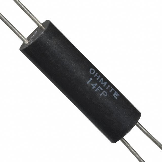

    70 mOhms ±1% 4.5W 轴向 通孔电阻器 电流感应,非电感 金属元素
14FPR070E 数据手册
10 Series Axial Wire Element Current Sense Two Terminal Axial F e at u r e s • Ideal for current sensing applications • 1% Tolerance standard, others available • Fixed resistance measuring point “M” • Low inductance (non-inductive below 0.25Ω) • RoHS compliant product available; add “E” suffix to part number to specify S e r i e s s p e c i f i c at i o n s Series 12 13 15 Wattage 2 3 5 Ohms 0.005-0.10 0.005-0.20 0.005-0.25 C h a r a c t e r i s t i cs Terminals Solder-plated copper terminals or copper clad steel depending on ohmic value. RoHS solder is 96% Sn, 3.5% Ag, 0.5% Cu 700 Encapsulation Silicone molding compound Derating Linearly from 100% @ +25°C to 0% @ +275°C 500 ppm/ °C Tolerance ±1% standard; Others available Power rating Based on 25°C free air rating Overload 5 times rated wattage for 5 seconds Thermal EMF Less than ±2µV/°C 0 Temperature range -55°C to 275°C L max. D ±.010" / ±0.3mm d ±.002" / ±0.05mm Length “L” Diam. “D” “M” “d” (lead ga.) 12 2 0.416 / 10.6 0.094 / 2.4 1.156 / 29.4 20 15 5 0.935 / 23.8 0.330 / 8.4 1.675 / 42.5 18 13 3 0.570 / 14.5 0.205 / 5.2 0 10 20 30 Milliohms 40 50 OR D ERIN G IN F ORMATION M Series Wattage 300 100 Insulation resistance Not less than 1000MΩ 1.562" ±0.062 / 39.7mm ±1.6 2 watt 3 watt 5 watt 400 200 Dielectric withstanding voltage 1000 VRMS for 3 and 5 watt; 500 VRMS for 2 watt Dimensions Temperature Coefficient of Resistance 600 1.310 / 33.3 20 Wattage RoHS Compliant 13FR050ET 10 Series Tolerance Ohm Value Tape & reel F = 1% Example: 12FR: 1250 pcs D=0.5% R050 = 0.05Ω 13FR: 1000 pcs 15FR: 750 pcs Standard part numbers Ohmic value 0.005 0.010 0.015 0.020 0.025 0.030 0.040 0.050 0.060 0.070 0.080 0.090 0.100 0.150 0.200 0.250 2 watt 3 watt 12FR005E 13FR005E 12FR010E 13FR010E 12FR015E 13FR015E 12FR020E 13FR020E 12FR025E 13FR025E 12FR030E 13FR030E 12FR040E 13FR040E 12FR050E 13FR050E 12FR060E 13FR060E 12FR070E 13FR070E 12FR080E 13FR080E 12FR090E 13FR090E 12FR100E 13FR100E 13FR150E 13FR200E 5 watt 15FR005E 15FR010E 15FR015E 15FR020E 15FR025E 15FR030E 15FR040E 15FR050E 15FR060E 15FR070E 15FR080E 15FR090E 15FR100E 15FR150E 15FR200E 15FR250E (continued) 44 1-866-9-OHMITE • Int’l 1-847-258-0300 • Fax 1-847-574-7522 • www.ohmite.com • info@ohmite.com 10 Series Axial Wire Element Current Sense Four Terminal Axial Ohmite’s Four-terminal Current-sense Resistors are specifically designed for low-resistance applications requiring the highest accuracy and temperature stability. This four-terminal version of Ohmite’s 10 Series resistor is specially designed for use in a Kelvin configuration, in which a current is applied through two opposite terminals and sensing voltage is measured across the other two terminals . The Kelvin configuration enables the resistance and temperature coefficient of the terminals to be effectively eliminated. The four terminal design also results in a lower temperature coefficient of resistance and lower self-heating drift which may be experienced on two-terminal resistors. The requirement to connect to the terminals at precise test points is eliminated, allowing for tighter tolerancing on the end application. F e at u r e s • Ideal for current sensing applications • 1% Tolerance standard, others available • Low Inductance (non-inductive below 0.25Ω) • Tinned Copper Leads • RoHS Compliant S e r i e s s p e c i f i c at i o n s Series Wattage Ohms 13 3 0.005-0.1 14 4.5 0.005-0.1 17 7 0.005-0.1 C h a r a c t e r i s t i cs Dimensions Terminals Tinned Copper Leads D +.015 / +0.4 L +.015 / +0.4 A (min.) Encapsulation Silicone Molding Compound B ±.010 / ±0.03 Derating Linearly from 100% at +25˚C to 0% at +200˚C 0.032 ±.002 0.81±.05 (20 AWG) Resistance Range 0.005Ω to 0.100Ω standard Standard Tolerance ±1%; others available Operating Temp. Range -55˚C to +200˚C Temperature Coefficient (0˚C to 85˚C) ≥0.015Ω: ±50 PPM/˚C; of Resistance

物料型号:10 Series Axial Wire Element Current Sense Resistors
器件简介:这些电阻器是轴向线绕元件电流感应电阻器,适用于电流感应应用,具有1%的标准公差,也提供其他公差选项。它们具有低电感特性(在0.25Ω以下非电感性),并且有RoHS合规产品可供选择。
引脚分配:文档中提到了两种类型的引脚分配,一种是两端口的,另一种是四端口的(Kelvin配置),后者用于提高测量精度和温度稳定性。
参数特性: - 端子:根据欧姆值,可能是镀锡铜端子或铜包钢端子。 - 封装材料:硅树脂模塑化合物。 - 公差:标准为+1%,也提供其他公差选项。 - 功率等级:基于25°C自由空气条件下的额定值。 - 过载能力:5倍额定功率持续5秒。 - 耐电压:3W和5W的为1000VRMS,2W的为500VRMS。 - 绝缘电阻:不低于1000MΩ。 - 热电势:小于2V/°C。 - 温度范围:-55°C至275°C。
功能详解:四端口电流感应电阻器专为低电阻应用设计,需要最高准确性和温度稳定性。Kelvin配置可以有效地消除端子的电阻和温度系数,四端口设计还导致更低的电阻温度系数和更低的自热漂移。
应用信息:这些电阻器非常适合电流感应应用,具有低电感和标准1%的公差。
封装信息:文档提供了不同瓦特数的电阻器尺寸,包括长度和直径,以及引脚间距。
订购信息:提供了订购时需要的电阻器型号、公差、欧姆值等信息,以及RoHS合规产品的后缀“E”。
