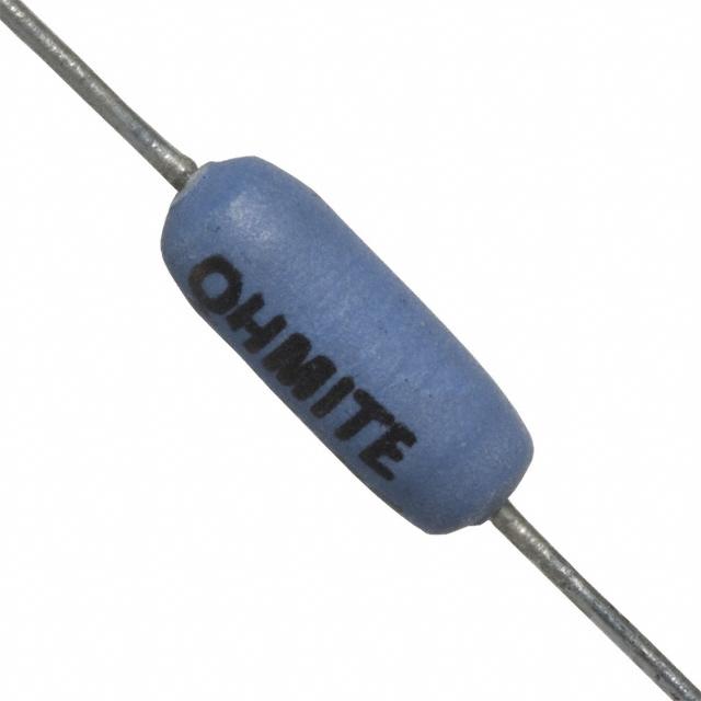

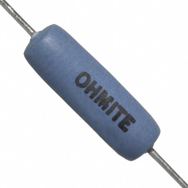

    15 Ohms ±5% 3W 轴向 通孔电阻器 绕线
33J15R 数据手册
High Energy Wirewound Axial Terminal / Surface Mount / Heat Sinkable Packaging Ohmite Manufacturing’s family of High Energy Wirewound Resistors employ special winding techniques to maximize the effective joule rating of each resistor. Most wirewound resistors are wound with the objective of meeting the stated power (wattage) rating and keeping cost low through the use of automatic winding equipment. Typically, manufacturers will allow substitution of resistance wire, depending on material availability. On tight tolerance wirewounds some type of abrasive adjustment to the resistance wire is often used to maximize production yields. Both of these procedures can adversely affect the joule rating and fusing current of a wirewound resistor, and this is often the reason that the manufacturer does not publish a fixed joule rating. Ohmite High Energy Wirewounds are wound so as to maintain the tightest possible pitch (space between windings) and thereby maximize the mass of the resistive element. Since no wire substitutions are allowed, and no abrasive adjusting is permitted in this family, Ohmite can publish a fixed joule rating and fusing current for each part number in the series. This technique can be applied to any wirewound product. In order to provide the broadest selection of packaging, Ohmite has developed standard offerings in three different package types-axial, SMD, and heat sinkable. Other sizes and types can be quoted on request, such as tubular power resistors. SE R IES S P E C I F I C A T IONS Series 33Jxxx 35Jxxx 30Jxxx 825JxxxH RH3R0DBxxxJ Type Axial Axial Axial Heat Sinkable Surface Mount Watts 3 5 10 25 3 Tolerance 5% 5% 5% 5% 5% Voltage 200 460 1000 520 200 Dimensions 1.5 / 38.1 33J: 0.593 / 15.1 35J: 1.000 / 25.4 30J: 1.900 / 46.8 825JxxxH: 1.938 / 49.23 33J: 0.218 / 5.5 35J: 0.343 / 8.7 30J: 0.406 / 10.3 33J: 20 ga. 35J: 18 ga. 30J: 18 ga. 0.273 / 6.934 0.226 / 5.740 RH3R0DBxxxJ: 0.612 / 15.545 0.546 / 13.87 1.080 / 27.43 in. / mm 1-866-9-OHMITE • Int’l 1-847-258-0300 • Fax 1-847-574-7522 • www.ohmite.com • info@ohmite.com 61 33 J1 33 R0 J5 33 R0 J1 33 0R J1 33 5R J2 33 0R J2 33 5R J3 33 0R J5 33 0R J1 35 00 J1 35 R5 J2 35 R5 J7 35 R5 J1 35 2R J1 35 8R J2 35 2R J3 35 6R J4 35 7R J7 30 5R J2 30 R0 J4 30 R7 J6 30 R8 J1 30 5R J2 30 7R J3 30 3R J5 30 0R J8 30 2R J1 30 00 J1 50 50 62 50 40 100 80 30 60 20 40 20 0 Fusing Energy (J) 600 500 200 100 0 Fusing Current (A) 40 30 20 825J- 250 Fusing Energy (J) 200 50 0 825J- 45 Fusing Current (A) 40 35 30 15 825J- 1-866-9-OHMITE • Int’l 1-847-258-0300 • Fax 1-847-574-7522 • www.ohmite.com • info@ohmite.com -R 50 -1R 0J 0 -2R 0J 7 -4R 0J 7 -6R 0J 8 -7R 0J 5 -10 0J R -15 0J R -25 0J R -47 0J R -68 0J R -75 0J R0 J 120 Energy (J) -R 50 -1R 0J 0 -2R 0J 7 -4R 0J 7 -6R 0J 8 -7R 0J 5 -10 0J R -15 0J R -25 0J R -47 0J R -68 0J R -75 0J R0 J 140 -1R 0 -5R H 0 -10 H R -25 H R -36 H R -47 H R -75 H R -10 H 0 -15 H 0H 160 60 14 10 2 0 0 60 400 150 30 300 100 20 35 25 20 20 15 10 10 5 5 0 0 0 RH3R0DB- -R 50 -1R 0J 0 -2R 0J 7 -4R 0J 7 -6R 0J 8 -7R 0J 5 -10 0J R -15 0J R -25 0J R -47 0J R -68 0J R -75 0J R0 J 700 Energy (J) -1R 0 -5R H 0 -10 H R -25 H R -36 H R -47 H R -75 H R -10 H 0 -15 H 0H 33 J1 33 R0 J5 33 R0 J1 33 0R J1 33 5R J2 33 0R J2 33 5R J3 33 0R J5 33 0R J1 35 00 J1 35 R5 J2 35 R5 J7 35 R5 J1 35 2R J1 35 8R J2 35 2R J3 35 6R J4 35 7R J7 30 5R J2 30 R0 J4 30 R7 J6 30 R8 J1 30 5R J2 30 7R J3 30 3R J5 30 0R J8 30 2R J1 30 00 J1 50 180 -1R 0 -5R H 0 -10 H R -25 H R -36 H R -47 H R -75 H R -10 H 0 -15 H 0H 33 J1 33 R0 J5 33 R0 J1 33 0R J1 33 5R J2 33 0R J2 33 5R J3 33 0R J5 33 0R J1 35 00 J1 35 R5 J2 35 R5 J7 35 R5 J1 35 2R J1 35 8R J2 35 2R J3 35 6R J4 35 7R J7 30 5R J2 30 R0 J4 30 R7 J6 30 R8 J1 30 5R J2 30 7R J3 30 3R J5 30 0R J8 30 2R J1 30 00 J1 50 High Energy Wirewound Axial Terminal / Surface Mount / Heat Sinkable Packaging p e rf o r m a n c e charact e r i s i c s Energy (J) 12 10 8 6 4 RH3R0DB- Fusing Energy (J) 50 40 10 0 0 RH3R0DB- Fusing Current (A) 30 25 10 (continued) High Energy Wirewound Axial Terminal / Surface Mount / Heat Sinkable Packaging o rd e r i n g i n f o r m at i o n Standard Part Numbers Part Number Ohms Power Energy Fusing Current (J) Energy (J) to fuse (A) Power to fuse (W) 33J1R0 33J5R0 33J10R 33J15R 33J20R 1 5 10 15 20 3 3 3 3 3 12.70 6.25 4.94 4.66 3.91 53.26 26.20 20.73 19.55 16.40 23.93 10.03 7.08 5.95 5.00 572.60 502.96 501.70 531.47 500.45 33J25R 33J30R 33J50R 33J100 35J1R5 25 30 50 100 1.5 3 3 3 3 5 3.07 2.97 2.43 1.92 76.55 12.89 12.46 10.20 8.07 321.19 4.20 3.92 2.97 2.10 40.32 441.79 460.80 440.68 439.58 2438.48 35J2R5 35J7R5 35J12R 35J18R 35J22R 2.5 7.5 12 18 22 5 5 5 5 5 64.65 37.66 37.90 28.80 27.48 271.23 158.01 158.99 120.84 115.29 31.59 16.90 14.20 11.13 10.03 2494.75 2141.89 2420.25 2228.50 2213.02 35J36R 35J47R 35J75R 30J2R0 30J4R7 36 47 75 2 4.7 5 5 5 10 10 22.78 23.22 18.77 162.30 150.86 95.59 97.42 78.77 680.93 632.92 7.86 7.08 5.55 47.98 33.88 2222.93 2358.00 2309.77 4603.79 5395.94 30J6R8 30J15R 30J27R 30J33R 30J50R 6.8 15 27 33 50 10 10 10 10 10 137.27 119.76 85.27 65.54 62.45 575.91 502.47 357.74 274.98 262.03 28.47 20.11 14.20 11.93 10.03 5513.41 6065.77 5445.56 4700.40 5029.59 30J82R 30J100 30J150 825J1R0H 825J5R0H 82 100 150 1 5 10 10 10 25 25 51.90 49.41 46.61 51.04 39.92 217.74 207.28 195.54 214.12 167.49 7.86 7.08 5.95 40.32 20.11 5063.34 5017.03 5314.71 1625.65 2021.92 825J10RH 825J25RH 825J36RH 825J47RH 825J75RH 10 25 36 47 75 25 25 25 25 25 31.58 19.64 17.79 18.71 14.66 132.50 82.40 74.62 78.49 61.49 14.20 8.43 7.08 6.60 5.00 2016.87 1776.01 1806.13 2049.57 1876.69 25 25 3 3 3 12.29 11.59 12.93 10.23 6.87 51.56 48.64 54.25 42.91 28.82 4.20 3.53 31.59 22.31 13.24 1767.15 1872.00 498.95 497.70 473.33 825J100H 100 825J150H 150 RH3R0DBR500J 0.5 RH3R0DB1R00J 1 RH3R0DB2R70J 2.7 RH3R0DB4R70J RH3R0DB6R80J RH3R0DB7R50J RH3R0DB10R0J RH3R0DB15R0J 4.7 6.8 7.5 10 15 3 3 3 3 3 5.87 5.34 4.75 3.98 3.75 24.63 22.41 19.91 16.70 15.75 10.03 8.43 7.86 6.60 5.55 472.78 483.07 463.11 436.08 461.95 RH3R0DB25R0J RH3R0DB47R0J RH3R0DB68R0J RH3R0DB75R0J 25 47 68 75 3 3 3 3 3.07 2.28 2.08 2.29 12.89 9.59 8.72 9.62 4.20 2.97 2.49 2.49 441.79 414.24 423.26 466.83 RoHS compliant product available; Add “E” suffix to part number to specify. Other values available, contact Ohmite for details. 1-866-9-OHMITE • Int’l 1-847-258-0300 • Fax 1-847-574-7522 • www.ohmite.com • info@ohmite.com 63
