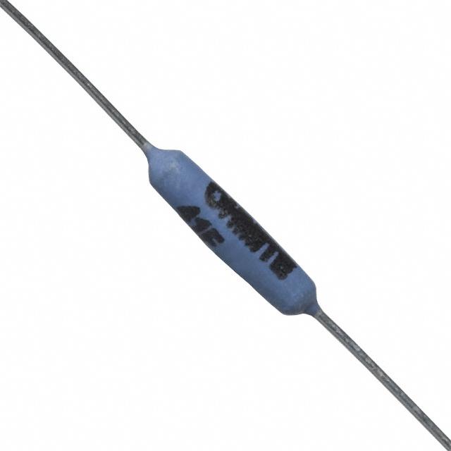

    插件,D3.2xL11.1mm
    130mΩ ±1% 1W 轴向 通孔电阻器 绕线
41FR13E 数据手册
40 Series Ohmicone Silicone-Ceramic Conformal Axial Terminal Wirewound 1% and 5% Tolerance Standard ® Ohmite 40 Series resistors are the most economical conformal silicone-ceramic coated resistors offered. These all-welded units are characterized by their low temperature coefficients and resistance to thermal shock, making them ideal for a wide range of electrical and electronic applications. Units with 1% and 5% tolerances are identical in construction and electrical specifications. Durable but economical 40 Series resistors exceed industry requirements for quality. F e at u r e s • Economical • Applications include commercial, industrial and communications equipment • Stability under high temperature conditions • All-welded construction • RoHS compliant; add “E” suffix to part number to specify. S e r i e s S P E C I F I C ATI O N S Series 41 42 43 45 47 40 Wattage 1.0 2.0 3.0 5.0 7.0 10.0 Ohms 0.10-6K 0.10-8K 0.10-20K 0.10-70K 0.10-80K 0.10-150K Voltage 150 100 200 460 670 1000 Non-Inductive versions available. Insert “N” before tolerance code. Example: 42NJ27R C h a r a c t e r i s t i cs Coating Conformal silicone-ceramic. Core Ceramic. Terminals Solder-coated copper clad axial. RoHS solder composition is 96% Sn, 3.5% Ag, 0.5% Cu Derating Linearly from 100% @ +25°C to 0% @ +275°C. Tolerance ±5% (J type), ±1% (F type) (other tolerances available). Power rating Based on 25°C free air rating Overload Under 5 watts: 5 times rated wattage for 5 seconds. 5 watts and over: 10 times rated wattage for 5 seconds. Temperature coefficient Under 1Ω: ±90 ppm/°C; 1Ω to 9.99Ω: ±50 ppm/°C; 10Ω and over: ±20 ppm/°C Operating temp. range -55°C to 275°C D i m e ns i ons Series (in./mm max.) 1.5 in. / 38.1mm min. L D Wattage Length Diam. 41 1.0 0.437 / 11.1 0.125 / 3.2 Lead ga. 24 42 2.0 0.406 / 10.3 0.219 / 5.6 20 43 3.0 0.593 / 15.1 0.219 / 5.6 20 45 5.0 0.937 / 23.8 0.343 / 8.7 18 47 7.0 1.280 / 32.5 0.343 / 8.7 18 40 10.0 1.900 / 48.3 0.406 / 10.3 18 (continued) 84 1-866-9-OHMITE • Int’l 1-847-258-0300 • Fax 1-847-574-7522 • www.ohmite.com • info@ohmite.com 40 Series Ohmicone Silicone-Ceramic Conformal Axial Terminal Wirewound 1% and 5% Tolerance Standard ® O R D ERI N G I N F O RMATI O N Standard part numbers                                                                     40 Series Ohmicone® Silicone Ceramic Conformal Axial Term. Wirewound Wattage 1 = 1W 2 3 5 7 0 = 10W 2,200 –––2K2   2,500 –––2K5   2,700 –––2K7   3,000 –––3K0   3,300 –––3K3  3,500 –––3K5  3,900 –––3K9  4,000 –––4K0  4,500 –––4K5  4,700 –––4K7  5,000 –––5K0  6,000 –––6K0  6,800 –––6K8  7,000 –––7K0  7,500 –––7K5  8,000 –––8K0  9,000 –––9K0  10,000 –––10K  12,000 –––12K 13,000 –––13K 15,000 –––15K 17,000 –––17K 20,000 –––20K 22,000 –––22K 25,000 –––25K 30,000 –––30K 33,000 –––33K 35,000 –––35K 40,000 –––40K 50,000 –––50K    = Standard values                                                                                                              Shaded values  involve very fine resistance wire  and should not  be used in critical applications  without burn-in  and/or thermal cycling.      = Non-standard values subject to minimum handling charge per item Non-Inductive Winding optional RoHS (blank= std. Compliant winding) 41NJR10E-T Tolerance Resistance F= 1% R10 = 0.10Ω J = 5% 1R0 = 1.0Ω 10R = 10.0Ω 250 = 250Ω 1K0 = 1,000Ω 4K5 = 4,500Ω 50K = 50,000Ω Tape & reel optional pc/reel: 41: 5000 42: 1250 43: 1250 45: 1000 47: 500 40: 500 rev 6/20-2 1-866-9-OHMITE • Int’l 1-847-258-0300 • Fax 1-847-574-7522 • www.ohmite.com • info@ohmite.com 40J––– 10                                   85 45J––– 5                                   43J––– 3                                   42J––– 2                                   41J––– 1                                   40F––– 10                                   45F––– 5                                   43F––– 3 –––68R –––75R –––82R –––100 –––120 –––125 –––150 –––180 –––200 –––220 –––225 –––250 –––270 –––300 –––330 –––350 –––390 –––400 –––450 –––470 –––500 –––560 –––600 –––680 –––750 –––800 –––820 –––900 –––1K0 –––1K1 –––1K2 –––1K5 –––1K8 –––2K0 Part No. Prefix  Suffix 41F––– 1 68 75 82 100 120 125 150 180 200 220 225 250 270 300 330 350 390 400 450 470 500 560 600 680 750 800 820 900 1,000 1,100 1,200 1,500 1,800 2,000 Ohmic value                                 40J––– 10                                   45J––– 5 40J––– 10                                   43J––– 3 45J––– 5                                 42J––– 2 43J––– 3                                   41J––– 1 42J––– 2                                 40F––– 10 41J––– 1                                 45F––– 5 40F––– 10                                 43F––– 3 45F––– 5                                41F––– 1 43F––– 3 –––R10 –––R15 –––R20 –––R25 –––R30 –––R33 –––R40 –––R50 –––R75 –––1R0 –––1R5 –––2R0 –––2R2 –––3R0 –––4R0 –––5R0 –––7R5 –––10R –––12R –––15R –––18R –––20R –––22R –––25R –––27R –––30R –––33R –––35R –––39R –––40R –––47R –––50R –––56R –––62R Ohmic value 41F––– 1 0.1 0.15 0.2 0.25 0.3 0.33 0.4 0.5 0.75 1 1.5 2 2.2 3 4 5 7.5 10 12 15 18 20 22 25 27 30 33 35 39 40 47 50 56 62 Part No. Prefix  Suffix  Part No. Prefix  Suffix Wattage and Tolerance 1% Tolerance 5% Tolerance   Wattage and Tolerance 1% Tolerance 5% Tolerance Ohmic value Wattage and Tolerance 1% Tolerance 5% Tolerance
