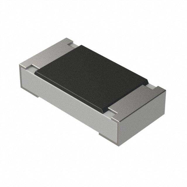

KDV Series Metal Film Low-Resistance Chip Resistor F e at u r e s A p p l i c at i o n s • Low Resistance / TCR / Inductance • Excellent long-term stability • High precision current sensing • High power capability • Halogen free and lead free • RoHs compliant • Consumer electronics • Computer • Telecom • Measuring instrument • Industrial / Power supply • Battery management system S e r i e s S p e c i f i c at i o n s Max. Rated Current Max. Overload Current Series Size Power @70°C KDV02 0201 1/10W 1.41A 3.16A KDV06 0603 1/5W 2.00A 4.47A KDV04 KDV08 KDV12 0402 0805 1206 1/8W 1/4W 1.58A 2.24A 1/2W 3.16A TCR (ppm/°C) 3.54A Resistance Range ±100 ±50 5.00A 50mΩ ~ 100mΩ 100mΩ ~ 1000mΩ 7.07A characteristics Derating Operating Temp. -55°C ~+155°C Range Power rating and Based on continuous full-load at ambient temperature of 70°C current rating TCR Test to - 55°C is available on request % Rated Power 100 Rated Current Resistance Range: ≤1Ω. DC continuous working current or a AC (rms) continuous working current at commercial-line frequency and wave form corresponding to the power rating, as determined formula Rated current = √(Rated power/Resistance) 80 -55° 60 40 155° 20 0 -60 Storage Storage time at environmental temp. 25°C ±5° & humidity 60 ±20% is valid for one year from the date of delivery 70° -20 20 60 100 140 Ambient Temperature (°C) 180 dimensions (mm) Size l1 L W H l1 l2 A B C Land pattern KDV02 0.60 ±.03 0.30 ±.03 0.26 ±.05 0.15 ±.05 0.15 ±.05 0.25 0.85 0.35 B A KDV04 1.00 ±.10 0.50 ±.05 0.35 ±.05 0.20 ±.10 0.25 ±.10 0.50 1.60 0.70 KDV06 1.60 ±.10 0.80 ±.10 0.45 ±.10 0.25 ±.15 0.30 ±.15 0.80 2.40 1.00 KDV08 2.00 ±.10 1.25 ±.10 0.55 ±.10 0.35 ±.20 0.40 ±.20 1.30 2.90 1.45 KDV12 3.10 ±.10 1.60 ±.10 0.55 ±.10 0.40 ±.20 0.45 ±.20 2.20 4.20 1.80 l2 12 1-866-9-OHMITE • Int’l 1-847-258-0300 • Fax 1-847-574-7522 • www.ohmite.com • info@ohmite.com C KDV Series Metal Film Low-Resistance Chip Resistor p e r f o r m a n c e d ata Test Method Temp. Coefficient of JIS C 5201-1, clause 4.8 Resistance (T.C.R.) Short Time Overload JIS C 5201-1, clause 4.13 Insulation JIS C 5201-1, clause 4.6 Resistance Solderability JIS C 5201-1, clause 4.17 Resistance to JIS-C5201-1, clause 4.18 Soldering Heat Leaching JIS-C5201-1, clause 4.18 Temperature Cycling JIS C 5201-1, clause 4.19 High Temperature JIS-C5201-1 4.25 Exposure Resistance to JIS C 5201-1, clause 4.29 Solvent Load Life in JIS C 5201-1 clause 4.24 Humidity Load Life JIS C 5201-1 clause 4.25 (Endurance) Terminal Bending JIS C 5201-1, clause 4.33 Strength Procedure TCR +125°C, 25°C is the reference temperature Requirements Refer to Standard Electrical Specifications Standard power: 6.25 times rated power whichever is less for 5 seconds High power (2X/4X): 5 times rated power whichever is less for 5 seconds. 100V for 1 minute. ±(1.0%+0.001Ω) ≥10GΩ 245 ±5°C for 3 ±0.5secs. >95% Coverage, No visible damage 260 ±5°C for 30 seconds. >95% Coverage, No visible damage 155 ±5°C for 1000 +48/-0 hours. ±(1.0%+0.001Ω) 260 ±5°C for 10 seconds. ±(1.0%+0.001Ω), No visible damage -55°C to +155°C, 300 cycles ±(1.0%+0.001Ω), No visible damage The tested resistor be immersed into isopropyl alcohol of 20~25°C for 60 secs. Then the resistor is left in the room for 48 hrs. 40±2°C, 90~95% R.H. , Rated power or Max. working current whichever is less for 1000 hrs with 1.5 hrs ON and 0.5 hr OFF. 70±2°C, Rated power, or Max. working current whichever is less for 1000 hrs with 1.5 hrs ON and 0.5 hr OFF. Bending once for 5 seconds: 0402, 0603, 0805 = 5mm; 1206, 1210 = 3mm; 2010, 2512 = 2mm ±(1.0%+0.001Ω), No visible damage ±(1.0%+0.001Ω) ±(1.0%+0.001Ω) ±(1.0%+0.001Ω), No visible damage soldering Wave solder Temp. (°C) Solder reflow Peak: 260°C +5/-0 Temp. (°C) 260° 230°C or higher 235° Rework temperature (hot air equipment): 350℃, 3~5seconds 260°C / 10 sec. Recommended reflow methods: IR, vapor phase oven, hot air oven Second wave First wave 180° 150° Pre-heating zone 90 sec. ±30 130° Soldering zone 30 sec. ±10 If reflow temperatures exceed the recommended profile, devices may not meet the performance requirements. ~5K/sec. ~200K/sec. ~2K/sec. 100° Forced cooling ~2K/sec. Time (sec.) 0 50 100 150 1-866-9-OHMITE • Int’l 1-847-258-0300 • Fax 1-847-574-7522 • www.ohmite.com • info@ohmite.com 200 Time (sec.) 250 13 KDV Series Metal Film Low-Resistance Chip Resistor Ta p e a n d r e e l D H 2.0mm ±0.5 G 11.5mm ±2.0 2512: 16.0mm Paper tape B T A 13.5mm ±1.0 E F W P 40° Back lead ≥120mm (30pcs) Resistors Space pcs ≥200mm (50pcs) 21mm ±1.0 Space tape ≥200mm Paper tape: 300mm/min. 10~70g 10° Size A B W E F G H T D P KDV02 KDV04 KDV06 KDV08 KDV12 0.45 ±.1 0.7 ±.1 1.05 ±.2 1.55 ±.2 1.90 ±.2 0.75 ±.1 1.20 ±.1 1.80 ±.2 2.30 ±.2 3.05 ±.2 60.0mm +1.0 178.0mm ±2.0 (mm) 8.0 ±.2 8.0 ±.2 8.0 ±.2 8.0 ±.2 8.0 ±.2 1.75 ±.1 1.75 ±.1 1.75 ±.1 1.75 ±.1 1.75 ±.1 3.5 ±.05 3.5 ±.05 3.5 ±.05 3.5 ±.05 3.5 ±.05 4.0 ±.1 4.0 ±.1 4.0 ±.1 4.0 ±.1 4.0 ±.1 2.0 ±.05 2.0 ±.05 2.0 ±.05 2.0 ±.05 2.0 ±.05 0.35 ±.1 0.45 ±.1 0.60 ±.1 0.75 ±.1 0.75 ±.1 1.50 +.1/-0 1.50 +.1/-0 1.50 +.1/-0 1.50 +.1/-0 1.50 +.1/-0 Qty. per reel 2.0 ±.1 2.0 ±.1 4.0 ±.1 4.0 ±.1 4.0 ±.1 10K 10K 5K 5K 5K OR D ERING INFORMATION Marking Size RoHS Compliant KDV06DR100ET KDV series Size 02 = 0201 04 = 0402 06 = 0603 08 = 0805 12 = 1206 Tolerance D = 0.5% F = 1% G = 2% J = 5% Resistance Resistance Code 0201, 0402 Example Value no marking 0603 50mΩ ~ 99mΩ 100mΩ ~ 990mΩ 1000mΩ 0XX RXX 1R0 068 R68 1R0 68mΩ 680mΩ 1000mΩ 0805, 1206, 1210, 2010, 2512 50mΩ ~ 99mΩ (only for 0805,1206, 1210) 100mΩ ~ 990mΩ 1000mΩ R0XX R068 68mΩ RXXX 1R00 R680 1R00 680mΩ 1000mΩ Tape and reel Standard part numbers Size 0201 0201 0402 0402 0603 0603 0805 0805 1206 1206 Power 0.10W 0.10W 0.125W 0.125W 0.20W 0.20W 0.25W 0.25W 0.5W 0.5W Tolerance 0.5% 1% 0.5% 1% 0.5% 1% 0.5% 1% 0.5% 1% Ohm Value Part. No. KDV02D- KDV02F- KDV04D- KDV04F- KDV06D- KDV06F- KDV08D- KDV08F- KDV12D- KDV12F- 50mΩ 68mΩ 82mΩ 100mΩ 120mΩ 150mΩ 180mΩ 200mΩ 220mΩ 240mΩ 270mΩ 300mΩ 330mΩ 360mΩ 390mΩ 470mΩ 510mΩ 560mΩ 620mΩ 820mΩ -R050ET -R068ET -R082ET -R100ET  -R120ET                                               -R150ET -R180ET -R200ET -R220ET -R240ET                                                   -R270ET -R300ET -R330ET -R360ET -R390ET                                                   -R470ET -R510ET -R560ET -R620ET -R820ET                                                   rev 1/21-2 14 1-866-9-OHMITE • Int’l 1-847-258-0300 • Fax 1-847-574-7522 • www.ohmite.com • info@ohmite.com Mouser Electronics Authorized Distributor Click to View Pricing, Inventory, Delivery & Lifecycle Information: Ohmite: KDV04DR050ET KDV04DR082ET KDV04DR100ET KDV04DR120ET KDV04DR150ET KDV04DR180ET KDV04FR510ET KDV04FR560ET KDV04FR620ET KDV04FR820ET KDV02FR240ET KDV02FR620ET KDV02FR820ET KDV04FR330ET KDV04FR360ET KDV04FR390ET KDV04FR470ET KDV02FR330ET KDV02FR360ET KDV02FR390ET KDV02FR470ET KDV02FR510ET KDV02FR560ET KDV02FR150ET KDV02FR180ET KDV02FR200ET KDV02FR220ET KDV02FR270ET KDV02FR300ET KDV02DR820ET KDV02FR050ET KDV02FR068ET KDV02FR082ET KDV02FR100ET KDV02FR120ET KDV02DR360ET KDV02DR390ET KDV02DR470ET KDV02DR510ET KDV02DR560ET KDV02DR620ET KDV02DR200ET KDV02DR220ET KDV02DR240ET KDV02DR270ET KDV02DR300ET KDV02DR330ET KDV04FR300ET KDV02DR100ET KDV02DR120ET KDV04DR068ET KDV02DR150ET KDV02DR180ET KDV04FR150ET KDV04FR180ET KDV04FR200ET KDV04FR220ET KDV04FR240ET KDV04FR270ET KDV04DR820ET KDV04FR050ET KDV04FR068ET KDV04FR082ET KDV04FR100ET KDV04FR120ET KDV04DR360ET KDV04DR390ET KDV04DR470ET KDV04DR510ET KDV04DR560ET KDV04DR620ET KDV04DR200ET KDV04DR220ET KDV04DR240ET KDV04DR270ET KDV04DR300ET KDV04DR330ET
KDV06DR620ET
物料型号:KDV系列,金属膜低电阻芯片电阻器。
器件简介: - 低电阻/TCR/电感特性。 - 适用于消费电子、计算机、电信、测量仪器、工业/电源供应、电池管理系统。 - 具有优异的长期稳定性、高精度电流检测、高功率能力和无卤素、无铅特性。 - 符合RoHS标准。
引脚分配:文档中未明确提供引脚分配信息。
参数特性: - 工作温度范围:-55°C至+155°C。 - 额定电流和功率等级基于70°C环境温度下的连续满载。 - 存储条件:在25°C环境温度和60%相对湿度下,存储时间自交货日期起一年内有效。
功能详解: - 电阻值(TCR):温度系数,参照标准电气规格。 - 短时间过载:标准功率和高功率(2X/4X)的过载测试。 - 绝缘电阻:100V下1分钟测试,要求≥10GΩ。 - 焊接性:245-255°C下3±0.5秒的焊接测试。 - 耐焊接热:260±5°C下10秒的耐热测试。 - 浸出测试:260-285°C下30秒的浸出测试。 - 温度循环:-55°C至+155°C,300次循环的测试。 - 高温暴露:155°C下1000小时的高温暴露测试。 - 耐溶剂性:在20-25°C的异丙醇中浸泡60秒,然后在室温下放置48小时。 - 湿度负载寿命:在40°C,90-95%相对湿度下,以额定功率或最大工作电流(取较小者)进行1000小时的测试。
应用信息:适用于多种电子设备,包括消费电子、计算机、电信设备、测量仪器、工业设备和电源供应、电池管理系统等。
封装信息: - 提供了不同尺寸(如0201、0402、0603、0805、1206等)的详细尺寸数据,包括长度(L)、宽度(W)、高度(H)以及相关的封装图案尺寸参数(11、12、A、B、C)。
