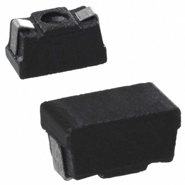

RW1S0BA1R00J 数据手册
Surface Mount Power Standard pedestal mount Recessed-base mount RC Series: carbon composition (1/4 & 1/2 watt) RC Series: ceramic composition (above 1/2 watt) RF Series: metal film RW Series: wirewound RP Series: power film RM Series: high voltage thick film Flexible J-bend F e at u r e s • Tolerance 1%, 5%, 10%, depending on construction • Twelve wattage ratings • Seven package sizes • Two mounting designs to accommodate your soldering process • Five power resistor technologies to optimize your operating performance: 1. Carbon and Ceramic composition for surge and low inductance 2. Metal film for high ohmic value and low T.C. 3. Wire element for inrush current combined with low ohmic values. Resistance values as low as 0.005Ω 4. Power film for high ohmic value and high wattage 5. High Voltage thick film for high voltage applications • Flexible J-bend terminations • Working Temperature Range: -55°C to +150°C S ER I E S S P E C I F I C AT I O N S Part Number Power Maximum (watts)* voltage 1% tol. Resistance range Temp. Coefficient 5% tol. 10% tol. 0.1Ω–1Ω 1Ω–10Ω 10Ω+ RC0S2CA––––– 0.25 250 — RW0S6BB––––– 0.6 50 0.010Ω–1K 50 0.005Ω–1K RC0R5DB––––– RF0S8BA––––– 0.50 350 — — Quantity per reel ±400 ±400 1000V 16mm 1500 0.005Ω–1K ±90 ±50 ±20 1000V 12mm 2500 0.005Ω–1K ±90 2.2Ω–20M ±400 ±400 RP1S3CA––––– 1.25 350 RP1S5CB––––– RP1R5CB––––– 1.5 350 75 0.005Ω–1.5K 0.005Ω–1.5K ±90 ±250 ±250 1000V 16mm 1500 RW2S0CB––––– RW2R0CB––––– 2.0 100 0.005Ω–5K 0.005Ω–5K ±90 ±50 ±20 1000V 16mm 1000 RP2S0DA––––– RP2R0DA––––– 2.0 500 — — ±250 ±250 1000V 24mm 1000 RW2S0DA––––– RW2R0DA––––– 2.0 100 0.005Ω–5K ±90 ±50 ±20 1000V 24mm 1000 RP2R5DB––––– RW3R0DB––––– 2.5 500 — ±250 ±250 1000V 24mm 1000 RP3R0EA––––– 3.0 3.0 750 — ±250 ±250 1000V 32mm 750 — — ±50 RC1R0EA––––– RW1S5CA––––– RW3R5EA––––– RM0R7EA––––– 1.0 1.5 3.5 0.75 500 — 1Ω–10M — ±200 ±100 — ±250 — — 1Ω–1M 1Ω–1M 1Ω–1M 0.005Ω–5K 1Ω–1M — 200 0.005Ω–13K 0.005Ω–13K ±90 350 0.005Ω–25K 0.005Ω–25K ±90 2500 ±50 3.3-100K (10% tol only) — 1KΩ–1000M 1Ω–1M 1KΩ–1000M *25°C ambient. E24 values standard; contact Ohmite for custom values. 32 ±100 ±250 ±50 ±50 1-866-9-OHMITE • Int’l 1-847-258-0300 • Fax 1-847-574-7522 • www.ohmite.com • info@ohmite.com ±20 -1300 ±250 ±250 ±20 ±20 1000V 1000V 1000V 1000V 1000V 1000V 1000V 1000V 1000V 12mm 12mm 16mm 32mm 16mm 16mm 24mm 32mm 32mm 1000 350 10Ω–1M ±100 24mm 1.0 RF1S0CA––––– — 1000V 200 1.0 — — 0.8 RW1S0BA––––– 1Ω–5M Tape Size 13” reels — — 2.2Ω–5.6M Dielectric Withstanding 2000 2000 1500 750 1500 1000 1000 750 750 (continued) Surface Mount Power p e r fo r m a nc e d a t a ALL models: Immersion (260°C for Momentary 10 sec.) Overload ±3.0%+.05Ω 6.3x rated power for 5 sec. ±0.1%+.05Ω 2x rated power for 0.1 sec. ±0.1%+.05Ω 5x rated power for 5 sec. ±0.5%+.05Ω 2x rated power for 0.1 sec. ±0.1%+.05Ω 5x rated power for 5 sec. Leaching (260°C Solder immersion, 60 sec.)....................... No visible leaching Thermal Shock (Units at -55°C, then rated power applied).. No mechanical damage Flammability ......................................................................... UL Material rating, UL94V0 TCR 300 Typical TCR for less than 0.1Ω SMD resistors (PPM/°C) Temperature °C 300 100 80 60 40 20 0 0 25 50 75 100 125 Ambient Temperature, ϒC 150 Recommended Solder Profile 500 400 Derating Percent Rated Power Temp. cycle Load Life (-55°C to 125°C, (1000 hours Construction 1000 cycles) at 25°C) RC Carbon/Ceramic Comp. ±4.0%+.05Ω ±10.0%+.05Ω RF Metal Film ±0.5%+.05Ω ±0.5%+.05Ω RW Wirewound ±0.5%+.05Ω ±3.0%+.05Ω RP Power Film ±3.0%+.05Ω ±5.0%+.05Ω RN Wirewound, Non-inductive ±0.5%+.05Ω ±3.0%+.05Ω 200 10 sec. 200 Soldering: min. 220°C, max. 60 sec. 60 sec. Preheating Max. Temp.: 260°C ±5°, 10 sec. (RC only: 250°C ±5°, 3 sec.) Cooling 120 sec. 150 100 50 0 100 Preheating: 145°C ±15°, max. 120 sec. Soldering 250 0 50 100 150 200 Time (sec.) 250 0.02 0.04 0.06 0.08 0.10 Ohms 200 Package limit hot spot temperature rise 180 Alumina Temperature rise, ϒC 160 FR4 140 The temperature rise graph data was obtained by a selection of test substrate size and trace width for each resistor size to limit operating temperatures to safe values. The operating temperature safe rises are either 100°C substrate temperature rise or 180°C package hot spot temperature rise at 25°C ambient. 120 100 80 FR4: 0.062 in. thick; 0.062 in. traces 60 40 Solder joint 20 100% 200% Percent Rated power 300% Alumina: 0.040 in. thick; 0.010 in. traces Molding material rated at 205°C continuous. R C s e r i e s : b a k e p r oc e d u r e RC SERIES ONLY A. Heat Treatment 110°C ±10°C 15 hours B. Frequency of heat treatment 1 time only C. Cautions Solderability: may be affected due to oxidization of lead wire Resistance value: some units may not completely recover to original value. Soldering heat: some treated product may have substantial resistance change during soldering operation. It is recommended that parts be tested to evaluate soldering heat effects. 1-866-9-OHMITE • Int’l 1-847-258-0300 • Fax 1-847-574-7522 • www.ohmite.com • info@ohmite.com 33 Surface Mount Power d im e nsions (in./mm) M L B A N P J E Note 2 K =0.006 Ref. O Note 1 G H F =0.005 ±.001 D Packages A B BA (in.) 0.246±.020 0.136±.005 (mm) 6.248±.508 3.454±.127 CA (in.) 0.394±.020 0.159±.005 (mm) 10.008±.508 4.039±.127 CB (in.) 0.407±.020 0.226±.005 (mm) 10.338±.508 5.74±.127 DA (in.) 0.455±.020 0.240±.005 (mm) 11.557±.508 6.096±.127 DB (in.) 0.625±.020 0.273±.005 (mm) 15.875±.508 6.934±.127 EA (in.) 0.811±.020 0.273±.005 (mm) 20.599±.508 6.934±.127 BB (in.) 0.202±.010 0.10±.010 (mm) 5.140±.508 2.54±.127 I Recommended for glue dot application C Package Outline Dimensions C D G 0.133 REF 0.110±.010 0.047 ±0.020 3.378 REF 2.794±.254 1.194 ±0.508 0.156 REF 0.220±.010 0.062 Nom. 3.962 REF 5.588±.254 1.575 Nom. 0.222 REF 0.260±.010 0.062 Nom. 5.639 REF 6.604±.254 1.575 Nom. 0.236 REF 0.260±.010 0.062 Nom. 5.994 REF 6.604±.254 1.575 Nom. 0.268 REF 0.417±.010 0.062 Nom. 6.807 REF 10.592±.254 1.575 Nom. 0.268 REF 0.572±.010 0.093 Nom. 6.807 REF 14.529±.254 2.362 Nom. 0.095 REF 0.079±.010 0.050 Nom. 2.41 REF 2.00±.254 1.280 Nom. I 0.054±.012 1.372±.305 0.064±.012 1.626±.305 0.084±.012 2.134±.305 0.115±.012 2.921±.305 0.115±.012 2.921±.305 0.115±.012 2.921±.305 0.065±.012 1.640±.305 J 0.136±.005 3.454±.127 0.159±.005 4.038±.127 0.222±.005 5.639±.127 0.226±.005 5.740±.127 0.226±.005 5.740±.127 0.273±.005 6.934±.127 0.135±.005 3.420±.127 Note 1: Packages BA and CA are only available with a pedestal base. Packages CB and DA are available in either pedestal or recessed base. Packages DB and EA are only available in a recessed base. Note 2: Test point is .020 above PCB. Note 3: Tape and reel dimensions per EIA 481 A except “EA” size which is 12 mm component pitch versus 16mm pitch. L 0.150 3.81 0.256 6.50 0.276 7.01 0.317 8.05 0.474 12.040 0.611 15.52 0.078 1.98 PC Board Land Pattern M N O P 0.346 0.098 0.126 0.050 8.79 2.49 3.20 1.27 0.524 0.134 0.126 0.060 13.31 3.40 3.20 1.52 0.537 0.131 0.126 0.093 13.64 3.33 3.20 2.36 0.585 0.134 0.155 0.093 14.86 3.40 3.94 2.36 0.742 0.134 0.155 0.093 18.85 3.40 3.94 2.36 1.000 0.195 0.155 0.093 25.4 4.95 3.94 2.36 0.328 0.125 0.126 0.026 8.33 3.18 3.20 0.66 Land pattern dimensions are for reference only Reel Dimensions 0.795* 20.2 min. 0.059* 1.5 min. C 0.512 ±.008 13.0 ±.200 1.973 50 min. A B Full Radius Tape Start Slot 0.098 / 2.5 min. width 0.394 / 10 min. depth Measured at Hub Size A nom. B 12mm 13” 0.488" +0.078, –0.00 12.4mm +2.0, –0.0 16mm 13” 0.646" +0.078, –0.00 16.4mm +2.0, –0.0 24mm 13” 0.961" +0.078, –0.00 24.4mm +2.0, –0.0 32mm 13” 1.276" +0.078, –0.00 32.4mm +2.0, –0.0 C max. 0.724" 18.4mm 0.882" 22.4mm 1.196" 30.4mm 1.52" 38.4mm Quantity 2000 pcs. BA or 2500 pcs. BB 1500 pcs. CA or 1000 pcs. CB 1000 pcs. DA or DB 750 pcs. EA All reels are compatible with major pick-and-place machines and made in accordance with EIA 481 A (except EA size, which is 12mm component pitch versus 16mm pitch). (continued) 34 1-866-9-OHMITE • Int’l 1-847-258-0300 • Fax 1-847-574-7522 • www.ohmite.com • info@ohmite.com Surface Mount Power o r d e r in g info r m a t ion Component type R = resistor Package B = 12mm C = 16mm D = 24mm E = 32mm Type of Base S = standard R = recessed Package Modifier A, B sequential Tolerance F = 1% G = 2% H = 3% J = 5% K =10% �������������� Component Modifier Wattage C = carbon/ceramic Examples: composition 1S3 = 1.25W F = film 2S0 or 2R0 = 2.0W P = power film 3R5 = 3.5W W = wire N = wirewound, non-inductive T = Tape and Reel (optional) E = RoHS compliant Resistance Value Available Jan. 2006 R = Decimal Examples: K = 1,000 R249 = 0.249 ohms M = 1,000,000 24R9 = 24.9 ohms 2K49 = 2,490 ohms (For example, the part number shown is a wirewound resistor, 3.5 watt, recessed base, 32mm tape size, first case size [A], 1000 ohms 1% tolerance.) Standard Part Numbers for Surface Mount Power Resistors Wirewound Wirewound S S R S R R R S R Package style  BA Base: standard or recessed  S F F F F F F F F F F F F Ohmic value RC1R0EA––– RW0S6BB––– RW3R5EA––– RW3R0DB––– RW2R0DA––– RW2S0DA––– RW2R0CB––– RW2S0CB––– RW1S5CA––– RW1S0BA––– Ohmic value Suffix Tolerance suffix: F = 1% J = 5% K=10% –––R005– J J F/J –––R010– F/J J J F J J J –––R015– F/J J –––R020– J J F J J –––R025– J –––R027– J –––R030– F J J J –––R033– J –––R036– J –––R050– F/J J J F J J –––R056– J –––R075– J –––R080– J J –––R100– F/J J J F J J J –––R150– J J J –––R200– J J J –––R220– J –––R240– J J –––R300– J J –––R330– J –––R040– J –––R400– J –––R470– J J J –––R500– J J J J –––R750– J –––1R00– F/J J J J J –––2R00– CB DA DA DB EA BB EA S S R S R R R S R 3.30 4.70 5.00 5.60 6.80 7.50 10.00 15.00 20.00 22.00 24.90 33.00 36.00 47.00 50.00 51.00 68.00 82.00 100.00 120.00 180.00 300.00 470.00 1K 4.7K 5K Part No. Prefix  Suffix Tolerance suffix: F = 1% J = 5% K=10% –––3R30– K –––4R70– K –––5R00– F –––5R60– J –––6R80– K –––7R50– J F –––10R0– J J J F K –––15R0– J J F K –––20R0– J –––22R0– F K –––24R9– F –––33R0– F K –––36R0– F –––47R0– J J F K –––50R0– J –––51R0– J –––68R0– K –––82R0– J –––100R– J F K –––120R– J –––180R– J –––300R– J –––470R– J –––1K00– J K –––4K70– J –––5K00– J  0.005 0.010 0.015 0.020 0.025 0.027 0.030 0.033 0.036 0.050 0.056 0.075 0.080 0.100 0.150 0.200 0.220 0.240 0.300 0.330 0.400 0.400 0.470 0.500 0.750 1.00 2.00  Prefix  CB Wattage  1.0 1.5 2.0 2.0 2.0 2.0 3.0 3.5 0.6 1.0 Wattage  1.0 1.5 2.0 2.0 2.0 2.0 3.0 3.5 0.6 1.0 Part No. CA RC1R0EA––– EA RW0S6BB––– BB RW3R5EA––– EA RW3R0DB––– DB RW2R0DA––– DA RW2S0DA––– DA RW2R0CB––– CB RW2S0CB––– CB RW1S5CA––– CA RW1S0BA––– Package style  BA Base: standard or recessed  S rev 1/20-1 1-866-9-OHMITE • Int’l 1-847-258-0300 • Fax 1-847-574-7522 • www.ohmite.com • info@ohmite.com 35
RW1S0BA1R00J
1. 物料型号:文档列出了多种型号的表面贴装功率电阻,包括RC系列(碳组成和陶瓷组成)、RF系列(金属膜)、RW系列(线绕)、RP系列(功率膜)和RM系列(高电压厚膜)。
2. 器件简介:文档介绍了不同系列的电阻器,包括它们的组成材料和特点,例如碳和陶瓷组成适用于浪涌和低电感,金属膜适用于高电阻值和低温度系数等。
3. 引脚分配:文档提供了不同封装尺寸的引脚分配信息,包括BA、CA、CB、DA、DB、EA等。
4. 参数特性:列出了电阻器的公差、功率等级、最大电压、电阻范围、温度系数、耐电压等参数。
5. 功能详解:文档详细描述了电阻器的工作原理和特性,如温度循环、负载寿命、瞬态过载等。
6. 应用信息:虽然文档没有直接提到应用信息,但从电阻器的特性可以推断它们适用于各种电子设备和电路。
7. 封装信息:提供了不同封装尺寸的详细尺寸信息,包括推荐的PCB焊盘图案尺寸。
