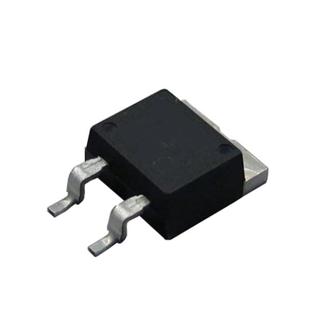

TDH50 Series 50 watt D2-PAK TO-263 Thick Film Surface Mount F e at u r e s • 50W high power resistors in TO263 (D2-PAK) style package with matte Tin plated flange. • Non-inductive design suits high frequency applications and high-speed pulse circuits. • Low, 2.3 deg C/W heat resistance from resistor hot spot to flange and long life performance are presented with thick film metallization technology. • Wide, 20 mΩ to 51K Ω resistance range. A p p l i c at i o n s • Automotive • Measurements • Industrial computers • High frequency electronics • UPS • Power unit of machines • Motor control • Drive circuits characteristics Test Condition Value Rating Power -55°C to 25°C flange temperature (when used with proper heatsink cooling system) Attached on simple footprint 2 Watt Heat Resistance Resistor hot spot to flange 2.3°C/W Resistance Range Resistance at terminal foot portion Nominal Res. Include 2.5, 4.0, 5.0, 8.0 and 16 TCR TCR (ppm/°C) of low resistance will typically be increased as indicated. Testing point is at 5.27mm from bottom of molding of terminals 50 Watt 300ppm 200ppm 140ppm 80ppm 0.02Ω 0.05Ω 0.1Ω 0.2Ω Tolerance 1% tolerance at 0.01-0.091Ω are available 0.02- 0.091Ω 0.1- 9.1Ω 1051KΩ E6 E24 E24 250 100 50 5%(J) 1% (F) 5% (J) ±1% (F) Capacitance Equivalent parallel capacitance 1.44pF Inductance Equivalent series inductance 8.38nH Operation Temp. Operating Volt. P is rating power and R resistance Withstand. Volt. Terminal and flange, 60 seconds. 1mA -55°C to +155°C Either 500V or √P·R 2000 VAC Load Life 25°C, 90 min.ON, 30 min. OFF, 1000h. ±1.0% Humidity 40°C, 90-95%RH, DC 0.1W, 1000 hours. ±1.0% Temp. Cycle -55°C,30 min., +155°C,30 min., 5cyc Soldering Heat 350±5°C, 3 sec., Lead Solderability 245±5°C, 3seconds. Insulation Between terminals and tab. Resistance Vibration IEC60068-2-6. Test method is IEC60068-2-6, and specification is sine sweep wave form, 100Hz-2000Hz, 10 cycles, amplitude 0.75mm or 100m/s2, 90minutes. direction x-y z, Amplitude 0.75mm will be applied under break point Frequency (about 60Hz) and 100m/ s2 over break point Flammability Weight ±0.25% ±0.1% Over 95% of surface Over 1,000MΩ ±0.25% UL94-V0 1.5 grams (continued) 38 1-866-9-OHMITE • Int’l 1-847-258-0300 • Fax 1-847-574-7522 • www.ohmite.com • info@ohmite.com TDH50 Series 50 watt D2-PAK TO-263 Thick Film Surface Mount characteristics Pulse Energy Durability 10K 1K 100 500W 100 10 120 Tentative continuous-pulse power allowance at duty 0.01. Load life test will be necessary in actual equipment, because curve will be changed by resistance, repetition, duty and operating temerature. % Rated Power Pulse peak power (W) 100K Derating 50W 10n 100n 1u 100u 1m 100m 1 Pulse width (seconds) 10 1000 60 40 20 155° 0 -50° -25° 0° 25° 50° 75° 100° 125° 150° 175° Terminal Temp. (°C) Soldering Peak temp. time 20-40sec. Construction Exceed 217 C permissible time 60 sec. to 180 sec. Molding, epoxy, UL94-V0 Leads, Tin plated Cu Leads joint, 85%Pb-Sn solder Resistor, Ni-Cr or RuO Substrate, Alumina Joint, 85%Pb-Sn solder Flange, matte tin plated Cu Temperature °C 350 Resistor element is electrically insulated from the metal flange 80 300 Peak temp. 270°C 240°C From 150°C to 200°C, 120 sec. to 180 sec. 250 200 Pre-heat temp. 200°C 150°C 150 100 50 0 To maximum temp. 400 sec. 0 50 100 150 200 250 300 350 400 450 500 550 600 Time (s) dimensions 1.5 ±0.05 10.1 ±0.2 10.3 ±0.2 2.2 ±0.2 2.5 ±0.5 5.0 ±1.0 0.75 ±0.05 1.5 ±0.05 5.08 ±0.10 Land Pattern 2.75 ±0.2 12.7 Tape Dimensions Tape and Reel packaging supplied in 500 pcs per reel. 5.0 ±.2 0.4 ±.1 16.0 ±.1 2.0 ±.1 11.5 ±.1 0.5 ±0.05 1.75 ±.1 4.5 ±0.2 24.0 ±.3 15.8 ±.1 10.16 10.8 ±.1 9.65 (4.75) 5.08 4.0 ±.1 4.32 1.27 Reel Dimensions Outer diameter: 330mm Width: 23.9mm min. 27.4mm max Inner diameter: 100mm Package quantity: 500pcs/13” reel (continued) 1-866-9-OHMITE • Int’l 1-847-258-0300 • Fax 1-847-574-7522 • www.ohmite.com • info@ohmite.com 39 TDH50 Series 50 watt D2-PAK TO-263 Thick Film Surface Mount o r d e r i n g i n f o r m at i o n TDH50HR100JE-TR Style Tape and reel (optional) 500 per reel 50 pcs tubes standard Modifier Ohms Tolerance RoHS Compliant Non-compliant R = Decimal F = 1% version unavailable Example: J = 5% R100 = 0.10 1R00= 1.0 10K0= 10,000 Standard Ohm Values Ohms 0.05 0.1 0.2 1 2 5 10 20 25 50 75 100 200 500 1,000 10,000 Part Number Tolerance TDH50HR050JE 5% TDH50H10R0FE TDH50H20R0FE TDH50H25R0FE TDH50H50R0FE TDH50H75R0FE 1% 1% 1% 1% 1% TDH50HR100FE TDH50HR200FE TDH50H1R00FE TDH50H2R00FE TDH50H5R00FE TDH50H100RFE TDH50H200RFE TDH50H500RFE TDH50H1K00FE TDH50H10K0FE THIS PRODUCT IS DESIGNED FOR USE WITH PROPER HEATSINKING. Maximum base plate temperature of the resistor must be monitored and kept within specified limits to establish the power rating. Best technique is to attach a thermocouple to the side of the base plate of the resistor. Temperature of plastic housing or heat sink cannot be used to establish rating of the resistor.   rev 11/20-1 40 1-866-9-OHMITE • Int’l 1-847-258-0300 • Fax 1-847-574-7522 • www.ohmite.com • info@ohmite.com 1% 1% 1% 1% 1% 1% 1% 1% 1% 1% Mouser Electronics Authorized Distributor Click to View Pricing, Inventory, Delivery & Lifecycle Information: Ohmite: TDH50H1R00FE-TR TDH50H200RFE TDH50H5R00FE TDH50H5R00FE-TR TDH50H100RFE TDH50H25R0FE TDH50H100RFE-TR TDH50H10R0FE TDH50H50R0FE TDH50H10R0FE-TR TDH50H2R00FE TDH50H10K0FE TDH50H1R00FE TDH50H1K00FE TDH50H75R0FE TDH50HR100FE TDH50HR200FE TDH50H20R0FE TDH50HR050JE TDH50H500RFE
