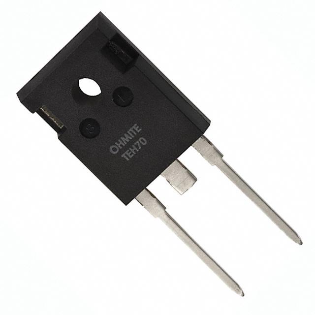

    2 Ohms ±5% 70W TO-247-2 通孔电阻器 防潮,非电感 厚膜
TEH70M2R00JE 数据手册
TEH70 Series 70 Watt TO247 Package Thick Film Power F e a t u r es • 70 Watt power rating at 25°C case temperature • Non-inductive performance • Low thermal resistance • RoHS compliant design • Two or three terminal versions available • Heat sink can be grounded through middle terminal (P style) c h a r a c te r i st i c s Resistor thick film on alumina Case high temperature plastic P Package middle terminal is electrically connected to header and insulated from left and right terminals M Package no middle terminal Derating linear, 100% at 25°C to 0% at 150°C Resistance range 2Ω-10KΩ Max. working voltage 500V or Ohm’s Law limited Thermal Resistance 1.79°C/W Temperature 2Ω-10Ω: ±100ppm Coefficient 10Ω-10KΩ: ±50ppm Insulation Resistance 400 MΩ Short time overload 2x rated power for 5 sec., not to exceed 1.5x max. working voltage Dielectric Strength 2000 VDC Performance ±1% ∆R Moisture MIL -STD-202, method 106 resistance ±0.5% ∆R Short time 2x rated power for 5 sec., not to overload exceed 1.5x max. working voltage ±0.3% ∆R Solderability MIL-STD-202, method 208 Thermal MIL-STD-202, method 170, cond. F shock ±0.2% ∆R Derating 100 70 80 56 60 42 40 28 20 14 Wattage Solder 100% Sn Test Conditions Of Test Load life 1000 hrs @ rated power Percent Rated Power Lead solder coated phosphor bronze 0 0 0 25 50 75 100 125 150 Bottom of base plate Temperature, °C 175 THIS PRODUCT IS DESIGNED FOR USE WITH PROPER HEATSINKING. Maximum base plate temperature of the resistor must be monitored and kept within specified limits to establish the power rating. Best technique is to attach a thermocouple to the side of the base plate of the resistor. Temperature of plastic housing or heat sink cannot be used to establish rating of the resistor.   (continued) 1-866-9-OHMITE • Int’l 1-847-258-0300 • Fax 1-847-574-7522 • www.ohmite.com • info@ohmite.com 151 TEH70 Series 70 Watt TO247 Package Thick Film Power dimensions (in./mm) P style (standard) 0.63" (15.90mm) M style (optional) 0.20" (5.08mm) 0.25" (6.24mm) 0.83" (21.08mm) ø0.15" (ø3.84mm) 0.80" (20.32mm) 0.08" (2.03mm) 0.05" (1.22mm) 0.21" (5.41mm) 0.43" (10.82mm) 0.025" (0.64mm) Connected to heatsink for grounding 0.09" (2.29mm) o r d e r i n g i n f o r m at i o n Package Code P = three terminals M = two terminals RoHS Compliant Non-compliant version unavailble ������������ Series 152 Ohms R = Decimal Example: 10R2 = 10.2 ohms 100R = 100 ohms 15K0 = 15,000 ohms Tolerance J = 5% Standard Part Numbers Ohms P-type 3-terminal M-type 2-terminal TEH70P2R00JE TEH70P3R00JE TEH70P4R00JE TEH70P5R00JE TEH70P7R50JE TEH70M2R00JE TEH70M3R00JE 10 TEH70P10R0JE 15 TEH70P15R0JE 20 TEH70P20R0JE 24 TEH70P24R0JE 33 TEH70M10R0JE TEH70M15R0JE TEH70M24R0JE TEH70M33R0JE 39 47 TEH70P47R0JE 68 TEH70P68R0JE 75 100 TEH70P100RJE TEH70M39R0JE TEH70M47R0JE TEH70M68R0JE TEH70M75R0JE TEH70M100RJE 150 TEH70P150RJE 270 TEH70P270RJE 470 TEH70P470RJE 680 750 TEH70P750RJE TEH70M150RJE TEH70M270RJE TEH70M470RJE TEH70M680RJE TEH70M750RJE 1000 TEH70P1K00JE 1500 TEH70P1K50JE 2000 TEH70P2K00JE 3000 5000 TEH70P5K00JE TEH70M1K00JE TEH70M1K50JE TEH70M2K00JE TEH70M3K00JE TEH70M5K00JE 7500 TEH70P7K50JE 10000 TEH70M10K0JE 2 3 4 5 7.5 1-866-9-OHMITE • Int’l 1-847-258-0300 • Fax 1-847-574-7522 • www.ohmite.com • info@ohmite.com TEH70M5R00JE TEH70M7R50JE
