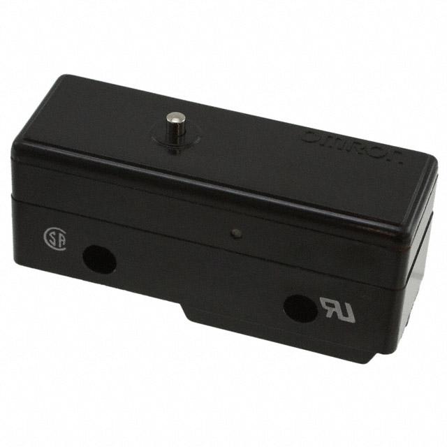

A-20G
A-20G
    OMRON(欧姆龙)
    检测开关 单刀双掷 DC30V AC125V
A-20G 数据手册
Snap Action Switch A General-purpose Snap Action Switch • High-capacity switch capable of handling 20 A loads with large inrush currents • Directly switches such loads as motors, halogen lamps and solenoids • Same shape as OMRON snap action switch model Z except in pin plunger position, yet endures inrush currents as large as 75 A. Ordering Information Terminal Actuator Pin plunger Short spring plunger Panel mount plunger Panel mount roller plunger Panel mount cross roller plunger Short hinge lever Hinge lever Short hinge roller lever Hinge roller lever Solder terminal Model A-20G A-20GD A-20GQ A-20GQ22 --A-20GV21 A-20GV A-20GV22 A-20GV2 Screw terminal (-B) Model A-20G-B A-20GD-B A-20GQ-B A-20GQ22-B A-20GQ21-B A-20GV21-B A-20GV-B A-20GV22-B A-20GV2-B Model Number Legend A - 20 G 123 4 1. Ratings 20: 20 A (250 VAC) 2. Contact Gap G: 0.5 mm 3. Actuator None: Pin plunger D: Short spring plunger Q: Panel mount plunger Q21: Panel mount cross roller plunger Q22: Panel mount roller plunger V: Hinge lever V2: Hinge roller lever V21: Short hinge lever V22: Short hinge roller lever 4. Terminals None: Solder terminal B: Screw terminal (with toothed washer) Snap Action Switch A 19 Specifications ■ Characteristics Operating speed Operating frequency Contact resistance Insulation resistance Dielectric strength Mechanical Electrical 0.01 mm to 1m/s (see note 1) 240 operations/min 20 operations/min 15 mΩ max. (initial value) 100 MΩ min. (at 500 VDC) 1,000 VAC, 50/60 Hz for 1 min between terminals of the same polarity 2,000 VAC, 50/60 Hz for 1 min between the current-carrying metal parts and the ground, and between each terminal and non-current-carrying metal parts Malfunction Destruction Malfunction Degree of protection Degree of protection against electric shock Proof tracking index (PTI) Ambient operating temperature Ambient operating humidity Service life Weight Note: 1. The value is for the pin plunger. 2. Malfunction: 1 ms max. Mechanical Electrical 10 to 55 Hz, 1.5-mm double amplitude (See note 2) 1,000 m/s2 max. 300 m/s2 max. (See notes 1 and 2) IP00 Class I 175 − 25°C to 80°C (with no icing) 35% to 85%RH 1,000,000 operations min. 500,000 operations min. Approx. 22 to 58 g Vibration resistance Shock resistance ■ Operating Characteristics Characteristics OF RF min. PT max. OT min. MD max. OP 16.3±0.4 mm 0.25 mm 3 mm 0.2 mm 26.2±0.5 mm 21.8±0.8 mm A-20G-B A-20GD-B 400 to 625 g 285 g 1.3 mm 5.6 mm 3.58 mm 0.35 mm 33.4±1.2 mm A-20GQ-B A-20GQ22-B A-20GQ21-B A-20GV21-B 160 g 42 g 6.5 mm 1.2 mm 1.2 mm 19±0.8 mm A-20GV-B 70 g 14 g 15.9 mm 4 mm 2.4 mm 19±0.8 mm A-20GV22-B 160 g 42 g 6.3 mm 1.2 mm 1.2 mm 29.8±0.8 mm A-20GV2-B 90 g 14 g 12 mm 2.4 mm 2.2 mm 30.2±0.8 mm 630 g max. 280g ■ Ratings Non-inductive load (A) Rated voltage (V) 125 VAC 250 VAC 500 VAC 8 VDC 14 VDC 30 VDC 125 VDC 250 VDC Resistive load NC 20 20 15 20 20 6 0.5 0.25 3 3 3 0.5 0.25 NO NC 7.5 7.5 4 1.5 1.5 1.5 0.5 0.25 Lamp load NO Inductive load NC 20 20 10 20 15 5 0.05 0.03 NO NC 12.5 8.3 2 12.5 12.5 5 0.05 0.03 Inductive load (A) Motor load NO Note: 1. The above values are for steady-state current. 2. Inductive load has a power factor of 0.4 min. (AC) and a time constant of 7 ms max. (DC). 3. Lamp load has an inrush current of 10 times the steady-state current. 4. Motor load has an inrush current of 6 times the steady-state current. 5. The ratings values apply under the following test conditions: (1) Ambient temperature: 20±2°C (2) Ambient humidity: 65±5%RH (3) Operating frequency: 20 operations/min ■ Contact Specification Contacts Shape Material Gap (standard value) Inrush current NC NO Rivet Silver alloy 0.5 mm 75 A max. 75 A max. ■ Safety Standards Ratings UL/CSA (General ratings only) Rated voltage 125 VAC 250 VAC 480 VAC 125 VDC 250 VDC A-20G 1 HP and 10 A "L" (Tungsten) 2 HP 20 A 0.5 A 0.25 A 20 Snap Action Switch A Engineering Data ■ Mechanical Durability (A-20G) Durability (x10 4 operations) 1,000 700 500 300 ■ Electrical Durability (A-20G) Durability (x10 4 operations) 1,000 700 500 300 Ambient temperature: 20 ±2 °C Ambient humidity: 65 ±5%RH Without load Operatin g f requency: 240 operations/min Ambient temperature: 20 ±2 °C Ambient humidity: 65 ±5%RH Operatin g f requency: 20 operations/min 125 VAC, cos φ = 1 125 VAC, cos φ = 0 .4 100 70 50 30 100 70 50 30 250 VAC, cos φ = 1 250 VAC, cos φ = 0 .4 10 0 0.1 0.2 0.3 0.4 0.5 0.6 0.7 0.8 10 0 5 10 15 20 25 Switchin g c urrent (A) Overtravel (mm) ■ Structure Contact Form (SPDT) COM NC NO Dimensions Note: Unless otherwise specified, all units are in millimeters and a tolerance of ± 0.4 mm applies to all dimensions. ■ Terminals Screw Terminals (-B) Solder Terminal (Blank) 9.2 20 COM NO 6.4 20 17.45±0.2 NC 1 NO COM NC 2 3 25.4±0.1 11.9 17.45±0.2 1 3 2 49.2 Three, M4 × 5.5 Terminal screws (with toothed washer) 49.2 Note: Appropriate terminal screw tightening torque: 0.78 to 1.18 N·m. ■ Mounting Holes All switches can be mounted using M4 mounting screws with plane washers or spring washers to securely mount the Switch. Tighten the screws to a torque of 1.18 to 1.47 N·m. Two, 4.2 dia. mounting holes or M4 Versions with panel mount plungers can be panel mounted via the plunger, provided that the hexagonal nut of the actuator is tightened to a torque of 2.94 to 4.9 N·m. Panel Mount Plunger 12.5 + 0.2 0 dia. Panel Mount Roller Plunger 12.5 + 0.2 0 dia. 25.4±0.1 5 + 0.2 0 13 + 0.2 0 Note: Mount using either the side mounting holes or the panel mount plunger, not both. If using the side mounting holes, then remove the hexagonal nut(s) from the panel mount plunger. Accessories (Terminal Covers, and Separators): Refer to ‘Z/A/X/DZ Common Accessories’ datasheet Snap Action Switch A 21 Note: 1. All drawings show the switches with screw terminals. For solder terminals, remove the “-B” from the end of the part number 2. Unless otherwise specified, all units are in millimeters and a tolerance of ± 0.4 mm applies to all dimensions. Pin Plunger A-20G-B PT 19.05±0.25 2.3 dia. 4.2 +0.075 dia. hole −0.025 2.3SR * OP 24.2 9.2 4.2 +0.075 dia. −0.025 4.36 +0.1 dia. −0.05 11.9 25.4±0.1 49.2 17.45±0.2 * Stainless-steel plunger Short Spring Plunger A-20GD-B PT 19.05±0.25 15 dia. 11.2 dia. 7.15 11.9SR * dia. 7.5 OP 24.2 * Stainless-steel plunger Panel Mount Plunger A-20GQ-B PT 19.05±0.25 8.35 dia. 11.9SR *1 M12 × 1 mounting screw OP 13.1 *2 Note: Do not use both M12 mounting screw and mounting holes at the Two hexagon nuts same time. (2 t × 14 width across flats) 16.3 16 dia. Two lock nuts (2 t × 15.6 width across flats) *1 Stainless-steel plunger *2 Incomplete screw part with a maximum length of 1.5 mm. Panel Mount Roller Plunger A-20GQ22-B PT 19.05±0.25 12.7 dia. × 4.8 *1 Two hexagon nuts (3 t × 17 width across flats) OP 15.5 *2 M12 × 1 mounting screw 16.3 16 dia. Note: Do not use both M12 mounting screw and mounting holes at the same time. *1 Stainless-steel roller *2 Incomplete screw part with a maximum length of 1.5 mm. Panel Mount Cross Roller Plunger A-20GQ21-B PT 19.05±0.25 12.7 dia. × 4.8 *1 Two hexagon nuts (3 t × 17 width across flats) OP 15.5 M12 × 1 mounting screw *2 16.3 16 dia. Note: Do not use both M12 mounting screw and mounting holes at the same time. *1 Stainless-steel roller *2 Incomplete screw part with a maximum length of 1.5 mm. 22 Snap Action Switch A Note: 1. All drawings show the switches with screw terminals. For solder terminals, remove the “-B” from the end of the part number 2. Unless otherwise specified, all units are in millimeters and a tolerance of ± 0.4 mm applies to all dimensions. Short Hinge Lever A-20GV21-B 24.56±0.25 t=1* 28 .3R 4.9 PT 20.2 17.9 14.7 OP * Stainless-steel lever Hinge Lever A-20GV-B 24.56±0.25 63. 5R t=1* PT 4.9 20.2 17.9 14.7 OP * Stainless-steel lever Short Hinge Roller Lever A-20GV22-B 24.56±0.25 t=1* 26 .2 R 9.5 dia. × 4 (plastic roller) PT OP 20.2 17.9 14.7 * Stainless-steel lever Hinge Roller Lever A-20GV2-B 24.56±0.25 PT 48 .4R 9.5 dia. × 4 (plastic roller) t=1* OP 20.2 17.9 14.7 * Stainless-steel lever Snap Action Switch A 23 Safety Precautions Be sure to read the precautions and information common to all Snap Action and Detection Switches, contained in the Technical User’s Guide, “Snap Action Switches, Technical Information” for correct use. Precautions for Safe Use Terminal Connection When soldering lead wires to the Switch, make sure that the capacity of the soldering iron is 60 W maximum. Do not take more than 5 s to solder any part of the Switch. The characteristics of the Switch will deteriorate if a soldering iron with a capacity of more than 60 W is applied to any part of the Switch for 5 s or more. • Do not use the switch in locations subject to hot water (greater than 60°C) or in water vapor. • Do not use the switch outside the specified temperature and atmospheric conditions. The permissible ambient temperature depends on the model. (Refer to the specifications in this catalog.) Sudden thermal changes may cause thermal shock to distort the switch and result in faults. Incorrect Correct Separate the installation location from heat sources. Operation • Make sure that the switching frequency or speed is within the specified range. 1. If the switching speed is extremely slow, the contact may not be switched smoothly, which may result in a contact failure or contact welding. 2. If the switching speed is extremely fast, switching shock may damage the Switch soon. If the switching frequency is too high, the contact may not catch up with the speed. The rated permissible switching speed and frequency indicate the switching reliability of the Switch. The life of a Switch is determined at the specified switching speed. The life varies with the switching speed and frequency even when they are within the permissible ranges. In order to determine the life of a Switch model to be applied to a particular use, it is best to conduct an appropriate durability test on some samples of the model under actual conditions. • Make sure that the actuator travel does not exceed the permissible OT position. The operating stroke must be set to 70% to 100% of the rated OT. • Mount a cover if the switch is to be installed in a location where worker inattention could result in incorrect operation or accidents. Incorrect Correct (preventing malfunctions) Precautions for Correct Use Mounting Location • Do not use the switch alone in atmospheres such as flammable or explosive gases. Arcing and heat generation associated with switching may cause fires or explosions. • Switches are generally not constructed with resistance against water. Use a protective cover to prevent direct spraying if the switch is used in locations subject to splashing or spurting oil or water, dust adhering. Incorrect Correct • Subjecting the switch to continuous vibration or shock may result in contact failure or faulty operation due to abrasion powder and in reduced durability. Excessive vibration or shock will cause the contacts to operate malfunction or become damaged. Mount the switch in a location that is not subject to vibration or shock and in a direction that does not subject the switch to resonance. • If silver contacts are used with relatively low frequency for a long time or are used with microloads, the sulfide coating produced on the contact surface will not be broken down and contact faults will result. Use a microload switch that uses gold contacts. • Do not use the switch in atmospheres with high humidity or heat or in harmful gases, such as sulfide gas (H2S, SO2), ammonia gas (NH3), nitric acid gas (HNO3), or chlorine gas (Cl2). Doing so may impair functionality, such as with damage due to contacting faults or corrosion. • The switch includes contacts. If the switch is used in an atmosphere with silicon gas, arc energy may cause silicon oxide (SiO2) to accumulate on the contacts and result in contact failure. If there is silicon oil, silicon filling, silicon wiring, or other silicon products in the vicinity of the switch, use a contact protection circuit to limit arcing and remove the source of the silicon gas. Terminal box Terminal box Panel-mounting model (A-20GQ@) • If a Switch is side-mounted with screws, remove the hexagonal nut of the actuator. • If a Switch is side-mounted and secured with screws, make sure that the angle or speed of the actuating object is not excessively large or too high, otherwise the Switch may be damaged. • If a Switch is panel-mounted, pay utmost attention to make sure that the actuating speed or OT distance is not excessively high or large. Not doing so may damage the Switch. • Install the switch in a location that is not directly subject to debris and dust from cutting. The actuator and the switch body must be protected from accumulated cutting debris and dirt. Incorrect Correct 24 Snap Action Switch A Omron Electronic Components, LLC Terms and Conditions of Sales I. GENERAL 1. Definitions: The words used herein are defined as follows. (a) Terms: These terms and conditions (b) Seller: Omron Electronic Components LLC and its subsidiaries (c) Buyer: The buyer of Products, including any end user in section III through VI (d) Products: Products and/or services of Seller (e) Including: Including without limitation 2. Offer; Acceptance: These Terms are deemed part of all quotations, acknowledgments, invoices, purchase orders and other documents, whether electronic or in writing, relating to the sale of Products by Seller. Seller hereby objects to any Terms proposed in Buyer's purchase order or other documents which are inconsistent with, or in addition to, these Terms. 3. Distributor: Any distributor shall inform its customer of the contents after and including section III of these Terms. II. SALES 1. Prices; Payment: All prices stated are current, subject to change without notice by Seller. Buyer agrees to pay the price in effect at the time the purchase order is accepted by Seller. Payments for Products received are due net 30 days unless otherwise stated in the invoice. Buyer shall have no right to set off any amounts against the amount owing in respect of this invoice. 2. Discounts: Cash discounts, if any, will apply only on the net amount of invoices sent to Buyer after deducting transportation charges, taxes and duties, and will be allowed only if (a) the invoice is paid according to Seller's payment terms and (b) Buyer has no past due amounts owing to Seller. 3. Interest: Seller, at its option, may charge Buyer 1.5% interest per month or the maximum legal rate, whichever is less, on any balance not paid within the stated terms. 4. Orders: Seller will accept no order less than 200 U.S. dollars net billing. 5. Currencies: If the prices quoted herein are in a currency other than U.S. dollars, Buyer shall make remittance to Seller at the then current exchange rate most favorable to Seller; provided that if remittance is not made when due, Buyer will convert the amount to U.S. dollars at the then current exchange rate most favorable to Seller available during the period between the due date and the date remittance is actually made. 6. Governmental Approvals: Buyer shall be responsible for all costs involved in obtaining any government approvals regarding the importation or sale of the Products. 7. Taxes: All taxes, duties and other governmental charges (other than general real property and income taxes), including any interest or penalties thereon, imposed directly or indirectly on Seller or required to be collected directly or indirectly by Seller for the manufacture, production, sale, delivery, importation, consumption or use of the Products sold hereunder (including customs duties and sales, excise, use, turnover and license taxes) shall be charged to and remitted by Buyer to Seller. 8. Financial: If the financial position of Buyer at any time becomes unsatisfactory to Seller, Seller reserves the right to stop shipments or require satisfactory security or payment in advance. If Buyer fails to make payment or otherwise comply with these Terms or any related agreement, Seller may (without liability and in addition to other remedies) cancel any unshipped portion of Products sold hereunder and stop any Products in transit until Buyer pays all amounts, including amounts payable hereunder, whether or not then due, which are owing to it by Buyer. Buyer shall in any event remain liable for all unpaid accounts. 9. Cancellation; Etc: Orders are not subject to rescheduling or cancellation unless Buyer indemnifies Seller fully against all costs or expenses arising in connection therewith. 10. Force Majeure: Seller shall not be liable for any delay or failure in delivery resulting from causes beyond its control, including earthquakes, fires, floods, strikes or other labor disputes, shortage of labor or materials, accidents to machinery, acts of sabotage, riots, delay in or lack of transportation or the requirements of any government authority. 11. Shipping; Delivery: Unless otherwise expressly agreed in writing by Seller: (a) All sales and shipments of Products shall be FOB shipping point (unless otherwise stated in writing by Seller), at which point title to and all risk of loss of the Products shall pass from Seller to Buyer, provided that Seller shall retain a security interest in the Products until the full purchase price is paid by Buyer; (b) Delivery and shipping dates are estimates only; and (c) Seller will package Products as it deems proper for protection against normal handling and extra charges apply to special conditions. 12. Claims: Any claim by Buyer against Seller for shortage or damage to the Products occurring before delivery to the carrier or any claim related to pricing or other charges must be presented in detail in writing to Seller within 30 days of receipt of shipment. III. PRECAUTIONS 1. Suitability: IT IS THE BUYER’S SOLE RESPOINSIBILITY TO ENSURE THAT ANY OMRON PRODUCT IS FIT AND SUFFICIENT FOR USE IN A MOTORIZED VEHICLE APPLICATION. BUYER SHALL BE SOLELY RESPONSIBLE FOR DETERMINING APPROPRIATENESS OF THE PARTICULAR PRODUCT WITH RESPECT TO THE BUYER’S APPLICATION INCLUDING (A) ELECTRICAL OR ELECTRONIC COMPONENTS, (B) CIRCUITS, (C) SYSTEM ASSEMBLIES, (D) END PRODUCT, (E) SYSTEM, (F) MATERIALS OR SUBSTANCES OR (G) OPERATING ENVIRONMENT. Buyer acknowledges that it alone has determined that the Products will meet their requirements of the intended use in all cases. Buyer must know and observe all prohibitions of use applicable to the Product/s. 2. Use with Attention: The followings are some examples of applications for which particular attention must be given. This is not intended to be an exhaustive list of all possible use of any Product, nor to imply that any use listed may be suitable for any Product: (a) Outdoor use, use involving potential chemical contamination or electrical interference. (b) Use in consumer Products or any use in significant quantities. (c) Energy control systems, combustion systems, railroad systems, aviation systems, medical equipment, amusement machines, vehicles, safety equipment, and installations subject to separate industry or government regulations. (d) Systems, machines, and equipment that could present a risk to life or property. 3. Prohibited Use: NEVER USE THE PRODUCT FOR AN APPLICATION INVOLVING SERIOUS RISK TO LIFE OR PROPERTY WITHOUT ENSURING THAT THE SYSTEM AS A WHOLE HAS BEEN DESIGNED TO ADDRESS THE RISKS, AND THAT THE PRODUCT IS PROPERLY RATED AND INSTALLED FOR THE INTENDED USE WITHIN THE OVERALL EQUIPMENT OR SYSTEM. 4. Motorized Vehicle Application: USE OF ANY PRODUCT/S FOR A MOTORIZED VEHICLE APPLICATION MUST BE EXPRESSLY STATED IN THE SPECIFICATION BY SELLER. 5. Programmable Products: Seller shall not be responsible for the Buyer's programming of a programmable Product. IV. WARRANTY AND LIMITATION 1. Warranty: Seller's exclusive warranty is that the Products will be free from defects in materials and workmanship for a period of twelve months from the date of sale by Seller (or such other period expressed in writing by Seller). SELLER MAKES NO WARRANTY OR REPRESENTATION, EXPRESS OR IMPLIED, ABOUT ALL OTHER WARRANTIES, NON-INFRINGEMENT, MERCHANTABILITY OR FITNESS FOR A PARTICULAR PURPOSE OF THE PRODUCTS. 2. Buyer Remedy: Seller's sole obligation hereunder shall be to replace (in the form originally shipped with Buyer responsible for labor charges for removal or replacement thereof) the non-complying Product or, at Seller's election, to repay or credit Buyer an amount equal to the purchase price of the Product; provided that there shall be no liability for Seller or its affiliates unless Seller's analysis confirms that the Products were correctly handled, stored, installed and maintained and not subject to contamination, abuse, misuse or inappropriate modification. Return of any Products by Buyer must be approved in writing by Seller before shipment. 3. Limitation on Liability: SELLER AND ITS AFFILIATES SHALL NOT BE LIABLE FOR SPECIAL, INDIRECT, INCIDENTAL OR CONSEQUENTIAL DAMAGES, LOSS OF PROFITS OR PRODUCTION OR COMMERCIAL LOSS IN ANY WAY CONNECTED WITH THE PRODUCTS, WHETHER SUCH CLAIM IS BASED IN CONTRACT, WARRANTY, NEGLIGENCE OR STRICT LIABILITY. FURTHER, IN NO EVENT SHALL LIABILITY OF SELLER OR ITS AFFILITATES EXCEED THE INDIVIDUAL PRICE OF THE PRODUCT ON WHICH LIABILITY IS ASSERTED. 4. Indemnities: Buyer shall indemnify and hold harmless Seller, its affiliates and its employees from and against all liabilities, losses, claims, costs and expenses (including attorney's fees and expenses) related to any claim, investigation, litigation or proceeding (whether or not Seller is a party) which arises or is alleged to arise from Buyer's acts or omissions under these Terms or in any way with respect to the Products. V. INFORMATION; ETC. 1. Intellectual Property: The intellectual property embodied in the Products is the exclusive property of Seller and its affiliates and Buyer shall not attempt to duplicate it in any way without the written permission of Seller. Buyer (at its own expense) shall indemnify and hold harmless Seller and defend or settle any action brought against Seller to the extent that it is based on a claim that any Product made to Buyer specifications infringed intellectual property rights of another party. 2. Property; Confidentiality: Notwithstanding any charges to Buyer for engineering or tooling, all engineering and tooling shall remain the exclusive property of Seller. All information and materials supplied by Seller to Buyer relating to the Products are confidential and proprietary, and Buyer shall limit distribution thereof to its trusted employees and strictly prevent disclosure to any third party. 3. Performance Data: Performance data is provided as a guide in determining suitability and does not constitute a warranty. It may represent the result of Seller's test conditions, and the users must correlate it to actual application requirements. 4. Change In Specifications: Product specifications and descriptions may be changed at any time based on improvements or other reasons. It is Seller’s practice to change part numbers when published ratings or features are changed, or when significant engineering changes are made. However, some specifications of the Product may be changed without any notice. 5. Errors And Omissions: The information on Seller’s website or in other documentation has been carefully checked and is believed to be accurate; however, no responsibility is assumed for clerical, typographical or proofreading errors or omissions. 6. Export Controls: Buyer shall comply with all applicable laws, regulations and licenses regarding (a) export of the Products or information provided by Seller; (b) sale of Products to forbidden or other proscribed persons or organizations; (c) disclosure to noncitizens of regulated technology or information. VI. MISCELLANEOUS 1. Waiver: No failure or delay by Seller in exercising any right and no course of dealing between Buyer and Seller shall operate as a waiver of rights by Seller. 2. Assignment: Buyer may not assign its rights hereunder without Seller's written consent. 3. Law: These Terms are governed by Illinois law (without regard to conflict of laws). Federal and state courts in Cook County, Illinois have exclusive jurisdiction for any dispute hereunder. 4. Amendment: These Terms constitute the entire agreement between Buyer and Seller relating to the Products, and no provision may be changed or waived unless in writing signed by the parties. 5. Severability: If any provision hereof is rendered ineffective or invalid, such provision shall not invalidate any other provision. Snap Action Switch A Certain Precautions on Specifications and Use 1. Suitability for Use. Seller shall not be responsible for conformity with any standards, codes or regulations which apply to the combination of the Product in Buyer's application or use of the Product. At Buyer's request, Seller will provide applicable third party certification documents identifying ratings and limitations of use which apply to the Product. This information by itself is not sufficient for a complete determination of the suitability of the Product in combination with the end product, machine, system, or other application or use. Buyer shall be solely responsible for determining appropriateness of the particular Product with respect to Buyer's application, product or system. Buyer shall take application responsibility in all cases but the following is a nonexhaustive list of applications for which particular attention must be given: (i) Outdoor use, uses involving potential chemical contamination or electrical interference, or conditions or uses not described in this document. (ii) Energy control systems, combustion systems, railroad systems, aviation systems, medical equipment, amusement machines, vehicles, safety equipment, and installations subject to separate industry or government regulations. (iii) Use in consumer products or any use in significant quantities. (iv) Systems, machines and equipment that could present a risk to life or property. Please know and observe all prohibitions of use applicable to this product. NEVER USE THE PRODUCT FOR AN APPLICATION INVOLVING SERIOUS RISK TO LIFE OR PROPERTY WITHOUT ENSURING THAT THE SYSTEM AS A WHOLE HAS BEEN DESIGNED TO ADDRESS THE RISKS, AND THAT THE OMRON PRODUCT IS PROPERLY RATED AND INSTALLED FOR THE INTENDED USE WITHIN THE OVERALL EQUIPMENT OR SYSTEM. 2. Programmable Products. Seller shall not be responsible for the user's programming of a programmable product, or any consequence thereof. 3. Performance Data. Performance data given in this publication is provided as a guide for the user in determining suitability and does not constitute a warranty. It may represent the result of Seller's test conditions, and the users must correlate it to actual application requirements. Actual performance is subject to Seller's Warranty and Limitations of Liability. 4. Change in Specifications. Product specifications and accessories may be changed at any time based on improvements and other reasons. It is our practice to change part numbers when published ratings or features are changed, or when significant construction changes are made. However, some specifications of the Product may be changed without any notice. When in doubt, special part numbers may be assigned to fix or establish key specifications for your application. Please consult with your Seller representative at any time to confirm actual specifications of purchased Product. 5. Errors and Omissions. The information in this publication has been carefully checked and is believed to be accurate; however, no responsibility is assumed for clerical, typographical or proofreading errors, or omissions. 6. RoHS Compliance. Where indicated, our products currently comply, to the best of our knowledge as of the date of this publication, with the requirements of the European Union's Directive on the Restriction of certain Hazardous Substances ("RoHS"), although the requirements of RoHS do not take effect until July 2006. These requirements may be subject to change. Please consult our website for current information. Complete “Terms and Conditions of Sale” for product purchase and use are on Omron’s website at http://www.components.omron.com – under the “About Us” tab, in the Legal Matters section. ALL DIMENSIONS SHOWN ARE IN MILLIMETERS. To convert millimeters into inches, multiply by 0.03937. To convert grams into ounces, multiply by 0.03527. OMRON ELECTRONIC COMPONENTS LLC 55 E. Commerce Drive, Suite B Schaumburg, IL 60173 OMRON ON-LINE Global - http://www.omron.com USA - http://www.components.omron.com 847-882-2288 Cat. No. X303-E-1 11/09 Specifications subject to change without notice Printed in USA Snap Action Switch A
