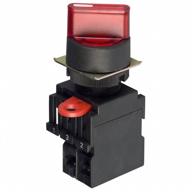

Knob-type Selector Switch (Cylindrical 22/25-dia.) A22@ CSM_A22@_DS_E_4_2 Install in 22-dia. or 25-dia. Panel Cutout • Lever for easily mounting and removing the Switch Unit • Finger protection mechanism on Switch Unit provided as a standard feature. • Use 25-dia. ring to install in 25-dia. panel cutouts. • Mounted using either open-type (fork-type) or closed-type (round-type) crimp terminals. • IP65 oil resistance (non-lighted models) IP65 (lighted models) Refer to Safety Precautions for All Pushbutton Switches/ Indicators and Safety Precautions for the A22. Note: Orders for non-lighted (IP65 oil-resistant) and lighted Selectors (completely assembled/subassembled) listed in this catalog will not be accepted after March 31, 2018. Model Number Structure Model Number Legend ................... Shipped as a set which includes the Selector, Lamp (lighted models only), and Switch. For information on combinations, refer to Ordering Information on pages 2 to 4. (1) (2) (3) (4) (5) A 22 W - 2M G - 6A - 11 (1) Lighted/Non-lighted Code S W (3) Illumination Color Description Non-lighted Lighted Code R G Y A None Color Red Green Yellow Blue Black* * For non-lighted models only (2) Number of Notches/Reset Method Code 2M 2A 3M 3A Number of Notches 2 notches 3 notches Reset Method Manual Automatic Manual Automatic (4) Light Source (5) Contacts Without Voltage Reduction Unit Code Description Code None 6A 12A 24A 5 12 24 Operating Voltage Non-lighted LED 6 VAC/VDC 12 VAC/VDC 24 VAC/VDC 5 VAC/VDC Incandescent 12 VAC/VDC lamp 24 VAC/VDC Type With Voltage Reduction Unit Code Type T1 T2 LED Operating Voltage 100 VAC 200 VAC 10 01 11 20 02 SPST-NO * SPST-NC * SPST-NO + SPST-NC SPST-NO + SPST-NO SPST-NC + SPST-NC * For models with 2 notches Note: The contacts are rated for standard loads. For microloads, refer to Accessories section for the A22. • LED incorporates the 24-VAC/VDC models. 1 A22@ Ordering Information Completely Assembled .................. Shipped as a set which includes the Selector, Lamp (lighted models only), and Switch. Non-lighted Knob-type Selector Switch (Orders will not be accepted after March 31, 2018.) Appearance Number of notches Resetting method Knob-type Selector Switch A22S Manual 2 notches Automatic Manual 3 notches Automatic Output Model Color of Selector SPST-NO SPST-NC SPST-NO + SPST-NC SPST-NO + SPST-NO SPST-NC + SPST-NC SPST-NO SPST-NC SPST-NO + SPST-NC SPST-NO + SPST-NO SPST-NC + SPST-NC SPST-NO + SPST-NC SPST-NO + SPST-NO SPST-NC + SPST-NC SPST-NO + SPST-NC SPST-NO + SPST-NO SPST-NC + SPST-NC A22S-2M-10 A22S-2M-01 A22S-2M-11 A22S-2M-20 A22S-2M-02 A22S-2A-10 A22S-2A-01 A22S-2A-11 A22S-2A-20 A22S-2A-02 A22S-3M-11 A22S-3M-20 A22S-3M-02 A22S-3A-11 A22S-3A-20 A22S-3A-02 Black Note: The contact ratings are for standard loads. 2 A22@ Ordering Information Completely Assembled .................. Shipped as a set which includes the Selector, Lamp (lighted models only), and Switch. Lighted Knob-type Selector Switch (Orders will not be accepted after March 31, 2018.) Appearance Number of notches Resetting method Knob-type Selector Switch A22W LED lighting (without Voltage Reduction Unit) Output SPST-NO SPST-NC Manual SPST-NO + SPST-NC SPST-NO + SPST-NO SPST-NC + SPST-NC 2 notches SPST-NO SPST-NC Automatic SPST-NO + SPST-NC SPST-NO + SPST-NO SPST-NC + SPST-NC SPST-NO + SPST-NC Manual SPST-NO + SPST-NO SPST-NC + SPST-NC 3 notches SPST-NO + SPST-NC Automatic SPST-NO + SPST-NO SPST-NC + SPST-NC Operating voltage Model 6 VAC/VDC 12 VAC/VDC 24 VAC/VDC 6 VAC/VDC 12 VAC/VDC 24 VAC/VDC 6 VAC/VDC 12 VAC/VDC 24 VAC/VDC 6 VAC/VDC 12 VAC/VDC 24 VAC/VDC 6 VAC/VDC 12 VAC/VDC 24 VAC/VDC 6 VAC/VDC 12 VAC/VDC 24 VAC/VDC 6 VAC/VDC 12 VAC/VDC 24 VAC/VDC 6 VAC/VDC 12 VAC/VDC 24 VAC/VDC 6 VAC/VDC 12 VAC/VDC 24 VAC/VDC 6 VAC/VDC 12 VAC/VDC 24 VAC/VDC 6 VAC/VDC 12 VAC/VDC 24 VAC/VDC 6 VAC/VDC 12 VAC/VDC 24 VAC/VDC 6 VAC/VDC 12 VAC/VDC 24 VAC/VDC 6 VAC/VDC 12 VAC/VDC 24 VAC/VDC 6 VAC/VDC 12 VAC/VDC 24 VAC/VDC 6 VAC/VDC 12 VAC/VDC 24 VAC/VDC A22W-2M@-6A-10 A22W-2M@-12A-10 A22W-2M@-24A-10 A22W-2M@-6A-01 A22W-2M@-12A-01 A22W-2M@-24A-01 A22W-2M@-6A-11 A22W-2M@-12A-11 A22W-2M@-24A-11 A22W-2M@-6A-20 A22W-2M@-12A-20 A22W-2M@-24A-20 A22W-2M@-6A-02 A22W-2M@-12A-02 A22W-2M@-24A-02 A22W-2A@-6A-10 A22W-2A@-12A-10 A22W-2A@-24A-10 A22W-2A@-6A-01 A22W-2A@-12A-01 A22W-2A@-24A-01 A22W-2A@-6A-11 A22W-2A@-12A-11 A22W-2A@-24A-11 A22W-2A@-6A-20 A22W-2A@-12A-20 A22W-2A@-24A-20 A22W-2A@-6A-02 A22W-2A@-12A-02 A22W-2A@-24A-02 A22W-3M@-6A-11 A22W-3M@-12A-11 A22W-3M@-24A-11 A22W-3M@-6A-20 A22W-3M@-12A-20 A22W-3M@-24A-20 A22W-3M@-6A-02 A22W-3M@-12A-02 A22W-3M@-24A-02 A22W-3A@-6A-11 A22W-3A@-12A-11 A22W-3A@-24A-11 A22W-3A@-6A-20 A22W-3A@-12A-20 A22W-3A@-24A-20 A22W-3A@-6A-02 A22W-3A@-12A-02 A22W-3A@-24A-02 Illumination color R (red) Y (yellow) G (green) A (blue) Note: 1. When ordering, specify the symbol that indicates color of the Selector in the @ of the model number. 2. The contact ratings are for standard loads. Individual models: Refer to pages 6 to 7. ■ Specifications: Refer to the A22. ■ Dimensions: Refer to page 10. (The Selector, Lamp, and Switch can be ordered separately.) ■ Accessories and tools: Refer to the A22. 3 A22@ Ordering Information Completely Assembled .................. Shipped as a set which includes the Selector, Lamp (lighted models only), and Switch. Lighted Knob-type Selector Switch (Orders will not be accepted after March 31, 2018.) Appearance Number of notches Resetting method Knob-type Selector Switch A22W LED voltage-reduction lighting (with Voltage Reduction Unit) Output SPST-NO SPST-NC Manual SPST-NO + SPST-NC SPST-NO + SPST-NO SPST-NC + SPST-NC 2 notches SPST-NO SPST-NC Automatic SPST-NO + SPST-NC SPST-NO + SPST-NO SPST-NC + SPST-NC SPST-NO + SPST-NC Manual SPST-NO + SPST-NO SPST-NC + SPST-NC 3 notches SPST-NO + SPST-NC Automatic SPST-NO + SPST-NO SPST-NC + SPST-NC Operating voltage Model 100 VAC 200 VAC 100 VAC 200 VAC 100 VAC 200 VAC 100 VAC 200 VAC 100 VAC 200 VAC 100 VAC 200 VAC 100 VAC 200 VAC 100 VAC 200 VAC 100 VAC 200 VAC 100 VAC 200 VAC 100 VAC 200 VAC 100 VAC 200 VAC 100 VAC 200 VAC 100 VAC 200 VAC 100 VAC 200 VAC 100 VAC 200 VAC A22W-2M@-T1-10 A22W-2M@-T2-10 A22W-2M@-T1-01 A22W-2M@-T2-01 A22W-2M@-T1-11 A22W-2M@-T2-11 A22W-2M@-T1-20 A22W-2M@-T2-20 A22W-2M@-T1-02 A22W-2M@-T2-02 A22W-2A@-T1-10 A22W-2A@-T2-10 A22W-2A@-T1-01 A22W-2A@-T2-01 A22W-2A@-T1-11 A22W-2A@-T2-11 A22W-2A@-T1-20 A22W-2A@-T2-20 A22W-2A@-T1-02 A22W-2A@-T2-02 A22W-3M@-T1-11 A22W-3M@-T2-11 A22W-3M@-T1-20 A22W-3M@-T2-20 A22W-3M@-T1-02 A22W-3M@-T2-02 A22W-3A@-T1-11 A22W-3A@-T2-11 A22W-3A@-T1-20 A22W-3A@-T2-20 A22W-3A@-T1-02 A22W-3A@-T2-02 Selector symbol (color) R (red) Y (yellow) G (green) A (blue) Note: 1. When ordering, specify the symbol that indicates color of the Selector in the @ of the model number. 2. The contact ratings are for standard loads. Individual models: Refer to pages 6 to 7. ■ Specifications: Refer to the A22. ■ Dimensions: Refer to page 10. (The Selector, Lamp, and Switch can be ordered separately.) ■ Accessories and tools: Refer to the A22. 4 A22@ Ordering Information Completely Assembled.................... The Selector, Lamp, or Switch can be ordered separately. Use them in combination for models that are not available as assembled Units. These can also be used as inventory for maintenance parts. Ordering: Specify the model from the listing starting on page 6. Non-lighted Models Selector Lighted Models (without Voltage Reduction Unit) Selector Lighted Models (with Voltage Reduction Unit) Selector Lamp Lamp Incandescent lamp Switch Set models: Refer to pages 2 to 4. LED Switch (without Voltage Reduction Unit) LED Switch (with Voltage Reduction Unit) ■ Specifications: Refer to the A22. ■ Dimensions: Refer to page 10. ■ Accessories and tools: Refer to the A22. 5 A22@ Ordering Information Subassembled ..................................... The Selector, Lamp, or Switch can be ordered separately. Use them in combination for models that are not available as assembled Units. These can also be used as inventory for maintenance parts. Selectors Non-lighted (Color: Only Black is Available) Sealing Lighted (Orders will not be accepted after March 31, 2018.) IP65 (oil-resistant) Standard lever Sealing Standard lever Appearance Notches 2 notches Appearance Reset method Manual Model A22S-2M * Automatic A22S-2A * Manual 3 notches A22S-3M * Automatic A22S-3A * * Orders will not be accepted after March 31, 2018. Sealing IP65 (oil-resistant) Long lever Appearance Notches 2 notches Reset method Manual Automatic Manual 3 notches Automatic Set models: Refer to pages 2 to 4. IP65 Model A22S-C2M Selector color Red Manual Green Yellow Blue 2 notches Red Automatic Green Yellow Blue Red Manual Green Yellow Blue 3 notches Red Automatic Green Yellow Blue Notches Reset method Model A22W-2MR A22W-2MG A22W-2MY A22W-2MA A22W-2AR A22W-2AG A22W-2AY A22W-2AA A22W-3MR A22W-3MG A22W-3MY A22W-3MA A22W-3AR A22W-3AG A22W-3AY A22W-3AA Note: Either incandescent lamps or LED lamps can be used with the above models. A22S-C2A A22S-C3M A22S-C3A ■ Specifications: Refer to the A22. ■ Dimensions: Refer to page 10. ■ Accessories and tools: Refer to the A22. 6 A22@ Ordering Information Subassembled ..................................... The Selector, Lamp, or Switch can be ordered separately. Use them in combination for models that are not available as assembled Units. These can also be used as inventory for maintenance parts. Switches (Standard Load) Non-lighted Without Voltage Reduction Unit Lighted With Voltage Reduction Unit 110 VAC With Voltage Reduction Unit 220 VAC Appearance Contacts Model SPST-NO SPST-NC SPST-NO + SPST-NC SPST-NO + SPST-NO SPST-NC + SPST-NC A22-10M A22-01M A22-11M A22-20M A22-02M A22L-10M A22L-01M A22L-11M A22L-20M A22L-02M A22L-10M-T1 A22L-01M-T1 A22L-11M-T1 A22L-20M-T1 A22L-02M-T1 A22L-10M-T2 A22L-01M-T2 A22L-11M-T2 A22L-20M-T2 A22L-02M-T2 Note: For voltage-reduction lighting, use the A22-24A@. Only 24-V LED lamps can be used. Lamps LED Lamp Operating voltage Appearance LED light Red Green AC and DC Yellow* Blue 6 VAC/VDC 12 VAC/VDC Model A22-12AR A22-12AG A22-12AY A22-12AA A22-6AR A22-6AG A22-6AY A22-6AA 24 VAC/VDC A22-24AR A22-24AG A22-24AY A22-24AA Note: For voltage-reduction lighting, use the A22-24A@. Only 24-V LED lamps can be used. * Used when the Selector color is yellow or white. Incandescent Lamp Appearance Operating voltage 5 VAC/VDC 12 VAC/VDC 24 VAC/VDC A22-5 A22-12 A22-24 Set models: Refer to pages 2 to 4. ■ Specifications: Refer to the A22. ■ Dimensions: Refer to page 10. ■ Accessories and tools: Refer to the A22. 7 A22@ Nomenclature Model Structure Selector • Number of Notches 2 notches/3 notches • Applicable Colors Non-lighted: Black Lighted: Red, Green Yellow, Blue Lock Ring Lamp • Light Source LED lamp Incandescent lamp Switch • Contacts SPST-NO, SPST-NC, SPST-NO + SPST-NC, SPST-NO + SPST-NO, SPST-NC + SPST-NC (Minimum applicable load: 10 mA at 5 VDC) • Lighting Method Non-lighted Lighted (without Voltage Reduction Unit) Lighted (with Voltage Reduction Unit) ■ Specifications: Refer to the A22. ■ Precautions for correct use: Refer to the A22. ■ Dimensions: Refer to page 10. ■ Accessories and tools: Refer to the A22. 8 A22@ Nomenclature Contacts 2-notch Type Knob position SPSTNO SPSTNC SPST-NO + SPST-NC SPST-NO + SPST-NO SPST-NO + SPST-NO SPST-NC + SPST-NC SPST-NC + SPST-NC 3-notch Type Knob position SPST-NO + SPST-NC Operation Angle Two notches (75˚) FP 90˚ Three notches (45˚) 45˚ FP (45˚) 45˚ Note: 1. The angle used for automatic reset is shown in parentheses. 2. FP: Free Position 9 A22@ Dimensions Knob-type Selector Switch (Lighted/Non-lighted) Knob-type Selector Switch A22S/A22W A22S-C 30 dia. 30 dia. 34 34 1.8 0.5 1.8 0.5 26.2 5.9 12 5.9 12 26.2 54.7 54.7 Terminal Arrangement (Bottom View) Non-lighted Panel Cutouts Lighted Switch Blocks 20.7 Switch Blocks 10 16.7 22 22.3 Lamp socket Terminal Connection Type dia. 25 +0.5 0 dia. • When applying coating such as paint to the panel, the dimensions should be those after the application of coating. • Recommended panel thickness: 1 to 5 mm. • Use an A22Z-R25 Ring when mounting to a panel with 25-mm holes. M3.5 screw Switch Blocks +0.4 0 Connection diagram Bottom view 1 3 2 4 Non-lighted Bottom view 3 X1 1 Lighted without Voltage Reduction Unit X 2 X2 4 Bottom view Lighted with Voltage Reduction Unit 1 X1 3 X 2 X2 4 Note: The above terminal connection diagrams are examples for SPST-NO + SPST-NC. Accessories Refer to the relevant information in the corresponding section for the A22. Safety Precautions Refer to Safety Precautions for All Pushbutton Switches/Indicators and Safety Precautions for the A22. 10 Terms and Conditions Agreement Read and understand this catalog. Please read and understand this catalog before purchasing the products. Please consult your OMRON representative if you have any questions or comments. Warranties. (a) Exclusive Warranty. Omron’s exclusive warranty is that the Products will be free from defects in materials and workmanship for a period of twelve months from the date of sale by Omron (or such other period expressed in writing by Omron). Omron disclaims all other warranties, express or implied. (b) Limitations. OMRON MAKES NO WARRANTY OR REPRESENTATION, EXPRESS OR IMPLIED, ABOUT NON-INFRINGEMENT, MERCHANTABILITY OR FITNESS FOR A PARTICULAR PURPOSE OF THE PRODUCTS. BUYER ACKNOWLEDGES THAT IT ALONE HAS DETERMINED THAT THE PRODUCTS WILL SUITABLY MEET THE REQUIREMENTS OF THEIR INTENDED USE. Omron further disclaims all warranties and responsibility of any type for claims or expenses based on infringement by the Products or otherwise of any intellectual property right. (c) Buyer Remedy. Omron’s sole obligation hereunder shall be, at Omron’s election, to (i) replace (in the form originally shipped with Buyer responsible for labor charges for removal or replacement thereof) the non-complying Product, (ii) repair the non-complying Product, or (iii) repay or credit Buyer an amount equal to the purchase price of the non-complying Product; provided that in no event shall Omron be responsible for warranty, repair, indemnity or any other claims or expenses regarding the Products unless Omron’s analysis confirms that the Products were properly handled, stored, installed and maintained and not subject to contamination, abuse, misuse or inappropriate modification. Return of any Products by Buyer must be approved in writing by Omron before shipment. Omron Companies shall not be liable for the suitability or unsuitability or the results from the use of Products in combination with any electrical or electronic components, circuits, system assemblies or any other materials or substances or environments. Any advice, recommendations or information given orally or in writing, are not to be construed as an amendment or addition to the above warranty. See http://www.omron.com/global/ or contact your Omron representative for published information. Limitation on Liability; Etc. OMRON COMPANIES SHALL NOT BE LIABLE FOR SPECIAL, INDIRECT, INCIDENTAL, OR CONSEQUENTIAL DAMAGES, LOSS OF PROFITS OR PRODUCTION OR COMMERCIAL LOSS IN ANY WAY CONNECTED WITH THE PRODUCTS, WHETHER SUCH CLAIM IS BASED IN CONTRACT, WARRANTY, NEGLIGENCE OR STRICT LIABILITY. Further, in no event shall liability of Omron Companies exceed the individual price of the Product on which liability is asserted. Suitability of Use. Omron Companies shall not be responsible for conformity with any standards, codes or regulations which apply to the combination of the Product in the Buyer’s application or use of the Product. At Buyer’s request, Omron will provide applicable third party certification documents identifying ratings and limitations of use which apply to the Product. This information by itself is not sufficient for a complete determination of the suitability of the Product in combination with the end product, machine, system, or other application or use. Buyer shall be solely responsible for determining appropriateness of the particular Product with respect to Buyer’s application, product or system. Buyer shall take application responsibility in all cases. NEVER USE THE PRODUCT FOR AN APPLICATION INVOLVING SERIOUS RISK TO LIFE OR PROPERTY OR IN LARGE QUANTITIES WITHOUT ENSURING THAT THE SYSTEM AS A WHOLE HAS BEEN DESIGNED TO ADDRESS THE RISKS, AND THAT THE OMRON PRODUCT(S) IS PROPERLY RATED AND INSTALLED FOR THE INTENDED USE WITHIN THE OVERALL EQUIPMENT OR SYSTEM. Programmable Products. Omron Companies shall not be responsible for the user’s programming of a programmable Product, or any consequence thereof. Performance Data. Data presented in Omron Company websites, catalogs and other materials is provided as a guide for the user in determining suitability and does not constitute a warranty. It may represent the result of Omron’s test conditions, and the user must correlate it to actual application requirements. Actual performance is subject to the Omron’s Warranty and Limitations of Liability. Change in Specifications. Product specifications and accessories may be changed at any time based on improvements and other reasons. It is our practice to change part numbers when published ratings or features are changed, or when significant construction changes are made. However, some specifications of the Product may be changed without any notice. When in doubt, special part numbers may be assigned to fix or establish key specifications for your application. Please consult with your Omron’s representative at any time to confirm actual specifications of purchased Product. Errors and Omissions. Information presented by Omron Companies has been checked and is believed to be accurate; however, no responsibility is assumed for clerical, typographical or proofreading errors or omissions. 2018.4 In the interest of product improvement, specifications are subject to change without notice. OMRON Corporation Industrial Automation Company http://www.ia.omron.com/ (c)Copyright OMRON Corporation 2018 All Right Reserved.

物料型号:文档中提到的型号为A22系列的旋钮式选择开关,包括带灯和不带灯的型号。
器件简介: - 旋钮式选择开关,可安装在22mm或25mm的面板开孔中。 - 提供杠杆便于安装和拆卸开关单元。 - 开关单元提供手指保护机制。 - 可使用25mm的环安装在25mm的面板开孔中。 - 可使用开放式(叉形)或封闭式(圆形)压接端子安装。 - 不带灯的型号具有IP65的油阻性能,带灯的型号也具有IP65防护等级。
引脚分配:文档中提供了详细的接线图,展示了不同类型开关的接线方式。
参数特性: - 提供了多种颜色的照明选项,包括红色、绿色、黄色、蓝色和黑色(不带灯的型号)。 - 有2个或3个档位以及手动或自动复位的选择。 - 接触类型包括SPST-NO、SPST-NC和它们的组合。
功能详解: - 详细列出了不同型号的开关,包括它们的操作电压、照明颜色、档位数量和复位方式。 - 特别指出了带有电压降低单元的型号,这些型号的额定电压为100VAC或200VAC。
应用信息: - 适用于需要选择和指示功能的场合,如工业控制面板等。
封装信息: - 提供了详细的尺寸信息,包括旋钮直径、开关块尺寸和安装孔径。 - 推荐面板厚度为1到5毫米,并提供了适用于25mm孔径的安装环的型号。
安全注意事项:文档中提到了所有按钮开关/指示器以及A22型号的安全预防措施。
订购信息:提供了完整的组装信息,包括选择器、灯(仅限带灯型号)和开关的组合,以及单独订购的选项。
