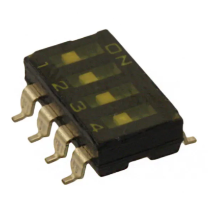

    SMD-8P,11.1x6.2mm
    拨码开关 SMD-8P,11.1x6.2mm SPST 24VDC 100mA
A6S-4102-H 数据手册
Slide DIP Switch A6S-H Standard Surface-Mounting Slide DIP Switches ● Gold-plated twin contacts ensure high reliability. ● Washable, with seal tape available. ● Models with from 1 to 10 poles meet wide needs. ● Embossed taping available for small-reel 100 pcs/ 500 pcs. RoHS Compliant ■List of Models Tube Packaging Type No. of poles Flat actuator Standard With seal tape Raised actuator Quantity per tube 1 130 A6S-1101-H A6S-1102-H A6S-1104-H 2 76 A6S-2101-H A6S-2102-H A6S-2104-H 3 55 A6S-3101-H A6S-3102-H A6S-3104-H 4 42 A6S-4101-H A6S-4102-H A6S-4104-H 5 35 A6S-5101-H A6S-5102-H A6S-5104-H 6 28 A6S-6101-H A6S-6102-H A6S-6104-H 7 25 A6S-7101-H A6S-7102-H A6S-7104-H 8 22 A6S-8101-H A6S-8102-H A6S-8104-H 9 20 A6S-9101-H A6S-9102-H A6S-9104-H 10 18 A6S-0101-H A6S-0102-H A6S-0104-H Note: Order in multiples of the package quantity. 1 A6S-H A6S-H Embossed Taping (Standard reel) Type Flat actuator Standard No. of poles Raised actuator With seal tape Quantity per Quantity per reel reel A6S-1101-PH A6S-1102-PH 800 A6S-1104-PH 2 A6S-2101-PH A6S-2102-PH 700 A6S-2104-PH 3 A6S-3101-PH A6S-3102-PH 700 A6S-3104-PH 4 A6S-4101-PH A6S-4102-PH 700 A6S-4104-PH 5 A6S-5101-PH A6S-5102-PH 800 A6S-5104-PH A6S-6101-PH A6S-6102-PH 700 A6S-6104-PH 7 A6S-7101-PH A6S-7102-PH 800 A6S-7104-PH 8 A6S-8101-PH A6S-8102-PH 700 A6S-8104-PH 9 --- (See note 2.) A6S-9102-PH 700 A6S-9104-PH 10 --- (See note 2.) A6S-0102-PH 800 A6S-0104-PH 1 800 6 900 Note: 1. Order in multiples of the package quantity. 2. Models with a different number of poles than those listed here can also be ordered. For details, consult your OMRON sales representative. Embossed Taping (Small reel) Type Flat actuator Raised actuator Standard With seal tape 2 --- (See note 2.) A6S-2102-PMH --- (See note 2.) 3 A6S-3101-PMH --- (See note 2.) --- (See note 2.) A6S-4101-PMH A6S-4102-PMH A6S-4104-PMH A6S-6101-PMH A6S-6102-PMH A6S-6104-PMH 8 A6S-8101-PMH A6S-8102-PMH A6S-8104-PMH 10 A6S-0101-PMH A6S-0102-PMH A6S-0104-PMH No. of poles Quantity per reel 4 400 6 Note: 1. Order in multiples of the package quantity. 2. Models with a different number of poles than those listed here can also be ordered. For details, consult your OMRON sales representative. Embossed Taping (100 pcs reel) Type No. of poles Flat actuator Standard With seal tape Raised actuator Quantity per reel 1 A6S-1101-H-R100 A6S-1102-H-R100 A6S-1104-H-R100 2 A6S-2101-H-R100 A6S-2102-H-R100 A6S-2104-H-R100 3 A6S-3101-H-R100 A6S-3102-H-R100 A6S-3104-H-R100 4 A6S-4101-H-R100 A6S-4102-H-R100 A6S-4104-H-R100 5 A6S-5101-H-R100 A6S-5102-H-R100 A6S-5104-H-R100 A6S-6101-H-R100 A6S-6102-H-R100 A6S-6104-H-R100 7 A6S-7101-H-R100 A6S-7102-H-R100 A6S-7104-H-R100 8 A6S-8101-H-R100 A6S-8102-H-R100 A6S-8104-H-R100 9 A6S-9101-H-R100 A6S-9102-H-R100 A6S-9104-H-R100 10 A6S-0101-H-R100 A6S-0102-H-R100 A6S-0104-H-R100 6 100 ■Ratings/Characteristics Rating (resistive load) 25 mA at 24 VDC 10 μA (minimum current) at 3.5 VDC Ambient operating temperature –20 to +70°C at 60% max. (with no icing or condensation) Ambient operating humidity 35% to 95% (at +5 to +35°C) Insulation resistance 100 MΩ min. (at 250 VDC with insulation tester) Contact resistance (initial value) 200 mΩ max. Dielectric strength Between terminals 500 VAC for 1 min Vibration resistance Malfunction 10 to 55 Hz, 1.5-mm double amplitude 2 A6S-H A6S-H Shock resistance Malfunction 300 m/s2 min. Durability Electrical 1,000 operations min. Washing Standard models: Not possible, Models with seal tape: Possible, Models with raised actuators: Not possible Degree of protection IEC IP40 Operating force 0.29 to 9.8 N {30 to 1,000 gf} Weight 0.25 g (2 poles) 0.41 g (4 poles) 0.58 g (6 poles) 0.73 g (8 poles) 0.87 g (10 poles) ■Dimensions (Unit: mm) ● Flat Actuator Standard A6S-@101-H A6S-@101-PH A6S-@101-PMH A6S-@101-H-R100 A±0.2 ON 6.2±0.2 1 2 3 4 5 6 7 8 0.5 With Seal Tape A6S-@102-H A6S-@102-PH A6S-@102-PMH A6S-@102-H-R100 Flat Actuator Raised Actuator Flat Actuator With Seal Tape Standard Seal tape (t = 0.06) 1.1 9.8±0.3 9.8±0.3 1 9.8±0.3 0.7 3±0.1 0.7 min. * ● Raised Actuator A6S-@104-H A6S-@104-PH A6S-@104-PMH A6S-@104-H-R100 0.25 2.54 2.54 × (P−1) 0.7 0.7 0.25 0.7 0.7 0.25 0.7 0.7 * 1 pole type is 0 to 0.15 mm No. of poles PCB Dimensions (Reference) (Top View) 1.1 7.4 10.4 2.54 × (P−1) ±0.1 P: Number of poles Model Flat Actuator Dimension A Standard With Seal Tape Raised Actuator 1 A6S-1101-H A6S-1102-H A6S-1104-H 3.48 2 A6S-2101-H A6S-2102-H A6S-2104-H 6.02 3 A6S-3101-H A6S-3102-H A6S-3104-H 8.56 4 A6S-4101-H A6S-4102-H A6S-4104-H 11.10 5 A6S-5101-H A6S-5102-H A6S-5104-H 13.64 6 A6S-6101-H A6S-6102-H A6S-6104-H 16.18 7 A6S-7101-H A6S-7102-H A6S-7104-H 18.72 8 A6S-8101-H A6S-8102-H A6S-8104-H 21.26 9 A6S-9101-H A6S-9102-H A6S-9104-H 23.80 10 A6S-0101-H A6S-0102-H A6S-0104-H 26.34 Note: Unless otherwise specified, a tolerance of ±0.4 mm applies to all dimensions. ■Internal Connections Contact Form (Top View) ON 1 2 9 10 ■Precautions Be sure to read the Safety precautions common to all DIP Switches for correct use. 3 A6S-H A6S-H • Application examples provided in this document are for reference only. In actual applications, confirm equipment functions and safety before using the product. • Consult your OMRON representative before using the product under conditions which are not described in the manual or applying the product to nuclear control systems, railroad systems, aviation systems, vehicles, combustion systems, medical equipment, amusement machines, safety equipment, and other systems or equipment that may have a serious influence on lives and property if used improperly. Make sure that the ratings and performance characteristics of the product provide a margin of safety for the system or equipment, and be sure to provide the system or equipment with double safety mechanisms. Note: Do not use this document to operate the Unit. OMRON Corporation Electronic and Mechanical Components Company 4 Contact: www.omron.com/ecb Cat. No. A211-E1-04 0619(0207)(O)

物料型号:A6S-H系列
器件简介:OMRON品牌的A6S-H系列滑动式DIP开关,采用镀金双触点确保高可靠性,可清洗,并提供密封胶带。该系列提供1至10极的多种型号,满足广泛的应用需求。符合RoHS标准。
引脚分配:文档中提供了不同极数的型号及其对应的封装类型,包括标准型、带密封胶带型和带凸起驱动器型。每种型号都有相应的型号编号,如A6S-1101-H、A6S-2101-H等。
参数特性: - 电阻负载:25mA at 24 VDC,最小电流10A at 3.5 VDC - 环境操作温度:-20至+70°C,最大湿度60%(无结冰或冷凝) - 环境操作湿度:35%至95%(+5至+35°C) - 绝缘电阻/接触电阻(初始值):最小100MΩ(250VDC绝缘电阻测试仪) - 耐电压:500VAC 1分钟 - 振动抵抗:10至55 Hz,1.5mm双振幅 - 冲击抵抗:300m/s² 1分钟 - 耐久性:最少1000次操作 - 洗涤:标准型号不可洗涤,带密封胶带的型号可洗涤,带凸起驱动器的型号不可洗涤 - 保护等级:IEC IP40 - 操作力:0.29至9.8N(30至1000gf) - 重量:根据极数不同,从0.25g(2极)到0.87g(10极)不等
功能详解:文档提供了详细的产品特性,包括操作温度、湿度、绝缘和接触电阻、耐电压、振动和冲击抵抗等。此外,还提供了操作力和重量信息。
应用信息:文档中提到应用示例仅供参考,在实际应用中,需要在确认设备功能和安全后使用产品。在未在手册中描述的条件下使用产品或将产品应用于可能对生命和财产产生严重影响的系统或设备之前,应咨询OMRON代表。
封装信息:提供了不同极数的DIP开关的尺寸信息,包括标准型、带密封胶带型和带凸起驱动器型。所有尺寸除非另有说明,否则公差为±0.4mm。
