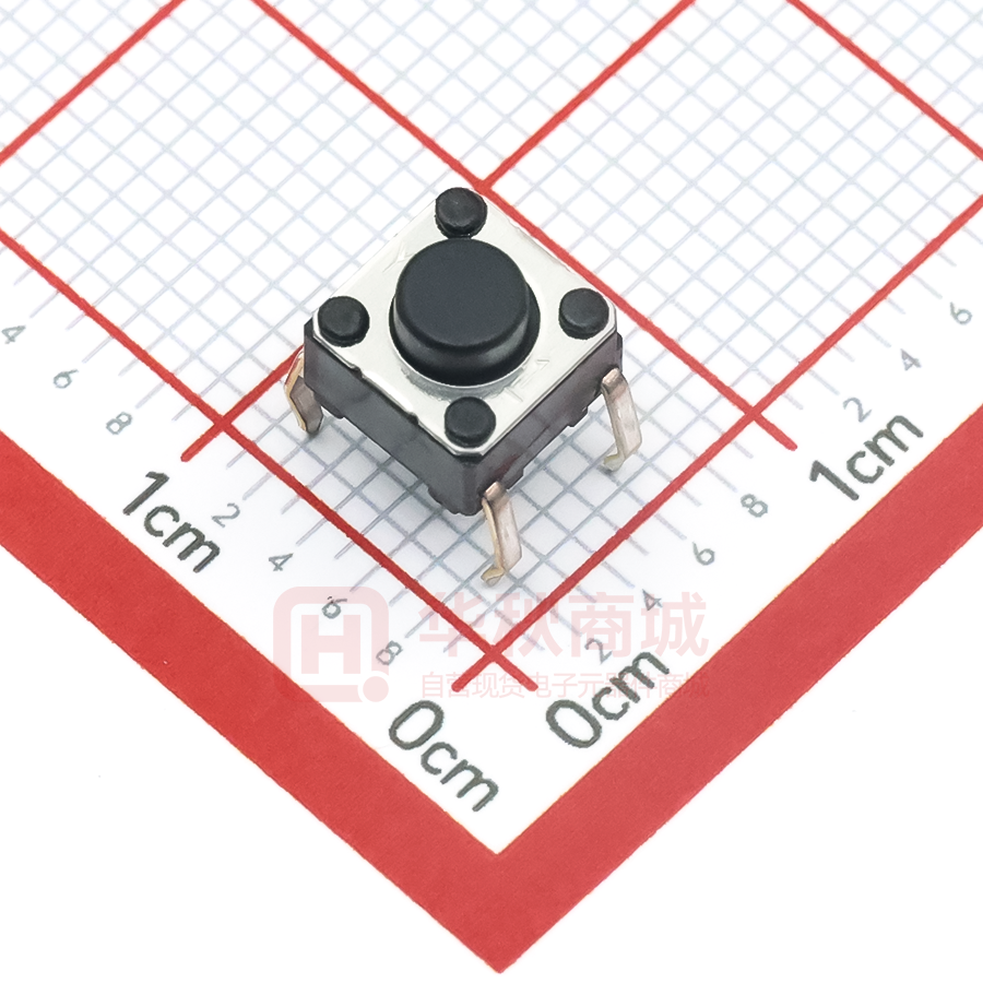

    轻触开关 6*6*5mm 直插
B3F-1020 数据手册
Tactile Switch B3F Miniature, Space-Saving Tactile Switch Provides Long Service Life and Easy Mounting • Extended mechanical/electrical service life: 10 x 106 operations for 12 x 12 mm type and 1 x 106 operations for the 6 x 6 mm type • Ideal for applications such as audio, office and communications equipment, measuring instruments, TVs, VCRs, etc. • Taped radial type, vertical type and high force types are available. • Gold plated models available for increased contact reliability, resistance to corrosive gas and insulation fault prevention for ion migration in harsh environments • RoHS Compliant Ordering Information ■ B3F-1@@@, B3F-3@@@ 6 x 6 mm type Type Plunger Switch height Operating force Model Without ground terminal With ground terminal Bags Standard Flat 4.3 mm General-purpose: 100 g 150 g High-force: 5.0 mm 260 g General-purpose: 100 g 150 g High-force: 5.0 mm (7.5 mm pitch) Projected 7.3 mm 260 g General-purpose: 100 g General-purpose: 100 g 150 g High-force: 260 g B3F-1000 B3F-1002 B3F-1005 B3F-1020 B3F-1022 B3F-1025 — B3F-1050 B3F-1052 B3F-1055 Bags B3F-1100 B3F-1102 B3F-1105 B3F-1120 B3F-1122 B3F-1125 B3F-1110 B3F-1150 B3F-1152 B3F-1155 Vertical Flat 3.15 mm General-purpose: 100 g 150 g High-force: 260 g General-purpose: 100 g 150 g High-force: 260 g General-purpose: 100 g 150 g High-force: 260 g — — — — — — — — — B3F-3100 B3F-3102 B3F-3105 B3F-3120 B3F-3122 B3F-3125 B3F-3150 B3F-3152 B3F-3155 3.85 mm Projected 6.15 mm Important Note:Switches cannot be water-washed. Tactile Switch B3F 221 ■ B3F-1@@@-G 6 x 6 mm type with Gold Plating Type Plunger Switch height Form of shipment operating force Model Without ground terminal Bags (100 Switches) 6 x 6 mm switches with gold plating Flat 4.3 mm 5.0 mm 180 g B3F-1002-G B3F-1022-G B3F-1102-G B3F-1122-G With ground terminal Note: The minimum order is 100 Switches. Order in multiples of the minimum order. ■ B3F-4@@@, B3F-5@@@ 12 x 12 mm type Type Plunger Switch height Operating force Model Without ground terminal With ground terminal Bags Standard Flat 4.3 mm General-purpose: 130 g High-force: 260 g B3F-4000 B3F-4005 Bags B3F-4100 B3F-4105 Projected 7.3 mm General-purpose: 130 g High-force: 260 g B3F-4050 B3F-4055 B3F-4150 B3F-4155 Long service life Flat 4.3 mm General-purpose: 130 g B3F-5000 B3F-5100 Projected 7.3 mm B3F-5050 B3F-5150 High reliability gold-plated contact Flat 4.3 mm B3F-5001 B3F-5101 Projected 7.3 mm B3F-5051 B3F-5151 Important Note: Switches cannot be water-washed. 222 Tactile Switch B3F ■ B3F-6@@@ Taped Radial (Auto Insertion) 6 x 6 mm type Type B3F-6000 Plunger Flat Switch height 4.3 mm 5.0 mm Operating force General-purpose: 100 g High-force: High-force: Projected 7.3 mm 150 g 150 g General-purpose: 100 g Model Without ground terminal With ground terminal B3F-6000 B3F-6002 B3F-6020 B3F-6022 B3F-6050 B3F-6052 B3F-6100 B3F-6102 B3F-6120 B3F-6122 B3F-6150 B3F-6152 General-purpose: 100 g High-force: 150 g Note: The above switches must be ordered in units of 1,000. Important Note: Switches cannot be water-washed. ■ Accessories See “B32” Tactile Switch Key Top data sheet for keycaps that fit projected plunger B3F models. ■ Plunger Identification Tables Use these tables to determine tactile switch type by plunger color. B3F-1@@@/-3@@@/-6@@@ Plunger color Ivory Black Yellow Gray Orange Pink Operating force 100 g 100 g 150 g 180 g 150 g 180 g 260 g 260 g Type B3F-1000, 1100, 1050, 1150, 3100, 3150, 6000, 6100, 6050, 6150 B3F-1020, 1120, 1110, 3120, 6020, 6120 B3F-1002, 1102, 1052, 1152, 3102, 3152, 6002, 6102, 6052, 6152 B3F-1002-G, 1102-G B3F-1022, 1122, 3122, 6022, 6122 B3F-1022-G, 1122-G B3F-1005, 1105, 1055, 1155, 3105, 3155, 6005, 6055 B3F-1025, 1125, 3125, 6025 B3F-4@@@/-5@@@ Plunger color Ivory Yellow Blue Operating force 130 g 260 g 130 g Type B3F-4000, 4100, 4050, 4150 B3F-4005, 4105, 4055, 4155 B3F-5000 Series Tactile Switch B3F 223 Specifications ■ Characteristics Part Number B3F-1@@@ B3F-3@@@ Contact form Switching capacity SPST-NO 1 to 50 mA, 5 to 24 VDC (resistive load) 100 μA to 50 mA, 5 to 24 VDC (resistive load) 100 MΩ max. (rated: 100 μA, 5 VDC) B3F-4@@@ B3F-5@@@ B3F-6@@@ B3F-1@@@-G Contact resistance Insulation resistance Dielectric strength Bounce time Vibration resistance Shock resistance Ambient operating temperature Ambient operating humidity Weight 100 MΩ max. (rated: 1mA, 5VDC) 100 MΩ min. (at 250 VDC) 500 VAC, 50/60 Hz for 1 minute 5 ms max. Malfunction durability: 10 to 55 Hz, 1.5 mm double amplitude for 30 to 60 s Mechanical durability: 1,000 m/s2 (approx. 100 G) Malfunction durability: 100 m/s2 (approx. 10 G) -25° to 70°C (at 60% RH max.) with no icing or condensation 35% to 85% RH (at 5 to 35 °C) Approx. 0.25 g Approx. 0.85 g Approx. 0.25 g Note: Data shown are of initial value. ■ Life Expectancy B3F-1000, B3F-3000, B3F-6000: 1,000,000 operations min (OF: 100gf) (B3F-1070: 500,000 operations min) 300,000 operations min (OF: 150 gf) 100,000 operations min (OF: 260gf) B3F-G: 300,000 operations min (OF: 180gf) B3F-4000: 3,000,000 operations min (OF: 130gf) 1,000,000 operations min (OF: 260gf) B3F-5000: 10,000,000 operations min. ■ Operating Characteristics Characteristics B3F-1@@@ / -3@@@ General purpose type Operating force (OF) Release force (RF) min. Pretravel (PT) 100 ± 30 g 20 g 150 ± 50 g 50 g 0.25 +0.2/-0.1 mm High force type 260 ± 70 gf 50 gf Part Number B3F-4@@@ / -5@@@ General purpose type 130 ± 50 g 30 g High force type 260 ± 70 g 50 g B3F-6@@@ General purpose type 100 ± 30 g 20 g High force type 150 ± 50 g 50 g 0.25 +0.2/-0.1 mm B3F-1@@@-G General purpose type 180 ± 50 g 50 g 0.3 +0.2/-0.1 mm 224 Tactile Switch B3F Dimensions Note: 1. Unless otherwise specified, all units are in millimeters and a tolerance of ± 0.4 mm applies to all dimensions. 2. Terminal numbers are not indicated on this switch. With the switch turned over so that the logo mark “OMRON” is visible on the upper part of the rear side of the switch base, the terminal on the right of the logo mark is numbered “1” and that on the bottom right is “3.” Accordingly, two terminals on the left side are numbered “2” and “4” respectively. ■ 6 x 6 mm Models Standard, Flat Plunger Type (without Ground Terminal) B3F-1000, B3F-1002, B3F-1005, B3F-1020*, B3F-1022*, B3F-1025*, B3F-1002-G, B3F-1022-G* 6±0.2 Standard, Projected Plunger Type (without Ground Terminal) B3F-1050, B3F-1052, B3F-1055 6±0.2 PCB Mounting (Top View) (Single-sided PCB, t=1.6) 4.5±0.2 4.5±0.1 6±0.2 PCB Mounting (Top View) (Single-sided PCB, t=1.6) 6±0.2 4.5±0.2 4.5±0.2 3.5 dia. (See note.) 2.4 2.4±0.1 6.5±0.1 Four, 1±0.1 dia. 1.8±0.1 7.3±0.2 4.3±0.2 3.5 3.5 dia. 6.5±0.1 Four, 1±0.05 dia. 4.3±0.2 3.5 3.4 Terminal Arrangement /Internal Connections (Top View) 4 3 Terminal Arrangement/Internal Connections (Top View) 4 3 3.4 0.3 6.5±0.5 7.7±0.5 0.7 0.7 2 1 0.3 6.5±0.5 7.7±0.5 0.7 0.7 2 1 * The height of B3F-1020, B3F-1022, B3F-1025, and B3F-1026 is 5±0.2 mm. Standard, Flat Plunger Type (with Ground Terminal, Pitch: 6.5 mm) B3F-1100, B3F-1102, B3F-1105, B3F-1120*, B3F-1122*, B3F-1125*, B3F-1102-G, B3F-1122-G* 6±0.2 Standard, Projected Plunger Type (with Ground Terminal) B3F-1150, B3F-1152, B3F-1155 6±0.2 PCB Mounting (Top View) (Single-sided PCB, t=1.6) 4.5±0.2 4.5±0.1 1.5 3.5 dia. 3.4 4.1±0.1 Five, 1±0.05 dia. 6.5±0.1 6±0.2 PCB Mounting (Top View) (Single-sided PCB, t=1.6) 6±0.2 4.5±0.2 4.1±0.1 1.5 2.4 2.4±0.1 1.8±0.1 3.5 dia. 4.5±0.1 Five, 1±0.05 dia. 6.5±0.1 (See note.) 4.3±0.2 3.5 0.3 0.7 Terminal Arrangement/Internal Connections (Top View) 4 0.7 0.3 2 1 5 0.7 3 7.3±0.2 4.3±0.2 3.5 Terminal Arrangement/ Internal Connections (Top View) 4 3 3.4 6.5±0.5 7.7±0.5 0.3 0.7 6.5±0.5 7.7±0.5 2 0.7 0.3 0.7 5 1 *The height of B3F-1120, B3F-1122, and B3F-1125 is 5±0.2 mm. Standard, Flat Plunger Type (with Ground Terminal, Pitch: 7.5 mm) B3F-1110 6±0.2 6±0.2 PCB Mounting (Top View) (Single-sided PCB, t=1.6) 4.5±0.2 4.5±0.1 1.5 3.5 dia. 4.1±0.1 Four, 1.2±0.05 dia. Terminal Arrangement/Internal Connections (Top View) 4 3 2 5 1 5±0.2 3.5 3.4 1±0.05 dia. 7.5±0.1 0.3 0.7 7.5±0.5 9±0.5 0.7 0.3 0.7 Tactile Switch B3F 225 Side-operated, Flat Plunger Type B3F-3100, B3F-3102, B3F-3105 Side-operated, Projected Plunger Type B3F-3150, B3F-3152, B3F-3155 7.3 7.3 PCB Mounting (Top View) (Single-sided PCB, t=1.6) Two, 1.5±0.05 dia. PCB Mounting (Top View) (Single-sided PCB, t=1.6) Two, 1.5±0.05 dia. 6.25 6.25 2.5±0.1 4.5±0.1 3.5 dia. 4.5±0.1 7±0.1 Two, 1±0.05 dia. 7.4 4 3.5 0.7 4.5±0.5 2.25 7±0.5 8.7 3.15±0.2 2.5±0.5 0.3 0.3 1 3.5 dia. 7±0.1 2.5±0.1 Two, 1±0.05 dia. 2.4 2.4±0.1 7.4 Terminal Arrangement/ Internal Connections (Top View) 4 3 1 2 4 3.5 Terminal Arrangement/ Internal Connections (Top View) 4 3 0.3 1.8±0.1 2.25 6.15±0.2 0.7 4.5±0.5 7±0.5 8.7 0.3 1 2.5±0.5 1 2 Side-operated, Flat Plunger Type (Height: 3.85 mm) B3F-3120, B3F-3122, B3F-3125 7.3 PCB Mounting (Top View) (Single-sided PCB, t=1.6) Two, 1.5±0.05 dia. 6.25 2.5±0.1 3.5 dia. 4.5±0.1 7±0.1 Two, 1±0.05 dia. 7.4 4 3.5 0.7 4.5±0.5 2.25 7±0.5 8.7 3.85±0.2 2.5±0.5 0.3 0.3 3 1 1 2 Terminal Arrangement/ Internal Connections (Top View) 4 226 Tactile Switch B3F ■ 12 x 12 mm Models Standard, Long-life, and High-reliability Models Flat Plunger Type (without Ground Terminal) B3F-4000, B3F-4005, B3F-5000, B3F-5001 Standard, Long-life, and High-reliability Models Projected Plunger Type (without Ground Terminal) B3F-4050, B3F-4055, B3F-5050, B3F-5051 PCB Mounting (Top View) (Single-sided PCB, t=1.6) Two, 1.8±0.05 dia. (for positioning boss) PCB Mounting (Top View) (Single-sided PCB, t=1.6) Two, 1.8±0.05 dia. (for positioning boss) 12±0.2 12±0.2 5±0.1 12±0.2 5±0.2 9±0.1 12±0.2 5±0.2 5±0.1 9±0.1 12.5±0.1 7.1 dia. Four, 1.2±0.05 dia. 12.5±0.1 3.8 3.8±0.1 1.8±0.2 7.3±0.2 4.3±0.2 3.5 0.3 1 9±0.1 1 2 3.5 7.1 dia. Four, 1.2±0.05 dia. 4.3±0.2 3.5 3.5 Terminal Arrangement/ Internal Connections (Top View) 4 3 Terminal Arrangement/ Internal Connections (Top View) 4 3 0.3 12.5±0.5 13.8±0.5 1 9±0.1 1 2 1 12.5±0.5 13.8±0.5 1 Standard, Long-life, and High-reliability Models Flat Plunger Type (with Ground Terminal) B3F-4100, B3F-4105, B3F-5100, B3F-5101 PCB Mounting (Top View) (Single-sided PCB, t=1.6) Two, 1.8±0.05 dia. (for positioning boss) 12±0.2 5±0.1 12±0.2 5±0.2 6.9±0.1 Five, 1.2±0.05 dia. 1.6 7.1 dia. 12.5±0.1 9±0.1 Standard, Long-life, and High-reliability Models Projected Plunger Type (with Ground Terminal) B3F-4150, B3F-4155, B3F-5150, B3F-5151 12±0.2 PCB Mounting (Top View) (Single-sided PCB, t=1.6) Two, 1.8±0.05 dia. (for positioning boss) 12±0.2 5±0.2 6.9±0.1 1.6 3.8 3.8±0.1 1.8±0.2 7.1 dia. 12.5±0.1 5±0.1 9±0.1 Five, 1.2±0.05 dia. 4.3±0.2 3.5 0.9 12.5±0.5 13.8±0.5 3.5 Terminal Arrangement/ Internal Connections (Top View) 4 3 7.3±0.2 4.3±0.2 3.5 0.9 12.5±0.5 13.8±0.5 3.5 Terminal Arrangement/ Internal Connections (Top View) 4 3 0.3 1 6.9 9±0.1 1 2 5 1 0.3 1 6.9 9±0.1 1 2 5 1 Tactile Switch B3F 227 ■ 6 x 6 mm Radial Taped Models: Sold in units of 1,000 switches Note: Terminal numbers are not indicated on this switch. With the switch turned over so that the logo mark “OMRON” is visible on the upper part of the rear side of the switch base, the terminal on the top of the logo mark is numbered “1” and that on the bottom is “2.” Flat Plunger Type (without Ground Terminal) B3F-6000, B3F-6002 6±0.3 Surface B 6±0.3 3.5 dia. Surface A 0.5 max. (1.1) 4.3 0.9 3.4 Support tape 12.7±1 6.35±1 2 max. 0.5 max. 9 180 +1 0.2 max. 0.5 5−0.2 +0.8 6 9±0.5 0.3 4 dia. ±0.2 18−0.5 +1 Note: The tape is random between surface A and surface B. PCB Mounting (Top View) (Single-sided PCB, t=1.6) +0.1 0 Terminal Arrangement /Internal Connections (Top View) 12.7±0.3 Carrier tape Two, 1 dia. 5±0.1 2 1 Flat Plunger Type (with Ground Terminal) B3F-6100, B3F-6102 6±0.3 12.7±1 6.35±1 2 2 max. 6±0.3 3.5 dia. 0.5 max. (1.1) 4.3 3.1 0.2 dia. 0.5 5±0.2 0.9 3.4 Support tape 11 0.5 max. 20±0.5 6 9±0.5 18−0.5 4±0.2 dia. 12.7±0.3 Carrier tape +1 5−0.2 +0.8 0.3 0.6 PCB Mounting (Top View) (Single-sided PCB, t=1.6) Terminal Arrangement /Internal Connections (Top View) Three, 1 +0.1 0 dia. 5±0.1 5±0.1 2 1 3 Flat Plunger Type (without Ground Terminal) B3F-6020, B3F-6022 6±0.3 6±0.3 Surface B 12.7±1 6.35±1 2 max. 3.5 dia. Surface A 0.5 max. (1.1) 5 0.9 3.4 6 0.2 max. 9±0.5 Support tape 0.5 max. 9 +1 180 18−0.5 4±0.2 dia. 12.7±0.3 Carrier tape +1 0.5 5−0.2 +0.8 0.3 5±0.2 Note: The tape is random between surface A and surface B. PCB Mounting (Top View) (Single-sided PCB, t=1.6) Terminal Arrangement /Internal Connections (Top View) Two, 1 +0.1 0 dia. 5±0.1 2 1 228 Tactile Switch B3F Flat Plunger Type (with Ground Terminal) B3F-6120, B3F-6122 6±0.3 12.7±1 6.35±1 6±0.3 3.5 dia. 2 2 max. 0.5 max. (1.1) 3.1 0.2 max. 0.5 5±0.2 +0.8 5−0.2 5 0.9 3.4 Support tape 11 0.5 max. 20±0.5 9±0.5 6 0.3 0.6 4±0.2 dia. 18−0.5 +1 PCB Mounting (Top View) (Single-sided PCB, t=1.6) Terminal Arrangement /Internal Connections (Top View) 12.7±0.3 Carrier tape Three, 1 +0.1 0 dia. 5±0.1 5±0.1 2 1 3 Projected Plunger Type (without Ground Terminal) B3F-6050, B3F-6052 6±0.3 Surface B 6±0.3 3.5 dia. 12.7±1 6.35±1 Surface A 2.4 0.5 max. 7.3 2 max. (1.1) 0.9 3.4 Support tape 0.2 max. 0.5 dia. 9 180 9±0.5 +1 0.5 5−0.2 +0.8 0.3 6 PCB Mounting (Top View) (Single-sided PCB, t=1.6) +0.1 0 Terminal Arrangement /Internal Connections (Top View) 18−0.5 4±0.2 dia. 12.7±0.3 Carrier tape +1 Two, 1 dia. 5±0.1 2 1 Note: The tape is random between surface A and surface B. Projected Plunger Type (with Ground Terminal) B3F-6150, B3F-6152 6±0.3 6±0.3 2 3.5 dia. 0.5 max. 7.3 2.4 12.7±1 6.35±1 2 max. (1.1) 3.1 0.9 3.4 Support tape 0.2 max. 0.5 max. 11 20±0.5 9±0.5 6 0.5 5±0.2 +0.8 5−0.2 0.3 0.6 18−0.5 4±0.2 dia. 12.7±0.3 Carrier tape +1 PCB Mounting (Top View) (Single-sided PCB, t=1.6) Terminal Arrangement /Internal Connections (Top View) Three, 1 +0.1 0 dia. 5±0.1 5±0.1 2 1 3 Tactile Switch B3F 229 Hints on Correct Use See the Tactile Switch User's Guide, "Tactile Switches - Technical Information" for information regarding processing and handling. ■ Taped Radial (Auto Insertion) Packaging • Tactile switches packed on tape are placed into packing boxes as shown below. • Number of switches per box: 1,000 • Tape may be drawn from the box either from the top or from the bottom. ■ Taping Strength The tactile switches will not release from the tape when pulled in directions A and B at the following forces. A: 500 g B: 100 g Precautions Be sure to read the precautions common to all Tactile Switches, contained in the Technical User’s Guide, “Tactile Switches, Technical Information” for correct use. 230 Tactile Switch B3F Omron Electronic Components, LLC Terms and Conditions of Sales I. GENERAL 1. Definitions: The words used herein are defined as follows. (a) Terms: These terms and conditions (b) Seller: Omron Electronic Components LLC and its subsidiaries (c) Buyer: The buyer of Products, including any end user in section III through VI (d) Products: Products and/or services of Seller (e) Including: Including without limitation 2. Offer; Acceptance: These Terms are deemed part of all quotations, acknowledgments, invoices, purchase orders and other documents, whether electronic or in writing, relating to the sale of Products by Seller. Seller hereby objects to any Terms proposed in Buyer's purchase order or other documents which are inconsistent with, or in addition to, these Terms. 3. Distributor: Any distributor shall inform its customer of the contents after and including section III of these Terms. II. SALES 1. Prices; Payment: All prices stated are current, subject to change without notice by Seller. Buyer agrees to pay the price in effect at the time the purchase order is accepted by Seller. Payments for Products received are due net 30 days unless otherwise stated in the invoice. Buyer shall have no right to set off any amounts against the amount owing in respect of this invoice. 2. Discounts: Cash discounts, if any, will apply only on the net amount of invoices sent to Buyer after deducting transportation charges, taxes and duties, and will be allowed only if (a) the invoice is paid according to Seller's payment terms and (b) Buyer has no past due amounts owing to Seller. 3. Interest: Seller, at its option, may charge Buyer 1.5% interest per month or the maximum legal rate, whichever is less, on any balance not paid within the stated terms. 4. Orders: Seller will accept no order less than 200 U.S. dollars net billing. 5. Currencies: If the prices quoted herein are in a currency other than U.S. dollars, Buyer shall make remittance to Seller at the then current exchange rate most favorable to Seller; provided that if remittance is not made when due, Buyer will convert the amount to U.S. dollars at the then current exchange rate most favorable to Seller available during the period between the due date and the date remittance is actually made. 6. Governmental Approvals: Buyer shall be responsible for all costs involved in obtaining any government approvals regarding the importation or sale of the Products. 7. Taxes: All taxes, duties and other governmental charges (other than general real property and income taxes), including any interest or penalties thereon, imposed directly or indirectly on Seller or required to be collected directly or indirectly by Seller for the manufacture, production, sale, delivery, importation, consumption or use of the Products sold hereunder (including customs duties and sales, excise, use, turnover and license taxes) shall be charged to and remitted by Buyer to Seller. 8. Financial: If the financial position of Buyer at any time becomes unsatisfactory to Seller, Seller reserves the right to stop shipments or require satisfactory security or payment in advance. If Buyer fails to make payment or otherwise comply with these Terms or any related agreement, Seller may (without liability and in addition to other remedies) cancel any unshipped portion of Products sold hereunder and stop any Products in transit until Buyer pays all amounts, including amounts payable hereunder, whether or not then due, which are owing to it by Buyer. Buyer shall in any event remain liable for all unpaid accounts. 9. Cancellation; Etc: Orders are not subject to rescheduling or cancellation unless Buyer indemnifies Seller fully against all costs or expenses arising in connection therewith. 10. Force Majeure: Seller shall not be liable for any delay or failure in delivery resulting from causes beyond its control, including earthquakes, fires, floods, strikes or other labor disputes, shortage of labor or materials, accidents to machinery, acts of sabotage, riots, delay in or lack of transportation or the requirements of any government authority. 11. Shipping; Delivery: Unless otherwise expressly agreed in writing by Seller: (a) All sales and shipments of Products shall be FOB shipping point (unless otherwise stated in writing by Seller), at which point title to and all risk of loss of the Products shall pass from Seller to Buyer, provided that Seller shall retain a security interest in the Products until the full purchase price is paid by Buyer; (b) Delivery and shipping dates are estimates only; and (c) Seller will package Products as it deems proper for protection against normal handling and extra charges apply to special conditions. 12. Claims: Any claim by Buyer against Seller for shortage or damage to the Products occurring before delivery to the carrier or any claim related to pricing or other charges must be presented in detail in writing to Seller within 30 days of receipt of shipment. III. PRECAUTIONS 1. Suitability: IT IS THE BUYER’S SOLE RESPOINSIBILITY TO ENSURE THAT ANY OMRON PRODUCT IS FIT AND SUFFICIENT FOR USE IN A MOTORIZED VEHICLE APPLICATION. BUYER SHALL BE SOLELY RESPONSIBLE FOR DETERMINING APPROPRIATENESS OF THE PARTICULAR PRODUCT WITH RESPECT TO THE BUYER’S APPLICATION INCLUDING (A) ELECTRICAL OR ELECTRONIC COMPONENTS, (B) CIRCUITS, (C) SYSTEM ASSEMBLIES, (D) END PRODUCT, (E) SYSTEM, (F) MATERIALS OR SUBSTANCES OR (G) OPERATING ENVIRONMENT. Buyer acknowledges that it alone has determined that the Products will meet their requirements of the intended use in all cases. Buyer must know and observe all prohibitions of use applicable to the Product/s. 2. Use with Attention: The followings are some examples of applications for which particular attention must be given. This is not intended to be an exhaustive list of all possible use of any Product, nor to imply that any use listed may be suitable for any Product: (a) Outdoor use, use involving potential chemical contamination or electrical interference. (b) Use in consumer Products or any use in significant quantities. (c) Energy control systems, combustion systems, railroad systems, aviation systems, medical equipment, amusement machines, vehicles, safety equipment, and installations subject to separate industry or government regulations. (d) Systems, machines, and equipment that could present a risk to life or property. 3. Prohibited Use: NEVER USE THE PRODUCT FOR AN APPLICATION INVOLVING SERIOUS RISK TO LIFE OR PROPERTY WITHOUT ENSURING THAT THE SYSTEM AS A WHOLE HAS BEEN DESIGNED TO ADDRESS THE RISKS, AND THAT THE PRODUCT IS PROPERLY RATED AND INSTALLED FOR THE INTENDED USE WITHIN THE OVERALL EQUIPMENT OR SYSTEM. 4. Motorized Vehicle Application: USE OF ANY PRODUCT/S FOR A MOTORIZED VEHICLE APPLICATION MUST BE EXPRESSLY STATED IN THE SPECIFICATION BY SELLER. 5. Programmable Products: Seller shall not be responsible for the Buyer's programming of a programmable Product. IV. WARRANTY AND LIMITATION 1. Warranty: Seller's exclusive warranty is that the Products will be free from defects in materials and workmanship for a period of twelve months from the date of sale by Seller (or such other period expressed in writing by Seller). SELLER MAKES NO WARRANTY OR REPRESENTATION, EXPRESS OR IMPLIED, ABOUT ALL OTHER WARRANTIES, NON-INFRINGEMENT, MERCHANTABILITY OR FITNESS FOR A PARTICULAR PURPOSE OF THE PRODUCTS. 2. Buyer Remedy: Seller's sole obligation hereunder shall be to replace (in the form originally shipped with Buyer responsible for labor charges for removal or replacement thereof) the non-complying Product or, at Seller's election, to repay or credit Buyer an amount equal to the purchase price of the Product; provided that there shall be no liability for Seller or its affiliates unless Seller's analysis confirms that the Products were correctly handled, stored, installed and maintained and not subject to contamination, abuse, misuse or inappropriate modification. Return of any Products by Buyer must be approved in writing by Seller before shipment. 3. Limitation on Liability: SELLER AND ITS AFFILIATES SHALL NOT BE LIABLE FOR SPECIAL, INDIRECT, INCIDENTAL OR CONSEQUENTIAL DAMAGES, LOSS OF PROFITS OR PRODUCTION OR COMMERCIAL LOSS IN ANY WAY CONNECTED WITH THE PRODUCTS, WHETHER SUCH CLAIM IS BASED IN CONTRACT, WARRANTY, NEGLIGENCE OR STRICT LIABILITY. FURTHER, IN NO EVENT SHALL LIABILITY OF SELLER OR ITS AFFILITATES EXCEED THE INDIVIDUAL PRICE OF THE PRODUCT ON WHICH LIABILITY IS ASSERTED. 4. Indemnities: Buyer shall indemnify and hold harmless Seller, its affiliates and its employees from and against all liabilities, losses, claims, costs and expenses (including attorney's fees and expenses) related to any claim, investigation, litigation or proceeding (whether or not Seller is a party) which arises or is alleged to arise from Buyer's acts or omissions under these Terms or in any way with respect to the Products. V. INFORMATION; ETC. 1. Intellectual Property: The intellectual property embodied in the Products is the exclusive property of Seller and its affiliates and Buyer shall not attempt to duplicate it in any way without the written permission of Seller. Buyer (at its own expense) shall indemnify and hold harmless Seller and defend or settle any action brought against Seller to the extent that it is based on a claim that any Product made to Buyer specifications infringed intellectual property rights of another party. 2. Property; Confidentiality: Notwithstanding any charges to Buyer for engineering or tooling, all engineering and tooling shall remain the exclusive property of Seller. All information and materials supplied by Seller to Buyer relating to the Products are confidential and proprietary, and Buyer shall limit distribution thereof to its trusted employees and strictly prevent disclosure to any third party. 3. Performance Data: Performance data is provided as a guide in determining suitability and does not constitute a warranty. It may represent the result of Seller's test conditions, and the users must correlate it to actual application requirements. 4. Change In Specifications: Product specifications and descriptions may be changed at any time based on improvements or other reasons. It is Seller’s practice to change part numbers when published ratings or features are changed, or when significant engineering changes are made. However, some specifications of the Product may be changed without any notice. 5. Errors And Omissions: The information on Seller’s website or in other documentation has been carefully checked and is believed to be accurate; however, no responsibility is assumed for clerical, typographical or proofreading errors or omissions. 6. Export Controls: Buyer shall comply with all applicable laws, regulations and licenses regarding (a) export of the Products or information provided by Seller; (b) sale of Products to forbidden or other proscribed persons or organizations; (c) disclosure to noncitizens of regulated technology or information. VI. MISCELLANEOUS 1. Waiver: No failure or delay by Seller in exercising any right and no course of dealing between Buyer and Seller shall operate as a waiver of rights by Seller. 2. Assignment: Buyer may not assign its rights hereunder without Seller's written consent. 3. Law: These Terms are governed by Illinois law (without regard to conflict of laws). Federal and state courts in Cook County, Illinois have exclusive jurisdiction for any dispute hereunder. 4. Amendment: These Terms constitute the entire agreement between Buyer and Seller relating to the Products, and no provision may be changed or waived unless in writing signed by the parties. 5. Severability: If any provision hereof is rendered ineffective or invalid, such provision shall not invalidate any other provision. Tactile Switch B3F Certain Precautions on Specifications and Use 1. Suitability for Use. Seller shall not be responsible for conformity with any standards, codes or regulations which apply to the combination of the Product in Buyer's application or use of the Product. At Buyer's request, Seller will provide applicable third party certification documents identifying ratings and limitations of use which apply to the Product. This information by itself is not sufficient for a complete determination of the suitability of the Product in combination with the end product, machine, system, or other application or use. Buyer shall be solely responsible for determining appropriateness of the particular Product with respect to Buyer's application, product or system. Buyer shall take application responsibility in all cases but the following is a nonexhaustive list of applications for which particular attention must be given: (i) Outdoor use, uses involving potential chemical contamination or electrical interference, or conditions or uses not described in this document. (ii) Energy control systems, combustion systems, railroad systems, aviation systems, medical equipment, amusement machines, vehicles, safety equipment, and installations subject to separate industry or government regulations. (iii) Use in consumer products or any use in significant quantities. (iv) Systems, machines and equipment that could present a risk to life or property. Please know and observe all prohibitions of use applicable to this product. NEVER USE THE PRODUCT FOR AN APPLICATION INVOLVING SERIOUS RISK TO LIFE OR PROPERTY WITHOUT ENSURING THAT THE SYSTEM AS A WHOLE HAS BEEN DESIGNED TO ADDRESS THE RISKS, AND THAT THE OMRON PRODUCT IS PROPERLY RATED AND INSTALLED FOR THE INTENDED USE WITHIN THE OVERALL EQUIPMENT OR SYSTEM. 2. Programmable Products. Seller shall not be responsible for the user's programming of a programmable product, or any consequence thereof. 3. Performance Data. Performance data given in this publication is provided as a guide for the user in determining suitability and does not constitute a warranty. It may represent the result of Seller's test conditions, and the users must correlate it to actual application requirements. Actual performance is subject to Seller's Warranty and Limitations of Liability. 4. Change in Specifications. Product specifications and accessories may be changed at any time based on improvements and other reasons. It is our practice to change part numbers when published ratings or features are changed, or when significant construction changes are made. However, some specifications of the Product may be changed without any notice. When in doubt, special part numbers may be assigned to fix or establish key specifications for your application. Please consult with your Seller representative at any time to confirm actual specifications of purchased Product. 5. Errors and Omissions. The information in this publication has been carefully checked and is believed to be accurate; however, no responsibility is assumed for clerical, typographical or proofreading errors, or omissions. 6. RoHS Compliance. Where indicated, our products currently comply, to the best of our knowledge as of the date of this publication, with the requirements of the European Union's Directive on the Restriction of certain Hazardous Substances ("RoHS"), although the requirements of RoHS do not take effect until July 2006. These requirements may be subject to change. Please consult our website for current information. Complete “Terms and Conditions of Sale” for product purchase and use are on Omron’s website at http://www.components.omron.com – under the “About Us” tab, in the Legal Matters section. ALL DIMENSIONS SHOWN ARE IN MILLIMETERS. To convert millimeters into inches, multiply by 0.03937. To convert grams into ounces, multiply by 0.03527. OMRON ELECTRONIC COMPONENTS LLC 55 E. Commerce Drive, Suite B Schaumburg, IL 60173 OMRON ON-LINE Global - http://www.omron.com USA - http://www.components.omron.com 847-882-2288 Cat. No. X303-E-1 11/09 Specifications subject to change without notice Printed in USA Tactile Switch B3F
B3F-1020
1. 物料型号: - 6 x 6 mm类型:B3F-1000, B3F-1002, B3F-1005, B3F-1020, B3F-1022, B3F-1025, B3F-1002-G, B3F-1022-G - 12 x 12 mm类型:B3F-4000, B3F-4005, B3F-4050, B3F-4055, B3F-5000, B3F-5001, B3F-5100, B3F-5101 - 胶带径向(自动插入)6 x 6 mm类型:B3F-6000, B3F-6002, B3F-6020, B3F-6022, B3F-6050, B3F-6052, B3F-6100, B3F-6102, B3F-6120, B3F-6122
2. 器件简介: - B3F系列是一种小型、节省空间的触觉开关,提供长寿命和易于安装的特点。适用于音频、办公和通讯设备、测量仪器、电视、VCR等应用场合。
3. 引脚分配: - 6 x 6 mm型号:当开关翻转,使得“OMRON”标识在开关座的后侧上部可见时,右侧的引脚编号为“1”,右下侧的引脚编号为“3”,左侧两个引脚分别编号为“2”和“4”。 - 12 x 12 mm型号:同样方式确定引脚编号。
4. 参数特性: - 机械/电气寿命:12 x 12 mm类型为10^6次操作,6 x 6 mm类型为1^6次操作。 - 接触形式:单刀单掷(SPST-NO)。 - 切换容量:1至50 mA,5至24 VDC(电阻负载)。 - 接触电阻:最大100 MΩ(额定值:1mA,5VDC)。 - 绝缘电阻:最小100 MΩ(250 VDC测试)。 - 耐压:500 VAC,50/60 Hz,持续1分钟。 - 回跳时间:最大5 ms。 - 振动抵抗力:10至55 Hz,1.5 mm双振幅,持续30至60秒。 - 冲击抵抗力:机械耐久性1,000 m/s²(约100 G),故障耐久性100 m/s²(约10 G)。 - 工作环境温度:-25°C至70°C(最大60%RH,无结冰或结露)。 - 工作环境湿度:5至35°C时35%至85%RH。
5. 功能详解: - 提供了触觉开关的详细规格和性能数据,包括操作力、预行程、释放力等。
6. 应用信息: - 适用于需要触觉反馈的开关应用,如音频设备、办公和通讯设备、测量仪器等。
7. 封装信息: - 提供了详细的尺寸图和安装视图,包括6 x 6 mm和12 x 12 mm型号的平面和投影型开关。
