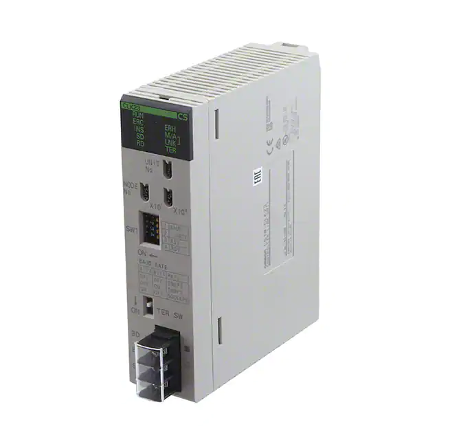

SYSMAC CS-series Controller Link Units CS1W-CLK CSM_CS1W-CLK_DS_E_2_1 New Controller Link Units, Now with 4,000 Send Words • The Controller Link is an FA network that can send and receive large amounts of data easily and at high speed. The Controller Link supports data links that enable sharing data between PLCs and computers and a message service that enables sending and receiving data whenever required. • With Wired Controller Link Units, systems can be flexibly built by using Repeater Units to enable Tbranches, long-distance wiring, and converting part of the network to optical cable. CS1W-CLK23 CS1W-CLK13 CS1W-CLK53 Features Large-capacity data links are easily achieved without programming simply by setting data link tables. Up to 20,000 (See note 1.) send/receive words can be set per node for Units (up to 62,000 words for Boards). Data links can be performed with up to 4,000 (See note 2.) words per node while ensuring data concurrency. User-set data link tables can be changed while data links are operating. (See note3.) Errors for the entire system can be monitored by using error diagnosis support software and a variety of status flags. With the token ring mode of Optical Ring Controller Link Units/Boards, duplex communications paths enable communications to continue normally even if the cable becomes disconnected. • Detecting locations of disconnection greatly shortens time required for maintenance. • Installing Controller Link Units in a CS1D system enables Duplex Communications Units to further enhance reliability. (See note 4.) Note: 1. Supported for unit version 1.2 or later. 2. CS1W-CLK@3 and 3G8F7-CLK@3 are supported. 3. Supported for CS1W-CLK@3, 3G8F7-CLK@3, and models ending with "-V1" (CS1W-CLK12-V1 and CS1W-CLK52-V1 with lot numbers 0306@@_@@@ or later ). 4. Supported for CS1W-CLK13/CLK12-V1/CLK53/CLK52-V1 and CS1D Duplex and Simplex Systems. • • • • • • 1 CS1W-CLK System Configuration Wired Controller Link Units Basic Wiring (Daisy Chain Connections) A A A A (1) B 1 km Max. * (1) C D A B (2) A C (1) D (1) D (1) 1 km Max. * 1 km Max. * 1 km Max. * (1) B (1) A A B B A A T-Branch Wiring and Partial Conversion to Optical Cable Long-distance Wiring A A A: Wired Controller Link Unit B: Wired Controller Link Support Board C: Wire-to-Optical Repeater Unit D: Wire-to-Wire Repeater Unit * At 500 kbits/s (1): Twisted-pair cable (2): Optical cable Optical Controller Link Units Token Ring Mode A A B Token Bus Mode A A B B (1) B (1) A A A A A A A: Optical Ring Controller Link Unit B: Optical Ring Controller Link Support Board (1): Optical cable 2 CS1W-CLK Ordering Information Controller Link Units, New Models Unit classification Specifications Product name Communications cable Communications type Duplex support Max. Units mountable per CPU Unit No. of unit numbers allocated Current consumption (A) 5V DC 26 V DC Model Standards Controller Link Unit Wired shielded twisted-pair cable (See note 1.) No 8 1 0.33 − CS1W-CLK23 CS1 CPU Bus Unit Controller Link Unit Optical ring H-PCF cable (See note 2.) Data links and message service Yes. Unit duplexing and cable loop back are supported. 1 Non-duplex: 8, Duplex: 11 (6 Units comprising 3 sets of Duplex Units + 5 Non-duplex Units) 1 0.52 − CS1W-CLK13 UC1, N, L, CE Controller Link Unit Optical ring GI cable (See note 3.) 0.65 − CS1W-CLK53 Controller Link Units, Old Models New models are fully compatible with old models and provide enhanced functionality, such as an increase in the number of send words from 1,000 to 4,000 words. Both types can be used simultaneously on the same network. Select a new model when ordering. Specifications Product name Communications cable Wired shielded twisted-pair cable (See note 1.) CS1 Controller CPU Link Bus Unit Unit Optical ring H-PCF cable (See note 2.) Communications type Duplex support No Max. Units mountable per CPU Unit 8 Non-duplex: 8, Duplex: 11 (6 Units comprising 3 sets of Duplex Units + 5 Non-duplex Units) (See note 4.) Current consumption (A) 5V DC 0.33 26 V DC − Unit classification No. of unit numbers allocated Model Note: New models are listed above. Standards 1 CS1W-CLK21-V1 Data links and message service Optical ring GI cable (See note 3.) Yes. Unit duplexing and cable loop back are supported. 1 0.52 − CS1W-CLK12-V1 UC1, N, L, CE 1 0.65 − CS1W-CLK52-V1 Note: 1. Use the following special cable for shielded, twisted-pair cable. • ESVC0.5×2C-13262 (Bando Electric Wire : Japanese Company) • ESNC0.5×2C-99-087B (Nihon Electric Wire & Cable Corporation : Japanese Company) • ESPC 1P×0.5mm2 (Nagaoka Electric Wire Co.,Ltd. : Japanese Company) • Li2Y-FCY2×0.56qmm (Kromberg & Schubert, Komtec Department : German Company) • 1×2×AWG-20PE+Tr.CUSN+PVC (Draka Cables Industrial : Spanish Company) • #9207 (Belden : US Company) 2. When using a wire-to-optical (H-PCF) cable, use a H-PCF cable (for both Controller Link and SYSMAC LINK) or a H-PCF optical fiber cable with connector. 3. When using a wire-to-optical (GI) cable, use a GI optical cable that matches the specifications. 4. Pre-Ver. 1.2 Controller Link Units support 4 Units maximum for non-duplex and 7 Units maximum for duplex (6 Units comprising 3 sets of Duplex Units + 1 Non-duplex Unit). Accessories The Optical Fiber Cable Bracket is included in CS1W-CLK13/12-V1 and CS1W-CLK53/52-V1. 3 CS1W-CLK Controller Link Support Boards, New Models Specifications Product name Controller Link Support Board for PCI Bus Communications cable Wired shielded twisted-pair cable H-PCF optical model GI optical model Data links and message service Communications type Accessories • CD-ROM × 1 (See note.) • INSTALLATION GUIDE (W467) × 1 • Communications connector × 1 • CD-ROM × 1 (See note.) • INSTALLATION GUIDE (W467) × 1 • Optical Fiber Cable Bracket × 1 • Power supply connector × 1 Model Standards 3G8F7-CLK23-E 3G8F7-CLK13-E 3G8F7-CLK53-E CE Controller Link Support Boards, Old Models New models are fully compatible with old models and provide enhanced functionality, such as an increase in the number of send words from 1,000 to 4,000 words. Both types can be used simultaneously on the same network. Select a new model when ordering. Specifications Product name Communications cable Wired shielded twisted-pair cable H-PCF optical model GI optical model Data links and message service Communications type Accessories • CD-ROM × 1 (See note.) • INSTALLATION GUIDE (W422) × 1 • Communications connector × 1 • CD-ROM × 1 (See note.) • INSTALLATION GUIDE (W422) × 1 • Optical Fiber Cable Bracket × 1 • Power supply connector × 1 Model Note: New models are listed above. 3G8F7-CLK21-EV1 3G8F7-CLK12-EV1 3G8F7-CLK52-EV1 CE Standards Controller Link Support Board for PCI Bus Note: The CD-ROM contains the following software. • Controller Link (PCI) Driver • FinsGataway Version 2003 (PCI-CLK Edition) • FinsGataway Version 3 (PCI-CLK Edition) • Setup Diagnostic Utility • C Library Repeater Units Name Controller Link Repeater Unit CS1W-RPT0 PWR T/R1 T/R2 Specifications Wire-to-Wire Model CS1W-RPT01 CS1W-RPT02 CS1W-RPT03 Model Standards 1 Wire-to-Optical (H-PCF) Model (See note 1.) Wire-to-Optical (GI) Model (See note 2.) UC1, CE SL1 TER SW SW1 1 BAUD 2 RATE ON TER SW SL2 DC24V INPUT Using Repeater Units enables T-branches and long-distance wiring for Wired Controller Link networks, 62-node configurations, and converting part of the network to optical cable. Note: 1. When using wire-to-optical (H-PCF) cable, use a H-PCF cable (for both Controller Link and SYSMAC LINK) or a H-PCF optical fiber cable with connector. 2. When using wire-to-optical (GI) cable, use a GI optical cable (for Controller Link). Relay Terminal Block Name Relay Terminal Blocks for Wired Controller Link Units Specifications Model Standards Used for Wired Controller Link Units (set of 5) CJ1W-TB101 − Controller Link Units can be replaced without stopping the communications of the entire network if a Relay Terminal Block is installed in advance on the Unit in a Wired Controller Link network. Relay Terminal Blocks cannot be used on Controller Link Support Boards. Duplex Optical Fiber Cable (H-PCF Cable) Name Duplex Optical Fiber Cable Application CS1W-CLK13 or CS1W-CLK12-V1 in a CS1D system Specifications H-PCF cable for connecting Duplex Controller Link Units Cable length: 50 cm Model CS1D-CN051 Standards − This cable is used to connect Units in active mode (ACT) and standby mode (STB) in a CS1D Duplex System. 4 CS1W-CLK H-PCF Cables and Optical Connectors Name Application/construction 1 2 3 4 5 6 Specifications Black Black Black Black 10 m 50 m 100 m 500 m 1000 m 10 m 50 m 100 m 500 m 1000 m Model S3200-HCCB101 S3200-HCCB501 S3200-HCCB102 S3200-HCCB502 S3200-HCCB103 S3200-HCCO101 S3200-HCCO501 S3200-HCCO102 S3200-HCCO502 S3200-HCCO103 Standards Optical Fiber Cables Controller Link, SYSMAC LINK, SYSBUS 1. Optical fiber single-core cord 2. Tension member (plastic-sheathed wire) 3. Filler (plastic) 4. Filler surrounding signal wires (plastic, yarn, or fiber) 5. Holding tape (plastic) 6. Heat-resistant PV sheath CS1W-CLK13 CS1W-CLK12-V1 3G8F7-CLK13-E 3G8F7-CLK12-EV1 CS1W-RPT02 CS1W-SLK11 3G8F7-SLK11-E C200HW-SLK13/14 CS1W-CLK13 CS1W-CLK12-V1 3G8F7-CLK13-E 3G8F7-CLK12-EV1 CS1W-RPT02 3G8F7-SLK11-E Two-core optical cable with tension member Black Orange Orange Orange Orange Orange − Controller Link: Half lock S3200-COCF2571 Optical Connectors (Crimp-cut) SYSMAC LINK: Controller Link: Full lock S3200-COCF2071 (See note.) SYSMAC LINK: Note: Full-lock Optical Connectors (Crimp-cut) (S3200-COCF2071) cannot be used with the CS1W-SLK11. Use a Half-lock Cable (S3200COCF2571) or a H-PCF Optical Fiber Cable with Connector (S3200-CN@@@-@@-@@). H-PCF Optical Fiber Cables with Connectors (Black Composite Cables with Two-Optical Lines and Two Power Supply Lines) Application Appearance Model S3200-CN@@@-20-20 Controller Link, SYSMAC LINK S3200-CN@@@-20-25 S3200-CN@@@-25-25 Optical connectors for H-PCF Optical Cables with Connectors are adhesive polished. − Standards Cable Length The following cable lengths are available: 2 m, 5 m, 15 m, and 20 m. For lengths of 21 m or more, contact your OMRON sales representative. Model Numbers (1) 2 m, 5 m, 10 m, 15 m, or 20 m (2) 21 m or longer S3200-CN@@@-20-25 1. 2. 3. S3200-CN-20-20 1. 3. Specify the cable length in meters. 1. H-PCF Optical Fiber Cable 2. Cable length @@@ 201 501 102 152 202 Length 2m 5m 10 m 15 m 20 m 3. Connectors (both ends) Number Connector lock 20 Full-lock 25 Half-lock Cable length 5 CS1W-CLK Optical Connector Assembly Tool Name Applicable Unit Model Manufacturer Standards Optical Fiber This tool is used on site for mounting crimp-cut connectors and hard Sumitomo Electric Assembly plastic-clad silica optical fiber for optical transmission systems of CAK-0057 − Industries, Ltd. Tool SYSMAC C-series SYSBUS, SYSMAC LINK, and Controller Link. (See note.) Note: There is a risk of quality problems when using cables assembled by typical users, so we recommend purchasing cables with preattached connectors or having a qualified technician assemble the cables. GI Optical Cables A qualified technician must select, assemble, and install GI Optical Fiber Cable, so always let an optical cable specialist handle the GI cable. Usable Optical Cables and Optical Connectors • Optical fiber types: Graded, indexed, multi-mode, all quartz glass, fiber (GI-type AGF cable) • Optical fiber construction (core diameter/clad diameter): 62.5/125 μm or 50/125 μm • Optical fiber optical characteristics of optical fiber: Refer to the tables. • Optical connector: ST connector (IEC-874-10) • 50/125-μm AGF Cable Item Numerical aperture (N.A) Transmission loss (dB) Connection loss (dB) Transmission bandwidth (MHz-km) 500 Minimum − Standard 0.21 Maximum − 3.0Lf − − 3.0Lf+0.2 3.0Lf+0.4 − − − 1.0 − 0.5 km ≤ Lf 0.2 km ≤ Lf ≤ 0.5 km Lf ≤ 0.2 km λ = 0.8 μm, one location λ = 0.85 μm (LD) λ = 0.8 μm Ta = 25°C Conditions − • 62.5/125-μm AGF Cable Item Numerical aperture (N.A) Transmission loss (dB) Connection loss (dB) Transmission bandwidth (MHz-km) 200 Minimum − Standard 0.28 Maximum − 3.5Lf − − 3.5Lf+0.2 3.5Lf+0.4 − − − 1.0 − 0.5 km ≤ Lf 0.2 km ≤ Lf ≤ 0.5 km Lf ≤ 0.2 km λ = 0.8 μm, one location λ = 0.85 μm (LD) λ = 0.8 μm Ta = 25°C Conditions − Lf is fiber length in km, Ta is ambient temperature, and λ is the peak wavelength of the test light source. Lf is fiber length in km, Ta is ambient temperature, and λ is the peak wavelength of the test light source. International Standards • The standards indicated in the Standards column are those current for UL, CSA, cULus, cUL, NK, and Lloyd standards and EC Directives as of the end of July 2007. The standards are abbreviated as follows: U: UL, U1: UL (Class I Division 2 Products for Hazardous Locations), C: CSA, UC: cULus, UC1: cULus (Class I Division 2 Products for Hazardous Locations), CU: cUL, N: NK, L: Lloyd, and CE: EC Directives. • Ask your OMRON representative for the conditions under which the standards were met. Mountable Racks CS1 System CPU Rack CS1W-BC @@3 CS1W-CLK23 CS1W-CLK13 CS1W-CLK53 CS1W-CLK21-V1 CS1W-CLK12-V1 CS1W-CLK52-V1 CS1W-CLK21-V1 CS1W-CLK12-V1 CS1W-CLK52-V1 Unit version 2.0 8 Units (per CPU Unit) Unit version 1.2 Not supported 4 Units (per CPU Unit) Not supported 8 Units (See note 1.) (per CPU Unit) @@2 Expansion Backplane (including Long-distance Expansion Rack) CS1W-BI @@3 @@2 SYSBUS Remote I/O Slave Rack CS1D System CPU Rack CS1D-BC 052 042D 082S Expansion Backplane CS1D-BI 092 082D Model C200HX/HG/ HE Expansion I/O Rack 8 Units (per CPU Unit) Pre-Ver. 1.2 4 Units (See note 2.) (per CPU Unit) Note: 1. Optical Ring Controller Link Units support 11 Units maximum for duplex (6 Units comprising 3 sets of Duplex Units + 5 Non-duplex Units). 2. Optical Ring Controller Link Units support 7 Units maximum for duplex (6 Units comprising 3 sets of Duplex Units + 1 Non-duplex Unit). 6 CS1W-CLK Communications Specifications Items Model Type Communications method Code Modulation Synchronization Transmission path format Transmission speed CS1W-CLK23 3G8F7-CLK23-E CS1W-CLK21-V1 3G8F7-CLK21-EV1 Wired (shielded twisted-pair cable) N:N token-bus method Manchester code Baseband code Flag synchronization (conforms to HDLC frames) Multidrop method (bus type) • Ring method (token-ring mode) • Daisy-chain method (token-ring mode) 2 Mbits/s Specifications CS1W-CLK13 3G8F7-CLK13-E CS1W-CLK12-V1 3G8F7-CLK12-EV1 Optical Ring (H-PCF cable) CS1W-CLK53 3G8F7-CLK53-E CS1W-CLK52-V1 3G8F7-CLK52-EV1 Optical Ring (GI cable) N:N token-ring method (token-ring mode) N:N token-bus method (token-bus mode) The following are the maximum transmission distances depending on the transmission speed. 2 Mbits/s: 500 m Maximum 1 Mbits/s: 800 m transmission distance 500 kbits/s: 1 km Maximum distance between nodes Medium Node connection method Maximum number of nodes 20 km 30 km Not specified. (Maximum transmission Crimp-cut: 800 m 62.5/125 μm: 2 km distance must be satisfied for the Adhesive polishing: 1 km (See note 1.) 50/125 μm: 1 km entire system.) Specified shielded twist-pair cable Two signal wires, one shield PLC: Connection to terminal block Computer: Connection using special (supplied) connector 32 or 62 nodes (See note 2 and 3.) H-PCF cable (two-core optical cable) Connection using special connector (full-lock connector or half-lock connector) 62 (See note 4.) GI cable (two-core optical cable: 62.5/125 μm, 50/125 μm) Connection using ST connector Applicable CX-Integrator in CX-One, CX-Net in CX-Programmer (See note 3.), and Programming Console Programming Devices Communications functions Number of data link words Data link areas Message length Data links and message service Send words per node: 4,000 words max. (CS1W-CLK@3), 1,000 words max. (All other Units) Number of send/receive words per node: 12,000 words max. (Pre-Ver. 1.2) 20,000 words max. (unit Ver. 1.2 or later) Total number of send words per network: 62,000 words max. PLC: Bit areas (CIO Area, Work Area, Link Area (See note 5.)), Data Memory (DM), Extended DM Area (EM) Computer: FinsGateway event memory 2,012 bytes max. (including the header) • Polling node backup function • Self-diagnosis function (hardware checking at startup) • Echoback test and broadcast test (using the FINS command) • Watchdog timer • Error log function • Node bypass function • Transmission path duplication (for ring method in token-ring mode only) • Disconnect detection and notification (token-ring mode only) • Node connection configuration data reading (for ring method in token-ring mode only) • Duplex operation of Communications Units (See note 6.) RAS functions • Polling node backup function • Self-diagnosis function (hardware checking at startup) • Echoback test and broadcast test (using the FINS command) • Watchdog timer • Error log function Error control Manchester code check CRC check (CCITT X16+X12+X5+1) Note: 1. The maximum distance between nodes depends on the processing method for connectors and cables. 2. With wired models, the maximum number of nodes is 32 if Repeater Units are not used. A Repeater Unit is required when building a network with more than 32 nodes. If a Repeater Unit is used, be sure to use only the following Controller Link Units or Boards and set the Wired Network 62 Node Enable Bit in the DM Parameter Area software switches at all nodes. CS1W-CLK23/CLK21-V1 CJ1W-CLK23/CLK21-V1 3G8F7-CLK23-E/CLK21-EV1 3. CX-Net in CX-Programmer version 3.1 or earlier can be used only in a system with a maximum of 32 nodes (node address 1 to 32). If a system is to be used with a maximum of 62 nodes (node addresses 1 to 62), use CX-Net in CX-Programmer version 3.2 or higher or the CX-Integrator. 4. If duplex Controller Link Units are used, the effective maximum number of nodes will be 62 (i.e., the maximum number of nodes in standby mode (STB)). 5. CS-series PLCs do not have a Link Area, but LR000 to LR199 are automatically converted CIO 1000 to CIO 1199. 6. Only when a CS1W-CLK13/12-V1/53/52-V1 installed in a CS1D system is used in token ring mode. 7 CS1W-CLK Individual Specifications Controller Link Units Item Model Supported PLC Number of mountable Units Installation site Storage location for network parameters and manually set data tables Storage location for routing tables Weight 5 V in PLC Current consumption 26 V in PLC External 24 V CS1W-CLK23 CS1W-CLK21-V1 All CS-series CPU Units Unit version 1.2 or later: 8 Units max., Pre-Ver. 1.2: 4 Units max. Install onto a CPU Backplane or CS-series Expansion Backplane (classified as a CPU Bus Unit). CPU Bus Unit Area (in the CPU Unit parameter area) CPU Unit parameter area 220 g 0.33 A − − 0.20 A 300 g (excluding mounting bracket) 0.52 A − 0.26 A 300 g (excluding mounting bracket) 0.65 A − Specifications CS1W-CLK13 CS1W-CLK12-V1 CS1W-CLK53 CS1W-CLK52-V1 Controller Link Support Boards (for PCI Bus) Item Models 3G8F7-CLK23-E 3G8F7-CLK21-EV1 Specifications 3G8F7-CLK13-E 3G8F7-CLK12-EV1 3G8F7-CLK53-E 3G8F7-CLK52-EV1 Applicable computers IBM PC/AT or compatible • CPU: Intel Celeron 400 MHz or better • Main memory: 128 MB minimum • One or more PCI bus slots (PCI bus revision 2.0 or higher, power supply: 5 V) • Available hard disk space: 70 MB min. • CD-ROM drive: One required for installation • Display: VGA (640 × 480 (pixels) min.) (Other conditions conform to the OS.) • FinsGateway Version 2003 Windows XP Professional Windows XP Home Edition Windows 2000 Professional • FinsGateway Version 3 Windows XP Professional Windows XP Home Edition Windows 2000 Professional Windows NT 4.0 (Service Pack 3 or higher) Windows ME Windows 98SE 104 g 5 V in PLC External 24 V 0.35 A − 120 g (excluding mounting bracket) 0.54 A 0.35 A 124 g (excluding mounting bracket) 0.60 A 0.35 A Compatible OS Weight Current consumption Install FinsGateway version 3 if the operating system is Windows NT 4.0 (Service pack 3 or higher), Windows ME, or Windows 98SE. In that case, however, the new functions of Controller Link Support Boards for the PCI Bus cannot be used (i.e., automatic data link creation with 1:N allocation, changing data link tables with active data links, 62-node setting for wired models, and maximum of 4000 send words). Repeater Units Item Model Supported Units and Boards Transmission path Transmission path format Installation Weight CS1W-RPT01 Specifications CS1W-RPT02 CS1W-RPT03 All wired Controller Link Units and Boards Note: If a maximum of 62 nodes is used, models that support 62 nodes must be used. Wire-to-wire Multi-drop Tree Wire-to-optical (H-PCF) 1:1 Wire-to-optical (GI) 1:1 Repeater Units are not mounted to the PLC. They are mounted separately with screws or on a DIN Track. 126 g 113 g (excluding mounting bracket) 0.06 A at 24 VDC 116 g (excluding mounting bracket) 0.07 A at 24 VDC Allowable power supply voltage range 20.4 to 26.4 VDC (24 VDC −15 V to +10%) Current consumption Inrush current 0.06 A at 24 VDC 2.5 A max. (24 VDC with rise time of 5 ms) Repeater Units are used to expand the Controller Link network for wired models. For Wired-to-optical Repeater Units, always use a set of two (1:1). Optical Ring Controller Link Units and Boards cannot be connected to the optical cable section between Repeater Units. 8 CS1W-CLK External Interface CS1W-CLK23/CS1W-CLK21-V1 LED Indicators Display the Unit and network status. Unit Number Switch One rotary switch. The unit number of the Unit on the PLC is set in single-digit hexadecimal. Node Address Switches Two rotary switches. The node address of the Unit on the Controller Link Network is set in 2-digit decimal. Baud Rate Switches A four-pin DIP switch. The following setting is made. Pins 1 and 2: Baud rate Pins 3 and 4: Not used (always OFF). Terminating Resistance Switch A slide switch. Use this switch to set the terminating resistance to ON for nodes at both ends of the Controller Link Network. Terminal Block for the Communications Cable Terminals to connect to the Controller Link Network communications cable (twisted-pair cable). Definition of Terminal Block Pin Names for Communications Cables Marking ■ @ None BD H BD L SHLD Notation Signal name Communications data, high Communication data, low Shield Black White None Line color Crimp Terminals Use crimp terminals (M3) having the dimensions shown below. 6.2 mm max. 6.2 mm max. 9 CS1W-CLK CS1W-CLK13/CS1W-CLK12-V1 LED Indicators Display the Unit and network status. Unit Number Switch One rotary switch. The unit number of the Unit on the PLC is set in single-digit hexadecimal. Node Address Switches Two rotary switches. The node address of the unit on the Controller Link Network is set in 2-digit decimal. Optical Connectors Connect to communications cables (H-PCF fiber optical cables) for the Controller Link network. Power Supply Terminal Block Connect to a backup power supply for the node bypass function. Crimp Terminals Use crimp terminals (M3) having the dimensions shown below. 6.2 mm max. 6.2 mm max. CS1W-CLK53/CS1W-CLK52-V1 LED Indicators Display the Unit and network status. Unit Number Switch One rotary switch. The unit number of the Unit on the PLC is set in single-digit hexadecimal. Node Address Switches Two rotary switches. The node address of the unit on the Controller Link Network is set in 2-digit decimal. Optical Connectors Connect to communications cables (GI optical cables) for the Controller Link network. Power Supply Terminal Block Connect to a backup power supply for the node bypass function. Crimp Terminals Use crimp terminals (M3) having the dimensions shown below. 6.0 mm max. 6.0 mm max. 10 CS1W-CLK Differences in Specifications of New and Old Models Controller Link Units CS1W-CLK23 CS1W-CLK13 CS1W-CLK53 Unit version 2.0 Number of data link send words (data link areas that are created for a single node in a single PLC) CS1W-CLK21-V1 CS1W-CLK12-V1 CS1W-CLK52-V1 Unit version 1.2 Note: The following models are discontinued. Note: The following models are discontinued. Model CS1W-CLK21-V1 CS1W-CLK12-V1 CS1W-CLK52-V1 Pre-Ver. 1.2 CS1W-CLK21 CS1W-CLK12 CS1W-CLK52 Pre-Ver. 1.2 20,000 words max. 12,000 words max. Number of send words 4,000 words max. per node (total of area 1 (user-set links only) and area 2) Data link areas Max. Units mountable per PLC Automatic data link setting Changing data link allocations during active data links Maximum connectable nodes Duplex support Mixed use Compatible support software 1,000 words max. Allocation setting can be performed for same areas in areas 1 and 2. 4 Supported for equality layout only. Not supported. Wired model: 32 nodes Optical ring model: 62 nodes Not supported Allocation setting can be performed for same areas in areas 1 and 2. 8 Choose from equality layout or 1:N allocations (common type, 1:1, chain type) Supported (Data link tables can be changed during active data links.) 62 nodes (See note 1.) Supported (optical ring model only) (See note 2.) Yes (See note 3.) CX-Integrator for CX-One V2.1or higher, or CX-Net for CX-Net for CX-Programmer CX-Net for CX-Programmer CX-Net for CX-Programmer CX-Programmer Ver. 7.2 or Ver. 5.0 or higher Ver. 3.2 or higher Ver. 1.0 or higher higher Note: 1. For wired models, the maximum number of nodes is 32 if Repeater Units are not used. 2. Use models with lot numbers 0306@@ (June 2003 production) or later to enable duplexing in a CS1D System using the Pre-Ver. 1.2 CS1W-CLK12-V1 or CS1W-CLK52-V1. 3. Old models and new models can be used mixed on the same network. In that case, however, build the system using the specifications for the old models. The data link send/receive words can be separately set to their maximums when new and old models are mixed. Controller Link Support Boards (for PCI Bus) Model 3G8F7-CLK23-E 3G8F7-CLK13-E 3G8F7-CLK53-E 3G8F7-CLK21-EV1 3G8F7-CLK12-EV1 3G8F7-CLK52-EV1 Note: The following models are discontinued. 3G8F7-CLK21-E 3G8F7-CLK12-E 3G8F7-CLK52-E Number of data link send/ receive words (data link areas for sending/receiving that are created for a single node in a single computer) Send words per node Changing data link allocations during active data links 62,000 words max. 32,000 words max. 4,000 words max. (user-set links only) 1,000 words max. Not supported. Wired model: 32 nodes Optical ring model: 62 nodes Supported. (Data link tables can be changed during active data links.) Maximum connectable nodes 62 nodes (See note 1.) Mixed use Yes (See note 2.) FinsGateway Version 2003.00 or higher (CD Ver. 2.00 or higher) CX-Net for CX-Programmer Ver. 3.2 or higher Compatible FinsGateway and FinsGateway Version 2003.21 or version of supplied CD higher (CD Ver. 3.00 or higher) (See note 3.) CX-Integrator for CX-One Ver. 2.1 Compatible support software or higher, or CX-Net for CX-Programmer Ver. 7.2 or higher FinsGateway Version 3.00 or higher (CD Ver. 1.00 or higher) CX-Net for Ver. 1.0 or higher Note: 1. For wired models, the maximum number of nodes is 32 if repeater units are not used. 2. Old models and new models can be used mixed on the same network. In that case, however, build the system using the specifications for the old models. The data link send/receive words can be separately set to their maximums when new and old models are mixed. 3. FinsGateway Version 2003 is compatible with Windows XP and Windows 2000. For Windows NT4.0 (Service Pack 3 or higher), Windows ME, or Windows 98SE, use FinsGateway Version3. (With FinsGateway Version 3, only functions supported by the 3G8F7-CLK21/ CLK12/CLK52 can be used.) 11 CS1W-CLK Usage Precautions • Old models and new models can be used mixed on the same network. In that case, however, build the system using the specifications for the old models. The data link send/receive words can be separately set to their maximums when new and old models are mixed. • Repeater Units can be used to expand a Wired Controller Link Network. For Wired-to-optical Repeater Units, always use a set of two (1:1). Optical Ring Controller Link Units and Boards cannot be connected to the optical cable section between Repeater Units. • Connect Repeater Units so that there are no more than two stages between any two nodes. One set of two Wire-to-Optical Repeater Units is counted as one stage. 12 CS1W-CLK Dimensions CS1W-CLK23/CS1W-CLK21-V1 (Unit: mm) 130 35 101 CS1W-CLK13/CS1W-CLK12-V1 130 35 101 CS1W-CLK53/CS1W-CLK52-V1 130 35 10 (13.5) 101 Note: The dimensions in parentheses are for the CS1W-CLK53 (including the terminal cover). 13 CS1W-CLK Related Manuals Cat. No. Models CS1W-CLK23 CS1W-CLK21-V1 CJ1W-CLK23 CJ1W-CLK21-V1 C200HW-CLK21 CVM1-CLK21 CQM1H-CLK21 CS1W-RPT01/02/03 3G8F7-CLK12-V1 3G8F7-CLK52-V1 3G8F7-CLK21-V1 3G8F7-CLK13 3G8F7-CLK12-V1 3G8F7-CLK53 3G8F7-CLK52-V1 3G8F7-CLK23 3G8F7-CLK21-V1 3G8F7-CLK13 3G8F7-CLK12-V1 3G8F7-CLK53 3G8F7-CLK52-V1 3G8F7-CLK23 3G8F7-CLK21-V1 Name Application Used when information regarding operating procedures for Wired Controller Link Units is needed. Description Describes operating procedures for Controller Link Units. Controller Link Units can connect to Wired Controller Link Units. W309 Controller Link Units Operation Manual W422 Used when information Controller Link Support Boards for PCI Bus regarding setup procedures for Controller Link Support Installation Guide Boards for PCI bus (3G8F7-CLK12/21/52-V1) connections is needed. Used when information Controller Link Support Board for PCI Bus regarding setup procedures for Controller Link Support Installation Guide (3G8F7-CLK13/12-V1/53/52-V1/23/21-V1) Boards for PCI bus connections is needed. Used when information regarding setup procedures Controller Link Support Boards for PCI Bus for Controller Link Support Operation Manual Boards for PCI bus connections is needed. Describes the setup method for the Controller Link Support Boards for PCI bus connections. W467 Describes the setup method for the Controller Link Support Boards for PCI bus connections. W383 Describes the setup method for the Controller Link Support Boards for PCI bus connections. W370 CS1W-CLK13 CS1W-CLK12-V1 CVM1-CLK12 CS1W-CLK53 CS1W-CLK52-V1 CVM1-CLK52 Optical Ring Controller Link Units Operation Manual Describes the operating procedures for Controller Link Units. Controller Link Units can Used when information connect to Controller Link regarding operating Networks (Optical Ring System procedures for Optical Ring for H-PCF Cable, or GI Cable) . Model Controller Link Units is Refer to this manual for needed. information regarding the discontinued CS1W-CLK11 Optical Bus Controller Link Unit. Used when network setup or network monitoring needs to be performed. Used when installing software from the CX-One. Describes the operating procedures for the CX-Integrator. Provides an overview of the FA Integration Tool Package CX-One, and describes the CX-One installation procedures. W464 CXONE-AL@@C-JV2/ CX-Integrator Ver. 2.1 Operation Manual AL@@D-JV2 CXONE-AL@@C-JV2/ CX-One Ver. 2.1 FA Integrated Tool AL@@D-JV2 Package Setup Manual W463 14 Read and Understand This Catal og Please read and understand this catalog before purchasing the products. Please consult your OMRON representative if you have any questions or comments. Warranty and Limitations of Li abilit y WARRANTY OMRON's exclusive warranty is that the products are free from defects in materials and workmanship for a period of one year (or other period if specified) from date of sale by OMRON. OMRON MAKES NO WARRANTY OR REPRESENTATION, EXPRESS OR IMPLIED, REGARDING NON-INFRINGEMENT, MERCHANTABILITY, OR FITNESS FOR PARTICULAR PURPOSE OF THE PRODUCTS. ANY BUYER OR USER ACKNOWLEDGES THAT THE BUYER OR USER ALONE HAS DETERMINED THAT THE PRODUCTS WILL SUITABLY MEET THE REQUIREMENTS OF THEIR INTENDED USE. OMRON DISCLAIMS ALL OTHER WARRANTIES, EXPRESS OR IMPLIED. LIMITATIONS OF LIABILITY OMRON SHALL NOT BE RESPONSIBLE FOR SPECIAL, INDIRECT, OR CONSEQUENTIAL DAMAGES, LOSS OF PROFITS OR COMMERCIAL LOSS IN ANY WAY CONNECTED WITH THE PRODUCTS, WHETHER SUCH CLAIM IS BASED ON CONTRACT, WARRANTY, NEGLIGENCE, OR STRICT LIABILITY. In no event shall the responsibility of OMRON for any act exceed the individual price of the product on which liability is asserted. IN NO EVENT SHALL OMRON BE RESPONSIBLE FOR WARRANTY, REPAIR, OR OTHER CLAIMS REGARDING THE PRODUCTS UNLESS OMRON'S ANALYSIS CONFIRMS THAT THE PRODUCTS WERE PROPERLY HANDLED, STORED, INSTALLED, AND MAINTAINED AND NOT SUBJECT TO CONTAMINATION, ABUSE, MISUSE, OR INAPPROPRIATE MODIFICATION OR REPAIR. Application Considerations SUITABILITY FOR USE OMRON shall not be responsible for conformity with any standards, codes, or regulations that apply to the combination of products in the customer's application or use of the products. At the customer's request, OMRON will provide applicable third party certification documents identifying ratings and limitations of use that apply to the products. This information by itself is not sufficient for a complete determination of the suitability of the products in combination with the end product, machine, system, or other application or use. The following are some examples of applications for which particular attention must be given. This is not intended to be an exhaustive list of all possible uses of the products, nor is it intended to imply that the uses listed may be suitable for the products: • Outdoor use, uses involving potential chemical contamination or electrical interference, or conditions or uses not described in this catalog. • Nuclear energy control systems, combustion systems, railroad systems, aviation systems, medical equipment, amusement machines, vehicles, safety equipment, and installations subject to separate industry or government regulations. • Systems, machines, and equipment that could present a risk to life or property. Please know and observe all prohibitions of use applicable to the products. NEVER USE THE PRODUCTS FOR AN APPLICATION INVOLVING SERIOUS RISK TO LIFE OR PROPERTY WITHOUT ENSURING THAT THE SYSTEM AS A WHOLE HAS BEEN DESIGNED TO ADDRESS THE RISKS, AND THAT THE OMRON PRODUCTS ARE PROPERLY RATED AND INSTALLED FOR THE INTENDED USE WITHIN THE OVERALL EQUIPMENT OR SYSTEM. PROGRAMMABLE PRODUCTS OMRON shall not be responsible for the user's programming of a programmable product, or any consequence thereof. Disclaimers CHANGE IN SPECIFICATIONS Product specifications and accessories may be changed at any time based on improvements and other reasons. It is our practice to change model numbers when published ratings or features are changed, or when significant construction changes are made. However, some specifications of the products may be changed without any notice. When in doubt, special model numbers may be assigned to fix or establish key specifications for your application on your request. Please consult with your OMRON representative at any time to confirm actual specifications of purchased products. DIMENSIONS AND WEIGHTS Dimensions and weights are nominal and are not to be used for manufacturing purposes, even when tolerances are shown. PERFORMANCE DATA Performance data given in this catalog is provided as a guide for the user in determining suitability and does not constitute a warranty. It may represent the result of OMRON’s test conditions, and the users must correlate it to actual application requirements. Actual performance is subject to the OMRON Warranty and Limitations of Liability. ERRORS AND OMISSIONS The information in this document has been carefully checked and is believed to be accurate; however, no responsibility is assumed for clerical, typographical, or proofreading errors, or omissions. 2009.1 In the i nter est of product improvement, specifications are subject t o change without notice. Indust rial Automat ion Company http://www.i a.omron.com/ OMRON Corporation (c)Copyright OMRON Corporation 2009 All Right Reserved.

1. 物料型号: - CS1W-CLK23:新型控制器链路单元,使用屏蔽双绞线。 - CS1W-CLK13:控制器链路单元,使用H-PCF光缆。 - CS1W-CLK53:控制器链路单元,使用GI光缆。
2. 器件简介: - 控制器链路单元是一种FA网络,可以轻松、高速地发送和接收大量数据。支持PLC和计算机之间的数据共享以及按需发送和接收数据的消息服务。
3. 引脚分配: - 对于CS1W-CLK23/CS1W-CLK21-V1,通信数据高(BD H)为黑色线,通信数据低(BD L)为白色线,屏蔽(SHLD)无。 - 对于CS1W-CLK13/CS1W-CLK12-V1和CS1W-CLK53/CS1W-CLK52-V1,使用M3尺寸的压接端子。
4. 参数特性: - 数据链路:无需编程,只需设置数据链路表即可实现大容量数据链路。 - 发送/接收字数:每个节点可设置高达20,000个发送/接收字(对于板卡高达62,000字)。 - 错误诊断:使用错误诊断支持软件和多种状态标志监测整个系统的错误。
5. 功能详解: - 支持令牌环模式的光控器链路单元/板卡,双工通信路径即使电缆断开也能保持通信正常。 - 通过安装控制器链路单元在CS1D系统中,可以实现双工通信单元,进一步提高可靠性。
6. 应用信息: - 控制器链路单元可用于构建灵活的系统,使用中继单元实现T型分支、长距离布线和将部分网络转换为光纤。
7. 封装信息: - CS1W-CLK23/CS1W-CLK21-V1的尺寸为101 x 130 mm。 - CS1W-CLK13/CS1W-CLK12-V1的尺寸为101 x 130 mm。 - CS1W-CLK53/CS1W-CLK52-V1的尺寸为101 x 130 mm(CS1W-CLK53包括终端盖)。
