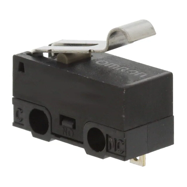

D2F Ultra Subminiature Basic Switch Ultra Subminiature Basic Switch with plenty of terminal variations ● Incorporating a snapping mechanism made with two highly precise split springs that ensures long D 2 F durability. ● Using insertion molded terminals that prevents flux penetration. ● In addition to self-clinching PCB, left-angled, right-angled terminals, 2 types of soldering terminals are available. ● Lineup of 5A type for high load applications. RoHS Compliant Model Number Legend 1 @ 2 @ 3 @ 4 D2F - @ 1. Ratings None : 125 VAC 3A 125 VAC 1A (Low operating force) 01 : 30 VDC 0.1A 5 : 250 VAC 5A 2. Maximum Operating Force (OF) None : 1.47 N {150 gf} F : 0.74 N {75 gf} 4. Terminals None : PCB terminals (Straight) -T : Self-clinching PCB terminals -A : PCB terminals (Right-angled) -A1 : PCB terminals (Left-angled) -D3 : Solder terminals -D : Compact solder terminals Note. The given values are for pin plunger models only. 3. Actuator None : Pin plunger L L2 L3 L30 : Hinge lever : Hinge Roller Lever : Simulated roller lever (R1.3) : Simulated roller lever (R2.5) 1 D2F Ultra Subminiature Basic Switch List of Models Ratings Maximum Operating Force (OF) * Actuator Terminals Pin plunger D 2 F Hinge lever Hinge roller lever Simulated roller lever (R1.3) Simulated roller lever (R2.5) * 3A 1A General Purpose 1.47 N {150 gf} Low Operating Force 0.74 N {75 gf} 0.1 A General Purpose 1.47 N {150 gf} 5A Low Operating Force 0.74 N {75 gf} PCB terminals (Standard) D2F D2F-F D2F-01 D2F-01F Self-clinching PCB terminals D2F-T D2F-F-T D2F-01-T D2F-01F-T PCB terminals (Right-angled) D2F-A D2F-F-A D2F-01-A D2F-01F-A PCB terminals (Left-angled) D2F-A1 D2F-F-A1 D2F-01-A1 D2F-01F-A1 Solder terminals D2F-D3 D2F-F-D3 D2F-01-D3 D2F-01F-D3 Compact solder terminals D2F-D D2F-F-D D2F-01-D D2F-01F-D PCB terminals (Standard) D2F-L D2F-FL D2F-01L D2F-01FL Self-clinching PCB terminals D2F-L-T D2F-FL-T D2F-01L-T D2F-01FL-T PCB terminals (Right-angled) D2F-L-A D2F-FL-A D2F-01L-A D2F-01FL-A PCB terminals (Left-angled) D2F-L-A1 D2F-FL-A1 D2F-01L-A1 D2F-01FL-A1 Solder terminals D2F-L-D3 D2F-FL-D3 D2F-01L-D3 D2F-01FL-D3 Compact solder terminals D2F-L-D D2F-FL-D D2F-01L-D D2F-01FL-D PCB terminals (Standard) D2F-L2 D2F-FL2 D2F-01L2 D2F-01FL2 Self-clinching PCB terminals D2F-L2-T D2F-FL2-T D2F-01L2-T D2F-01FL2-T PCB terminals (Right-angled) D2F-L2-A D2F-FL2-A D2F-01L2-A D2F-01FL2-A PCB terminals (Left-angled) D2F-L2-A1 D2F-FL2-A1 D2F-01L2-A1 D2F-01FL2-A1 Solder terminals D2F-L2-D3 D2F-FL2-D3 D2F-01L2-D3 D2F-01FL2-D3 Compact solder terminals D2F-L2-D D2F-FL2-D D2F-01L2-D D2F-01FL2-D PCB terminals (Standard) D2F-L3 D2F-FL3 D2F-01L3 D2F-01FL3 Self-clinching PCB terminals D2F-L3-T D2F-FL3-T D2F-01L3-T D2F-01FL3-T PCB terminals (Right-angled) D2F-L3-A D2F-FL3-A D2F-01L3-A D2F-01FL3-A PCB terminals (Left-angled) D2F-L3-A1 D2F-FL3-A1 D2F-01L3-A1 D2F-01FL3-A1 Solder terminals D2F-L3-D3 D2F-FL3-D3 D2F-01L3-D3 D2F-01FL3-D3 Compact solder terminals D2F-L3-D D2F-FL3-D D2F-01L3-D D2F-01FL3-D PCB terminals (Standard) D2F-L30 D2F-FL30 D2F-01L30 D2F-01FL30 Self-clinching PCB terminals D2F-L30-T D2F-FL30-T D2F-01L30-T D2F-01FL30-T PCB terminals (Right-angled) D2F-L30-A D2F-FL30-A D2F-01L30-A D2F-01FL30-A PCB terminals (Left-angled) D2F-L30-A1 D2F-FL30-A1 D2F-01L30-A1 D2F-01FL30-A1 Solder terminals D2F-L30-D3 D2F-FL30-D3 D2F-01L30-D3 D2F-01FL30-D3 Compact solder terminals D2F-L30-D D2F-FL30-D D2F-01L30-D D2F-01FL30-D General Purpose 1.47 N {150 gf} D2F-5 - D2F-5L - - D2F-5L3 - - OF are value for Pin plunger. Contact Form Contact Specifications ●SPDT Item Model D2F models D2F-5 models Specifications Contact Material Minimum applicable load (see note) * NO NC * Crossbar Silver alloy Gap (standard value) COM D2F-01 models Gold alloy 0.25 mm 100 mA at 5 VDC 1 mA at 5 VDC Please refer to "Using Micro Loads" in "Precautions" for more information on the minimum applicable load. Ratings Model D2F models D2F-01 models D2F-5 models Maximum Operating 1.47N (General-purpose) 0.74N (Low Operating Force) 1.47N (General-purpose) 0.74N (Low Operating Force) 1.47N (General-purpose) Force (OF) Resistive load Rated voltage 125 VAC 3A 1A - 30 VDC 2A 0.5 A 0.1 A - - 5A 250 VAC - Note. The above rating values apply under the following test conditions. (1) Ambient temperature: 20±2°C (2) Ambient humidity: 65±5% (3) Operating frequency: 30 operations/min Approved Safety Standard The items shown in the "List of Models" above are not standard approved models. Consult your OMRON sales representative for specific models with standard approvals. UL (UL1054) /CSA (CSA C22.2 No.55) Rated voltage 2 D2F (General-purpose) D2F (Low operating force) 125 VAC Model 3A 1A D2F-01 - 30 VDC 2A 0.5 A 0.1 A - D2F Ultra Subminiature Basic Switch Characteristics Model Item D2F models D2F-01 models Pin plunger models: 1 mm to 500 mm/s, Lever models: 5 mm to 500 mm/s Permissible operating speed Pin plunger models: 200 operations/min, Lever models: 100 operations/min Mechanical Permissible operating frequency D2F-5 models 0.74 N (Low operating force) 1.47 N (General-purpose) 1.47 N (General-purpose) Electrical 30 operations/min Insulation resistance 100 MΩ min. (at 500 VDC with insulation tester) Contact resistance (initial value) Dielectric strength Vibration resistance * 1 100 mΩ max. 50 mΩ max. 600 VAC 50/60 Hz for 1min Between current-carrying metal parts and ground 1,500 VAC 50/60 Hz for 1min Between each terminal and non-current-carrying metal parts 1,500 VAC 50/60 Hz for 1min Malfunction 1,000 m/s2 {approx. 100G} max. 300 m/s2 {approx. 30G} max. Malfunction * 1 Mechanical Durability * 2 D 2 F 10 to 55 Hz, 1.5-mm double amplitude Durability Shock resistance 30 mΩ max. Between terminals of the same polarity 1,000,000 operations min. (60 operations/min) 100,000 operations min. (30 operations/min) Electrical 30,000 operations min. (30 operations/min) Degree of protection 10,000 operations min. (30 operations/min) IEC IP40 -40°C to +85°C (at ambient humidity 60% max.) (with no icing or condensation) Ambient operating temperature Ambient operating humidity 85% max. (for +5°C to +35°C) Weight Approx. 0.5 g (pin plunger models) Note. The data given above are initial values. *1. The values are at Free Position and Total Travel Position values for pin plunger, and Total Travel Position value for lever. Close or open circuit of the contact is 1ms max. *2. For testing conditions, consult your OMRON sales representative. Terminals/Appearances (Unit: mm) ●PCB terminals (Straight) ●Self-clinching PCB terminals 5.8±0.15 3-1.2 dia. holes 3.15 6.5±0.1 5.08 5.08 12.8±0.15 1.5 1.5 3.5 3.4 3.15 0.4 0.9 6.5±0.1 5.08 5.08 12.8±0.15 5.8±0.15 ●PCB terminals (Right-angled) 5.08±0.1 12.8±0.15 1.6±0.15 1.5 0.9 0.4±0.05 1.25±0.15 5.8±0.15 ●PCB terminals (Left-angled) 1.5 1.5 2.6±0.2 3.15 6.5±0.1 5.8±0.15 0.9 3.1±0.2 5.08 5.08 12.8±0.15 ●Solder terminals 2.6±0.2 3.15 0.4 1.5 1.5 3.5 3.15 6.5±0.1 5.08 0.9 0.4 5.8±0.15 3.1±0.2 ●Compact solder terminals 2 0.5 6.5±0.1 5.08 5.08 12.8±0.15 3.15 1.2 2.2 0.4 5.8±0.15 5.08 3−0.8 dia. holes 6.5±0.1 5.08 5.08 1.6 2.4 0.4 5.8±0.15 12.8±0.15 12.8±0.15 Mounting Holes (Unit: mm) 2-2 dia. mounting holes 6.5±0.15 3 D2F Ultra Subminiature Basic Switch Dimensions (Unit: mm) /Operating Characteristics The following illustrations and drawings are for D2F models with PCB terminals (straight). Self-clinching, solder, compact solder, and right-angled, left angled terminals are omitted from the following drawings. Refer to the previous page for these terminals. When ordering, replace @ with the code for the terminal that you need. See the "List of Models" for available combinations of models. D 2 F ●Pin Plunger Models D2F-@ D2F-01@ D2F-F@ D2F-01F@ D2F-5 1.2 12.7 dia. 2.2+0.12 0 2+0.12 dia. holes 0 A 5.7 2.9 PT 5.2 5 Operating Characteristics Operating Force Releasing Force OP 2+0.12 0 Model Operating Position D2F-F@ D2F-01F@ OF Max. 1.47 N {150 gf} 0.74 N {75 gf} RF Min. 0.20 N {20 gf} 0.05 N {5 gf} Pretravel PT Max. Overtravel OT Min. Movement Differential MD Max. 0.4 D2F-@ D2F-01@ D2F-5 OP 0.5 mm 0.25 mm 0.12 mm 0.5 mm 0.25 mm 0.12 mm 5.5±0.3 mm 5.8±0.15 ●Hinge Lever Models D2F-L@ D2F-01L@ D2F-FL@ D2F-01FL@ D2F-5L 12.8 (10.8) Operating Characteristics A t=0.3 * 3 Operating Force Releasing Force FP Model OF Max. RF Min. Overtravel OT Min. Movement Differential MD Max. OP Free Position Operating Position FP Max. OP D2F-L@ D2F-01L@ D2F-5L D2F-FL@ D2F-01FL@ 0.78 N {80 gf} 0.05 N {5 gf} 0.25 N {25 gf} 0.02 N {2 gf} 0.55 mm 0.5 mm 0.55 mm 0.5 mm 10 mm 6.8±1.5 mm * Stainless-steel lever ●Simulated Roller Lever Models (R1.3) D2F-L3@ 12.7 D2F-01L3@ (7.5) D2F-FL3@ 10 D2F-01FL3@ R1.3 D2F-5L3 Operating Characteristics A t=0.3 * 2.1 3 Operating Force Releasing Force Model D2F-L3@ D2F-01L3@ D2F-5L3 OF Max. RF Min. Overtravel OT Min. Movement Differential MD Max. FP OP Free Position Operating Position FP Max. OP D2F-FL3@ D2F-01FL3@ 0.78 N {80 gf} 0.05 N {5 gf} 0.39 N {40 gf} 0.02 N {2 gf} 0.5 mm 0.45 mm 0.5 mm 0.45 mm 13 mm 8.5±1.2 mm * Stainless-steel lever ●Simulated Roller Lever Models (R2.5) D2F-L30@ D2F-01L30@ 12.7 D2F-FL30@ D2F-01FL30@ 3.3 t=0.3 * R2.5 A 3 OP FP Operating Characteristics Operating Force Releasing Force Note 1. Unless otherwise specified, a tolerance of ±0.4 mm applies to all dimensions. Note 2. The operating characteristics are for operation in the A direction ( ). 4 OF Max. RF Min. Overtravel OT Min. Movement Differential MD Max. Free Position Operating Position * Stainless-steel lever Model D2F-L30@ D2F-01L30@ FP Max. OP D2F-FL30@ D2F-01FL30@ 0.54 N {55 gf} 0.04 N {4 gf} 0.3 N {31 gf} 0.02 N {2 gf} 0.5 mm 0.5 mm 0.5 mm 0.5 mm 12.6 mm 9.5±1.0 mm D2F Ultra Subminiature Basic Switch ●Hinge Roller Lever Models D2F-L2@ D2F-01L2@ D2F-FL2@ D2F-01FL2@ 12.8 4 (10) A 4.8 dia.×2.8 *2 (4.6) Operating Force Releasing Force OF Max. RF Min. Overtravel OT Min. Movement Differential MD Max. t=0.3 *1 4 Model D2F-L2@ D2F-01L2@ Operating Characteristics FP Free Position Operating Position OP D2F-FL2@ D2F-01FL2@ 0.78 N {80 gf} 0.05 N {5 gf} 0.39 N {40 gf} 0.02 N {2 gf} 0.55 mm 0.5 mm 0.55 mm 0.5 mm FP Max. OP 16.5 mm 13±2 mm D 2 F *1. Stainless-steel lever *2. Polyacetal resin roller Note 1. Unless otherwise specified, a tolerance of ±0.4 mm applies to all dimensions. Note 2. The operating characteristics are for operation in the A direction ( ). Precautions ★Please refer to "Basic Switches Common Precautions" for correct use. Cautions • Terminal connection When soldering, make sure that the temperature of the soldering iron tip is not higher than 300°C, and complete the soldering within 3 seconds. Do not apply any external force for 1 minute after soldering. Soldering at an excessively high temperature or soldering for more than 3 seconds may deteriorate the characteristics of the Switch. • Connecting to PCB terminal Boards When using automatic soldering baths, we recommend soldering at 260°C ±5°C within 5 seconds. Make sure that the liquid surface of the solder does not flow over the edge of the board. When soldering terminals manually, perform soldering within 3 seconds at iron tip temperature not higher than 350°C. Do not apply any external force for at least 1 minute after soldering. When applying solder, keep the solder away from the case of the Switch and do not allow solder or flux to flow into the case. ●Mounting Use M2 mounting screws with plane washers or spring washers to securely mount the Switch. Tighten the screws to a torque of 0.08 to 0.1 N·m {0.8 to 1 kgf·cm}. ●Using Micro Loads Using a model for ordinary loads to open or close the contact of a micro load circuit may result in faulty contact. Use models that operate in the following range. However, even when using micro load models within the following operating range, if inrush current occurs when the contact is opened or closed, it may increase the contact wear and so decrease durability. Therefore, insert a contact protection circuit where necessary. The minimum applicable load is the N-level reference value. This value indicates the malfunction reference level for the reliability level of 60% (λ60). (JIS C5003) The equation, λ60=0.5×10-6/operation, indicates that the 1 estimated malfunction rate is less than operations 2,000,000 with a reliability level of 60%. Voltage (V) ●Soldering Correct Use 30 16.6 mA 100 mA 0.16 mA 24 Operating range for micro load models D2F-01 Operating range for general-load models D2F 12 5 1 mA 0 0.1 1 10 100 1,000 Current (mA) 5 D2F Ultra Subminiature Basic Switch D 2 F • Application examples provided in this document are for reference only. In actual applications, confirm equipment functions and safety before using the product. • Consult your OMRON representative before using the product under conditions which are not described in the manual or applying the product to nuclear control systems, railroad systems, aviation systems, vehicles, combustion systems, medical equipment, amusement machines, safety equipment, and other systems or equipment that may have a serious influence on lives and property if used improperly. Make sure that the ratings and performance characteristics of the product provide a margin of safety for the system or equipment, and be sure to provide the system or equipment with double safety mechanisms. Note: Do not use this document to operate the Unit. OMRON Corporation Electronic and Mechanical Components Company 6 Contact: www.omron.com/ecb Cat. No. B036-E1-12 0318(0207)(O)

物料型号: - D2F系列开关有多种型号,包括D2F-A1、D2F-L3、D2F-L2、D2F-T、D2F-01FL-D3等。
器件简介: - D2F系列是超小型基本开关,采用两个高精度分割弹簧制成的快门机制,确保了长寿命。 - 使用插入成型端子,防止助焊剂渗透。
引脚分配: - 提供了多种端子类型,包括自扣式PCB端子、直角和左角端子,以及两种焊接端子。
参数特性: - 有5A型的高负载应用型号。 - 符合RoHS标准。
功能详解: - 提供了详细的型号编号规则,包括额定值、最大操作力、驱动器类型和端子类型。 - 列出了不同型号的开关的接触形式、材料、间隙、最小适用负载等接触规格。
应用信息: - 强调了正确使用开关的重要性,包括焊接和安装时的注意事项。
封装信息: - 提供了详细的端子/外观尺寸和安装孔尺寸。
