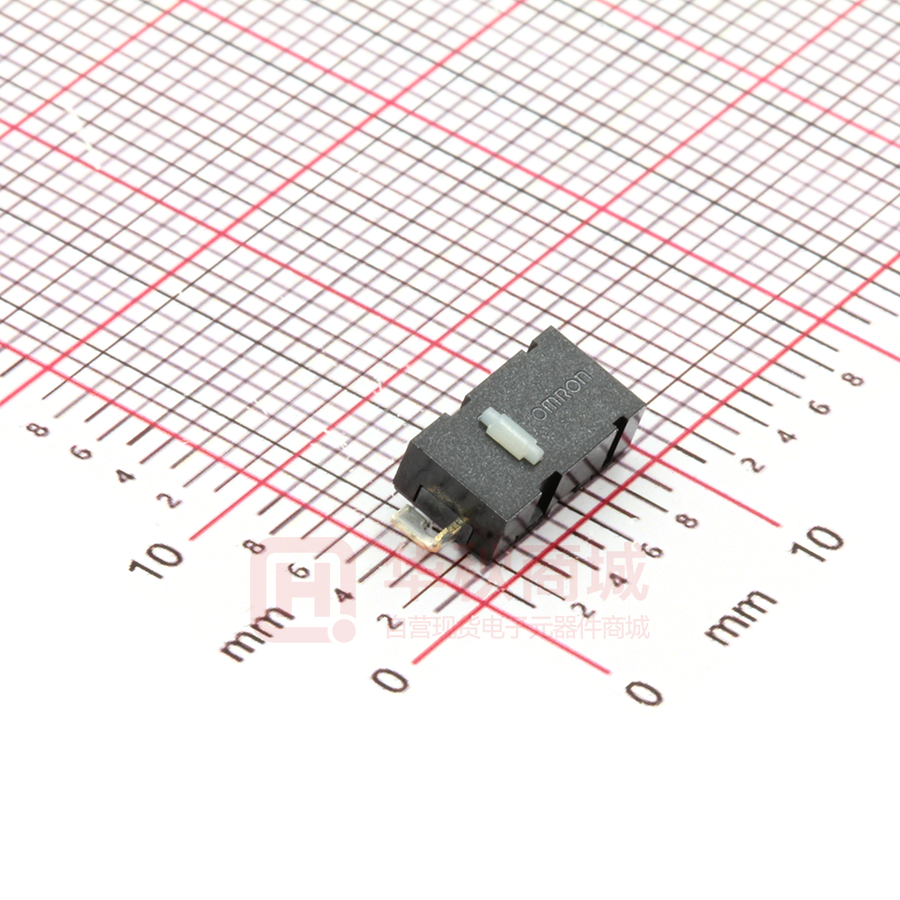

D2LS Ultra Subminiature Basic Switch Compact Surface-mounting Switches ideal for applications requiring long durability High Force type also available · High operating force type also achieving long durability (OF: 1.2 N, Durability: 5,000,000 operations) · Compact size 8.6 × 4.8 × 3.0 mm (W × D × H) contributing to down-sizing of module · Clear click feeling · Embossed taping package for automatic mounting RoHS Compliant Model Number Legend Contact Form D2LS - @ 1 ● SPST-NO Operating Force (OF) 1: 1.2±0.4 N {122±41 gf} COM NO 2: 0.6±0.2 N {61±20 gf} List of Models Contact Specifications Operating Force (OF) Button color Model 1.2 N {122 gf} WHITE D2LS-11 0.6 N {61 gf} BLUE D2LS-21 Minimum packing unit * Contact 2,000 pcs. Specification Crossbar Material Silver Gap (standard value) Minimum applicable load (reference value) * Products are packed with embossed tape. 0.4 mm 3 VDC 15 µA Ratings Rated voltage Resistive load 6 VDC 1 mA Note: The rating values apply under the following test conditions. Ambient temperature: 20 ± 2°C Ambient humidity: 65 ± 5%RH Operating frequency: 30 operations/min Characteristics Operating speed Operatiing frequency 1 mm to 500 mm/s Mechanical/Electrical Insulation resistance 300 operations/min max. 100 MΩ min. (at 500 VDC) Contact resistance (initial value) 100 mΩ max. Dielectric strength Between terminals of same polarity 600 VAC 50/60 Hz 1 min Vibration resistance *1 Malfunction 10 to 55 Hz, 1.5 mm double amplitude Destruction 1,000 m/s2 max. Malfunction 300 m/s2 max. Shock resistance *1 Durability *2 Mechanical/Electrical 5,000,000 operations min. (at 300 ops./min.) Degree of protection IP40 Ambient operating tamperature –25 to +85°C (at 60%RH Max.) (with no icing or condensation) Ambient operation humidity 85%RH max. (for +5 to +35°C) Weight Approx. 0.16 g Note: The data given above are initial values. *1. The values are at Free Position and Total Travel Position values. Close or open circuit of the contact is 1ms max. *2. For testing conditions, consult your OMRON sales representative. 1 D2LS Ultra Subminiature Basic Switch Dimensions (Unit: mm) / Operating Characteristics D2LS-11 D2LS-21 NO terminal 1 PCB pad dimensions (reference) (TOP VIEW) COM terminal 1.4 2.25 11.8 8.8 8.6±0.15 11.2±0.2 2.7 1.7 1 OP 3 FP 1.6 2.2 4.8±0.15 3.16±0.2 4±0.1 +0.05 dia. 0 1.1 0.6 0.95±0.05 dia. 0.05±0.05 4±0.1 Model D2LS-11 D2LS-21 1.2 ± 0.4 N {122 ± 41 gf} 0.15 N {15 gf} 0.6 ± 0.2 N {61 ± 20 gf} 0.15 N {15 gf} Operating Characteristics Operating Force Releasing Force OF RF min. Overtravel OT min. Movement Differential MD max. Operating Position Free Position 0.1 mm 0.12 mm 3.2 ± 0.2 mm 3.5 ± 0.2 mm OP FP Note:Unless otherwise specified, a tolerance of ±0.4 mm applies to all dimensions. Packaging Specifications (Unit: mm) 8±0.1 4±0.1 29.4 2 (5.10) 1.75 -0.1 Reel 1.5 0 dia. (11.5) 24 Drawing direction 13.2 dia. Standard package Qty: 2,000 pcs./reel 2 380 dia. D2LS Ultra Subminiature Basic Switch Precautions Refer to General Information. Cautions Use the Switch within the rated voltage and current ranges, otherwise the Switch may have a shortened durability, radiate heat, or burn out. This particularly applies to the instantaneous voltages and currents when switching. · Manual Soldering Soldering temperature: 350°C max. at the tip of the soldering iron Soldering time: 3 s max. ● Washing The Switch is not sealed, and cannot be washed. Doing so will cause the washing agent, together with flux or dust particles on the PCB, to enter the Switch, resulting in malfunction. Correct Use ● Soldering · General Precautions Before soldering the Switch on a multilayer PCB, test to confirm that soldering can be performed properly. Otherwise the Switch may be deformed by the soldering heat on the pattern or lands of the multilayer PCB. Do not solder the Switch more than twice, including rectification soldering. An interval of five minutes is required between the first and the second soldering. ● Application Environment Do not use the Switch in locations that are subject to toxic gas, silicon, excessive dust, excessive dirt, high temperatures, high humidity, sudden temperature changes, water splashes, or oil splashes. Otherwise, damage resulting by faulty contact of the Switch contacts, corrosion, or other causes, or other functional faults may occur. · Reflow Soldering (Surface Mounting) Solder the terminals within the heating curve shown in the following diagram. The peak temperature may vary depending on the reflow bath used. Confirm the conditions beforehand. 255˚C 3 sec max. 255˚C 220˚C 190˚C 150˚C 60 to 120 s 45 to 75 s • Application examples provided in this document are for reference only. In actual applications, confirm equipment functions and safety before using the product. • Consult your OMRON representative before using the product under conditions which are not described in the manual or applying the product to nuclear control systems, railroad systems, aviation systems, vehicles, combustion systems, medical equipment, amusement machines, safety equipment, and other systems or equipment that may have a serious influence on lives and property if used improperly. Make sure that the ratings and performance characteristics of the product provide a margin of safety for the system or equipment, and be sure to provide the system or equipment with double safety mechanisms. Note: Do not use this document to operate the Unit. OMRON Corporation Electronic and Mechanical Components Company Contact: www.omron.com/ecb Cat. No. B122-E1-02 1014(1213) 3
