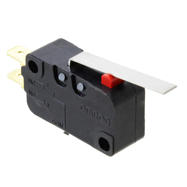

D3V Miniature Basic Switch Reliable Basic Switch with External Lever ● Available by 21 A, 16 A, 11 A, 6 A and 0.1 A models, all with self-cleaning contacts. ● Available with internally or externally fitted D 3 V levers. RoHS Compliant Model Number Legend 1 D 3 V- @ 1. Ratings 21 : 20 (4) A at 250 VAC 16 : 16 (3) A at 250 VAC 11 : 11 (3) A at 250 VAC 6 : 16 (2) A at 250 VAC 01 : 0.1 A at 125 VAC 2. Contact Gap None : 1 mm (F gap) G : 0.5 mm (G gap) 3. Actuator None : Pin plunger 1 : Short hinge lever 2 : Hinge lever 3 : Long hinge lever 4 : Simulated roller lever 5 : Short hinge roller lever 6 : Hinge roller lever 4. Hinge Position None : Internal/Far from plunger 8.1 2 @ 3 @ 4 -@ 5 @ 6 @ 7 -@ 8 -@ 9 @ 5. Contact Form 1 : SPDT 2 : SPST-NC 3 : SPST-NO 6. Terminals A : Solder terminals C2 : Quick-connect terminals (#187) C : Quick-connect terminals (#250) 7. Maximum Operating Force 5 : 1.96 N {200 gf} 4A : 1.23 N {125 gf} 4 : 0.98 N {100 gf} 3 : 0.49 N {50 gf} 2 : 0.25 N {25 gf} Note. These values are for the pin plunger models. 8. Mounting Hole Size None : 3.1 mm K : 2.9 mm 9. Special Code None : Standard H : High temperature (125°C) (See note) E : Special rating: 21 (8) A Note. Consult your OMRON sales representative for high temperature models. K : External/Near plunger 14.3 1 D3V Miniature Basic Switch List of Models ●21 A (OF: 1.23 N {125 gf}) Ratings Contact gap Actuators Pin plunger Contact form Terminals Maximum operating force (OF) D3V-21G-1C4A SPDT SPDT-NC Quick-connect terminals (#250) (C) - 1.23 N {125 gf} - SPDT-NO Short hinge lever SPDT-NC D 3 V D3V-21G1-1C4A SPDT - 1.23 N {125 gf} - SPDT-NO Hinge lever SPDT SPDT-NC D3V-21G2-1C4A - 0.78 N {80 gf} - SPDT-NO Long hinge lever 21 A 0.5 mm (G gap) SPDT SPDT-NC D3V-21G3-1C4A - 0.44 N {45 gf} - SPDT-NO Simulated roller lever SPDT SPDT-NC D3V-21G4-1C4A - 0.83 N {85 gf} - SPDT-NO Short hinge roller lever SPDT SPDT-NC D3V-21G5-1C4A - 1.42 N {145 gf} - SPDT-NO Hinge roller lever D3V-21G6-1C4A SPDT SPDT-NC - 0.79 N {80 gf} - SPDT-NO Note. If you need mounting hole 2.9 mm, add "-K" at last of model. Consult your OMRON sales representative when you can't find a model on this List of Models. ●16 A (OF: 1.96 N {200 gf}) Ratings Contact gap Actuators Pin plunger Contact form SPDT D3V-16-1C5 D3V-16-2C25 D3V-16-2C5 SPDT-NO D3V-16-3A5 D3V-16-3C25 D3V-16-3C5 SPDT D3V-161-1A5 D3V-161-1C25 D3V-161-1C5 D3V-161-2A5 D3V-161-2C25 D3V-161-2C5 D3V-161-3A5 D3V-161-3C25 D3V-161-3C5 D3V-162-1A5 D3V-162-1C25 D3V-162-1C5 D3V-162-2A5 D3V-162-2C25 D3V-162-2C5 1.96 N {200 gf} SPDT SPDT-NC 16 A 1 mm (F gap) 1.23 N {125 gf} SPDT-NO D3V-162-3A5 D3V-162-3C25 D3V-162-3C5 SPDT D3V-163-1A5 D3V-163-1C25 D3V-163-1C5 SPDT-NC Simulated roller lever D3V-163-2A5 D3V-163-2C25 D3V-163-2C5 SPDT-NO D3V-163-3A5 D3V-163-3C25 D3V-163-3C5 SPDT D3V-164-1A5 D3V-164-1C25 D3V-164-1C5 SPDT-NC 0.69 N {70 gf} 1.23 N {125 gf} SPDT-NO Short hinge roller lever SPDT SPDT-NC 2.35 N {240 gf} SPDT-NO Hinge roller lever SPDT SPDT-NC SPDT-NO 1.23 N {125 gf} D3V-164-2A5 D3V-164-2C25 D3V-164-2C5 D3V-164-3A5 D3V-164-3C25 D3V-164-3C5 D3V-165-1A5 D3V-165-1C25 D3V-165-1C5 D3V-165-2A5 D3V-165-2C25 D3V-165-2C5 D3V-165-3A5 D3V-165-3C25 D3V-165-3C5 D3V-166-1A5 D3V-166-1C25 D3V-166-1C5 D3V-166-2A5 D3V-166-2C25 D3V-166-2C5 D3V-166-3A5 D3V-166-3C25 D3V-166-3C5 Note. If you need mounting hole 2.9 mm, add "-K" at last of model. Consult your OMRON sales representative when you can't find a model on this List of Models. 2 Quick-connect terminals (#250) (C) D3V-16-1C25 1.96 N {200 gf} SPDT-NO Long hinge lever Quick-connect terminals (#187) (C2) D3V-16-2A5 SPDT-NC Hinge lever Solder terminals (A) D3V-16-1A5 SPDT-NC Short hinge lever Terminals Maximum operating force (OF) D3V Miniature Basic Switch ●11 A (OF: 1.96 N {200 gf}) Ratings Contact gap Actuators Pin plunger Contact form Terminals Maximum operating force (OF) D3V-11-1A5 SPDT SPDT-NC Solder terminals (A) - 1.96N {200 gf} - SPDT-NO Short hinge lever D3V-111-1A5 SPDT SPDT-NC 1.96N {200 gf} SPDT-NO Hinge lever SPDT SPDT-NC Long hinge lever 11 A 1 mm (F gap) SPDT-NC 0.69N {70 gf} Simulated roller lever SPDT SPDT-NC SPDT-NO Short hinge roller lever SPDT SPDT-NC SPDT-NO Hinge roller lever D3V-112-1C25 D3V-113-1C25 D3V-113-1C5 - - - - - D3V-114-1C25 D3V-114-1C5 - - - - - - D3V-115-1C25 D3V-115-1C5 - - - - - - D3V-116-1C25 D3V-116-1C5 - - - - - - Solder terminals (A) Quick-connect terminals (#187) (C2) Quick-connect terminals (#250) (C) 1.23N {125 gf} SPDT-NO D 3 V D3V-112-1C5 - D3V-116-1A5 SPDT SPDT-NC - D3V-115-1A5 2.35N {240 gf} D3V-111-1C5 - D3V-114-1A5 1.23N {125 gf} - - D3V-113-1A5 SPDT-NO D3V-111-1C25 D3V-11-1C5 - - SPDT - - - SPDT-NO D3V-11-1C25 Quick-connect terminals (#250) (C) D3V-112-1A5 1.23N {125 gf} Quick-connect terminals (#187) (C2) Note. If you need mounting hole 2.9 mm, add "-K" at last of model. Consult your OMRON sales representative when you can't find a model on this List of Models. ●11 A (OF: 0.98 N {100 gf}) Ratings Contact gap Actuators Pin plunger Contact form Terminals Maximum operating force (OF) SPDT SPDT-NC D3V-11-1A4 0.98N {100 gf} SPDT-NO Short hinge lever SPDT SPDT-NC SPDT-NO Hinge lever SPDT SPDT-NC SPDT-NO Long hinge lever 11 A 1 mm (F gap) 0.34N {35 gf} SPDT-NO Simulated roller lever 0.59N {60 gf} SPDT-NO Short hinge roller lever SPDT SPDT-NC SPDT-NC - - - D3V-112-1C4 - - - - - D3V-113-1C24 D3V-113-1C4 - - - - - - D3V-114-1C24 D3V-114-1C4 - - - - - - D3V-116-1A4 0.59N {60 gf} D3V-112-1C24 - - SPDT-NO D3V-111-1C4 - - SPDT D3V-111-1C24 - D3V-115-1A4 1.18N {120 gf} SPDT-NO Hinge roller lever - D3V-114-1A4 SPDT SPDT-NC - D3V-113-1A4 SPDT SPDT-NC - D3V-112-1A4 0.59N {60 gf} D3V-11-1C4 D3V-111-1A4 0.98N {100 gf} D3V-11-1C24 D3V-115-1C24 D3V-116-1C24 D3V-115-1C4 D3V-116-1C4 - - - - - - Note. If you need mounting hole 2.9 mm, add "-K" at last of model. Consult your OMRON sales representative when you can't find a model on this List of Models. 3 D3V Miniature Basic Switch ●6 A (OF: 0.98 N {100 gf}) Ratings Contact gap Actuators Pin plunger Contact form Terminals Maximum operating force (OF) D3V-6-1A4 SPDT SPDT-NC Solder terminals (A) - 0.98 N {100 gf} - SPDT-NO Short hinge lever SPDT-NC D 3 V D3V-61-1A4 SPDT 0.98 N {100 gf} SPDT-NO Hinge lever SPDT SPDT-NC Long hinge lever 6A 1 mm (F gap) SPDT-NC 0.34 N {35 gf} Simulated roller lever SPDT SPDT-NC SPDT-NO Short hinge roller lever SPDT SPDT-NC SPDT-NO Hinge roller lever D3V-62-1C24 D3V-63-1C24 D3V-62-1C4 D3V-63-1C4 - - - - - - D3V-64-1C24 D3V-64-1C4 - - - - - - D3V-65-1C24 D3V-65-1C4 - - - - - - D3V-66-1A4 SPDT SPDT-NC - D3V-65-1A4 1.18 N {120 gf} D3V-61-1C4 - D3V-64-1A4 0.59 N {60 gf} - - D3V-63-1A4 SPDT-NO D3V-61-1C24 D3V-6-1C4 - - SPDT - - - SPDT-NO D3V-6-1C24 Quick-connect terminals (#250) (C) D3V-62-1A4 0.59 N {60 gf} Quick-connect terminals (#187) (C2) D3V-66-1C24 D3V-66-1C4 - - - - - - Solder terminals (A) Quick-connect terminals (#187) (C2) Quick-connect terminals (#250) (C) 0.59 N {60 gf} SPDT-NO ●6 A (OF: 0.49 N {50 gf}) Ratings Contact gap Actuators Pin plunger Contact form Terminals Maximum operating force (OF) SPDT SPDT-NC D3V-6G-1A3 - 0.49 N {50 gf} - SPDT-NO Short hinge lever D3V-6G1-1A3 SPDT SPDT-NC 0.49 N {50 gf} SPDT-NO Hinge lever Long hinge lever 6A 0.5 mm Ggap) SPDT SPDT-NC 0.20 N {20 gf} Simulated roller lever SPDT SPDT-NC SPDT-NO Short hinge roller lever SPDT SPDT-NC 0.29 N {30 gf} SPDT-NO Note. If you need mounting hole 2.9 mm, add "-K" at last of model. Consult your OMRON sales representative when you can't find a model on this List of Models. 4 D3V-6G3-1C23 D3V-6G2-1C3 D3V-6G3-1C3 - - - - - D3V-6G4-1C23 D3V-6G4-1C3 - - - - - - D3V-6G5-1C23 D3V-6G5-1C3 - - - - - - D3V-6G6-1A3 SPDT SPDT-NC D3V-6G2-1C23 - D3V-6G5-1A3 0.59 N {60 gf} SPDT-NO Hinge roller lever - D3V-6G4-1A3 0.29 N {30 gf} D3V-6G1-1C3 - D3V-6G3-1A3 SPDT-NO - - - SPDT-NO D3V-6G1-1C23 D3V-6G-1C3 - - 0.59 N {60 gf} - D3V-6G2-1A3 SPDT SPDT-NC D3V-6G-1C23 D3V-6G6-1C23 D3V-6G6-1C3 - - - - - - D3V Miniature Basic Switch ●0.1 A (OF: 0.49 N {50 gf}) Ratings Contact gap Actuators Pin plunger Contact form Terminals Maximum operating force (OF) SPDT SPDT-NC 0.49 N {50 gf} D3V-01-1A3 D3V-01-1C23 D3V-01-1C3 D3V-01-2A3 D3V-01-2C23 D3V-01-2C3 D3V-01-3A3 D3V-01-3C23 D3V-01-3C3 SPDT D3V-011-1A3 D3V-011-1C23 D3V-011-1C3 D3V-011-2A3 D3V-011-2C23 D3V-011-2C3 D3V-011-3A3 D3V-011-3C23 D3V-011-3C3 SPDT-NC 0.49 N {50 gf} SPDT-NO Hinge lever SPDT SPDT-NC 0.59 N {60 gf} SPDT-NO Long hinge lever 1 mm (F gap) Quick-connect terminals (#250) (C) SPDT-NO Short hinge lever 0.1 A Quick-connect terminals (#187) (C2) Solder terminals (A) SPDT SPDT-NC 0.20 N {20 gf} D3V-012-1A3 D3V-012-1C23 D3V-012-1C3 D3V-012-2A3 D3V-012-2C23 D3V-012-2C3 D3V-012-3A3 D3V-012-3C23 D3V-012-3C3 D3V-013-1A3 D3V-013-1C23 D3V-013-1C3 D3V-013-2A3 D3V-013-2C23 D3V-013-2C3 SPDT-NO D3V-013-3A3 D3V-013-3C23 D3V-013-3C3 SPDT D3V-014-1A3 D3V-014-1C23 D3V-014-1C3 D3V-014-2A3 D3V-014-2C23 D3V-014-2C3 Simulated roller lever SPDT-NC 0.29 N {30 gf} SPDT-NO D3V-014-3A3 D3V-014-3C23 D3V-014-3C3 SPDT D3V-015-1A3 D3V-015-1C23 D3V-015-1C3 D3V-015-2C3 Short hinge roller lever D3V-015-2A3 D3V-015-2C23 SPDT-NO SPDT-NC D3V-015-3A3 D3V-015-3C23 D3V-015-3C3 SPDT D3V-016-1A3 D3V-016-1C23 D3V-016-1C3 D3V-016-2A3 D3V-016-2C23 D3V-016-2C3 D3V-016-3A3 D3V-016-3C23 D3V-016-3C3 Hinge roller lever 0.59 N {60 gf} SPDT-NC 0.29 N {30 gf} SPDT-NO D 3 V Note. If you need mounting hole 2.9 mm, add "-K" at last of model. Consult your OMRON sales representative when you can't find a model on this List of Models. Contact Form ●SPDT ●SPST-NC ●SPST-NO NC NO NC NO COM COM COM Contact Specifications Item Model D3V-21 D3V-16 D3V-11 Specification Contact Material Gap (standard value) Inrush current NC NO Minimum applicable load (see note) 0.5 mm 50 A max. D3V-6 Crossbar Silver alloy Gold alloy 1.0 mm (F gap) or 0.5 mm (G gap) 40 A max. D3V-01 Rivet 24 A max. 160 mA at 5 VDC 1.0 mm 15 A max. --1 mA at 5 VDC Note. For more information on the minimum applicable load, refer to Using Micro Loads on page 11. 5 D3V Miniature Basic Switch Ratings Item Model D3V-21 D3V-16 D 3 V Resistive load Rated voltage D3V-11 D3V-6 D3V-01 250 VAC 21 A 125 VDC 0.6 A 250 VDC 0.3 A 250 VAC 16 A 125 VDC 0.6 A 250 VDC 0.3 A 250 VAC 11 A 125 VDC 0.6 A 250 VDC 0.3 A 250 VAC 6A 125 VDC 0.4 A 250 VDC 0.3 A 125 VAC 0.1 A 30 VDC 0.1 A Note 1. The above current values are the normal current values of models with a contact gap of 1 mm (gap F), which vary with the normal current values of models with a contact gap of 0.5 mm (gap G). Note 2. The ratings values apply under the following test conditions: Ambient temperature: 20±2°C Ambient humidity: 65±5% Operating frequency: 30 operations/min Approved Safety Standards Consult your OMRON sales representative for specific models with standard approvals. UL (UL61058-1)/cUL (CSA C22.2 No. 61058-1) Rated voltage D3V-21G D3V-16 D3V-16G D3V-11 D3V-11G D3V-6 D3V-6G D3V-01 125 VAC Model --- 16 A, 1/2 HP 16 A, 1/2 HP 11 A, 1/2 HP 11 A, 1/2 HP 6 A, 1/4 HP 6 A, 1/4 HP 0.1 A 250 VAC 20.1 A 16 A, 1/2 HP 16 A, 1/2 HP 11 A, 1/2 HP 11 A, 1/2 HP 6 A, 1/4 HP 6 A, 1/4 HP --- 125 VDC --- 0.6 A 0.1 A 0.6 A 0.1 A --- --- --- 250 VDC --- 0.3 A --- 0.3 A --- --- --- --- VDE (EN 61058-1) Rated voltage Model D3V-21G D3V-16 D3V-11 D3V-6 D3V-01 125 VAC --- --- --- --- 0.1 A 250 VAC 20 (4) A 16 (3) A 11 (3) A 6 (2) A --- Testing conditions: 5E4 (50,000 operations), T85 (0 to 85°C) for D3V-21/D3V-01, T105 (0 to 105°C) for D3V-16/D3V-11/D3V-6 Rated voltage 250 VAC Model D3V-21G 21 (8) A Testing conditions: 10,000 operations, T85 (0 to 85°C) 6 D3V Miniature Basic Switch Characteristics Item Model D3V-21 D3V-16 Permissible operating speed D3V-11 D3V-6 D3V-01 0.1 mm to 1 m/s (pin plunger models) Mechanical: 600 operations/min max. Electrical: 30 operations/min max. Permissible operating frequency Insulation resistance 100 MΩ min. (at 500 VDC with insulation tester) Contact resistance (initial values) 50 mΩ max. 0.49N {50 gf}: 50 mΩ max. 0.25N {25 gf}: 100 mΩ max. 30 mΩ max. 1,000 VAC, 50/60 Hz for 1 min between terminals of the same polarity Dielectric strength (see note 2) 2,000 VAC, 50/60 Hz for 1 min between current-carrying metal parts and ground, and between each terminal and noncurrent-carrying metal parts Vibration resistance (see note 3) Malfunction: 10 to 55 Hz, 1.5-mm double amplitude Destruction: 400 m/s2 {approx. 40 G} max. Malfunction: 100 m/s2 {approx. 10 G} max. Shock resistance (see note 3) Durability (see note 4) Mechanical 10,000,000 operations min. Electrical 50,000 operations min. 100,000 operations min. 200,000 operations min. Degree of protection 500,000 operations min. IEC IP40 Degree of protection against electric shock Ambient operating temperature Class I –25 to +85°C (at ambient humidity of 60% max.) (with no icing or condensation) –25 to +85°C (at ambient humidity of 60% max.) (with no icing or condensation) –25 to +105°C (at ambient humidity of 60% max.) (with no icing or condensation) Ambient operating humidity 85% max. (for +5 to +35°C) Weight Approx. 6.2 g (pin plunger models) Note 1. The data given above are initial values. Note 2. The dielectric strength values shown in the table are for models with a Separator. Note 3. For the pin plunger models, the above values apply for use at both the free position and total travel position. For the lever models, they apply at the total travel position. Note 4. For testing conditions, contact your OMRON sales representative. Terminals/Appearances (Unit: mm) Solder Terminals (A) (5.5) (6.5) 2.9 t = 0.5 (10) Three, solder terminals 6.35 3.2 (see note) Quick-connect Terminals (#187) (C2) Quick-connect Terminals (#250) (C) (4.9) (5.5) (7.7) (6.5) 3.2 2.9 t = 0.5 (10) Three, quick-connect terminals (#187) (12.0) t = 0.8 Three, quick-connect terminals (#250) 8 6.35 3.2 3.95 4.75±0.1 4.75±0.1 2.4 dia. 1.6 dia. Note: Indicates the length to the center of the 1.6-dia. holes 6.35±0.1 1.6-dia. terminal hole 1.65-dia. terminal hole Note. The table below is for the SPDT contact specifications. Two terminals will be available for SPST-NO or SPST-NC contact specifications. For terminal positions, refer to Contact Form on page 5. Mounting Holes (Unit: mm) Two, 3.1-dia. mounting holes or M3 screw holes 10.3±0.1 22.2±0.1 7 D 3 V D3V Miniature Basic Switch Dimensions (Unit: mm) and Operating Characteristics The following illustrations and drawings are for quick-connect terminals (#187) (terminals C2). D3V models incorporate terminals A and C. These models are different from #187 models in terminal size only. Terminals A and C are omitted from the following drawings. Refer to "Terminals/Appearances" on page 7 for these terminals. The @ in the model number is for the terminal code. ●Pin Plunger Models D3V-21G-1C4A D3V-16-1@5 D3V-11-1@5 D3V-11-1@4 D3V-6-1@4 D D3V-6G-1@3 3 V D3V-01-1@3 A t=0.5 Three, quick-connect terminals (#187) Model Operating Characteristics Operating Force Releasing Force D3V-21G-1C4A D3V-16-1@5 D3V-11-1@5 D3V-11-1@4 D3V-6-1@4 1.96 N {200 gf} 0.49 N {50 gf} 0.98 N {100 gf} 0.15 N {15 gf} OF RF Max. Min. 1.23 N {125 gf} 0.20 N {20 gf} Pretravel PT Overtravel OT Movement Differential MD Max. Min. Max. 1.2 mm 1.0 mm 0.3 mm Operating Position Model 10.3±0.1 15.9 7.2 D3V-161-1@5 D3V-111-1@5 D3V-111-1@4 D3V-61-1@4 1.96 N {200 gf} 0.49 N {50 gf} 0.98 N {100 gf} 0.15 N {15 gf} Max. Min. Max. 1.6 mm 0.8 mm 0.5 mm D3V-6G1-1@3 OP D3V-011-1@3 0.49 N {50 gf} 0.05 N {5 gf} 1.6 mm 0.8 mm 0.6 mm 1.6 mm 0.8 mm 0.5 mm 1.6 mm 0.8 mm 0.6 mm 15.2±0.5 mm ●Hinge Lever Models D3V-21G2-1C4A D3V-162-1@5 D3V-112-1@5 D3V-112-1@4 D3V-62-1@4 D3V-6G2-1@3 D3V-012-1@3 A 35.6±0.8 3.1+0.13 −0.03 dia. hole 1.6 0.7 Model Operating Characteristics D3V-21G2-1C4A OF RF Max. Min. 0.78 N {80 gf} 0.06 N {6 gf} Pretravel PT Overtravel OT Movement Differential MD Max. Min. Max. 4.0 mm 1.6 mm 0.8 mm PT 8.1 2.8 4 18.8 2.85 4.2 t=0.5 10.3±0.1 15.9 7.2 t=0.5 Three, #187 series tab 2.8 (10) 3.4±0.15 dia. hole 22.2±0.1 27.8 37.8±0.8 D3V-162-1@5 D3V-112-1@5 OP 3.1+0.13 −0.03 D3V-112-1@4 D3V-62-1@4 1.23 N {125 gf} 0.14 N {14 gf} Note 1. Unless otherwise specified, a tolerance of ±0.4 mm applies to all dimensions. Note 2. The operating characteristics are for operation in the A direction ( ). 8 10.3 D3V-21G1-1C4A Pretravel PT Overtravel OT Movement Differential MD OP 3.1+0.13 −0.03 3.4±0.15 dia. hole 22.2±0.1 27.8 37.8±0.8 2.8 (10) t=0.5 Three, #187 series tab 1.23 N {125 gf} 0.20 N {20 gf} 4.2 2.8 4 18.7 2.85 PT t=0.5 8.1 0.7 Max. Min. Operating Position A 22.1 3.1+0.13 −0.03 dia. hole 1.6 OF RF Operating Force Releasing Force 1.2 mm 1.0 mm 0.4 mm 1.2 mm 1.0 mm 0.3 mm 14.7±0.4 mm Operating Characteristics Operating Position D3V-01-1@3 0.49 N {50 gf} 0.05 N {5 gf} 1.2 mm 1.0 mm 0.4 mm OP ●Short Hinge Lever Models D3V-21G1-1C4A D3V-161-1@5 D3V-111-1@5 D3V-111-1@4 D3V-61-1@4 D3V-6G1-1@3 D3V-011-1@3 Operating Force Releasing Force D3V-6G-1@3 OP 10.3 D3V-6G2-1@3 0.59 N {60 gf} 0.06 N {6 gf} 4.0 mm 1.6 mm 1.5 mm 0.29 N {30 gf} --4.0 mm 1.6 mm 0.8 mm 15.2±1.2 mm D3V-012-1@3 4.0 mm 1.6 mm 1.5 mm D3V Miniature Basic Switch ●Long Hinge Lever Models D3V-21G3-1C4A D3V-163-1@5 D3V-113-1@5 D3V-113-1@4 D3V-63-1@4 D3V-6G3-1@3 D3V-013-1@3 A 3.1+0.13 −0.03 dia. hole 59.4±0.8 1.6 8.1 0.7 2.85 4.2 PT t=0.5 2.8 4 15.9 7.2 18.7 10.3±0.1 OP +0.13 2.8 (10) t=0.5 Three, #187 series tab 3.1−0.03 3.4±0.15 dia. hole 22.2±0.1 27.8 10.3 D 3 V 37.8±0.8 Model Operating Characteristics Operating Force Releasing Force D3V-21G3-1C4A OF RF Max. Min. 0.44 N {45 gf} 0.03 N {3 gf} Pretravel PT Overtravel OT Movement Differential MD Max. Min. Max. 9.0 mm 2.0 mm 2.0 mm Operating Position D3V-163-1@5 D3V-113-1@5 0.69 N {70 gf} 0.06 N {6 gf} Model Operating Characteristics 9.0 mm 3.2 mm 2.8 mm 9.0 mm 3.2 mm 2.0 mm 15.2±2.6 mm A +0.13 3.1−0.03 dia. hole 1.6 PT 2.8 4 18.8 D3V-21G4-1C4A 0.83 N {85 gf} 0.07 N {7 gf} Pretravel PT Overtravel OT Movement Differential MD Max. Min. Max. 4.0 mm 1.6 mm 1.4 mm 2.85 4.2 t=0.5 8.1 0.7 Max. Min. 10.3±0.1 15.9 7.2 2.8 (10) 3.4±0.15 dia. hole OP 3.1+0.13 −0.03 10.3 22.2±0.1 27.8 37.8±0.8 D3V-164-1@5 D3V-114-1@5 D3V-114-1@4 D3V-64-1@4 1.23 N {125 gf} 0.14 N {14 gf} D3V-6G4-1@3 0.59 N {60 gf} 0.06 N {6 gf} OP D3V-014-1@3 0.29 N {30 gf} --4.0 mm 1.6 mm 1.5 mm 4.0 mm 1.6 mm 1.4 mm 4.0 mm 1.6 mm 1.5 mm 18.7±1.2 mm ●Short Hinge Roller Lever Models D3V-21G5-1C4A D3V-165-1@5 D3V-115-1@5 D3V-115-1@4 D3V-65-1@4 D3V-6G5-1@3 D3V-015-1@3 A +0.13 3.1−0.03 20.1±0.8 Model Operating Characteristics PT dia. hole 1.6 8.1 0.7 4.8 2.8 OP 10.3±0.1 4 2.8 (10) 3.4±0.15 dia. hole 22.2±0.1 27.8 37.8±0.8 3.1+0.13 −0.03 D3V-21G5-1C4A D3V-165-1@5 D3V-115-1@5 D3V-115-1@4 D3V-65-1@4 2.35 N {240 gf} 0.49 N {50 gf} 1.18 N {120 gf} 0.15 N {15 gf} OF RF Max. Min. 1.42 N {145 gf} 0.2 N {20 gf} Pretravel PT Overtravel OT Movement Differential MD Max. Min. Max. 1.6 mm 0.8 mm 0.5 mm 5.1 t=0.5 15.9 7.2 18.8 t=0.5 Three, #187 series tab Operating Position D3V-013-1@3 0.20 N {20 gf} --- 32.5±0.8 OF RF Operating Force Releasing Force 0.34 N {35 gf} --- +2.6 15.2 −3.2 mm OP t=0.5 Three, #187 series tab Operating Position D3V-6G3-1@3 9.0 mm 2.0 mm 2.8 mm ●Simulated Roller Lever Models D3V-21G4-1C4A D3V-164-1@5 D3V-114-1@5 D3V-114-1@4 D3V-64-1@4 D3V-6G4-1@3 D3V-014-1@3 Operating Force Releasing Force D3V-113-1@4 D3V-63-1@4 OP 1.6 mm 0.8 mm 0.6 mm 10.3 D3V-6G5-1@3 D3V-015-1@3 0.59 N {60 gf} 0.06 N {6 gf} 1.6 mm 0.8 mm 0.5 mm 1.6 mm 0.8 mm 0.6 mm 20.7±0.6 mm Note 1. Unless otherwise specified, a tolerance of ±0.4 mm applies to all dimensions. Note 2. The operating characteristics are for operation in the A direction ( ). 9 D3V Miniature Basic Switch ●Hinge Roller Lever Models D3V-21G6-1C4A D3V-166-1@5 D3V-116-1@5 D3V-116-1@4 D3V-66-1@4 D3V-6G6-1@3 D3V-016-1@3 A 33.0±0.8 +0.13 3.1−0.03 dia. hole 8.1 Model Operating Characteristics Operating Force Releasing Force 2.8 OP 10.3±0.1 15.9 7.2 18.7 +0.13 D3V-21G6-1C4A Max. Min. 0.79 N {80 gf} 0.05 N {5 gf} Pretravel PT Overtravel OT Movement Differential MD Max. Min. Max. 4.0 mm 1.6 mm 0.8 mm 2.8 (10) D3V-166-1@5 D3V-116-1@5 OP 3.4±0.15 dia. hole 3.1−0.03 10.3 22.2±0.1 27.8 37.8±0.8 D3V-116-1@4 D3V-66-1@4 1.23 N {125 gf} 0.14 N {14 gf} Note 1. Unless otherwise specified, a tolerance of ±0.4 mm applies to all dimensions. Note 2. The operating characteristics are for operation in the A direction ( ). 10 4.8 0.7 OF RF Operating Position 5.1 PT t=0.5 4 t=0.5 Three, #187 series tab D 3 V 1.6 D3V-6G6-1@3 0.59 N {60 gf} 0.06 N {6 gf} 0.29 N {30 gf} --4.0 mm 1.6 mm 0.8 mm 4.0 mm 1.6 mm 1.5 mm 20.7±1.2 mm D3V-016-1@3 4.0 mm 1.6 mm 1.5 mm D3V Miniature Basic Switch Precautions ★Please refer to "Common Precautions" for correct use. Cautions ●Handling Be careful not to drop the switch. Doing so may cause damage to the switch's internal components because it is designed for a small load. Correct Use D 3 V ●Using Micro Loads Use two M3 mounting screws with an appropriate screwdriver to mount the switch. Tighten the screws to a torque of 0.39 to 0.59 N·m {4 to 6 kgf·cm}. Using a model for ordinary loads to open or close the contact of a micro load circuit may result faulty contact. Use models that operate in the following range. However, even when using micro load models within the operating range shown below, if inrush current occurs when the contact is opened or closed, it may increase contact wear and so decrease durability. Therefore, insert a contact protection circuit where necessary. The minimum applicable load is the N-level reference value. This value indicates the malfunction reference level for the reliability level of 60% (λ 60). The equation, λ 60 = 0.5 × 10-6/operations indicates that the estimated malfunction rate is less than 1/2,000,000 operations with a reliability level of 60%. ●Mounting Direction Mount lever-operated switches with a maximum operating force of 0.49 N in a direction where the actuator weight will not be applied to the switch. Since the switch is designed for a small load, its resetting force is small. Therefore, resetting failure may occur if unnecessary load is applied to the switch. ●Insulation Distance According to EN61058-1, the minimum insulation thickness for this switch should be 1.1 mm and minimum clearance distance between the terminal and mounting plate should be 1.9 mm. If the insulation distance cannot be provided in the product incorporating the switch, either use a switch with insulation barrier or use a Separator to ensure sufficient insulation distance. Voltage (V) ●Mounting Operating range for micro load models D3V-01 Operating range for generalload models Inoperable range Current (mA) ●Solder Terminal Approval Conditions Soldering iron can be used. Soldering hook hole available. Soldering terminal types 1 and 2 are met. Actuator (Sold Separately) Various Actuators are available as shown on D3V/V/VX/D2MV/D2RV Common Accessories. Connector (Sold Separately) Refer to Terminal Connectors. 11 D3V Miniature Basic Switch D 3 V Please check each region's Terms & Conditions by region website. OMRON Corporation Electronic and Mechanical Components Company Regional Contact Americas https://www.components.omron.com/ Asia-Pacific https://ecb.omron.com.sg/ Korea https://www.omron-ecb.co.kr/ Europe http://components.omron.eu/ China https://www.ecb.omron.com.cn/ Japan https://www.omron.co.jp/ecb/ © OMRON Corporation 2007-2021 All Rights Reserved. In the interest of product improvement, specifications are subject to change without notice. 12 Cat. No. B103-E1-06 0621(0207)
