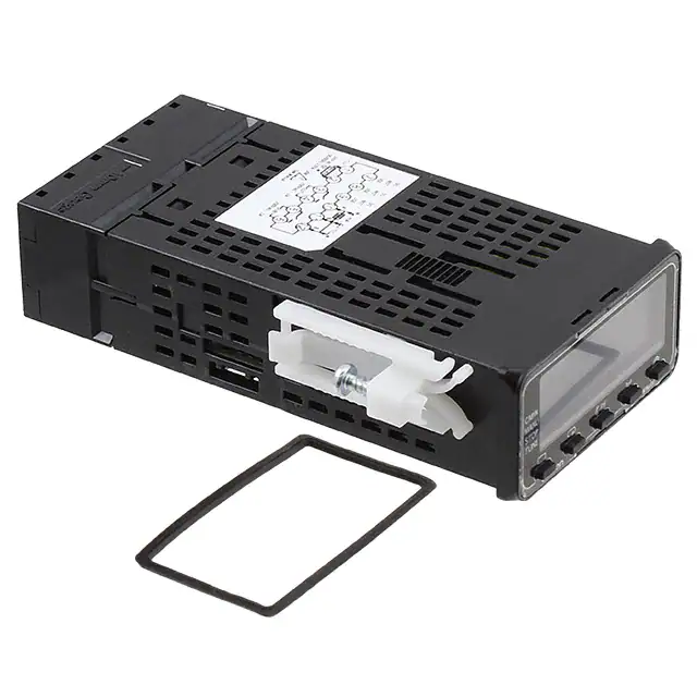

Digital Temperature Controller E5GC (48 × 24 mm) Easy Operation and High Performance of the E5@C Series in a Compact 48 × 24mm Body • A compact body of 48 × 24 × 90 mm (W × H × D) that is ideal for small equipment, laboratory instruments, and others. • White PV display with a height of 10.5 mm for high visibility even with the compact body. • Removable terminal block to simplify maintenance. Select from screw terminals or screwless clamp terminals for the wiring method. • High-speed sampling at 50 ms. • Easy connections to a PLC with programless communications. • Set up the Controller without wiring the power supply by connecting to the computer with a Communications Conversion Cable (sold separately). Setup is easy with the CX-Thermo (sold separately). 48 × 24 mm Models with Screw Terminal Blocks E5GC-@6 48 × 24 mm Models with Screwless Clamp Terminal Blocks E5GC-@C Refer to your OMRON website for the most recent information on applicable safety standards. Refer to Safety Precautions on page 104. Main I/O Functions Sensor Input Universal input • Thermocouple • Pt • Analog current/voltage E5GC Dual displays: PV/SV Control Output 1 • Relay output • Voltage output (for driving SSR) • Linear current output Indication Accuracy • Thermocouple input: ±0.3% of PV • Pt input: ±0.2% of PV • Analog input: ±0.2% of FS Sampling Period • 50 ms Event Inputs • None •1 •2 Serial Communications • None • RS-485 4-digit displays • PF (shift) Key • Temperature status display • Simple programming • Independent heating and cooling PID control • Changed parameter display • Display brightness setting • Simple transfer output (only on models with liner current outputs) • Work Bit Message Auxiliary Outputs • None •1 •2 This datasheet is provided as a guideline for selecting products. Be sure to refer to the following manuals for application precautions and other information required for operation before attempting to use the product. E5@C Digital Temperature Controllers User’s Manual (Cat. No. H174) E5@C Digital Temperature Controllers Communications Manual (Cat. No. H175) 1 E5GC Model Number Legend and Standard Models Model Number Legend E5GC-@@ @ @ @ M-@@@ (Example: E5GC-RX1A6M-015) −− − − − − −−− A B C D E F Model A B Control No. of outputs 1 auxiliary and 2 outputs C Power supply voltage D E F Terminal type Input type Options Meaning 48 × 24 mm E5GC Control output 1 Relay output Voltage output (for driving SSR) Linear current output RX QX *1 CX *2 0 1 2 A D 6 C M *3 *3, *4 *5 *1 *2 *3 *4 *5 000 015 016 023 024 Heating and Cooling Control A Control Output Assignment An auxiliary output is used as the cooling control output. B Control If PID control is used, you can set PID control separately for heating and cooling. This allows you to handle control systems with different heating and cooling response characteristics. 2 None None None 1 2 100 to 240 VAC 24 VAC/DC Screw terminals (with cover) Screwless clamp terminals Universal input HB alarm and HS alarm Communications Event inputs --------RS-485 ------1 1 --------2 The control output can be used as a simple transfer output. Only option 000 can be selected if an auxiliary output is zero. Option 016 and 023 can be selected only if two auxiliary outputs are selected. Option with HB and HS alarms (023) cannot be selected if a linear current output is selected for the control output. Option 024 can be selected only if one auxiliary output is selected. ●Using Heating and Cooling Control Control output 2 None E5GC Optional Products (Order Separately) USB-Serial Conversion Cable Model E58-CIFQ2 Model Y92S-P12 Communications Conversion Cable Model E58-CIFQ2-E Note: This Waterproof Packing is provided with the Digital Temperature Controller. Draw-out Jig Note: Always use this product together with the E58-CIFQ2. This Cable is used to connect to the bottom-panel Setup Tool port. Current Transformers (CTs) Hole diameter 5.8 mm 12.0 mm Waterproof Packing Model E54-CT1 E54-CT3 Mounting Adapter Model Y92F-53 (2pcs) Model Y92F-55 CX-Thermo Support Software Model EST2-2C-MV4 Note: CX-Thermo version 4.62 or higher is required for the E5GC. For the system requirements for the CX-Thermo, refer to information on the EST2-2C-MV4 on the OMRON website (www.ia.omron.com). Note: This Mounting Adapter is provided with the Digital Temperature Controller. 3 E5GC Specifications Ratings Power supply voltage Operating voltage range Power consumption Sensor input Input impedance Control method Relay output Control output Auxiliary output Voltage output (for driving SSR) Linear current output Number of outputs Output specifications Number of inputs Event input External contact input specifications Setting method Indication method Multi SP Bank switching Other functions Ambient operating temperature Ambient operating humidity Storage temperature Altitude Recommended fuse Installation environment A in model number: 100 to 240 VAC, 50/60 Hz D in model number: 24 VAC, 50/60 Hz; 24 VDC 85% to 110% of rated supply voltage 5.9 VA max. at 100 to 240 VAC, and 3.2 VA max. at 24 VAC or 1.8 W max. at 24 VDC Temperature input Thermocouple: K, J, T, E, L, U, N, R, S, B, W, or PL II Platinum resistance thermometer: Pt100 or JPt100 Infrared temperature sensor (ES1B): 10 to 70°C, 60 to 120°C, 115 to 165°C, or 140 to 260°C Analog input Current input: 4 to 20 mA or 0 to 20 mA Voltage input: 1 to 5 V, 0 to 5 V, or 0 to 10 V Current input: 150 Ω max., Voltage input: 1 MΩ min. (Use a 1:1 connection when connecting the ES2-HB/ THB.) ON/OFF control or 2-PID control (with auto-tuning) SPST-NO, 250 VAC, 2 A (resistive load), electrical life: 100,000 operations, minimum applicable load: 5 V, 10 mA (reference value) Output voltage 12 VDC ±20% (PNP), max. Load current: 21 mA, with short-circuit protection circuit 4 to 20 mA DC/0 to 20 mA DC, load: 500 Ω max., resolution: Approx. 10,000 1 or 2 (depends on model) SPST-NO relay outputs, 250 VAC, 2 A (resistive load), Electrical life: 100,000 operations, Minimum applicable load: 10 mA at 5 V (reference value) 1 or 2 (depends on model) Contact input ON: 1 kΩ max., OFF: 100 kΩ min. Non-contact input ON: Residual voltage 1.5 V max.; OFF: Leakage current 0.1 mA max. Current flow: approx. 7 mA per contact Digital setting using front panel keys 11-segment digital displays and individual indicators Character height: PV: 10.5 mm, SV: 5.0 mm Up to eight set points (SP0 to SP7) can be saved and selected using the event inputs, key operations, or serial communications.* None Manual output, heating/cooling control, loop burnout alarm, SP ramp, other alarm functions, heater burnout (HB) alarm (including SSR failure (HS) alarm), 40% AT, 100% AT, MV limiter, input digital filter, self tuning, robust tuning, PV input shift, run/stop, protection functions, extraction of square root, MV change rate limit, logic operations, temperature status display, simple programming, moving average of input value, display brightness setting, simple transfer output, and work bit message −10 to 55°C (with no condensation or icing), For 3-year warranty: −10 to 50°C with standard mounting (with no condensation or icing) 25% to 85% −25 to 65°C (with no condensation or icing) 2,000 m max. T2A, 250 VAC, time-lag, low-breaking capacity Installation Category II, Pollution Degree 2 (IEC 61010-1 compliant) * Only four set points are selectable for event inputs. 4 E5GC Input Ranges ●Thermocouple/Platinum Resistance Thermometer (Universal inputs) Sensor type Platinum resistance thermometer Sensor specification Pt100 Infrared temperature sensor Thermocouple JPt100 K J T E L U N R S B W PLII 10 to 70°C 60 to 120°C 115 to 165°C 120 165 140 to 260°C 2300 2300 1800 1800 1700 1700 1700 Temperature range (°C) 1600 1500 1400 1300 1300 1300 1300 1200 1100 1000 900 850 850 850 800 700 600 600 500.0 500 500.0 500.0 400.0 400 400 400.0 400 400.0 260 300 200 100.0 100 Set value 90 100 0.0 -100 -200 100.0 -200 -199.9 0 1 0.0 -199.9 2 3 -20.0 -100 -20.0 6 7 8 -200 4 5 0 0 16 17 0 0 0 0 0 0 19 20 21 22 23 24 -100 -200 -199.9 -200 9 10 11 -200 -199.9 -200 12 13 14 15 18 Shaded settings are the default settings. The applicable standards for the input types are as follows: K, J, T, E, N, R, S, B: JIS C 1602-1995, IEC 60584-1 L: Fe-CuNi, DIN 43710-1985 U: Cu-CuNi, DIN 43710-1985 W: W5Re/W26Re, ASTM E988-1990 JPt100: JIS C 1604-1989, JIS C 1606-1989 Pt100: JIS C 1604-1997, IEC 60751 PL II: According to Platinel II electromotive force charts from BASF (previously Engelhard) ●Analog input Input type Input specification Setting range Set value Current Voltage 4 to 20 mA 0 to 20 mA 1 to 5 V 0 to 5 V Usable in the following ranges by scaling: -1999 to 9999, -199.9 to 999.9, -19.99 to 99.99 or -1.999 to 9.999 25 26 27 28 0 to 10 V 29 5 E5GC Alarm Types Each alarm can be independently set to one of the following 17 alarm types. The default is 2: Upper limit. (See note.) Auxiliary outputs are allocated to alarms. ON delays and OFF delays (0 to 999 s) can also be specified. Note: In the default settings for models with HB or HS alarms, alarm 1 is set to a heater alarm (HA) and the Alarm Type 1 parameter is not displayed. To use alarm 1, set the output assignment to alarm 1. Set value Alarm type 0 Alarm function OFF 1 Upper- and lower-limit *1 2 Upper-limit (default) 3 Lower-limit 4 Upper- and lower-limit range *1 5 6 7 8 9 10 11 Alarm output operation Description of function When alarm value X When alarm value X is positive is negative Output OFF No alarm Set the upward deviation in the set point for the alarm upper L H limit (H) and the lower deviation in the set point for the alarm ON *2 OFF PV lower limit (L). The alarm is ON when the PV is outside this SP deviation range. Set the upward deviation in the set point by setting the alarm X X ON ON value (X). The alarm is ON when the PV is higher than the OFF PV OFF PV SP SP SP by the deviation or more. Set the downward deviation in the set point by setting the X X ON ON alarm value (X). The alarm is ON when the PV is lower than OFF PV OFF PV SP SP the SP by the deviation or more. Set the upward deviation in the set point for the alarm upper L H limit (H) and the lower deviation in the set point for the alarm ON *3 OFF PV lower limit (L). The alarm is ON when the PV is inside this deSP viation range. Upper- and lower-limit with standby sequence *1 *5 Upper-limit with standby sequence Lower-limit with standby sequence ON OFF Absolute-value upper-limit ON OFF Absolute-value lower-limit ON OFF Absolute-value upper-limit with standby sequence ON OFF Absolute-value lower-limit with standby sequence ON OFF LBA (alarm 1 type only) PV change rate alarm 14 SP absolute-value upper-limit alarm ON OFF SP absolute-value lower-limit alarm ON OFF X SP PV ON OFF PV ON OFF PV ON OFF PV ON OFF PV ON OFF PV ON OFF X SP X 0 X 0 X 0 X 0 X 0 ON OFF A standby sequence is added to the upper-limit alarm (2). *6 PV A standby sequence is added to the lower-limit alarm (3). *6 X SP X 0 PV X 0 PV X 0 PV X 0 PV ON OFF SP ON OFF X 0 The alarm will turn ON if the process value is smaller than the alarm value (X) regardless of the set point. A standby sequence is added to the absolute-value upperlimit alarm (8). *6 A standby sequence is added to the absolute-value lowerlimit alarm (9). *6 X 0 SP X 0 SP This alarm type turns ON the alarm when the set point (SP) is higher than the alarm value (X). This alarm type turns ON the alarm when the set point (SP) is lower than the alarm value (X). Standard Control X MV 0 The alarm will turn ON if the process value is larger than the alarm value (X) regardless of the set point. ON OFF X 0 MV X MV 0 Standard Control X MV 0 Always ON ON OFF X 0 MV This alarm type turns ON the alarm when the manipulated Heating/Cooling Heating/Cooling variable (MV) is lower than the alarm value (X). Control (Cooling MV) Control (Cooling MV) ON OFF 6 PV *7 *8 SP Standard Control 17 SP This alarm type turns ON the alarm when the manipulated Heating/Cooling Heating/Cooling variable (MV) is higher than the alarm value (X). Control (Heating MV) Control (Heating MV) ON OFF MV absolute-value lower-limit alarm *9 X - ON OFF MV absolute-value upper-limit alarm *9 *4 PV Standard Control 16 A standby sequence is added to the upper- and lower-limit alarm (1). *6 H SP ON OFF 12 13 15 L ON OFF X 0 MV Always ON E5GC *1 With set values 1, 4, and 5, the upper- and lower-limit values can be set independently for each alarm type, and are expressed as “L” and “H.” *2 Set value: 1, Upper- and lower-limit alarm Case 3 (Always OFF) Case 2 Case 1 H0, L
