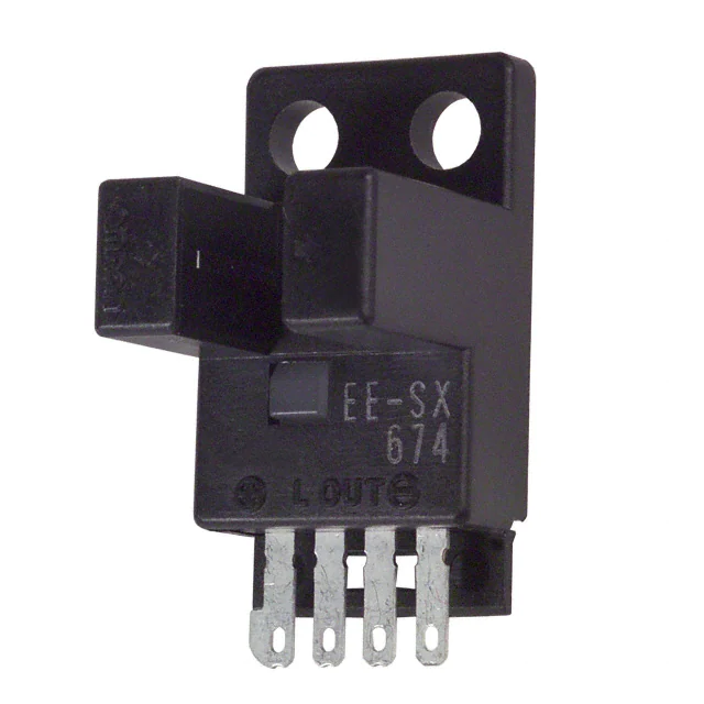

Slot-type Photomicrosensor (Non-modulated) *1 EE-SX47/67 CSM_EE-SX47/67_DS_E_13_2 Global Standard Slot-type photomicrosensors with 50- to 100-mA direct switching capacity. • Series includes models that enable switching between dark-ON and light-ON operation. • Response frequency as high as 1 kHz. • Easy operation monitoring with bright light indicator. • Wide operating voltage range: 5 to 24 VDC • Models in which the light indicator turns ON for dark-ON operation are also available. • A wide range of variations in eight different shapes. • Flexible robot cable is provided as a standard feature. *2 Be sure to read Safety Precautions on page 5. For the most recent information on models that have been certified for safety standards, refer to your OMRON website. *1. Pre-wired Models are available only in the EE-SX67 Series. *2. Only for Pre-wired Models. Ordering Information Connector Appearance Infrared light Sensing Connectmethod ing method Sensing distance Standard L-shaped T-shaped, slot center 7 mm Closemounting Closemounting T-shaped, slot center 10 mm Throughbeam type (with slot) Connector (4 poles) 5 mm (slot width) Output configuration Indicator mode Model NPN output PNP output Dark-ON/Light-ON Incident light (selectable) *3 *4 No incident light EE-SX670 EE-SX670P EE-SX670A EE-SX670R Light-ON EE-SX470 Incident light --- Dark-ON/Light-ON Incident light (selectable) *3 *4 No incident light EE-SX671 EE-SX671P EE-SX671A EE-SX671R Light-ON EE-SX471 --- Dark-ON/Light-ON Incident light (selectable) *3 *4 No incident light EE-SX672 EE-SX672P EE-SX672A EE-SX672R Light-ON EE-SX472 --- Dark-ON/Light-ON Incident light (selectable) *3 *4 No incident light EE-SX673 EE-SX673P EE-SX673A EE-SX673R Light-ON EE-SX473 --- Dark-ON/Light-ON Incident light (selectable) *3 *4 No incident light EE-SX674 EE-SX674P EE-SX674A EE-SX674R Light-ON Incident light EE-SX474 --- Dark-ON/Light-ON Incident light (selectable) *3 *4 EE-SX675 EE-SX675P Dark-ON/Light-ON Incident light (selectable) *3 *4 EE-SX676 EE-SX676P Dark-ON/Light-ON Incident light (selectable) *3 *4 EE-SX677 EE-SX677P Incident light Incident light Incident light F-shaped R-shaped *3. Dark-ON when the L terminal of the connector is opened, and light-ON when the L terminal and positive (+) terminal are connected. Do not connect the L terminal to 0 V when using dark-ON operation. When using light-ON, it is useful to select the connector EE-1001-1. The L terminal and positive (+) terminal of this connector are connected in advance. *4. If you do not use the L terminal wire ((2) pink) when you use a Connector with Cable for an EE-1006 or EE-1010-series Photomicrosensor, noise may affect the Photomicrosensor. To prevent the effects of noise, cut the unused L terminal wire at the base of the connector and wrap it with insulating tape to prevent it from coming in contact with other terminals. 1 EE-SX47/67 Pre-wired Models Appearance Infrared light Sensing method Sensing distance Output configuration Indicator mode Connecting method Model NPN output PNP output Standard EE-SX670-WR 1M EE-SX670P-WR 1M EE-SX671-WR 1M EE-SX671P-WR 1M EE-SX672-WR 1M EE-SX672P-WR 1M EE-SX673-WR 1M EE-SX673P-WR 1M EE-SX674-WR 1M EE-SX674P-WR 1M EE-SX675-WR 1M EE-SX675P-WR 1M EE-SX676-WR 1M EE-SX676P-WR 1M EE-SX677-WR 1M EE-SX677P-WR 1M L-shaped T-shaped, slot center 7 mm Closemounting Throughbeam type (with slot) Closemounting Dark-ON/ Light-ON 5 mm (slot width) (selectable) *1 *2 Incident light T-shaped, slot center 10 mm Pre-wired Models (1m) F-shaped R-shaped *1. Dark-ON operation can be used when the L terminal is left unconnected or Light-ON operation can be used when the L terminal and positive (+) terminal are connected to each other. Do not connect the L terminal to 0 V when using dark-ON operation. *2. If you do not use the L terminal wire ((2) pink) when you use a Connector with Cable for an EE-1006 or EE-1010-series Photomicrosensor, noise may affect the Photomicrosensor. To prevent the effects of noise, cut the unused L terminal wire at the base of the connector and wrap it with insulating tape to prevent it from coming in contact with other terminals. Accessories (Order Separately) Connector Models Type Cable length Connector 1m Connector with Cable 2m Connector with Robot Cable Connector Hold-down Clip 1m 2m Model EE-1001 EE-1001-1 EE-1009 * EE-1006 1M EE-1010 1M * EE-1006 2M EE-1010 2M * EE-1010-R 1M * EE-1010-R 2M * EE-1006A Remarks L terminal and positive (+) terminal are already short-circuited. Applicable Photomicrosensors For EE-SX670@ and 470@ only. (Can be used only with EE-1006 Connectors for the Photomicrosensors listed above.) Note: For details, refer to the Photomicro Sensors Accessories on EE-@ which can be accessed from your OMRON website. * EE-1009- or EE-1010-series Connectors have a builtin locking mechanism to prevent cable disconnection when only the cable is pulled. To remove the Connector from the Sensor, grip the top and bottom of the Connector firmly and push into the Sensor once before pulling out. The locking mechanism prevents the Connector from being removed by pulling on the cable only and enables removal only when the Connector (housing) is pulled. 2 EE-SX47/67 Ratings and Specifications Type Standard L-shaped T-shaped, slot center 7 mm EE-SX672 EE-SX672A EE-SX472 EE-SX672WR EE-SX672P EE-SX672R EE-SX672PWR T-shaped, slot center 10 mm Close-mounting F-shaped R-shaped EE-SX670 EE-SX671 EE-SX673 EE-SX674 Connector EE-SX670A EE-SX671A EE-SX673A EE-SX674A EE-SX675 EE-SX676 EE-SX677 models EE-SX470 EE-SX471 EE-SX473 EE-SX474 Pre-wired EE-SX670EE-SX671EE-SX673EE-SX674EE-SX675EE-SX676EE-SX677models WR WR WR WR WR WR WR Connector EE-SX670P EE-SX671P EE-SX673P EE-SX674P EE-SX675P EE-SX676P EE-SX677P models EE-SX670R EE-SX671R EE-SX673R EE-SX674R PNP models Pre-wired EE-SX670PEE-SX671PEE-SX673PEE-SX674PEE-SX675PEE-SX676PEE-SX677PItem models WR WR WR WR WR WR WR Sensing distance 5 mm (slot width) Sensing object Opaque: 2 × 0.8 mm min. Differential distance 0.025 mm Light source Infrared LED with a peak wavelength of 940 nm Indicator *1 Light indicator (red) (turns ON when light is interrupted for models with A or R suffix) Supply voltage 5 to 24 VDC ±10%, ripple (p-p): 10% max. Current consumption 12 mA max. (Connector models, L terminal open), 35 mA max. (NPN pre-wired models), 30 mA max. (PNP pre-wired models) NPN open collector: 5 to 24 VDC, 100 mA max. 100 mA load current with a residual voltage of 0.8 V max. 40 mA load current with a residual voltage of 0.4 V max. Control output OFF current (leakage current): 0.5 mA max. PNP open collector: 5 to 24 VDC, 50 mA max. 50 mA load current with a residual voltage of 1.3 V max. OFF current (leakage current): 0.5 mA max. Protection circuits Load short circuit protection (Connector models), No circuit protection (Pre-wired models) Response frequency *2 1 kHz min. (3 kHz average) Ambient illumination 1,000 lx max. with fluorescent light on the surface of the receiver. Ambient temperature range Operating: −25 to +55°C, Storage: −30 to +80°C (with no icing or condensation) Ambient humidity range Operating: 5% to 85%, Storage: 5% to 95% (with no icing or condensation) Destruction: 20 to 2,000 Hz (peak acceleration: 100 m/s2) Vibration resistance 1.5-mm double amplitude for 2 h (4-min periods) each in X, Y, and Z directions Shock resistance Destruction: 500 m/s2 for 3 times each in X, Y, and Z directions Degree of protection IEC60529 IP50 Connector Models (direct soldering possible), Pre-wired Models (Standard cable length: 1 m), Connecting method Models with Connectors (Standard cable length: 0.1 m) Approx. 3.1 g Approx. 3 g Approx. 2.4 g Approx. 2.3 g Approx. 3 g Approx. 2.7 g Approx. 2.2 g Approx. 2.2 g Wei- Connector models ght Pre-wired models Approx. 18.9 g Approx. 17.3 g Approx. 17.8 g Approx. 16.8 g Approx. 17.1 g Approx. 18.3 g Approx. 16.9 g Approx. 16.9 g Polybutylene phthalate (PBT) Ma- Case teri- Cover Polycarbonate al Emitter/receiver NPN models *1. The indicator is a GaP red LED (peak wavelength: 690 nm). *2. The response frequency was measured by detecting the rotating disk shown at the right. Disk 1 mm 2.1 mm 1 mm t = 0.2 mm 3 EE-SX47/67 Engineering Data (Reference Value) Sensing Position Characteristics EE-SX47@/67@ Sensing Position Characteristics EE-SX47@/67@ Repeated Sensing Position Characteristics EE-SX47@/67@ d Dark-ON Dark-ON Dark-ON Δd2 Δd3 Δd1 Δd4 d Δd5 d Light-ON Ta = −25°C Ta = 55°C Ta = 25°C Light-ON 0 1.0 2.0 3.0 4.0 5.0 6.0 Light-ON 0 1.0 Distance d (mm) 2.0 3.0 4.0 5.0 6.0 Distance d (mm) 0 3.20 3.22 3.24 3.26 3.28 Distance d (mm) Vcc =12 V, No. of repetitions: 20, Δd1 = 0.002 mm, Δd2 = 0.004 mm, Δd3 = 0.005 mm, Δd4 = 0.02 mm, Δd5 = 0.04 mm Note: The data applies to dark status. Operation may be affected by external light interference or light coming through the sensing object. I/O Circuit Diagrams NPN Output Model Output configuration Light-ON EE-SX67@ EE-SX67@-WR Incident Interrupted ON OFF ON Output transistor OFF Operates Load (e.g., relay) Releases Light indicator (red) Terminal connections L Incident Interrupted ON Light indicator (red) OFF ON Output transistor OFF Operates Load (e.g., relay) Releases Short-circuited between L terminal and positive terminal Dark-ON Incident Interrupted Light indicator ON (red) OFF Output ON transistor OFF Operates Load (e.g., relay) Releases Open between L terminal and positive terminal *1 *2 Light-ON Incident Interrupted ON Light indicator (red) OFF ON Output transistor OFF Operates Load (relay) Releases EE-SX670A EE-SX671A EE-SX672A EE-SX673A EE-SX674A * (red) Open between L terminal and positive terminal *1 *2 Light-ON Output circuit EE-SX67@ Short-circuited between EE-SX67@A L terminal and positive terminal Light indicator Incident Interrupted ON Light indicator (red) OFF ON Output transistor OFF Operates Load (e.g., relay) Releases Dark-ON EE-SX470 EE-SX471 EE-SX472 EE-SX473 EE-SX474 Timing charts Main circuit Load OUT IC (Control output) 100 mA max. 5 to 24 VDC *The terminal arrangement depends on the model. Check the dimensional diagrams. EE-SX67@-WR * Light indicator (red) L Main circuit Load OUT IC (Control output) 100 mA max. 5 to 24 VDC *The terminal arrangement depends on the model. Check the dimensional diagrams. Light indicator (red) Load --- Main circuit OUT IC 5 to 24 VDC *1. Do not connect the L terminal to 0 V when using dark-ON operation. *2. If you do not use the L terminal wire ((2) pink) when you use a Connector with Cable for an EE-1006 or EE-1010-series Photomicrosensor, noise may affect the Photomicrosensor. To prevent the effects of noise, cut the unused L terminal wire at the base of the connector and wrap it with insulating tape to prevent it from coming in contact with other terminals. 4 EE-SX47/67 PNP Output Output configuration Model Timing charts Incident Interrupted Light-ON Light indicator (red) Output transistor Load (relay) EE-SX67@P EE-SX67@P-WR ON OFF ON OFF Operates Light indicator (red) Output transistor Load (relay) ON OFF ON OFF Operates EE-SX670R EE-SX671R EE-SX672R EE-SX673R EE-SX674R Light indicator (red) Output transistor Short-circuited between L terminal and positive terminal Open between L terminal and positive terminal *1 *2 ON OFF ON OFF Operates * Light indicator (red) L Releases Incident Interrupted Light-ON Output circuit Releases Incident Interrupted Dark-ON Terminal connections 5 to 24 VDC OUT IC Main circuit Load Short-circuited between L terminal and positive terminal *The terminal arrangement depends on the model. Check the dimensional diagrams. Load (e.g., relay) Releases Dark-ON Incident Interrupted ON Light indicator (red) OFF ON Output transistor OFF Operates Load (e.g., relay) Releases Open between L terminal and positive terminal *1 *2 *1. Do not connect the L terminal to 0 V when using dark-ON operation. *2. If you do not use the L terminal wire ((2) pink) when you use a Connector with Cable for an EE-1006 or EE-1010-series Photomicrosensor, noise may affect the Photomicrosensor. To prevent the effects of noise, cut the unused L terminal wire at the base of the connector and wrap it with insulating tape to prevent it from coming in contact with other terminals. Safety Precautions Refer to Warranty and Limitations of Liability. WARNING This product is not designed or rated for ensuring safety of persons either directly or indirectly. Do not use it for such purposes. Precautions for Correct Use Make sure that this product is used within the rated ambient environment conditions. ● Installation • When direct soldering to the terminals, use the following guidelines. Precautions for Safe Use ● Operating Environment These Photomicrosensors have an IP50 (conforms to IEC) enclosure and do not have a water-proof or dust-proof structure. Therefore, do not use them in applications in which the sensor will be subjected to splashes from water, oil, or any other liquid. Liquid entering the Sensor may result in malfunction. Soldering Conditions Item Soldering iron Temper- Permissible ature time 350°C max. 3 s max. Remarks The portion between the base of the terminals and the position 1.5 mm from the terminal base must not be soldered. • The terminal base uses a polycarbonate resin, which could be deformed by excessive soldering heat, resulting in damage to the product's functionality. ● Lot Number and Model Number Legend In the following diagrams, 343U indicates the lot number and factory where the product was manufactured. Do not include this code with the model number when ordering. The QR code on connector models is used by OMRON only. EE-SX@70@ Model number EE-SX670 343U Lot number and factory code 5 EE-SX47/67 (Unit: mm) Dimensions Tolerance class IT16 applies to dimensions in this datasheet unless otherwise specified. Sensors EE-SX670/670P EE-SX670A/670R EE-SX470 EE-SX671/671P EE-SX671A/671R EE-SX471 Terminal Arrangement (1) Vcc (2) L (3) OUT Terminal Arrangement (1) L* OUTPUT (4) Vcc (2) L L* (3) OUT OUTPUT (4) GND (0 V) GND (0 V) * Pin 2 is not used for the EE-SX471. * Pin 2 is not used for the EE-SX470. 26.2 25.4 19 19 Two, 3.2 dia. holes Four, R3.5 3.2 6.95 14.5 3 19 13.4 5 Four, R1 4 3 Four, R1 6.4 0.8 6.2 3.8 Indicator window 1 2 3 4 2.54 9 Optical axis 2 13 6.35 0.8 13.4 5 13.8 8.4 13.2 6.2 9 Two, 3.8 dia. holes Indicator window 5.5 3.8 Optical axis Two, 3.2 dia. holes 8.3 9 2 3 4 0.3 2.54 15.5 2.1 0.3 7.2 7.2 6.2 0.7 3.6 1 2 0.7 13 13.4 0.6 6.95 19 EE-SX672/672P EE-SX672A/672R EE-SX472 Terminal Arrangement (1) Vcc EE-SX673/673P EE-SX673A/673R EE-SX473 Terminal Arrangement (1) Vcc (2) L L* (2) L L* (3) OUT OUTPUT (3) OUT OUTPUT (4) GND (0 V) (4) * Pin 2 is not used for the EE-SX472. GND (0 V) * Pin 2 is not used for the EE-SX473. 13.7 3 26 12.6 6.4 6.3 12.8 (6.65) 3.5 Two, R1 Two, 3.2 dia. holes 7 7 13.4 0.8 13.4 5 5 2 Optical axis 9 4.3 13 Optical axis 9 Indicator window 3 Four, R1.6 22.2 0.8 14.4 22.2 8.4 6.2 2 2.8 6.3 6.3 2.5 Four, R1 6.2 3.8 6.2 2.5 1 0.3 2 3 0.7 19 4.9 4 2.54 3.8 Indicator window 1 2 3 4 2.54 0.3 0.7 13 6 EE-SX47/67 EE-SX674/674P EE-SX674A/674R EE-SX474 EE-SX675/675P Terminal Arrangement Terminal Arrangement (1) Vcc (1) Vcc (2) L L* (2) L L (3) OUT OUTPUT (3) OUT OUTPUT GND (0 V) (4) (4) GND (0 V) * Pin 2 is not used for the EE-SX474. 16.7 4 Optical axis Two, R1 Two, 3.5 dia. holes 7 6.35 26 Indicator window 7 10 21.5 6.95 3 0.8 3 Sensing window 3.8 6.2 13.4 5 Optical axis 9 1 2 3 13 2.54 13 5 0.8 0.1 3.7 Four, R1.6 22.2 Four, R3 Optical axis 2.1 3.2 2 (9.3) 15.5 0.3 2.5 3.8 6.2 0.7 0.3 6.2 2.6 0.7 1 2 3 4 2.54 19.5 13 16.7 0.6 13.6 3 8.4 6 6.3 (2.9) Indicator window 2 4 EE-SX676/676P EE-SX677/677P Terminal Arrangement (1) (1) Vcc (2) L L (2) L L (3) OUT OUTPUT (3) OUT OUTPUT GND (0 V) (4) (4) 13.7 Terminal Arrangement Vcc Optical axis GND (0 V) 13.7 Optical axis 2.5 2.5 13.2 7 13.2 6.35 6.35 13.4 7 7 0.8 5 Optical axis 9 Indicator window 8.4 13.4 5 0.8 Optical axis 22.2 7 Sensing window 2 9 3 13.6 9 2 22.2 Sensing window 7 8.4 3 7 13.6 2.5 6.2 Indicator window 9 2.5 3.3 3.8 3.3 0.3 0.3 1 2 3 4 2.54 Two, 3.5 dia. holes 0.7 0.7 6.2 3.8 1 2 3 4 Two, 3.5 dia. holes 2.54 7 EE-SX47/67 EE-SX671-WR/671P-WR EE-SX670-WR/670P-WR Terminal Arrangement Brown Terminal Arrangement Vcc Brown Vcc Pink L Pink L Blue GND (0 V) Blue GND (0 V) Black OUTPUT Black OUTPUT 26.2 Four, R3.5 Four, R1 Optical axis 6.95 Optical axis 19 3.2 6.95 3 Four, R1 19 18.7 3 Two, 3.2 dia. holes 4 Indicator window 25.4 2 13.4 6.35 Optical axis 5 0.8 Robot cable of 2.8 dia., 4 cores, (0.15 mm2 with 0.8 mm dia. insulator); Standard length: 1 m 13.4 2 9 11.2 8.4 26.2 6.35 13.4 5 Sensing window 13.8 3 Optical axis 11 5.5 2.5 Indicator window 9 4.6 dia. 2.8 6.2 7.2 Two, 3.8 dia. holes 4.6 dia. 2 2 9 15.5 0.8 Sensing window Robot cable of 2.8 dia., 4 cores, (0.15 mm2 with 0.8 mm dia. insulator); Standard length: 1 m 3.6 EE-SX672-WR/672P-WR 19 Two, 3.2 dia. holes EE-SX673-WR/673P-WR Terminal Arrangement Brown Terminal Arrangement Vcc Brown Vcc Pink L Pink L Blue GND (0 V) Blue GND (0 V) Black OUTPUT Black OUTPUT 13.7 7 Optical axis 12.6 6.3 12.8 Optical axis 3 (6.65) 3.5 Four, R1 7 Two, 3.2 dia. holes 13.4 6.35 5 13.4 5 0.8 Sensing window Optical axis 2 2.5 13 9 9 4.3 Indicator window Four, R1.6 26.2 14.4 2.5 2 4.6 dia. 19 Sensing window 8.4 8.9 Four, R1 2 dia. 2 26.2 6.2 10.3 0.8 Optical axis Robot cable of 2.8 dia., 4 cores, (0.15 mm2 with 0.8 mm dia. insulator); Standard length: 1 m 2.8 Indicator window 3 2 Robot cable of 2.8 dia., 4 cores, (0.15 mm2 with 0.8 mm dia. insulator); Standard length: 1 m 4.6 dia. 26 8 EE-SX47/67 EE-SX675-WR/675P-WR EE-SX674-WR/674P-WR Terminal Arrangement Brown Two, 3.5 dia. holes Terminal Arrangement Vcc Brown L Pink L Blue GND(0V) Blue GND(0V) Black OUTPUT Black OUTPUT Two, R1 7 Vcc Pink 10 Optical axis 6.35 26 7 7 4 6.95 25.7 Optical axis 3 3 13.4 5 19.5 0.8 Sensing window 2 Optical axis 2 Indicator window 9 Four, R1.6 Robot cable of 2.8 dia., 4 cores, (0.15 mm2 with 0.8 mm dia. insulator); Standard length: 1 m Indicator window 13 3 26.2 8.4 6 3.2 13.6 5 Optical axis 0.8 Sensing window (2.9) 3.7 2.5 10.3 Four, R3 2 9 4.6 dia. 2 15.5 4.6 dia. Robot cable of 2.8 dia., 4 cores, (0.15 mm2 with 0.8 mm dia. insulator); Standard length: 1 m 2.6 6.2 2.8 13.4 16.7 EE-SX676-WR/676P-WR EE-SX677-WR/677P-WR Terminal Arrangement Brown Terminal Arrangement Vcc Brown Vcc Pink L Pink L Blue GND(0V) Blue GND(0V) Black OUTPUT Black OUTPUT Optical axis 2.5 Optical axis 2.5 7 7 13.7 13.7 13.2 6.4 13.2 Optical axis 6.4 13.4 5 7 9 8.4 3 Sensing window 13.4 5 Indicator window 9 9 0.8 26.2 8.4 26.2 13 Optical axis 2 2 0.8 9 Sensing window 7 7 7 2.5 2.5 3 13 3.3 3.3 Indicator window 2 4.6 dia. 4 4 Two, 3.5 dia. holes Robot cable of 2.8 dia., 4 cores, (0.15 mm2 with 0.8 mm dia. insulator); Standard length: 1 m Two, 3.5 dia. holes 4.6 dia. 2 Robot cable of 2.8 dia., 4 cores, (0.15 mm2 with 0.8 mm dia. insulator); Standard length: 1 m 9 Terms and Conditions Agreement Read and understand this catalog. Please read and understand this catalog before purchasing the products. Please consult your OMRON representative if you have any questions or comments. Warranties. (a) Exclusive Warranty. Omron’s exclusive warranty is that the Products will be free from defects in materials and workmanship for a period of twelve months from the date of sale by Omron (or such other period expressed in writing by Omron). Omron disclaims all other warranties, express or implied. (b) Limitations. OMRON MAKES NO WARRANTY OR REPRESENTATION, EXPRESS OR IMPLIED, ABOUT NON-INFRINGEMENT, MERCHANTABILITY OR FITNESS FOR A PARTICULAR PURPOSE OF THE PRODUCTS. BUYER ACKNOWLEDGES THAT IT ALONE HAS DETERMINED THAT THE PRODUCTS WILL SUITABLY MEET THE REQUIREMENTS OF THEIR INTENDED USE. Omron further disclaims all warranties and responsibility of any type for claims or expenses based on infringement by the Products or otherwise of any intellectual property right. (c) Buyer Remedy. Omron’s sole obligation hereunder shall be, at Omron’s election, to (i) replace (in the form originally shipped with Buyer responsible for labor charges for removal or replacement thereof) the non-complying Product, (ii) repair the non-complying Product, or (iii) repay or credit Buyer an amount equal to the purchase price of the non-complying Product; provided that in no event shall Omron be responsible for warranty, repair, indemnity or any other claims or expenses regarding the Products unless Omron’s analysis confirms that the Products were properly handled, stored, installed and maintained and not subject to contamination, abuse, misuse or inappropriate modification. Return of any Products by Buyer must be approved in writing by Omron before shipment. Omron Companies shall not be liable for the suitability or unsuitability or the results from the use of Products in combination with any electrical or electronic components, circuits, system assemblies or any other materials or substances or environments. Any advice, recommendations or information given orally or in writing, are not to be construed as an amendment or addition to the above warranty. See http://www.omron.com/global/ or contact your Omron representative for published information. Limitation on Liability; Etc. OMRON COMPANIES SHALL NOT BE LIABLE FOR SPECIAL, INDIRECT, INCIDENTAL, OR CONSEQUENTIAL DAMAGES, LOSS OF PROFITS OR PRODUCTION OR COMMERCIAL LOSS IN ANY WAY CONNECTED WITH THE PRODUCTS, WHETHER SUCH CLAIM IS BASED IN CONTRACT, WARRANTY, NEGLIGENCE OR STRICT LIABILITY. Further, in no event shall liability of Omron Companies exceed the individual price of the Product on which liability is asserted. Suitability of Use. Omron Companies shall not be responsible for conformity with any standards, codes or regulations which apply to the combination of the Product in the Buyer’s application or use of the Product. At Buyer’s request, Omron will provide applicable third party certification documents identifying ratings and limitations of use which apply to the Product. This information by itself is not sufficient for a complete determination of the suitability of the Product in combination with the end product, machine, system, or other application or use. Buyer shall be solely responsible for determining appropriateness of the particular Product with respect to Buyer’s application, product or system. Buyer shall take application responsibility in all cases. NEVER USE THE PRODUCT FOR AN APPLICATION INVOLVING SERIOUS RISK TO LIFE OR PROPERTY OR IN LARGE QUANTITIES WITHOUT ENSURING THAT THE SYSTEM AS A WHOLE HAS BEEN DESIGNED TO ADDRESS THE RISKS, AND THAT THE OMRON PRODUCT(S) IS PROPERLY RATED AND INSTALLED FOR THE INTENDED USE WITHIN THE OVERALL EQUIPMENT OR SYSTEM. Programmable Products. Omron Companies shall not be responsible for the user’s programming of a programmable Product, or any consequence thereof. Performance Data. Data presented in Omron Company websites, catalogs and other materials is provided as a guide for the user in determining suitability and does not constitute a warranty. It may represent the result of Omron’s test conditions, and the user must correlate it to actual application requirements. Actual performance is subject to the Omron’s Warranty and Limitations of Liability. Change in Specifications. Product specifications and accessories may be changed at any time based on improvements and other reasons. It is our practice to change part numbers when published ratings or features are changed, or when significant construction changes are made. However, some specifications of the Product may be changed without any notice. When in doubt, special part numbers may be assigned to fix or establish key specifications for your application. Please consult with your Omron’s representative at any time to confirm actual specifications of purchased Product. Errors and Omissions. Information presented by Omron Companies has been checked and is believed to be accurate; however, no responsibility is assumed for clerical, typographical or proofreading errors or omissions. 2017.7 In the interest of product improvement, specifications are subject to change without notice. OMRON Corporation Industrial Automation Company http://www.ia.omron.com/ (c)Copyright OMRON Corporation 2017 All Right Reserved.

物料型号:EE-SX47/67系列
器件简介: - 这是一系列全球标准的槽型光电传感器,具有50到100毫安的直接切换能力。 - 包括可以切换在暗ON和光ON操作的型号。 - 响应频率高达1kHz。 - 配备明亮的光指示器,便于操作监控。 - 宽工作电压范围:5至24VDC。 - 提供暗ON操作时的光指示器型号。 - 提供八种不同形状的广泛变化。 - 作为标准特性提供灵活的机器人电缆。
引脚分配: - 根据不同型号,引脚分配略有不同,但通常包括Vcc(电源)、L(控制端)、OUT(输出)和GND(地)。
参数特性: - 感应距离:标准型为5mm(槽宽)。 - 光源:使用波长约940nm的红外LED。 - 指示器:红色LED,当光线被中断时亮起(对于带有A或R后缀的型号)。 - 工作电压:5至24VDC±10%。 - 电流消耗:最大12mA(连接器型号,L端开路)。NPN型号最大100mA。 - 响应频率:最小1kHz(平均3kHz)。 - 环境光:最大1000lx,使用荧光灯在接收器表面。 - 环境温度范围:工作-25至+55°C,存储-30至+80°C。 - 环境湿度范围:工作5%至85%,存储5%至95%。 - 抗振动和冲击:具体数值未提供。
功能详解: - 提供NPN和PNP输出配置。 - 可以设置为暗ON或光ON操作模式。 - 通过连接器或预接线型号提供灵活的连接方式。
应用信息: - 适用于需要检测物体存在或位置的各种工业自动化应用。
封装信息: - 提供多种形状和尺寸,以适应不同的安装和应用需求。 - 重量和尺寸因型号而异。
安全注意事项: - 产品不适用于确保人员安全。 - 需要在规定的环境条件下使用。 - 避免在可能接触到水、油或其他液体的应用中使用。
订购信息: - 提供连接器型号和预接线型号。 - 连接器型号可以直接焊接。 - 提供不同长度的电缆选项。
